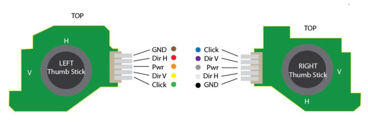

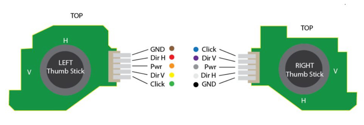

Hi!
A little off topic but since we are talking about Wii u gamepad maybe you can help.
I'm doing a Wii inside the Wii u gamepad and at the moment I'm wiring the buttons and analog sticks to the GC+.
My question is if anyone has got the analog sticks pinout.
I'm not sure were to wire the x and y axis and also how much voltage should I use on them.
Thanks
Hi!
Thanks
You can just use 3.3V for the sticks as well. The buttons all go to ground on one connection, and whatever gc+ data pin on the other, except for L and R (the analog ones).
These are connected to 3.3v and the data pins.
As for the analog stick pinout, just google em lol. Pretty sure some place has em..
