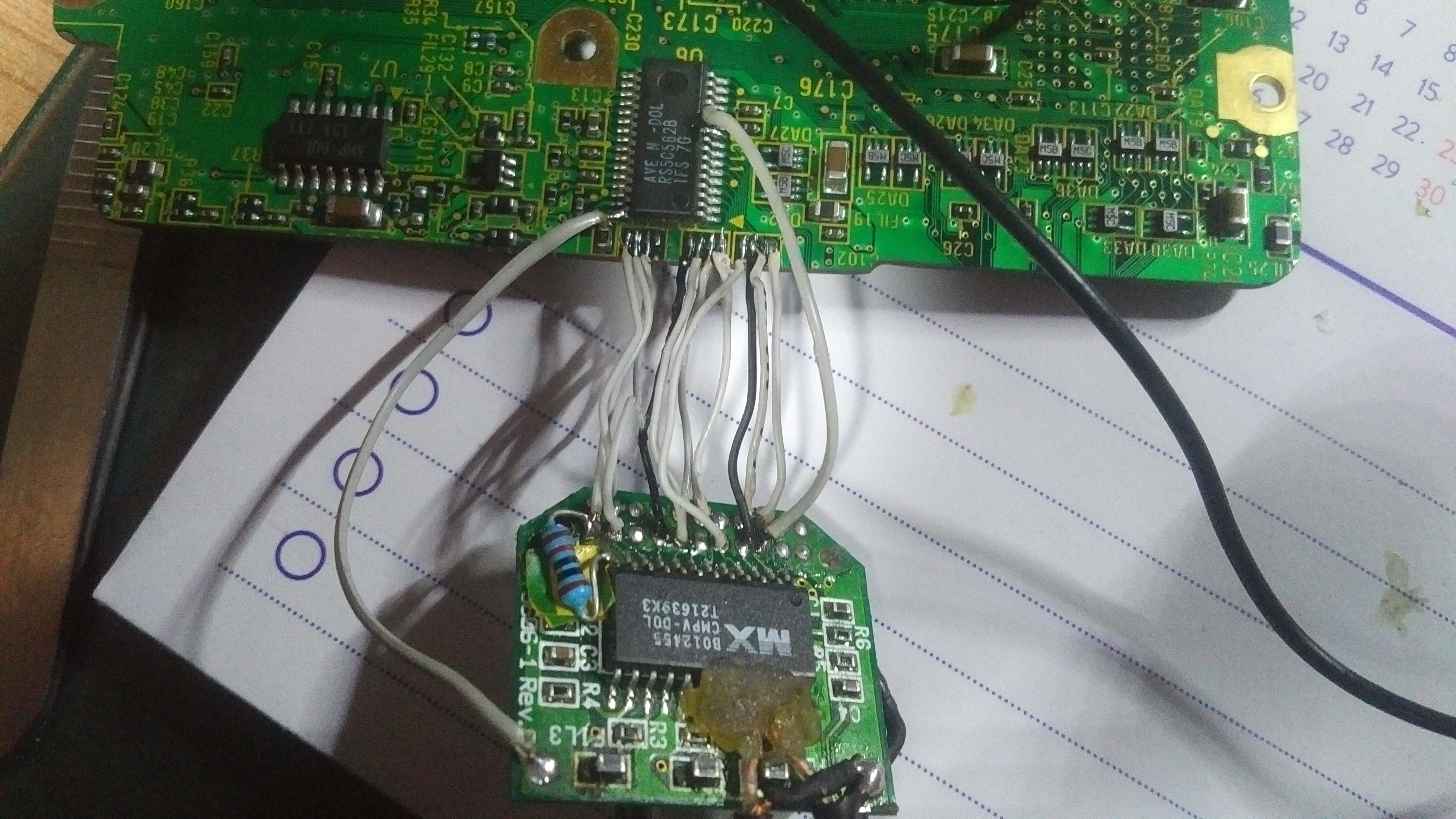

Because I had a spare Gamecube Component Cable video chip and Motherboards laying around, I decided to make a VGA compatible Portable like my second blue one.

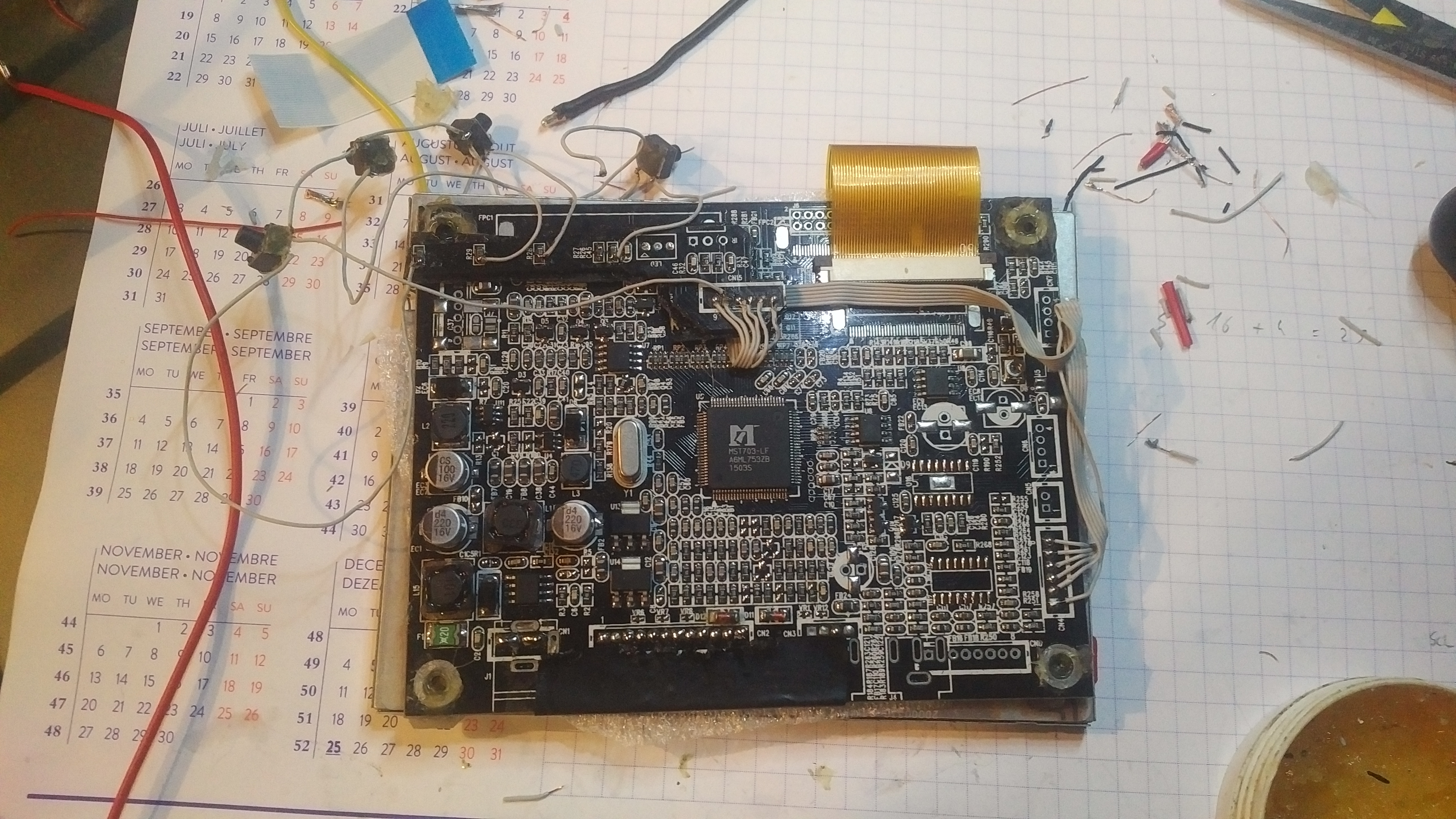

- 5" LCD screen Innolux AT050TN22 with KYV-N2-V1 driverboard (These screens support both 480i and p signals. So no black screen on Bios menu! The driverboard is big but still fits behind the screen. Works on 5v as well without issues)

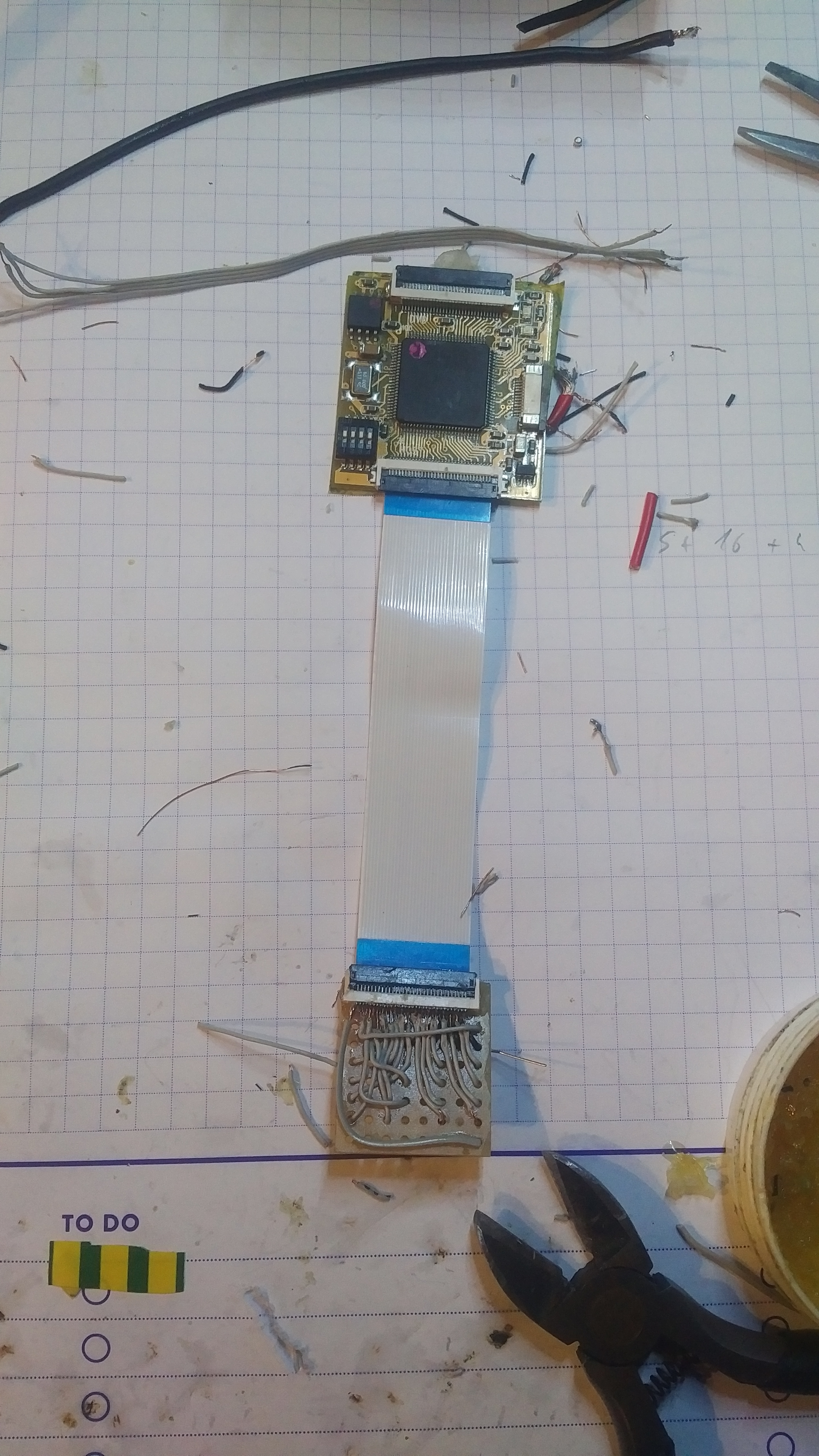

Edit:
02-08-2017
Pictures added.

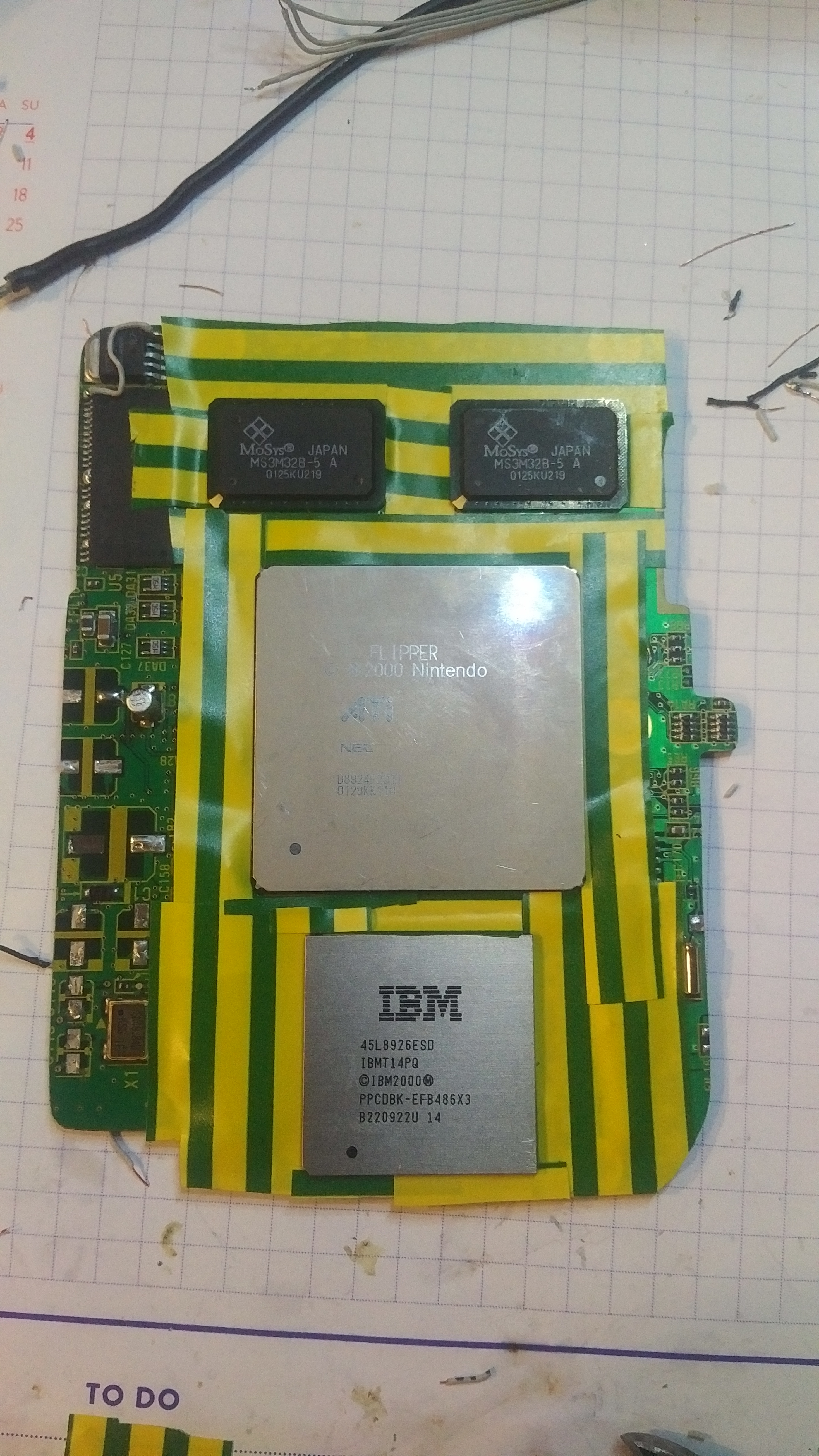

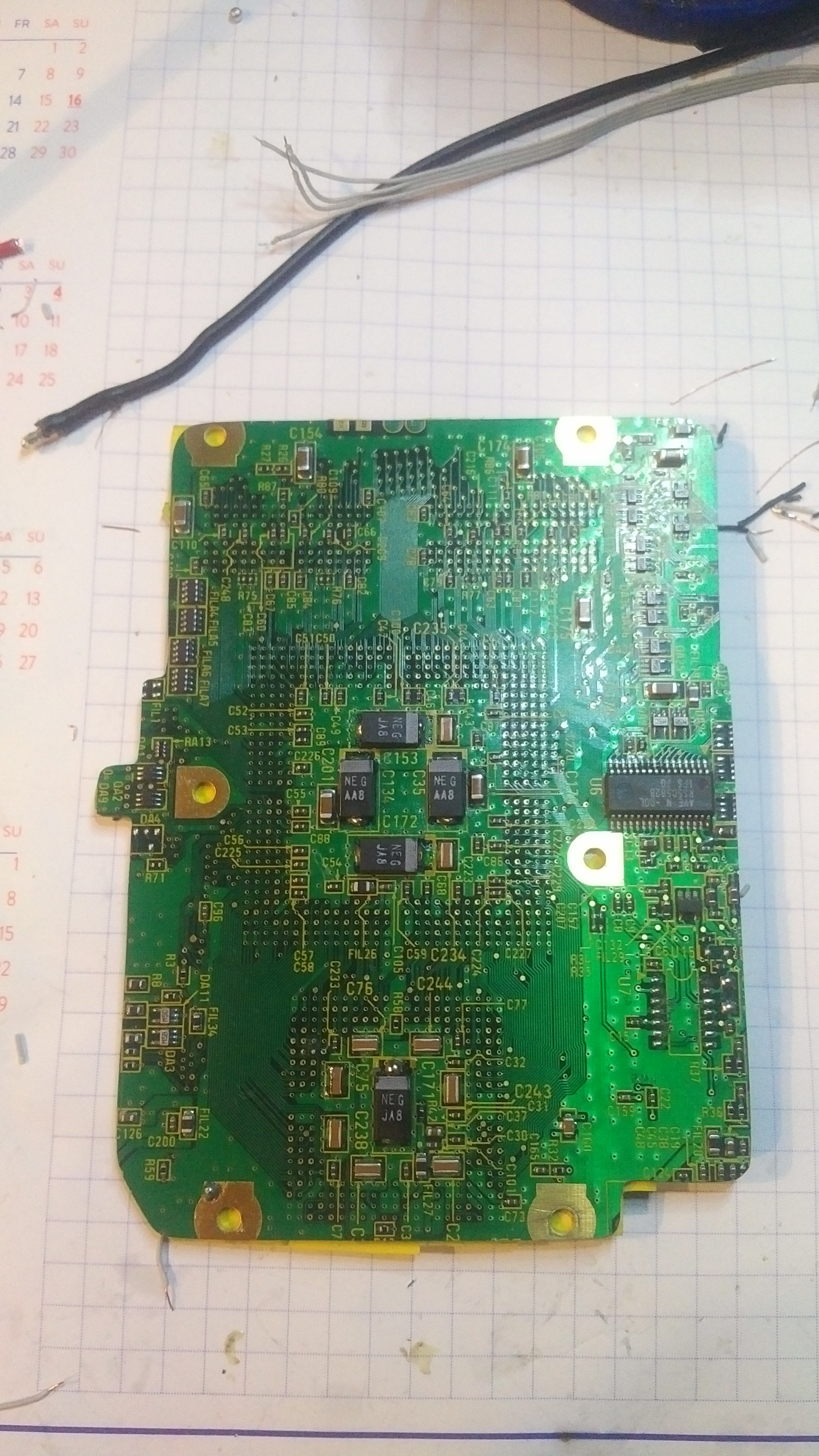

-Trimmed motherboard hybrid cut

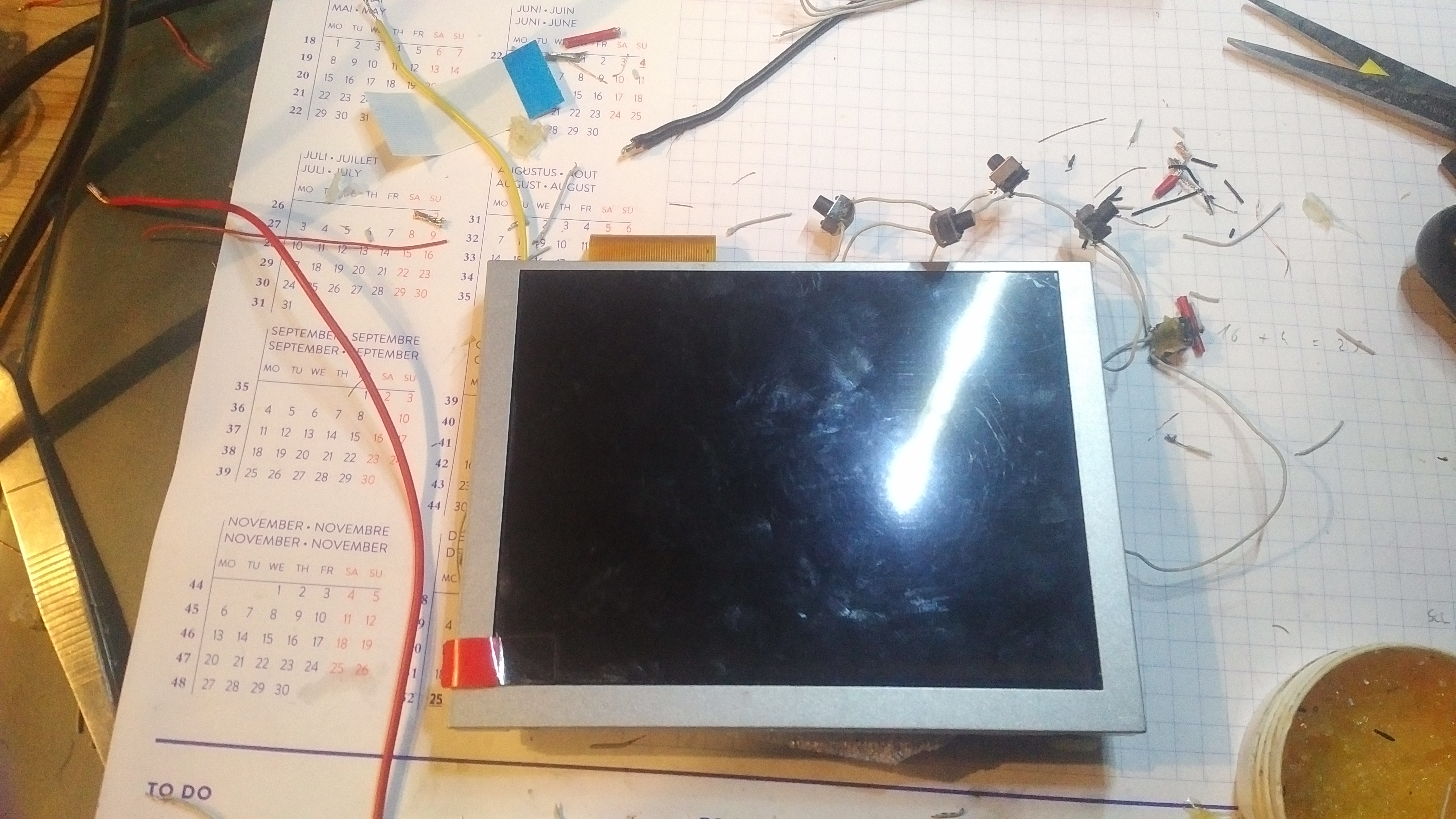

-5" LCD screen
-Homemade Wasp Fusion adapter for testing
-Gamecube Component cable chip wired for testing

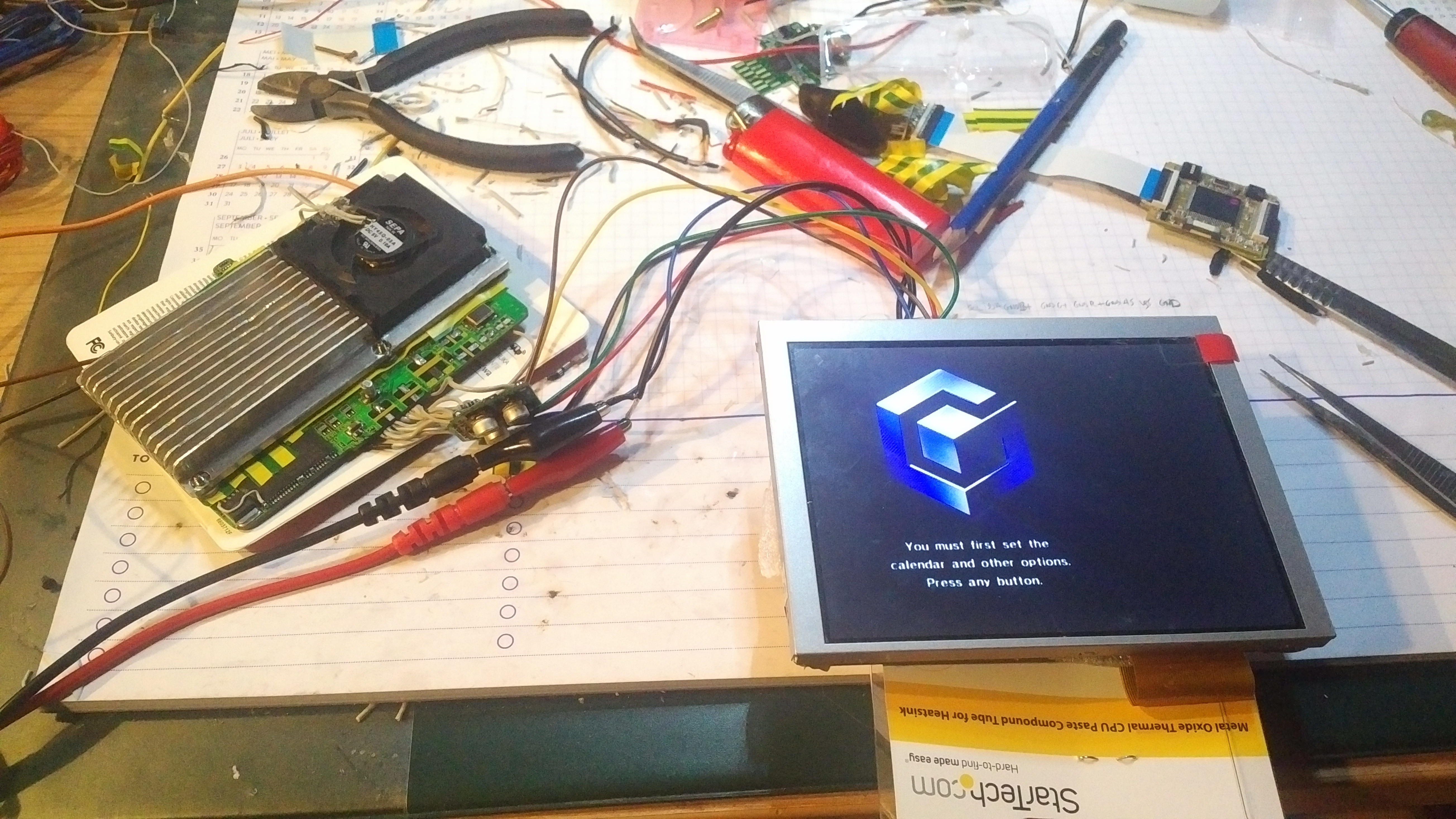

02-08-2017 part 2
-Picture with component cable attached and displaying bios menu.
-Changed Component wires from chip to motherboard. Ide to multistranded wire for better signal.
(Found out I have a dead pixel :( arggg, but we must go on! "Fixed")

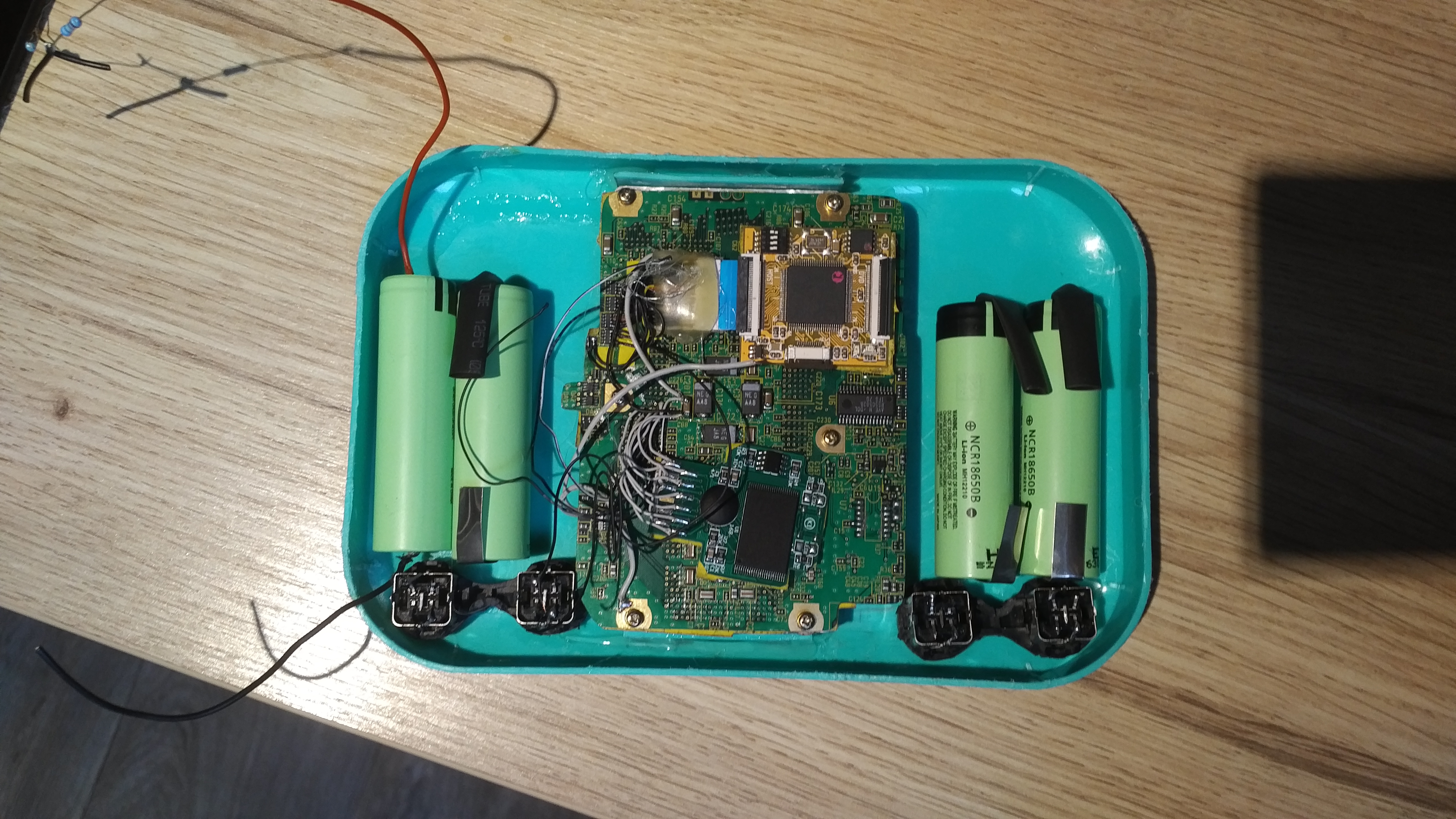

-Wasp Fusion, internal 250mb memorycard and SD-Gecko wired (SD-Gecko only wires)

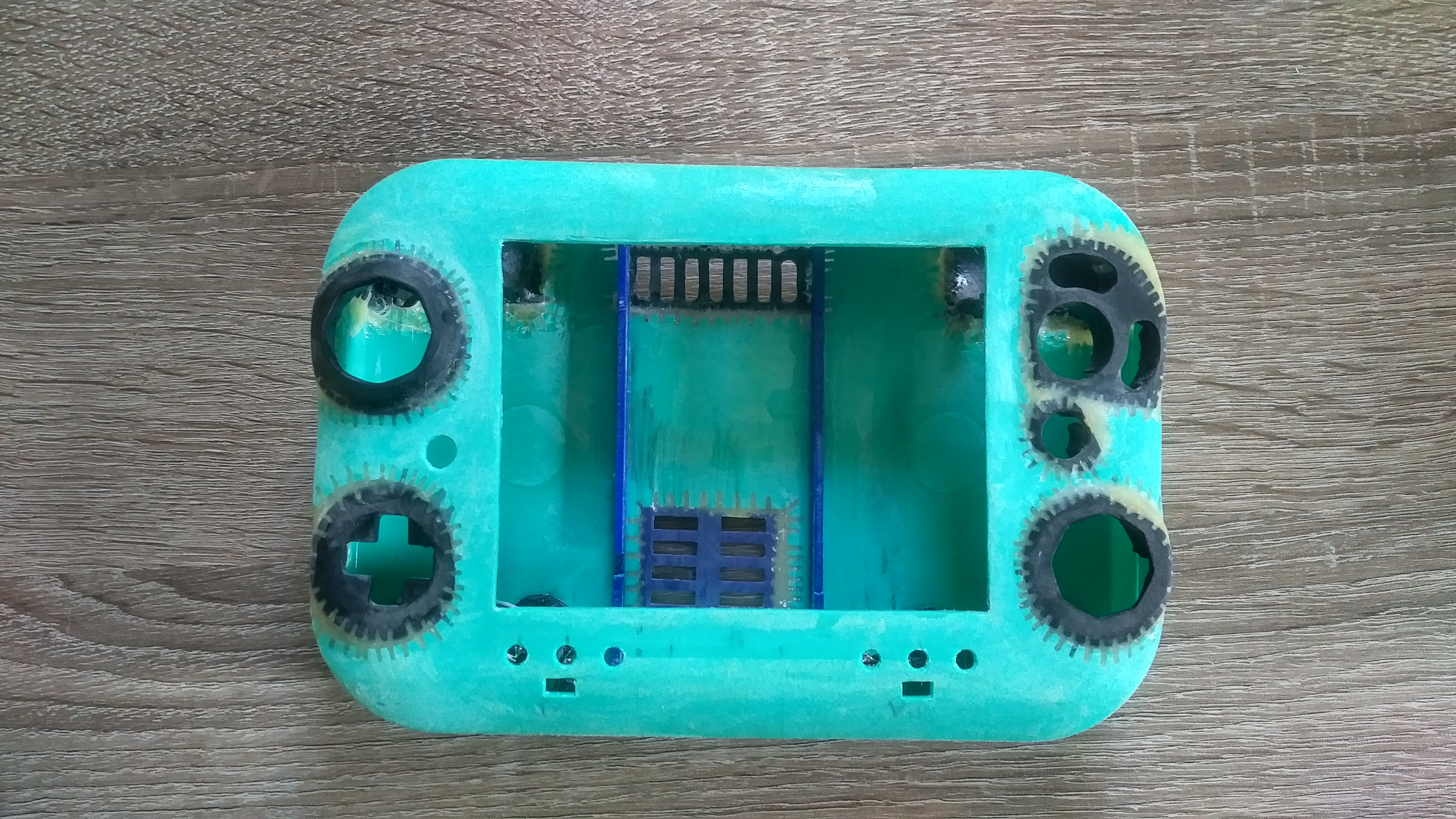

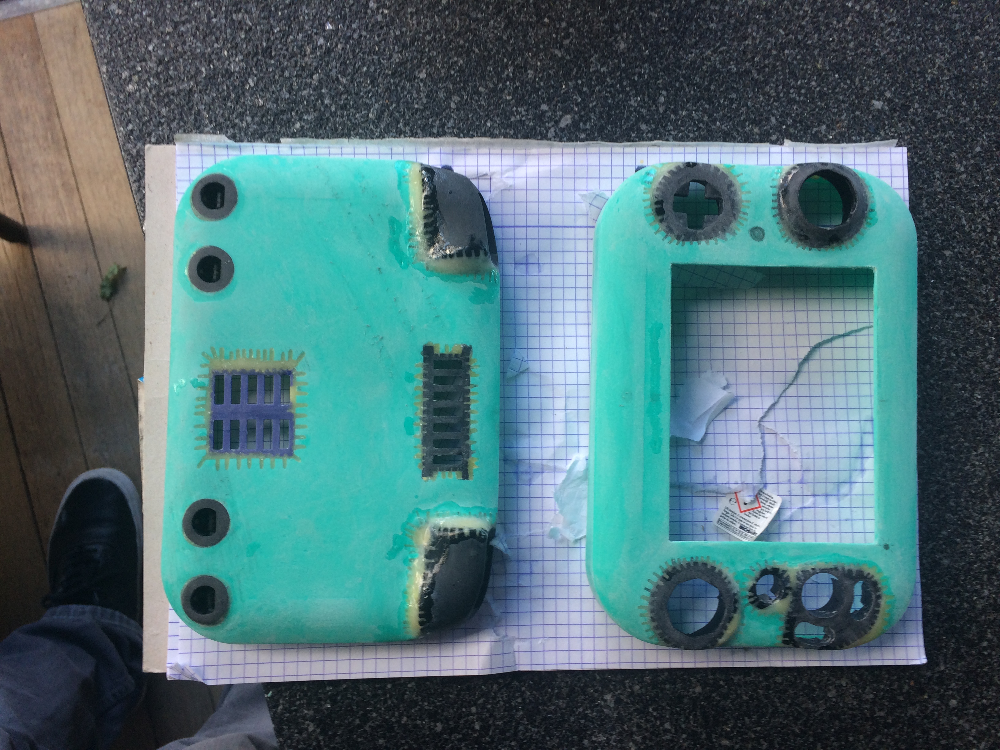

-Bottom half case cut to my desired height and rough placement
02-14-2017

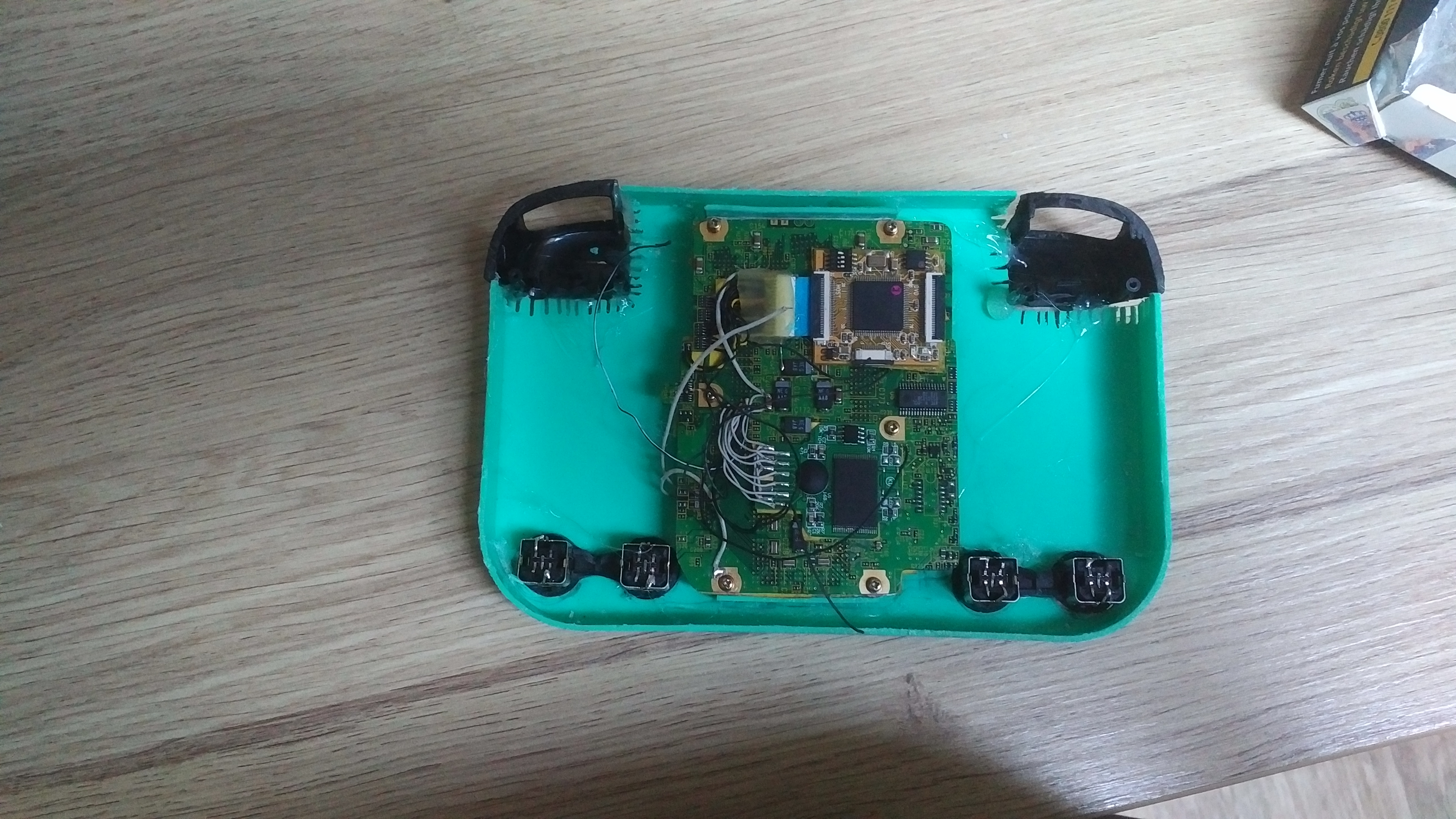

-shoulderbutton holders and multiplayer ports added

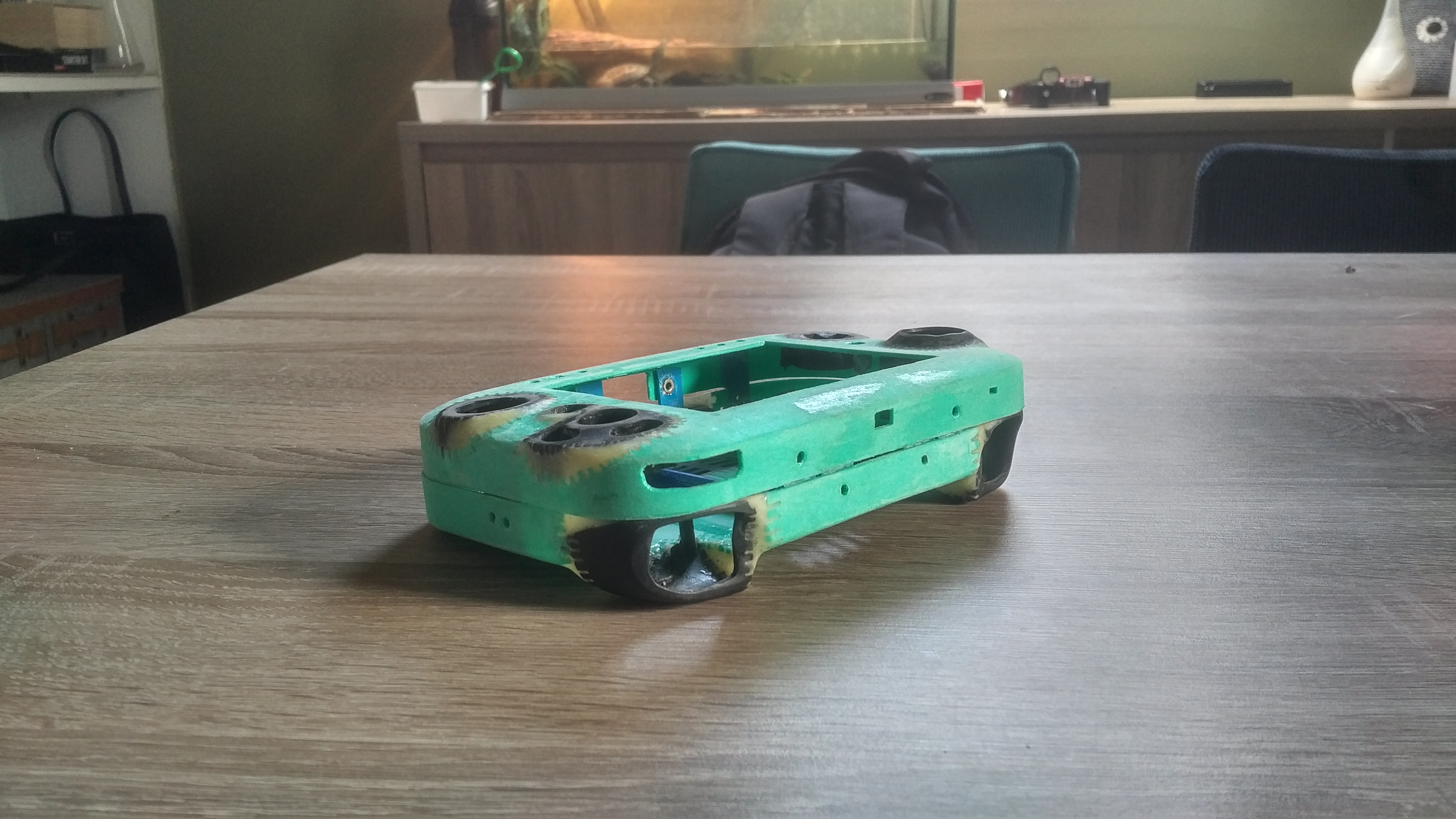

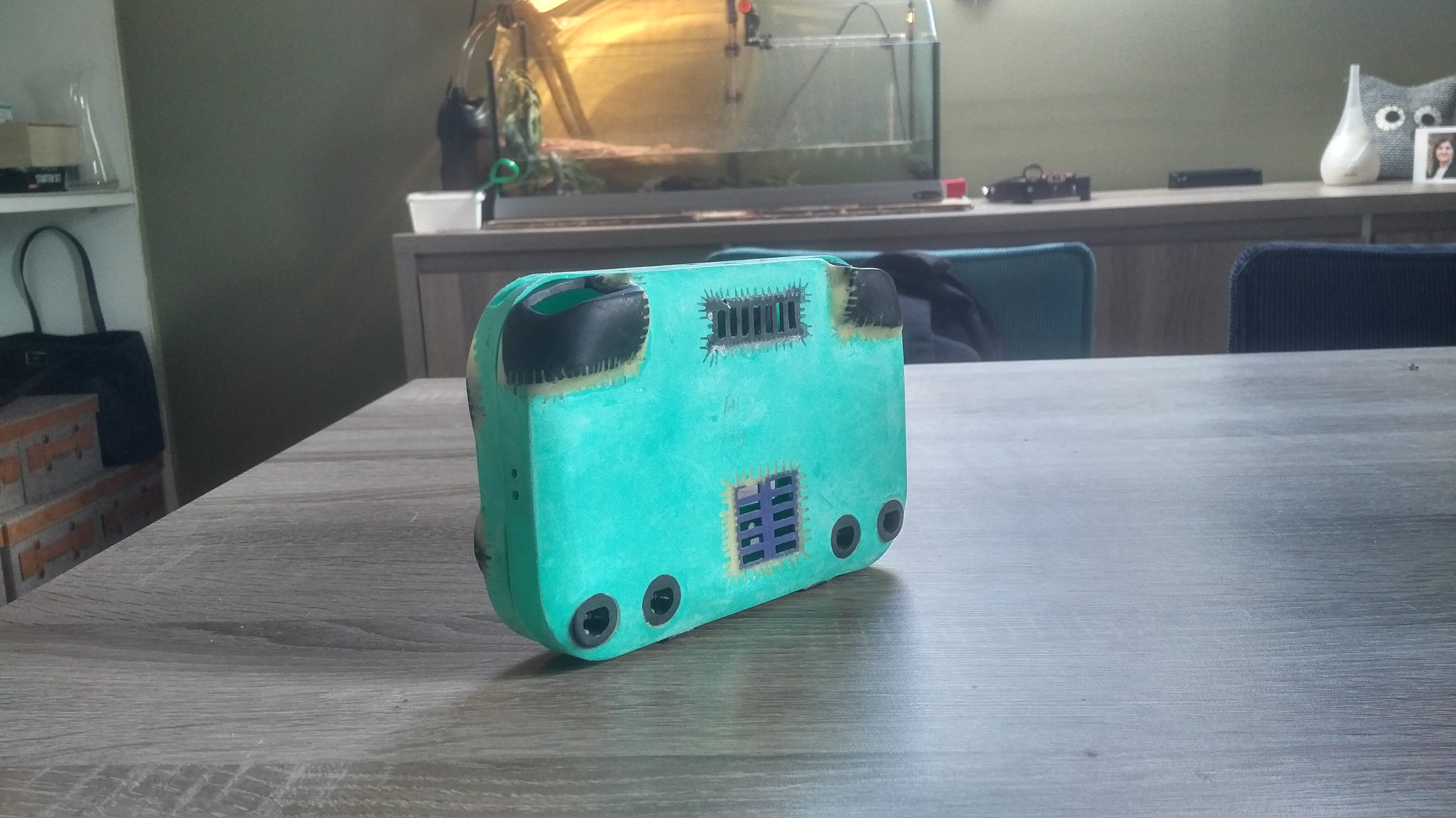

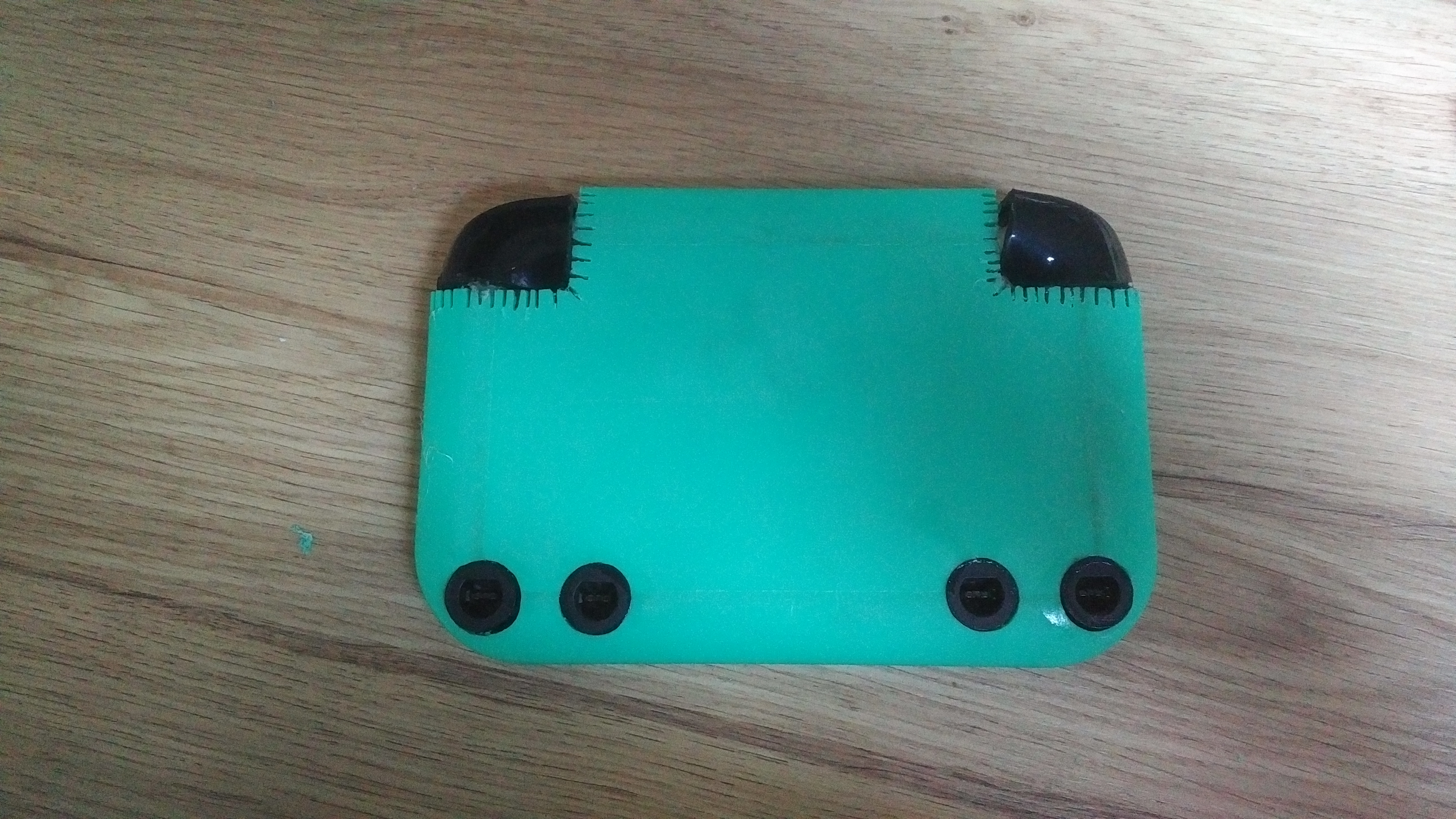

06-09-2017
-case almost done, little bit of standing required.

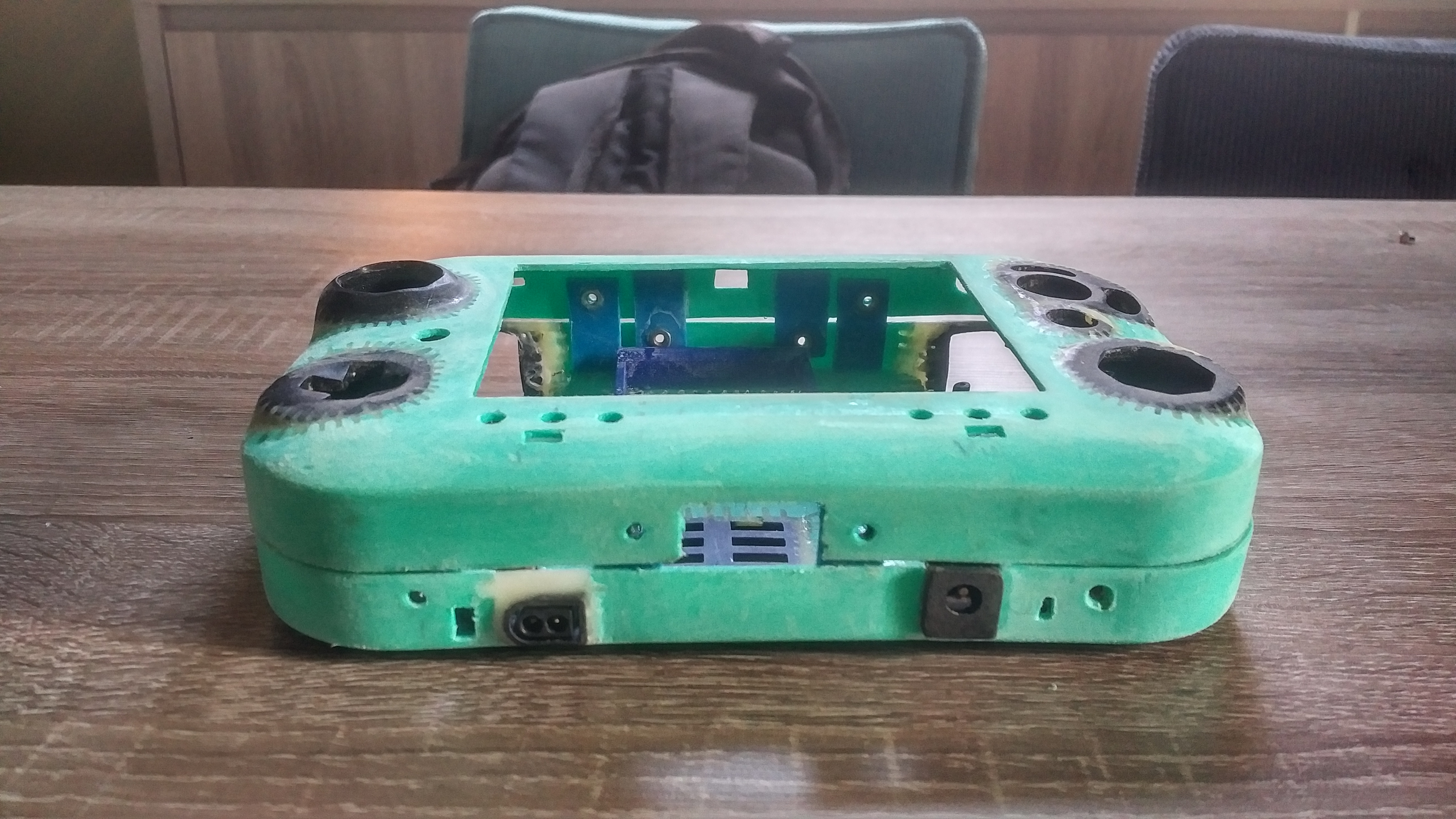

09-12-2017
Some case work done.
Enjoy

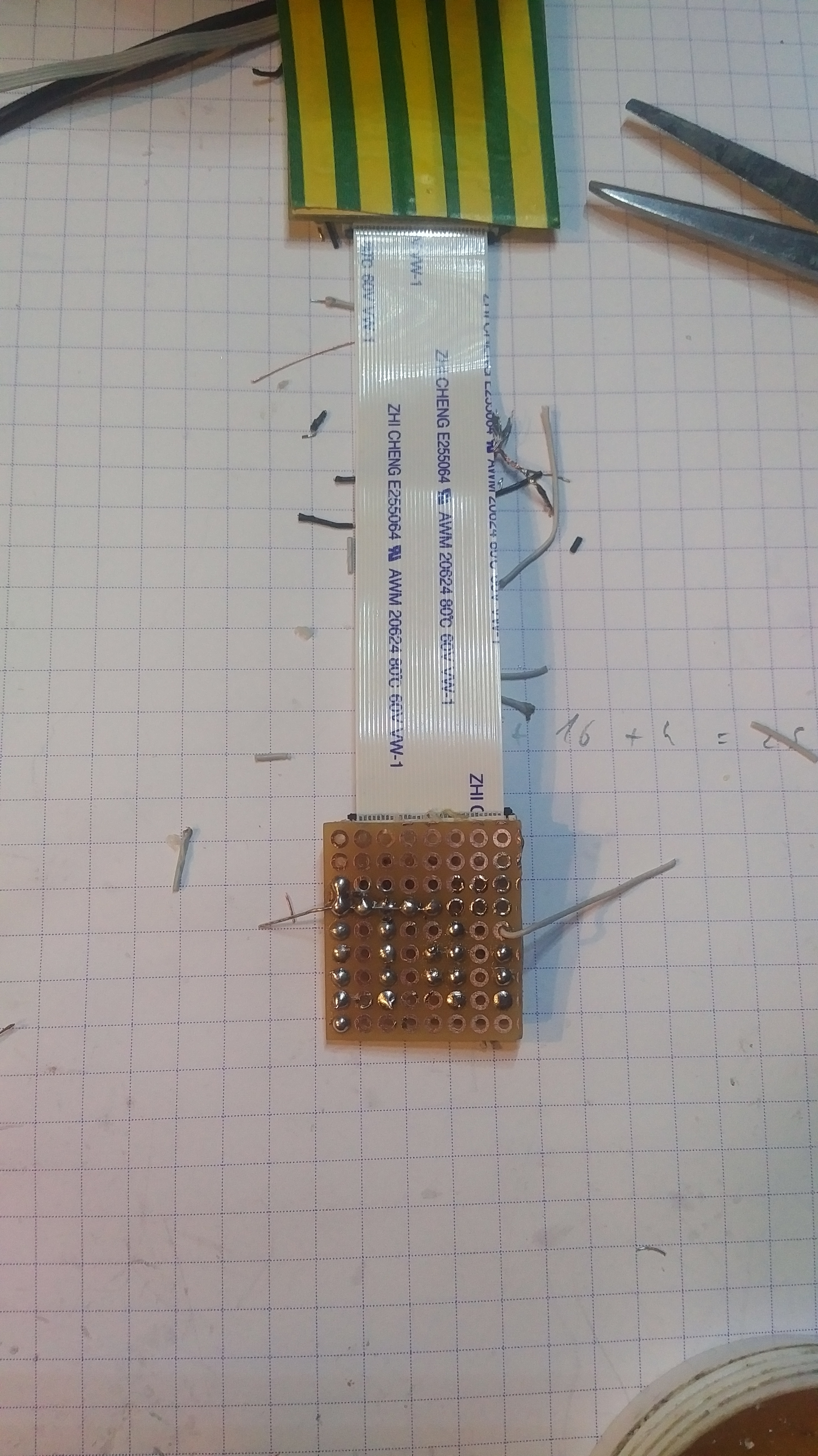

I like that DIY method of wiring to the FFC connector. I would've used that if I'd ever thought of it.
I had some ffc connectors for the DVD side of the modchip which I used for testing and tought I could use it for this setup as well. It's handy because now I don't have to slice up a Ffc cable which is a pain in the ass to be honest.
The pins are grouped vertically from top to bottom. 1 to 7, 9 to 15 and then 21, 17, 22, 24 and 23, 25, 19, 26 and a pair for 27 and 28. All corresponding to the filtercap pairs. Ground and 3.3v have their own pads. I only connected 5 ground pins as the rest is bridged on the Wasp side.

Good screen you chose there, it's my go-to for portables. They're pretty hard to break, so don't worry about accidentally dropping it. Though, I would like to know how you found that the V1 supports 480i over VGA. I've been trying to find out if the V6 supports it, but I can't find any mention of it.
Thanks! They are sturdy, yes. They support 480i because I tested it lol.
V6 is the one with the smal driverboard correct? The screen connector is in the middle.
Yeah the V6 is a lot smaller. About 2/3 the size of the screen with the central FFC connector. I guess I'll have to wait until the GCVideo has the option of Wii firmware to check if it also supports 480i.
