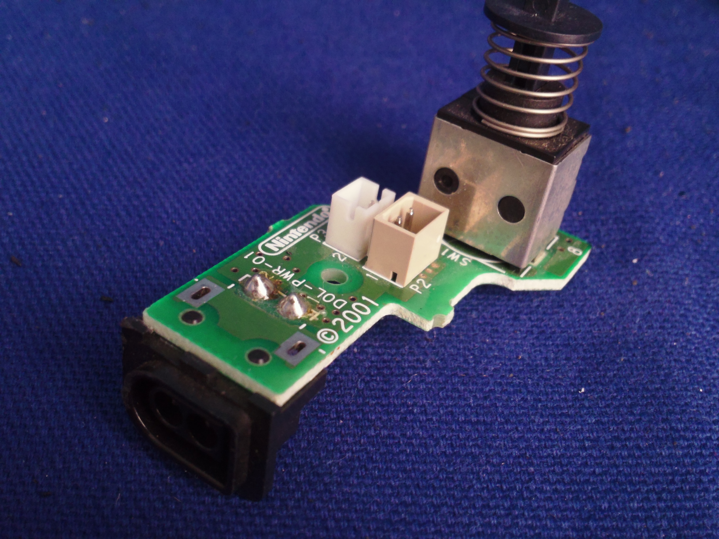

Okay so I'm making my first portable console, (a gamecube obviously) and I am not sure what I should do with the power board!
So here are my questions:
1. How do I connect the battery to the power input?
2. Will the battery power button turn on power or will the power board button turn on power?
3. There is another tiny board that connects via a white two pin connector to the power board and It has two black prongs that you can push. Do I need that board and what does it do?

But honestly with Custom regulators and switches you don't need this power board, unless you are planning on using wall power.
You will need the switch to cut power from the regulators to the board.

I would make a custom regulator board, but i'm too new to stuff like that :/ so do I really need the switch, or can I just scrap it all together?
You don't need to "make a custom board", you just need to get the regs and wire them properly. Explanation.
Obviously you're going to want some sort of power switch on your portable, and no it doesn't HAVE to the same switch that's on the gamecube already.
Please do as much of your own research as you can before you dive in. There is so much documentation for all of this.
No, you don't need that. The only thing that does is take power from the plug, run it through an on / off switch, and then on to the gc. You can take the 12v from your battery circuit to the gc motherboard directly and put your own switch in between to turn it on and off.
