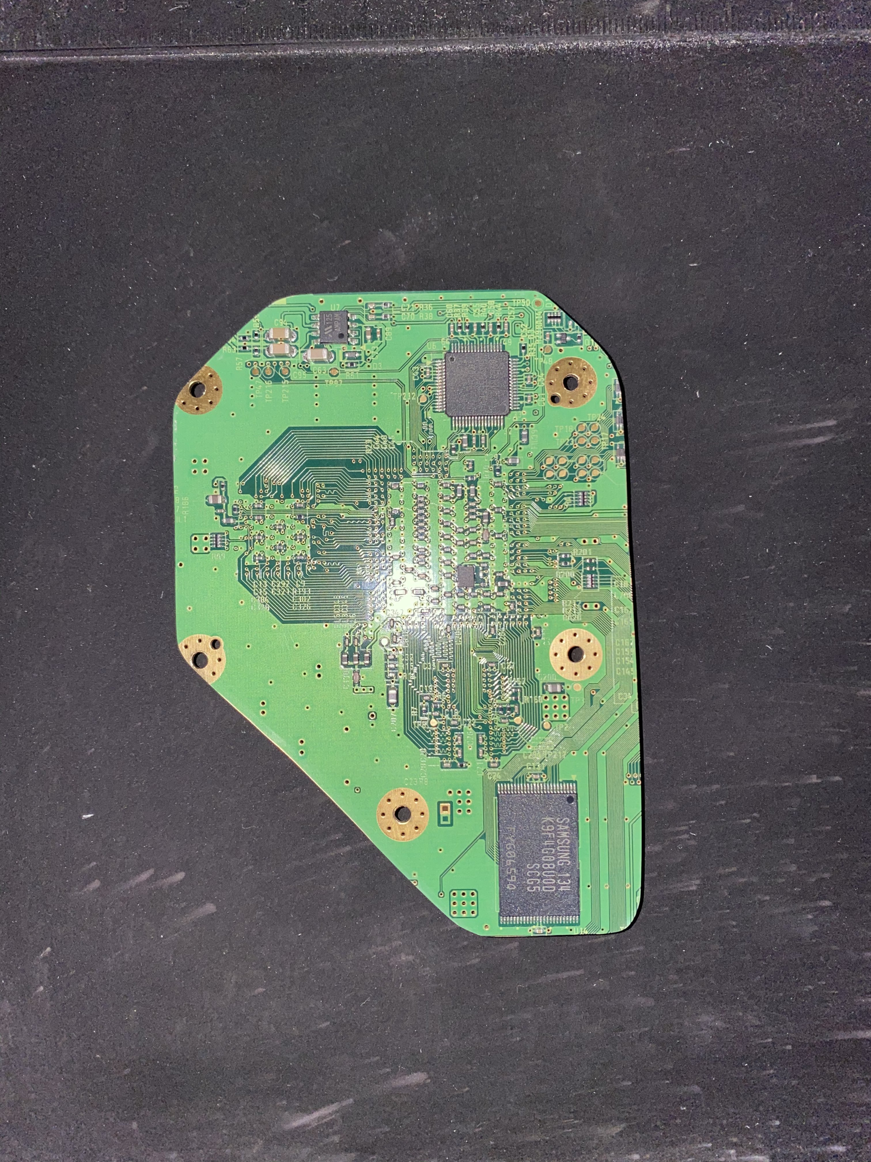

indierocker774 . Joined May 19, 2020 Messages 24 Likes 6 Location Naples, FL Aug 8, 2020 #1 I thought I had this thing wrapped up trim wise, but now I’m seeing some posts on here that lead me to believe I might’ve gone too far as well. Can anyone confirm whether I’ve over-trimmed? Image attached. Thanks! Attachments A4D64096-2B4F-45D3-95E5-0C2E972A0FEF.jpeg 2.7 MB · Views: 352
Wesk Needs recharging Staff member . . Joined Jul 12, 2017 Messages 1,003 Likes 2,643 Location Queensland, Australia Aug 8, 2020 #2 We'll need a picture of the back but it looks very close to where the NAND traces would be.
Stitches 2 and a Half Dollarydoos Staff member . . . Joined Feb 5, 2017 Messages 4,605 Likes 3,551 Location Banana Bender Land, Australia Portables 6 Aug 8, 2020 #3 Oof that'll be really hecking close, within 2mm of the NAND traces

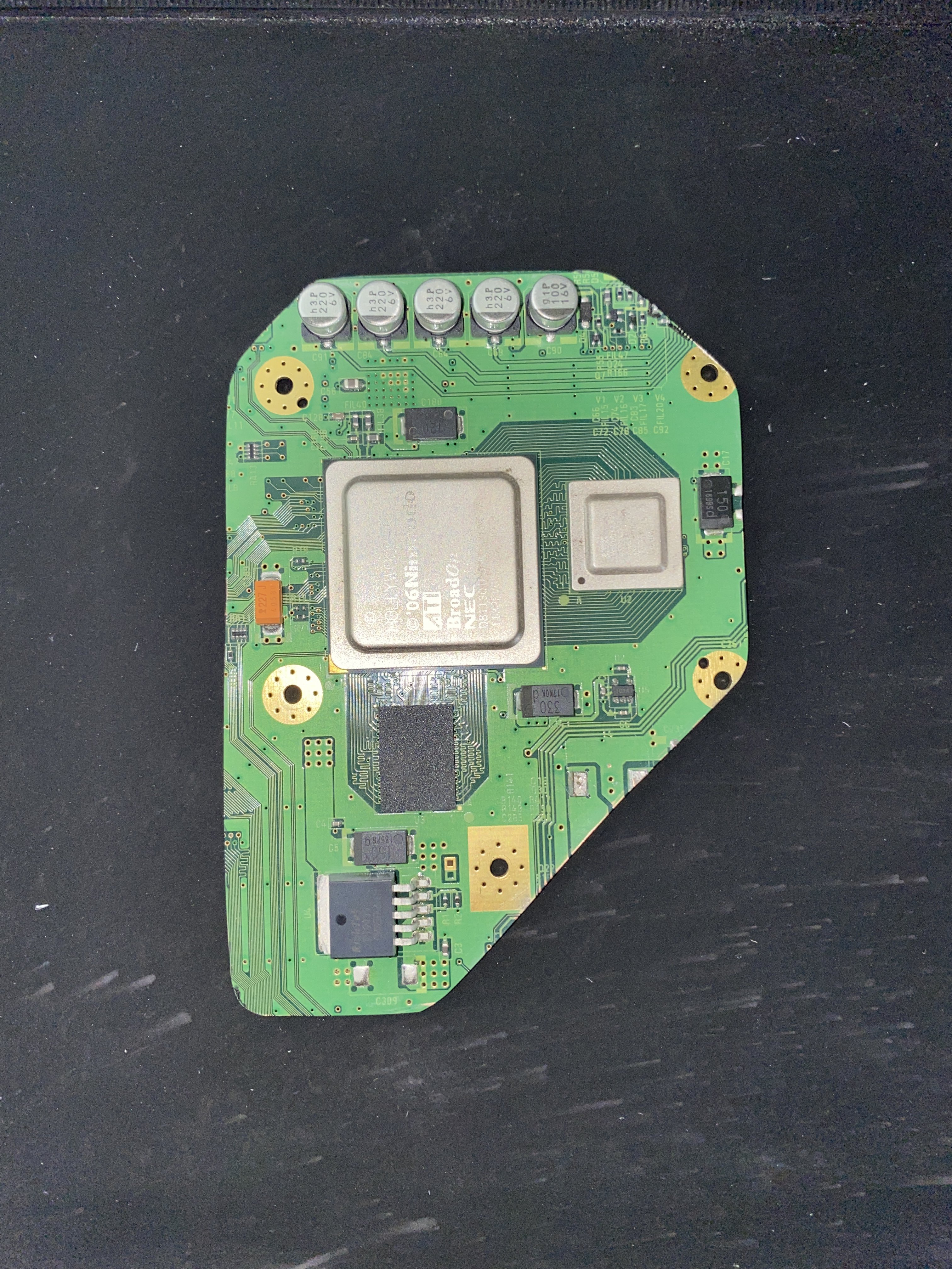

indierocker774 . Joined May 19, 2020 Messages 24 Likes 6 Location Naples, FL Aug 8, 2020 #4 Ugh, I think I see where I screwed up now. Attachments F5371170-C561-44E3-B3E5-8A736734FC49.jpeg 2.8 MB · Views: 346
Wesk Needs recharging Staff member . . Joined Jul 12, 2017 Messages 1,003 Likes 2,643 Location Queensland, Australia Aug 8, 2020 #5 NAND lines look to be intact, you're safe

Stitches 2 and a Half Dollarydoos Staff member . . . Joined Feb 5, 2017 Messages 4,605 Likes 3,551 Location Banana Bender Land, Australia Portables 6 Aug 8, 2020 #7 indierocker774 said: Ugh, I think I see where I screwed up now. Click to expand... Nah dude you're fine, you just missed them. That trim should work fine.
