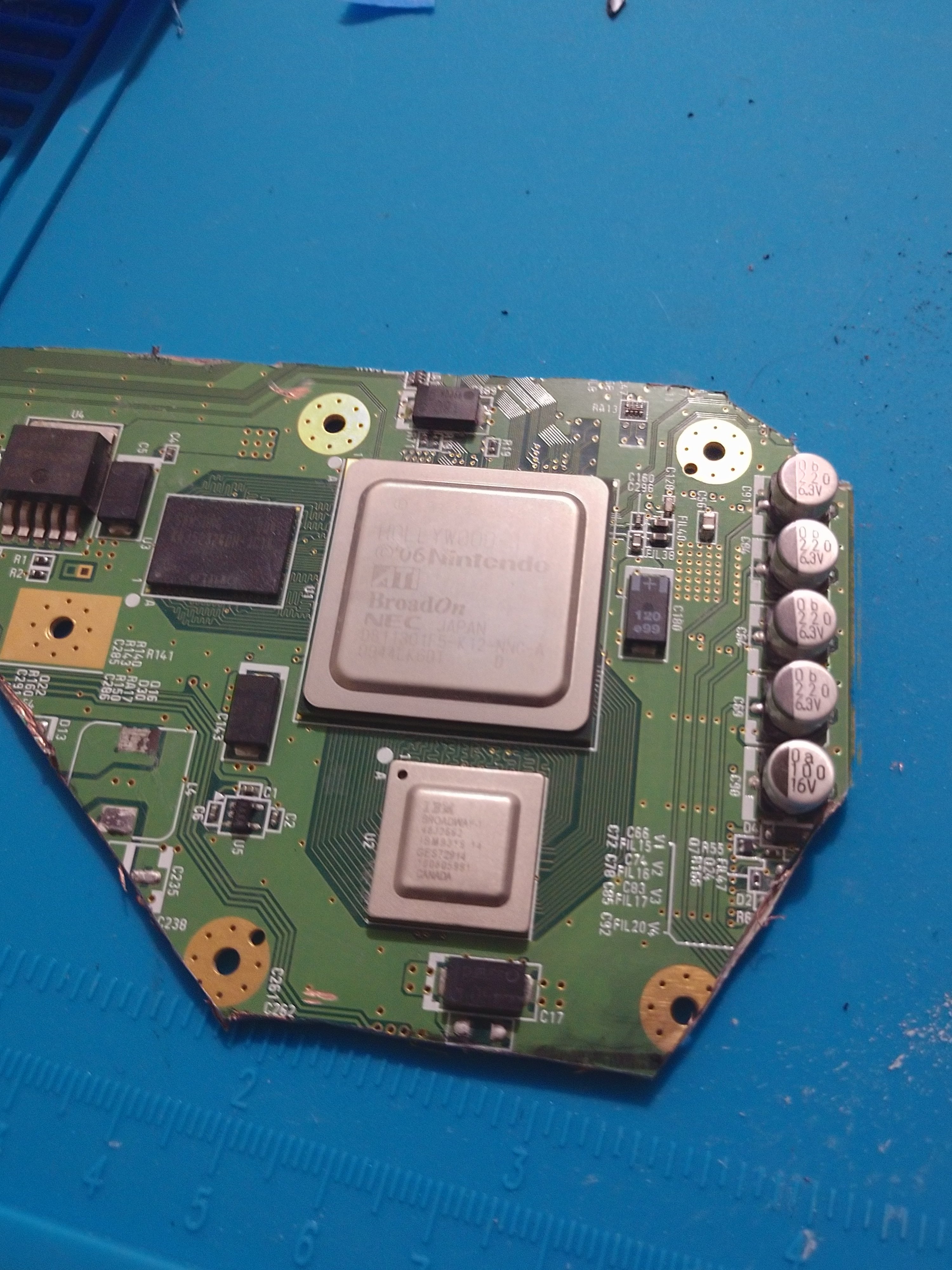

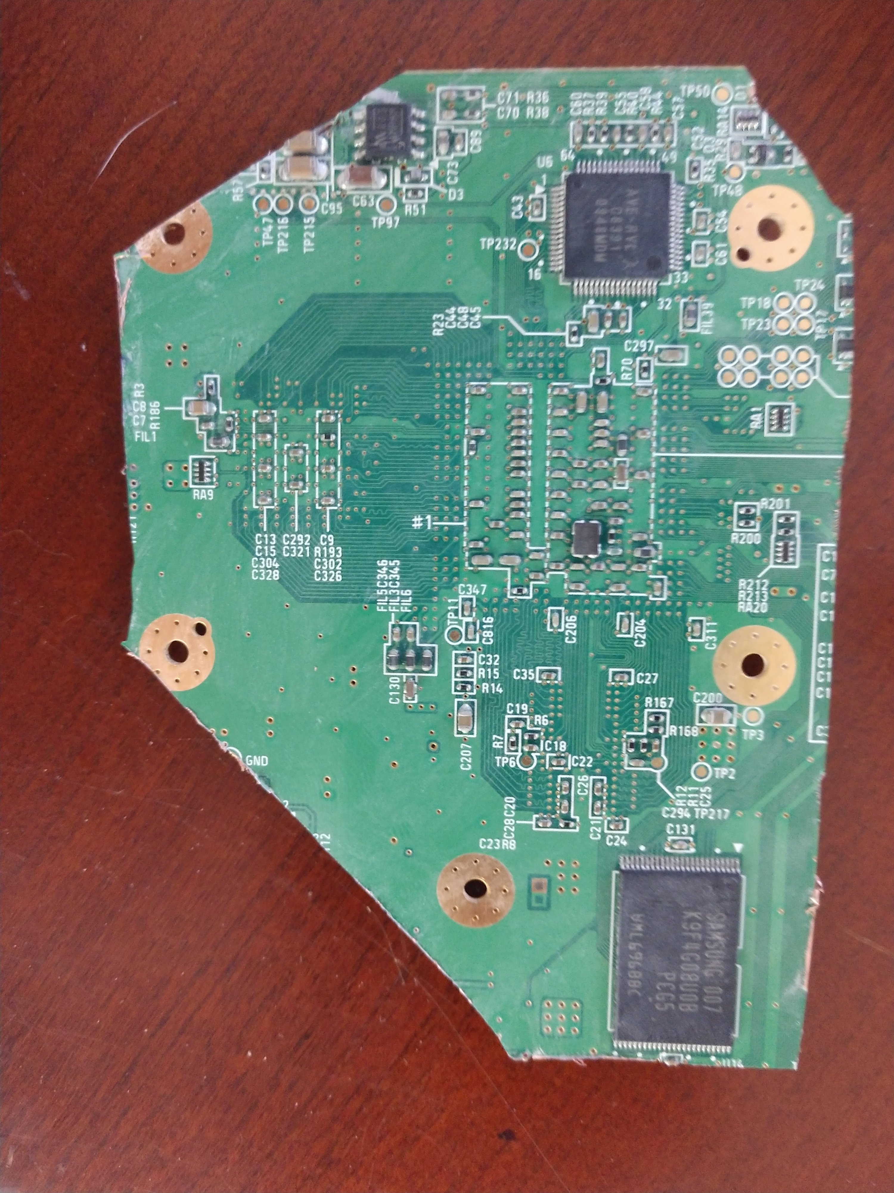

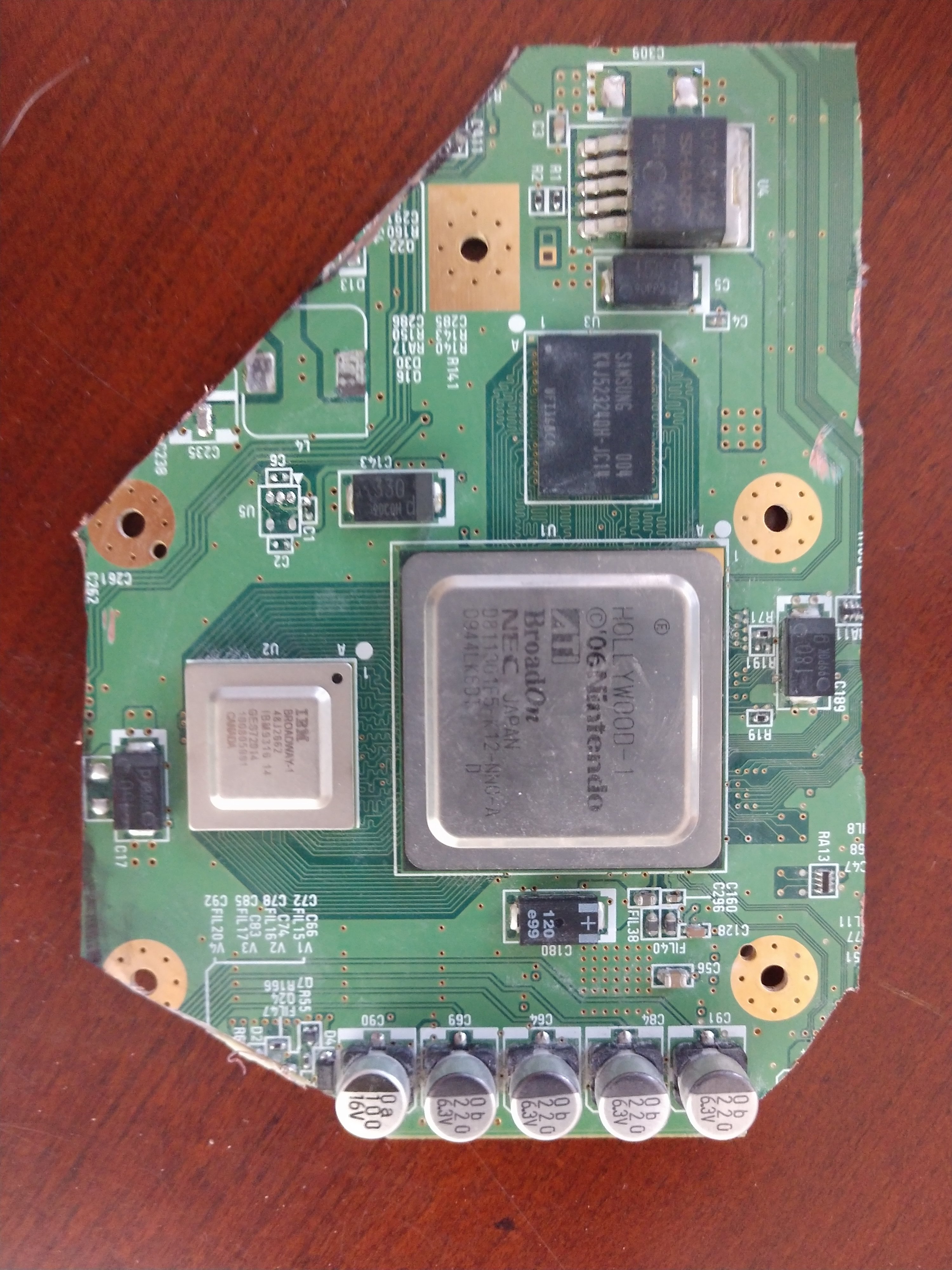

So I definitely think I over trimmed in the bottom right section of the board.
I still have to sand down the edges, but if it's a list cause then I'd rather know now before sanding.
Also my gboy kit is arriving this week so I'd need to order another wii ASAP.
I made a mistake reading the guide and thought the little black components were part of the sharpie line....

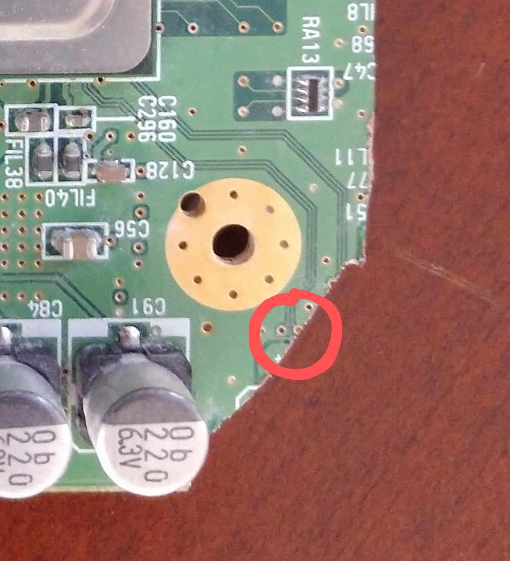

Edit: Sorry, I circled the wrong vias. The vias for the main USB lines are still accessible!
Hopefully sanding doesn't break the right-hand via's continuity.
Looks like you trimmed through a bunch of critical traces on the NAND. Trim a little outside of the sharpie line next time and then sand it closest.
Haha I was going to continue to work on this one while a replacement wii comes in the mail. Have to work on the u10 replacement anyways.
