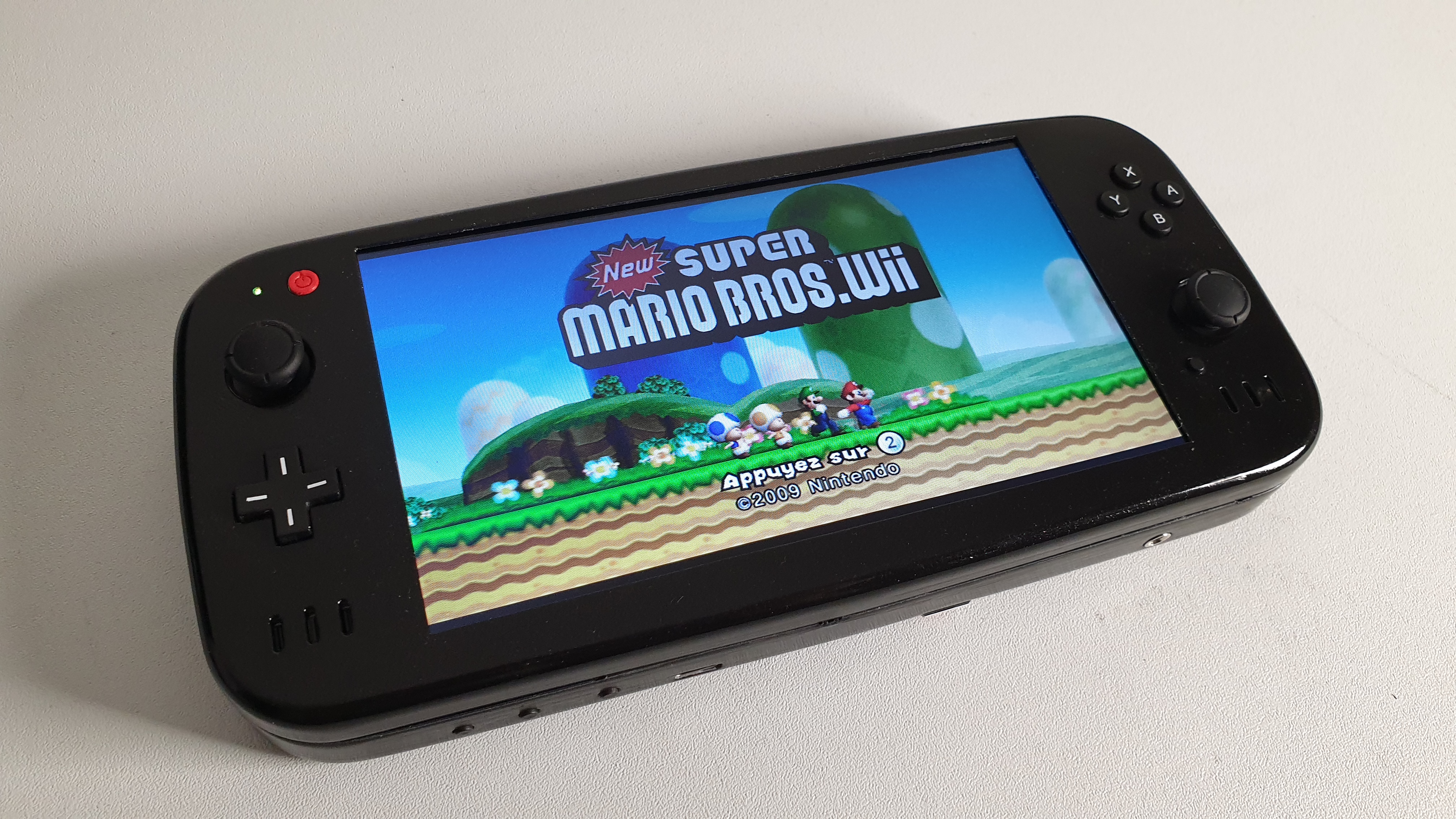

I'ts been a long that I have to post the cutting hedge of the O-Wii V1,
it is my first experiment in portabilizing
It was not perfect of course, but it works fine !
I am in the process of making so many modifications that I am going to V2.
So here is the Cutting Edge of the O-Wii V1
Specs :
- 7" screen in VGA (800x480 16:9)
- OMGWTF Trim
- MX chip relocation
- Bluetooth relocation
Power :
- RVL PMS
- USB-C charge input with PD activator module ZY12PDN
- 12 000 mAh battery (4 x NCR18650B li-ion 3 000 mah)
allow 4h30 of play time
Sound :
- U-Amp
- 3.5 mm audio jack
- reuse rectangle Macbook speaker
Controller :
- GC+ 2.0
- NDS lite button with squisshy tacts
- joy-con joystick
- dual tact L/R switch
- litle round vibrator
Other :
- BBloader V1.3
- µSD to USB adapter
- RGB led for battery indicator (with the Wii PMS)
- Thermal protection (Wii PMS)
Dimension :
- Height : 108,5 mm
- Width : 203 mm
- Thikness : 28,7 mm
- Weight : 606 g
