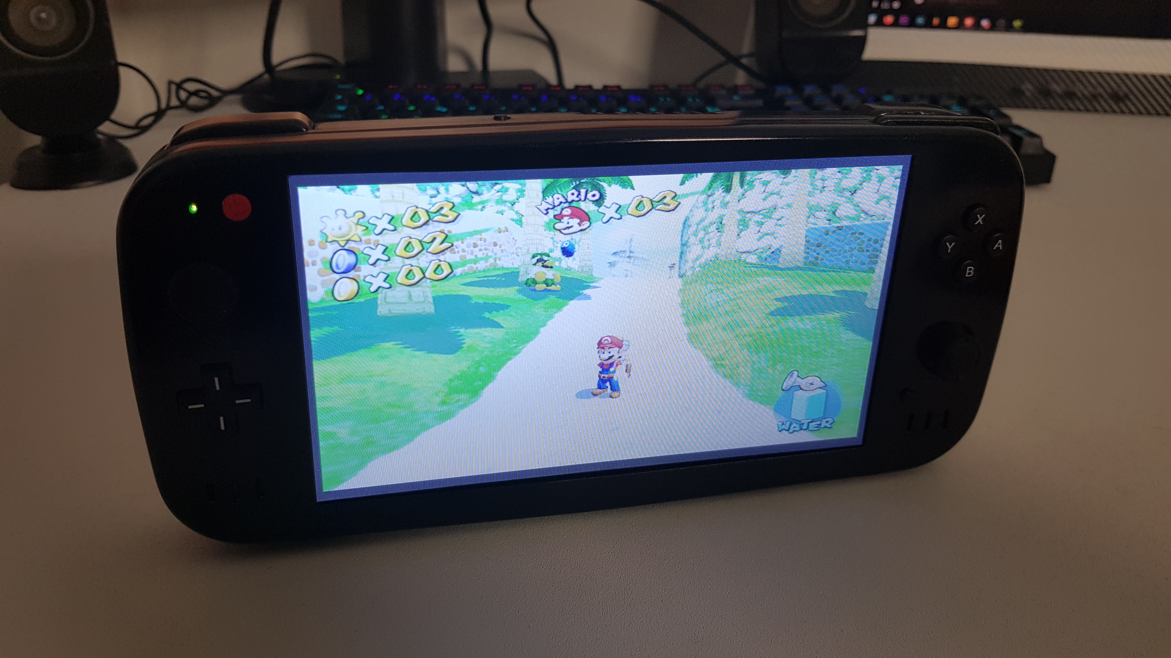

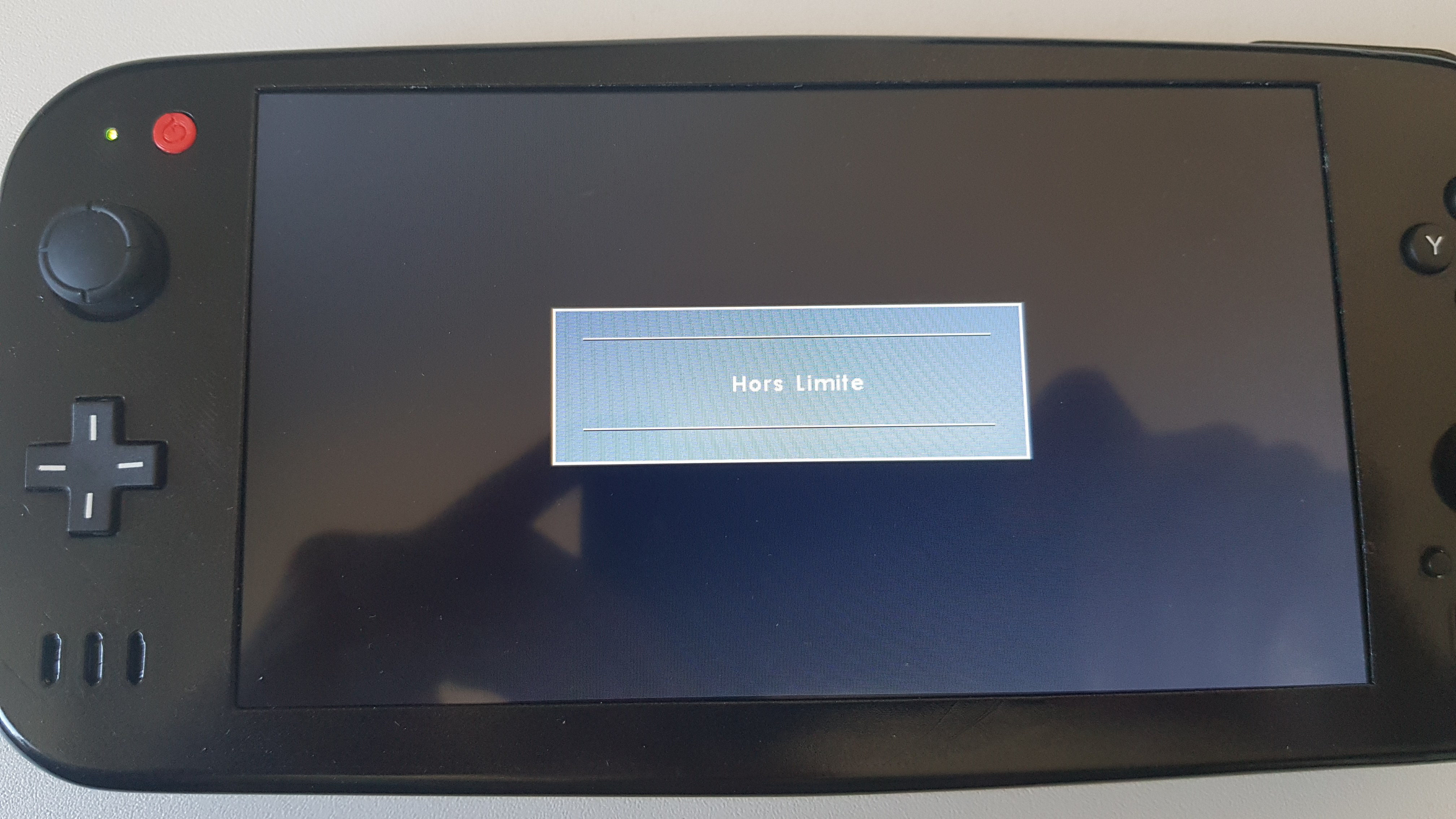

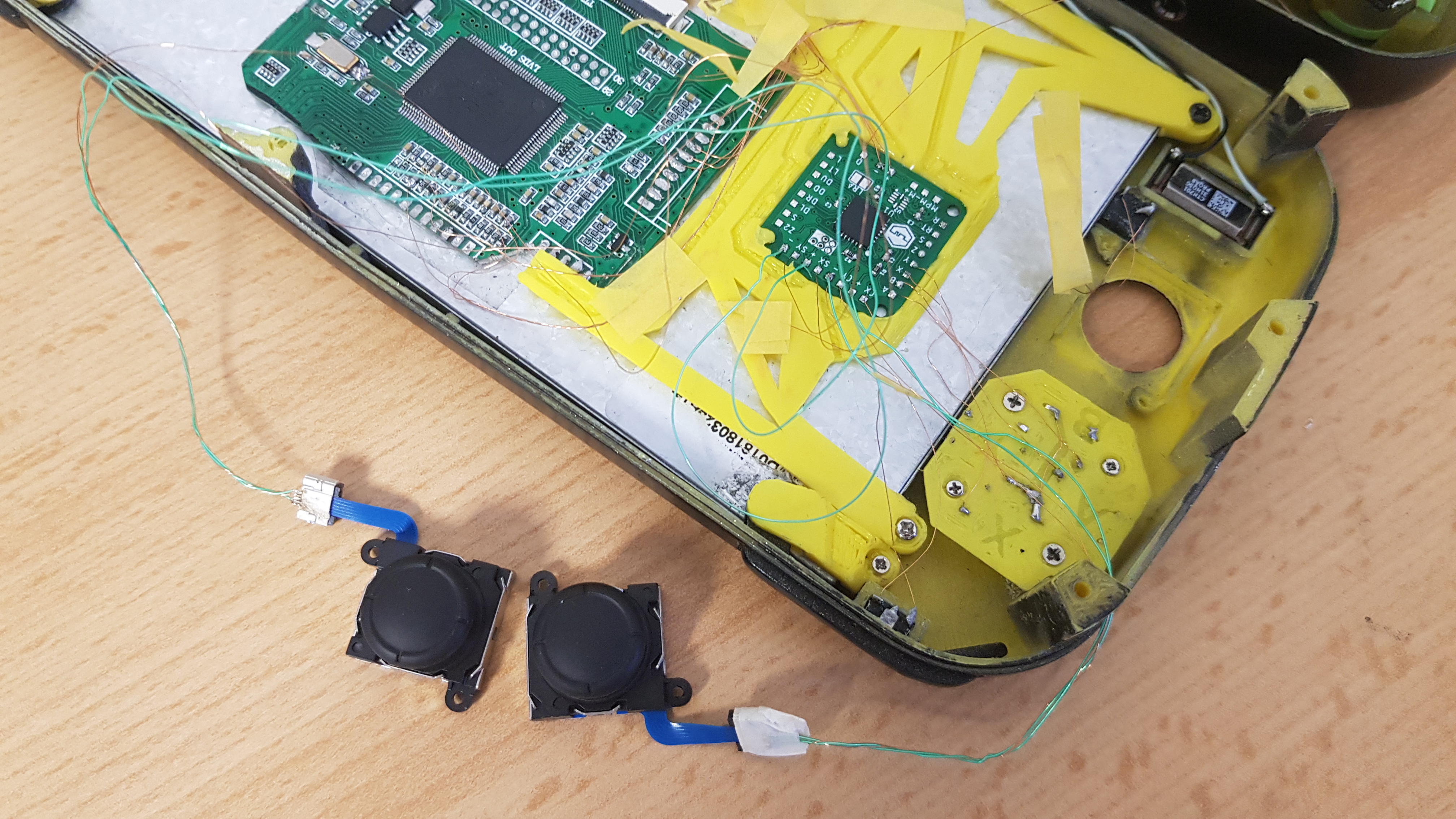

I have a small problem for gameboy games the video output seems not to be adapted to my screen it puts me out of bounds (Hors limite in french) :
Maybe your screen can't support 240p in VGA? Looks great and super clean! How is the sound quality from the uamp and MacBook speakers?
Ah I didn't know it was 240p, maybe my screen doesn't support it but I still find it weird it supports 480p well.
Macbook speaker sound with U-amp is super clean, I think it's much better than nintendo ds speakers or other small speakers !
EDIT : It work when I set to YES "Force Progressive"

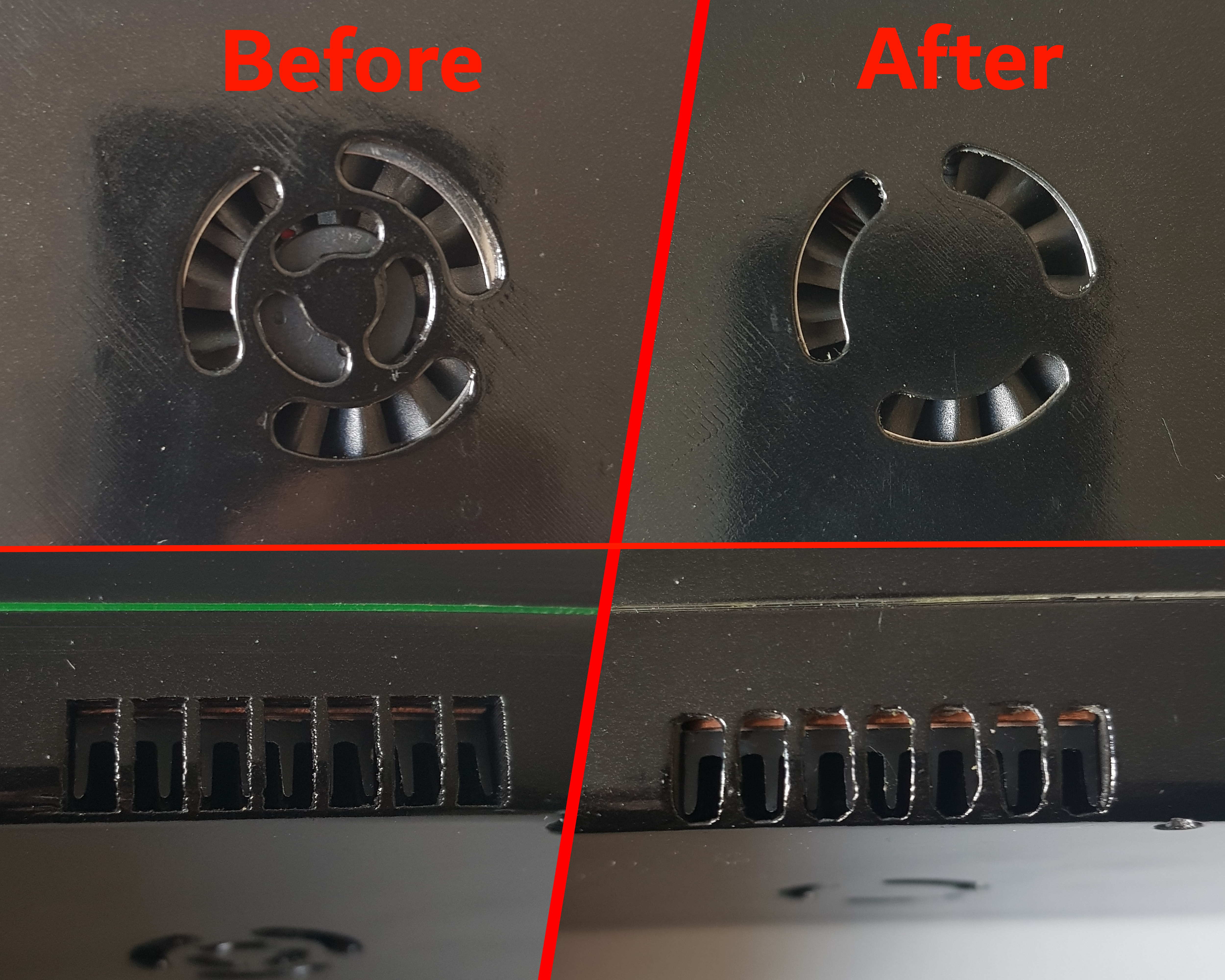

- Some little improvement for case :
hole size adjusment, modification of the hole for cooling, rounding of the air outlet.

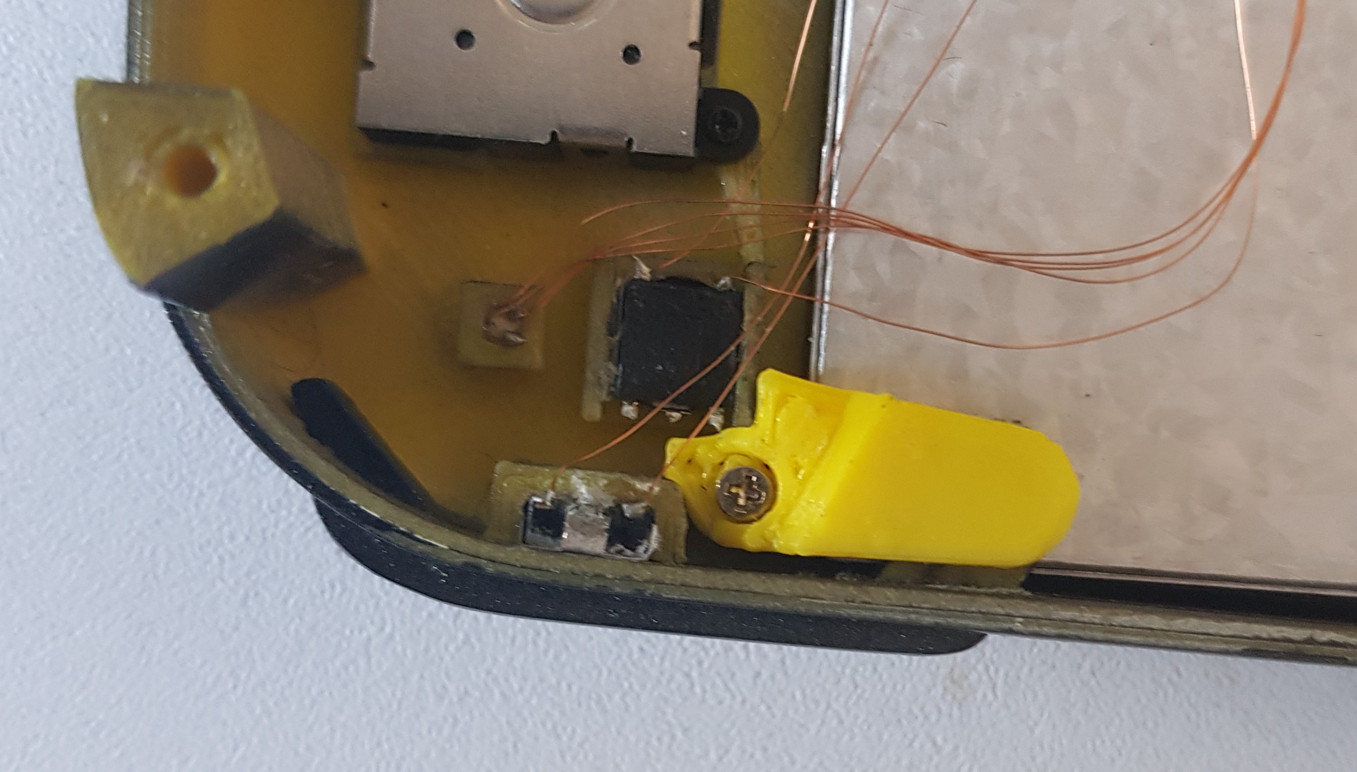

- I added a Z2 button (for use as a shake button) :

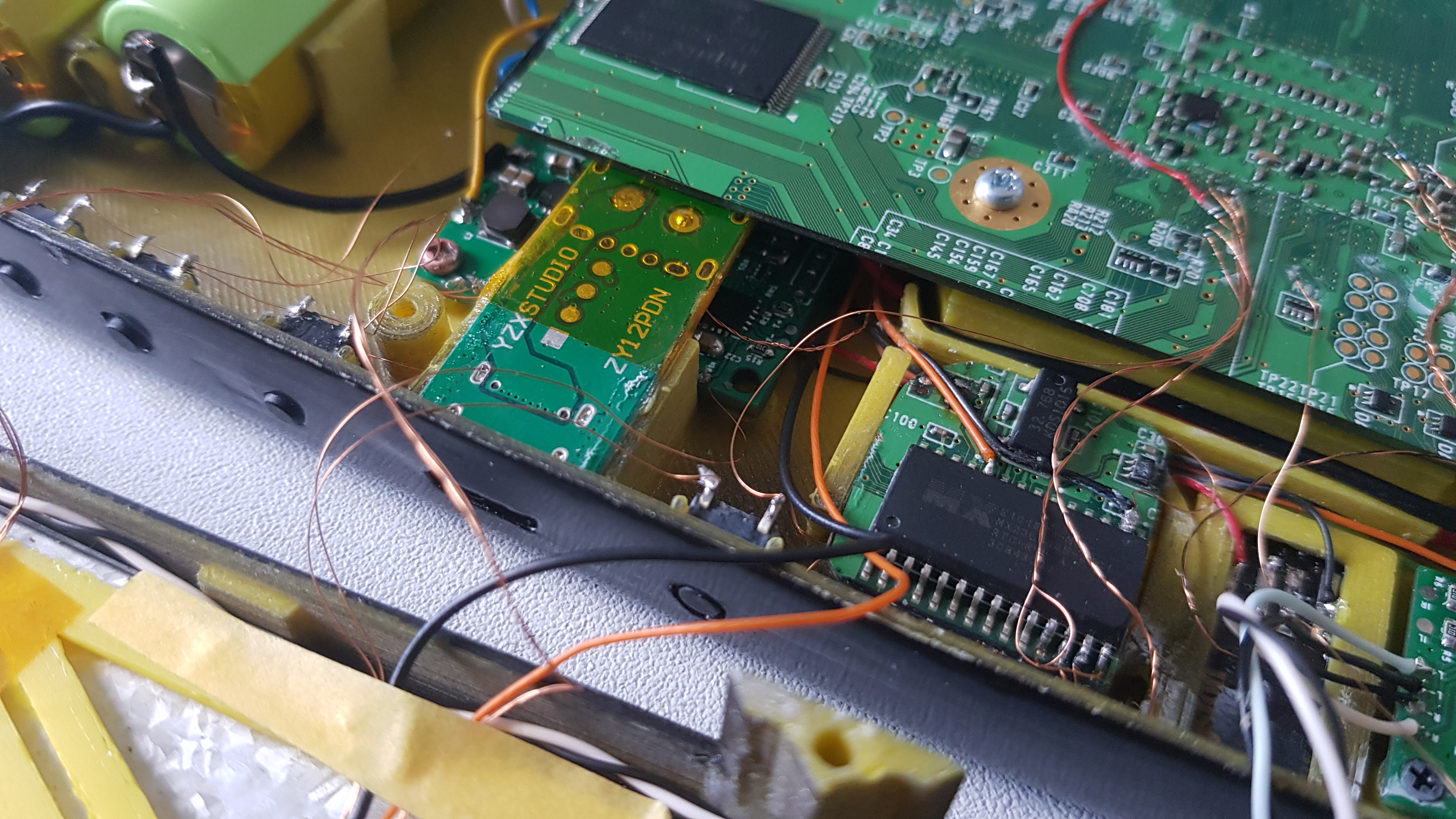

I have changed the cheap PD activator by a better the ZY12PDN, and added a reset button (nice new feature ) :

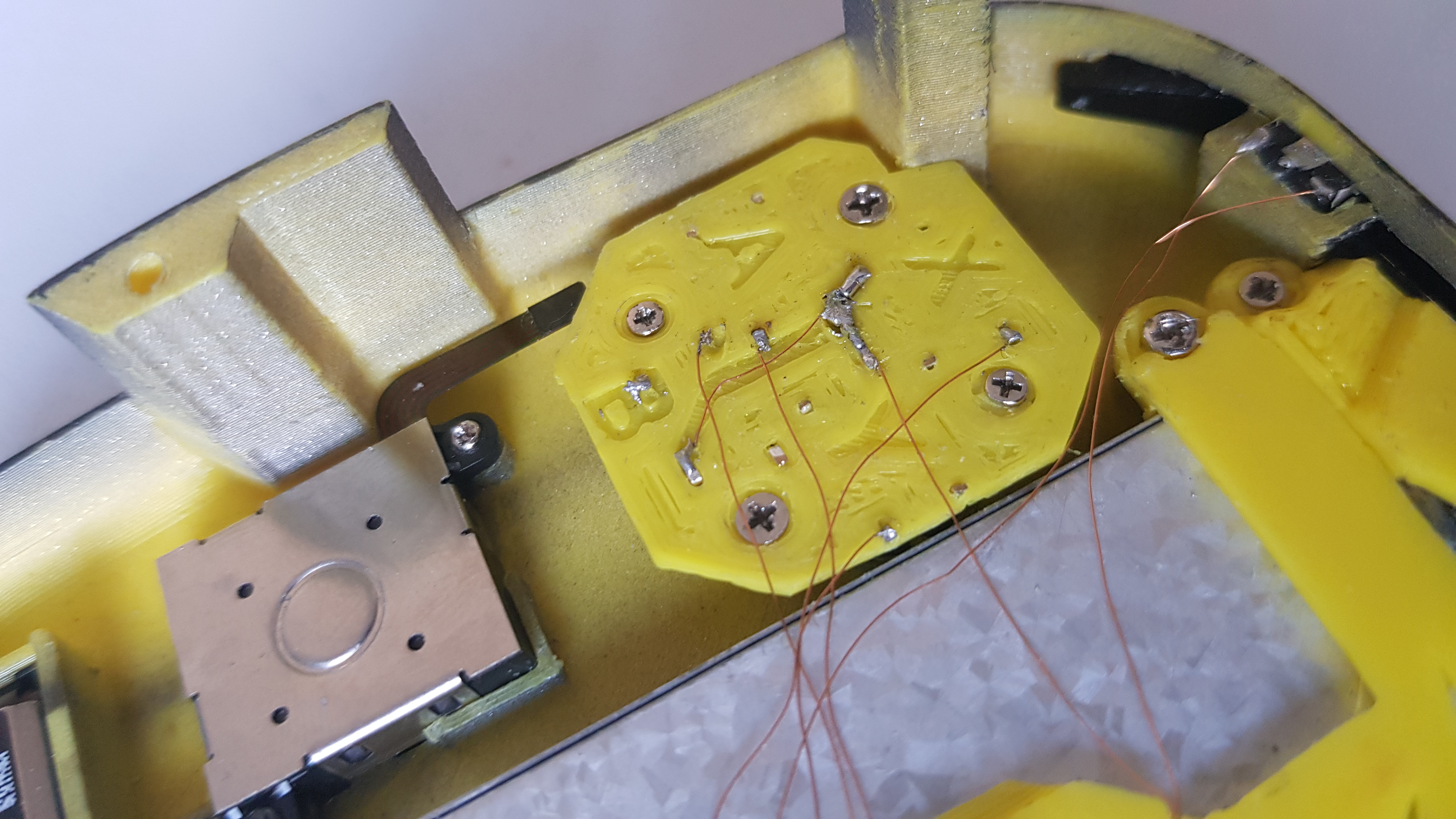

And the last modification I made was that I made squishy tacts holder, but I don't like it at all, it doesn't look clean :\

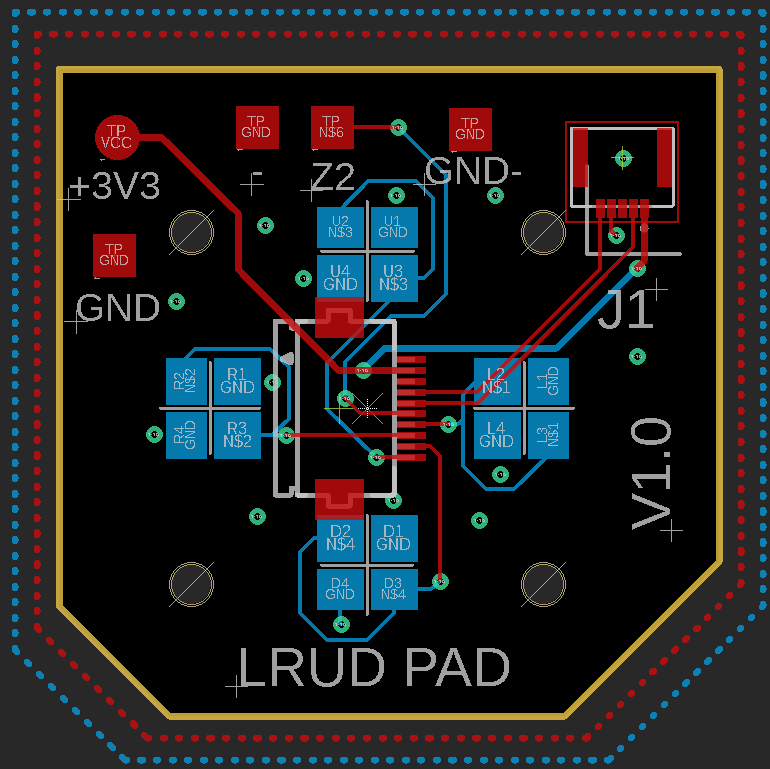

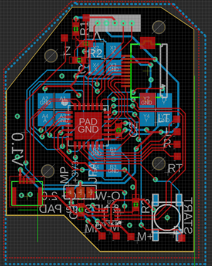

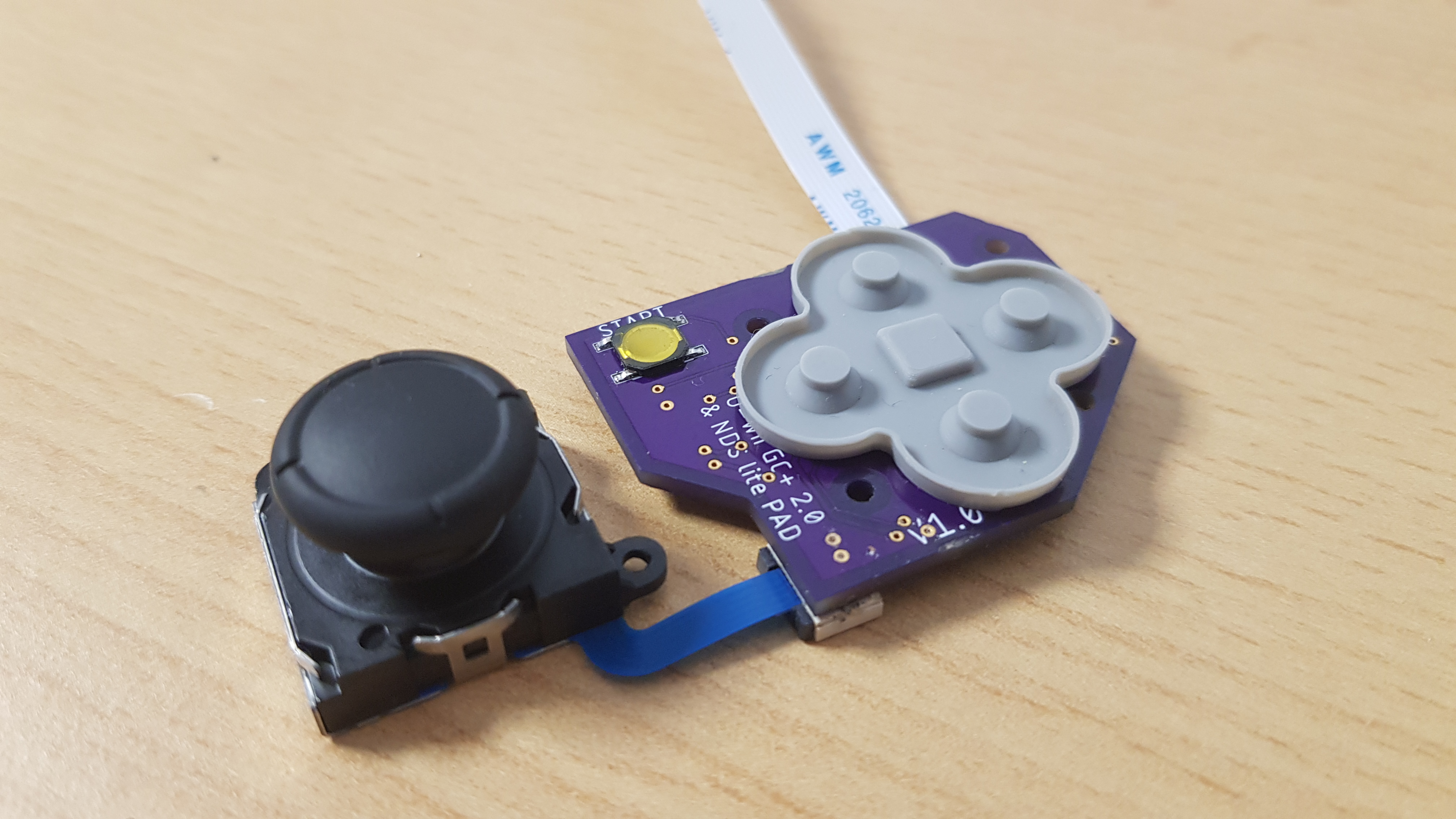

So to solve this problem I decided to try again to make custom pcbs with pad adapted to the NDS lite button.
This time I took all the pad measurements on an NDS lite with a digital caliper, and I created Eagle libraries.

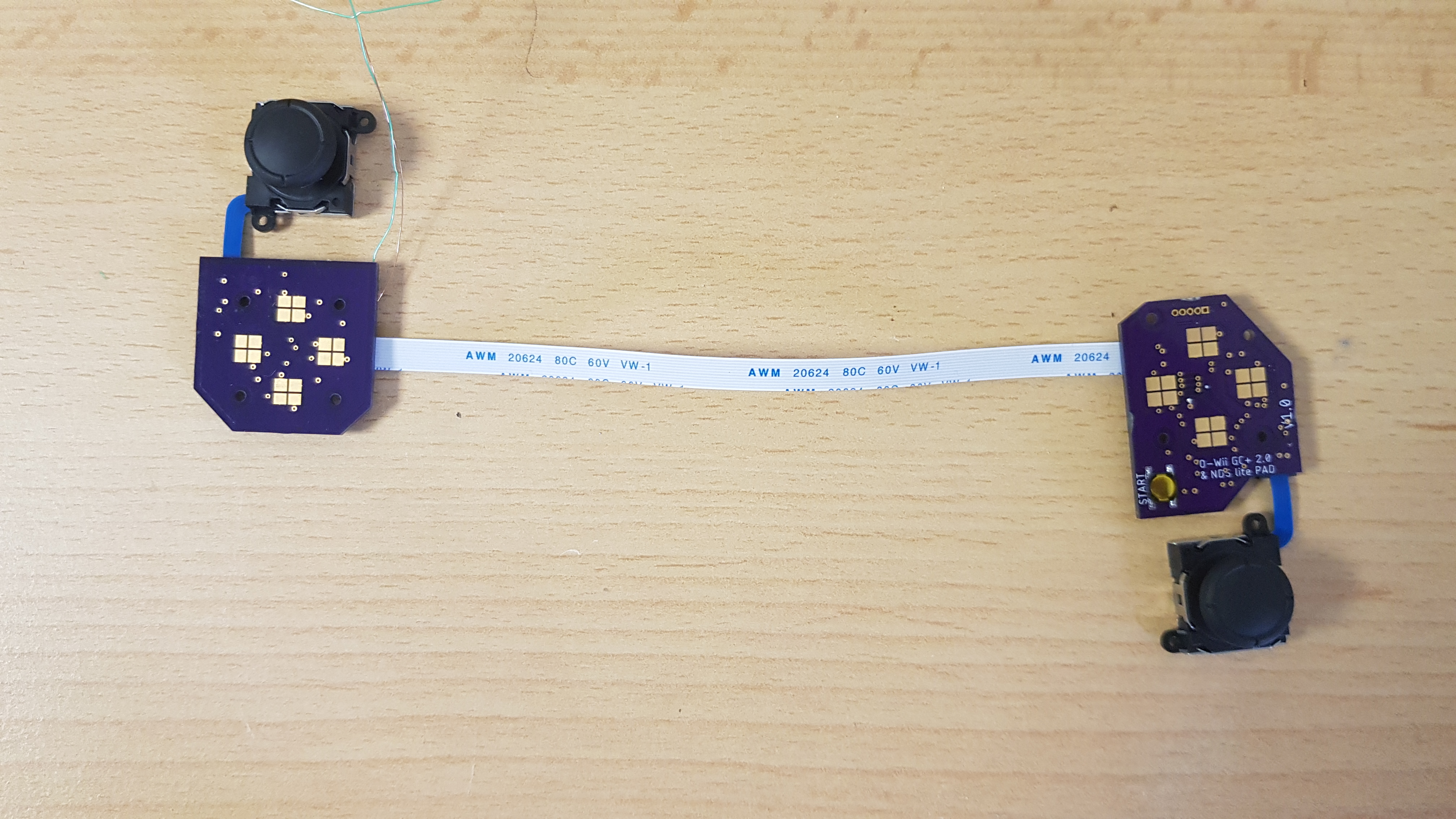

I wanted to remove as much wire as possible and make it easy to install so I integrated the GC + 2.0 above as well as connectors for the joysticks and a connector to put a flat cable that will connect the right side and the left side.
Moreover I took the opportunity to add the start button on the pcb.
Also I modified the programmer header so that they are like on the U-Amp or on the Wii-PMS, so we can use the same :D
This time I wouldn't make the mistake of leaving the surface finish in HASL, so i ordered them from OSH parks because it is ENIG surface finish.
So this is what they should look like, very eager to receive them to test them, and @KaitoTV too I imagine ;)
Plus it's cool because you can use them even for smaller portable wii like with 4 or 5 inch screens.

For the issue with gamecubes games, I guess the issue is that you have an PAL version of the rom and the progressive mode only works with NTSC roms.
Thank you @Noah, for the next I think to build a PS2 Portable ... but maybe for the 2021 contest, or a very tiny portable Wii like the GCii Pocket with Omega trim, and many other awesome project ;)
@Emetsys Thank you very much I hadn't thought of that !
I have to try to put games in NTSC to see if it work.

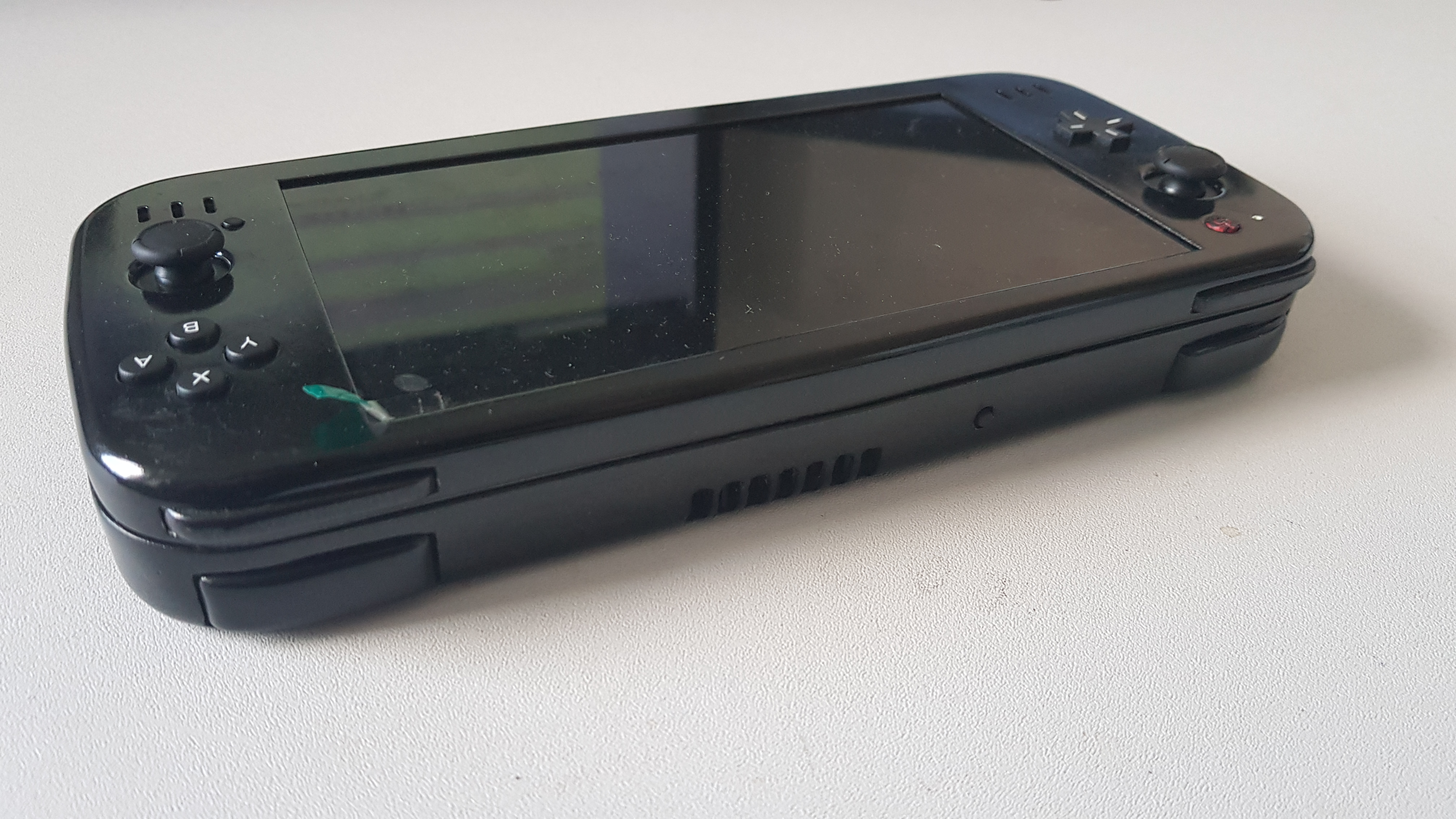

In my projects I always try to optimize the design to have something as miniaturized as possible,
I think I have succeeded with this portable Wii and its large 7-inch screen.

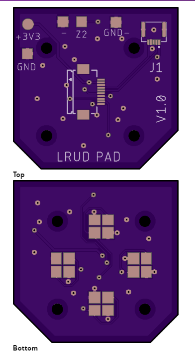

Hi, I like your build, your buttons, I hope you can improve some, I give you some, I hope it can help you. The added attachment is DXF format, which can be easily switched to PCB.

@ohkin86 Thank you very much <3, this is exactly what I was looking for ! I had tried to do some but failed to do them !
It can be very good for making PS2 pads custom pcbs due to the analog button.

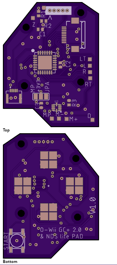

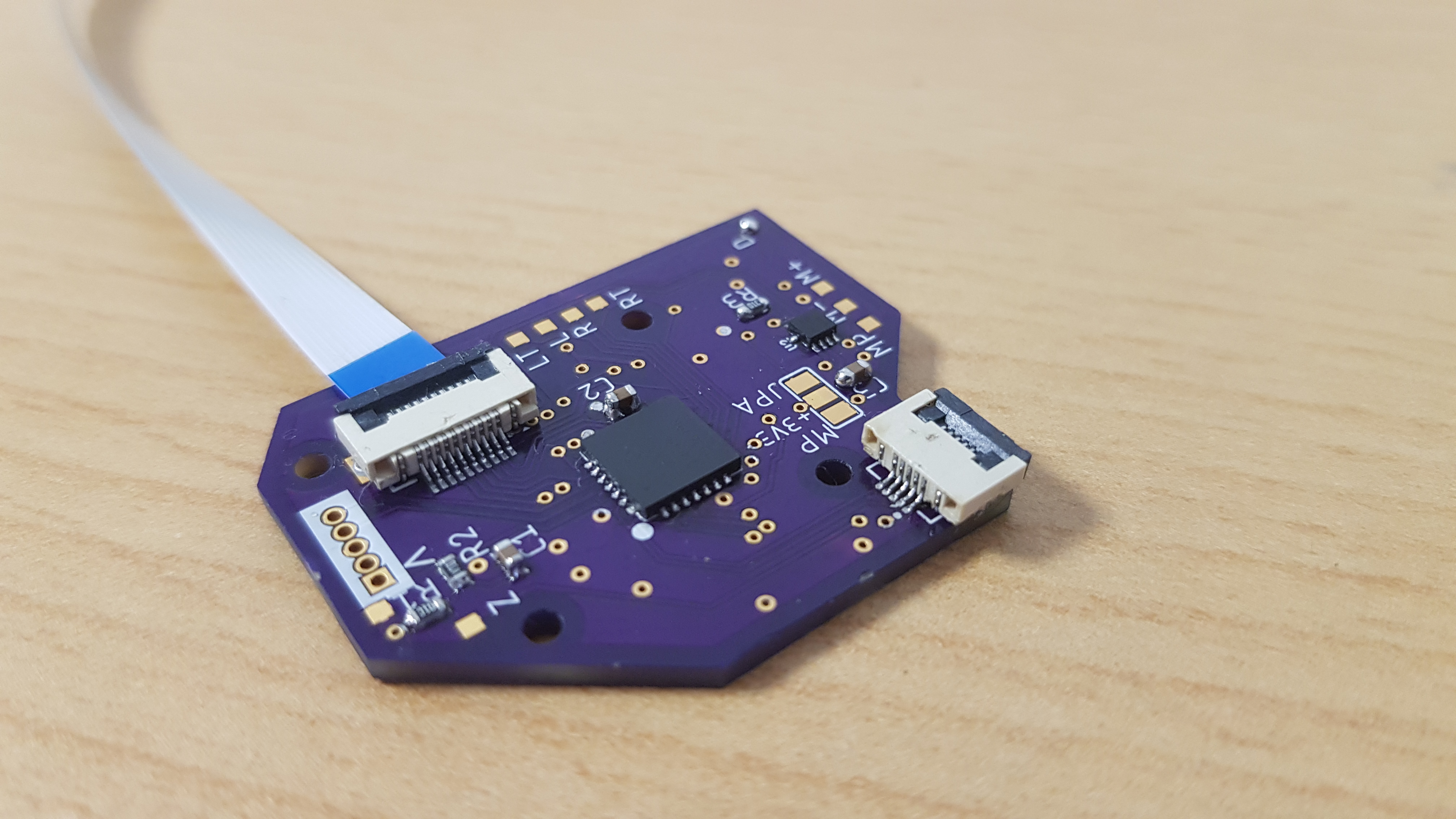

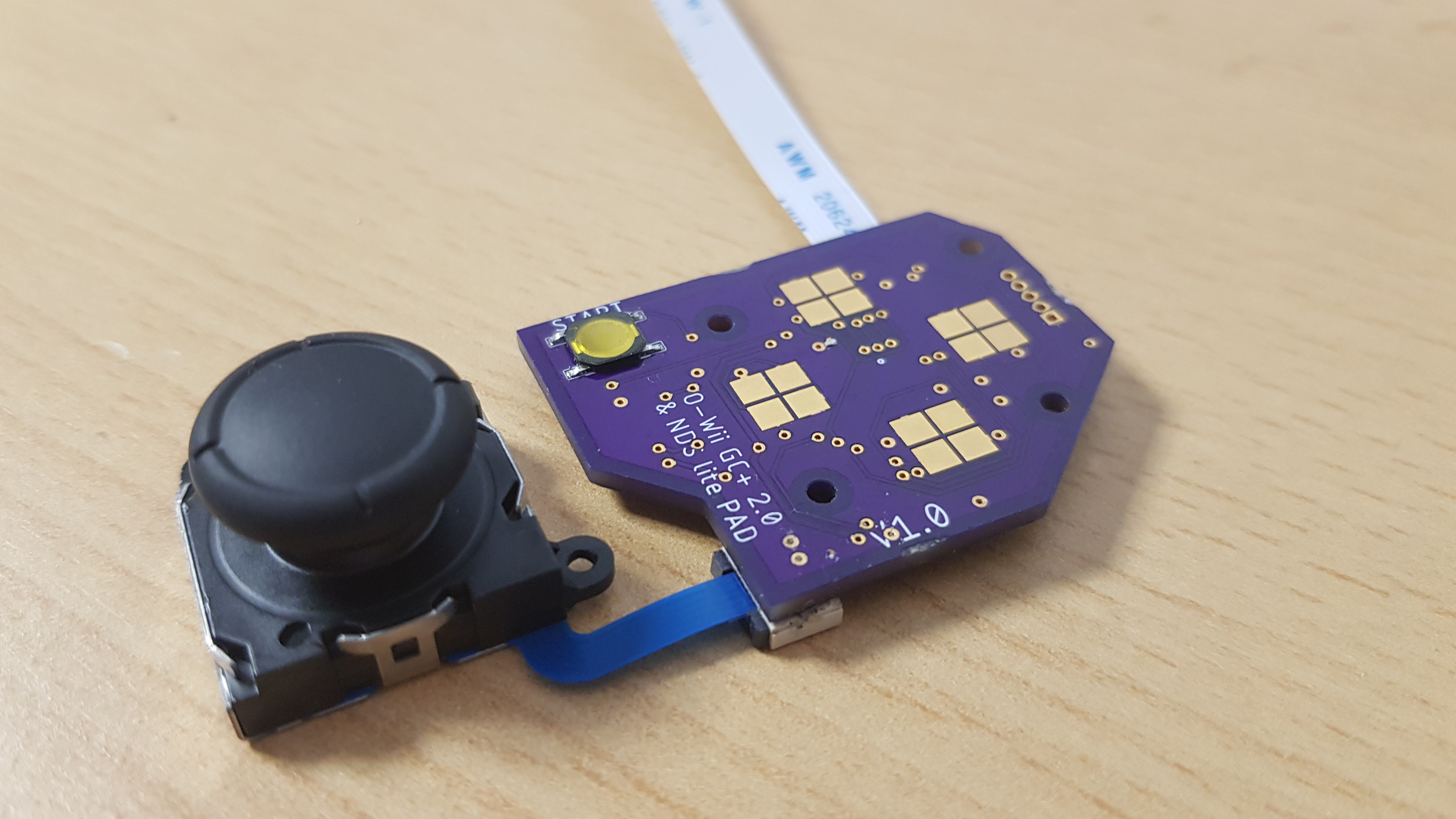

I haven't told you about it yet, but I received my custom NDS button pad with GC + 2.0 PCB that I made.
I finally received the flat ribbon cable that I was waiting to show you the result with all the components that I have solder on it :
Here is the result :D
The pads work well (cool I was not wrong in my measurements!) ....
But the joysticks don't work at all :facepalm:
I looked if the connections were good, tested the connections, tested the joysticks (with my first O-Wii, and looking at their resistance between their pins.
Everything is good, and when I test the resistance (U / D, L / R GND, Vcc ...) on the circuit it is also good :?:
But it doesn't work :(
I have tested to connect the connector directly to wire like I did in my first O-Wii (I think that by having solder the connectors it could have damaged them and created bad contacts between the joystick and the connector), and connect it directly to GC+ 2.0, I have tested so many time ... programmed the GC+ 2.0 again, change the GC+ 2.0 by another ... tested connection and resistance again and again. But the joysticks never wanted to work :angry:
I may have forgotten something or the connectors are not good (they work great with my O-Wii v1.0 so I find that weird).
If you have any ideas, of mistakes I could have made, please help me
