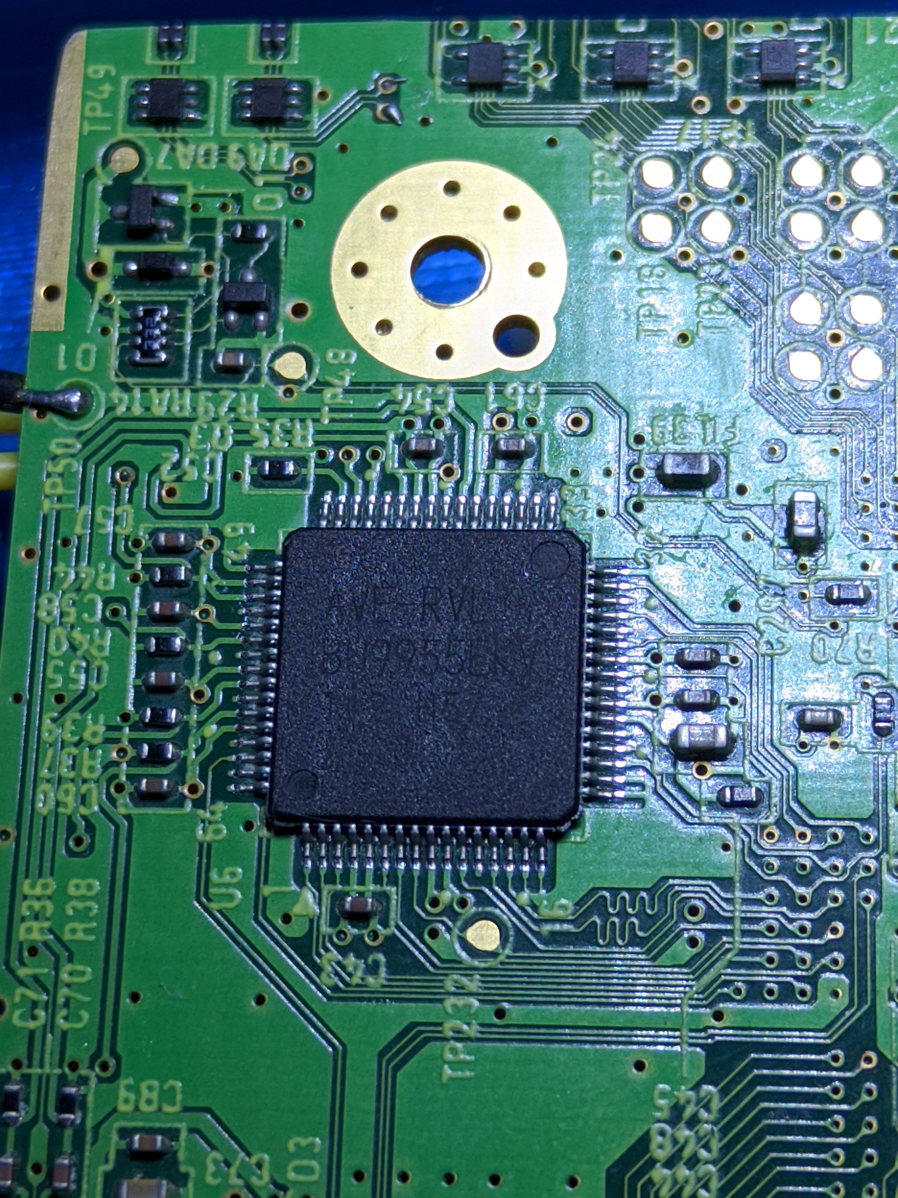

Can you take a closer pic of the area around the AVE? perhaps we might be able to see something.
Here's the AVE. You can see the ground point for composite off to the left side. I'm currently pulling composite from the opposite side at C91.

You need to connect mode to 3.3V, otherwise nothing will come out of luma. Though since you have enabled VGA during BBLoader installation you have to connect mode to 3.3V few seconds after boot, otherwise it would output VGA. Also, since 480p is already enabled, your monitor might not be able to handle a 480p "composite" signal from luma.
Those TP pads are not all ground. Even though some have continuity to ground on a multimeter most are a data line. Maybe use the outer ring of the screw holes on the GC motherboard as the ground. Or the ground side of a resistor. Also, your composite Via still has some mask on it. Make sure you scrape off all the green mask so it exposes more of a solder pad.
I used the composite ground based on the guide, but I'll try another location. For composite, I tried the via you mentioned, but then relocated to the edge side pad at C91 on the other side of the board and still had no signal.
