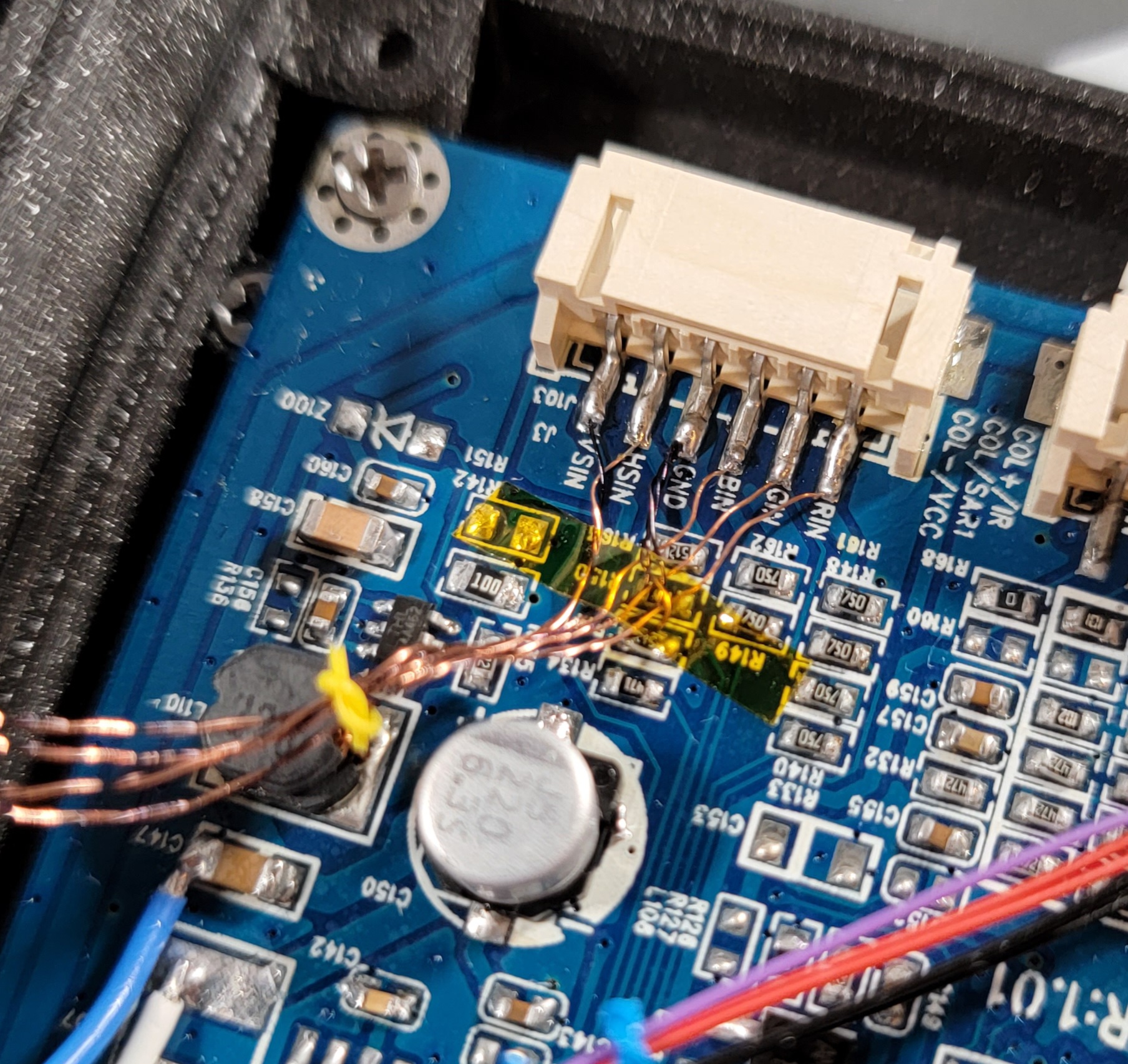

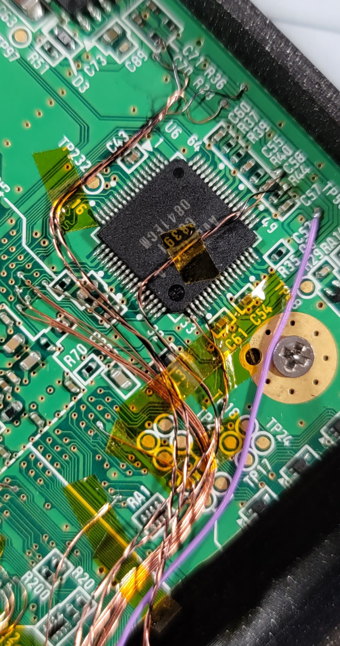

Hey there! Earlier in the build I skipped the VGA wiring step just to get everything else together and make sure buttons/audio were working.
Everything was working great so I disassembled it again to get the VGA hooked up.

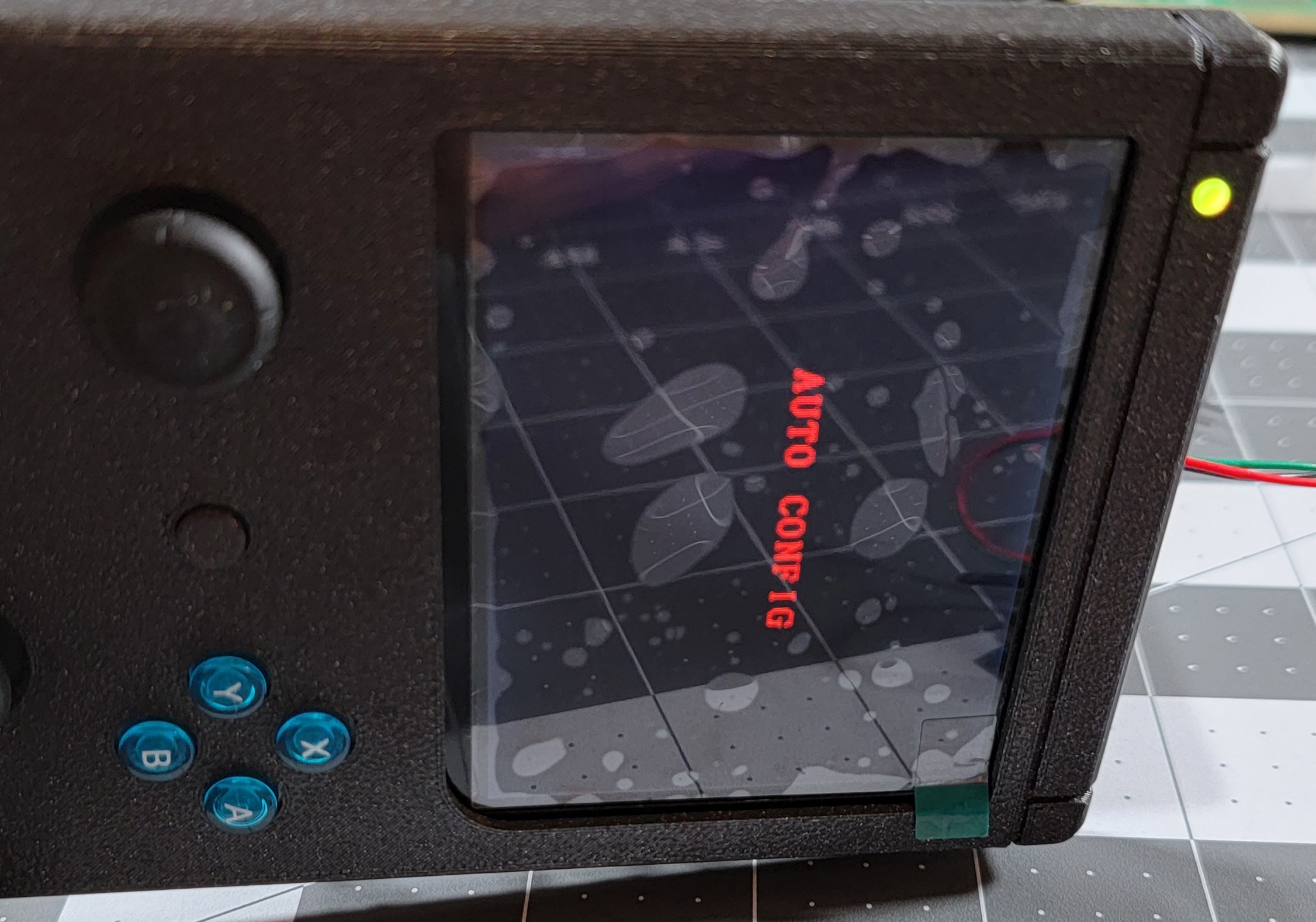

After getting that wiring complete (see attached photos), the unit now displays the message "AUTO CONFIG" for a second when it first boots up, but then seemingly reverts to composite as the picture quality is the same as before. Furthermore when I connect the provided daughterboard and press the source button, it just switches to a blank/black screen. If I press the source button again the display turns on again (presumably in composite mode). Any idea what my problem is here?
(also should say, it's not pictured, but I did wire a 3.3V line to the TP47 pad which I believe is the "mode pin")

I've personally not had any issues twisting the sync lines in any of my builds so I doubt that is the issue. Have you verified your mode line is getting 3.3v and that the VGA output is set to progressive?
3.3V is good, but how do I check if the VGA output is set to progressive?
