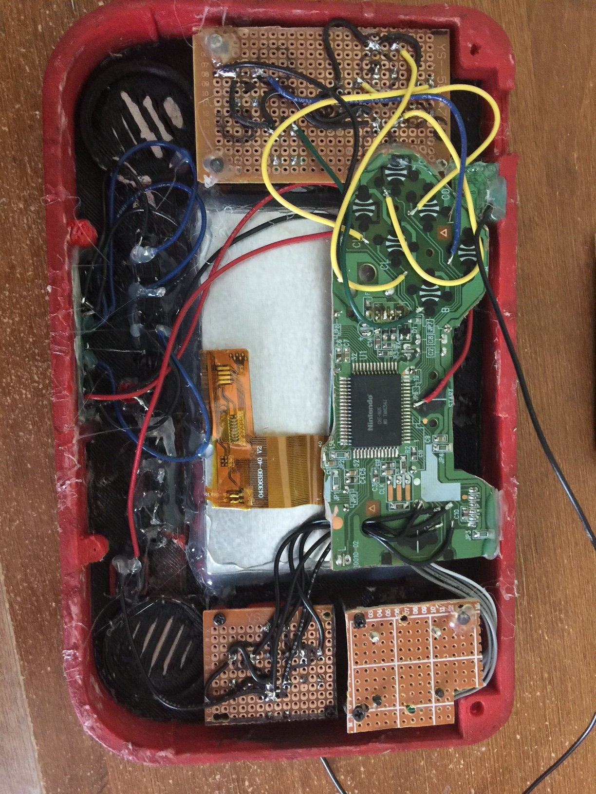

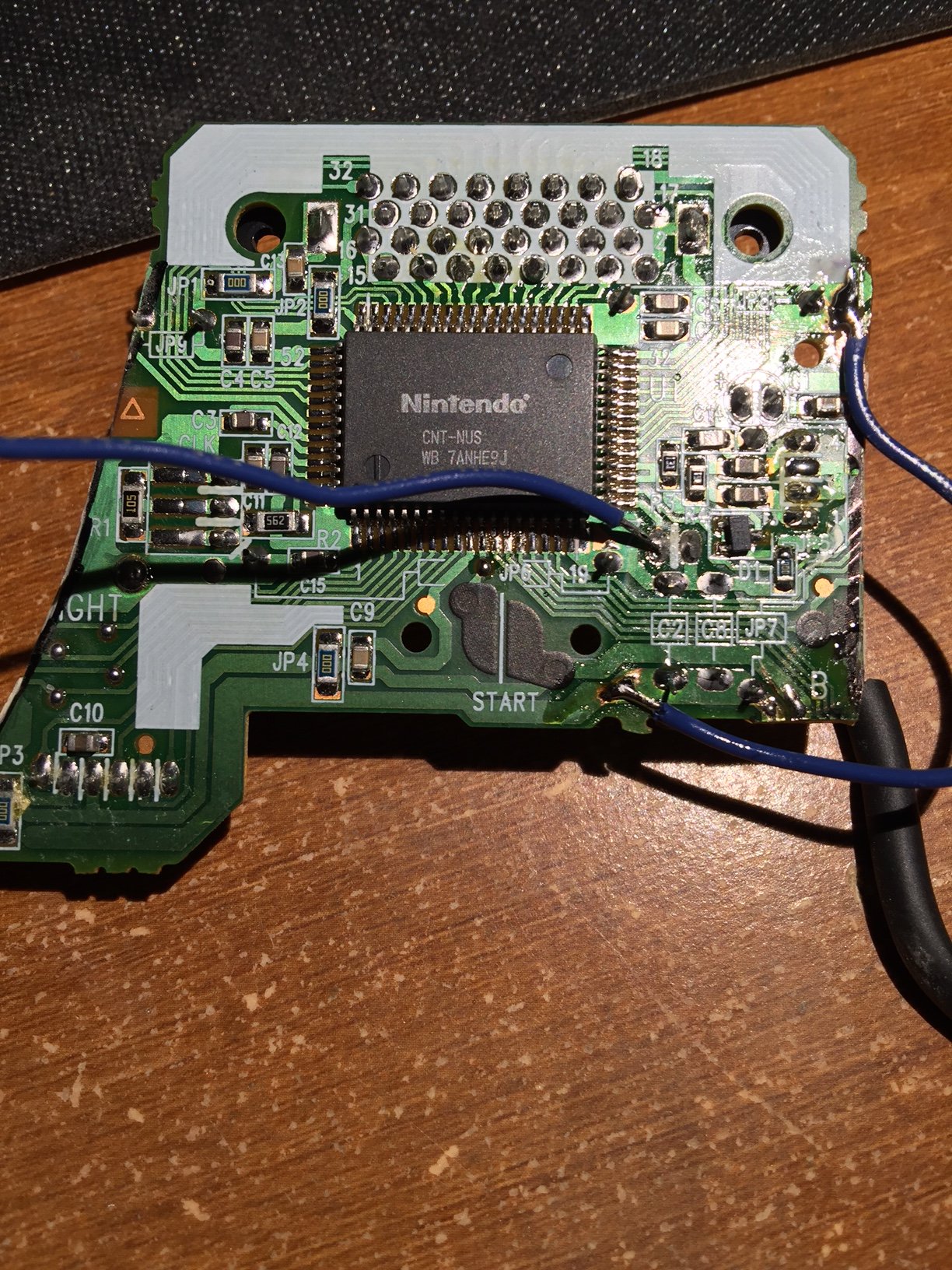

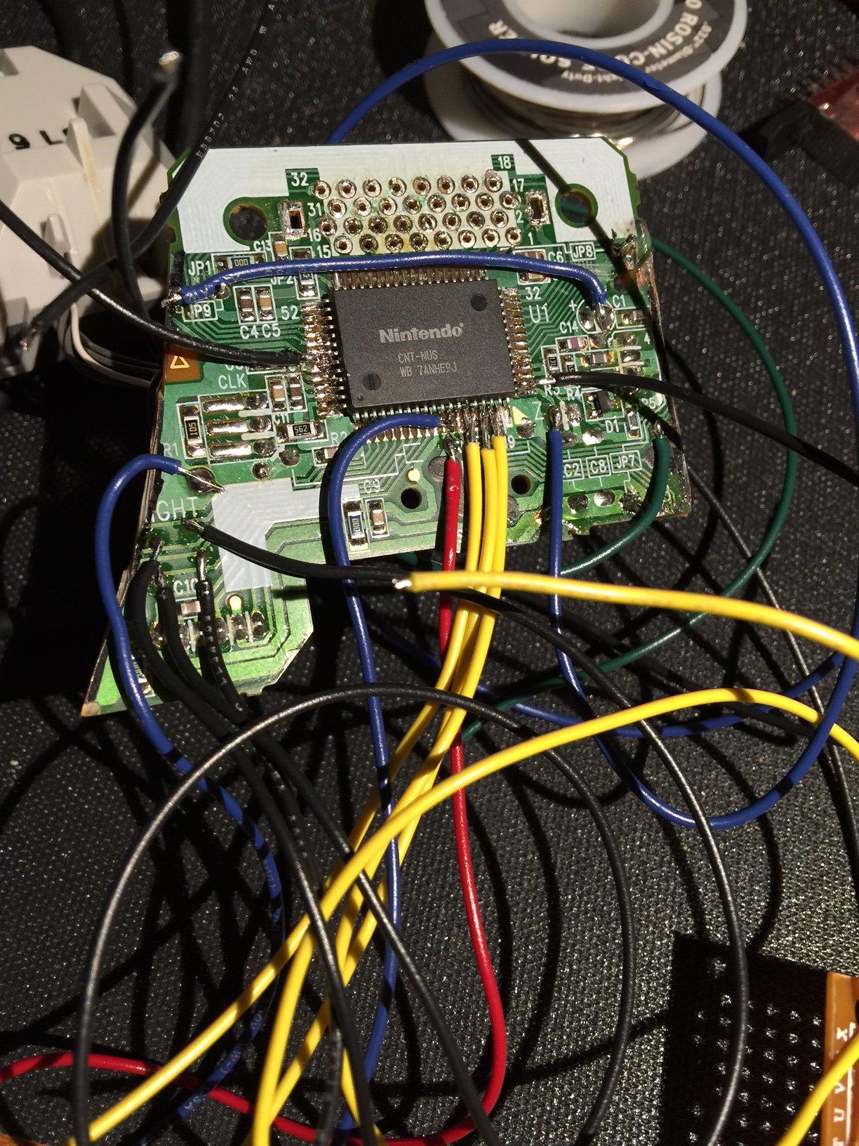

You may also want to look at getting some thinner wire, that wire you've got on the controller board looks a tad thick, and while it won't cause problems electrically to use thicker wires, it would most likely be much easier to solder the thinner wire to the points you want to get at

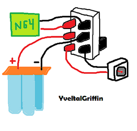

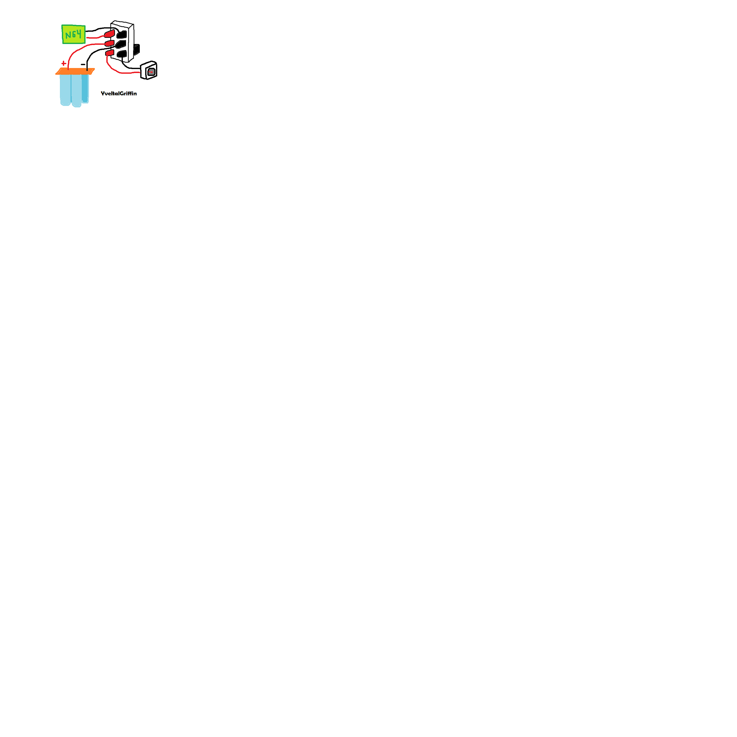

If you have any other tips, seriously feel free to share them, I could seriously use them. Specifically about the charging circuit for the batteries I could use some help. My goal is to just have it to able to charge the batteries when it's turned off and to run on batteries when it's turned on. No need for wall power. In future portables, I'll follow SS guide on the charge and play, but for this one, I'm fine with this idea.
@cheese -- You are totally right. I learned that about 5 seconds in when trying to solder to the chip. For the next portable I make I definitely will do that, but because I'm trying to finish this up before school starts, I just made do with what I had.
Hope this diagram helps. Simple DPDT switch. When no power is connected to the N64, the charging jack is connected to the battery pack. Just make sure to use a dedicated lithium ion charger.

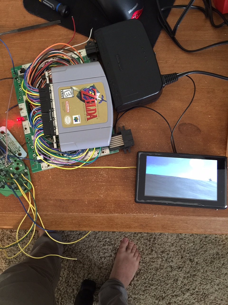

So it's been a bit since my last update but here ya go:
I managed to get it to work on a 3.5" screen I bought off amazon:
And although it fits (just barely) I decided I wanted to do a 5" screen instead. I'm still working on that part (the 5" screen isn't playing well with the n64)

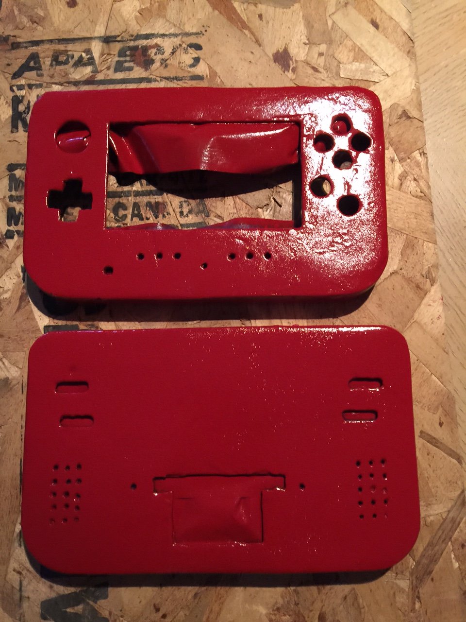

I have been working on my case a ton:
Something I learned from my first time using Bondo: Bondo is a huge pain to work with sometimes. The fumes filled the whole house, causing my mother-in-law to flee in a coughing fit, getting the right amount of hardener for the amount you are working on. Its gets everywhere, and it hardens waaay faster then I thought it would, plus it can leave a huge mess.
So basically my case looked like poop when I did it. I sanded it by hand for a few hours and spray painted it. But I thought it looked like crap so I decided to take an electric sander to it and the picture above is the end result!
So it's not amazing, but I love it! The pictures don't do it justice for how it looks and feels. It's very very smooth.
NOTE: I did purposefully fill in the speaker holes. I decided to go with just a headphone jack for this build. I don't plan on using speakers ever and because of time constrictions I decided to forego them.

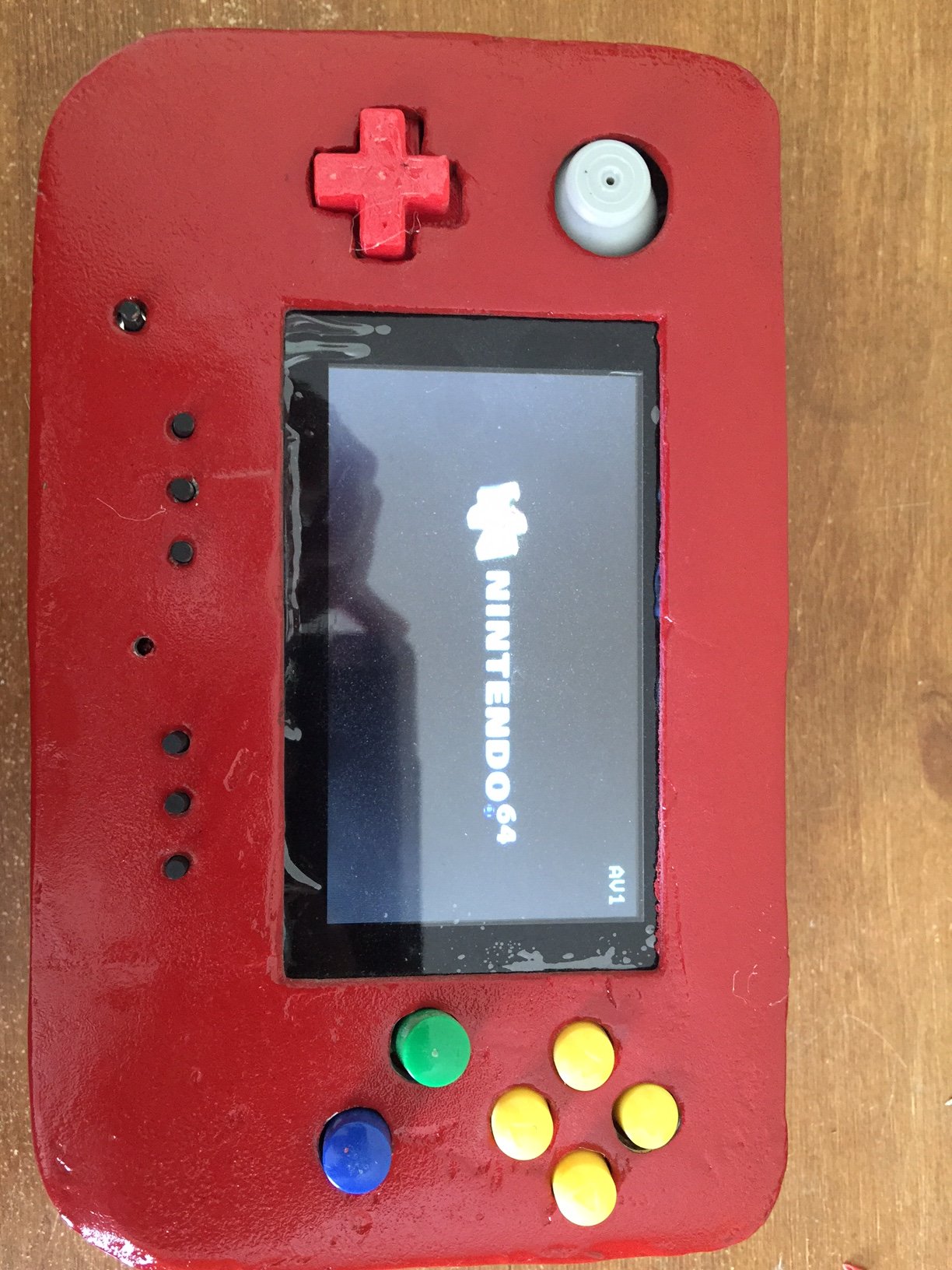

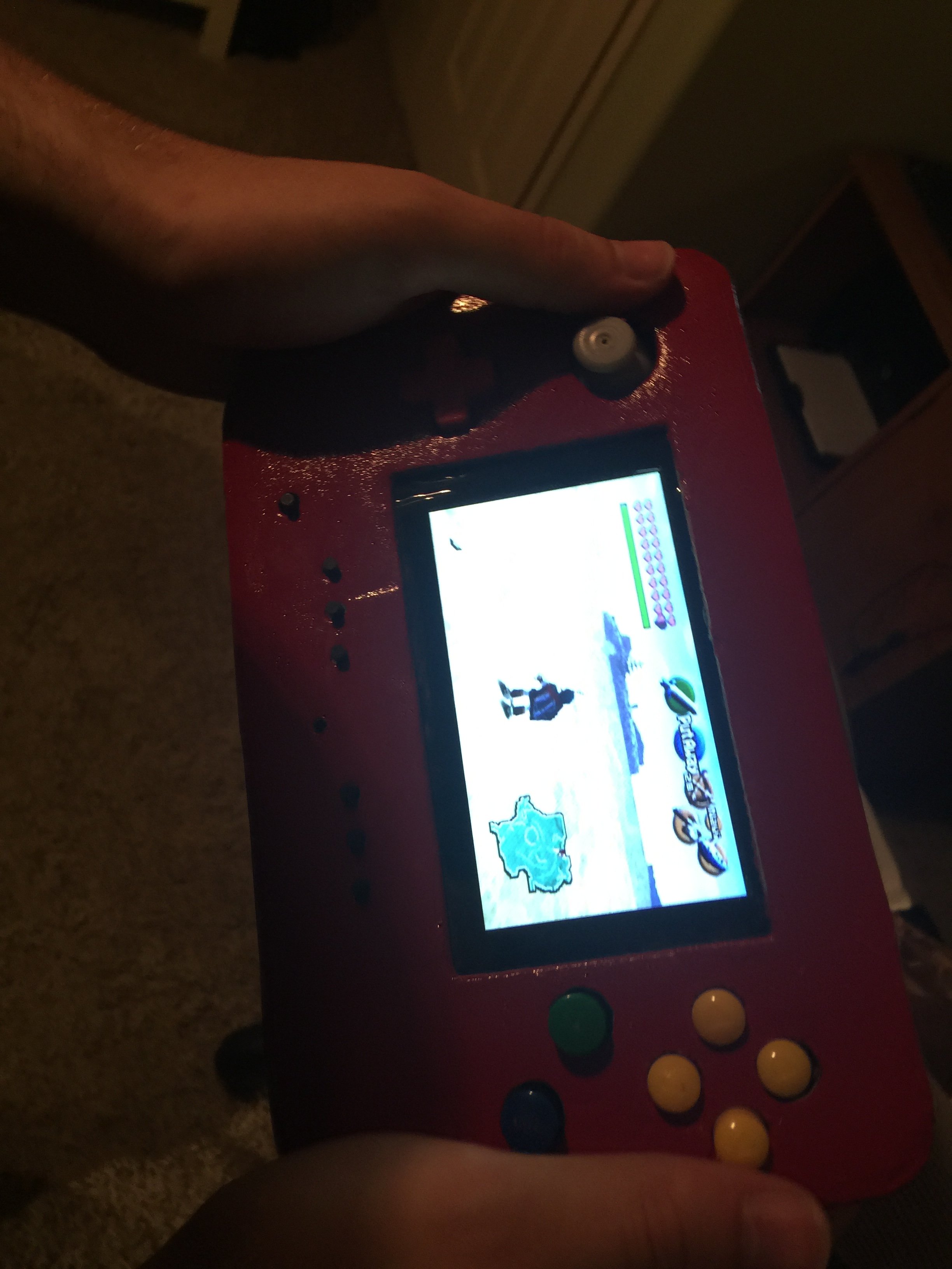

Here's the final result:
Specs:
- 3D printed case (Huge thanks to @Downing for those .stl files)
- SS Charge-and-Play circuit.
- Trimmed n64
- 1st party controller with a converter for GC joystick.
- 2 3.7 Li-Po Batteries at 5000mah each for good battery life.
- 3.5" backup camera screen
- Headphone jack for audio
- L button and double Z buttons.

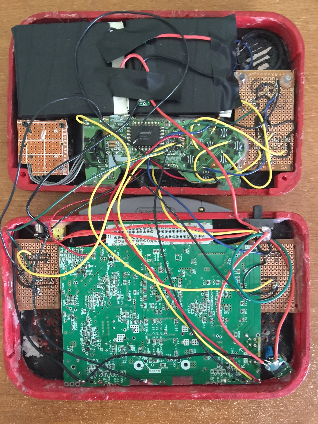

Here are some nudes:
The wiring isn't the best, there are some case flaws, but it plays great and works!
For my first portable ever, I'm really proud of it.
Here is the final look:
A huge thanks to everyone in this community, I couldn't have done it with out all the sweet documentation and hard work of the BitBuilt team!
I am still thinking of a name for this one, so if you have any suggestions, let me know!
