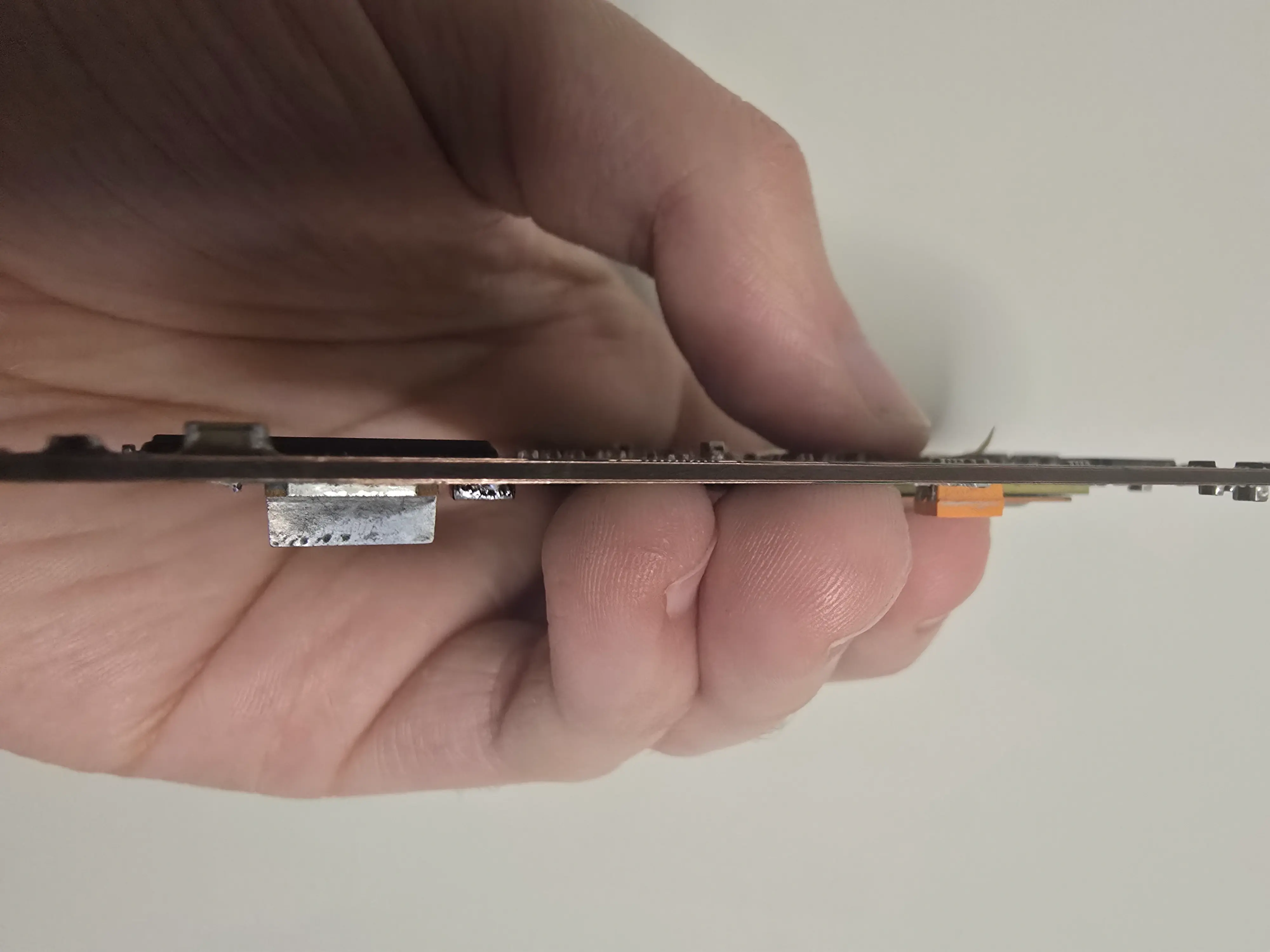

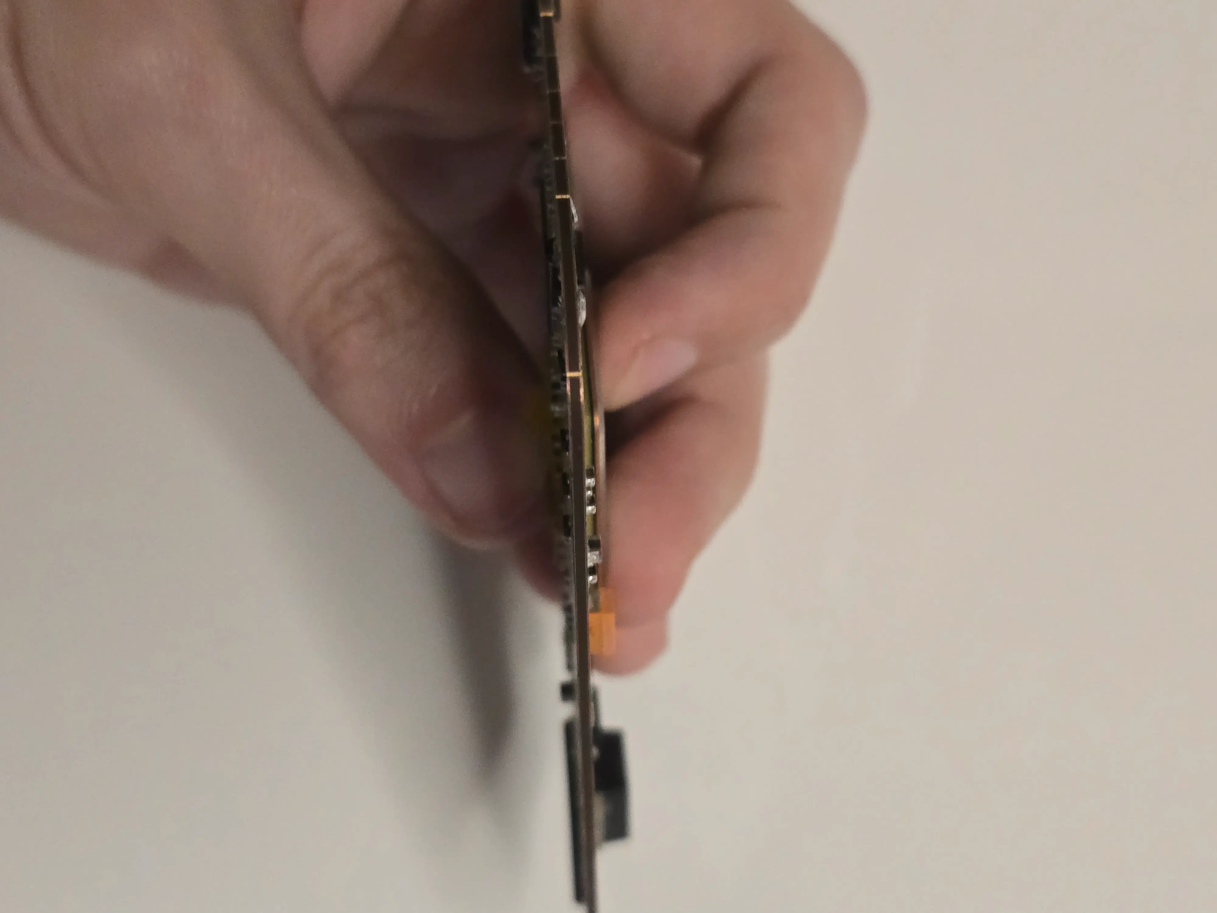

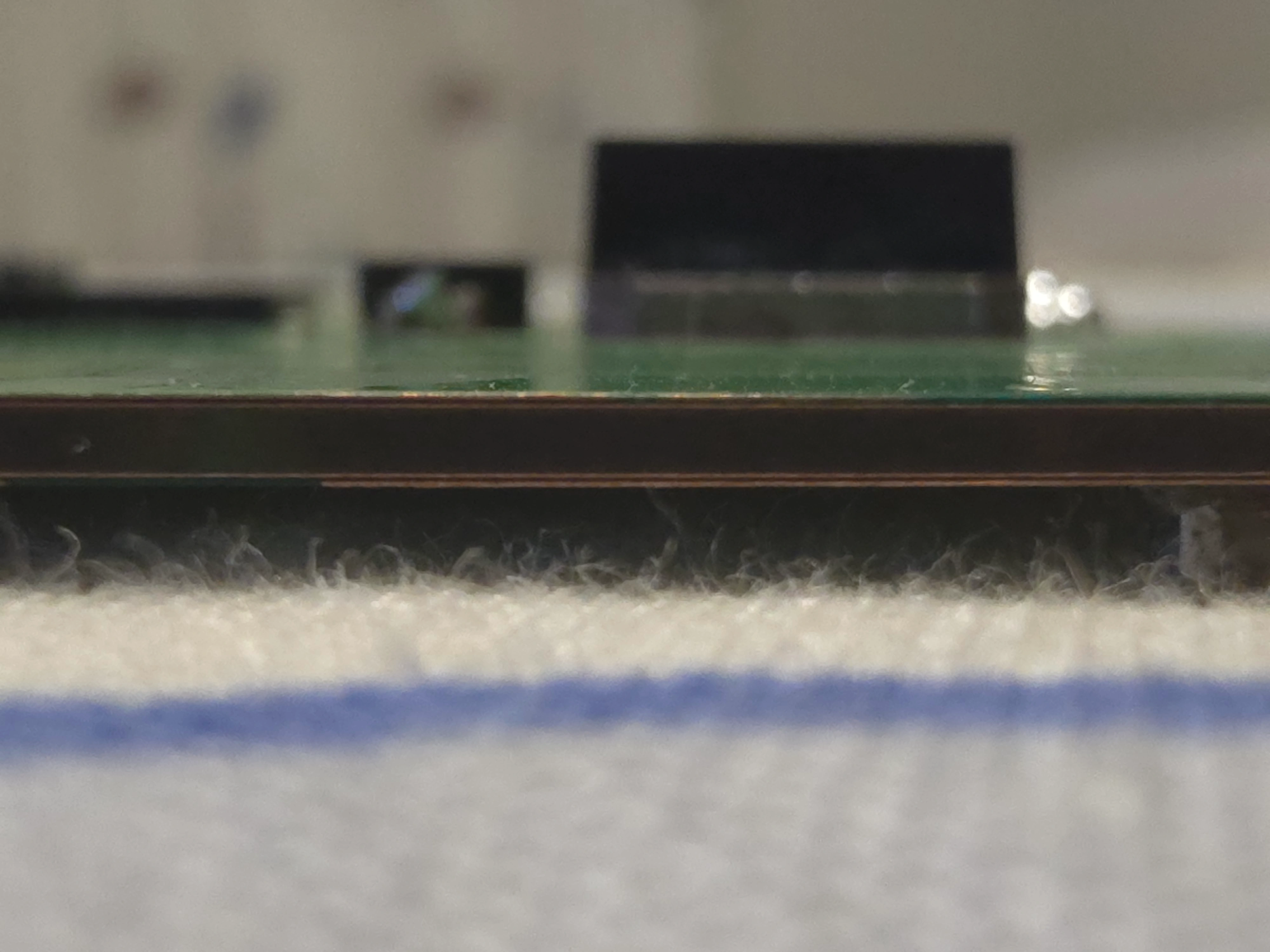

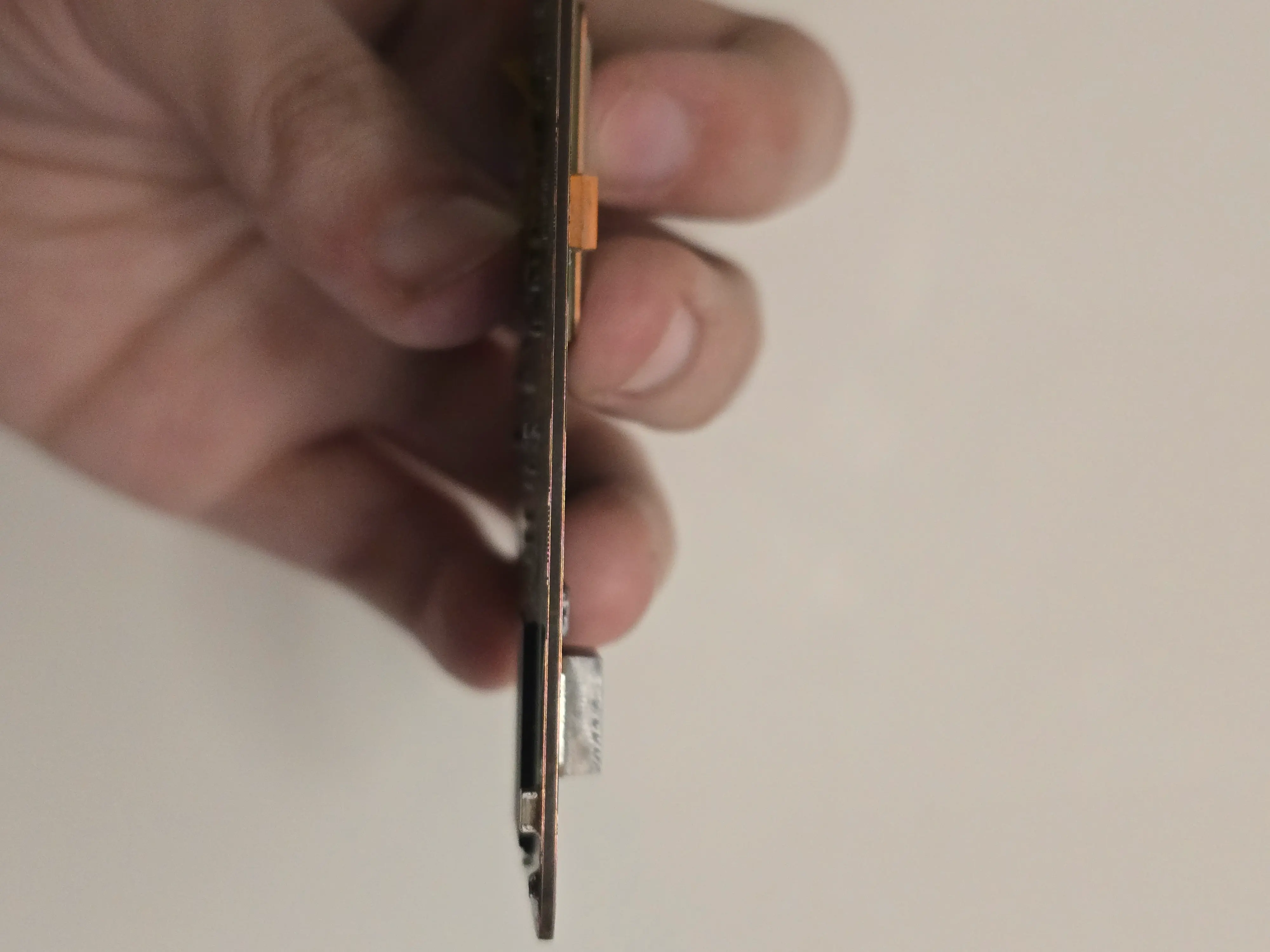

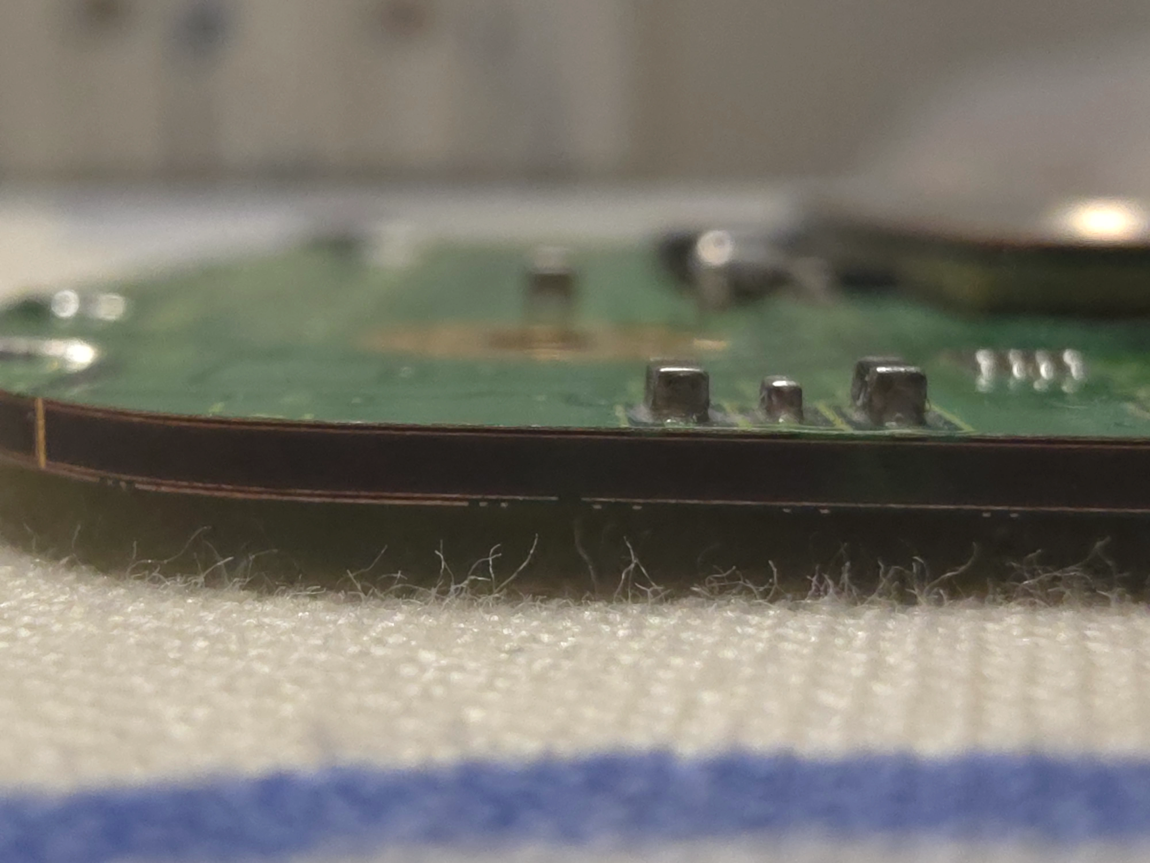

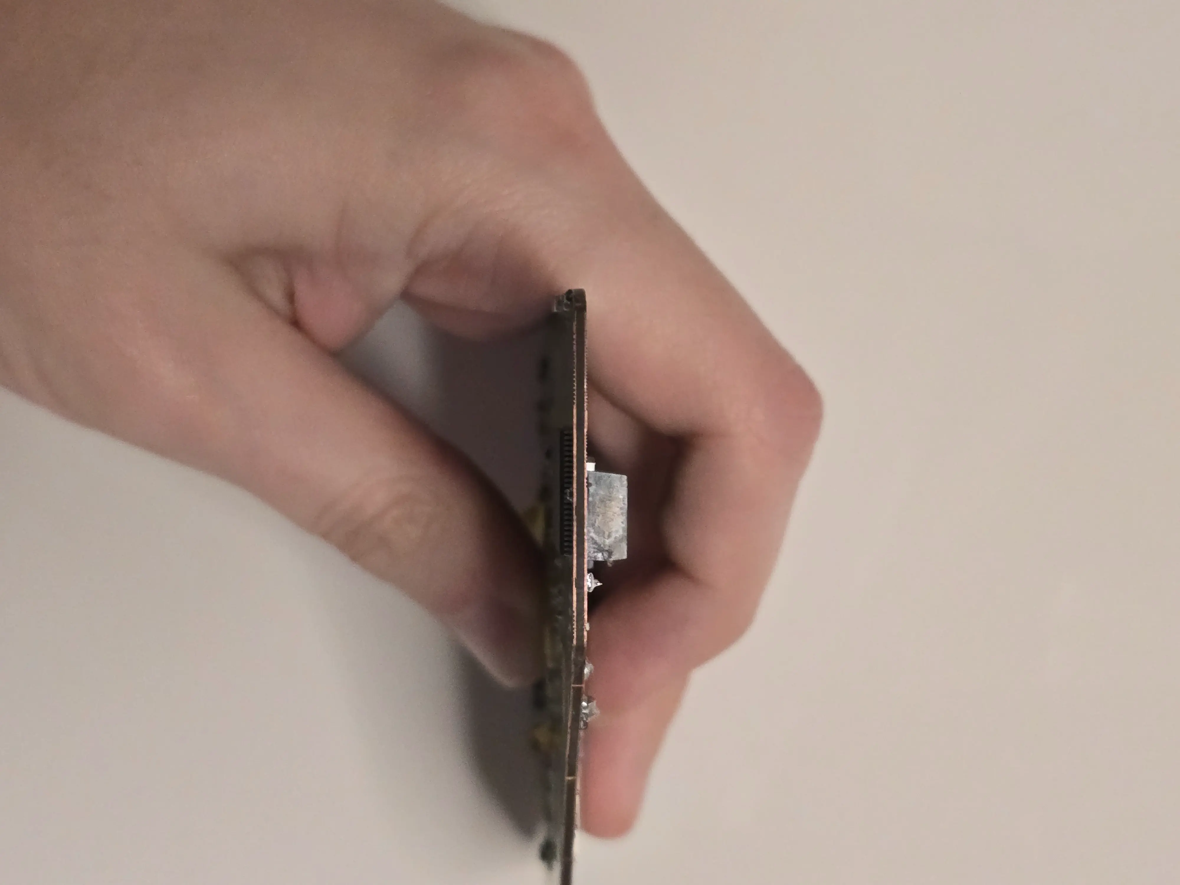

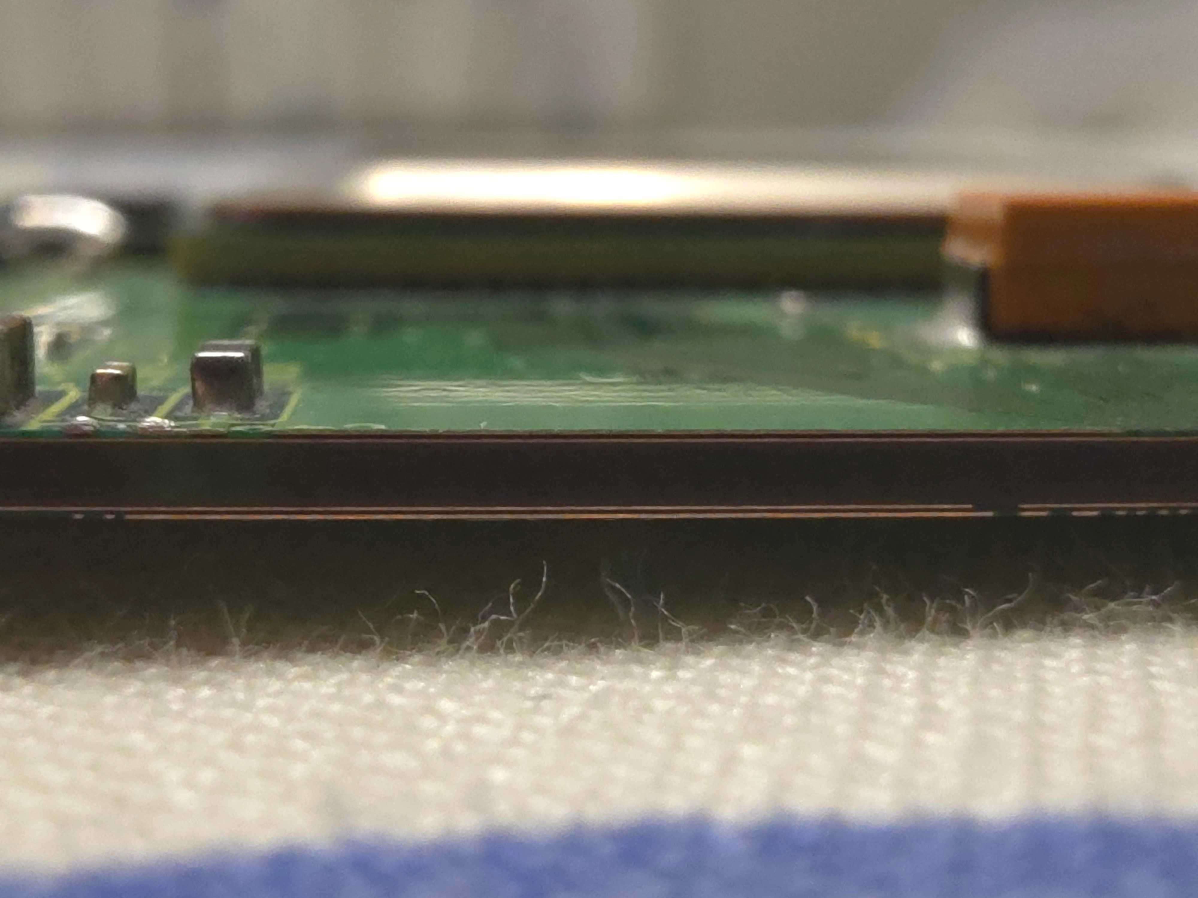

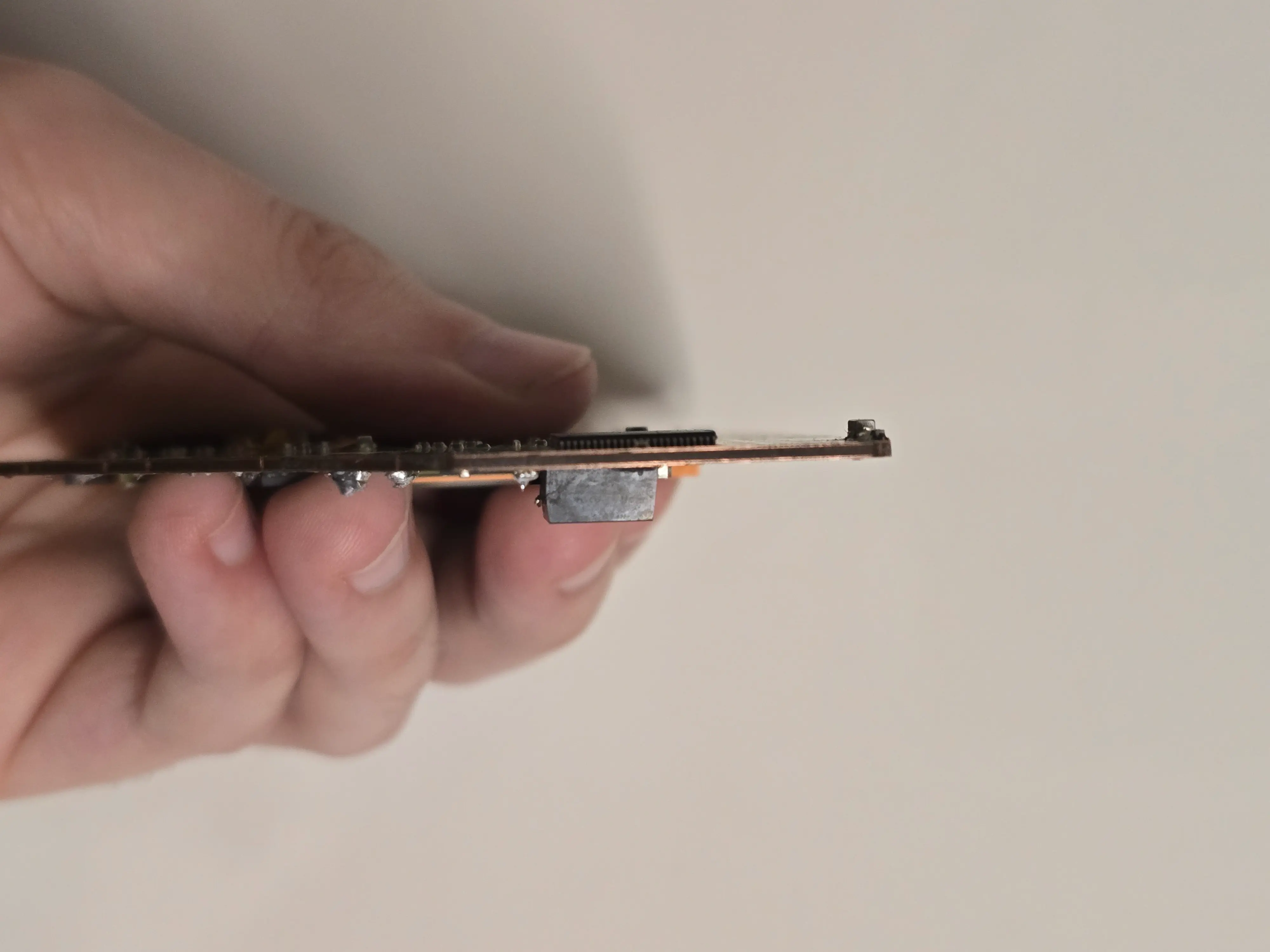

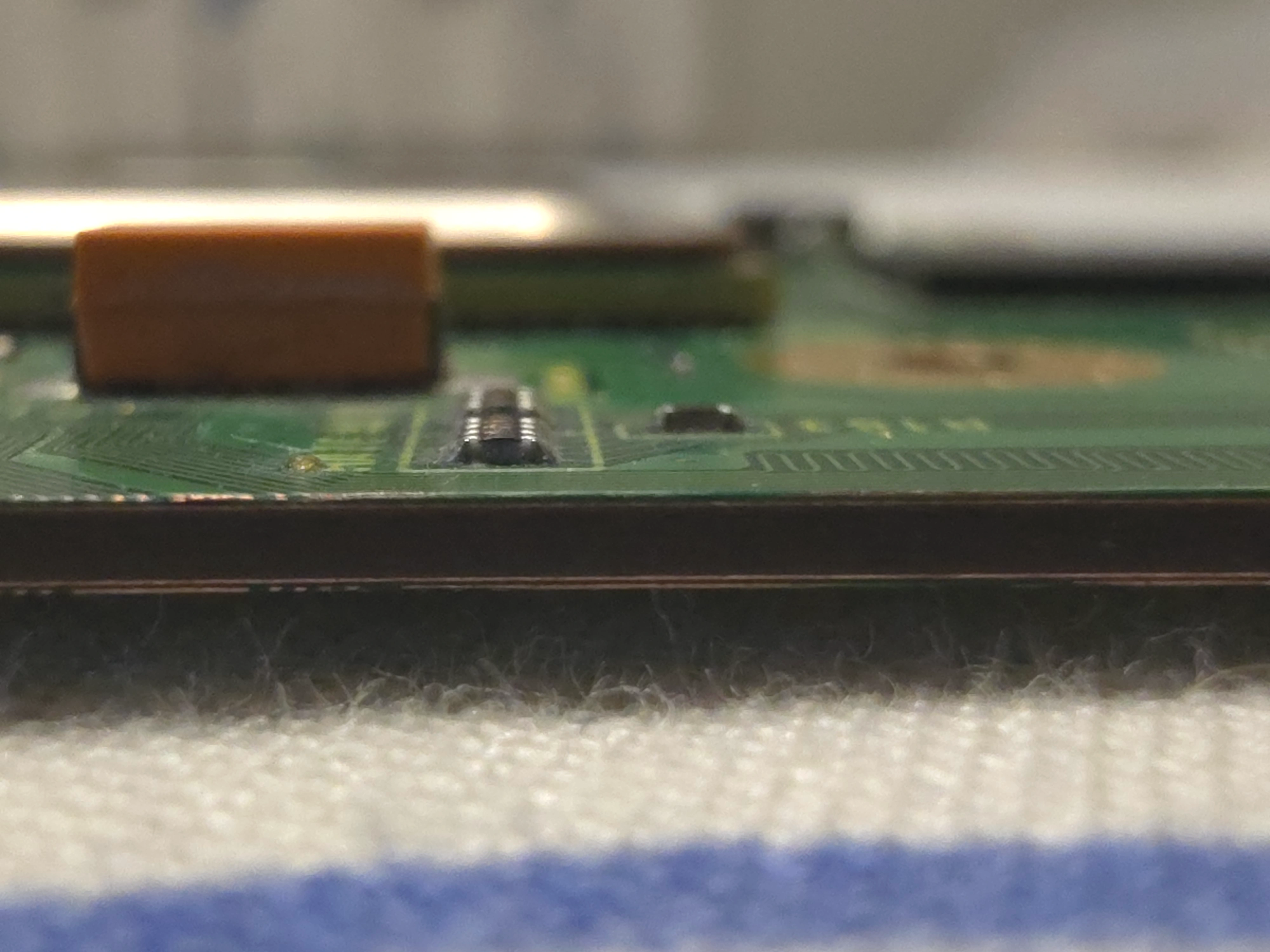

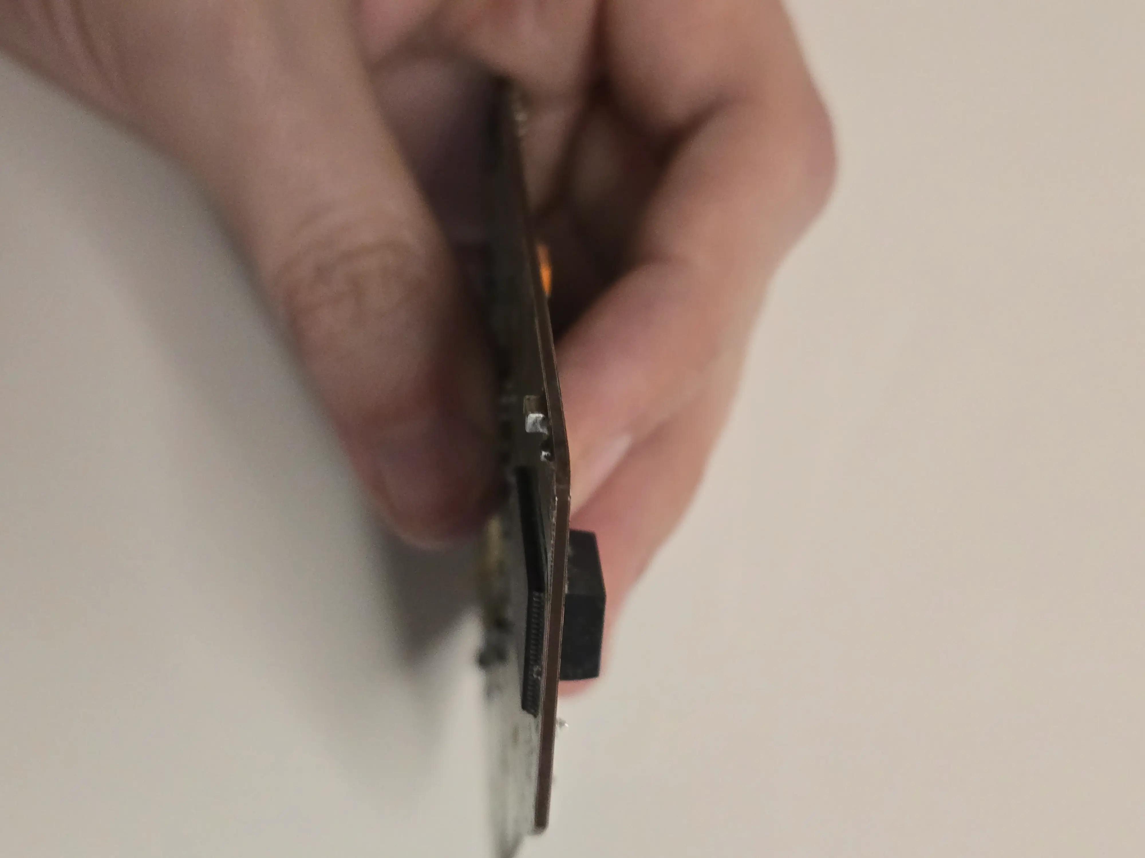

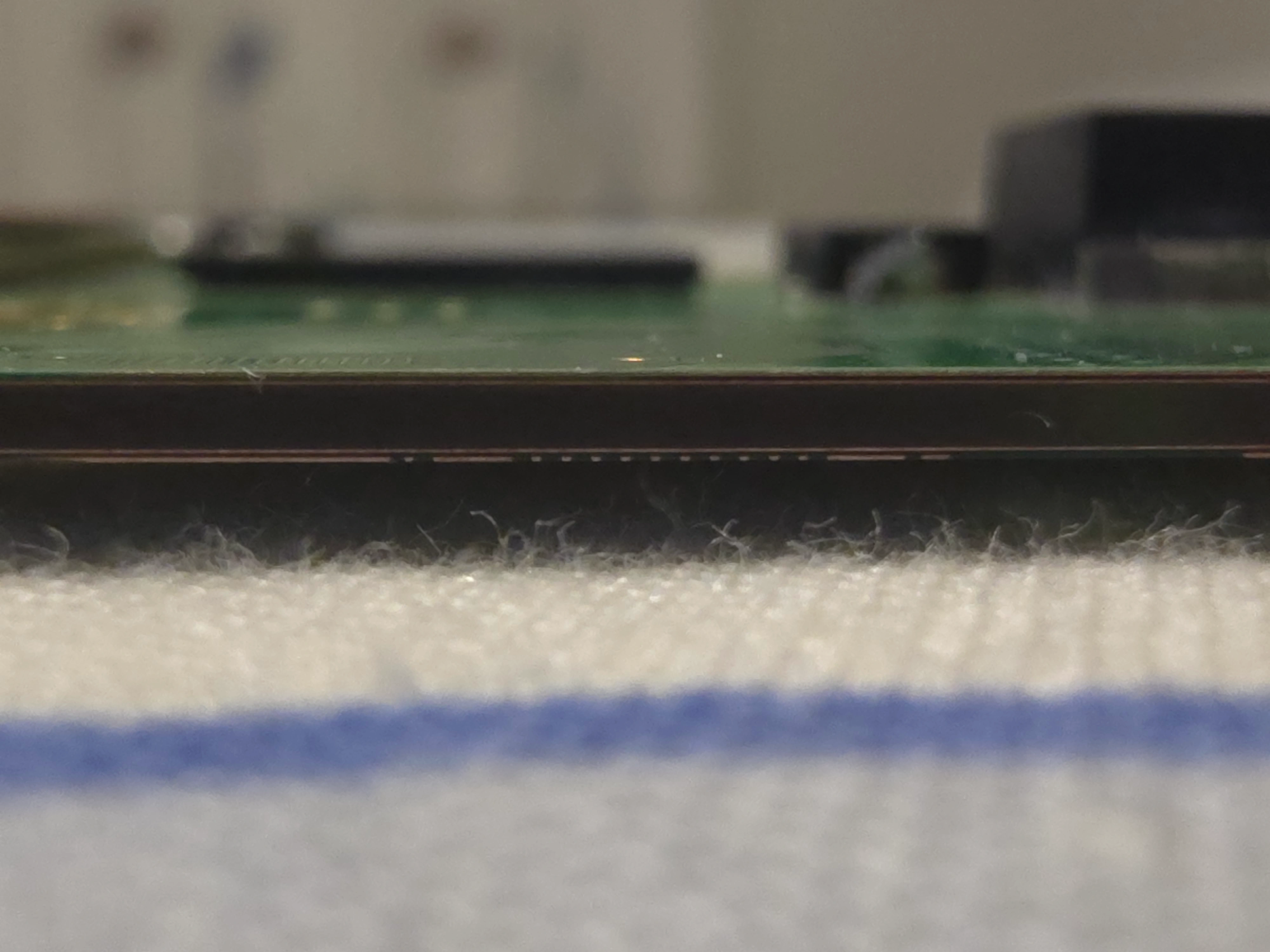

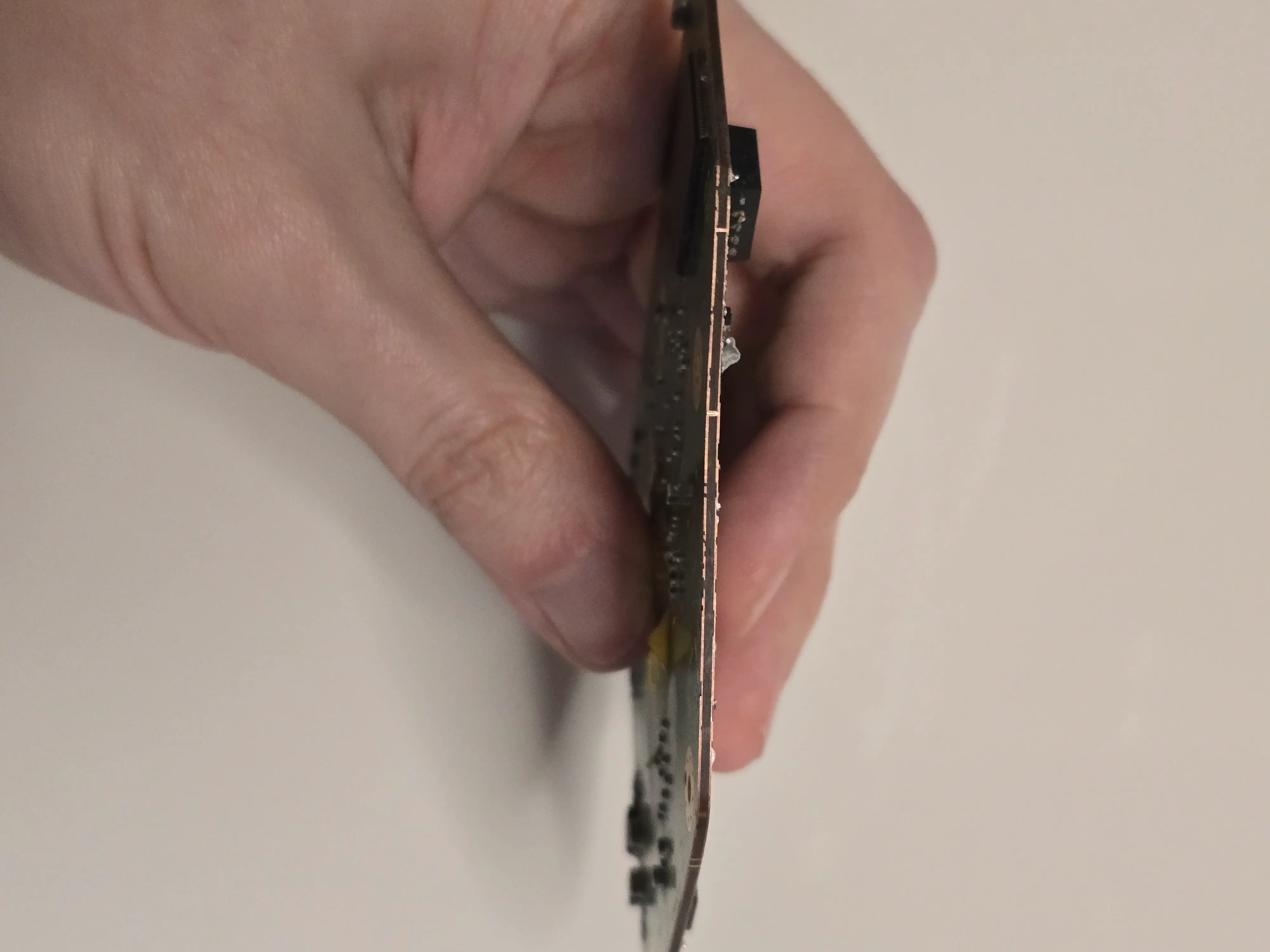

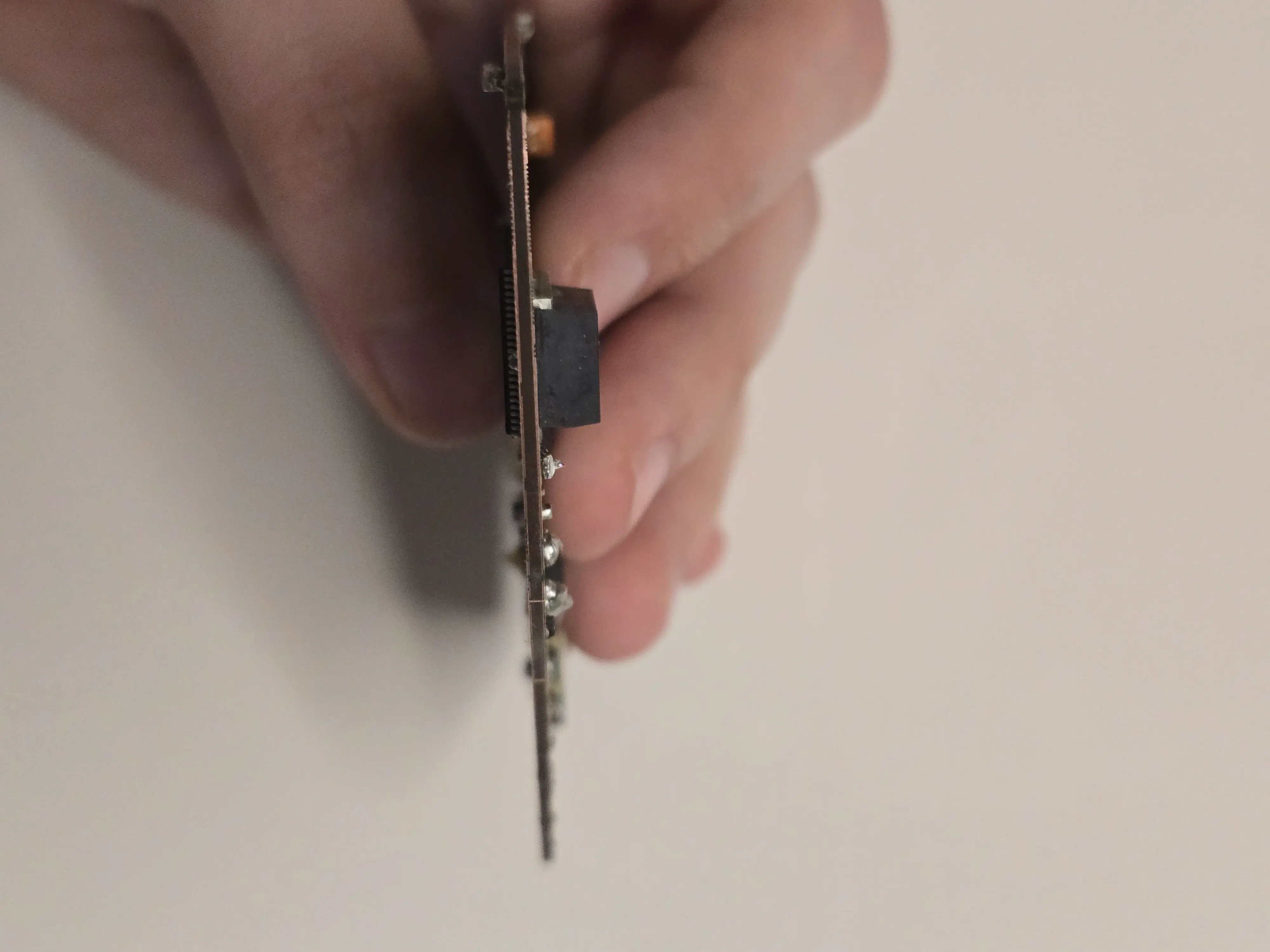

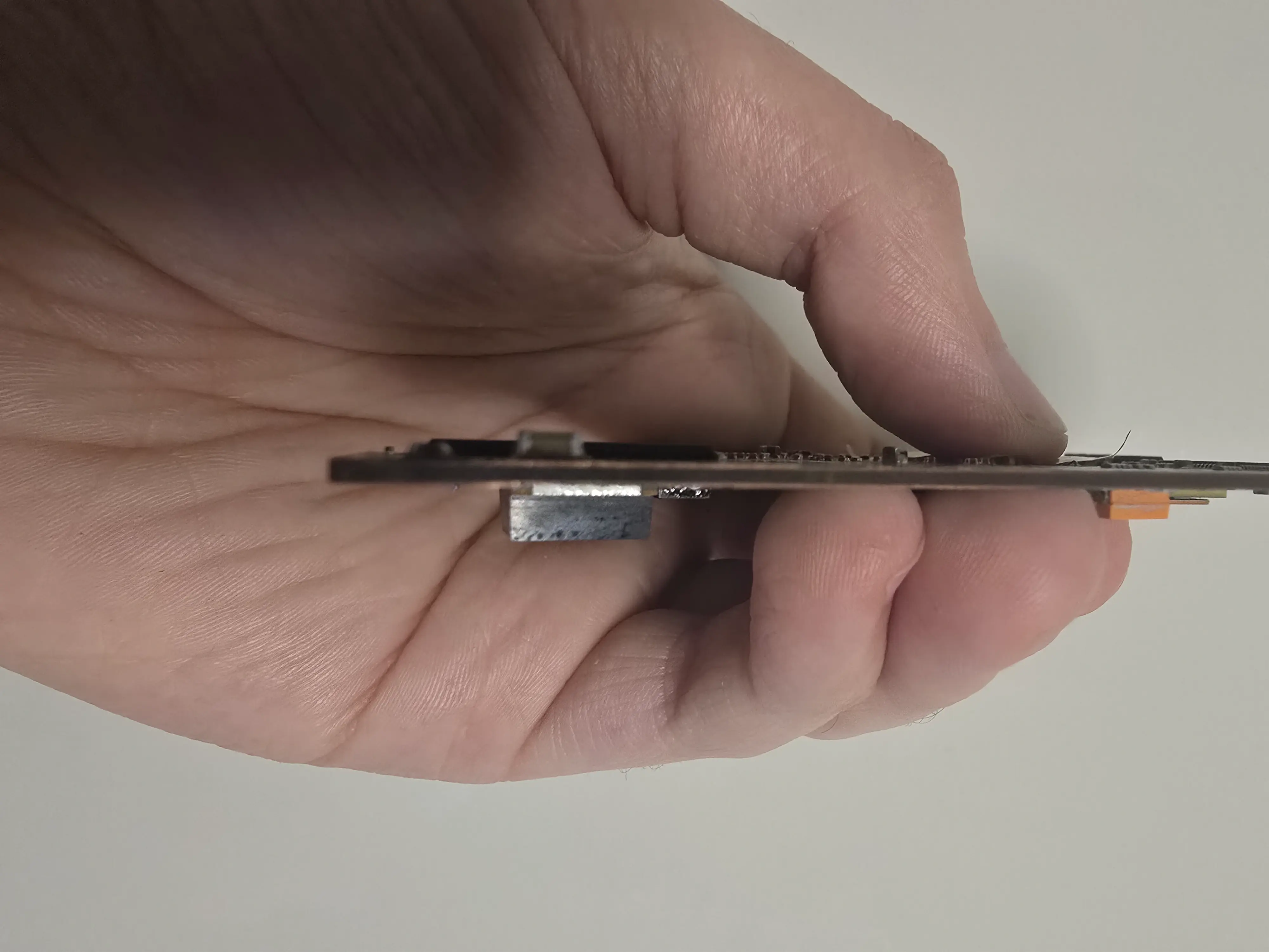

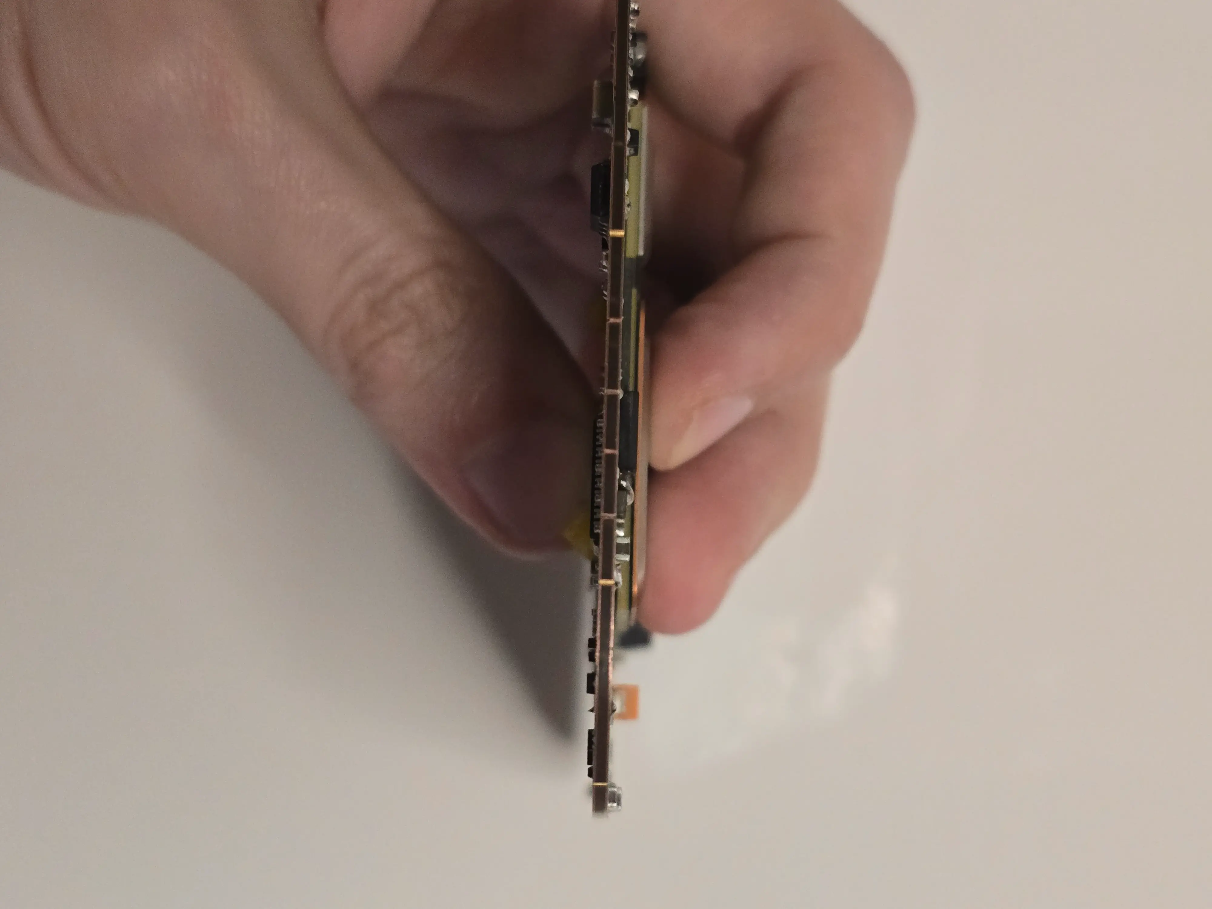

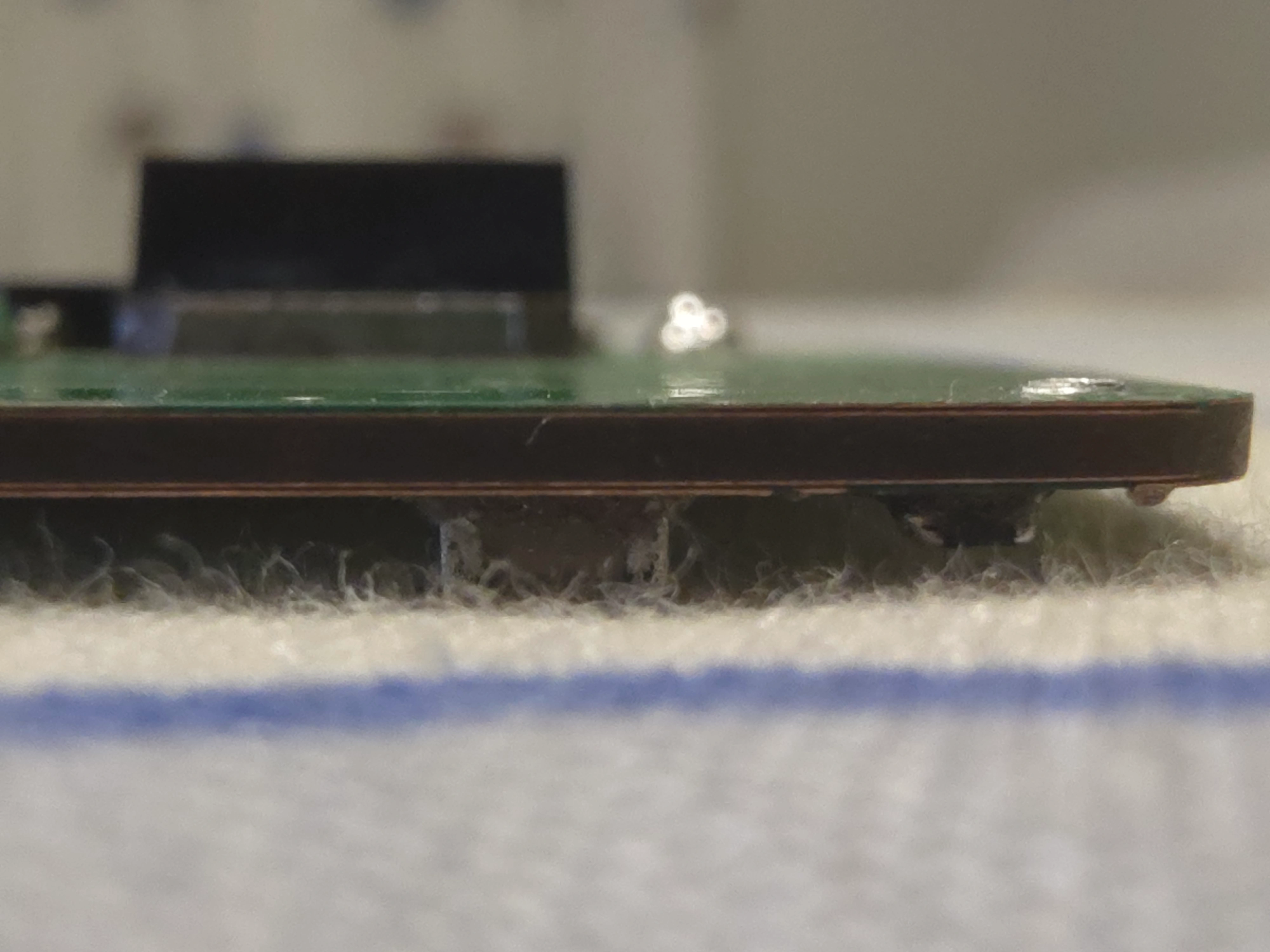

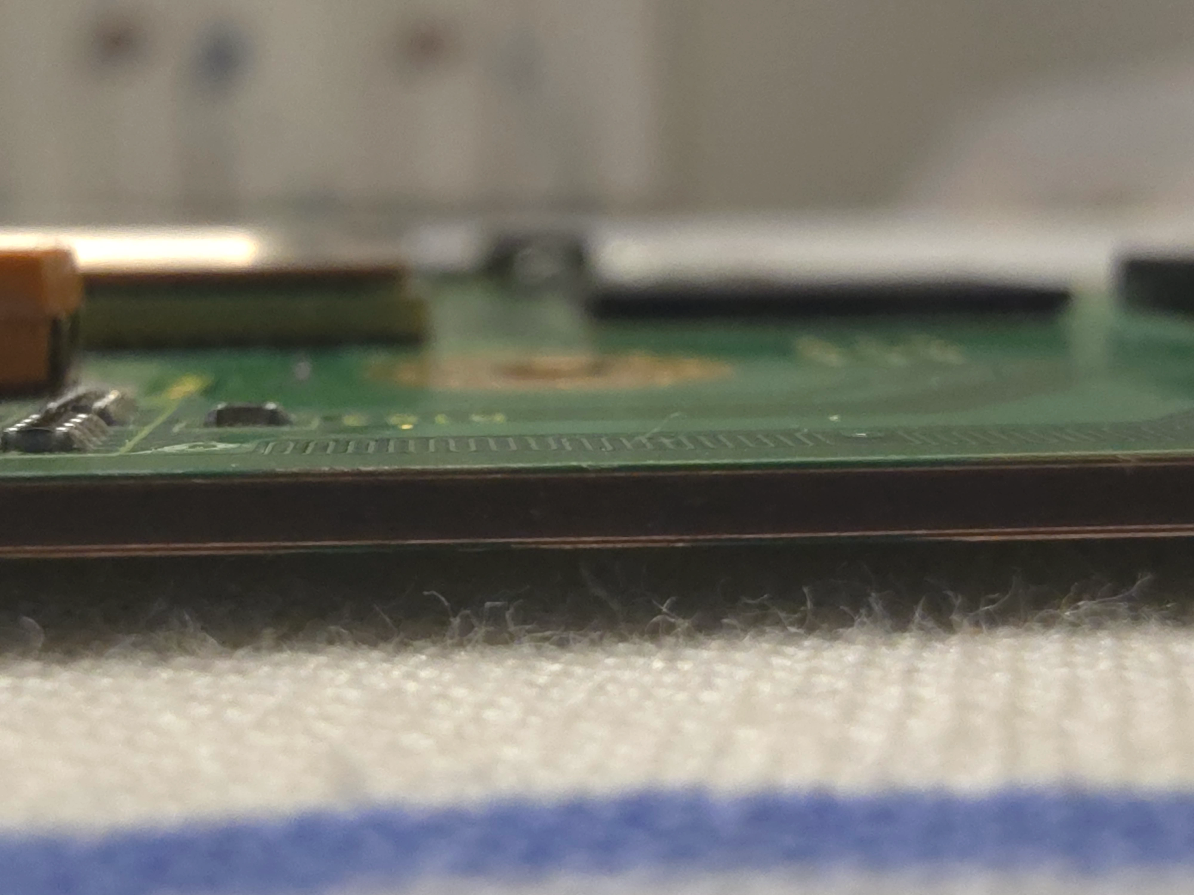

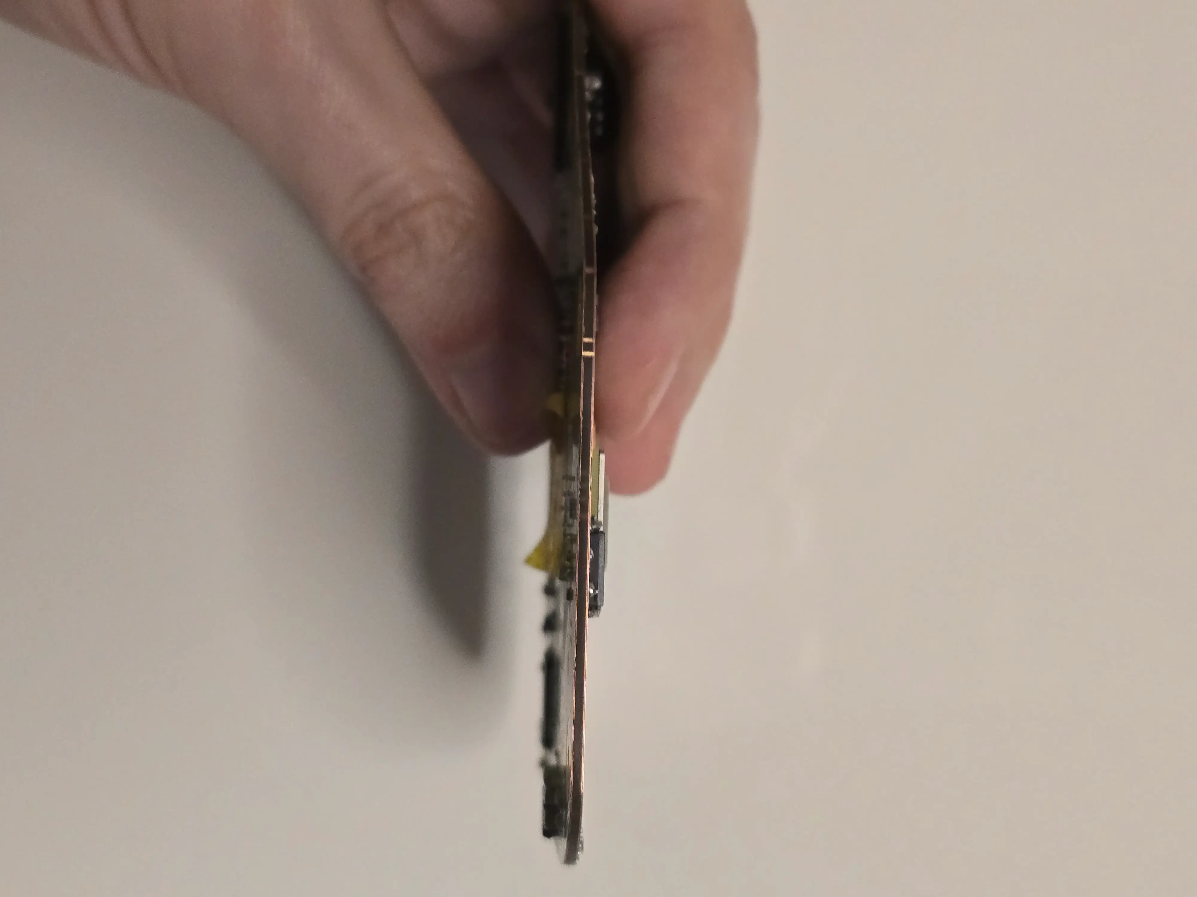

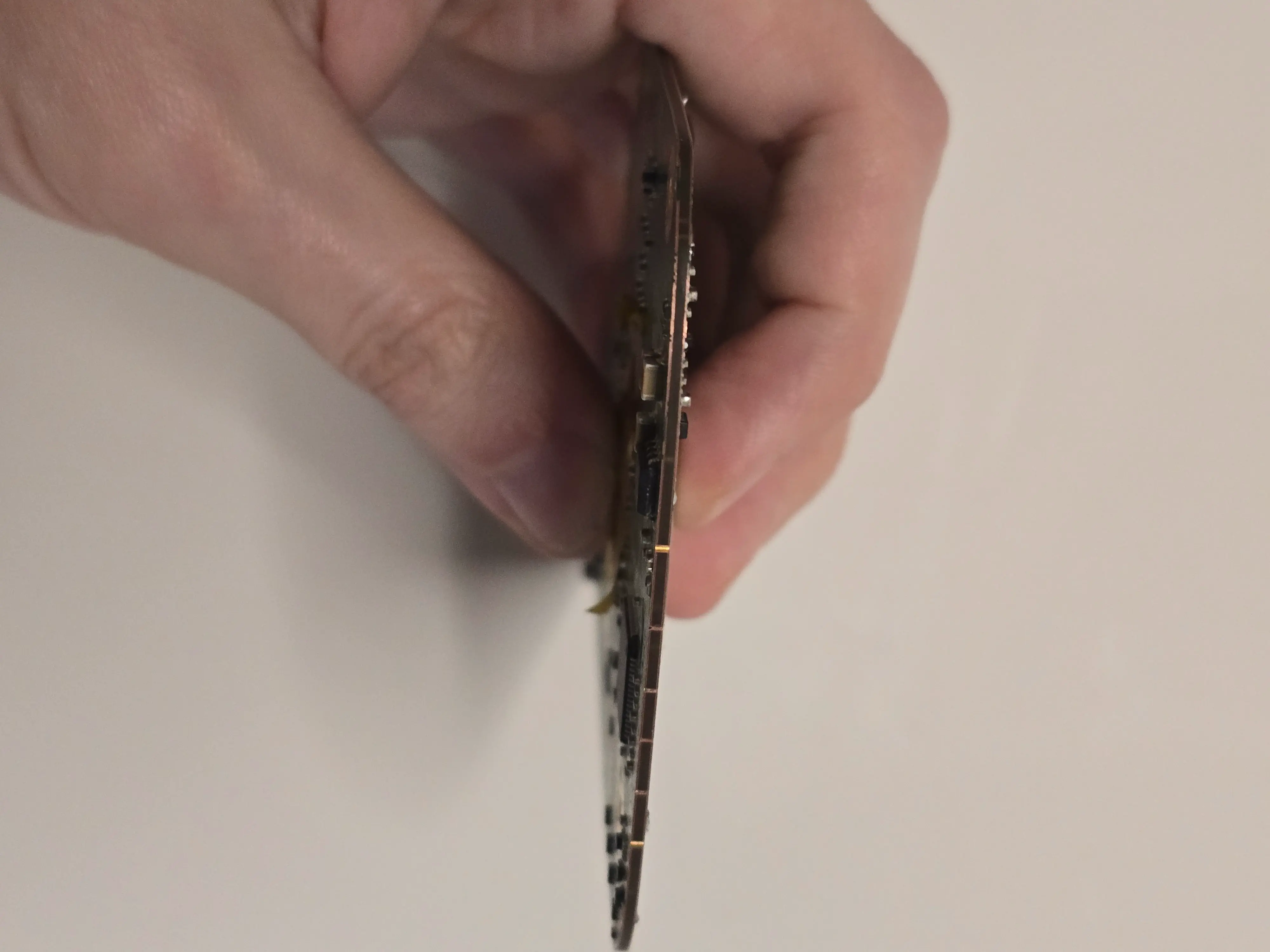

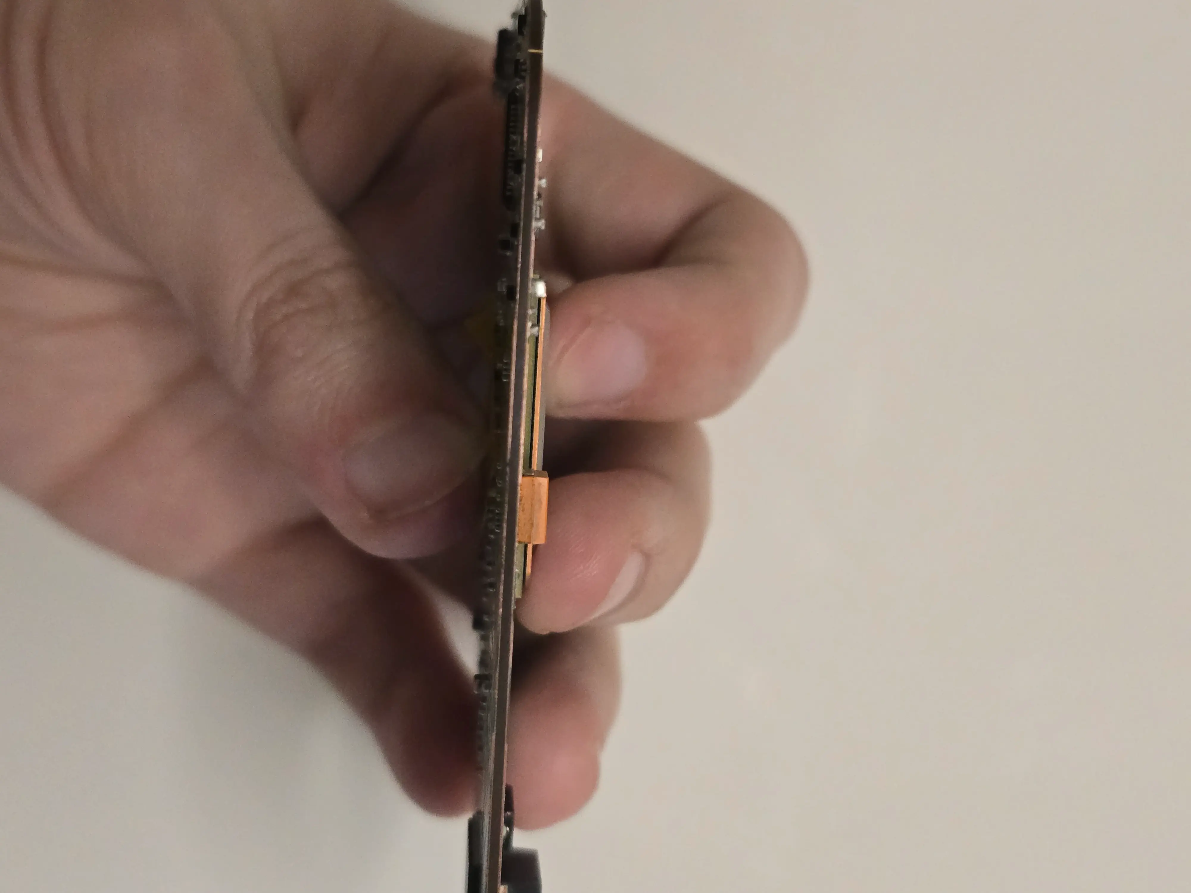

Some pictures of my hand with a wii inside them. For people who want to check if my trim is ok

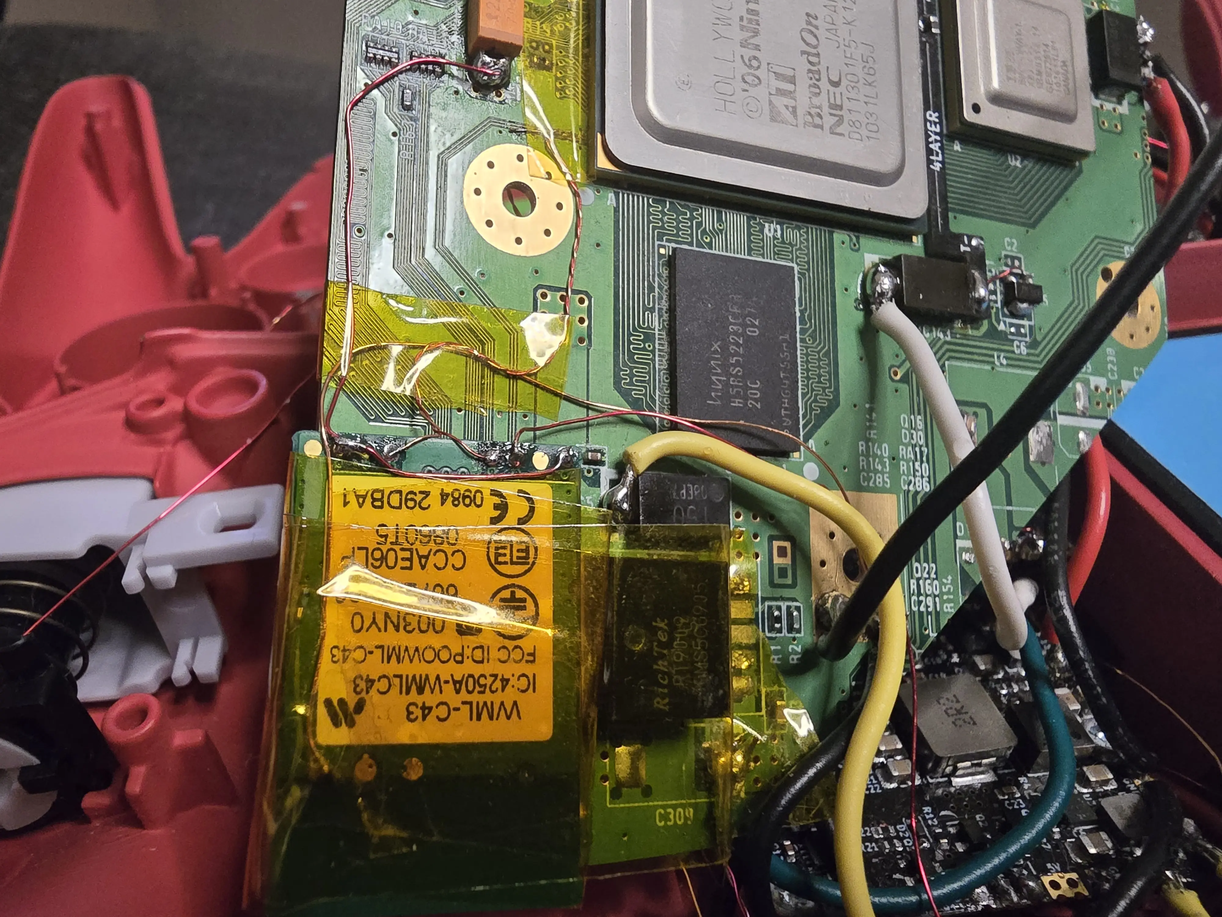

If things are going the way they've been for the last few weeks, then this is probably one of the last posts.
I'm getting so sick of this russian roulette game where the wii selfdestructs for no reason and I have no idea how to get proper feedback or guides to help me and others.
Lots of people have similar issues, yet there is no proper guide that's up to date or helping you to get the up to date data.

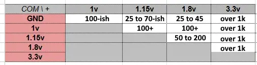

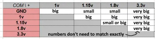

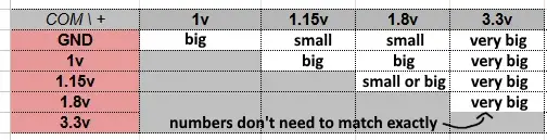

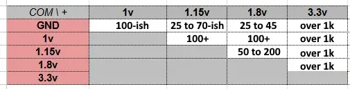

For the resistances being unexplained, we only answer the questions that are put to us. Basically no-one ever asks what the resistances mean or how they can know if a reading is good without needing to come back and ask about it. We just get asked "Is this okay?" and we answer yes or no, and point to possible causes of issues if any are present. Very rarely do we get asked to explain the methodology of this process or why we suggest specific troubleshootings, 95% of users are single project heads that just want a build to work and then we never see them again unless something breaks. The resistance values for the voltage chart are fluid, and will vary significantly in the exact ohm readings from Wii to Wii. Tiny differences in the PCB's copper density, the margin of error in the capacitors and resistors used in that particular unit, the quality of silicon used in that unit's chips, and the exact trim dimensions all result in differing values. When we say "that looks fine" to a resistance chart, it means we've checked the values against the minimum non-short values and known good pattern.
Expected value range:
Pattern for eyeballing:
If in doubt, you can always ask us to explain why we need a specific bit of info, or what the troubleshooting step actually means, and we will answer. We're not trying to ignore you, we just don't always have time to read and write out detailed replies to every post. Especially at this time of year. The holidays are a terrible time to start a build and get support, we're all on holiday and such.

And the specific expected and pattern charts are 2 I haven't seen yet.

But now to the steps of what I did after the trim. (Let's make it litterally right after the trim step by step)
-cleaned the wii from dust with ipa
-checked the resistances (expecting them to be way too small)
-sanding with 80 grit, some parts more than others to remove some stuff I was afraid to trim off
-checking resistances again (they were already good at this point)
-continue sanding with 120, 240, 400 and 600 grit (about double the time that ginger did in his trimming vod)
-checking resistances again (same as with 80 grit)
-Connecting power and av port to test it
-after the test I attached the sd data cable and t-
- tested these (t- did nothing I assumed it was bc the scw and sdw weren't connected yet)
- tested the controls (forgot start and added it later).
-tried to boot a wii game and a gc game (wii game didn't work probably bc of the cios)

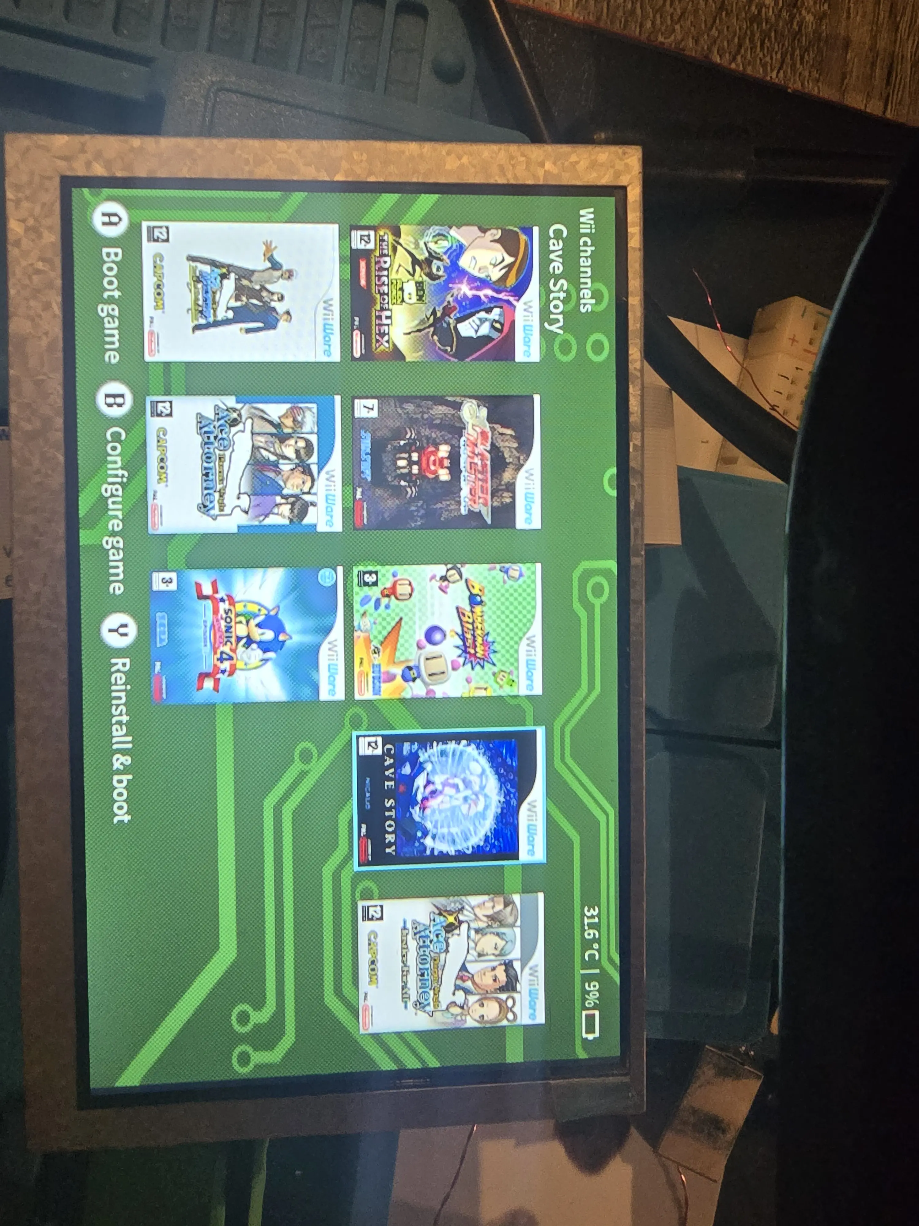

- attached bluetooth and tried to go to the wii menu, opening a wii game
-learned about the cios thing
-went to look for MMM (got recommended by yveltal), noticed that it's official page and only a post of 2010 existed about it. (So I went to see what I could do and what was accessible)
-reinstalled rvloader (since it was suggested that it might fix the wii games issue) and made sure the settings were ok (vga and wifi patch on yes)
- opened the homebrew channel trying to open wadmanager and bootmii (noticed homebrewchannel was upside down)
I had wadmanager added to add some wiiware games to the main menu since not all games played nicely with my first wii and I noticed that they played perfectly via the main menu. (Didn't do anything with it on this one and couldn't use it with the gc2 controls)
-Couldn't launch bootmii from priiloader (also couldn't change any priiloader settings like making the wii region free, wanted to see if anything there could help me) and had some trouble pressing start.
-resoldering the start and gnd (for start) wires.
- Put MMM on the sd card and went to the ashida and noticed the blackscreen
-went to see what happened and if some wires broke.
-at first everything seemed fine so I tested again and then I noticed that a speaker leg came loose, resoldered it (speaker cables aren't connected yet)
- then after trying again the bracket for the t- came loose. (Gotta admit that the connection done a bit quickly)
-after re-adding it and noticing that it didn't fix anything I started removing everything piece by piece to see if it would solve my issue.
-at the end when only the power and av cables were connected I measured the resistamces again. I believe only 3v3 changed noticably, still above 1K, but still lower then without the cables.
- checked voltage of the U9 I relocated before the trim (3.2xxV came out of the extra pin and that pin still was disconnected with the ground)
-then I stopped testing and completely removed the board.
-cleaned all flux/solder dirt, sanded an edge of the wii that didn't look clean anymore (the 45 deg line) for some reason it looked gray. Could've been me but extra sanding that side couldn't hurt it.
And now it's still disassembled I even removed the power cables going to the controllerboard from the pms. (They were pretty annoying to drag along all the time)
I wanna test it out again tomorrow but I don't expect anything to change, knowing that it probably died to cios or the temptation of the wii to kill itself when testing.
Every test just feels like I'm playing the pop pirate game and a wire could pop out.
But now knowing that norma tests don't need the wii heatshield, that feeling end experience might lessen.

Well you're certainly not crazy, you did everything correctly up until you attempted to install additional CIOS. RVLoader uses specific modified versions of essential opensource homebrew and has a custom framework that handles everything that you would normally use traditional CIOS for, so installing additonal CIOS can and will brick the system, especially if you touch Priiloader or BootMii. We had a support thread recently where a guy thought he needed to update Priiloader and it broke his system. In his case we were able to help him recover it because his board still booted to an error message. Your current trim may be beyond saving if you can't get any display with composite after the deep clean, but Wiis have resurrected themselves from worse states before. Was the CIOS that you installed to get VGA/bt emulation to work on the system menu?
I'll itemise the remainder of your questions/observations for readability:
  • I'm not sure if the thermistor reading needs I2C to be hooked up to work, it's not mentioned in the documentation, but I wouldn't be surprised if it did.
  • Homebrew Channel being upside down is normal, it's a thing the devs did to encourage people to stop modifying a certain IOS module after advances were made to make that risky method redundant. RVLoader modifies that IOS module for one of the hardware patches, wifi or bt emulation I think, so if RVLoader is properly installed then the HBC will be upside down.
  • RVLoader does support Wiiware and VC titles now via the wad folder on the USB/SD card, but yeah there are some that do not work correctly yet and the specific USB or SD card that you're using can cause compatibility problems if they aren't genuine. If you post a list of the titles that don't work properly in the RVLoader thread, Aurelio will add them to the testing list when he has time.
  • 3.3v's resistance changes a lot based on what's connected to the system, so the change when your other wires were removed is normal.
  • 3.2v from the U9/U10 output leg is an acceptable drop. Anything above 3v is sufficient I believe.
  • A deep clean is a good idea, and always the first thing that I personally suggest when encountering a boot failure issue. There's a lot of conductive debris that can get stuck in flux residue and cause just enough of a short to mess with the system logic, but not enough to show up on a multimeter.
You know the core process well now. Worst comes to worst, one more trim and you'll have a functional system.

"I'm not sure if the thermistor reading needs I2C to be hooked up to work, it's not mentioned in the documentation, but I wouldn't be surprised if it did."
I think I did it before and only got it to work once I hooked up the flex cable with I2C and maybe someone on discord told me it was also required.
Still not sure, but I think it's more likely that it is required imo.
Yh I don't know what I'm gonna do now tbh, either I'll play it safe and just try to keep it with the GC controls, or I'll take the risk and install bluetooth again (probably not a risk, but it still feels like one to me)
The sandpaper set of 600+ grit arrived (next day deliveries are such a blessing) but I honestly can't see the difference after using them.
I'll know better when the loupe arrives, but if everything goes as planned, then I shouldn't even need it.

Progressively increasing the sanding grit is mainly just to provide a foolproof way of ensuring that no copper foil from the inner layers can flake up and touch the GND plane. I've had trims that worked perfectly with only 400 grit sanding. So far the best technique for it is to put the paper on a flat table and run the trim in a sort of figure 8 motion on the paper to get nice flat edges. It's the little dips and inside corners that usually cause problems, so if you sand well, graduate up to 600 grit, and the sanded edges feel smooth to your finger, then you've done well. Personally I use a cheap magnifying glass that I got from a news agent to inspect the edges in detail. Much easier than trying to get a phone camera to focus.

Also found a way to get better pictures with my phone.

I still haven't trimmed the last(4th) wii (took some time to do some other stuff)
But I've tried wiiware and virtual console titles. Virtual console works perfectly, but wii ware doesn't want to boot at all. (screen signal goes through, but it's just black).
This is for all wiiware games outside of cave story.
I've had this issue with all my wii's and I did solve it with the first one, I just can't remember how exactly. I remember selecting a different IOS in one of the settings, around the time of fixing it, but I'm not sure if that fixed it.
Any idea what might be the cause?

Bluetooth and wii games work!
F U CIOS.
I'm thinking that maybe 1 of the 2 broken ones might still work, but they might boot on the wii menu, cios breaking bluetooth + autoboot being reset to the wii menu, might've caused the black screen.

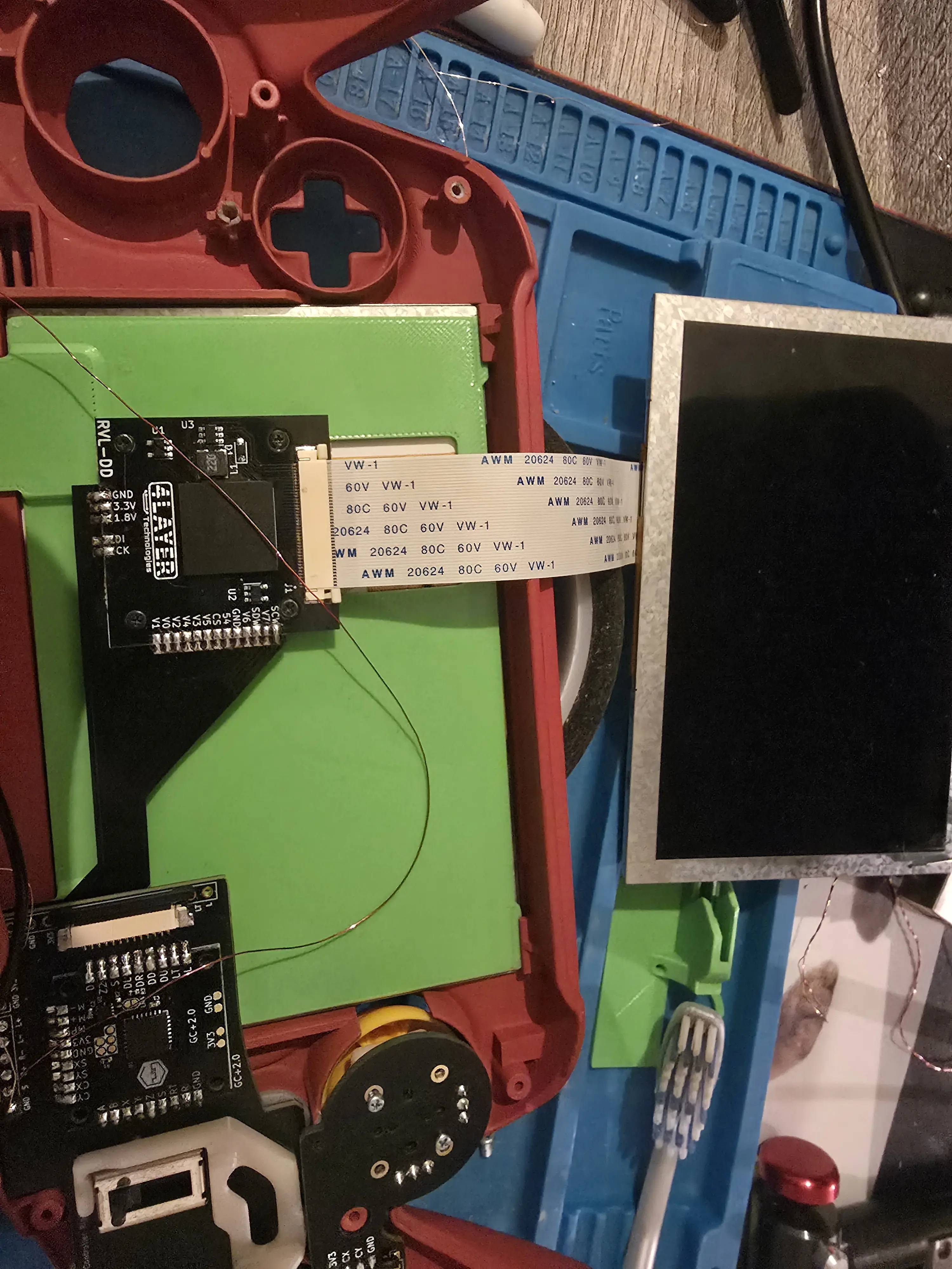

Bluetooth relocated now that it works.
also showing how I like to daisy chain, yes it's just 1 wire.
Used some tape to prevent contact to the 1.8v spot (wrapping the bluetooth layer in 2-3 layers of tape and then using another strap to stick it on the board)
"Broken" screen is working. So everyone who said the cut didn't destroy it was right.
Also using the extension cable from the raspberry pi project for easier testing. ( I already tested the controls with the last wii's and already know the buttons work since I had to use couple of them to boot a wii game for the bluetooth connection)
