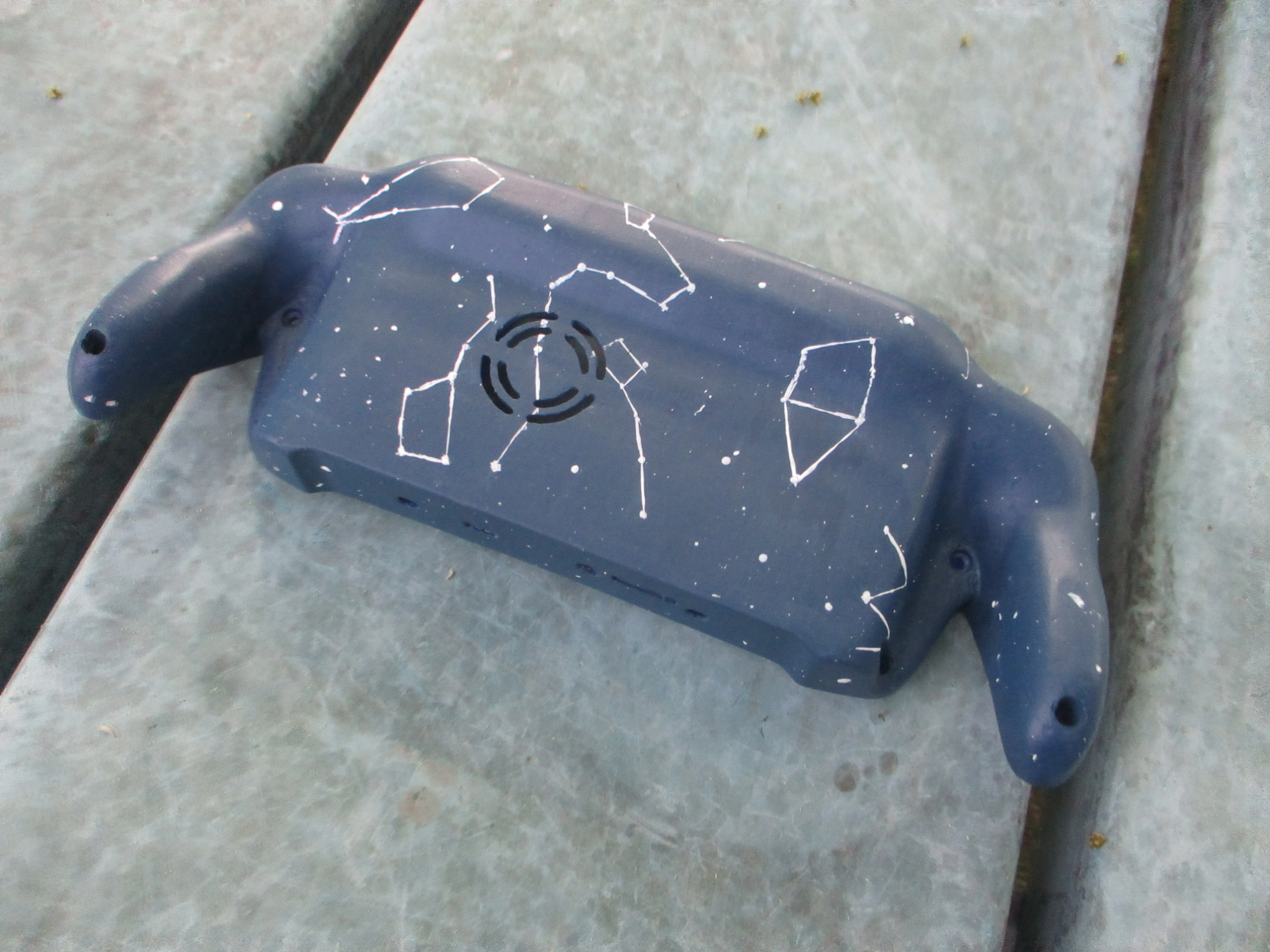

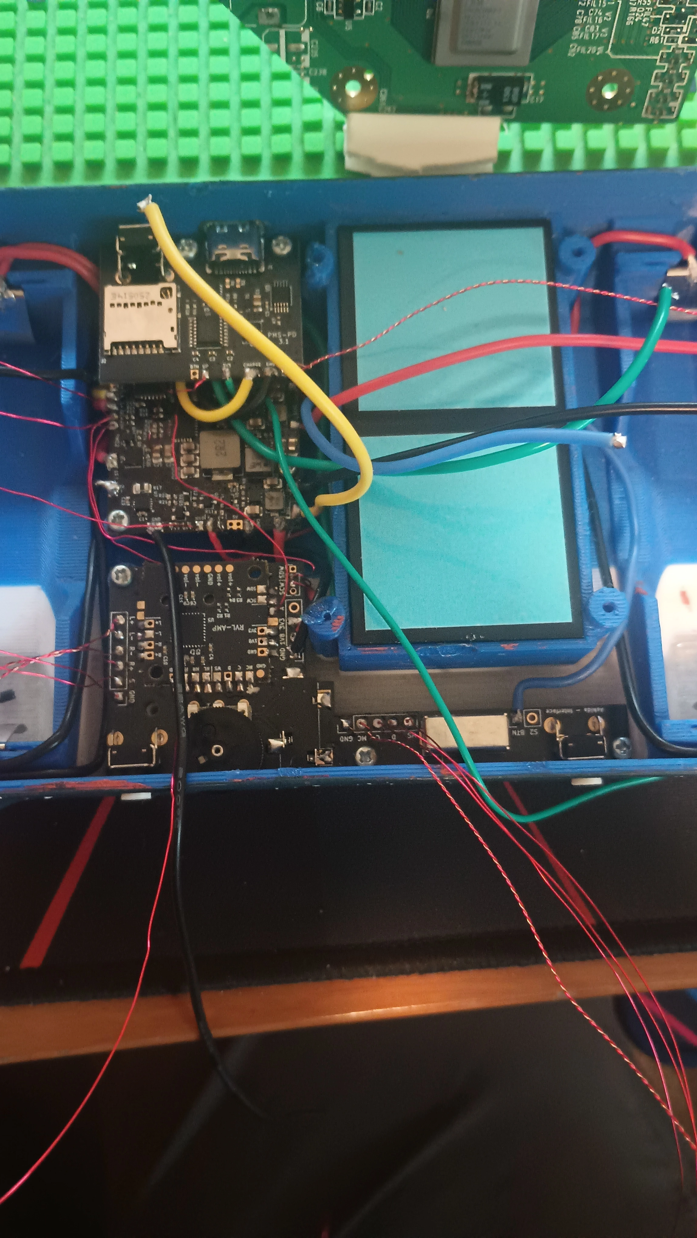

I have started on the PCB assembly and I have painted the shell dark blue and am getting ready to paint the constellations onto the back.
I finally got back around to working on the portable again and I painted the backside with constellations and just need to add a clear coat. I also painted on the front but I am not satisfied with how it looks so I am going to sand it down and repaint the front half.

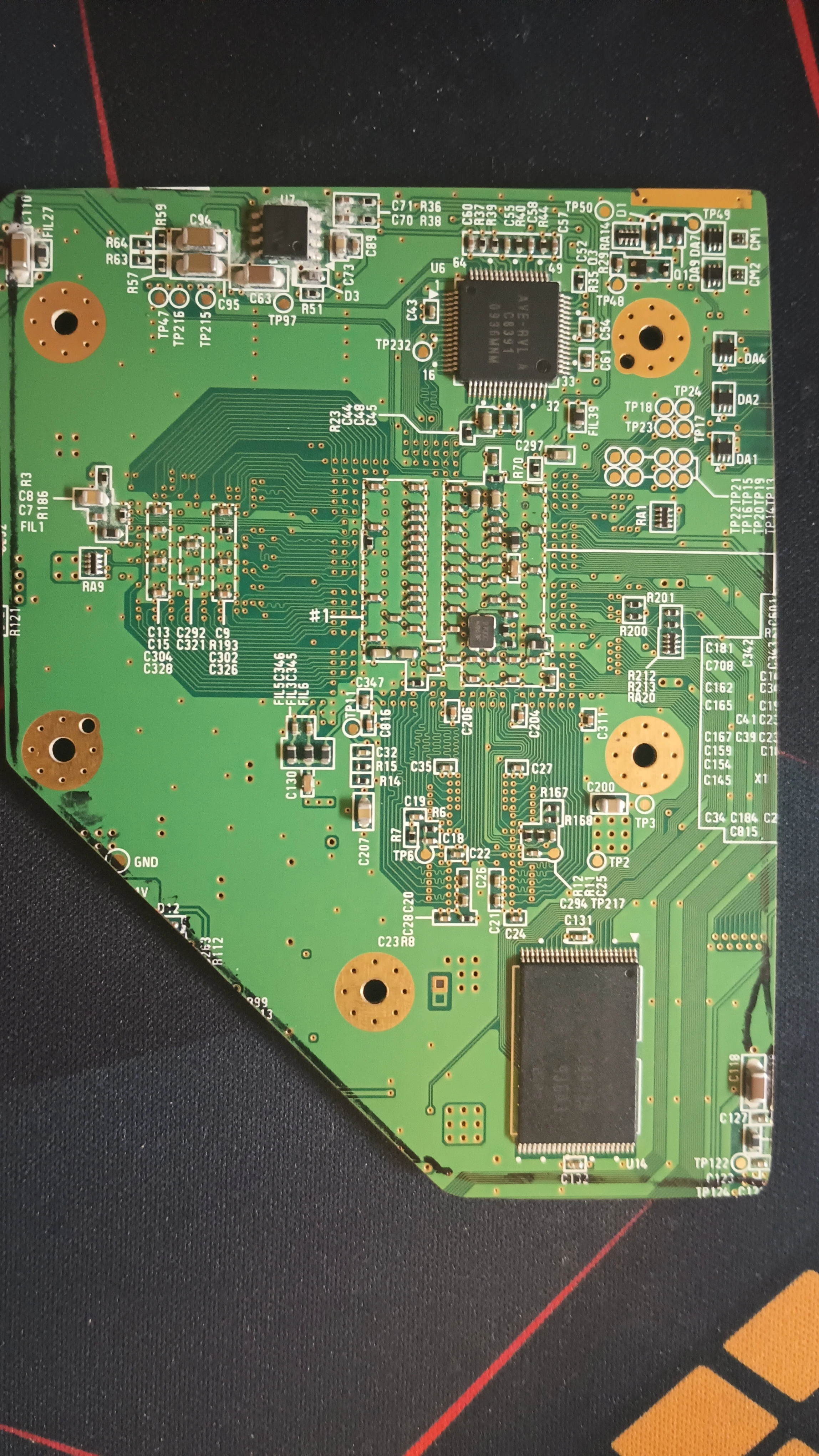

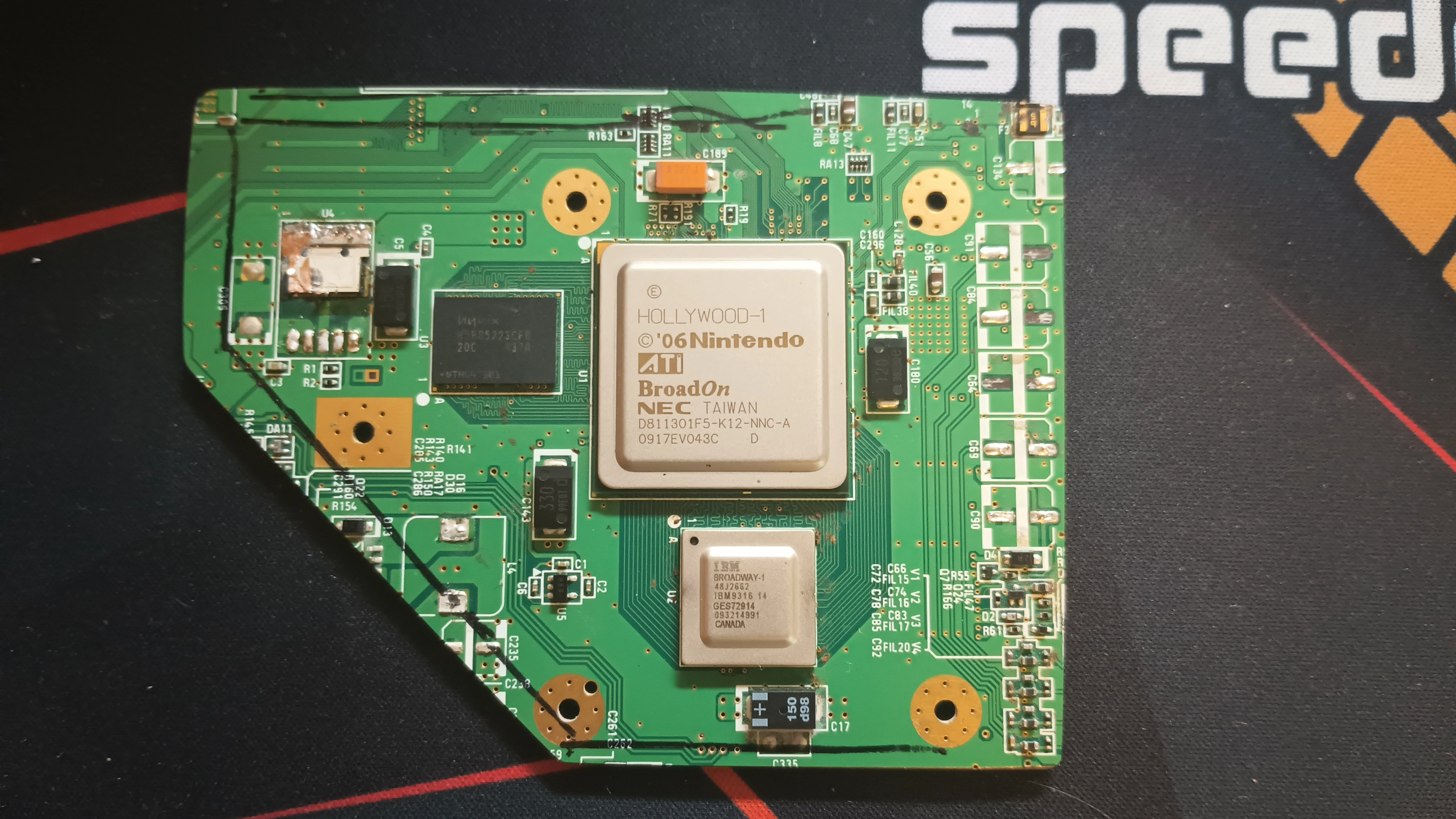

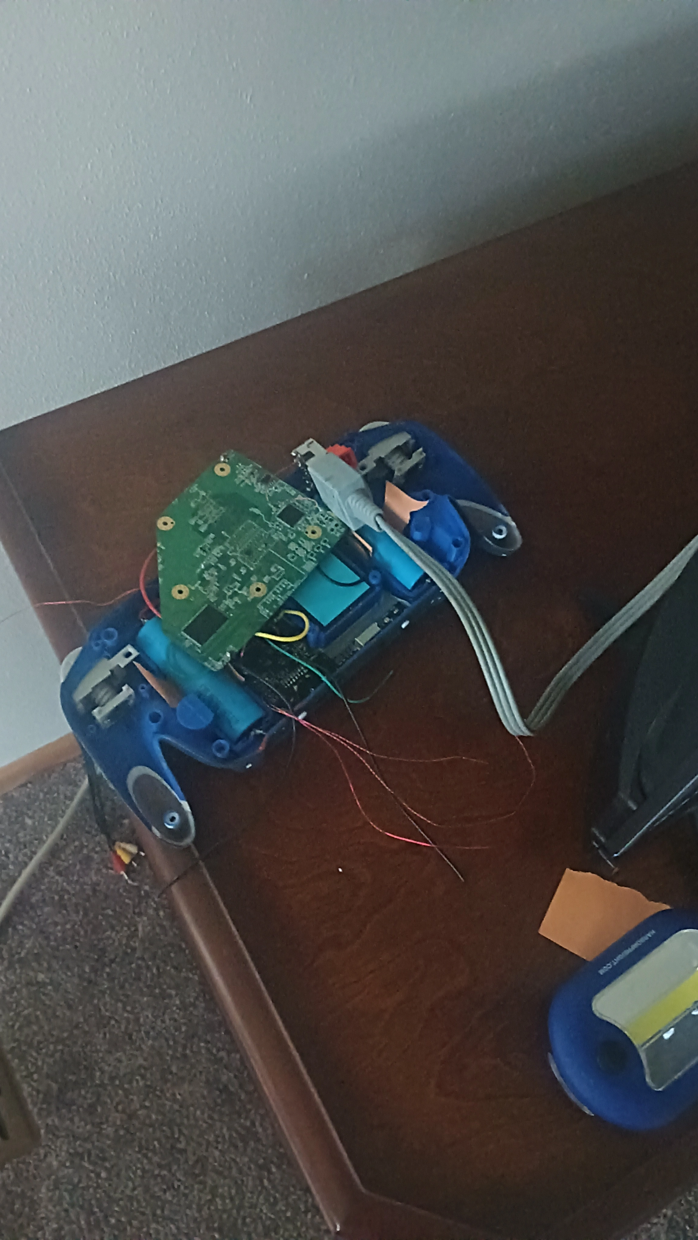

I finally got around to actually doing the motherboard trim for the wii and I am having trouble with it. As I was testing with the multimeter all of the voltage lines seem fine except for the 3.3v which registers absolutely nothing. I am not sure if I cut too far and ruined a component or knocked off a part. If anyone could help give me direction if my problem is fixable or if I need to find a new wii that would be very helpful.

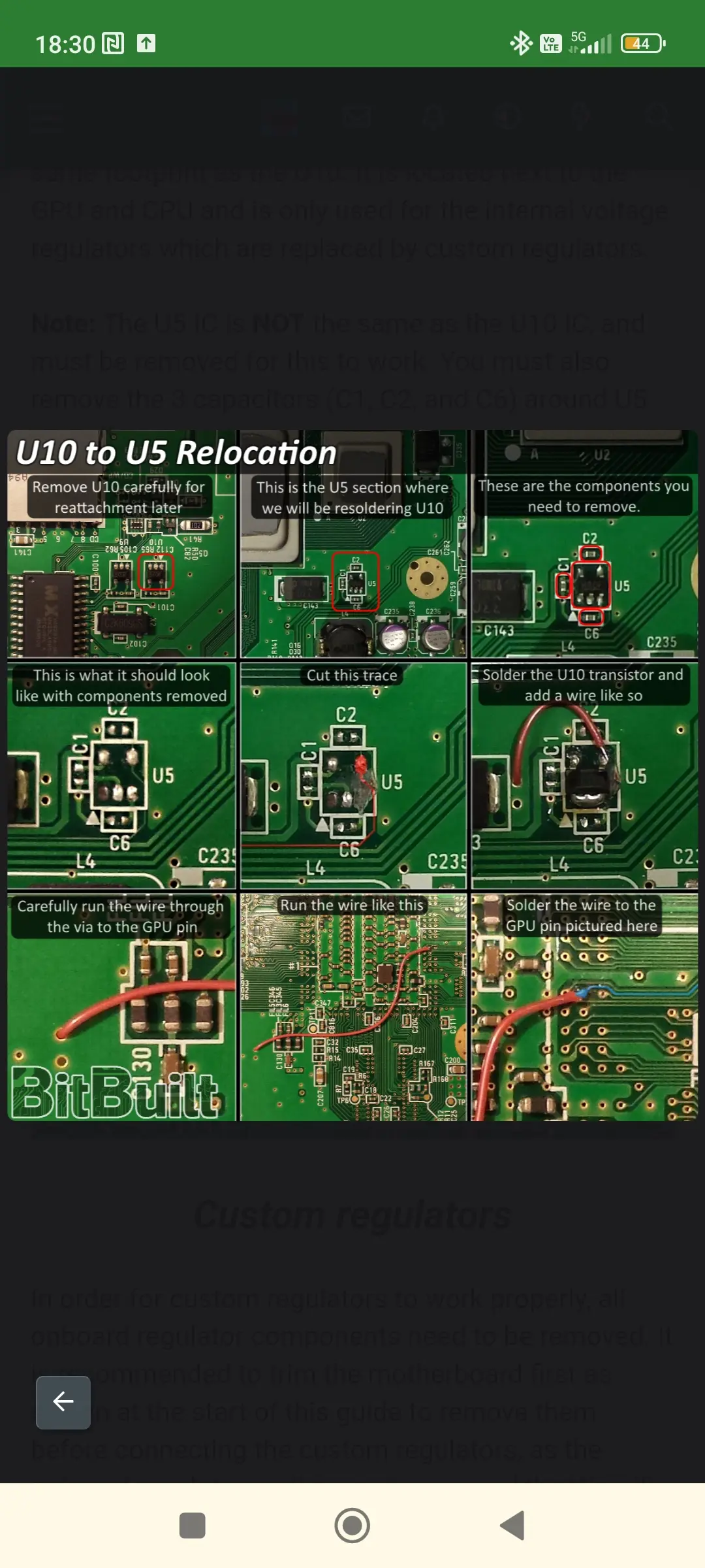

Nah, your wii looks good on the trimming part but you forgot to relocate the u10.
Here is how you Can Do
And also,for the future,I recommend you to get off the metal plate of the 1.8v regulator,I think it will help the future wiring.
Is the U10 relocation necessary if I am using the 4layer tech PMS 2? When I was watching Ginger of OZ's stream on wii trimming he said the relocation wasn't needed but you still have to run a wire to the U10 via from the PMS 2. If the trim looks good, what are some possible reasons the 3.3v lines would not have any resistances? And 1 last question what is the best way to get that metal plate for the 1.8v regulator if I don't have access to a hot air station?
Oh ok,that's will be good in that case.Well,for the resistance I don't really,I usually wire it anyway,and for the metal plate you can just put some soldier on the top of the 1.8v print,wait some Time and then you will feel that you can get it off,almost by itself,just as in butter :)
