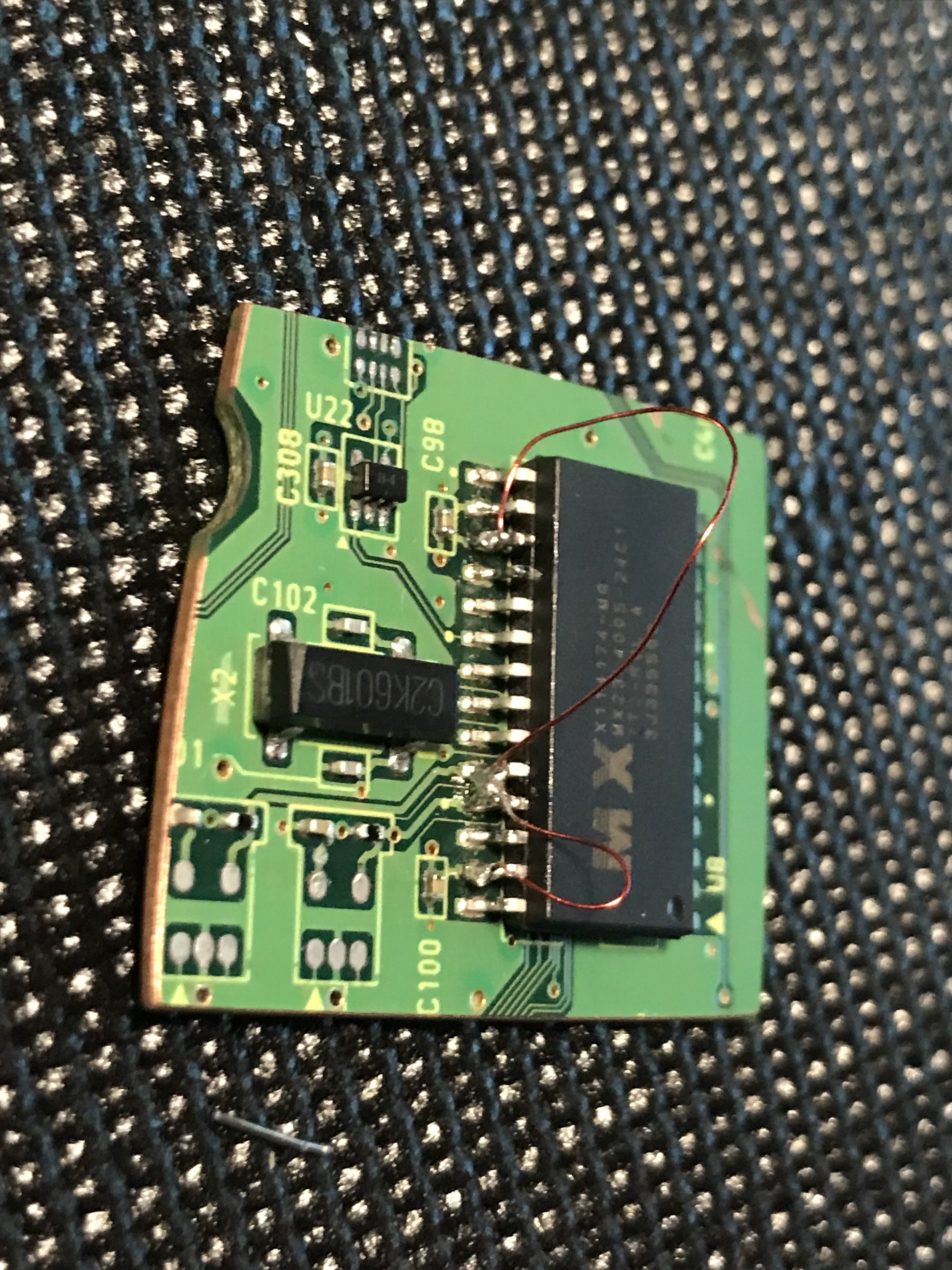

UPDATE:
I managed to rip up a trace on the PCB while removing an inductor. How f*cked am I?
That's a capacitor, and it's no biggie. It's not needed anyway. Just cut it where it is so it's hanging off.
You can still grab signal further back, so it's fine
