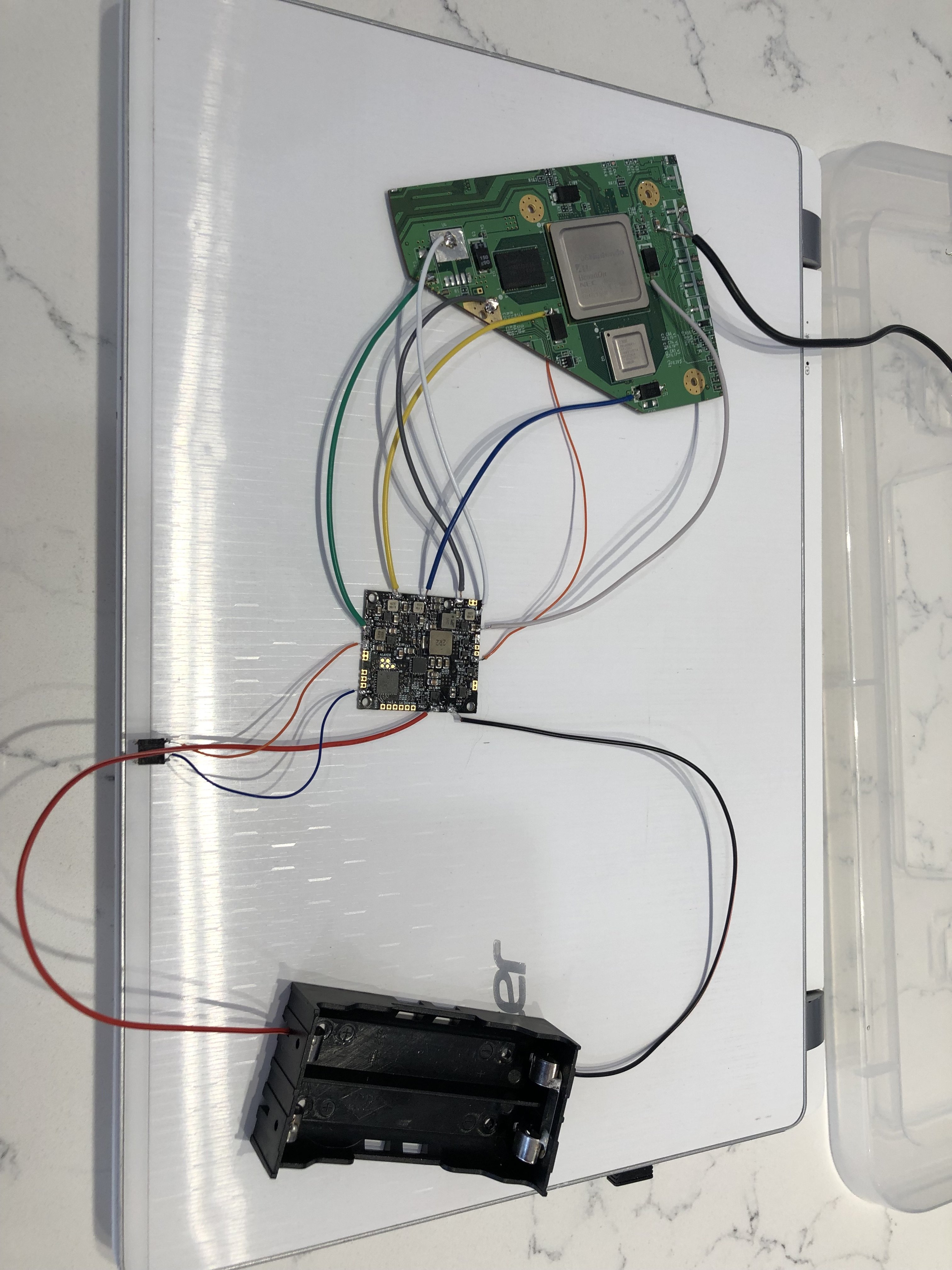

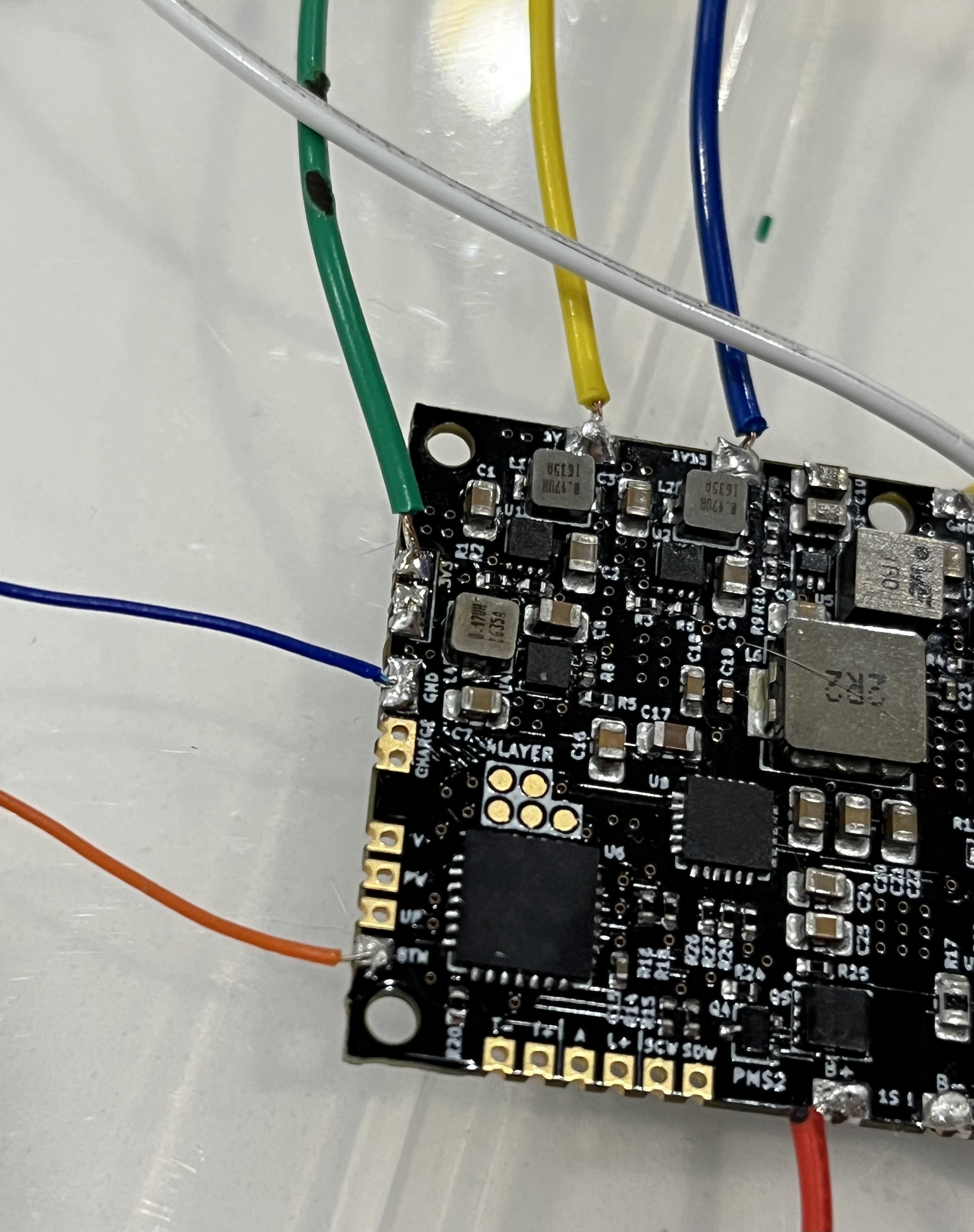

You could try larger gauge wires for better voltage delivery. Also make sure your battery voltage is 3.6-3.7 volts.
Good news, possibly!!
I swapped out the wires between the battery holder and the PMS and the fan spun with all voltage lines (and GND) connected!!

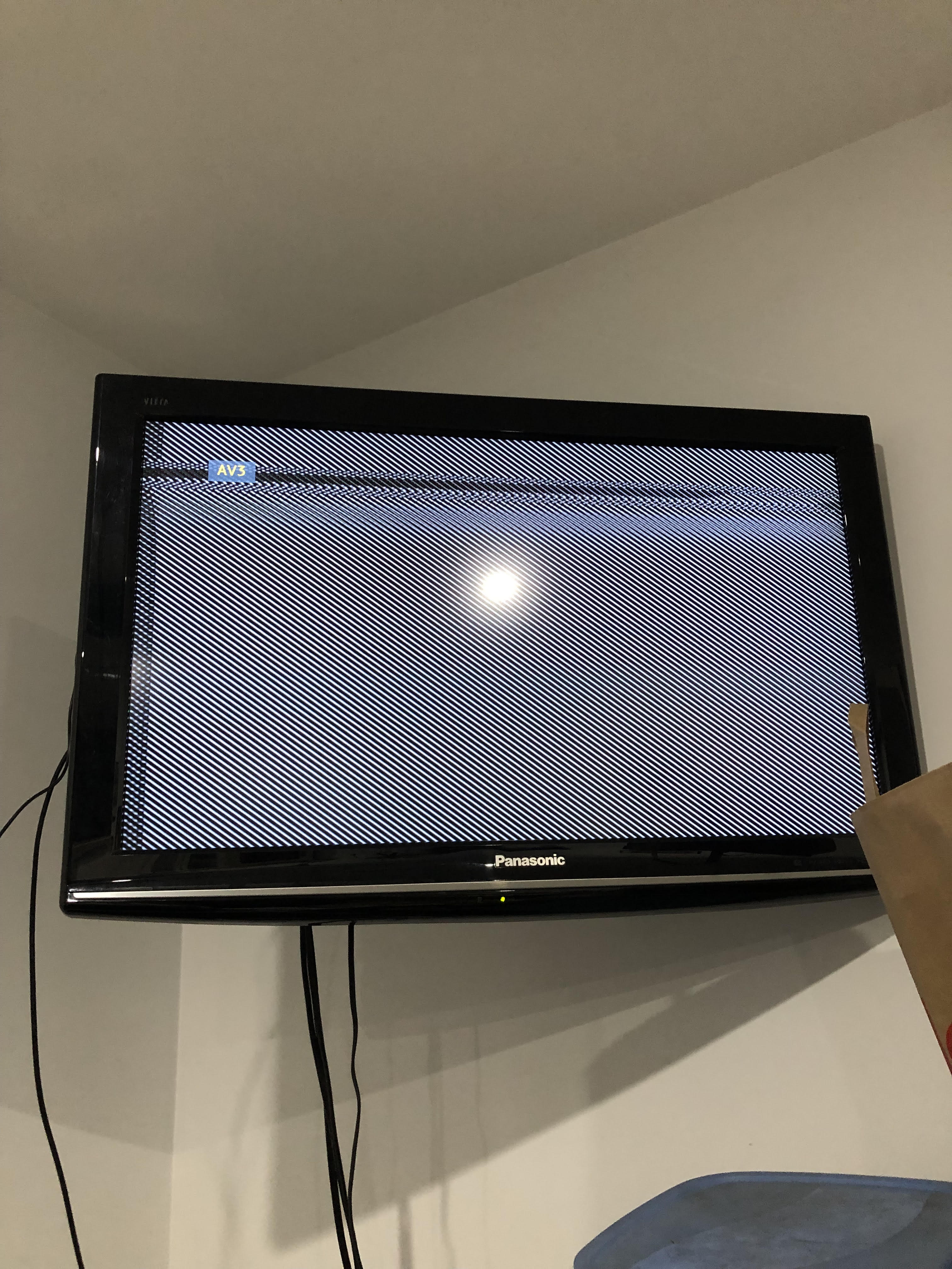

After hooking it to the TV, I didn't get the RVloader screen however, I got the attached image.
Any suggestions on this? Is it a dodgy hookup of the video lines?

Progress!!
That's a very interesting image on the screen. It's at least outputting.... Something...
How long is your AV cable? You're still using an RCA and composite video?

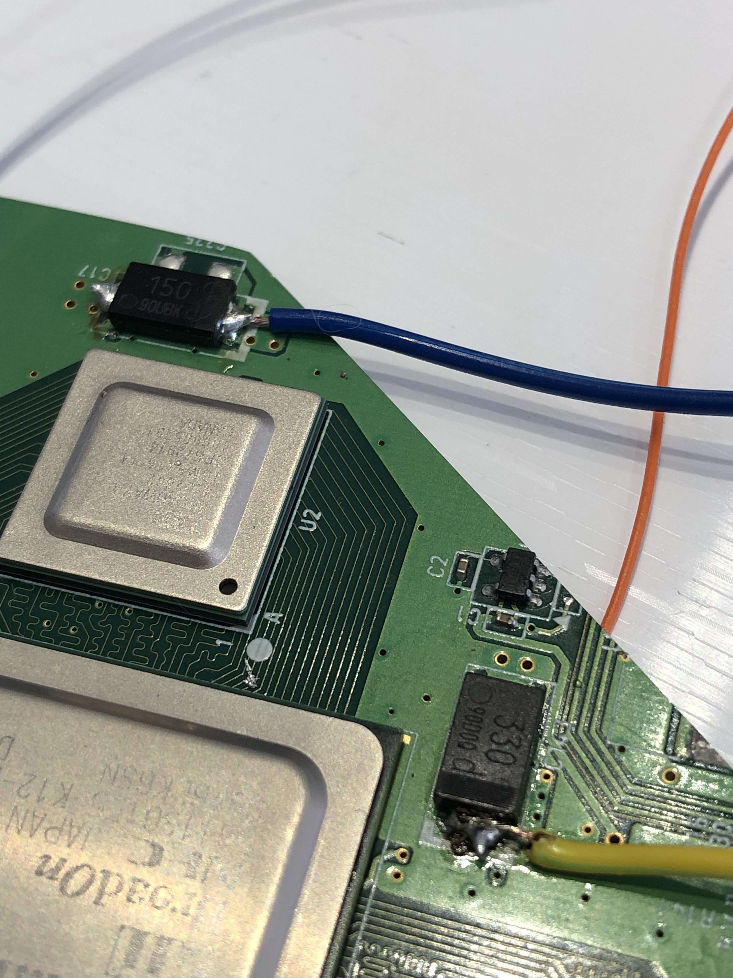

Thanks for the suggestion about the voltage lines. Looks like it helped for sure.

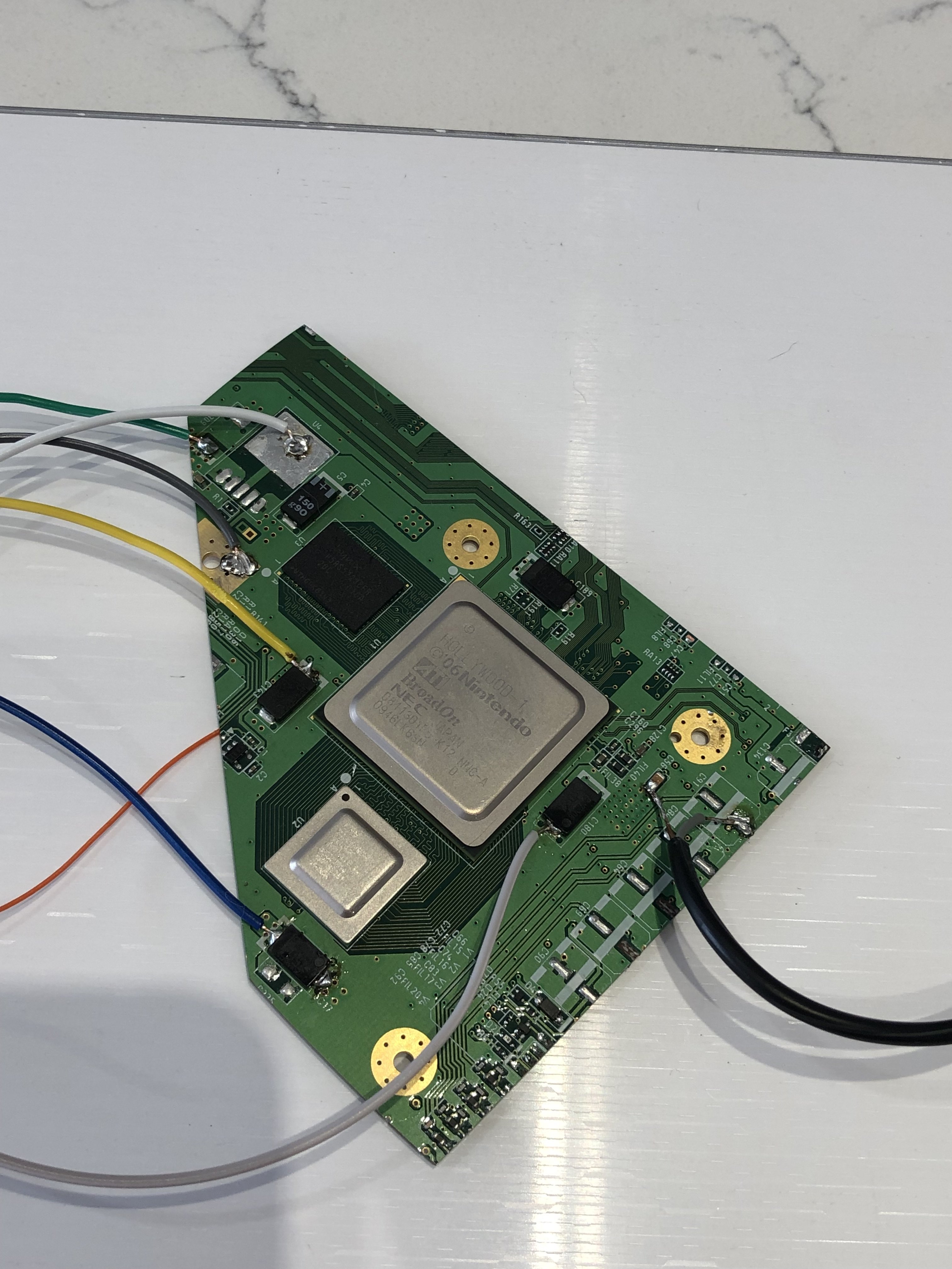

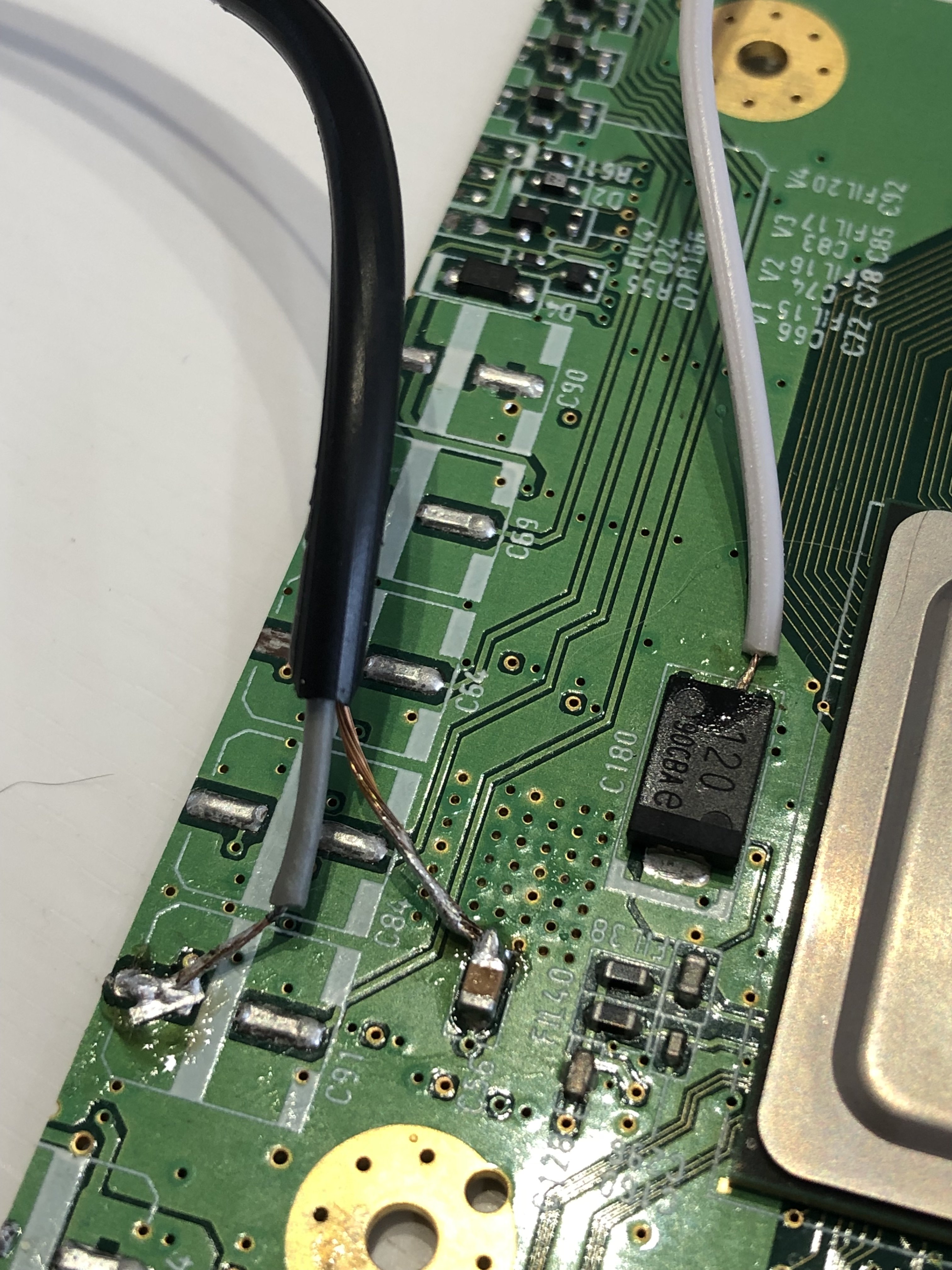

I am using a chopped RCA cable, its about 1m long, hooked up as in the image.

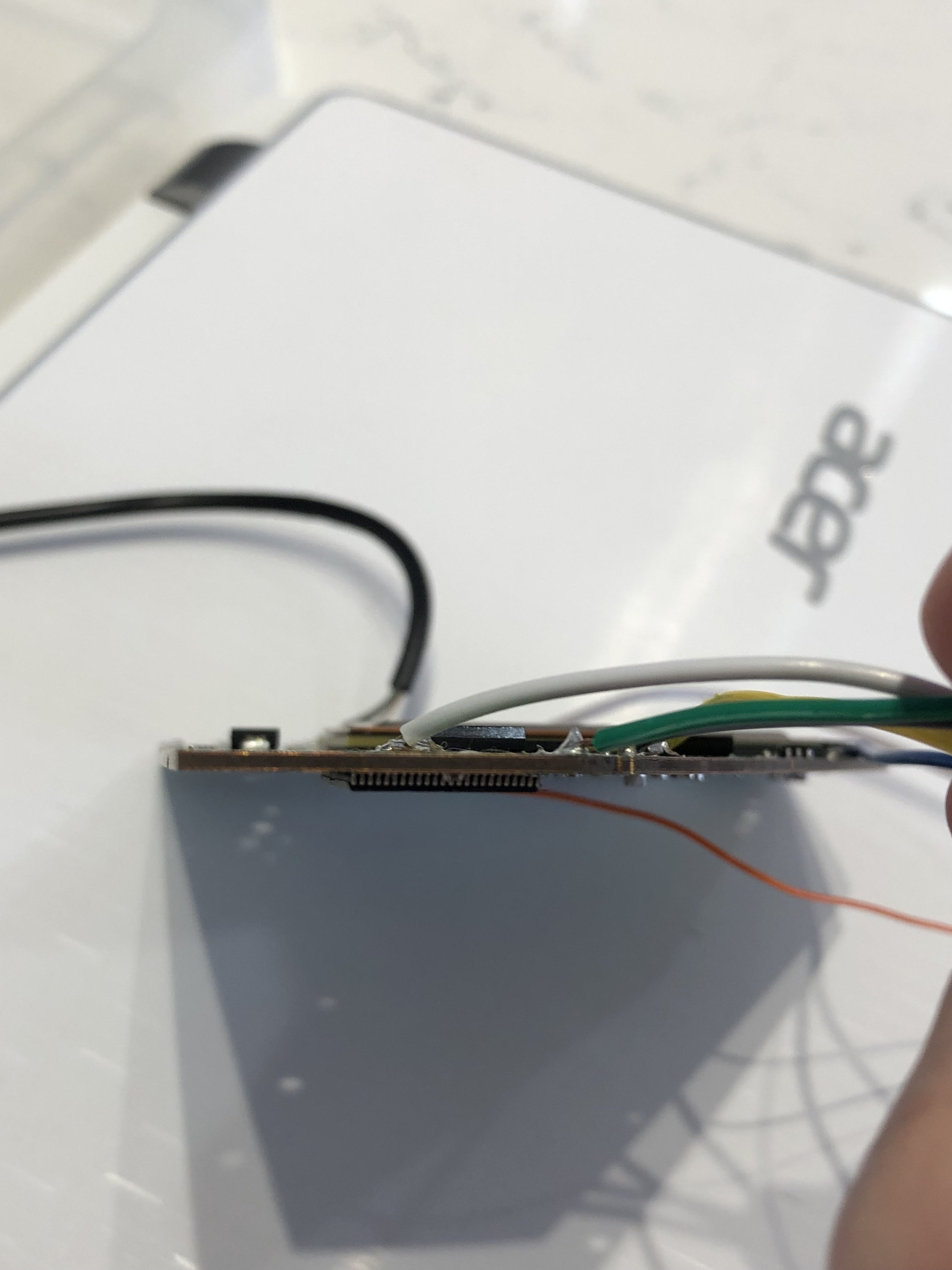

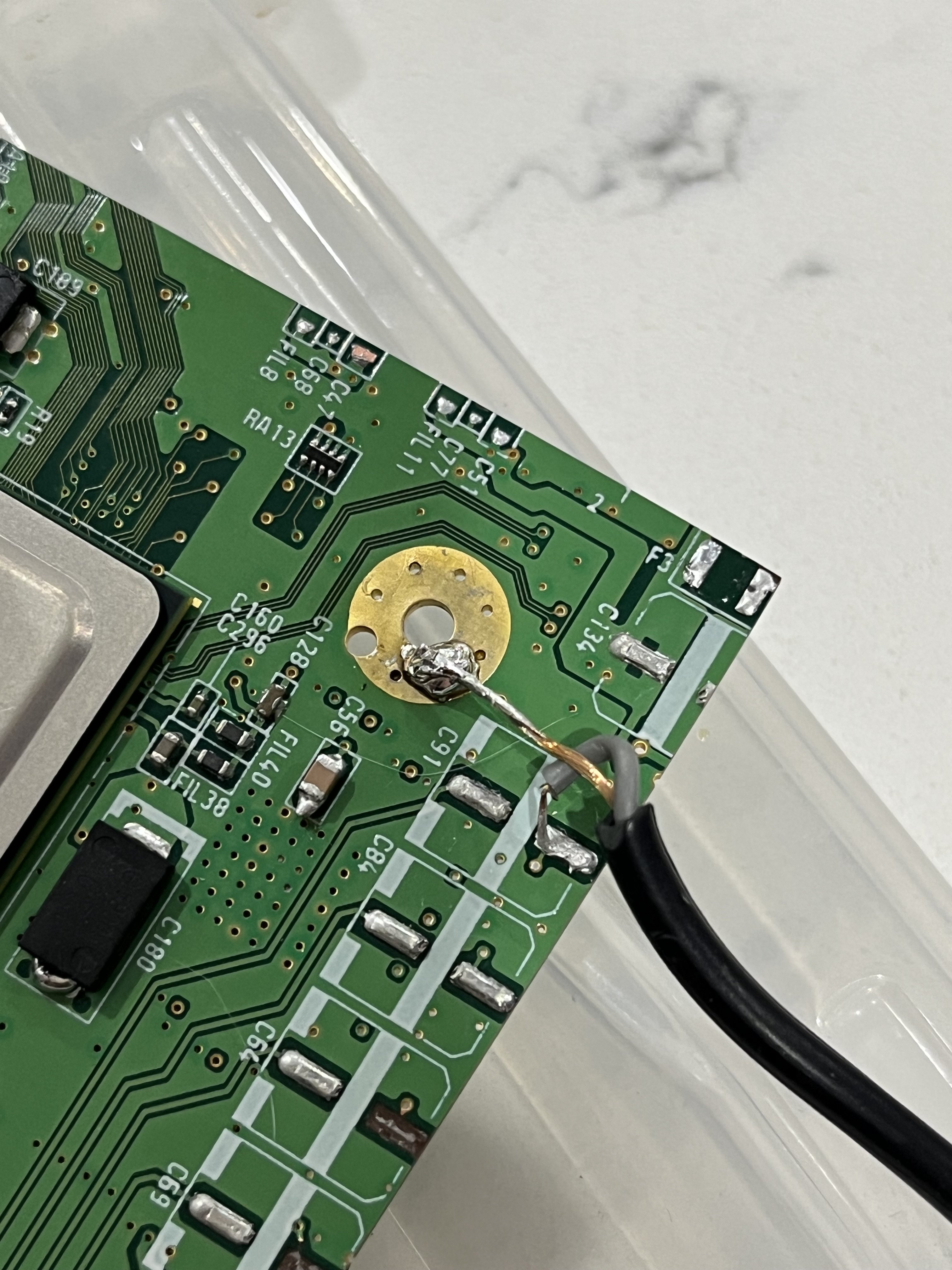

Interesting choice using the SMD capacitor for ground.
Try resoldering it to a GND screw post and see if the image posts correctly.

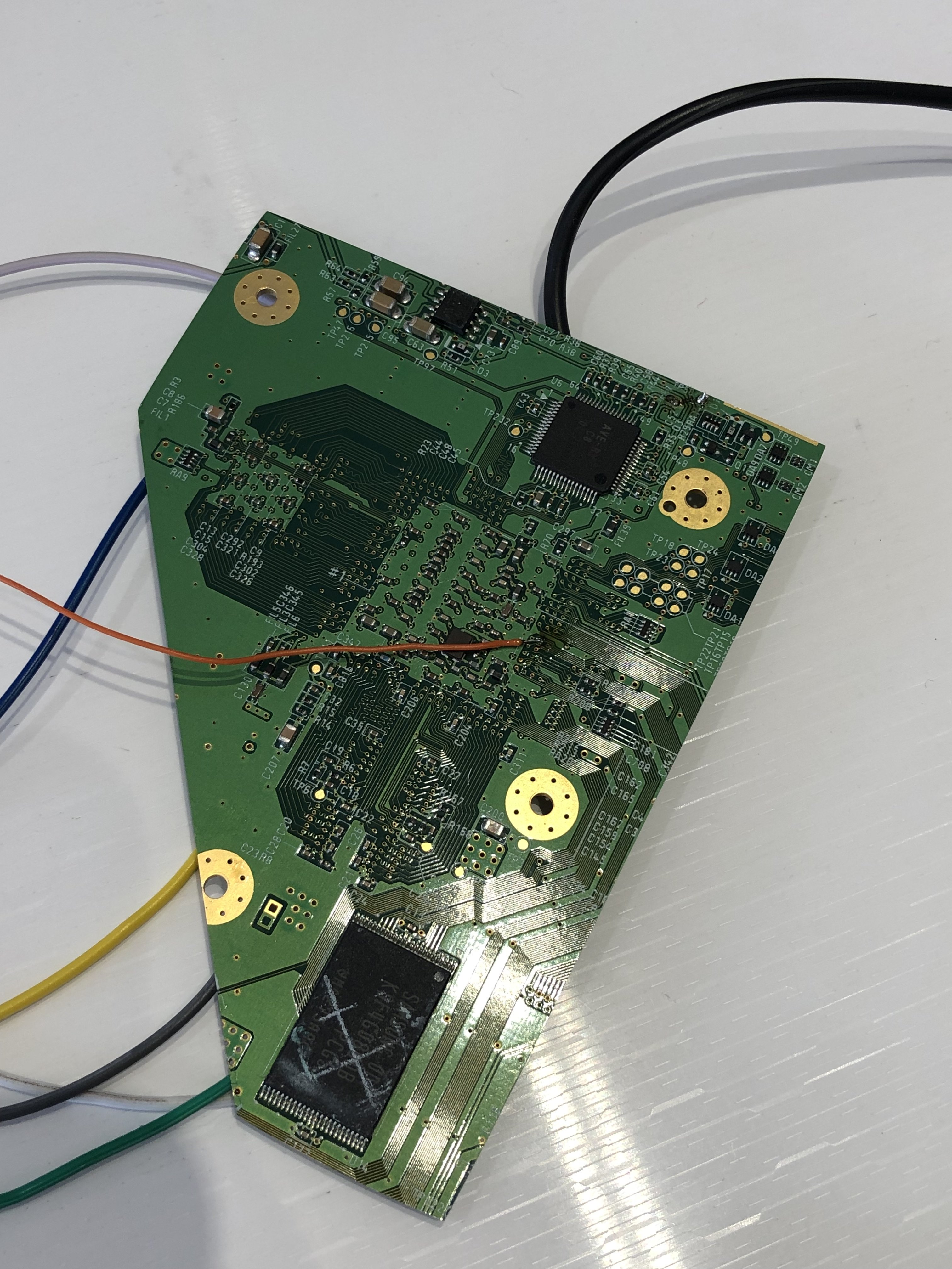

Also, do you have your U10 emulator wire soldering to the Wii? That's required to boot.
I actually saw it connected like this on a Youtube Wii trim video so thought, why not?
Moved the ground to the screw post but no difference in the video output.

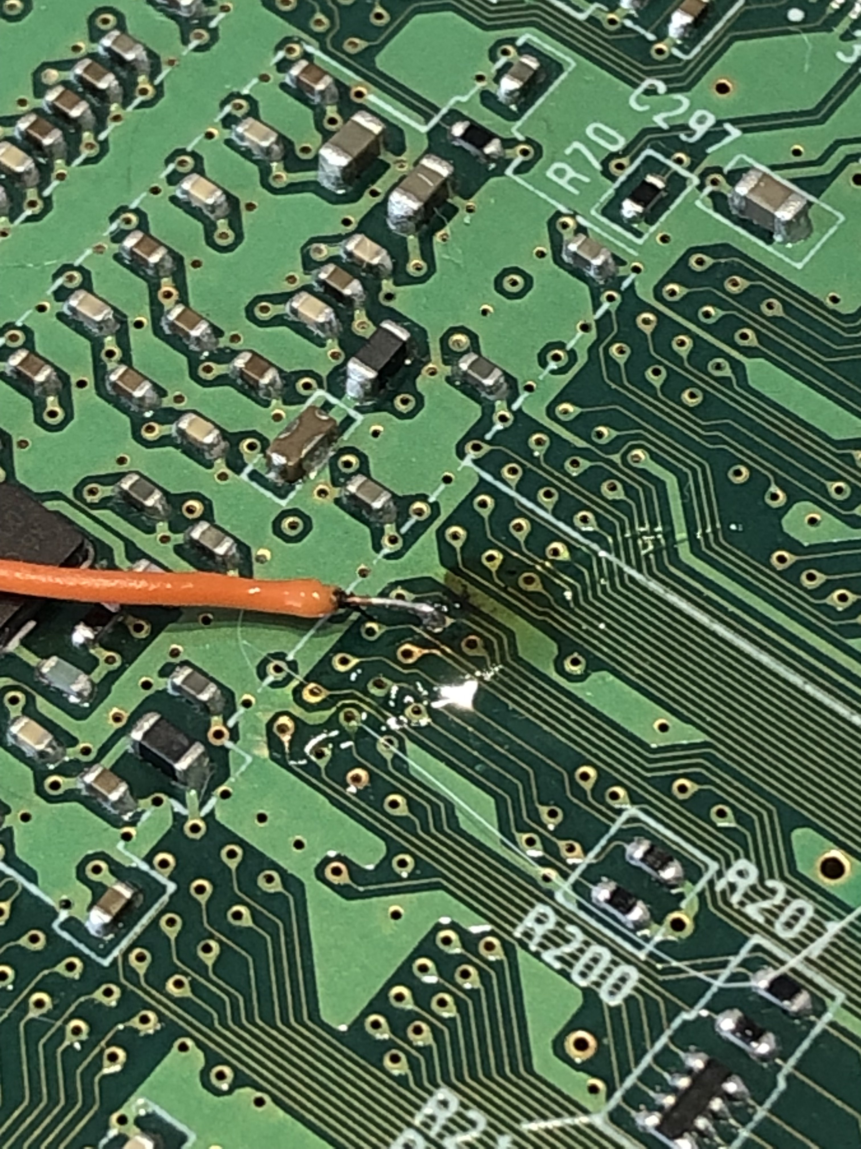

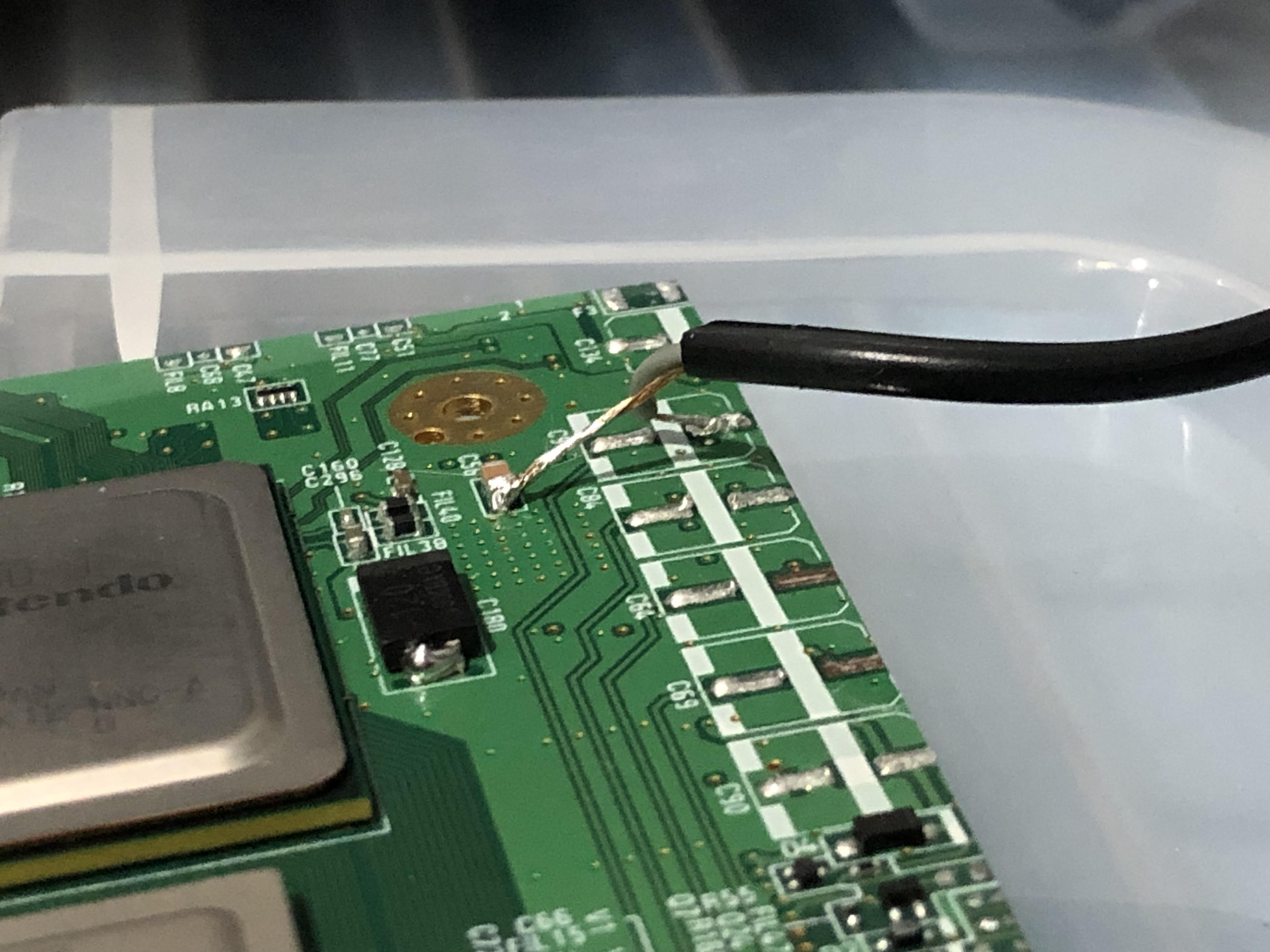

I do, I have a 30AWG wire running from the U10 via on the backside of the Wii board to the U10 port on the PMS.
If it's not posting, but getting voltage to the board correctly. Id recommend redoing your solder joint for the U10 wire on the PMS and the Wii side and see if that allows it to boot properly.

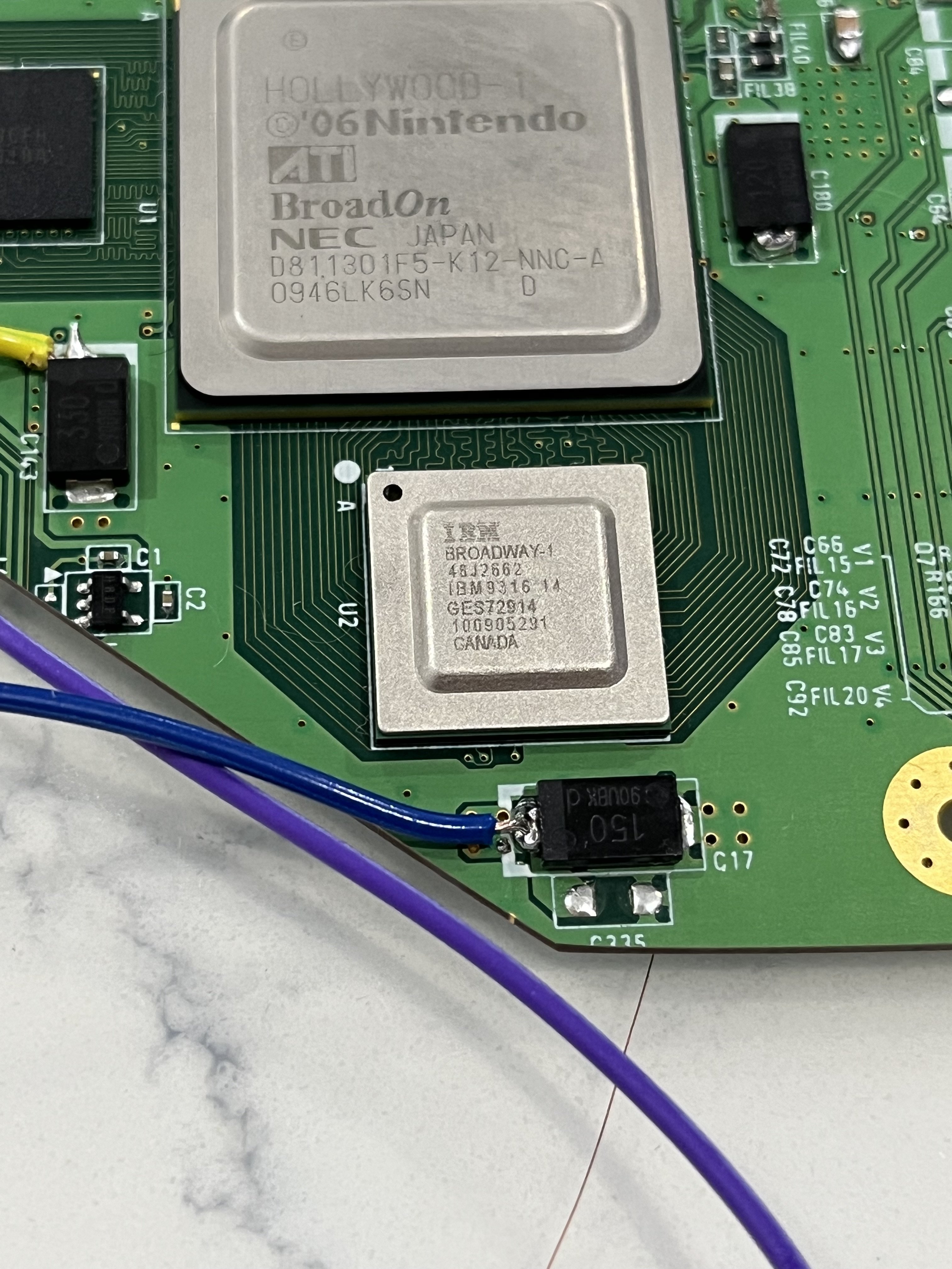

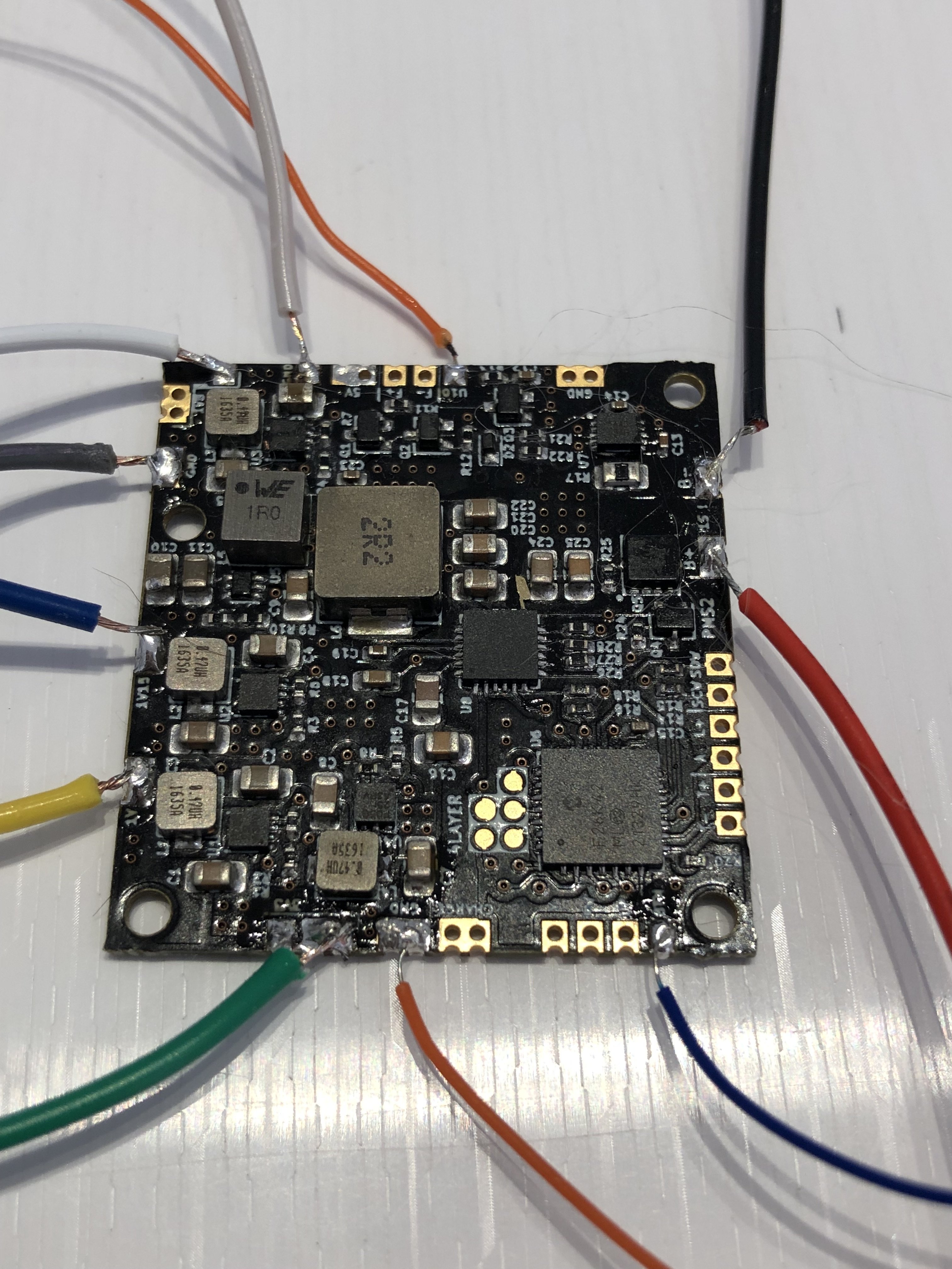

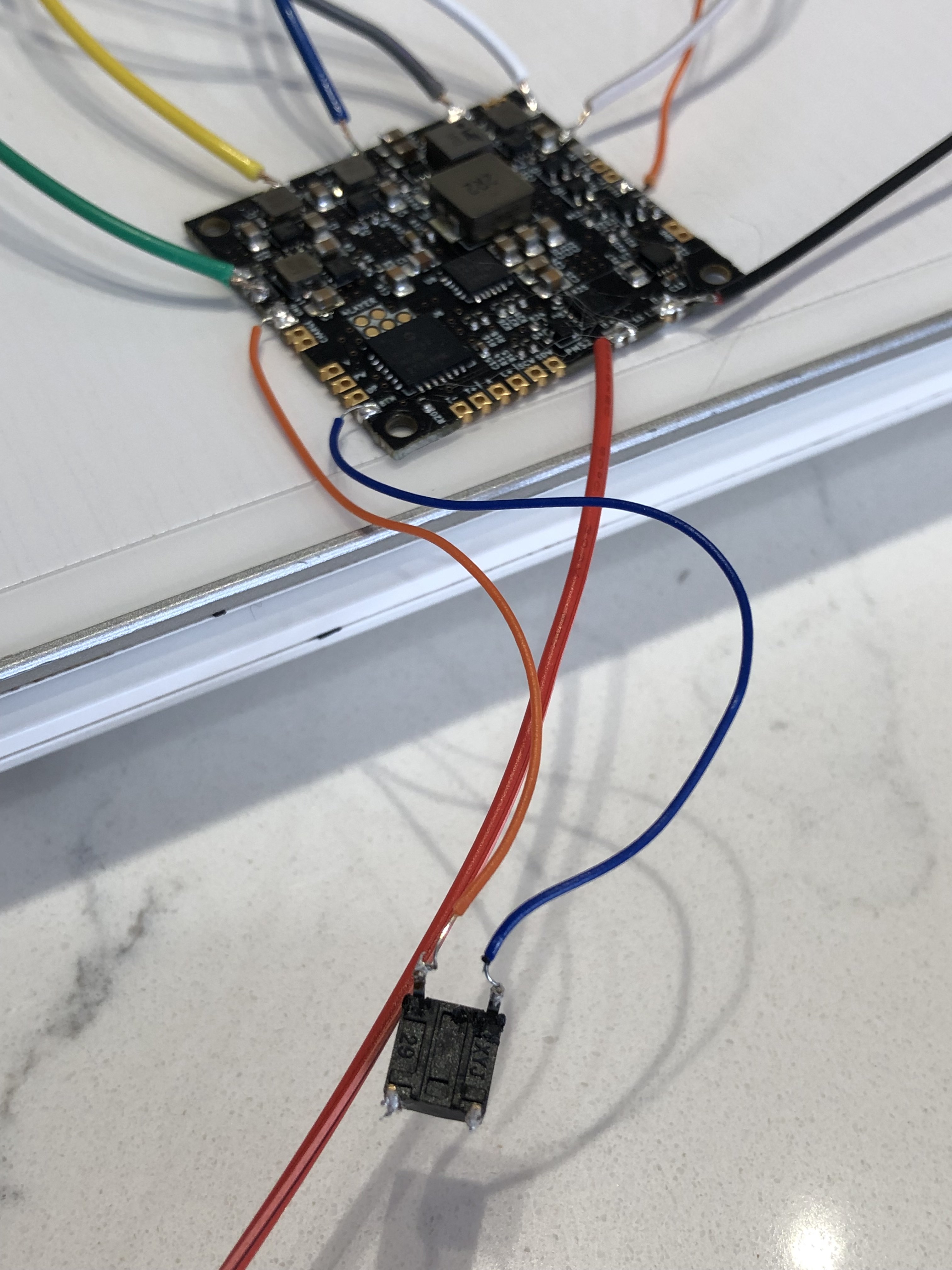

Have any more recent pics of your board? Cleaning it with IPA would be a good start.
That video output looks as if the NAND isn't ""starting up"", which makes sense given your voltages.
It makes a lot of sense. Is this evidence that each component is not getting the required voltage to "start up"?

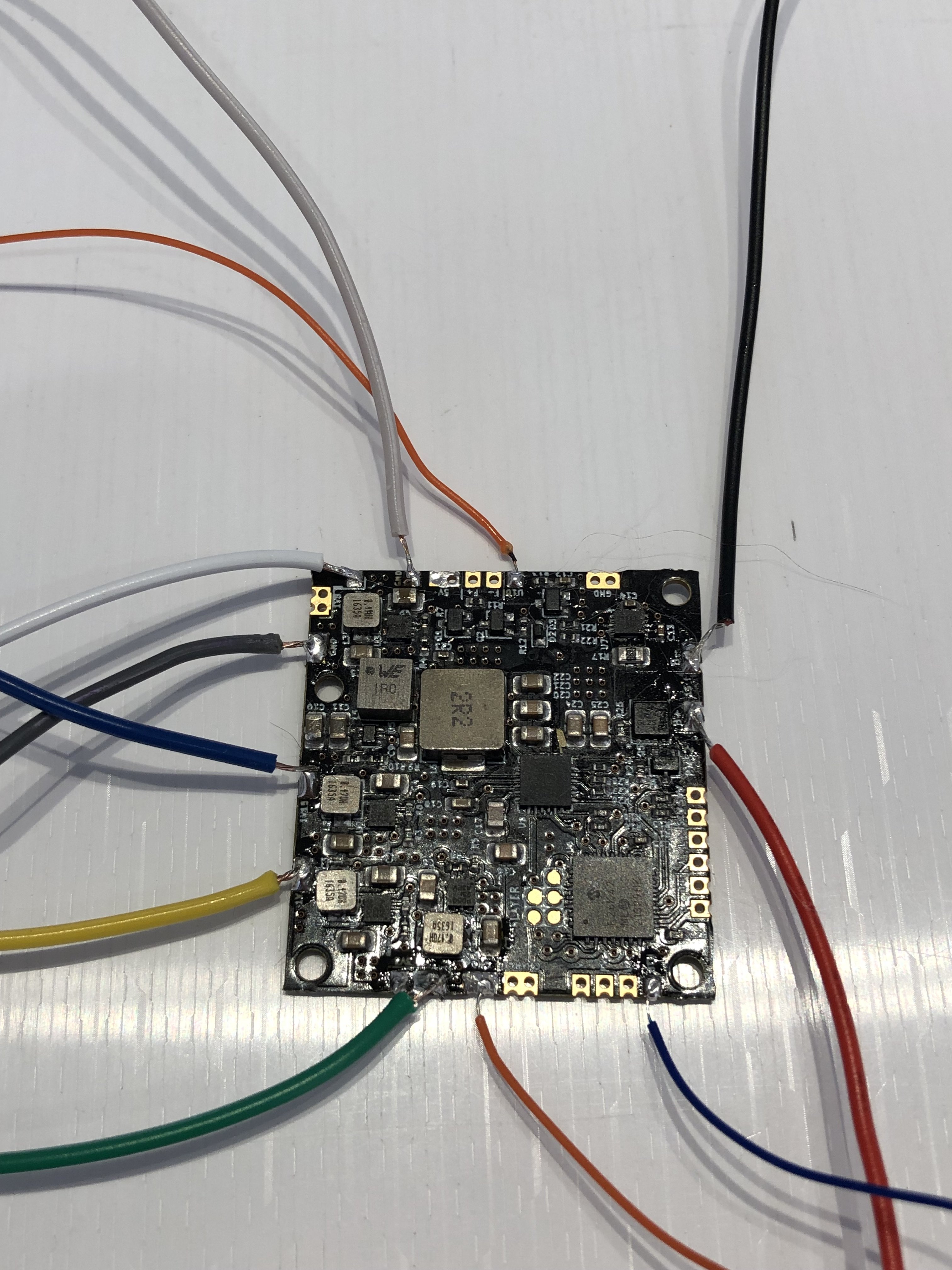

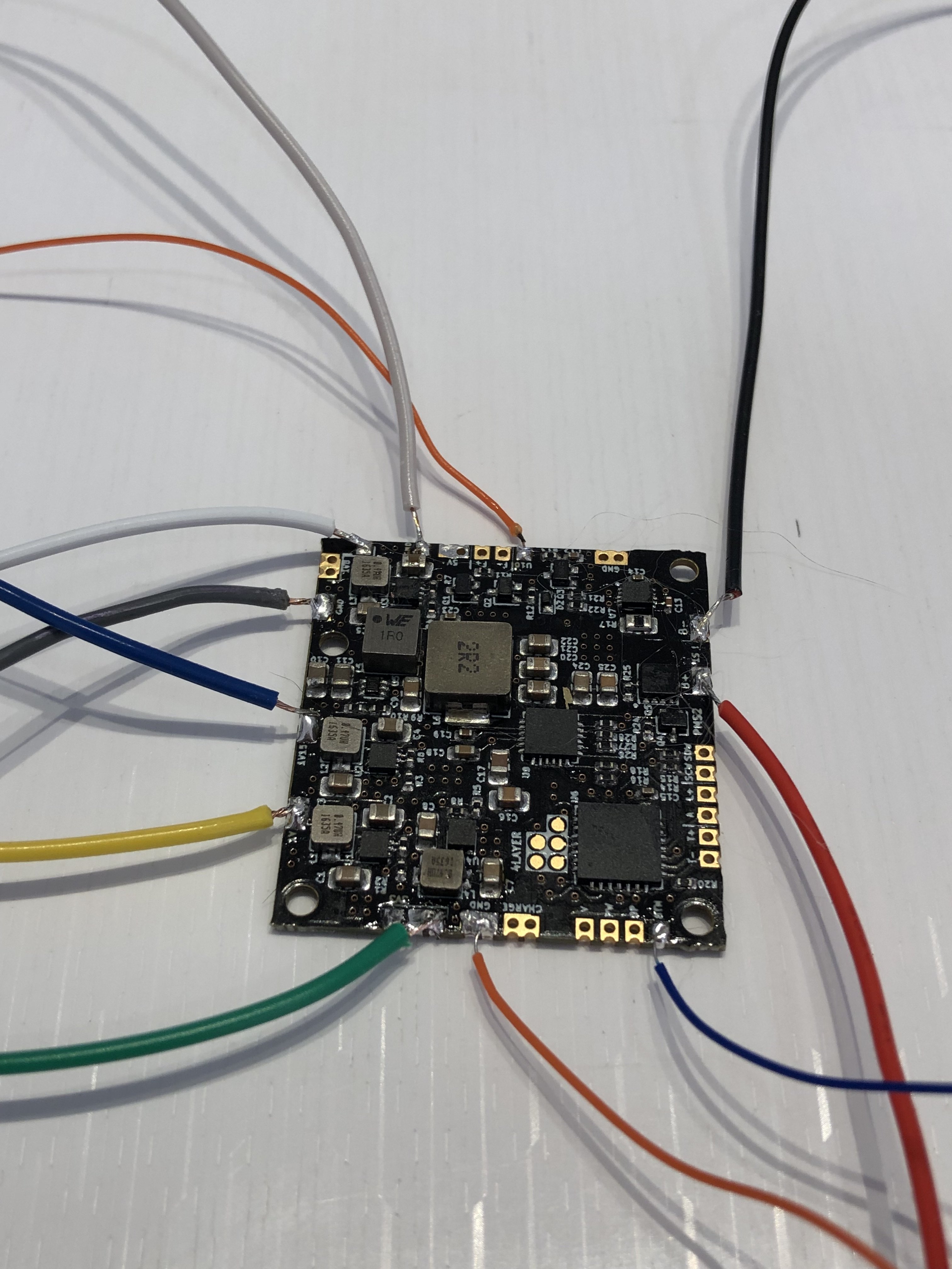

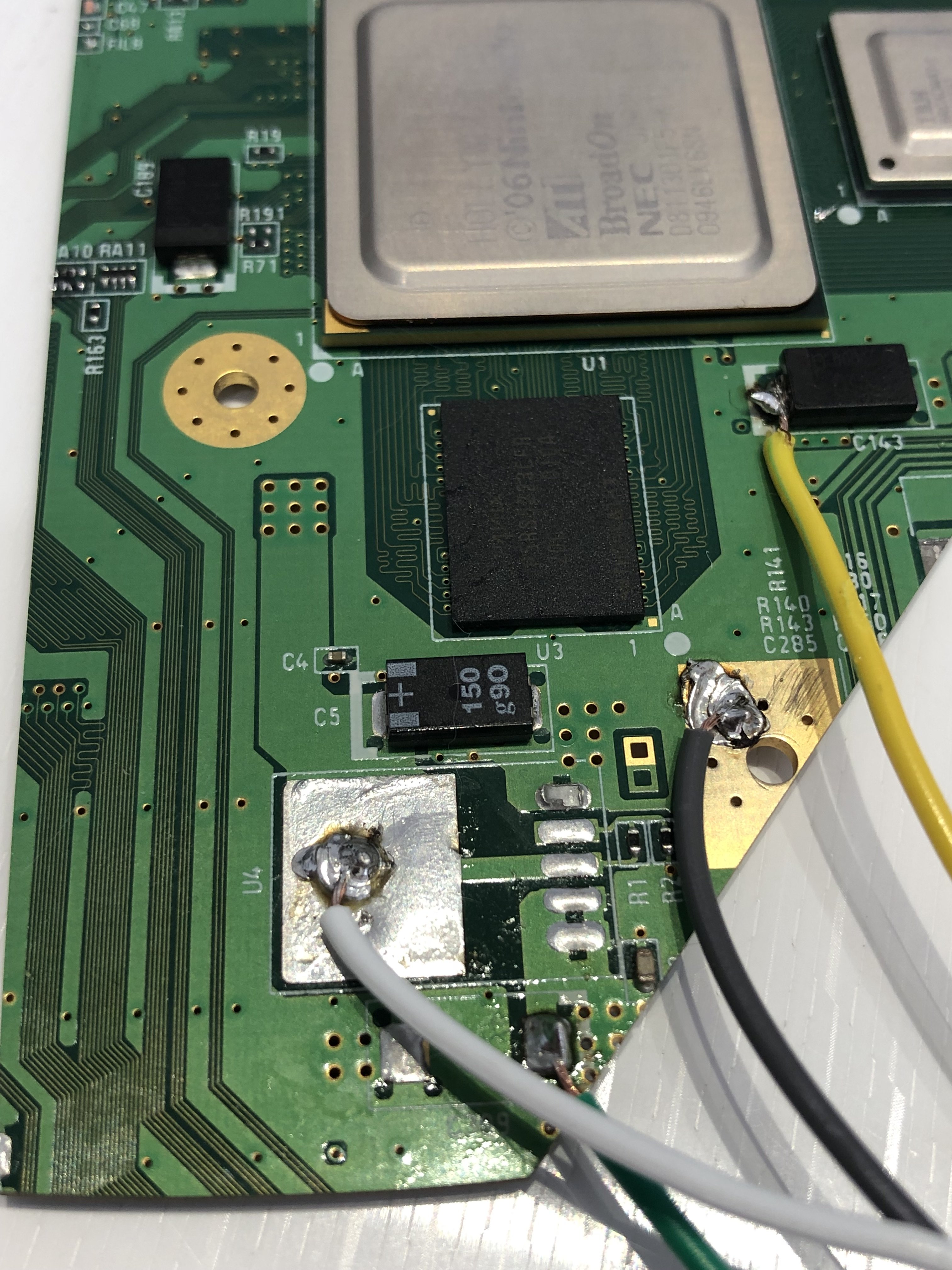

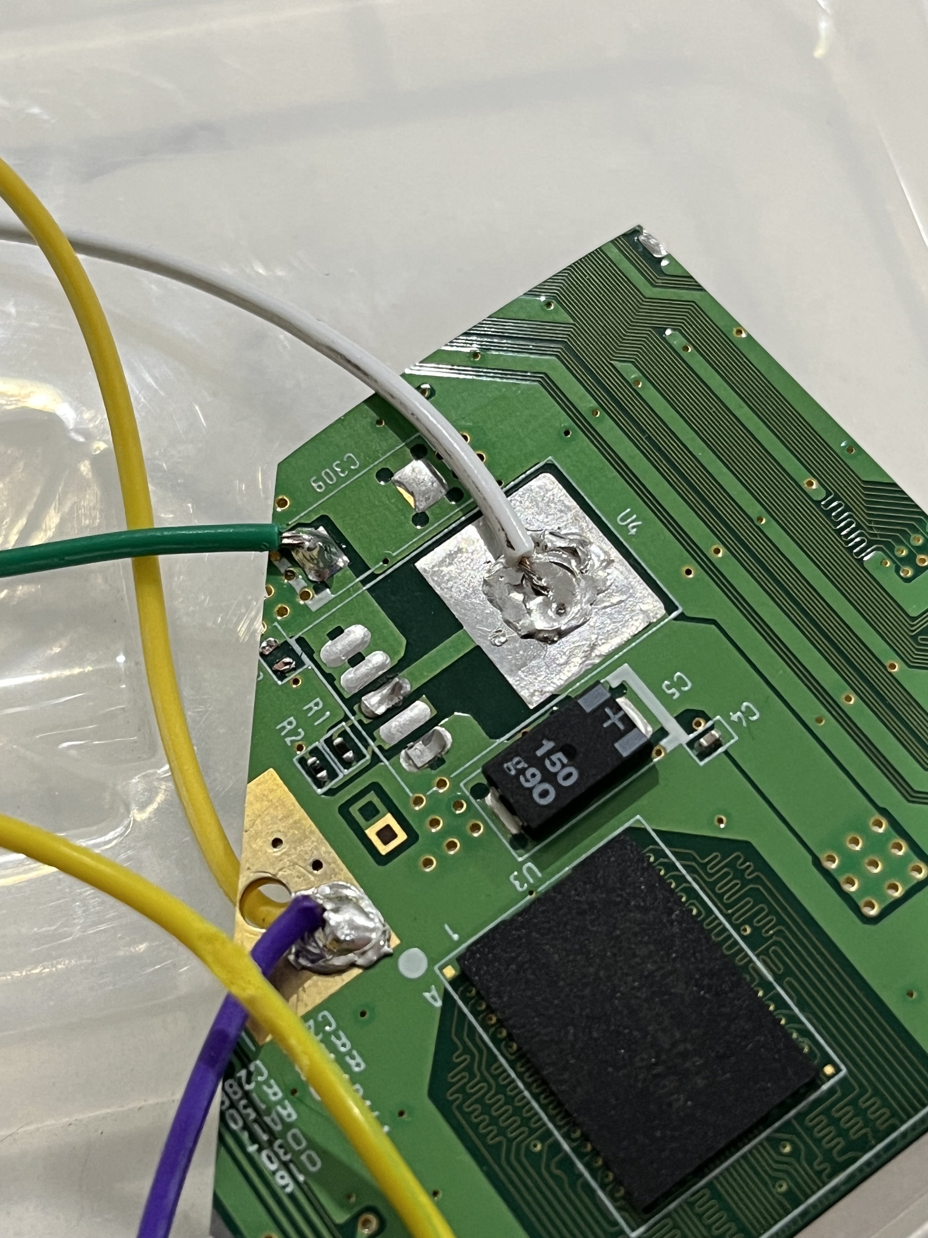

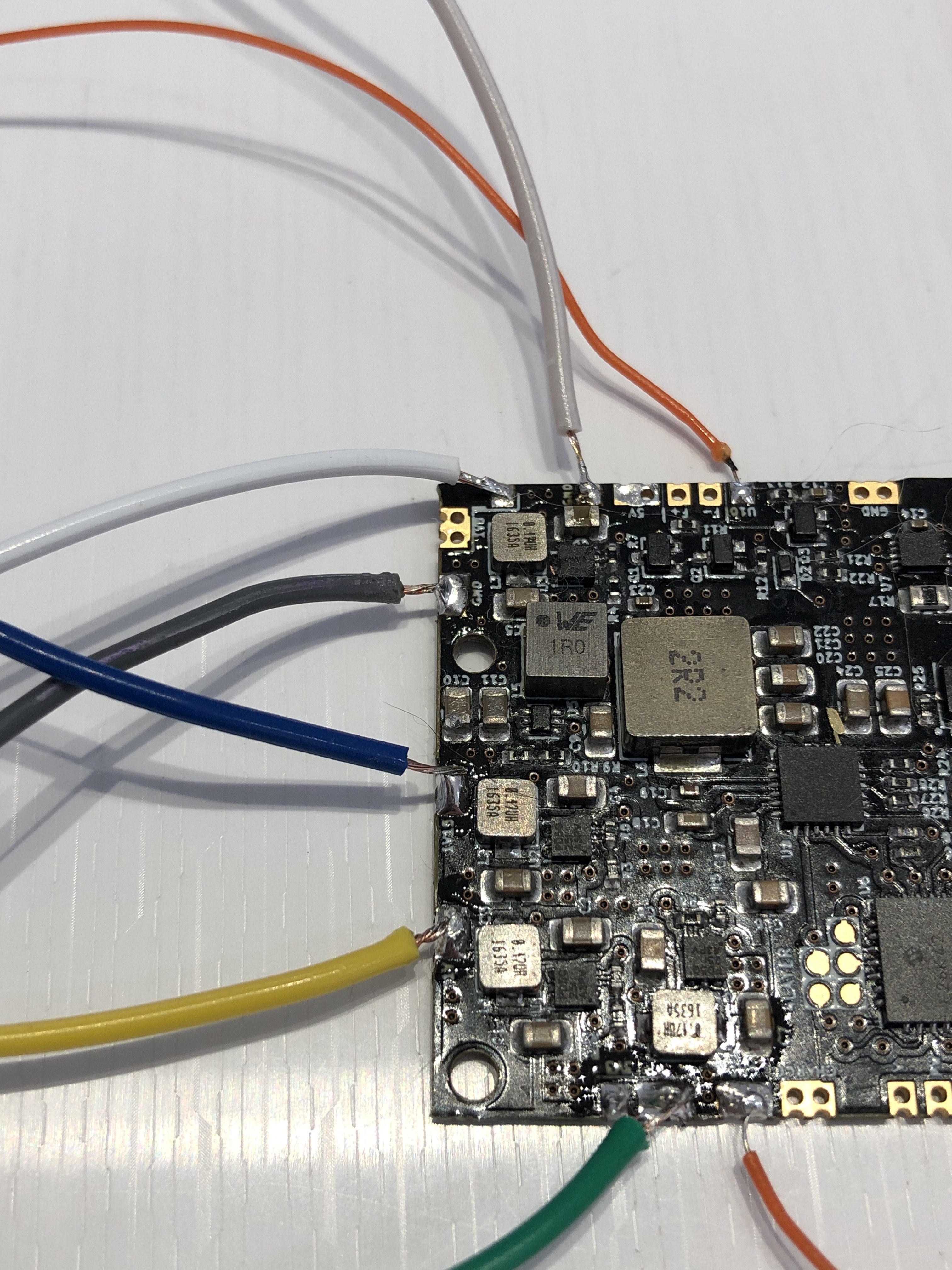

Got some more shots of the board at the moment. Can you see anything I may be missing?
Just desoldered and scrubbed it all down, VERY well with IPA. Then again after resoldering

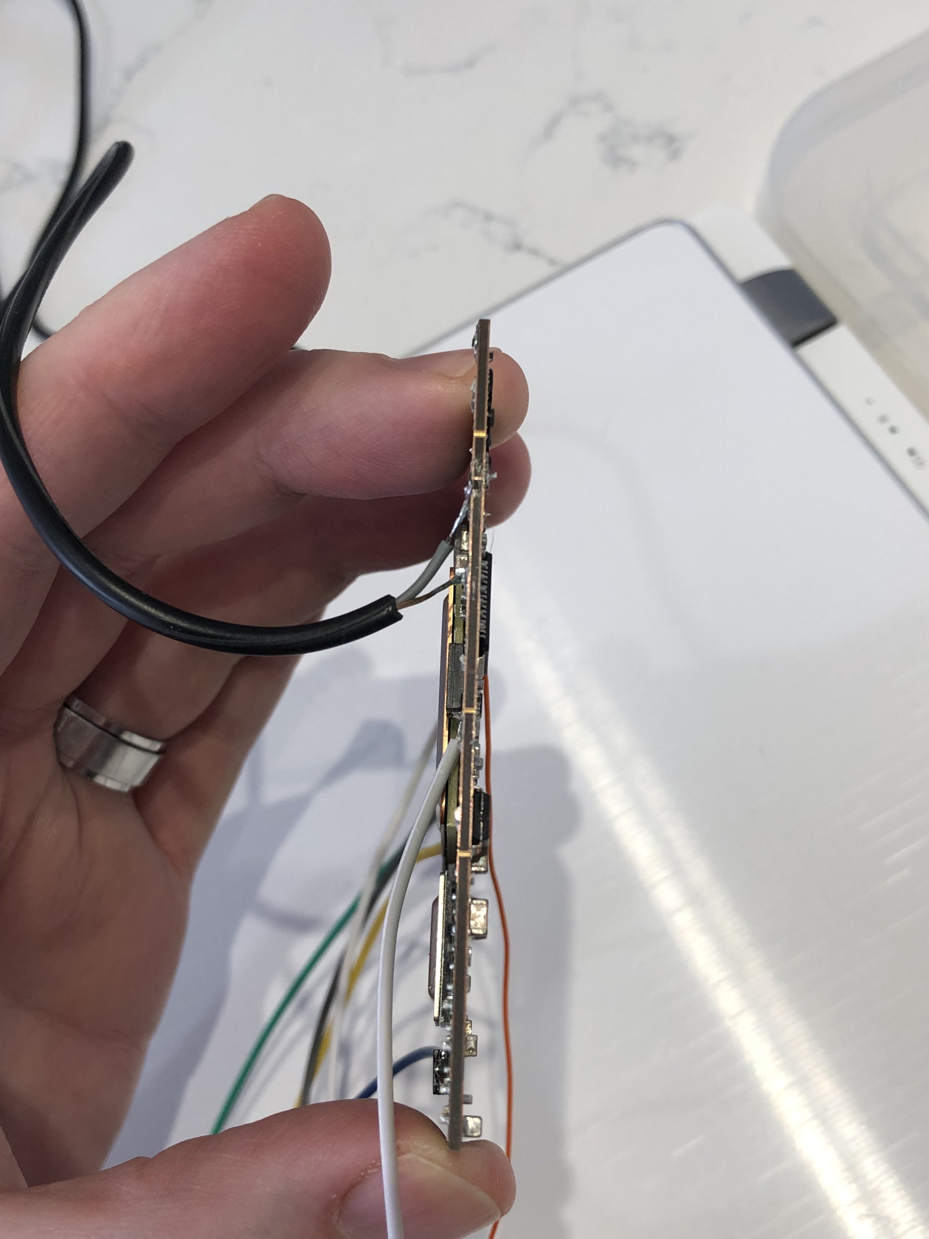

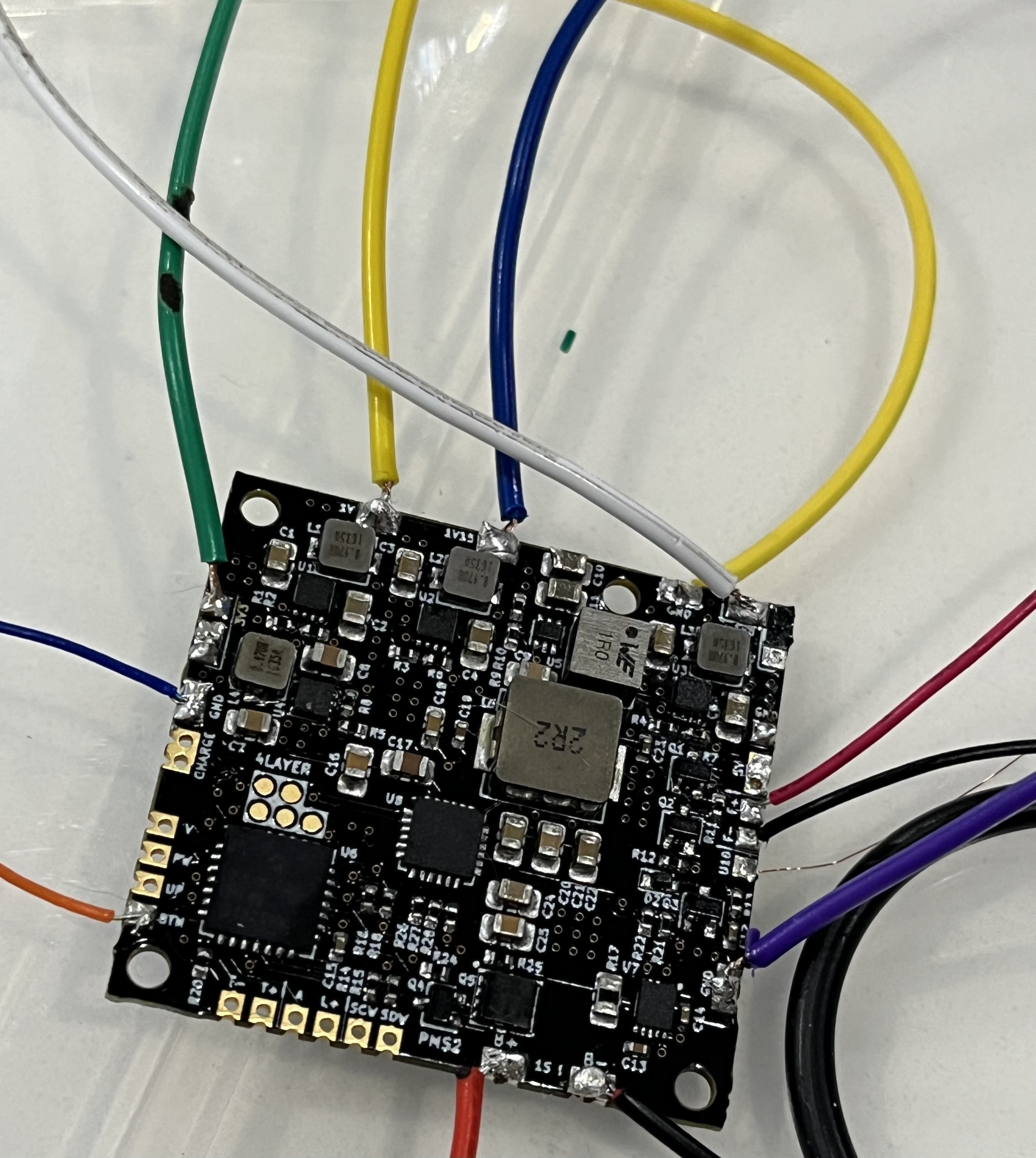

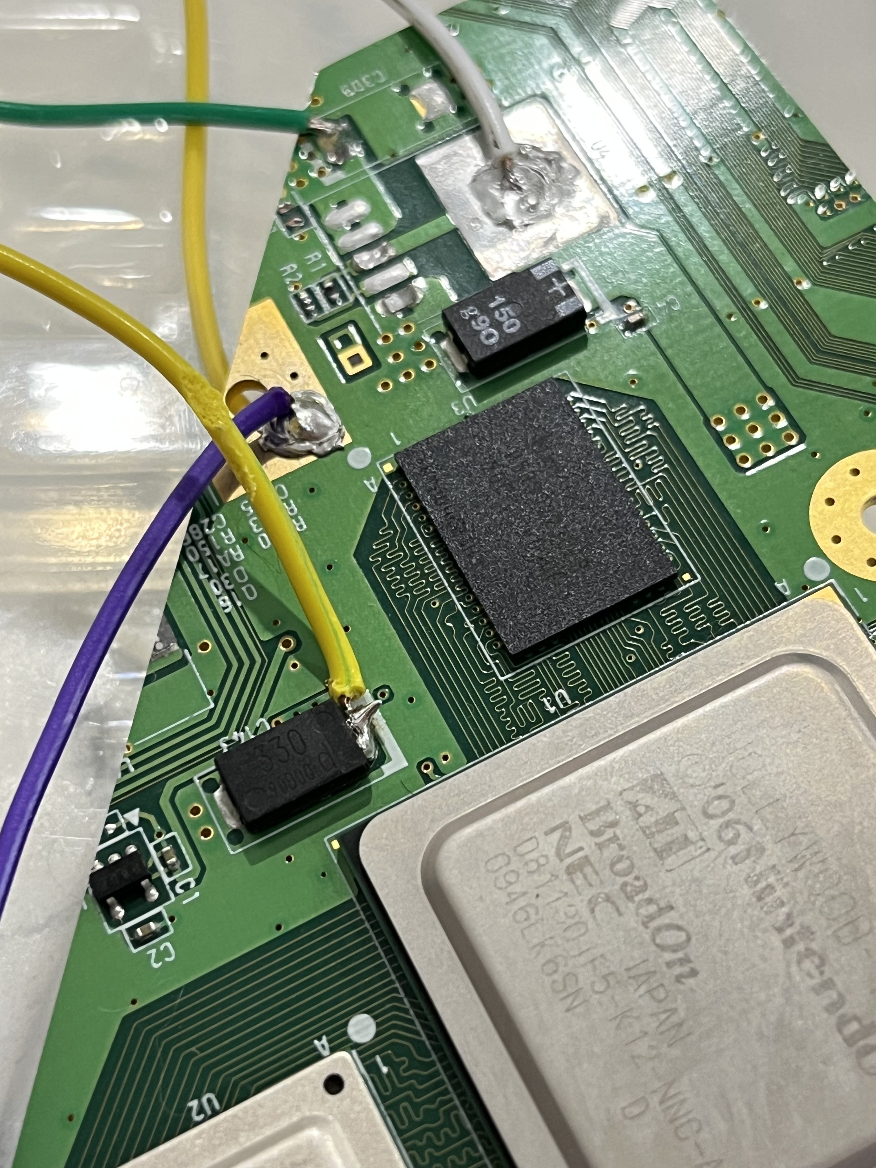

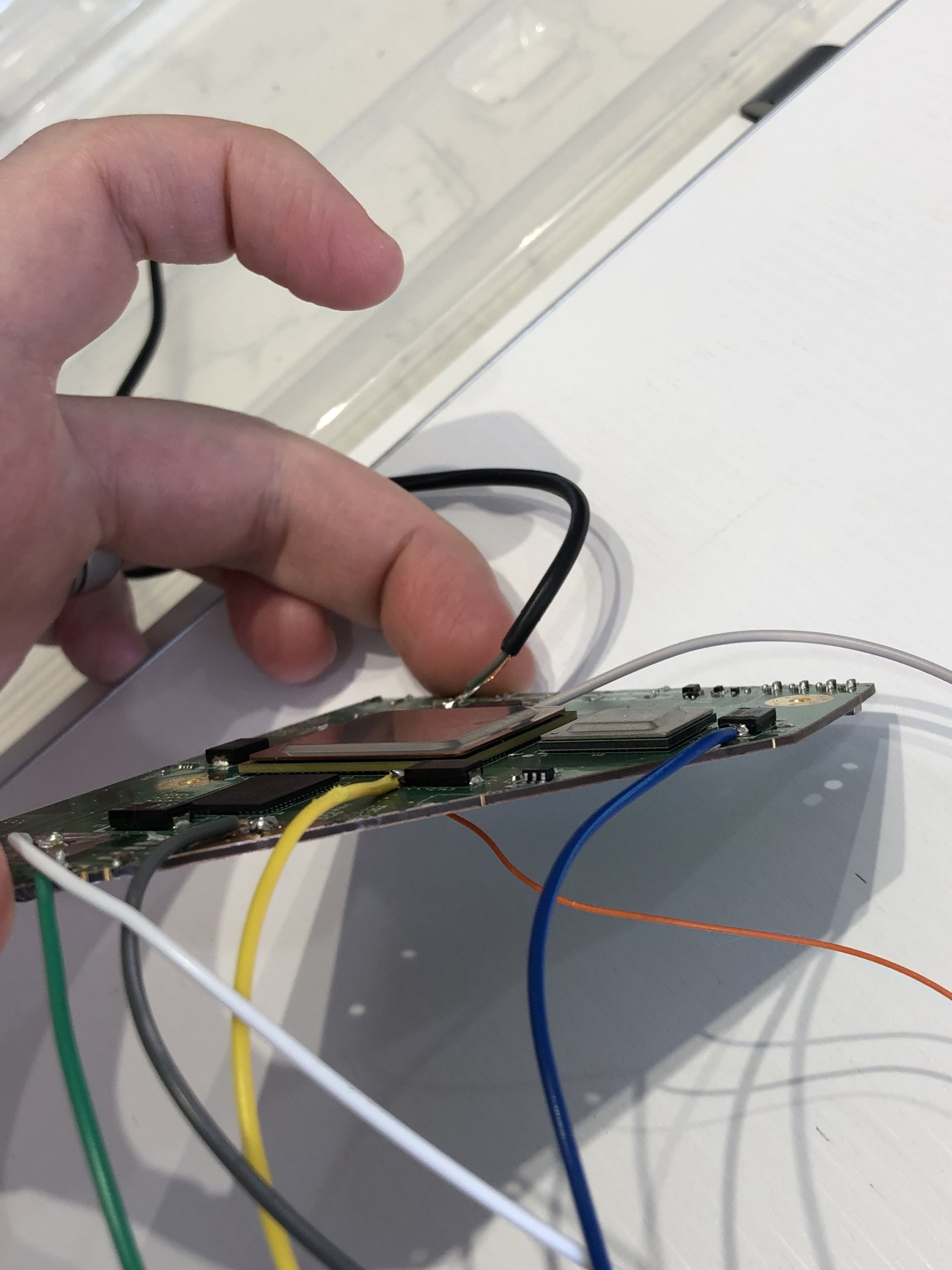

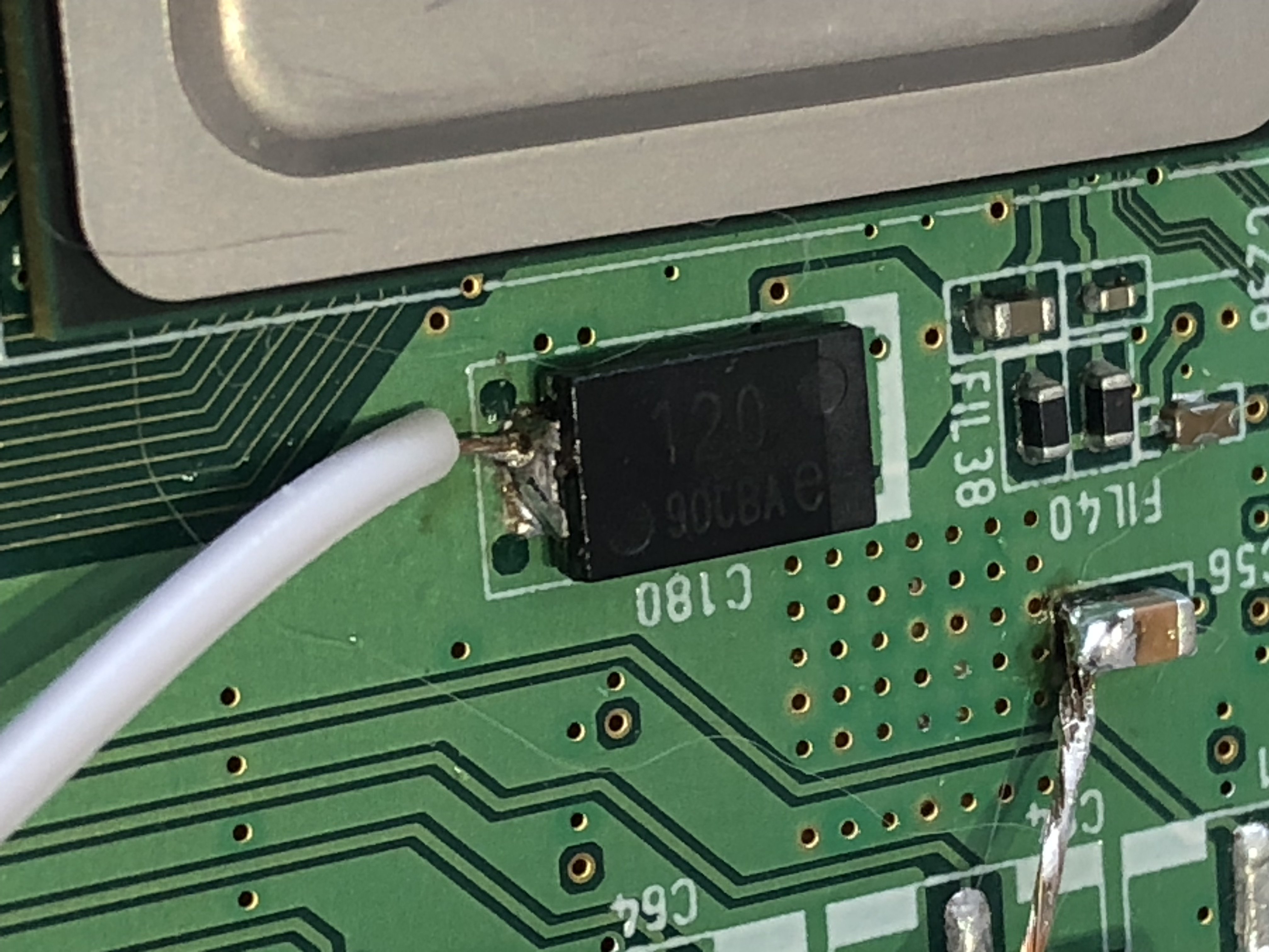

Soldering looks fine. Still need to reduce the amount of exposed wire if possible, but much better than before.
Are you still getting dropped voltage at the Wii after resoldering?
If you're still getting voltage drop on the Wii, but not on the PMS after resoldering. Then your issue is either the solder joints, or the wire itself.
If that's old wire, and it's oxidized then it can create resistance at your solder joints. Id recommend replacing your wire with something that's pre-tinned.
If had really good results with This. You might be able to find something at a local hardware store too.

Thank you Retro, I took your advice and replaced my current jumper wires with pretinned wires, replaced all the voltage lines and to my amazement, RVloader appeared on the TV.
