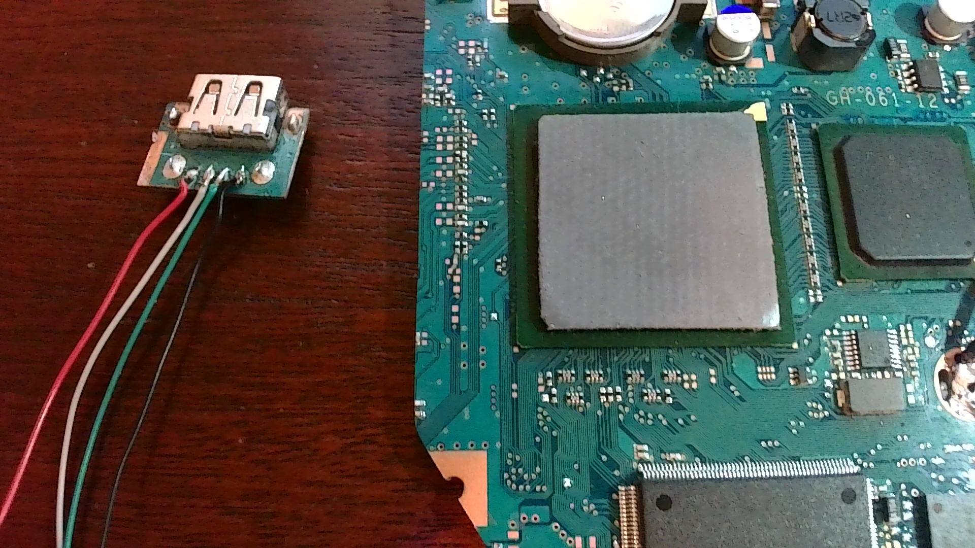

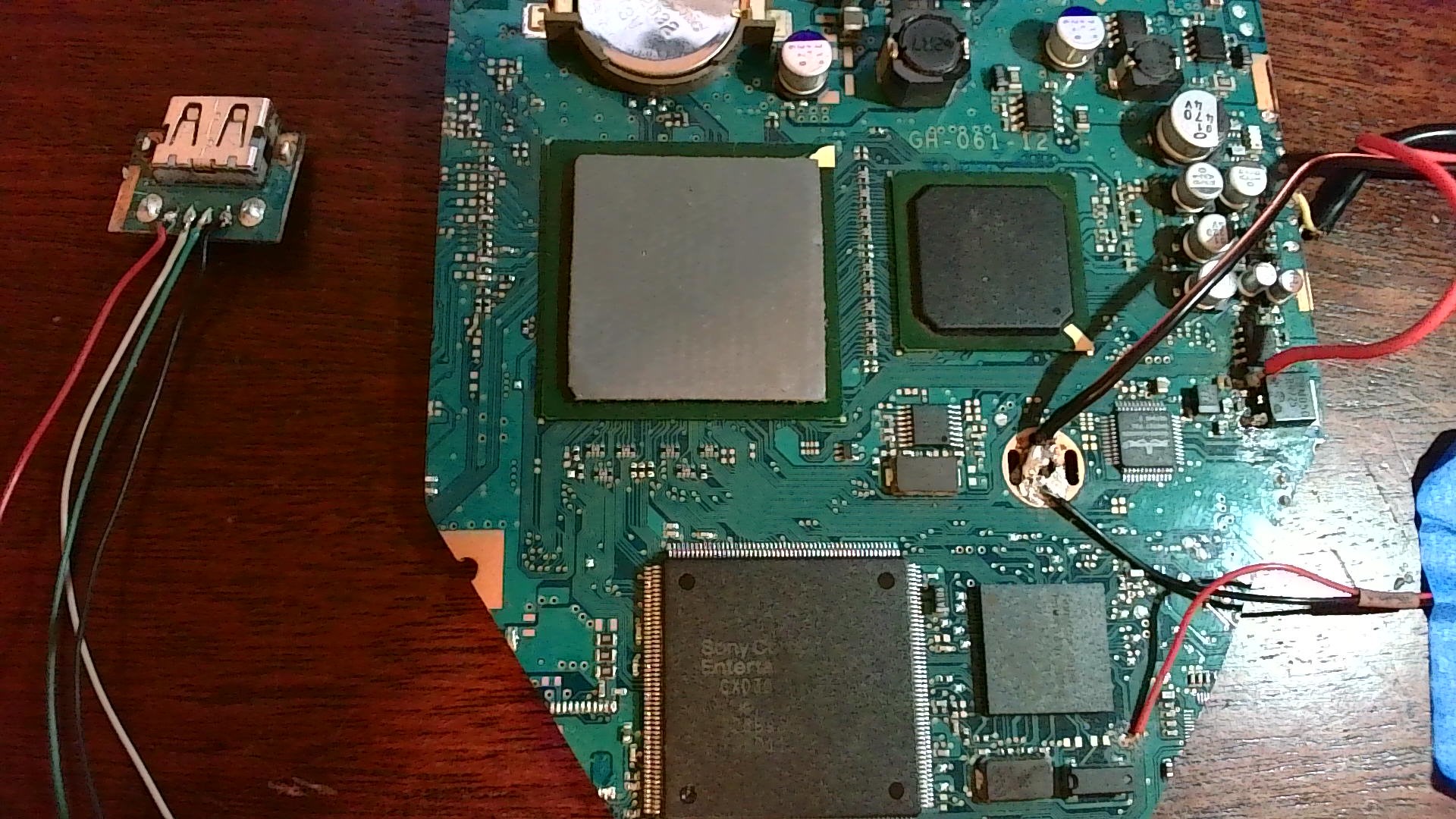

caxtilteca . Joined Aug 17, 2021 Messages 40 Likes 6 Oct 10, 2021 #1 i need help wiring the usb port to the ps2 board Attachments WIN_20211009_19_45_25_Pro.jpg 459 KB · Views: 329 WIN_20211009_19_47_15_Pro.jpg 526.2 KB · Views: 292
Heuic . Joined Dec 17, 2020 Messages 53 Likes 75 Location Enumclaw, Washington Oct 10, 2021 #2 You need to twist your data wires really tightly with a drill, otherwise they won't work

Heuic . Joined Dec 17, 2020 Messages 53 Likes 75 Location Enumclaw, Washington Oct 10, 2021 #4 The green and white wires, Also you might want to do a bit more reading on the guide if you don't know that

caxtilteca . Joined Aug 17, 2021 Messages 40 Likes 6 Oct 10, 2021 #5 is almost impossible to wire anything to those 2 thin lines
Heuic . Joined Dec 17, 2020 Messages 53 Likes 75 Location Enumclaw, Washington Oct 10, 2021 #6 caxtilteca said: is almost impossible to wire anything to those 2 thin lines Click to expand... You need to get 38 gauge magnet wire liker the guide says to use, and than tin the traces and solder the wire onto the traces with a generous amount of flux
