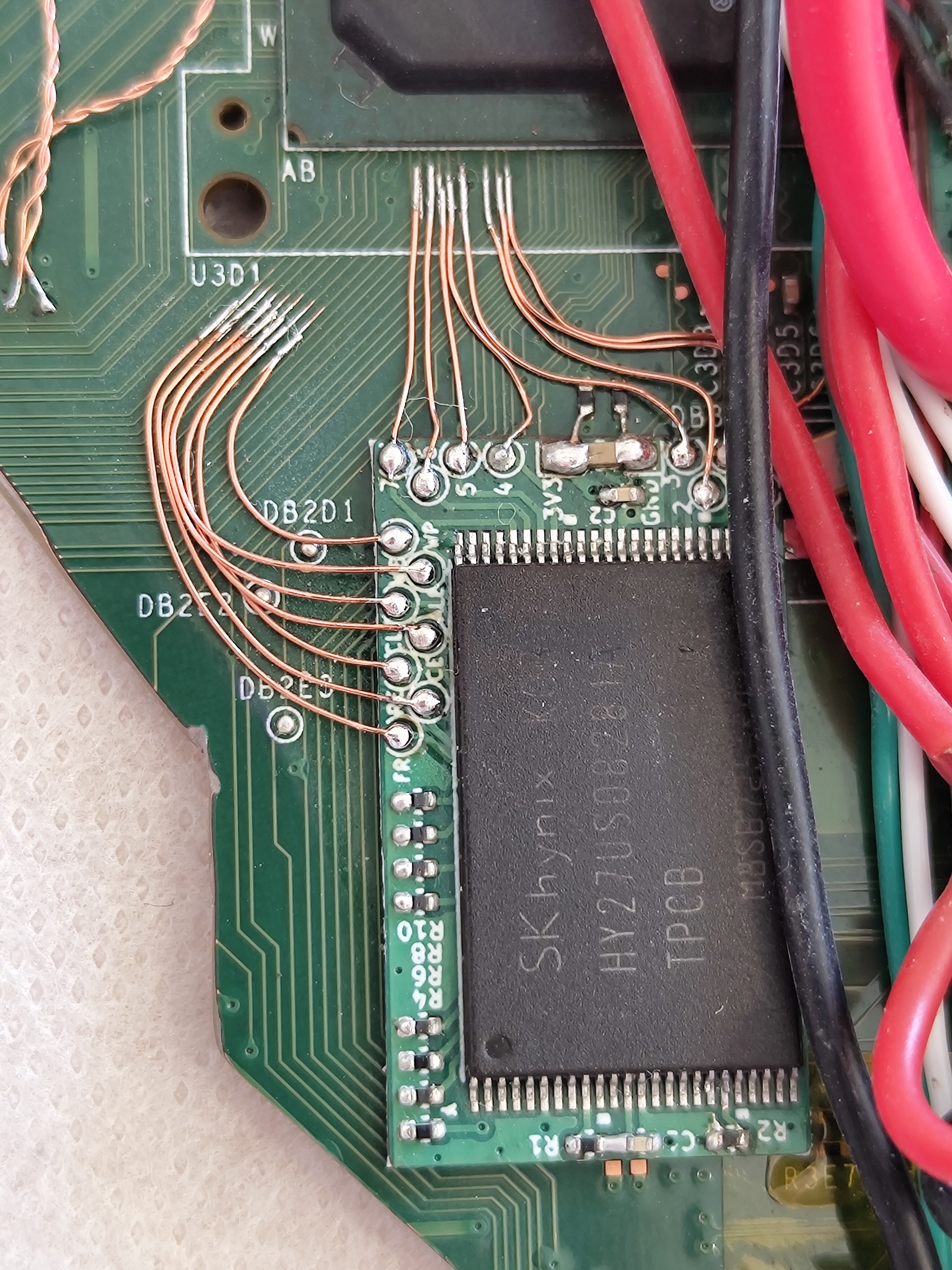

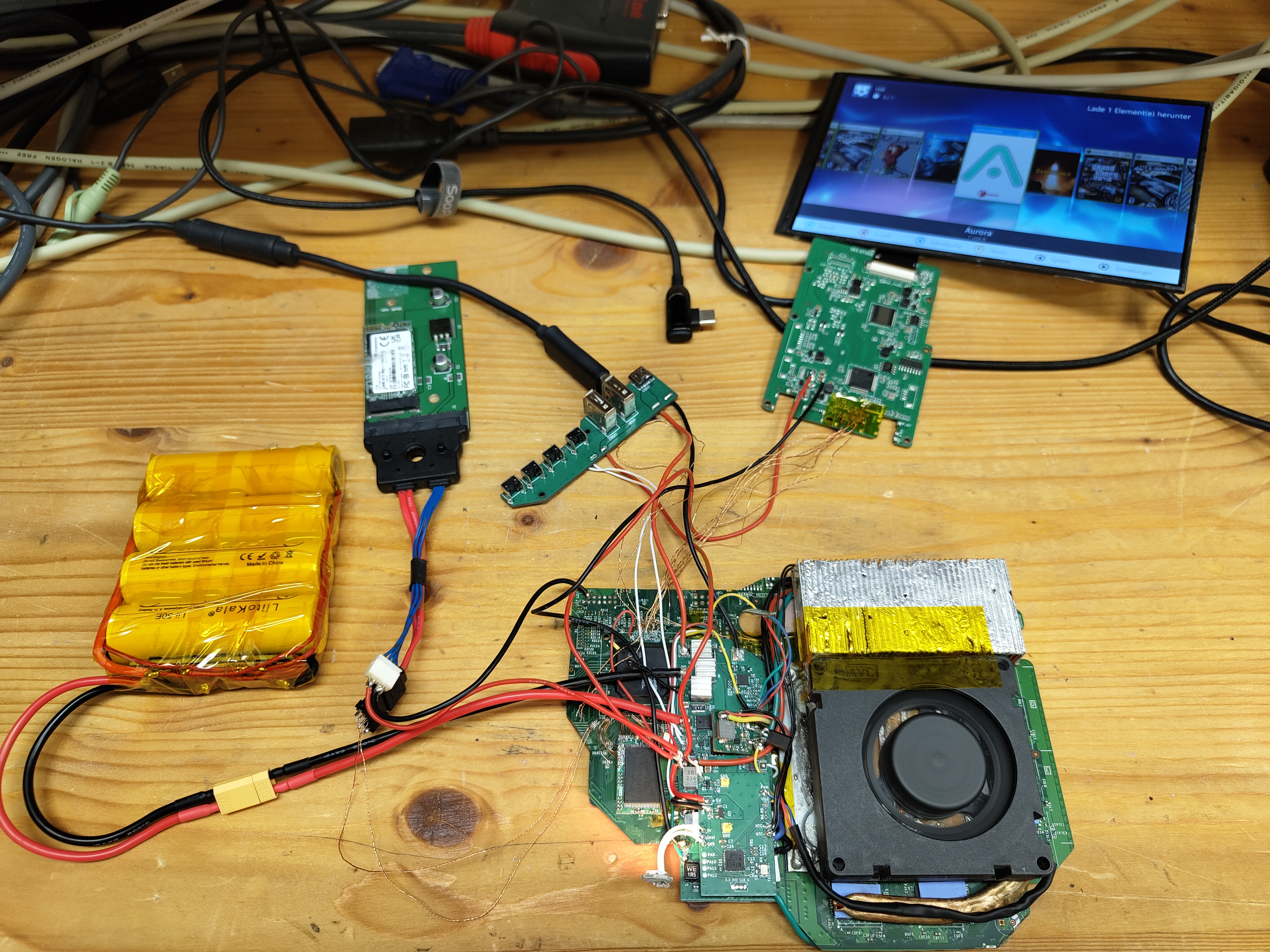

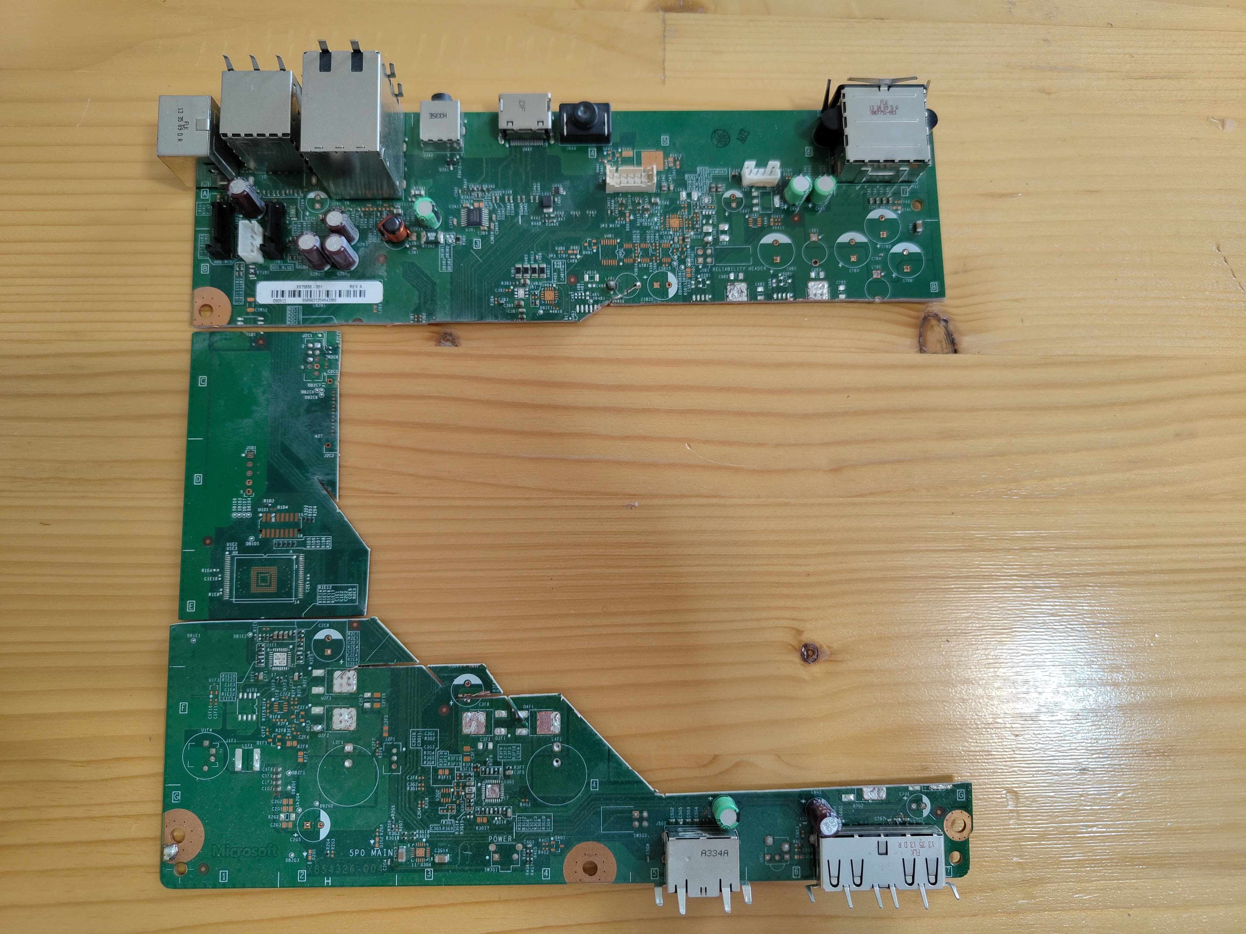

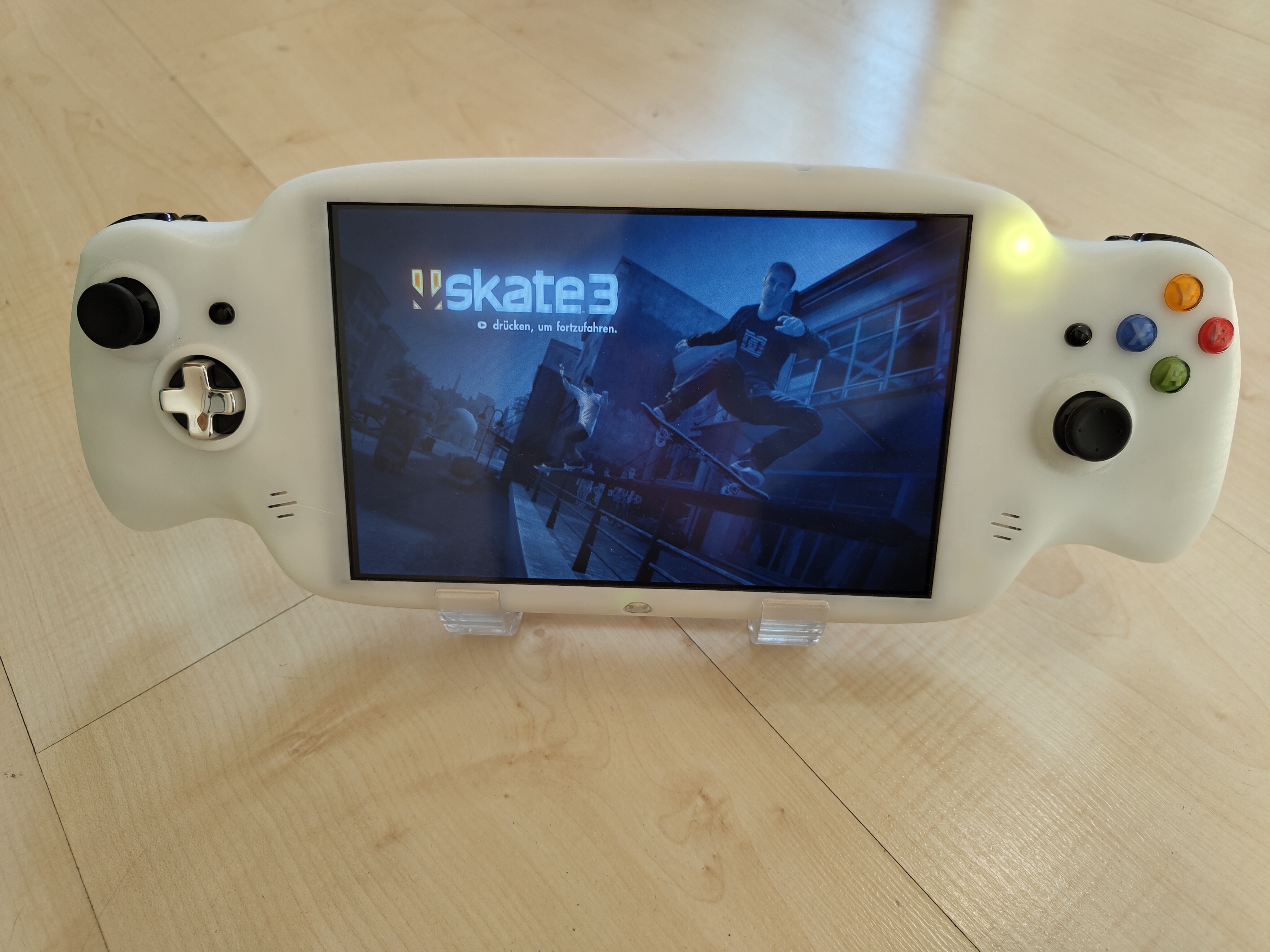

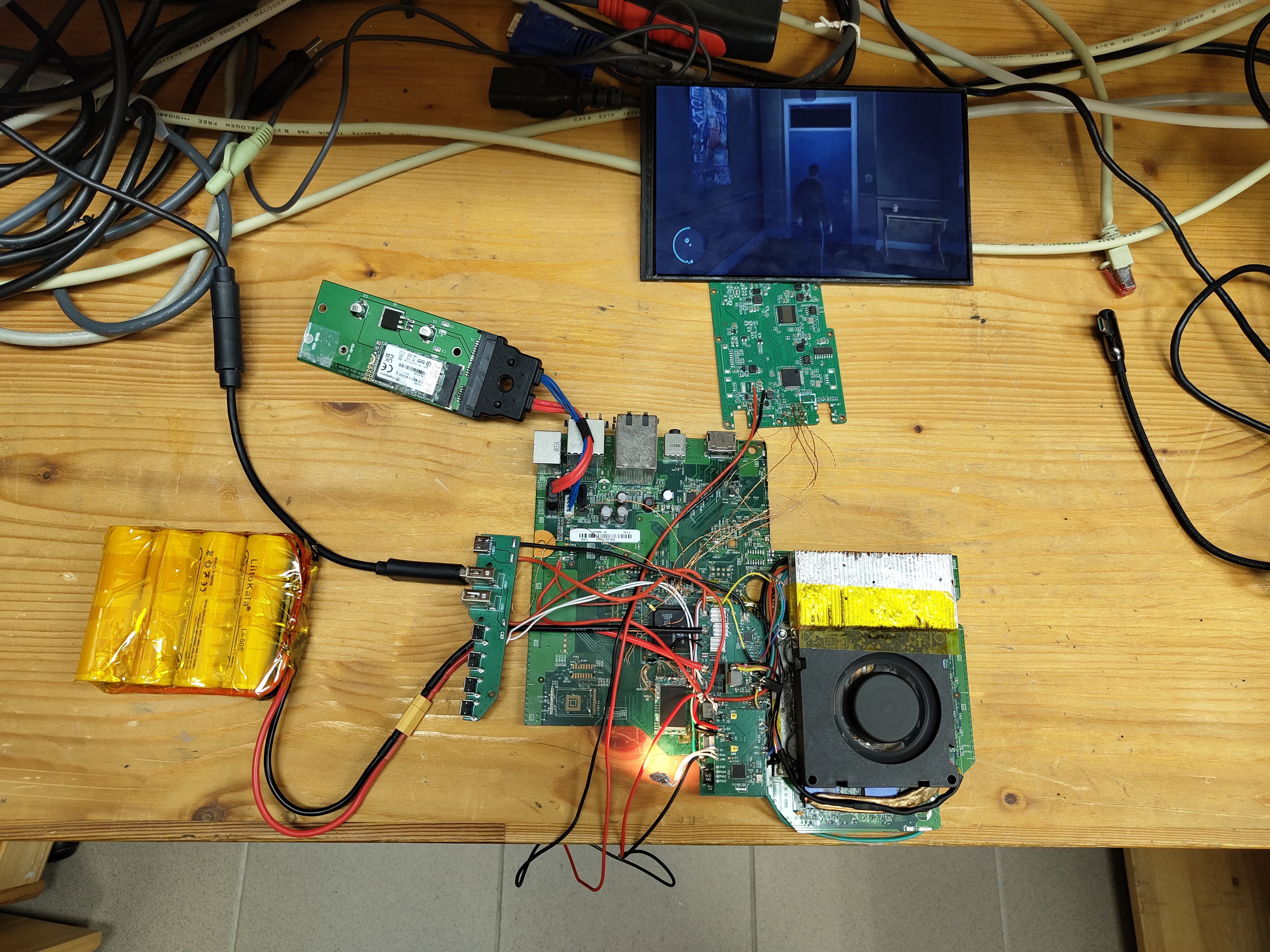

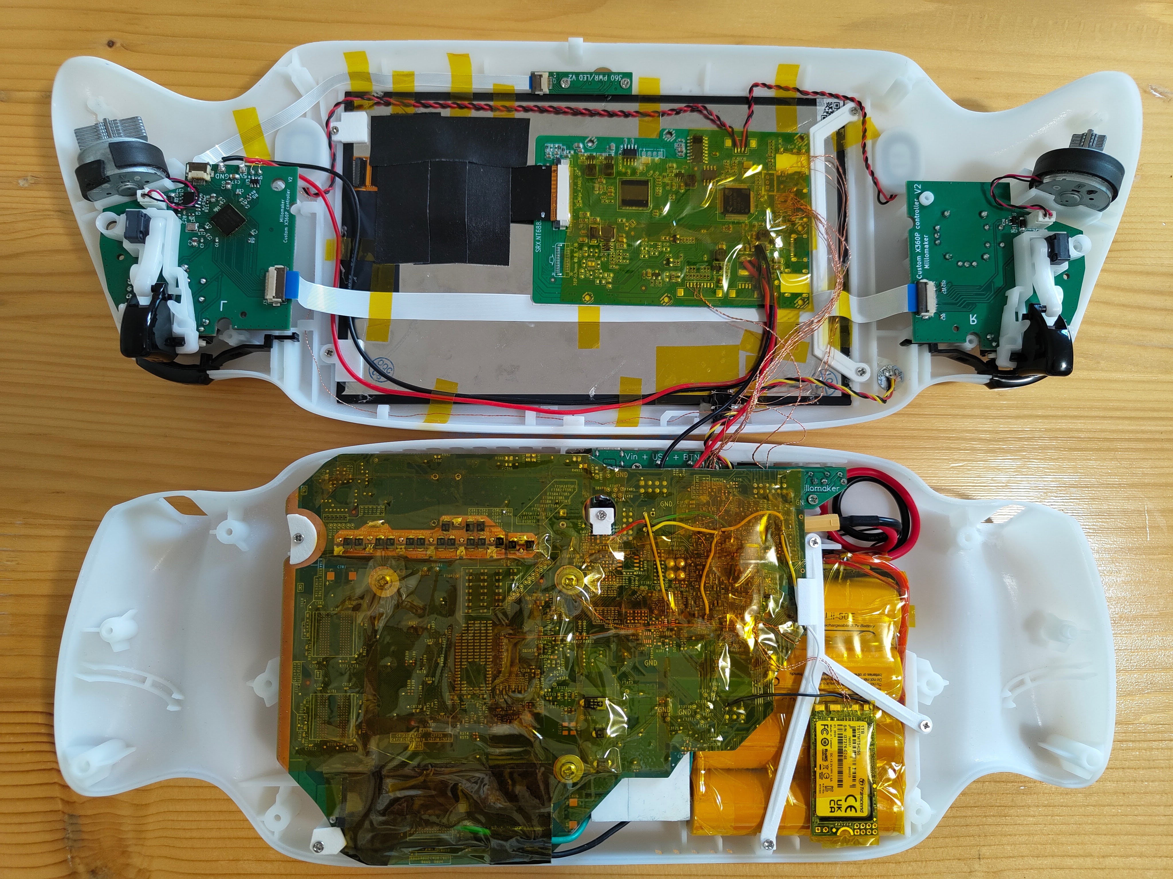

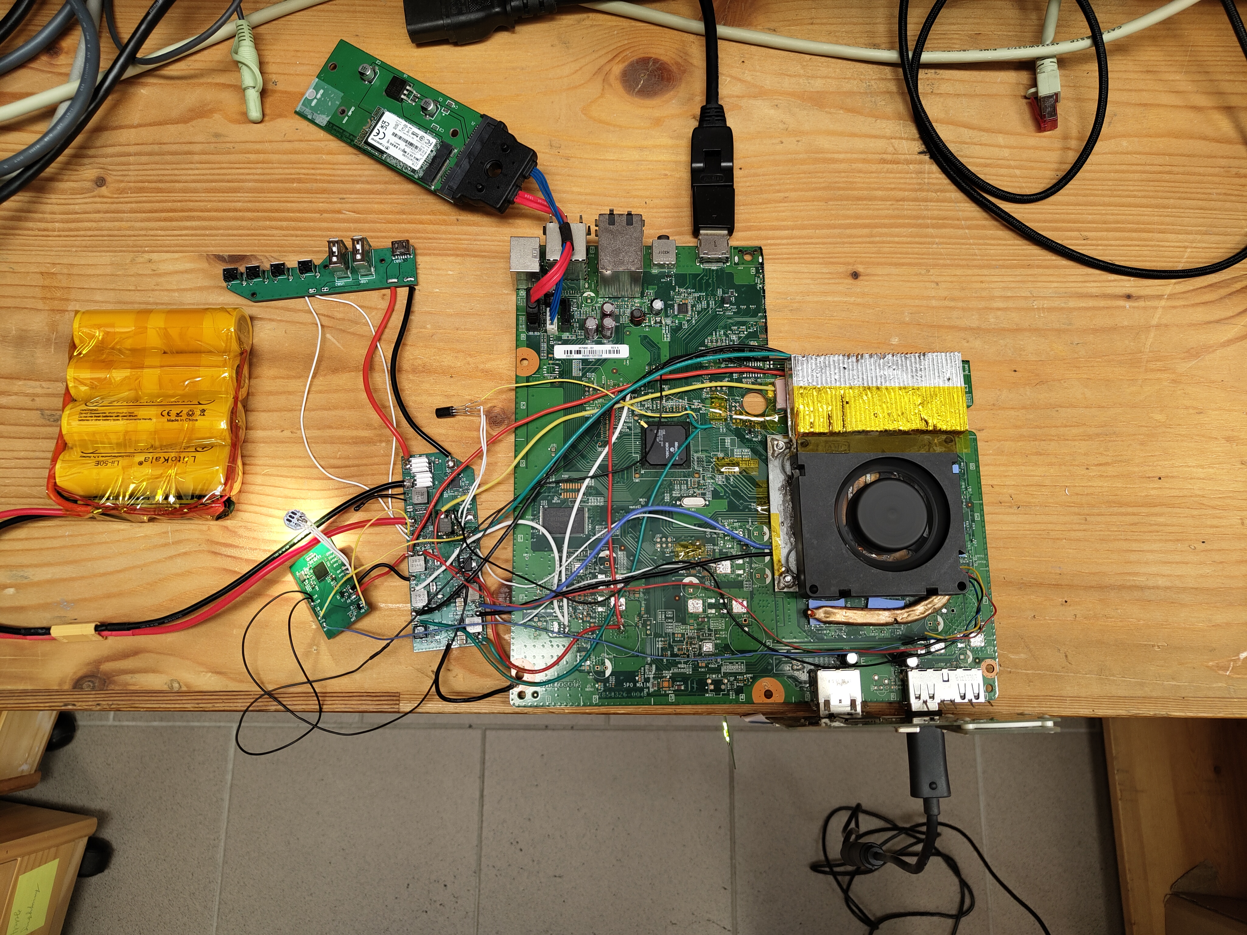

When I first saw that XBOX 360 portable from Benge I said: "Wow that's very impressive, I wanna build one myself". So I subscribed to his Patreon und studied all the files he provided for this project.
I also watched the whole series of videos (with translated subtitles because I can't speak french) where he discussed all the progress and failures of this project and after some weeks of work, it's finally finished. I present to you my version of Benge's XBOX 360 portable:
Here are some pictures of the build progress:
This is how it looks when it's built into the shell:
And this is how it looks when it's done:
This was a very long and challenging project for me and it still blows my mind that it's even possible. Thanks to @Benge for his hard work and dedication.
