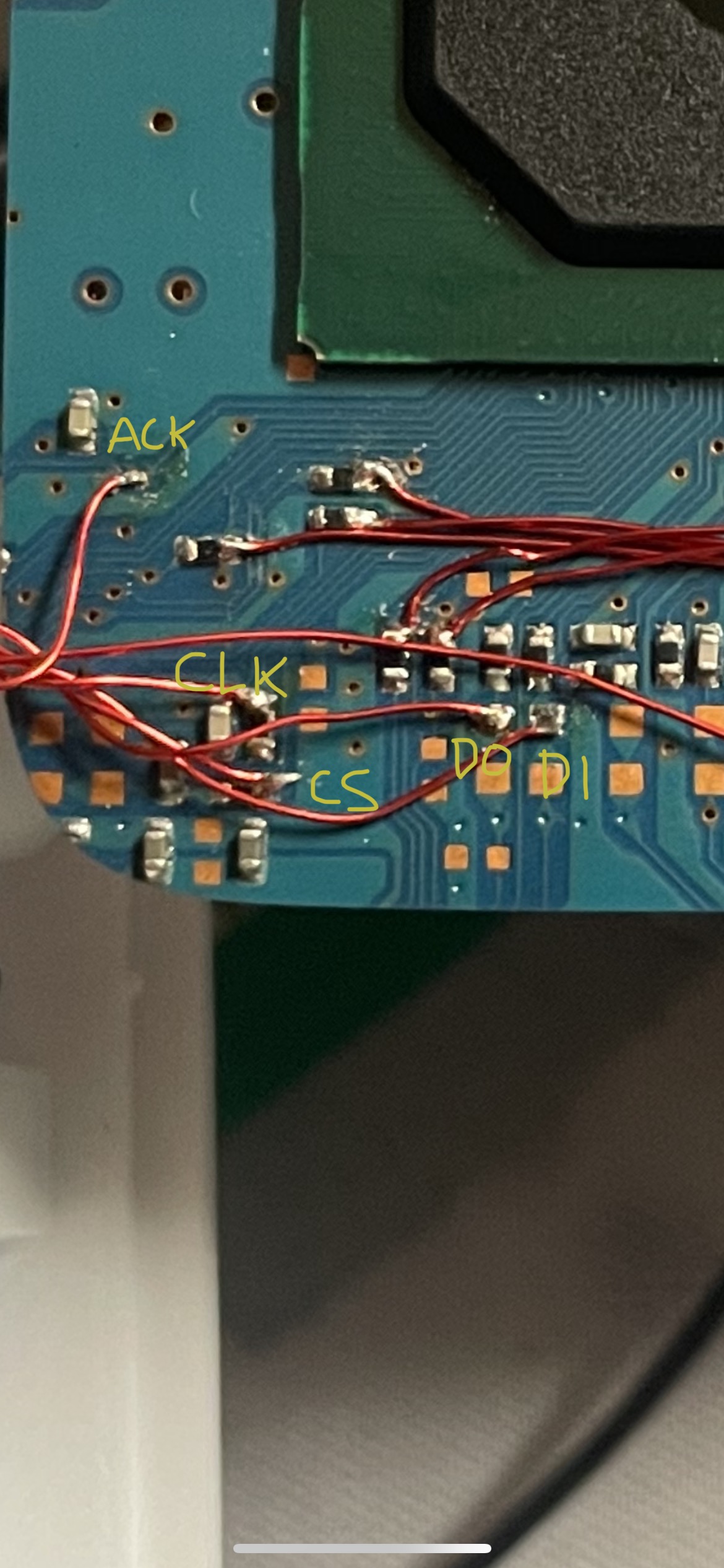

Good night I need urgent help, I want to know if for the controls to work you need to have these resistors? I damaged some while trying to solder the controls and now nothing has worked.

Can you upload a clearer picture? Also have you connected 3.5v to the controller? Upload a picture of the controller your using
yes connect 3v and 8v from the vibration and it doesn't work, i believe the reason is the resistors i accidentally removed

Do you have the joysticks connected to the controller? It will not work without them
I might be wrong on this, but I think you wired up the controller to the player 2 stuff. Also, I also think that you have a little too much copper exposed. One more thing, you don't have to solder the wires directly to the resistor. There are exposed copper pads you can solder to.
You need to clean up all those solder blobs also it looks like a lot of those connections are shorting, 8.5v is only needed for rumble. Here’s a picture of my wiring I’m using a similar controller hope it works.
You need to clean up all those solder blobs also it looks like a lot of those connections are shorting, 8.5v is only needed for rumble. Here’s a picture of my wiring I’m using a similar controller hope it works. View attachment 24975
friend I soldered in slot 2 to test, if you see in my photo I destroyed several resistors and capacitor, maybe that's why it doesn't work,
Yea I saw you’ll have to follow the connections higher up and solder directly onto the vías, scratch off the solder mask hopefully that works

I believe it doesn't work without the resistors I've already tested the control on but it doesn't respond to commands
