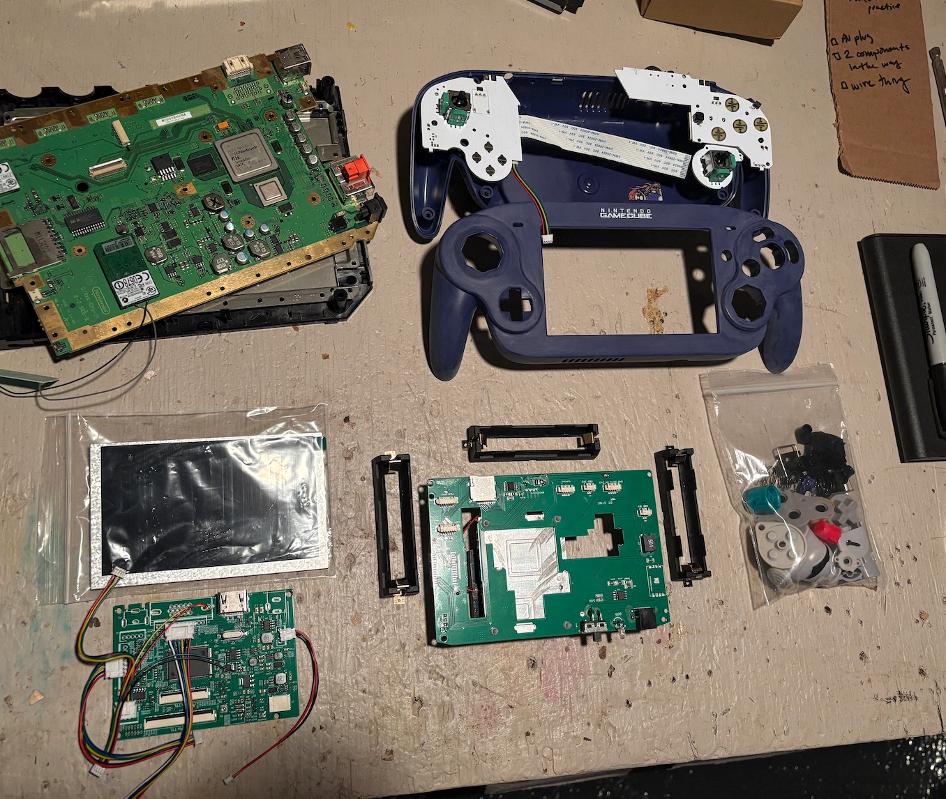

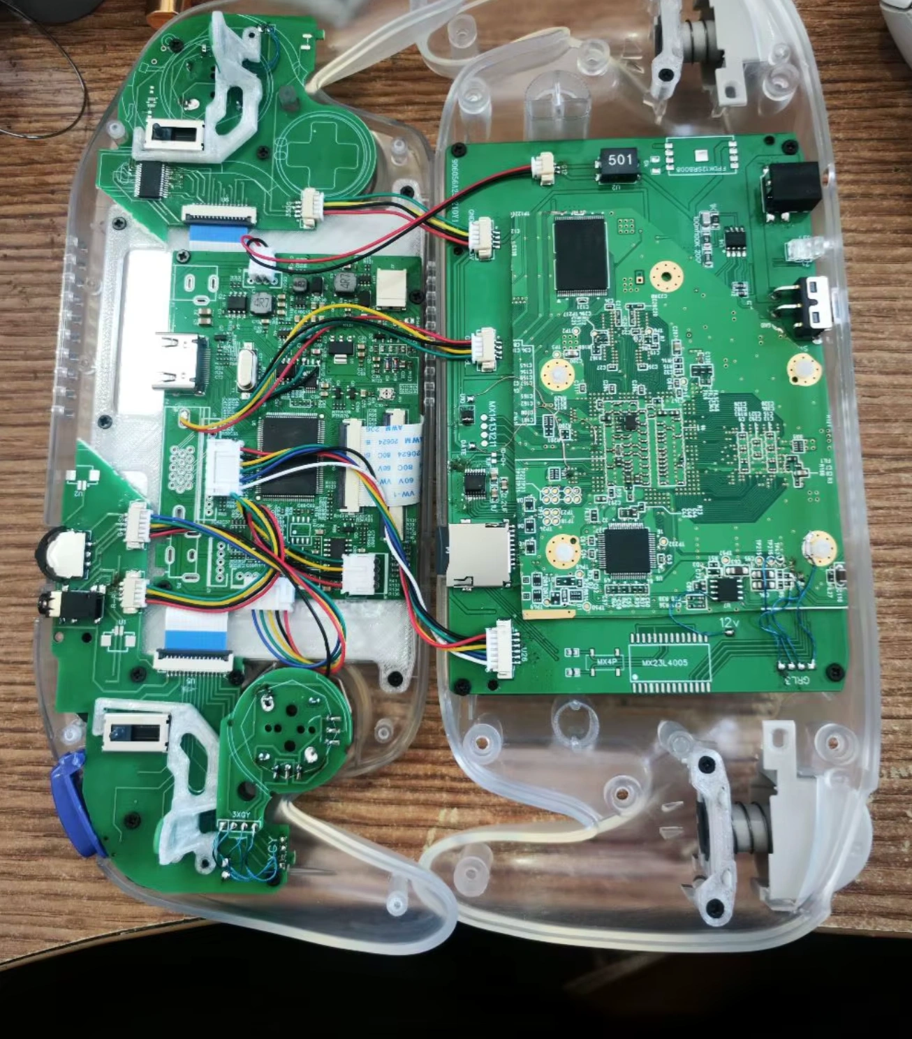

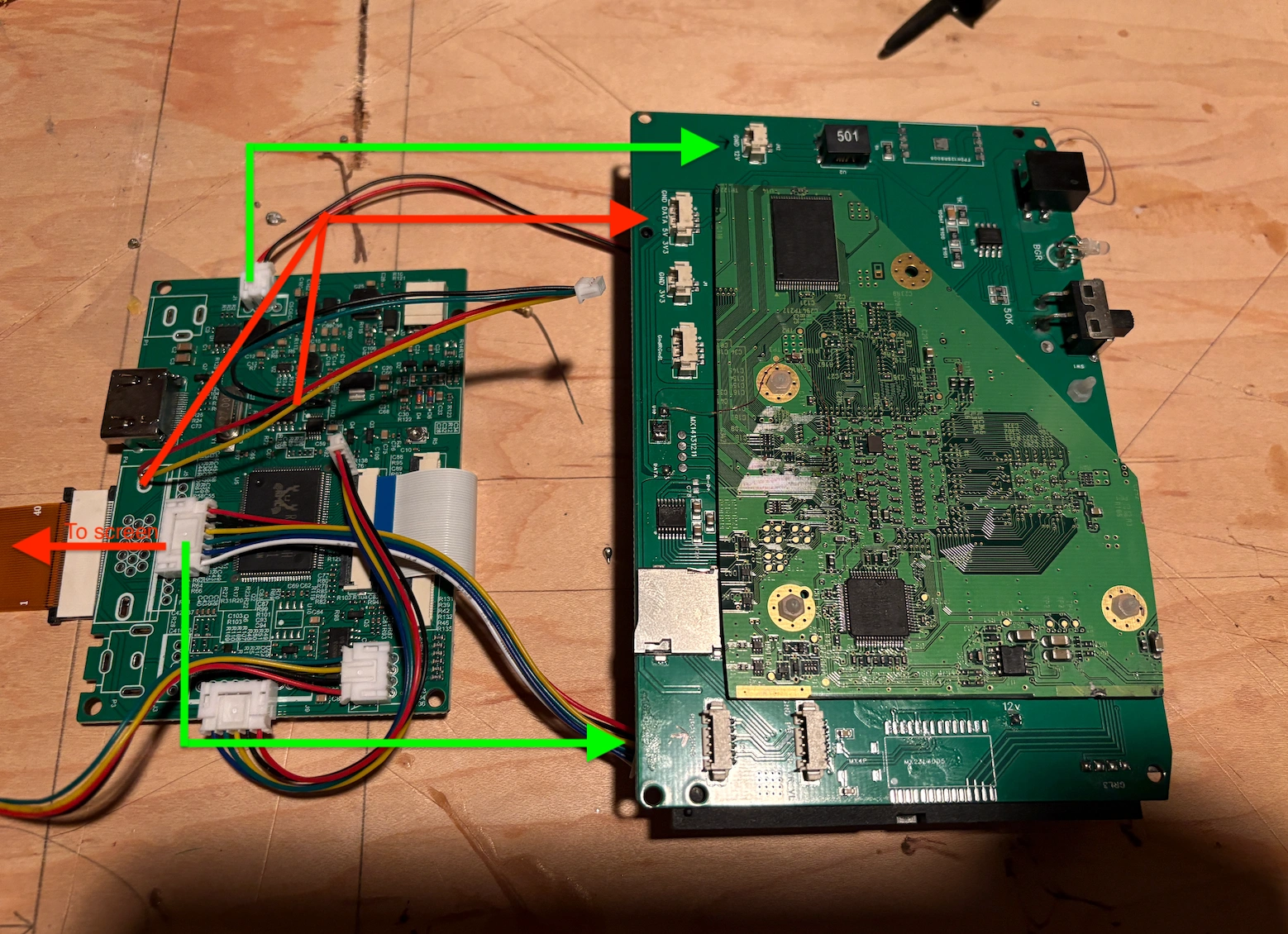

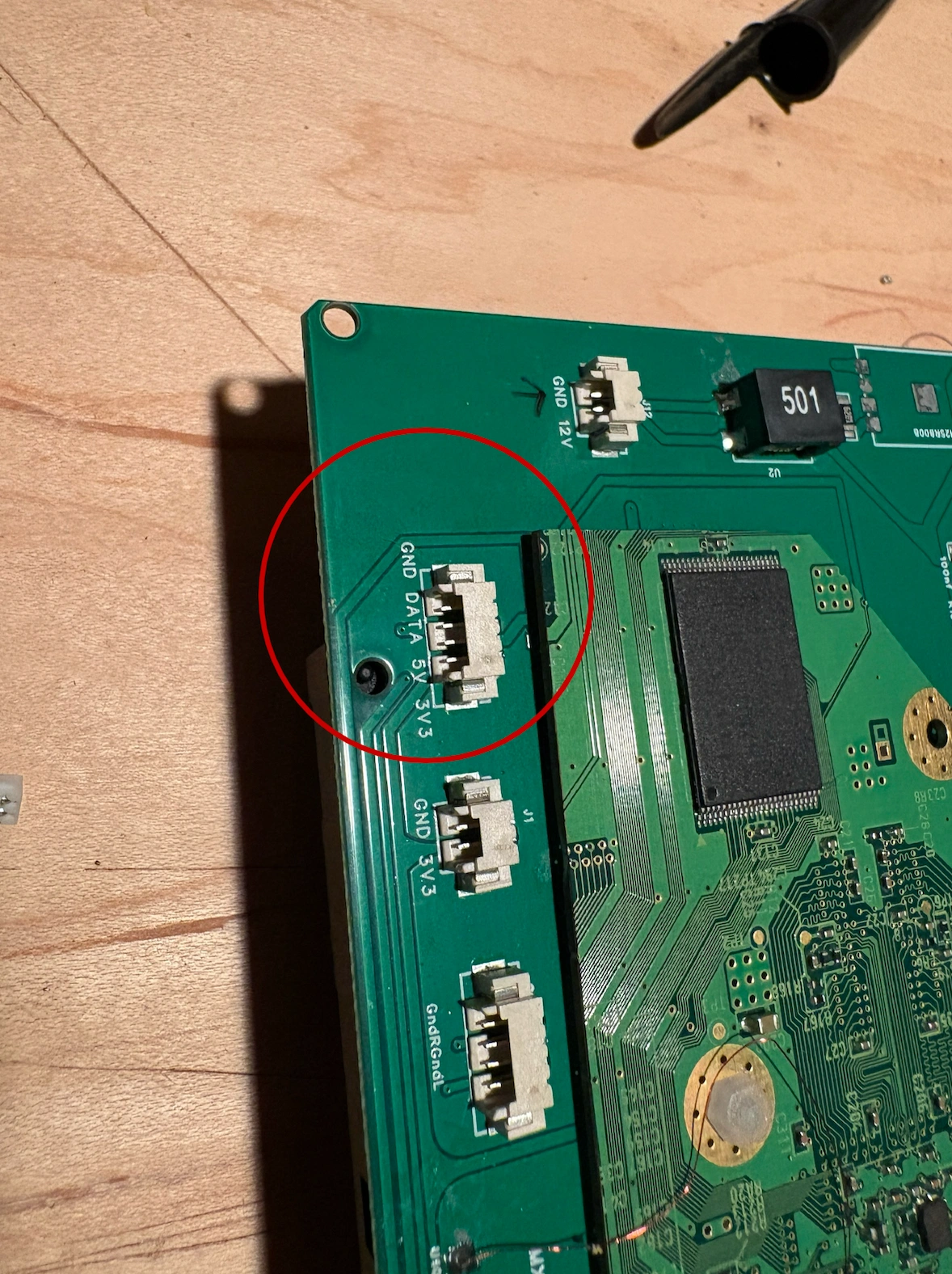

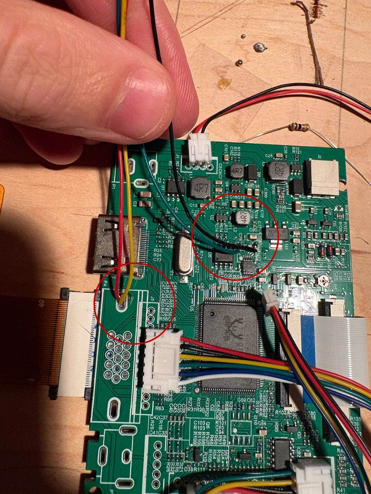

Hi all!
Starting a thread as I build my first-time portable. Fell in love with the Ashida but somewhere along the way I opted for the AliExpress components pathway (I think it came down to budget and getting a case I liked at a good price point). I've read all the 4Layer/Wesk guides, including full GingerofOz/Dubesintheshower videos and got a general idea of how components come together, but obviously the AliExpress components changes all that. I've been talking with them to get help but wanted to start a thread here as another resource for my questions.
Where I'm at: Need to clear coat my shell then that will be done, finished softmodding the wii, ready for the omgwtf trim.

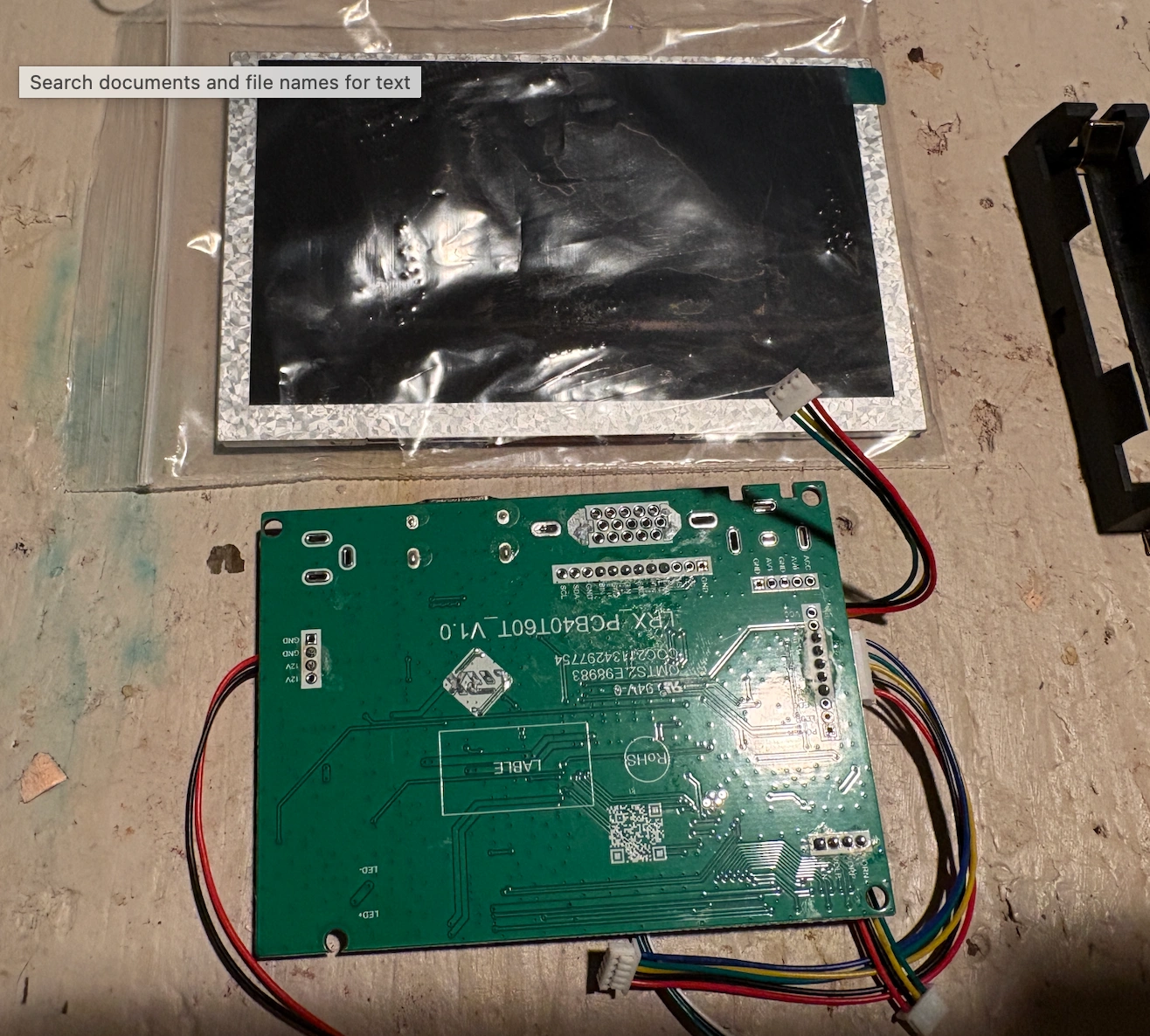

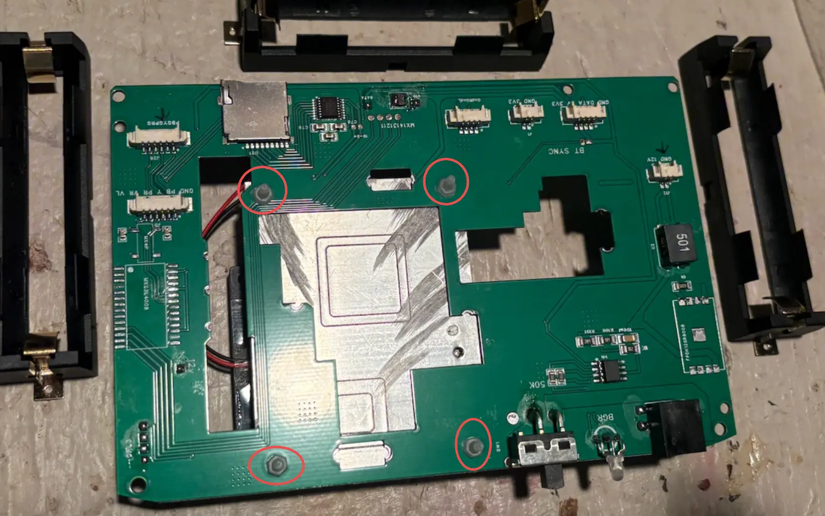

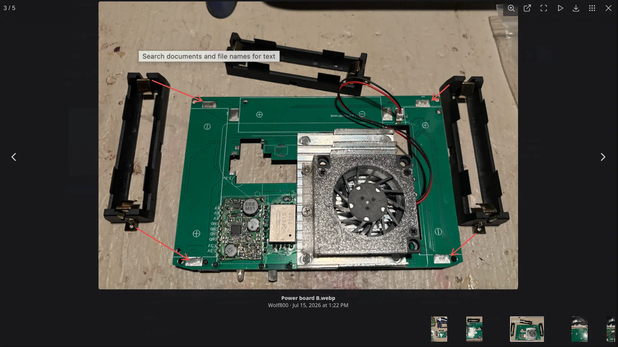

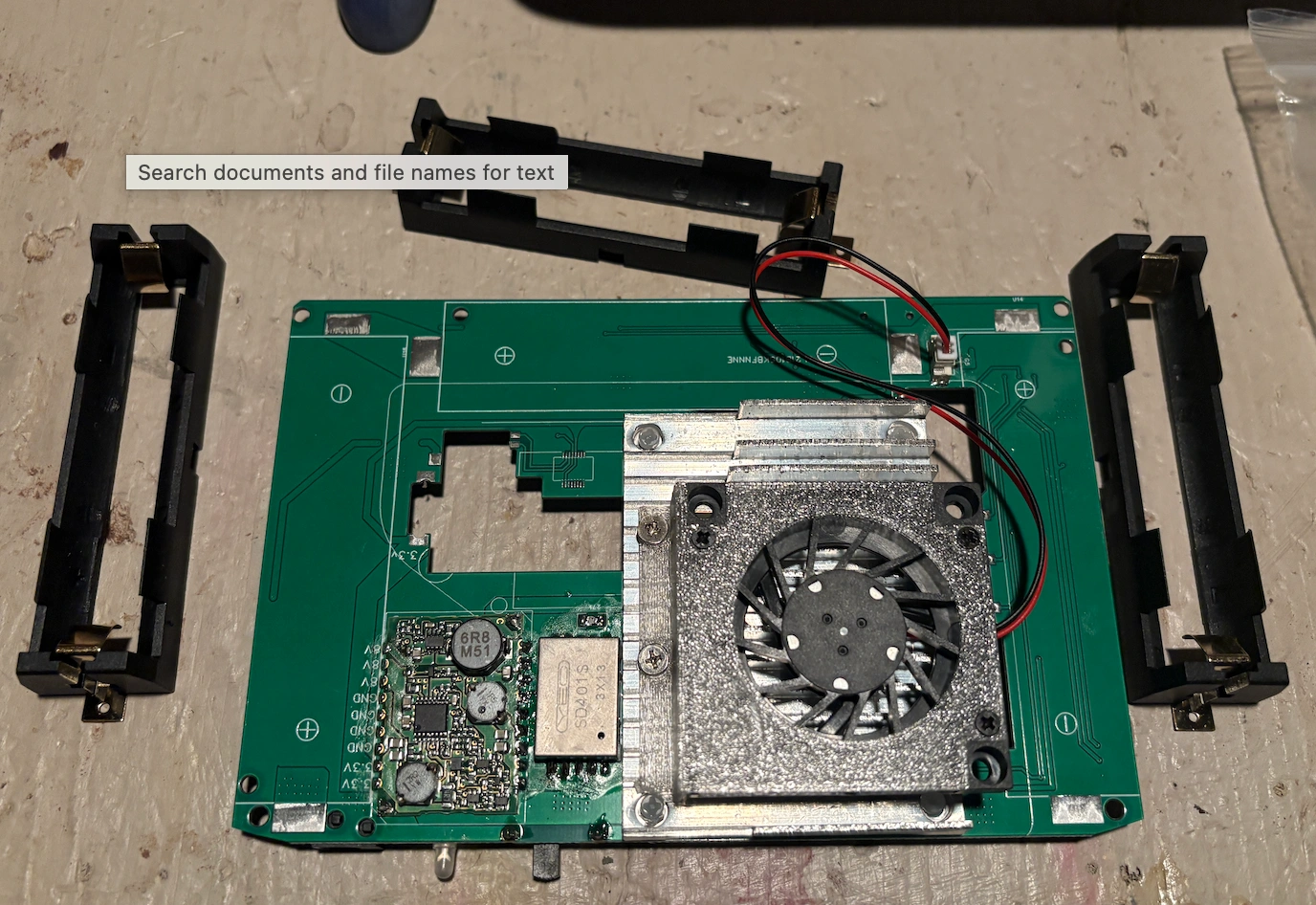

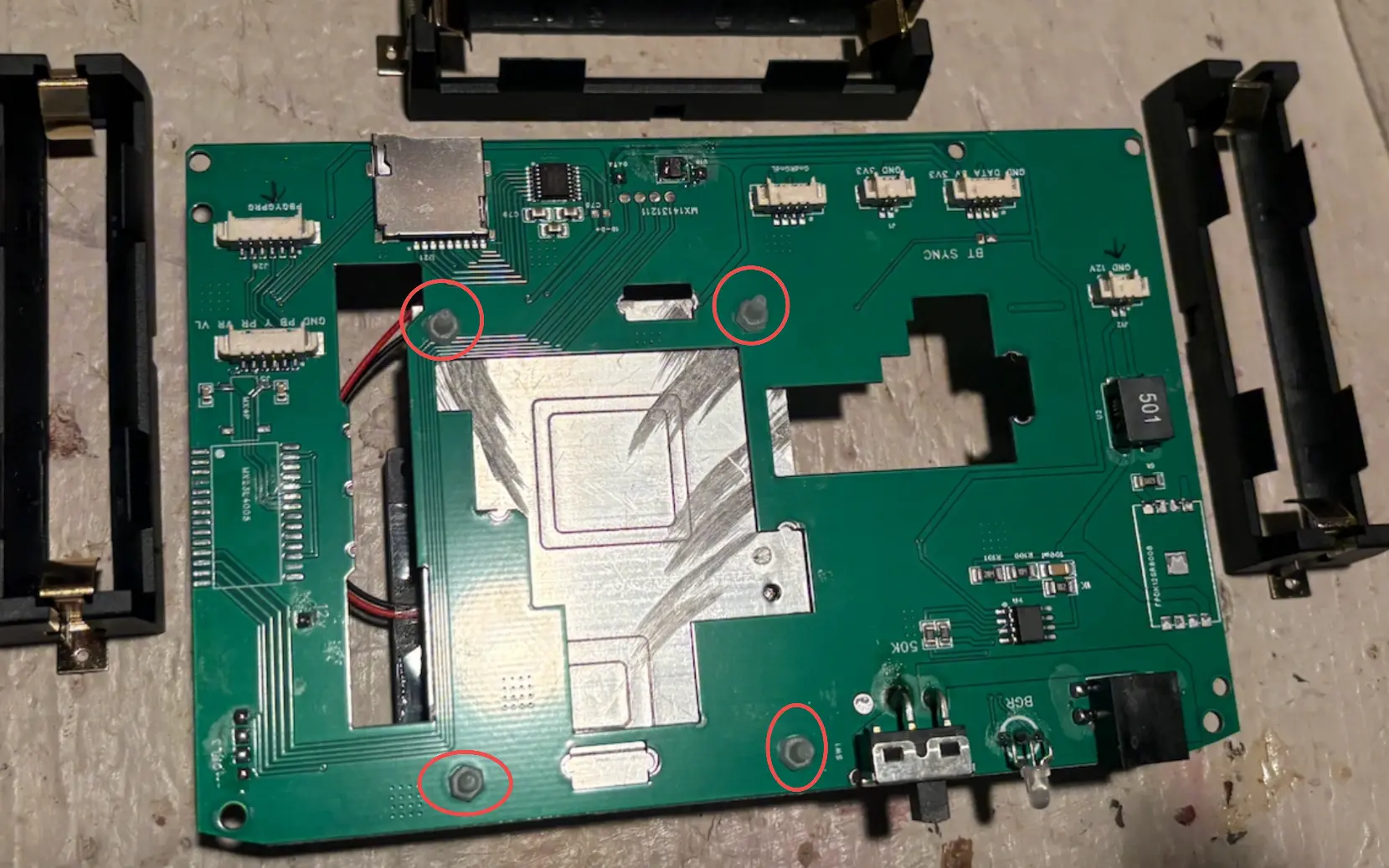

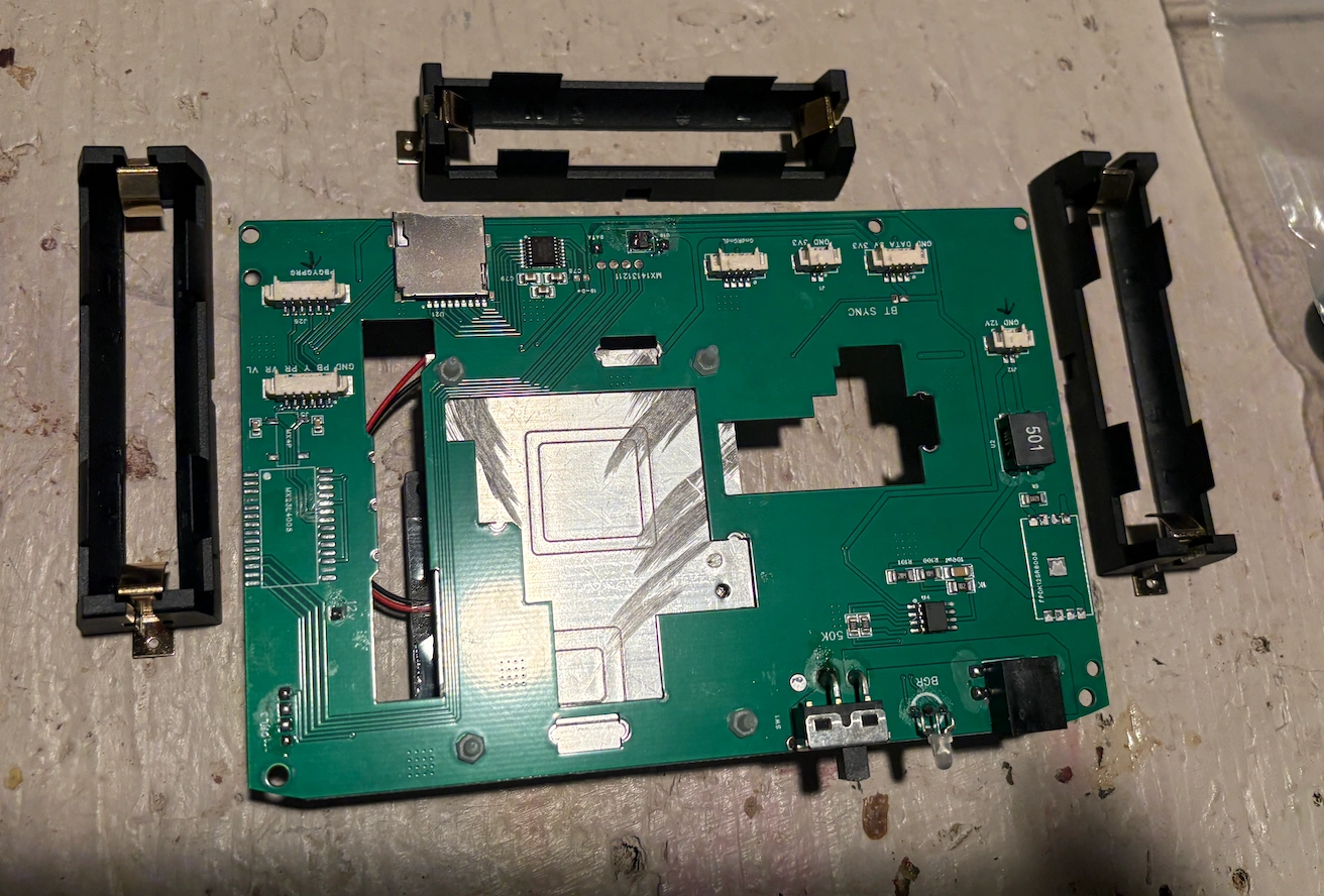

Anyway, below are roughly all the components I've sourced from the AliExpress store and I need help starting to get an idea of how these pieces are connected. I mostly am trying to figure out if the battery holders get directly soldered to the power board, and then how the wii board will get connected to the power board such that I'll be able to confirm the wii board works post-trim.
Thanks everyone! Wish me luck, and excited to work with you all!

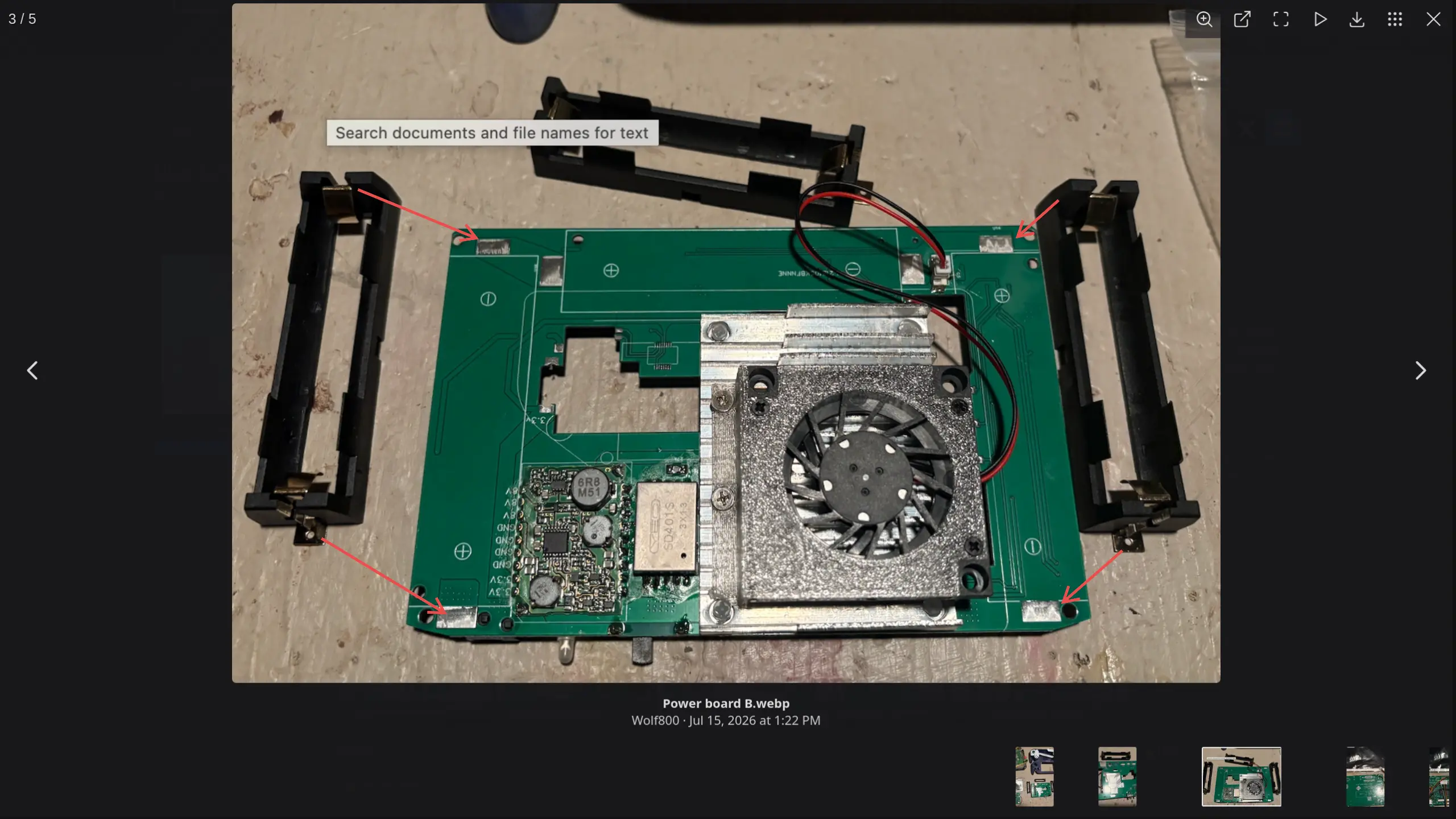

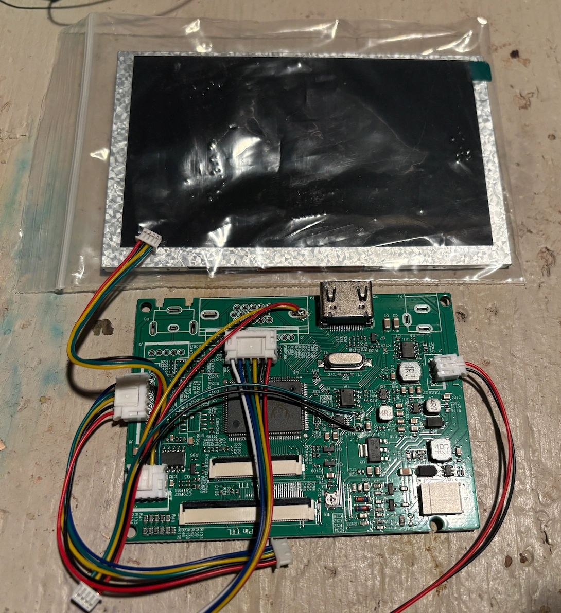

  • Screen:Driver A.webp
  • Screen:Driver B.webp
Hello and welcome!
It sounds like you're off to a really good start so far! It's worth noting that the Aliexpress Ashida doesn't seem to have too many (if any) worklogs on the forums (if there are any, I haven't come across them). This does imply we probably lack some documentation for this build, so there may be some things you end up having to figure out on your own. Having said that, the information found in the Wii trimming guide will still be very relevant as will information found in other people's worklogs here on the forums. I would definitely recommend checking out some user threads and the Wii trimming guide that I linked if you haven't already. I also made a Wii micro soldering guide which you can find here. It has great information, tools, and advice on performing the more challenging parts of these Wii mods.
To answer your question about the battery holders, they appear to solder straight to the PCB like this:
As for the Wii, it looks like there's a designated spot for it once it gets trimmed, it looks like the screw holes line up here:
I'm looking forward to seeing this worklog come together! It'll be another great resource for the community given that we don't have too many worklogs on this variation of Ashida and whatnot. Please remember you can always ask the community if you have a question, need advice, or get stuck on something.
Good luck!

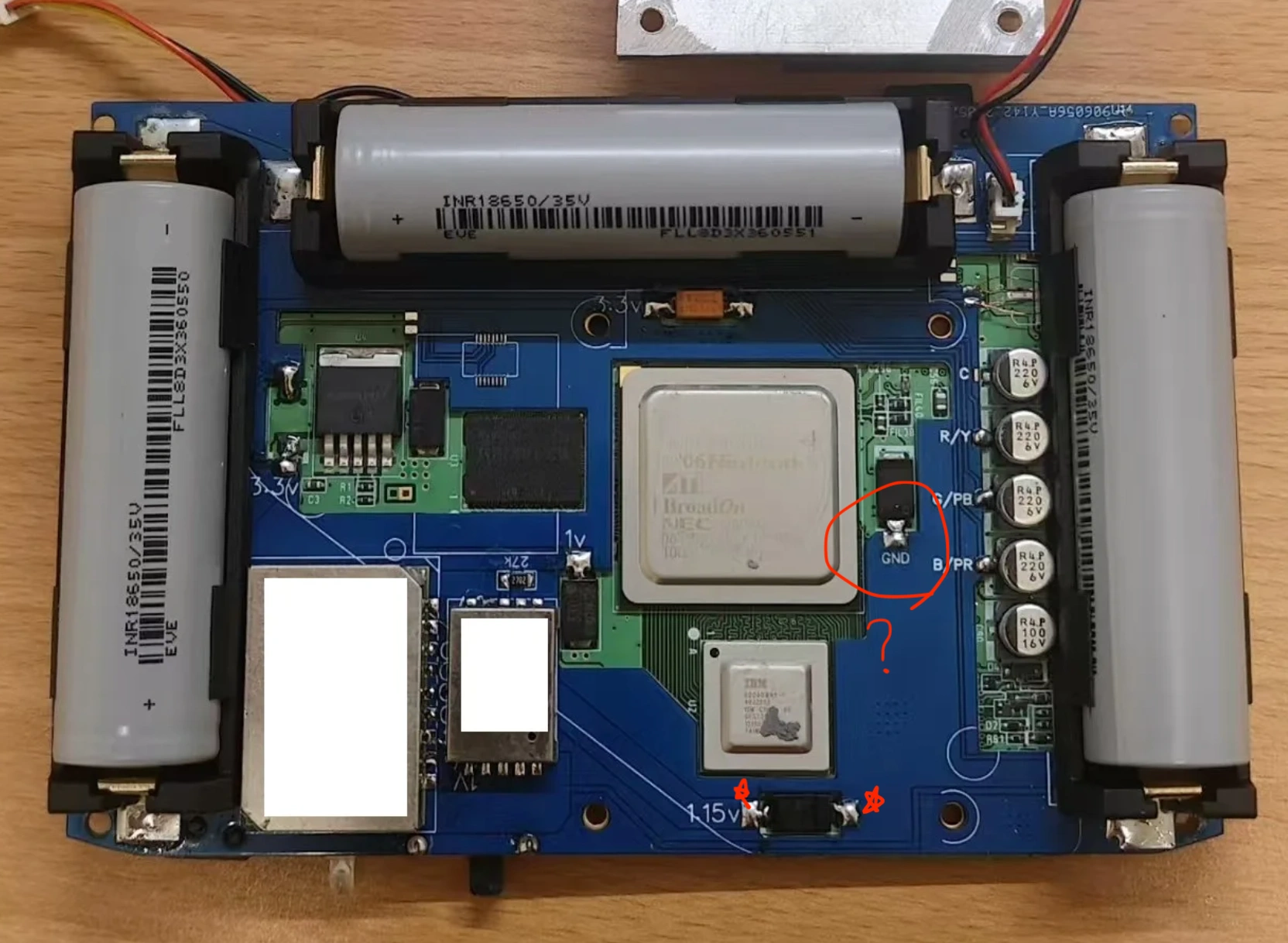

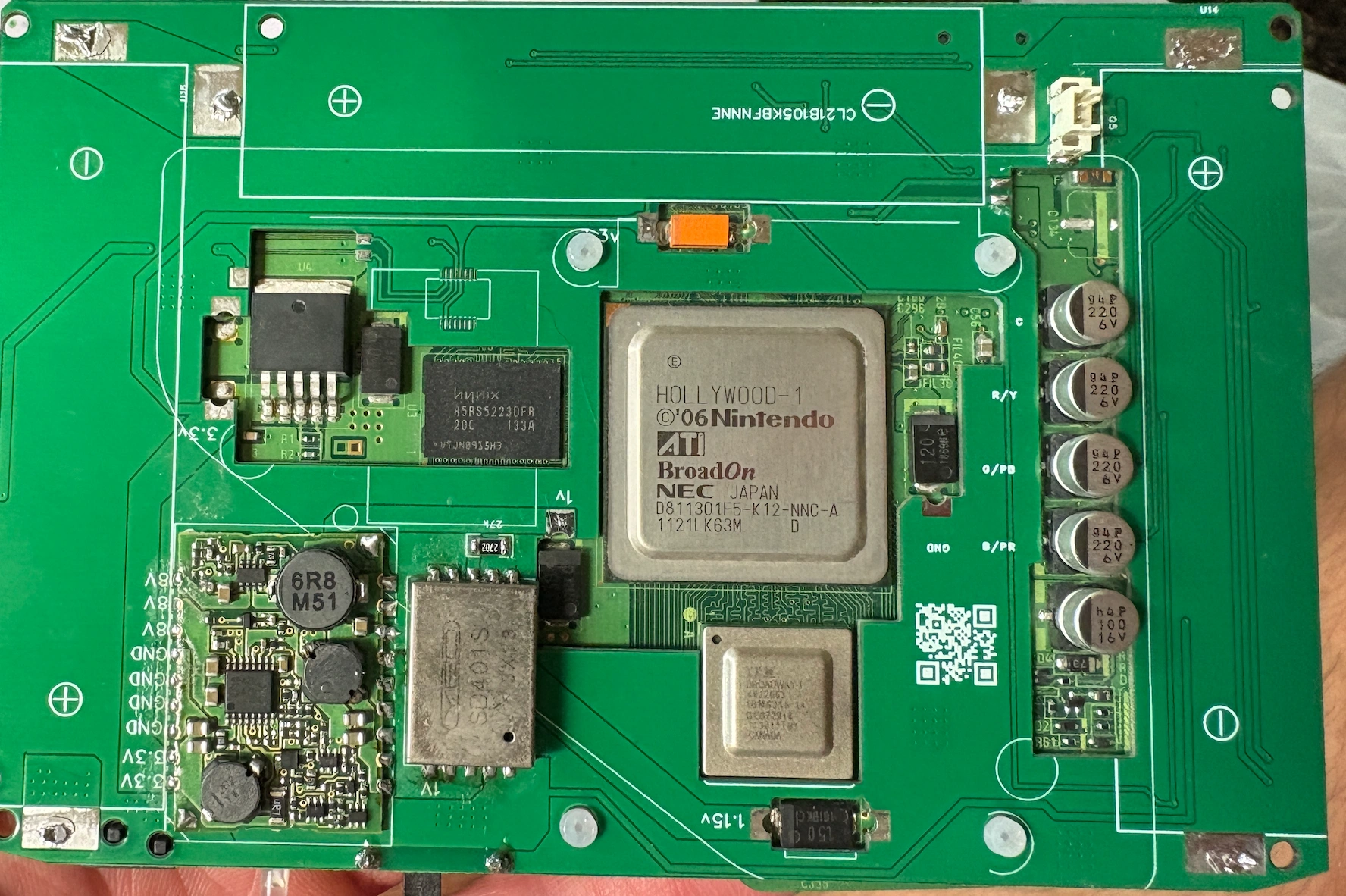

Hi all! Had a question/update: I'm about to trim the wii board, but trying to first get as best of an understanding possible with it's requirements, and I've been combing through the trim guide and videos, I've been able to figure out I won't need to relocate u10 with my board which is cool, and the board also has some nice placements with the other regulators making it a seemingly straightforward board-board install, but I'm getting stuck on understanding a couple things. The board pictured is the example from the seller's page, and you can see how they've wired the custom regulators but 1.8v is labeled GND and I don't otherwise see a GND wire. Also, I've see videos where they only solder a wire to one end of the regulator and in this case they've made connections on both ends for some of the regulators, does that matter? Thanks in advance for your help!

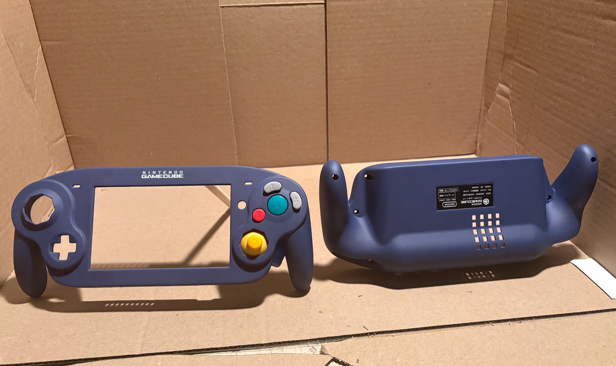

Fun part: Shell is done!
Okay slight update to my last question regarding the 1.8v vs. GND: Ohkin told me "1.8v does not require a connection. 1v, 1.15v, 3.3v, these three voltages are enough for the Wii to work" so it looks like the GND really does utilizez the 1.8v pathway does that sound feasible? I feel like I'm getting to the point where I should just full send and copy exactly how he has things soldered rather than trying to understand it all, pre-assembly. Thanks all!
Yeah that's fine. Every tantalum capacitor (the big black/orange ones) has one end connected to voltage and one end to GND. You can connect to just the GND end without issue. He probably did it that way so the solder joints would hold the all-in-one PCB against the Wii securely.
I forgot to comment on this when I first saw it. That shell looks absolutely beautiful! The GameCube stickers are such a nice touch!

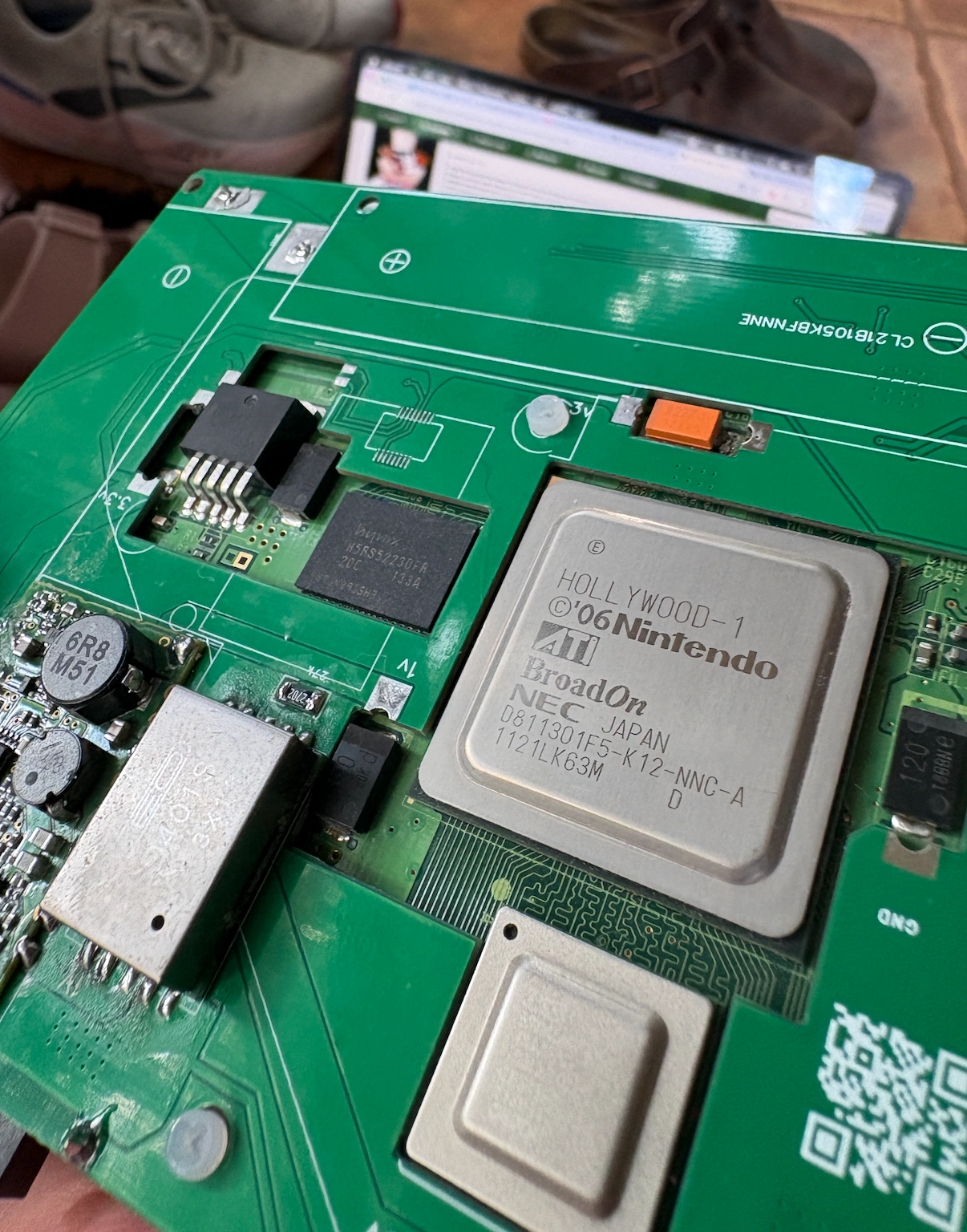

Things have been progressing well: I'm just about done reverse engineering all the solder points to the point where I can at least test the wii board, the trim is done and I confirmed the resistances based on the guide - so far so good!
Right now I'm just practicing basic soldering on the scrap wii boards, but I was hoping for some input on how to pull off the soldering: Based on Ohkin's pics, it looks like his pcb is directly soldered to the wii's voltage points, but when I dry fit my wii board to the pcb, there's still about 1mm between each board. I'm wondering if I were to just solder across that space does anyone foresee any issues with that? I'm curious if anyone has suggestions on how to do this as simply/cleanly as possible without gobbing it with a ton of solder and potentially introducing shorts. Thanks all!

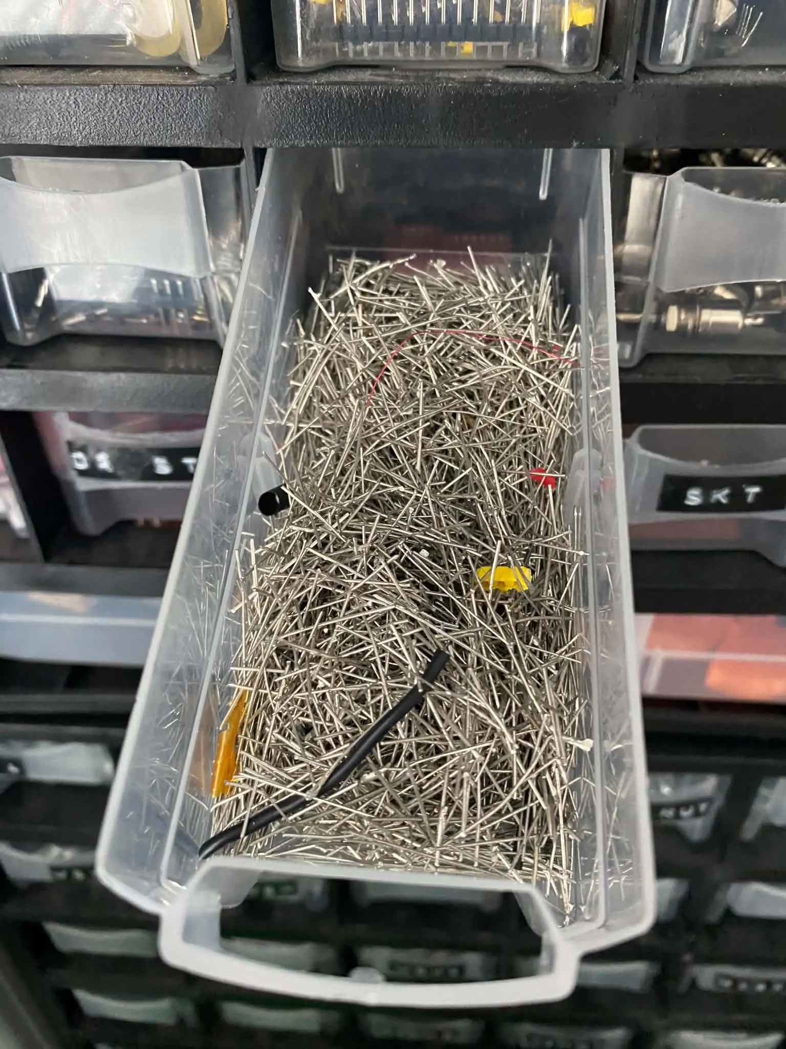

I'd prob suggest using some component lead clippings (like from through-hole resistors and such) to bridge those gaps. It'll make it much easier for you and provide a stronger mechanical connection for the solder, preventing cracked joints later :)
I personally save mine for special occasions like this lol
