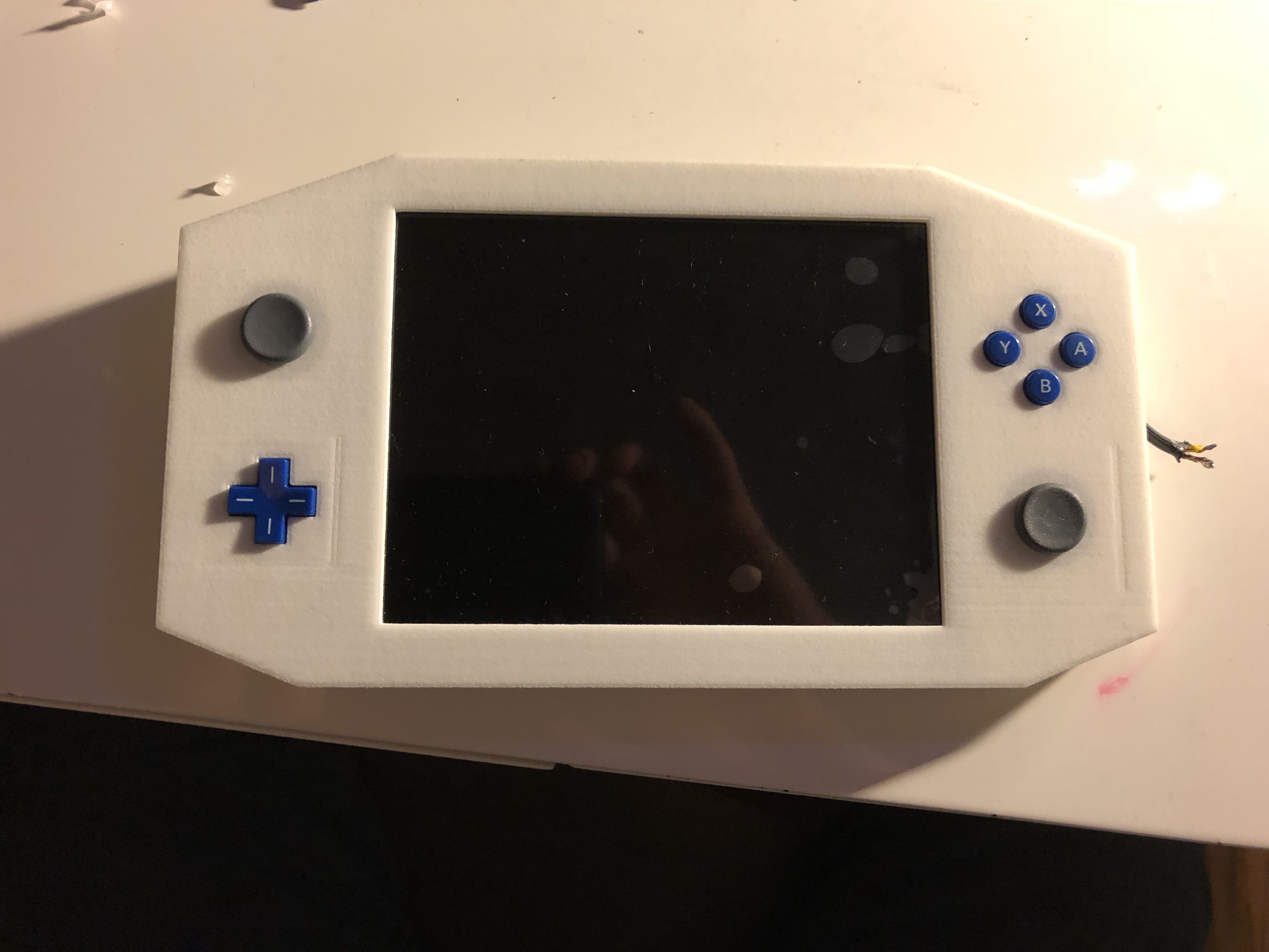

They finally sent me the right buttons! They won’t stay blue like this. I plan to paint the portable like a snes controller, so the dpad will be painted gray and the face buttons will be painted the right blue and light purple.
Speaking of which, how do you guys recommend painting buttons?

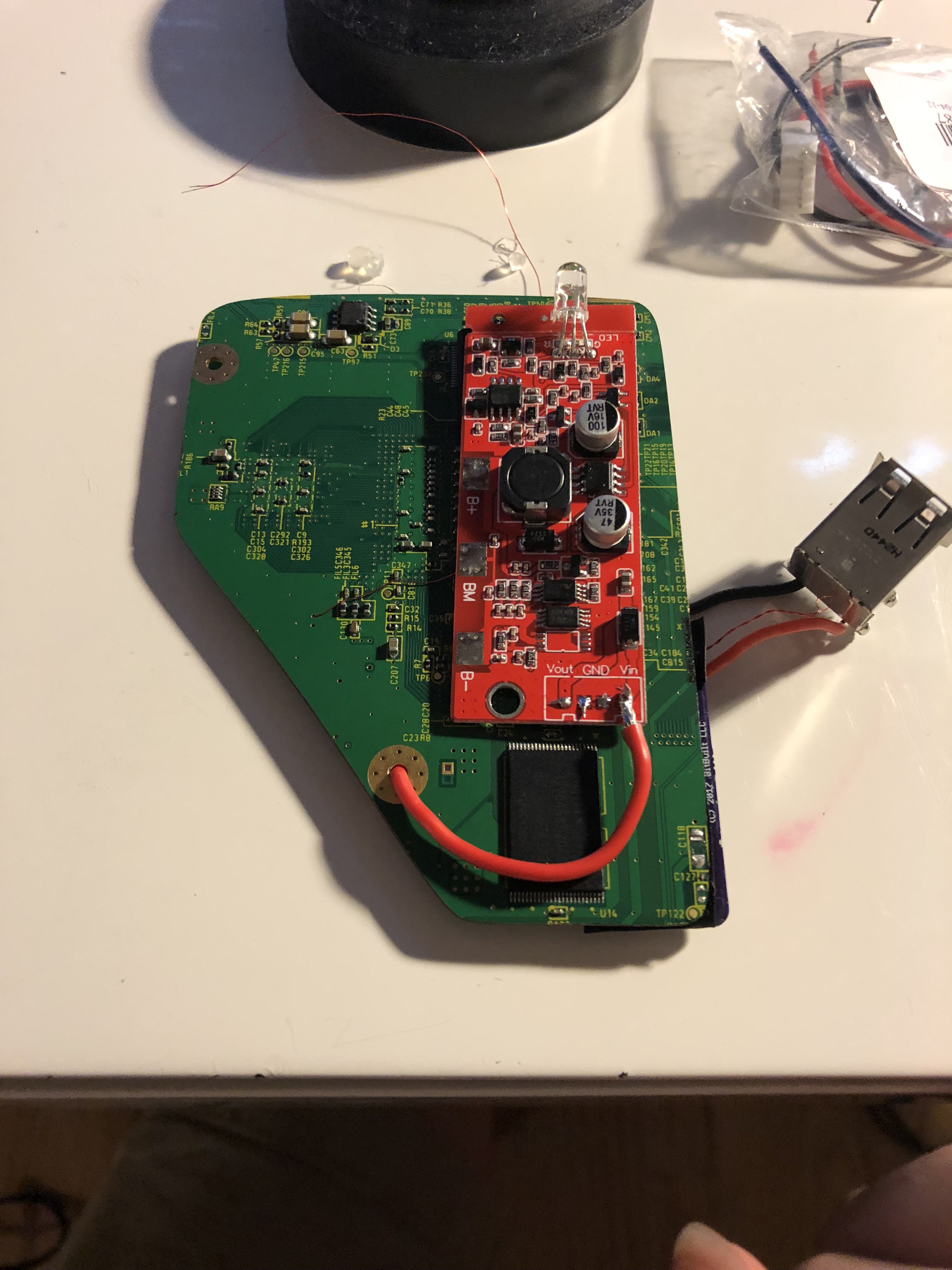

Battery board.

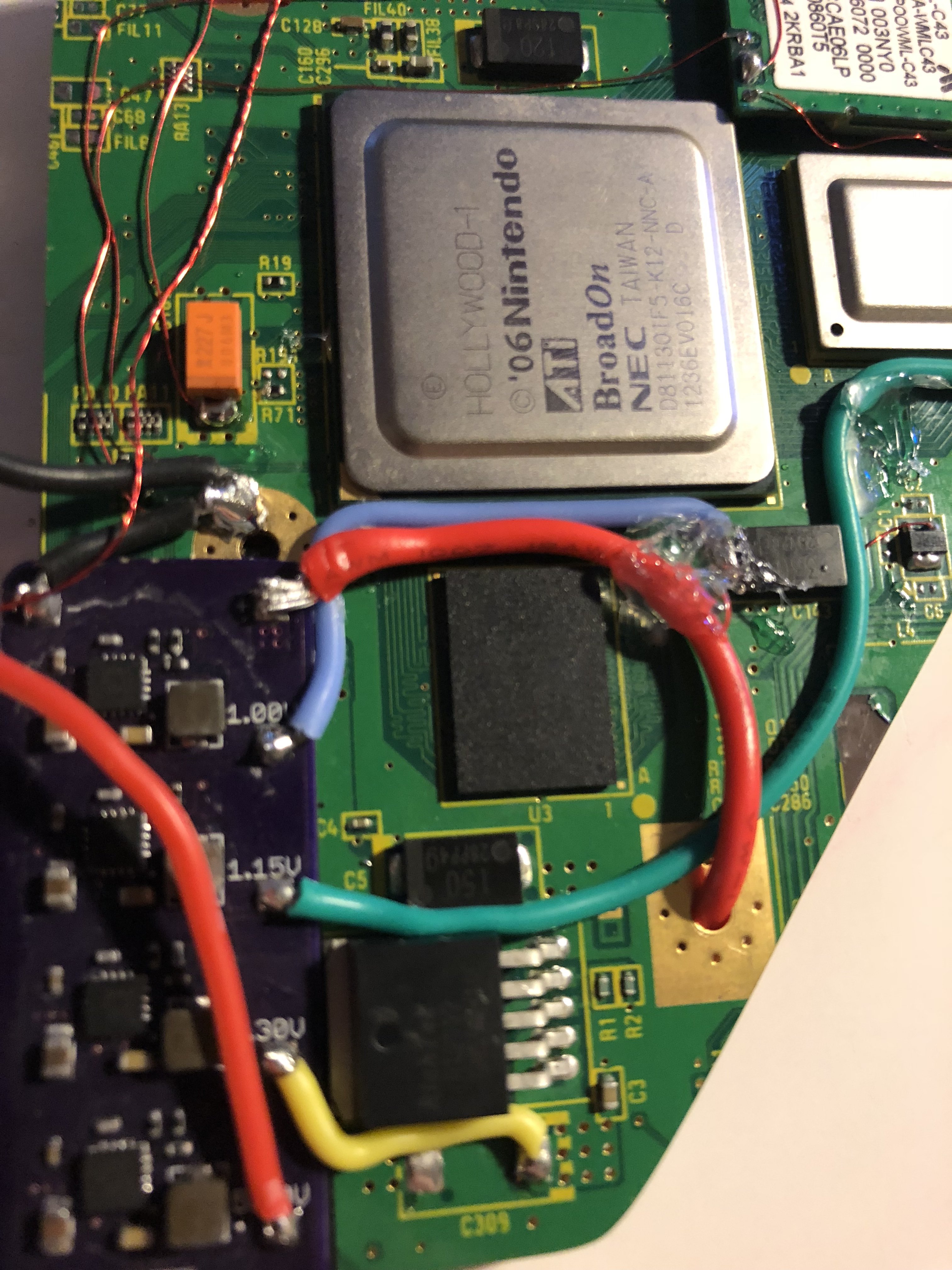

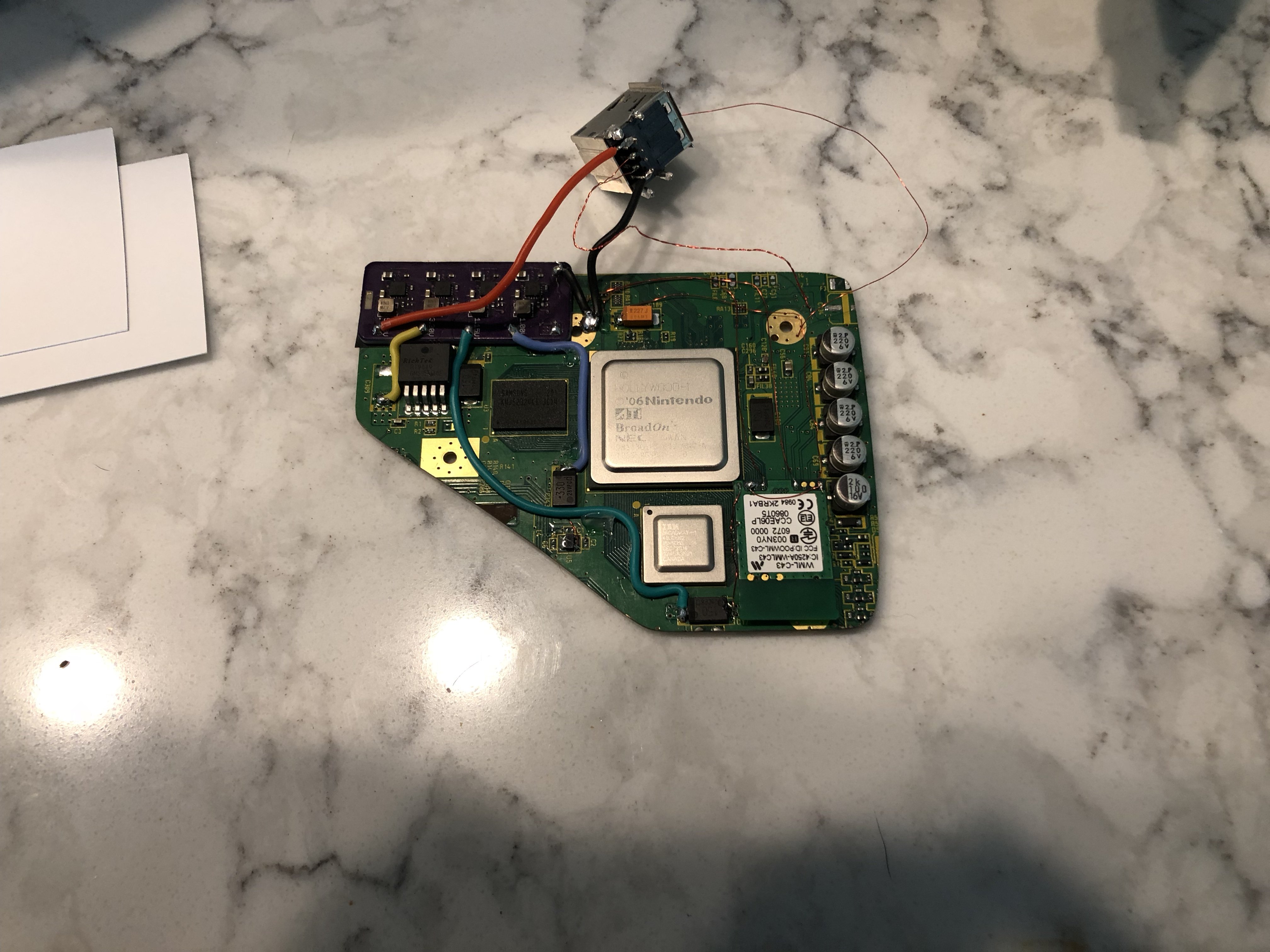

I actually went ahead and started adding it to the Wii. I held off on doing it, or touching the Wii at all really, because I’ve been so afraid of fucking it up, but tonight I went for it. Here’s the other side:
My connections look a little sketchy, but I think they should be alright?

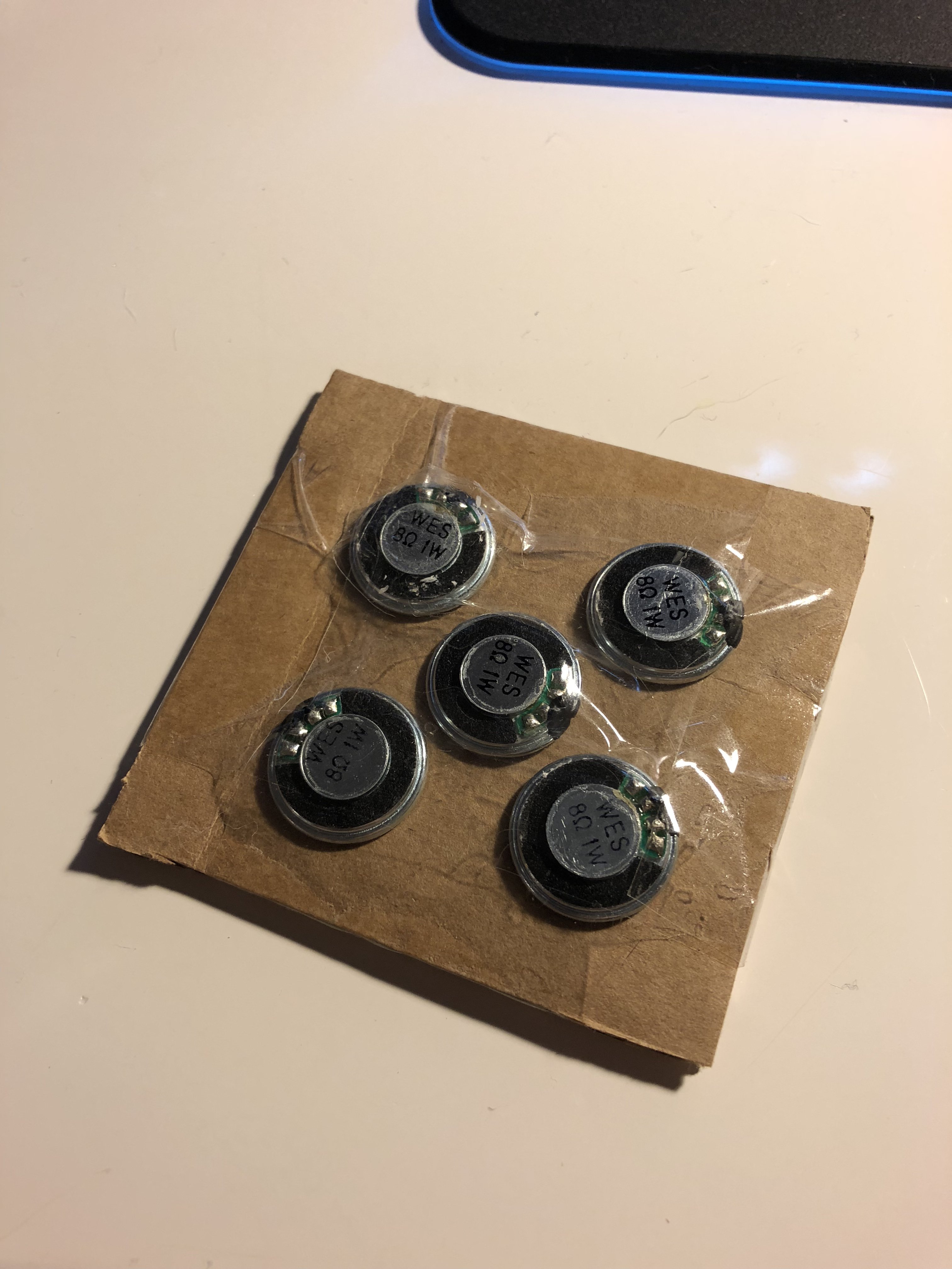

Speakers.
Actually used one to softmod my 3ds :XD:

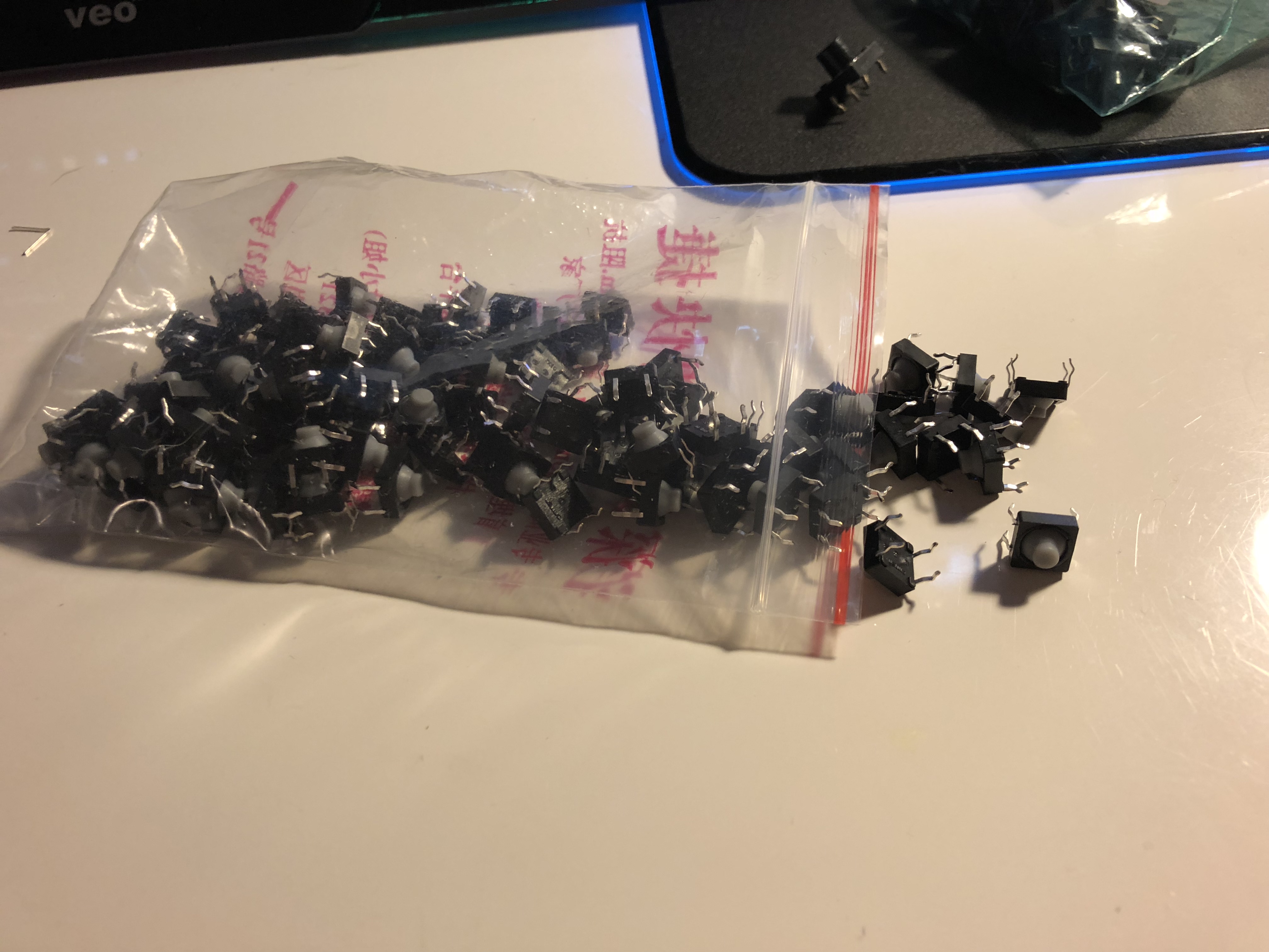

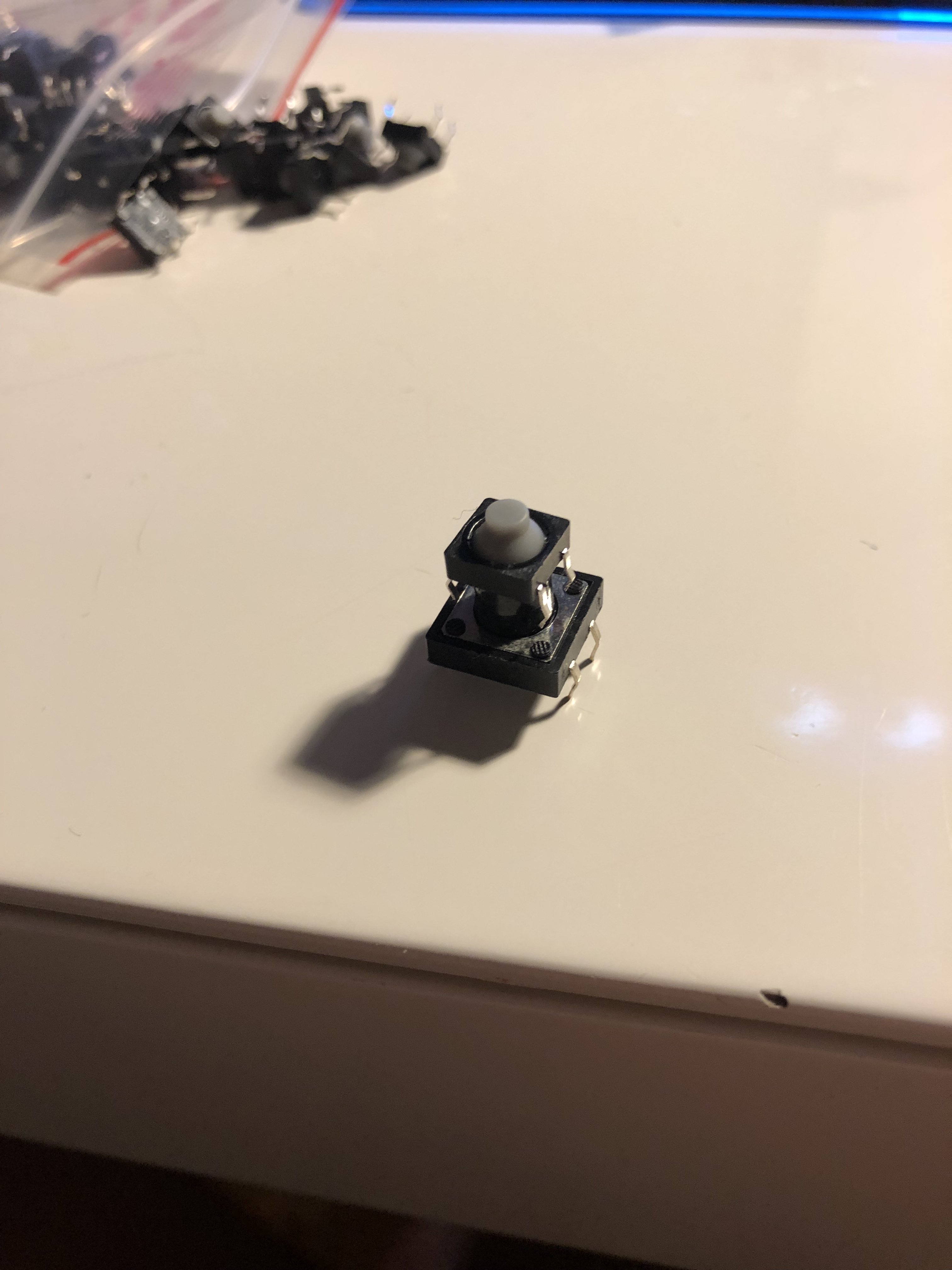

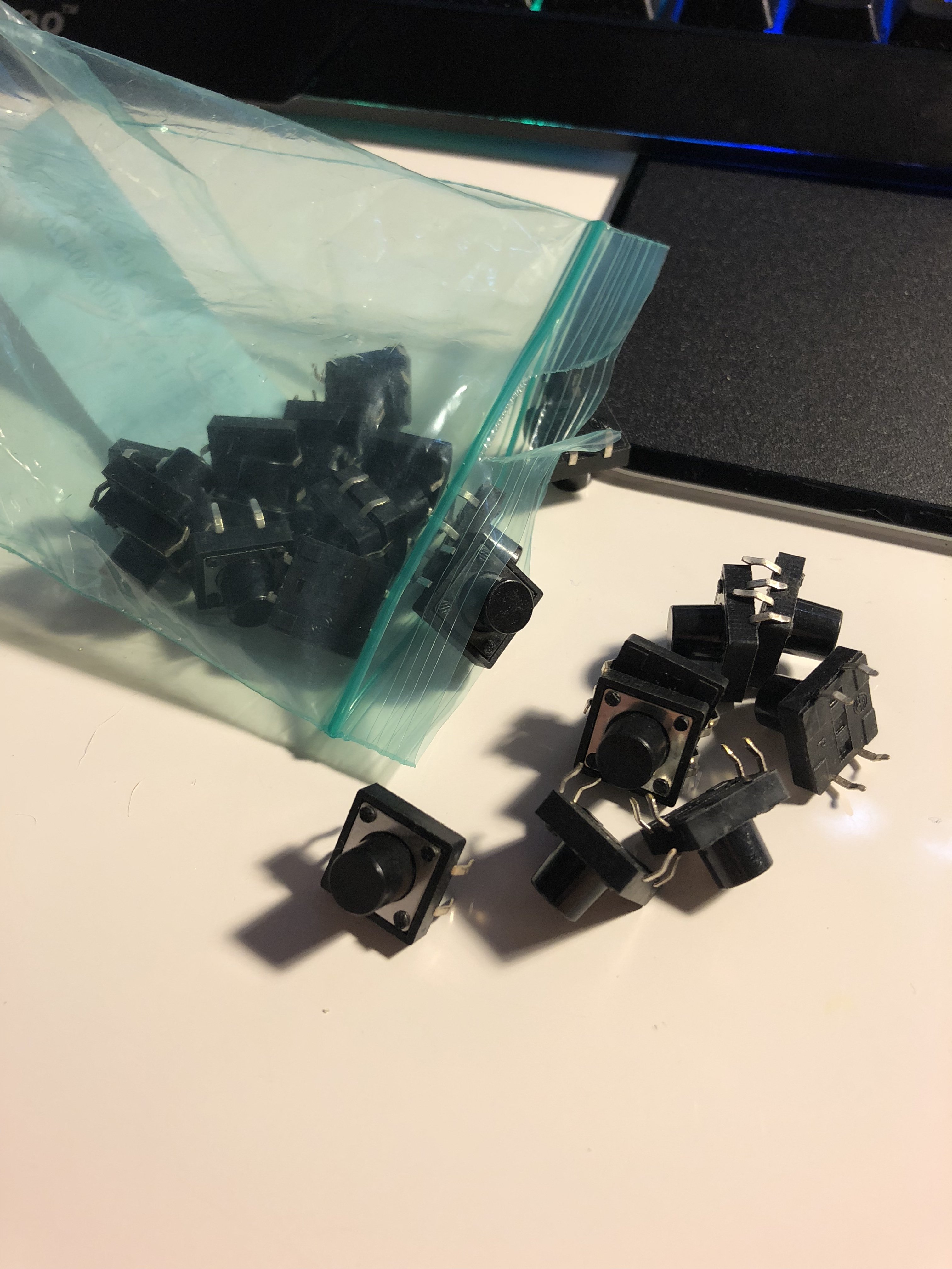

Tacts.
A lot bigger than I was expecting. They should still do the job.
Squishy tacts.
The orange ones on the BOM have been out of stock or discontinued or something for a while now, so I had to go with these. They seem fine, though.
These should make for a decent dual-tact mod.

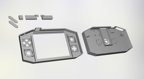

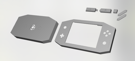

Been working on the case a ton recently, just refining little bits here and there, and I'm almost ready to call it finished.
Here is what it looks like as of now:

I've made a ton of changes since the most recent version. The two most prominent changes, however, are the mechanisms for the shoulder buttons, and the thiccness of the backside.
I'll start with the backside, since that has the most changes.
Like I just mentioned, the backside is significantly thicker now to make room for the battery holders:

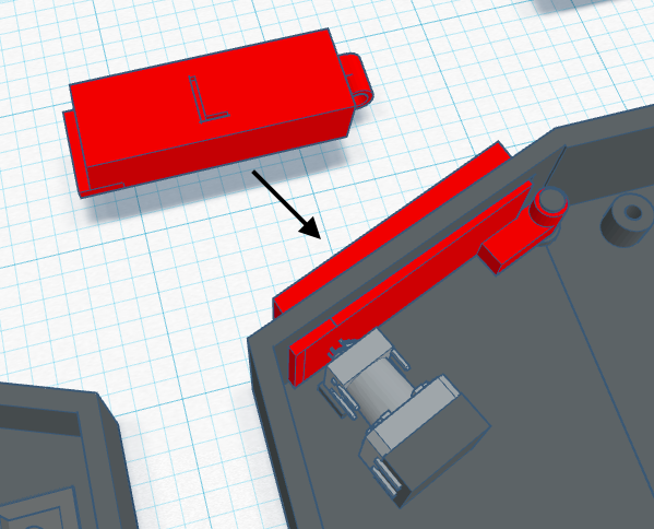

It also gave me an excuse to work on fixing the shoulder buttons, which actually WAS difficult.
Kinda shamelessly ripped it off of a bunch of other portables, but I think it'll work way better than what I had before.
... I just realized now that there's no easy way to get it attached GOD DAMMIT!
Guess I have yet another thing to fix!

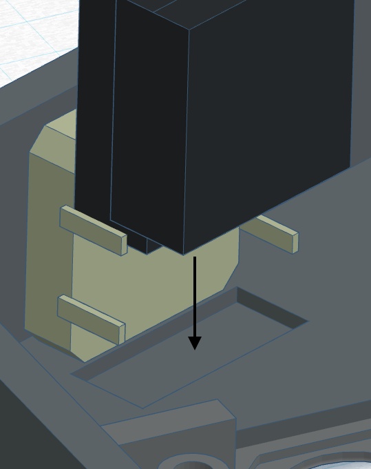

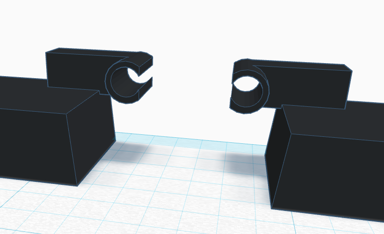

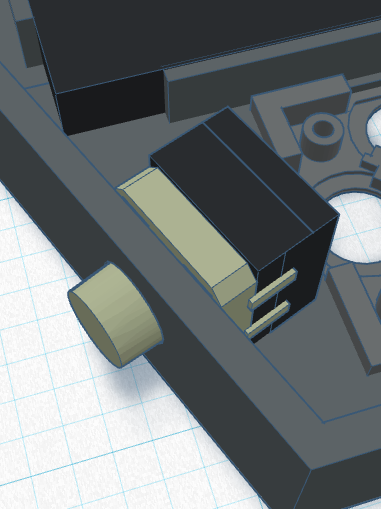

Onto the front, the only thing I changed was the Z button.
For the sake of simplicity, I'm just gonna have the Z button be a tact switch. I'm gonna put it where it needs to be, and slide a piece of plastic underneath to hold it in place.
Screen Shot 2018-09-24 at 12.36.18 PM.png Screen Shot 2018-09-24 at 12.38.08 PM.png

There we go.
Ideally they'll just snap on.
That should do the trick, right?
