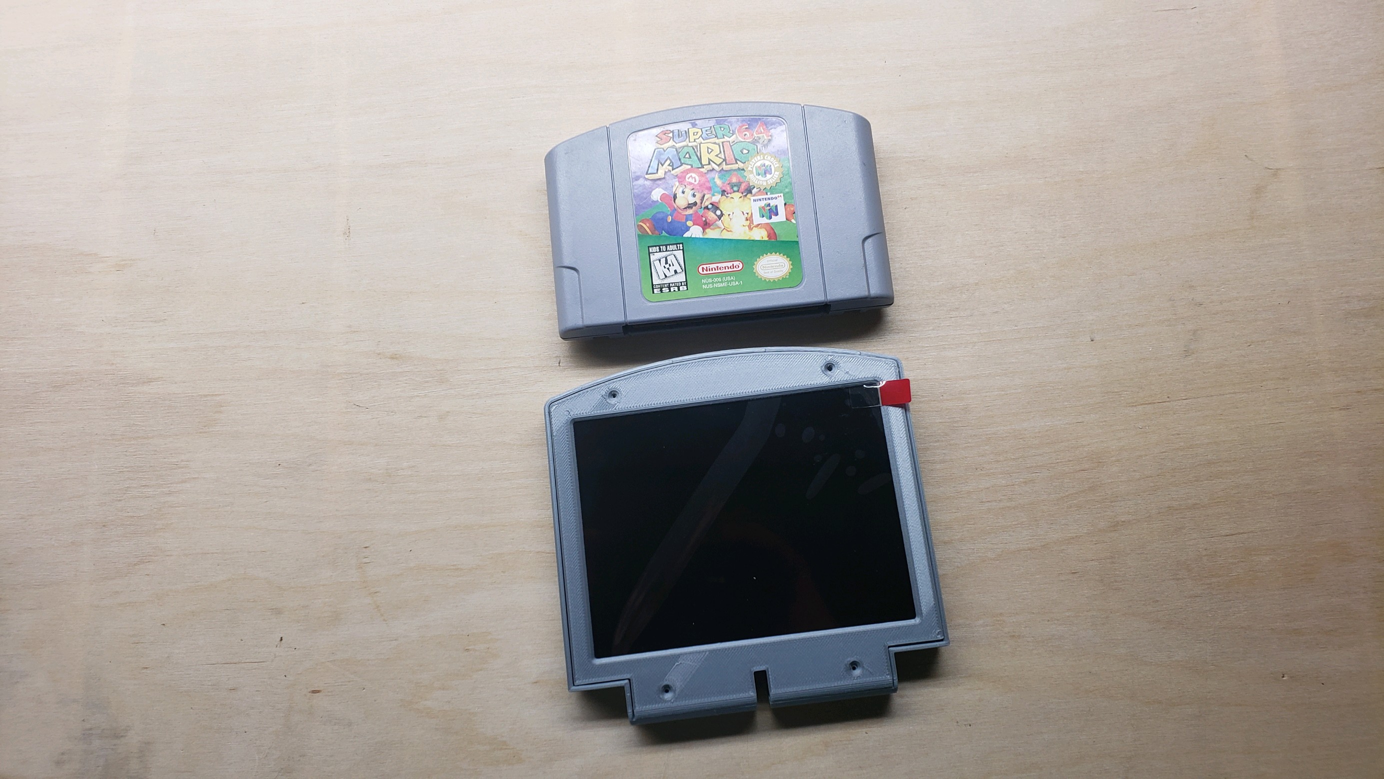

I like this screen and I like this filament
amazing, 5 inch screen?
and filament is PLA?
need right now a 3d printer and lessons of how to make a clamshell portable haha.
Yup and yup.

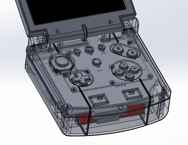

It's no different from any other portable design. Think about how it will work, draw some sketches on paper, then do it for real.

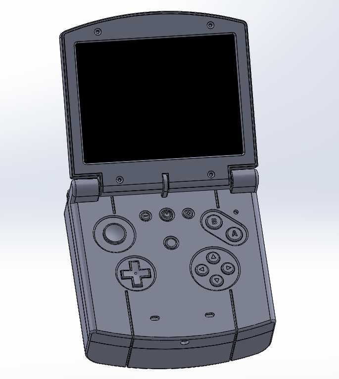

I focused on editing the case to bring the initial concept to something that is dimensionally accurate and possible to build. This incuded adding extra buttons for volume control / power on the front of the case. The thickness was adjusted until it looked possible to fit.

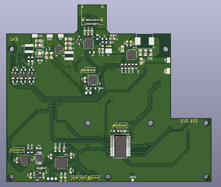

Then I whipped up a PCB with N64PMS, UAMP n64, USBC PD, and N64+.
There's 3 PIC mcus on the pcb which may seem a bit overkill. I could've absorbed the uamp mcu but chose to keep it this way since I already have working code and don't have to mess with the voltage sources (uamp is powered from 3v3, n64pms mcu from battery).

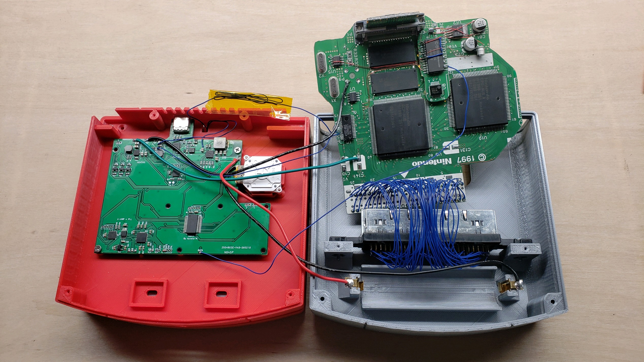

The all-in-one pcb arrived. All working. I made one routing error but I was able to solder the component creatively to work, can you spot it?
The test fit is all good, now I'm swapping the shell pieces to the final color. I also have to wire up the ultravga.
That poor n64 mother board, what have you done to it.
That is amazing, i legit couldn't spot the PIF at first, it fits so well there!

There will be a guide this year for sure (After MGC and GBoy frenzy passes). Even for myself lol. I trimmed it in 2 stages. First the PIF, then the cart slot area. When I trimmed the second part I accidentally rewired one of the pif wires to wrong cart slot pin. It took me a little while to figure it out.
