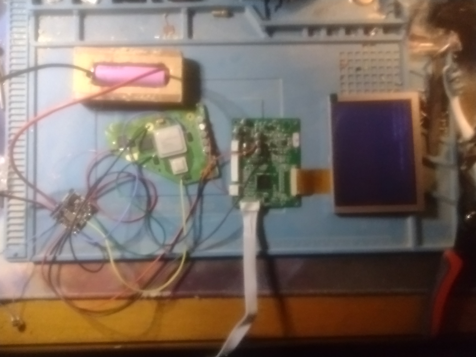

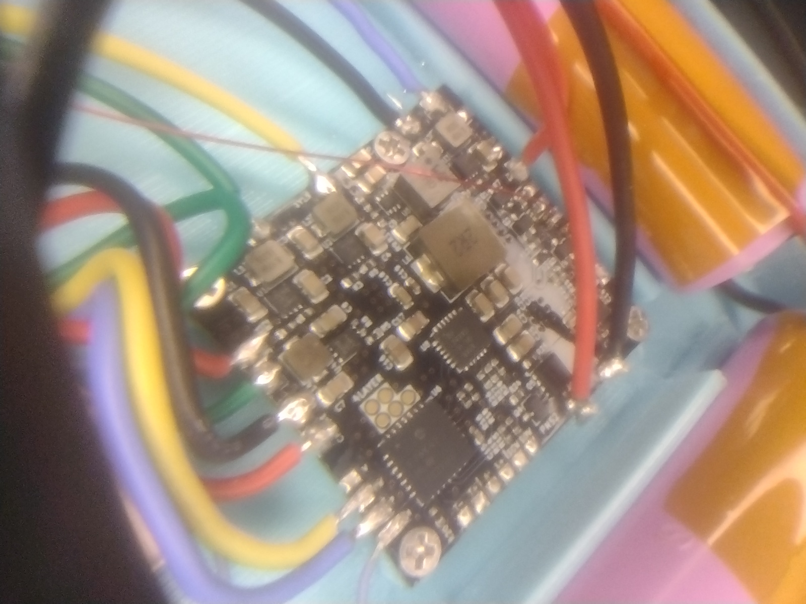

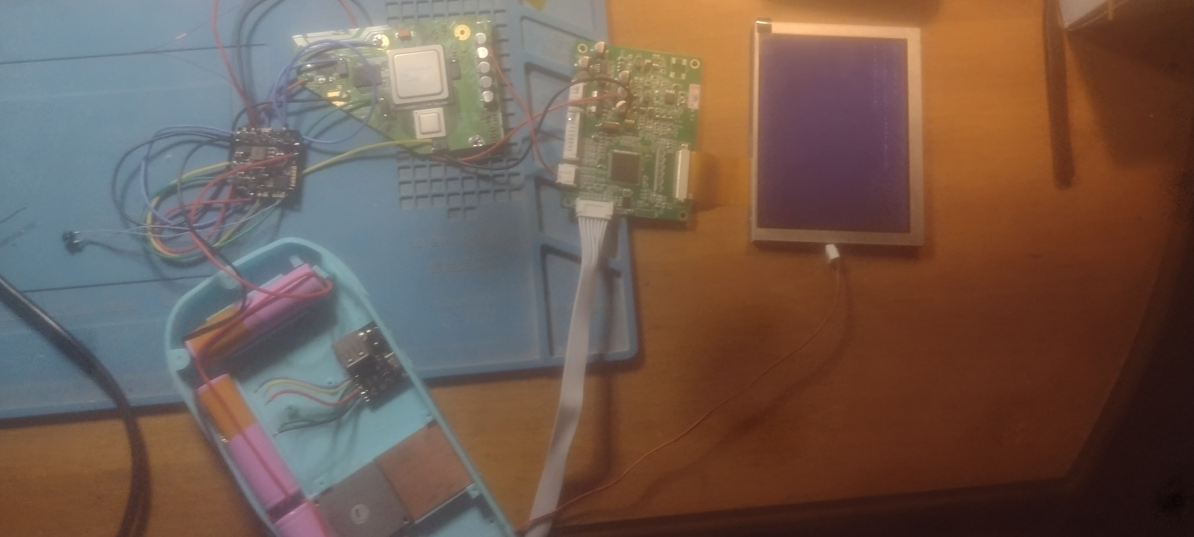

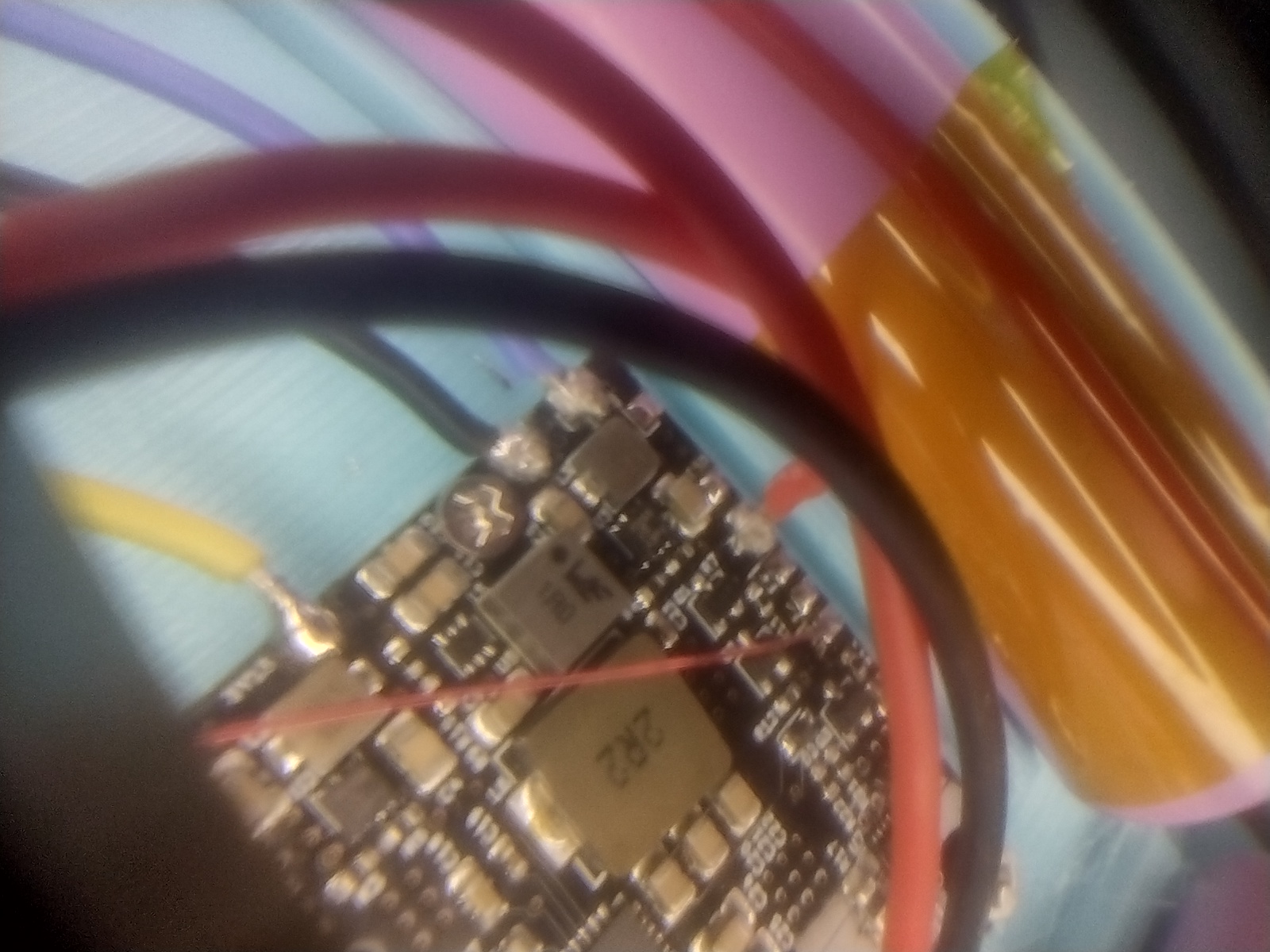

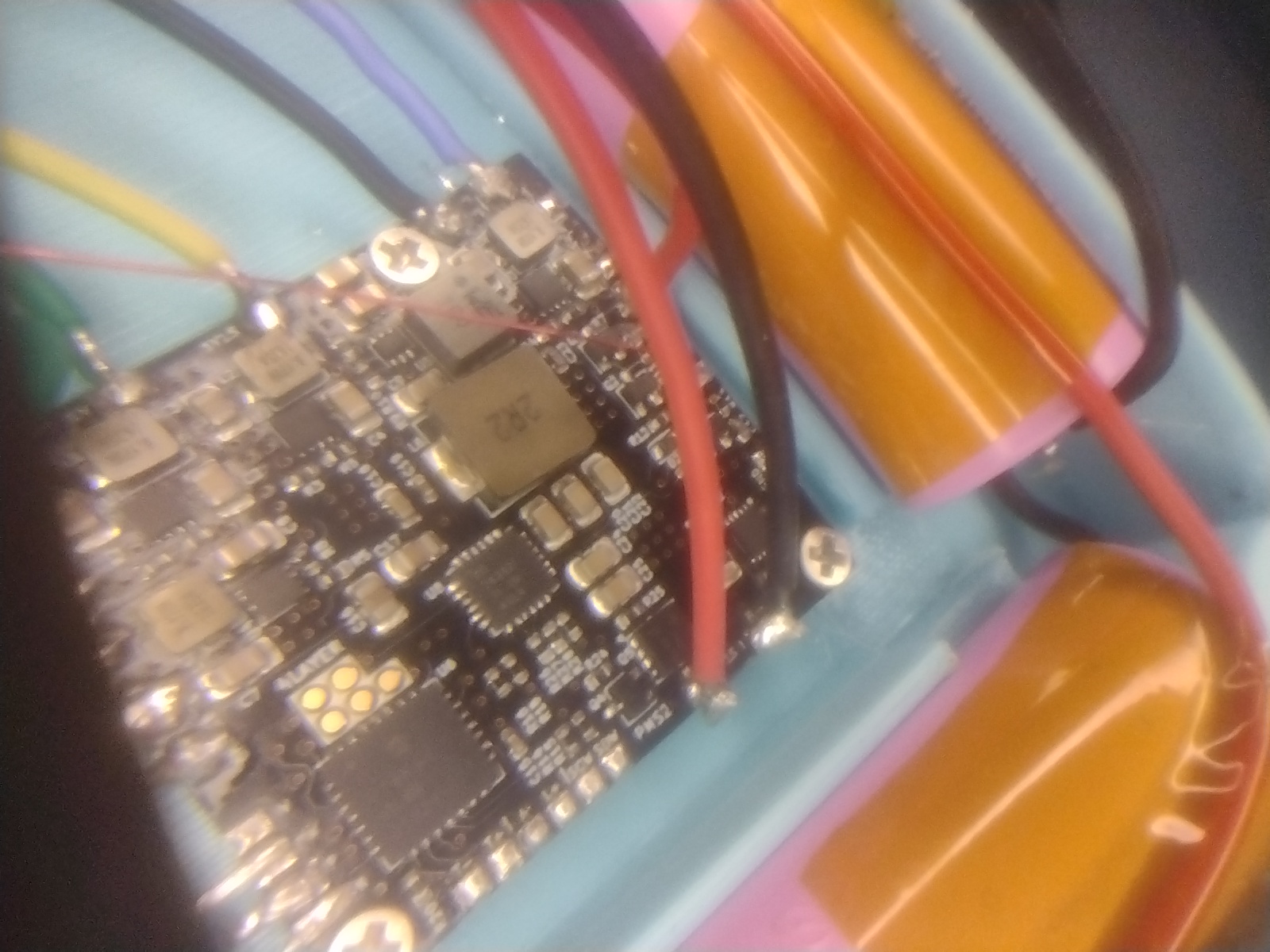

I wired up the PMS, PD, and the batteries, only to find out that the PMS can't handle 7v (I put the batteries in 2s2p), and fried the BQ. I should be getting a replacement BQ today and will test again now that the batteries are all wired in parallel. Here are a few images, though they don't really show much; I need to get better at taking pictures more often, but you can see a little bit that the BQ hasa strange little mark, that's where it popped. Won't make that mistake again, lol.
I'm going to re-print the bottom case to see if I can get the settings just right, and I need to print the top case and buttons/mounts, but it's coming along! (I'm so excited!)

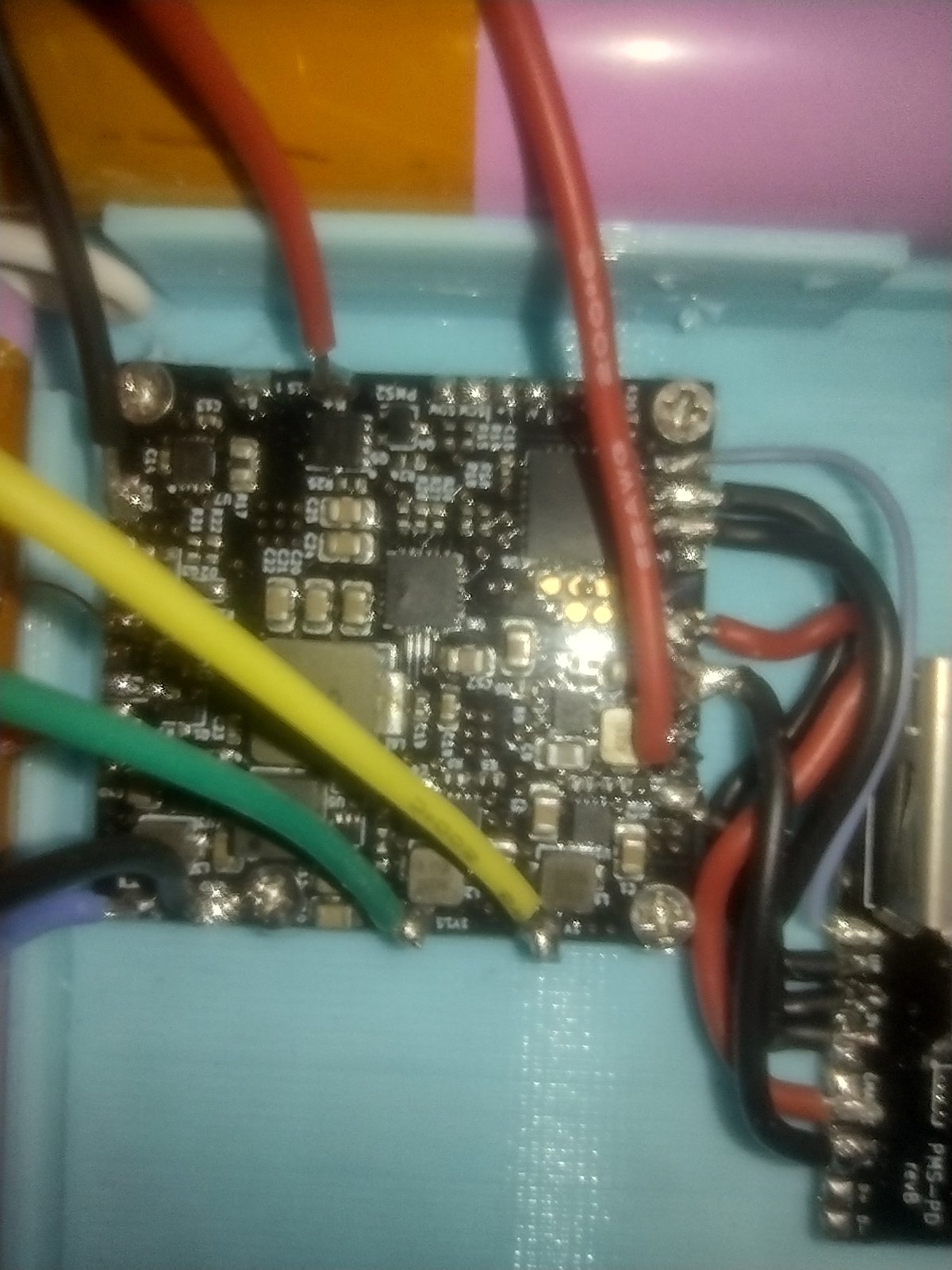

I've replaced the PMS' BQ, but the PMS gives no sign of life. It's starting to look like I'll have to save up for a bit to get a new one
Here are some images, though I don't know what help they'll be.
Quick little update: New PMS, all is well again!

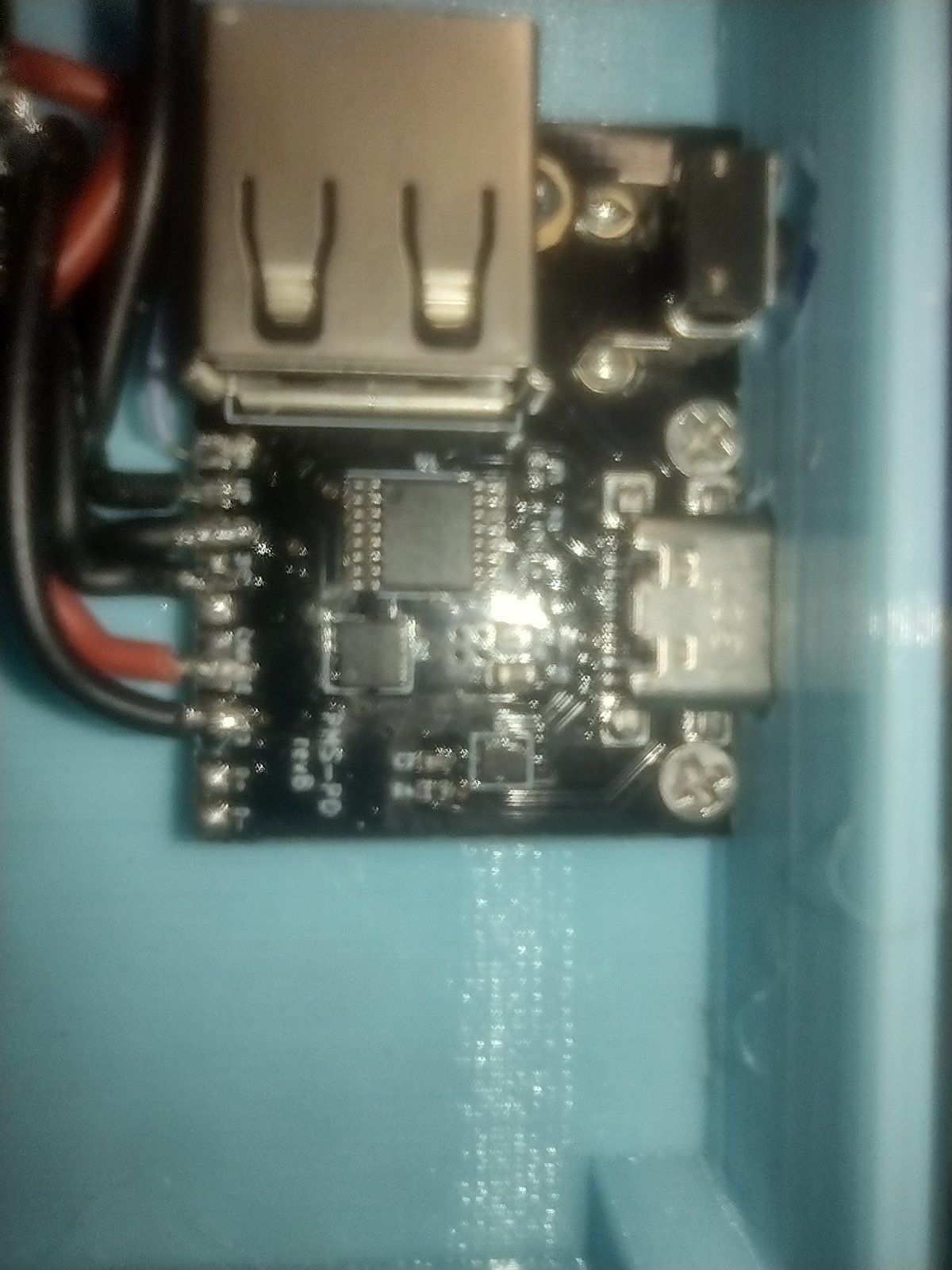

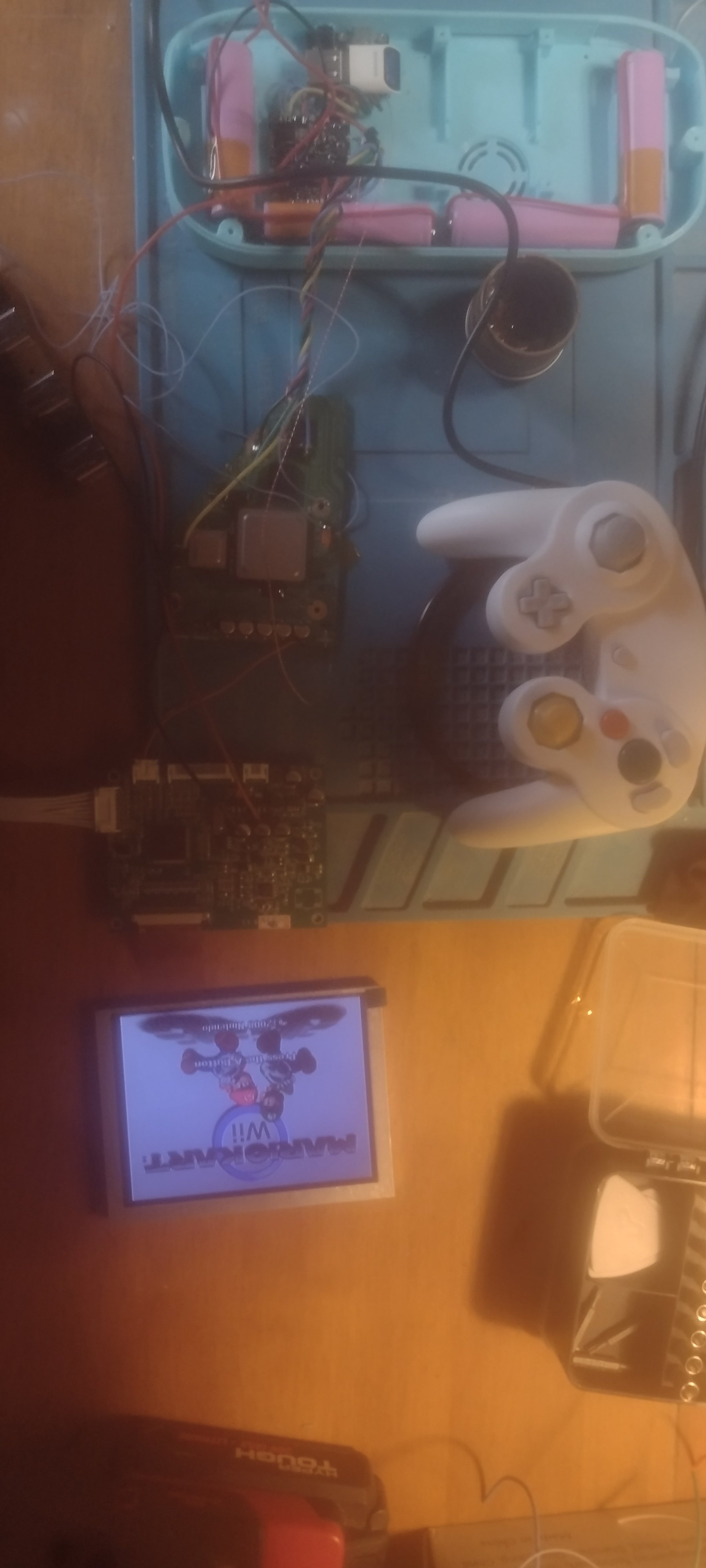

Wired up USB without a problem, wires are way longer than they need to be, but it doesn't seem to have been an issue. Also temporarily wired up one of the ports that I'll use for the external controller solution later on, to test loading up a game, and had no issues! Currently printing what I hope will be the final iteration of the bottom case, then I'll start making test mounts for HDMI out and controller expansion, then I'll move to the front case (I'm so excited!!!). Anyways, here are some photos:

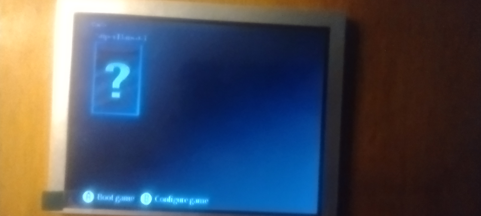

There is currently a brief hiatus in the progress of this project, as USB does not seem to work when VGA is enabled. I am encountering a LUA System Error, stating that "topbar.lua" cannot be found (I have checked, the file is indeed in the correct path). I don't know why this problem only exists when using VGA, and I don't know why topbar.lua is the only file that encounters errors. I've only seen one other mention of LUA System Errors, and it was stated that using higher gauge wire with USB seemed to fix it, so I'll be trying that as soon as said wire arrives. Though this problem is immensely annoying, this project seems to be going quite well overall, and I hope to keep updating!
UPDATE:
Once again, forgot to update. Figured out the problem, it was the SD adapter. In the process of redoing the wiring at some point the pads lost continuity so I ended up soldering them to the pins on the USB protection board thingy. After this, it recognized USB again but still gave the error, until I realized that I should've just tried a different adapter, and it works with VGA now. Project is still going slowly, mostly because a ton of stuff in school, but I ain't gonna quit that easily!

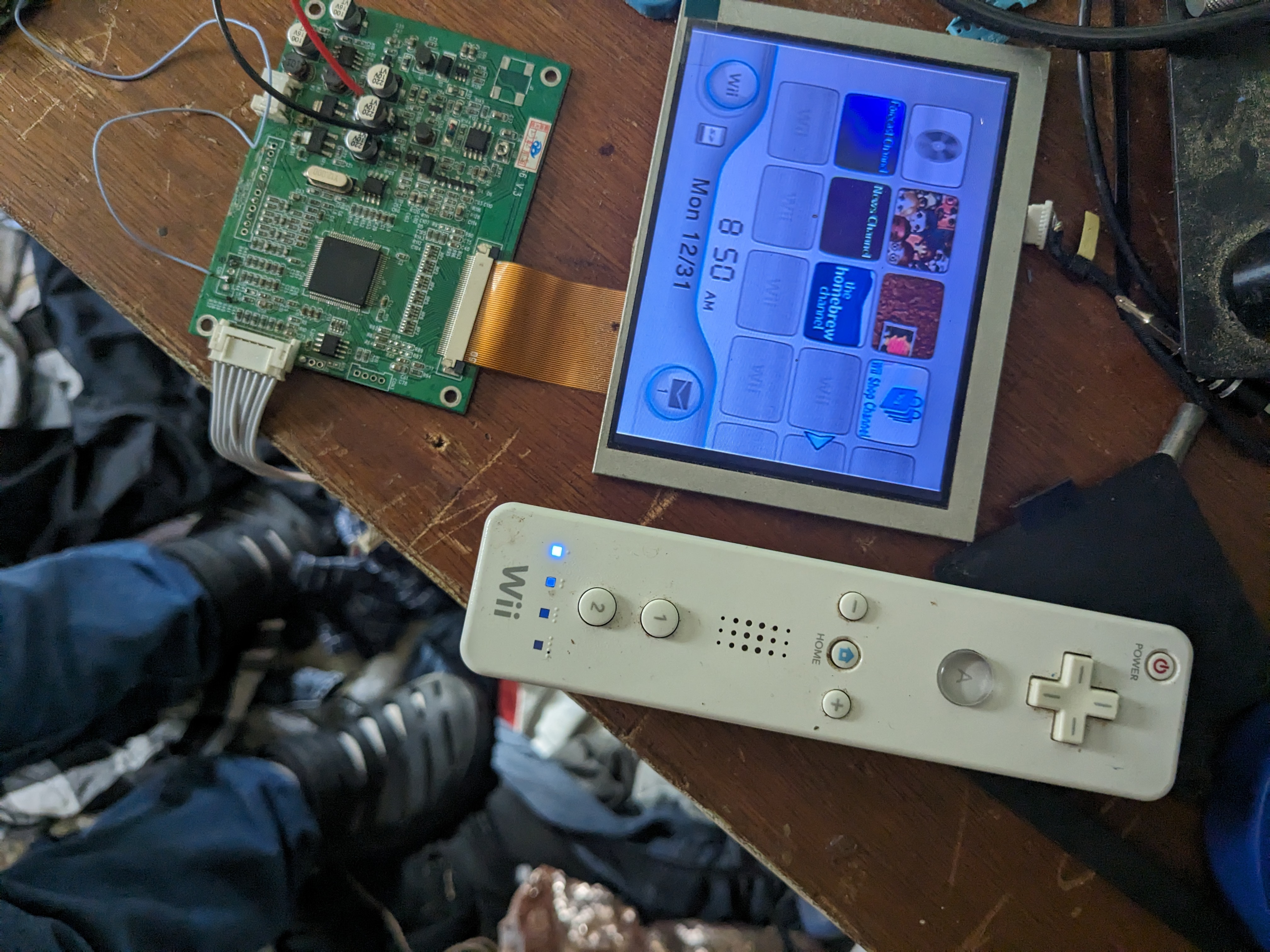

I haven't worked on the portable very much since the last update, I've been working on getting my printer to spit out the best bottom shell that I could get it to. I redid some of the wiring just because, and upgraded my PD-2 to the PD-3 because the data +/- traces on it got ripped off somehow. I also wanted to test &make sure that I was able to get bluetooth working, and finally got it, though I'll probably have to redo it once I start actually mounting things. Right now I need to make modifications to the Top Shell model to accommodate HDMI and the connector for my external controller dock thingy. I got some pictures showing the Bluetooth working, but be warned, my desk is complete chaos at the moment :P

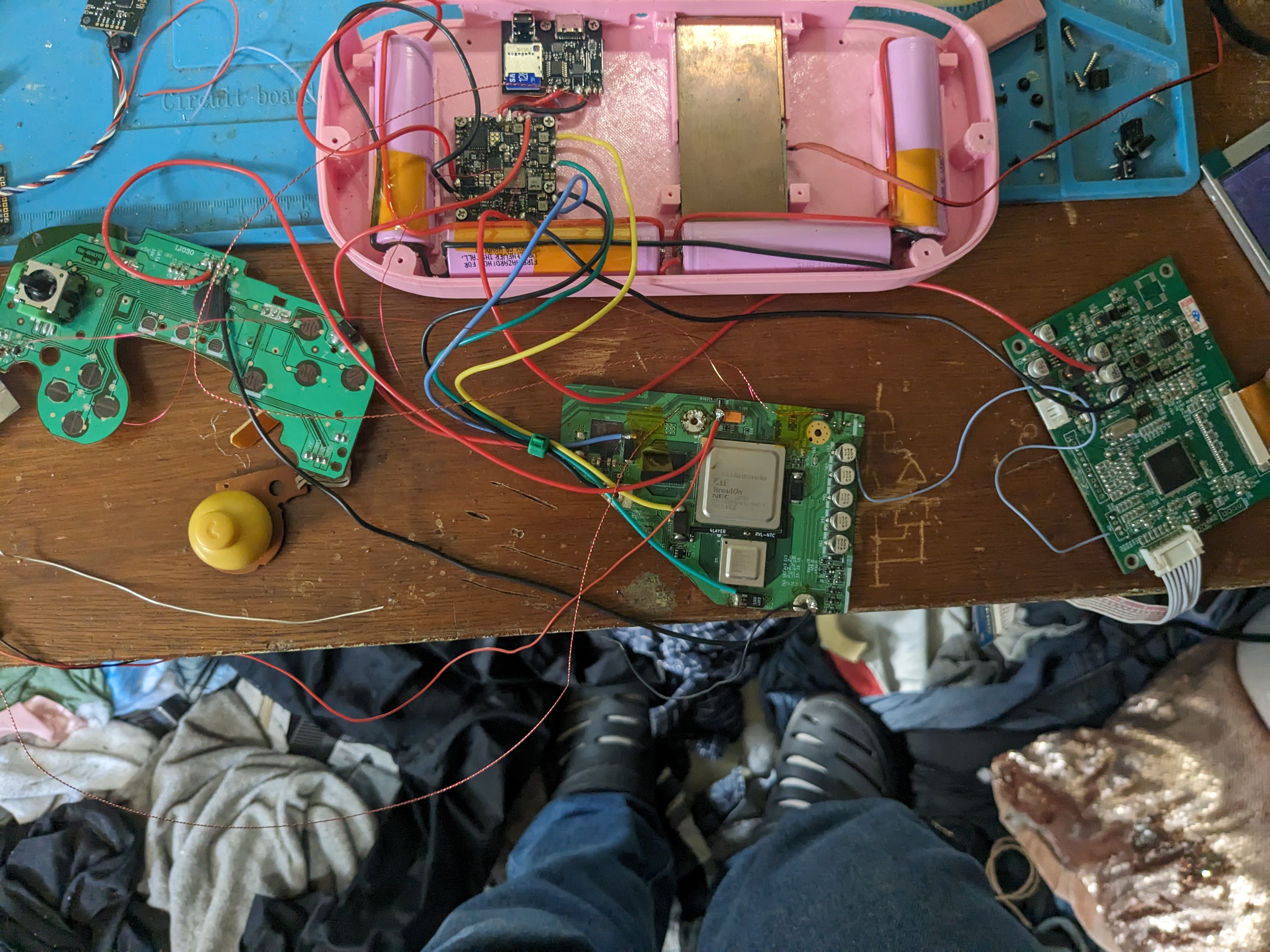

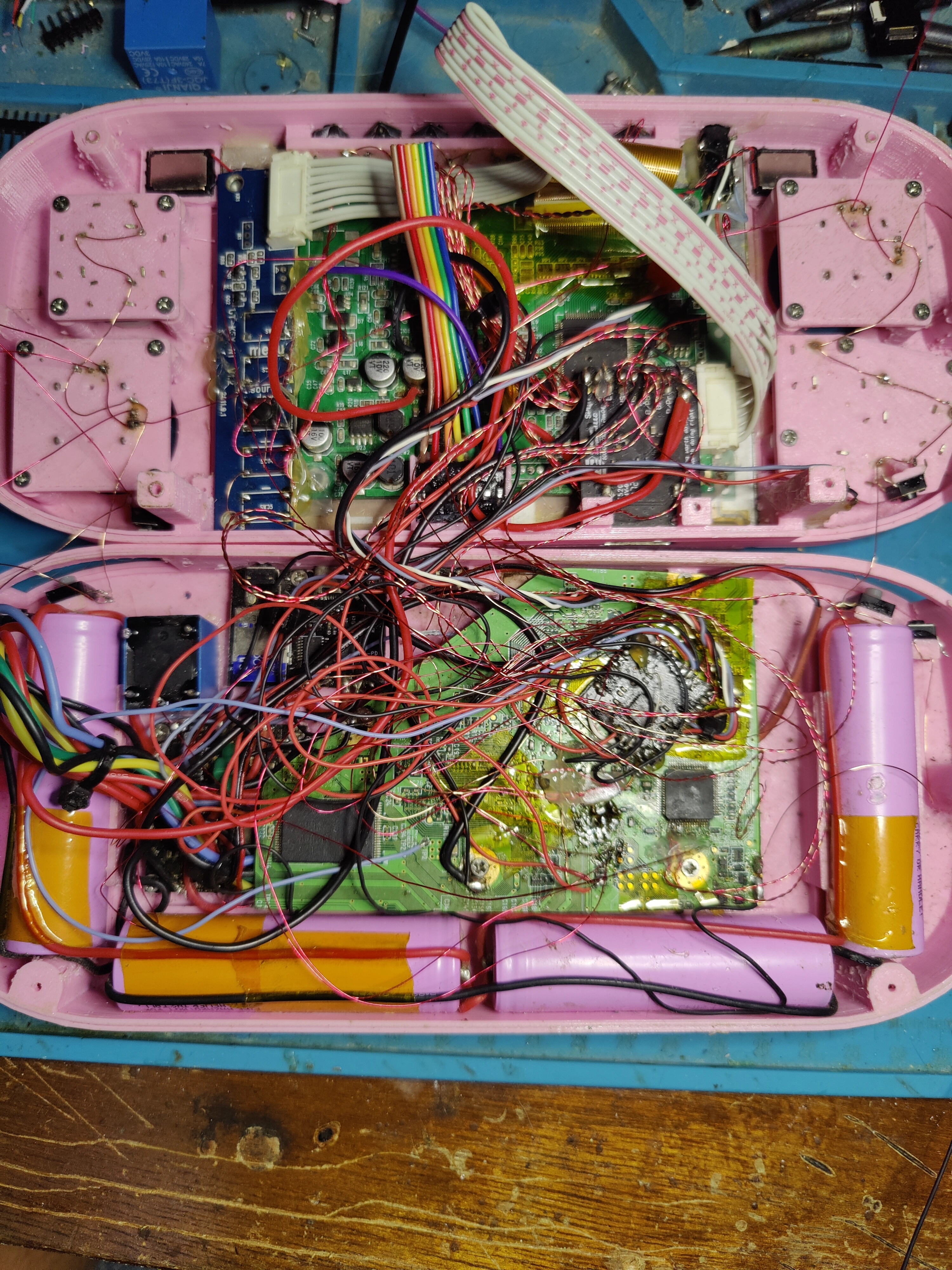

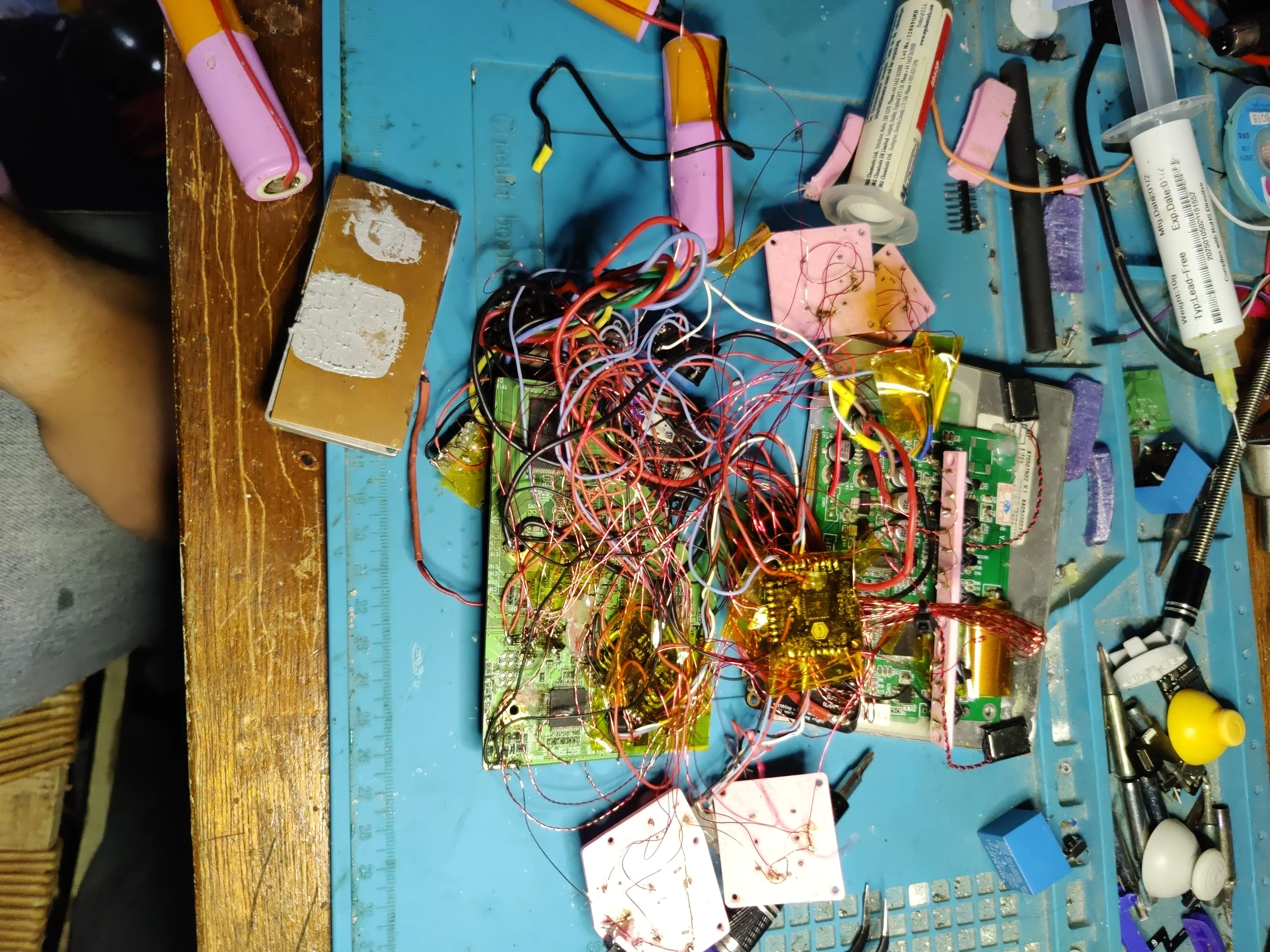

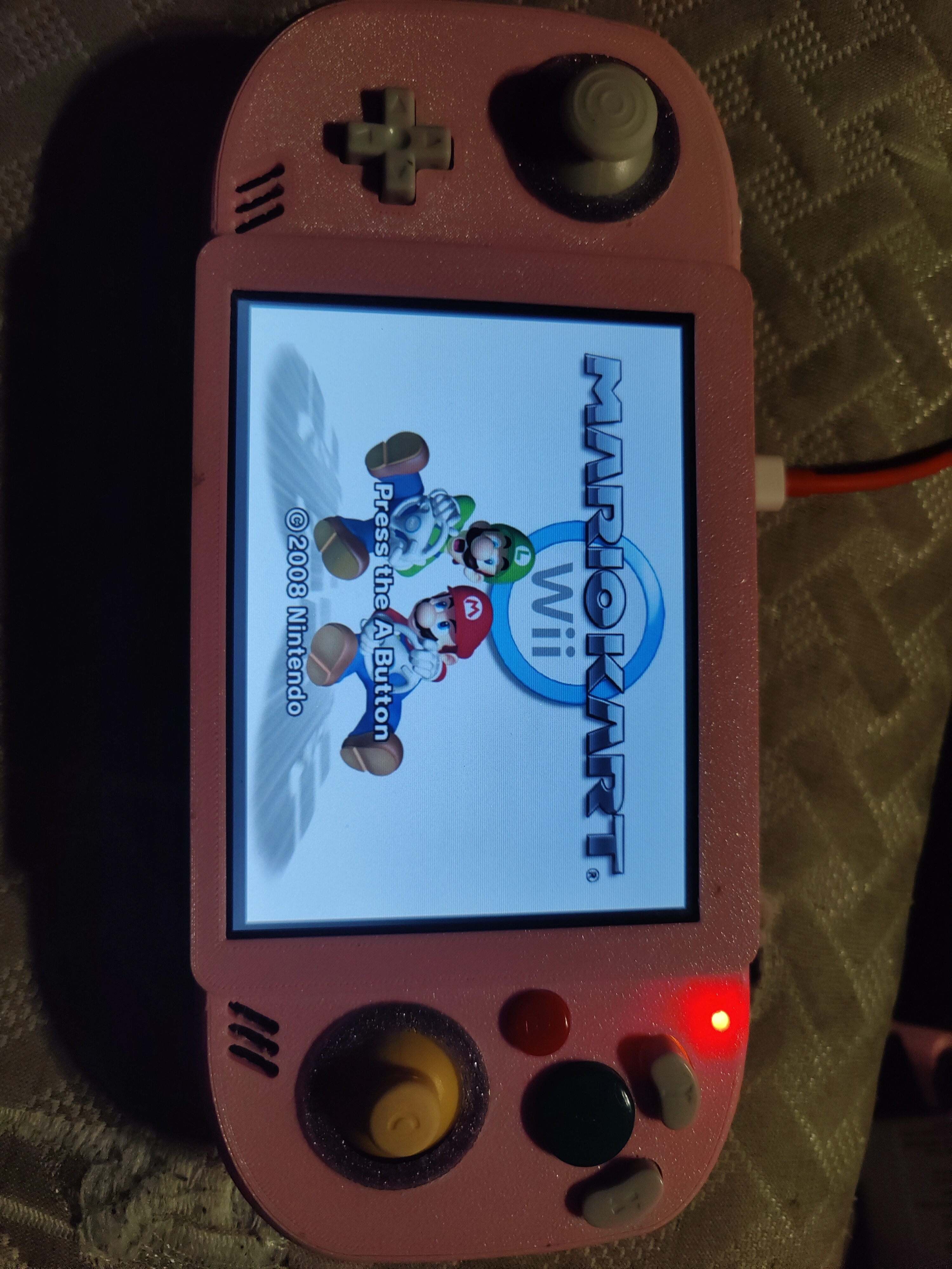

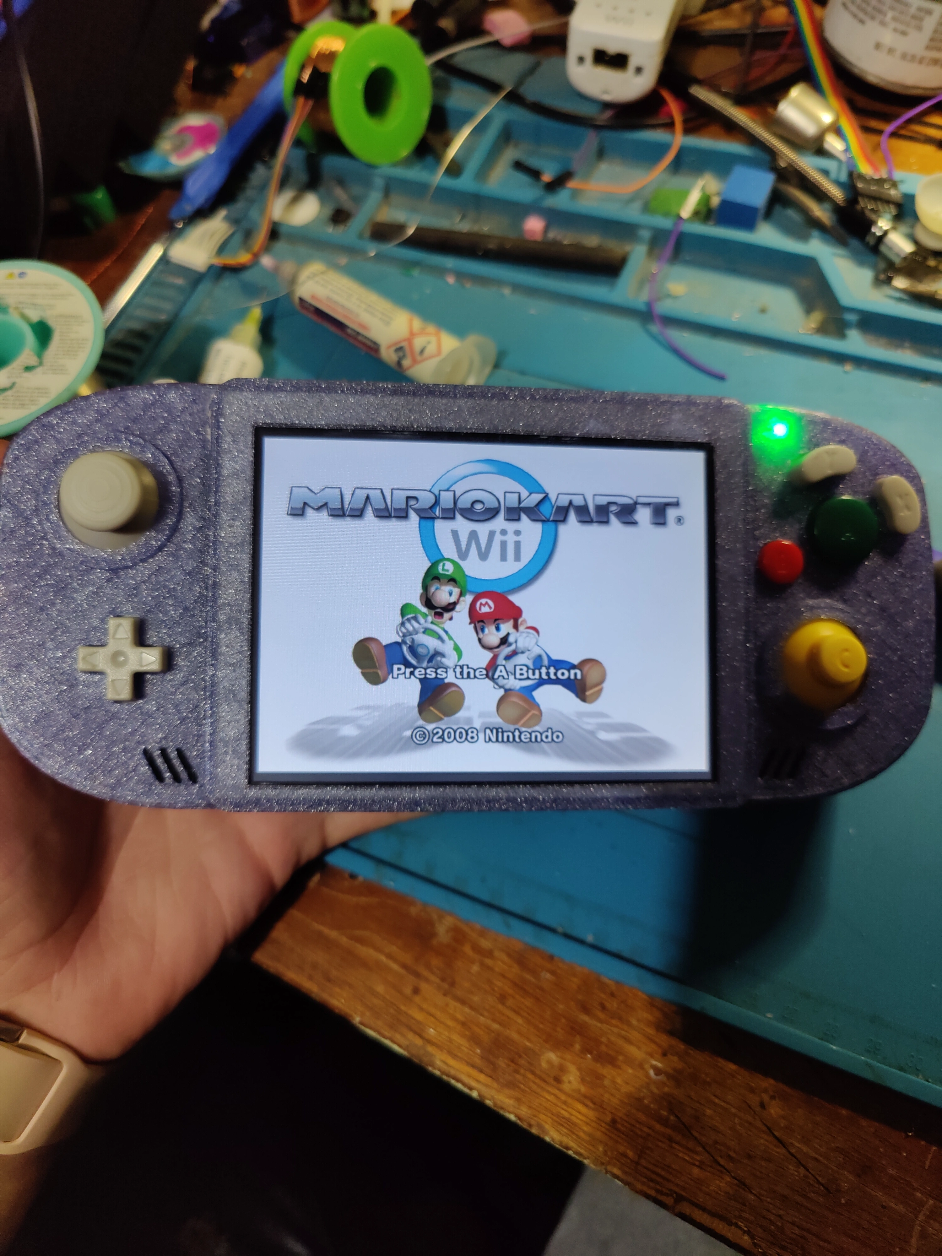

So yeah I completely forgot that I even had a worklog for this thing but I finished it ages ago. It has HDMI output working (although audio through HDMI only works when something is plugged into the headphone jack), and it has a very jankily-made breakout for external GameCube controllers. I never did make the actual adapter for the ports, but even so I know it works because I've tested by just jumping the data lines directly into it. Basically, I out it all together, then immediately gutted it to put it in a new shell (which only took 2 days because almost everything was already wired and I was lucky with how smoothly it went), then reassembled and it's done. All I can say is that I'm quite excited for my next build, which I'll actually be designing almost entirely myself! Anyways here are some photos, enjoy I guess
behold: spaghetti
(when I gutted it to reshell)
