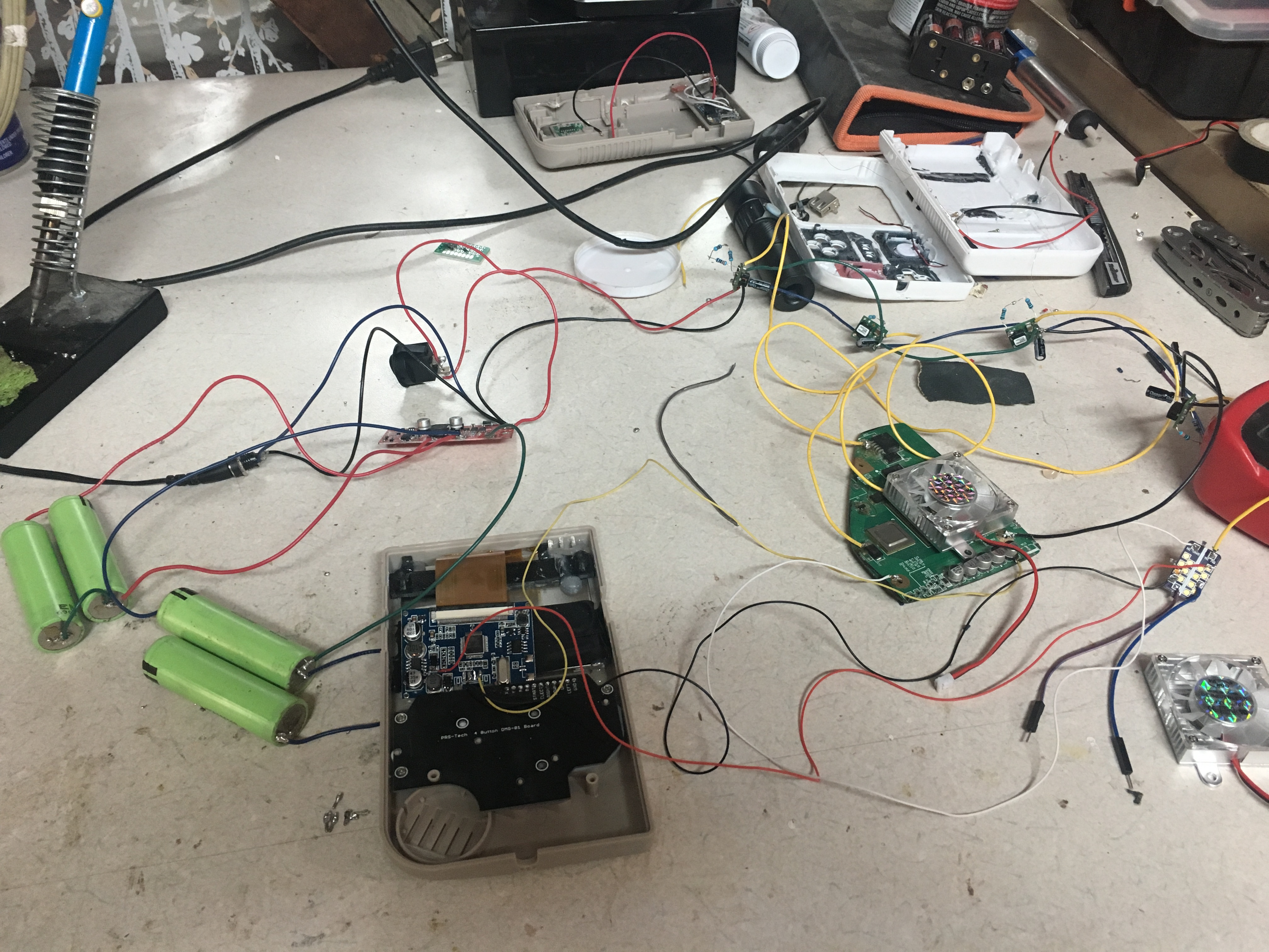

Well now my phone is not dead so here is a pic
The red board thinks your batteries are severely overcharged and is only passing power from the charger to the output... You have those wired in a 4s1p which that board doesn't support
Oh whoops still new so major error on my part
Is there a way for me to wire it to make it right or do I need to get new battery holders
You prolly also killed the red board by giving it 14.8v. The diode that passes excess charge current through works independently, so you most likely have a nice paperweight there.

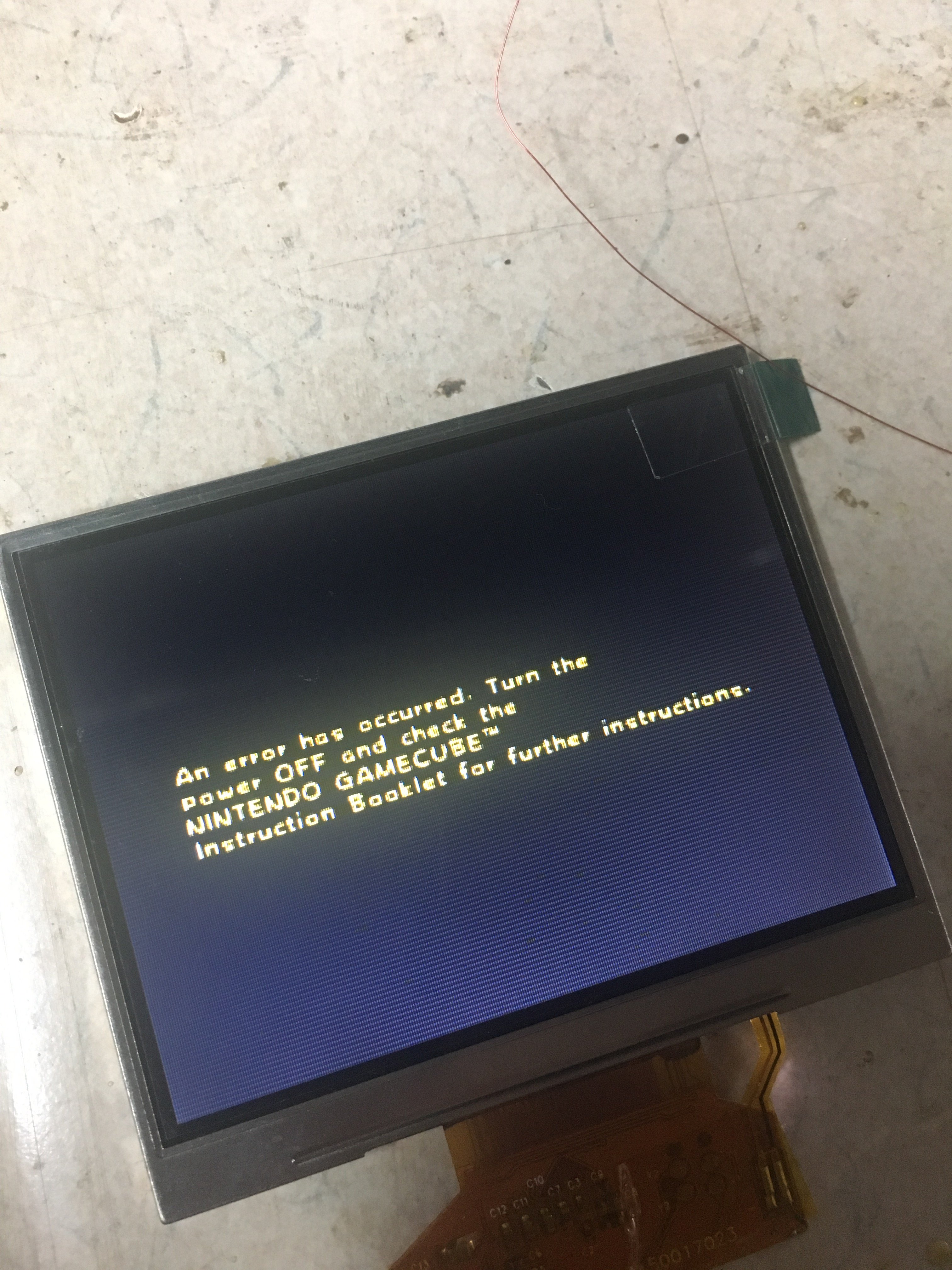

I have everything almost set up except for sound
But I keep getting this error and I want to know if it’s just from heat or something else
Well the good news is that my board did not become a paper weight
I got the new battery holders and my red board works just fine (thank god)
From what I've read I don't assume the wii gets hot fast enough for that to be an issue?
Like it should boot before any given problems.
In my experience that is usually a USB issue, or you're using a dud ISO.
Well it might be a usb issue since it happened on all the games I have on there
I’ll test out another usb tomorrow and see how it goes from there

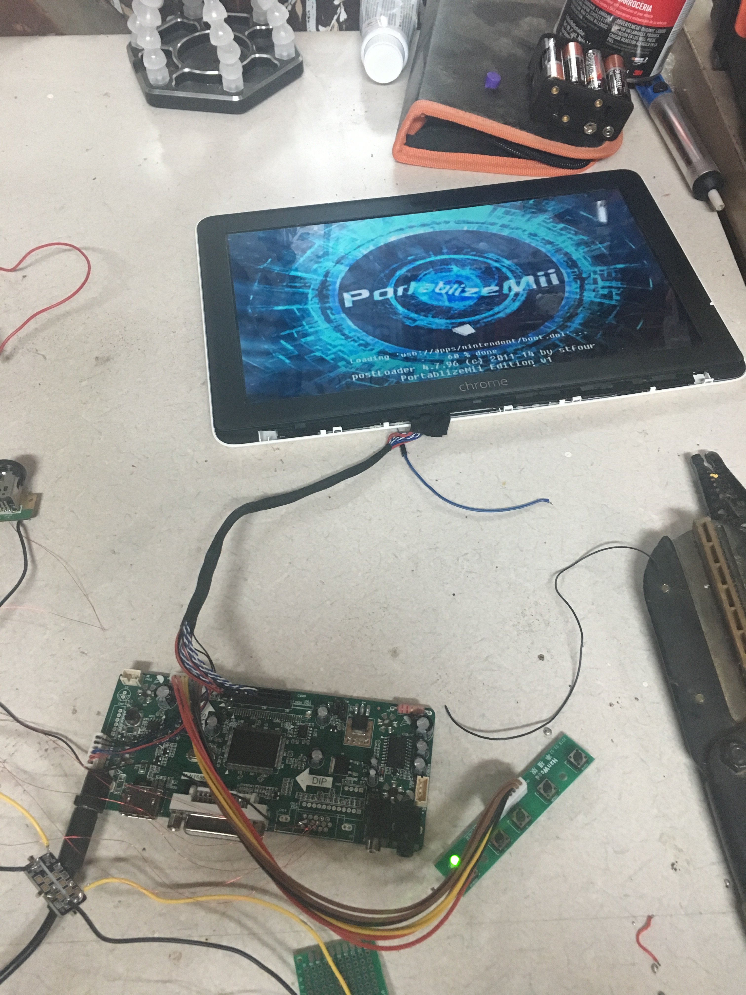

Ok so it’s been a while since I last posted and I have made some progress after a break cuz school
i got this broken DVD player as a case for my portable so it’s still laptop style
im Only using some of the internals from these such as the power switch and headphone jack and speakers, I had to replace the USB port on it since it wouldn’t work but it’s all better now
i then gutted the unnessary items that was on the dvd pub and put some perfboard on top with some epoxy and added the stuff that was needed such red board audio amp power mii etc.

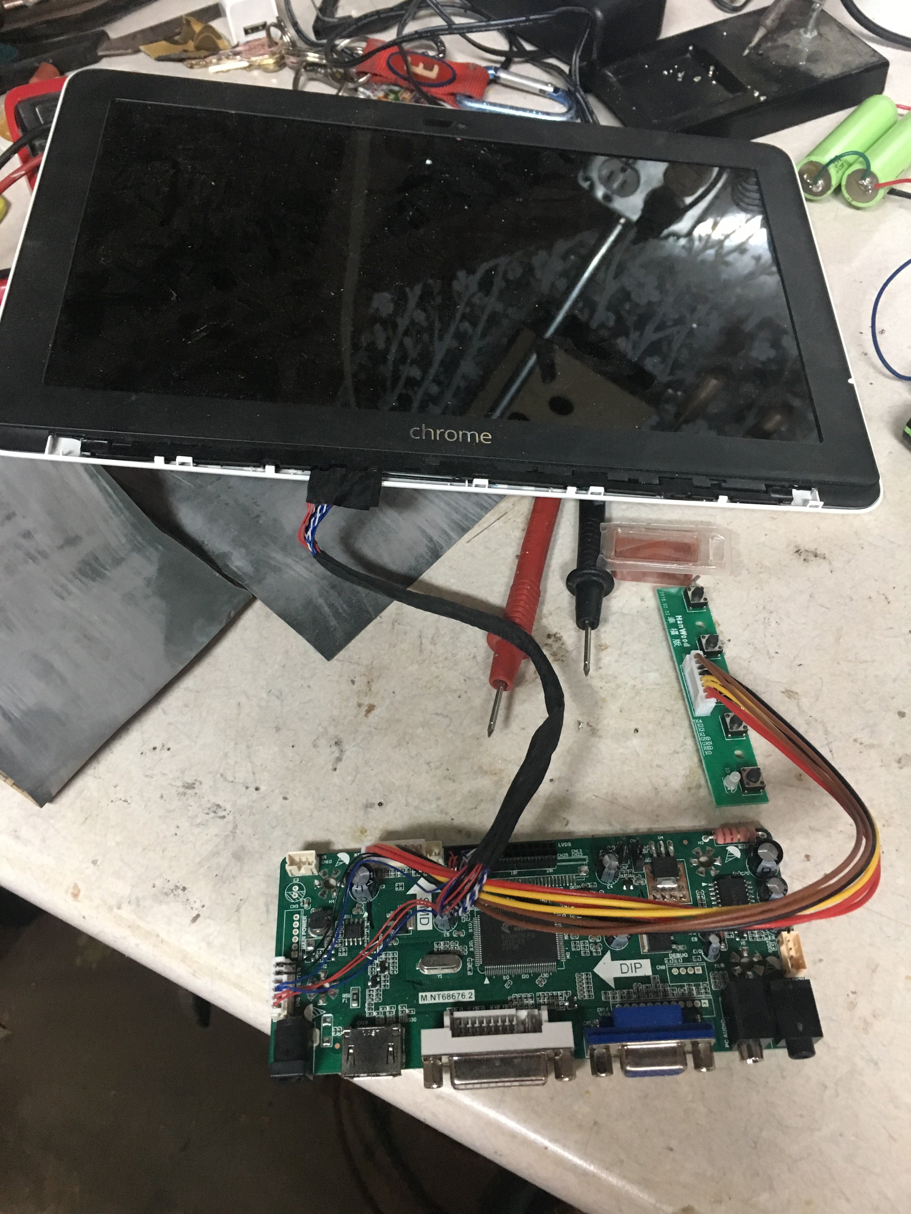

I also changed the screen with the google chrome book screen, it’s skinnier and lighter so that’s a good thing
but since the screen was bigger I had to modify the..top part?..bezel?.. to make the whole screen visible.
I did some sanding to it and it looks better with the screen on it
took a while to get vga to work since I had accident soldered h and v sync together so I spent some time getting rid of the solder
gonna Keep four of the buttons from the DVD player for the volume,reset and sync buttons, and put ports for go controllers, is gonna look better once I fill in some holes, prime it and sand some more, but that’s all I got for now, probably won’t be able to do more on it much since I need to get the paint and my city was one of the ones looted so it’s gonna be a while
