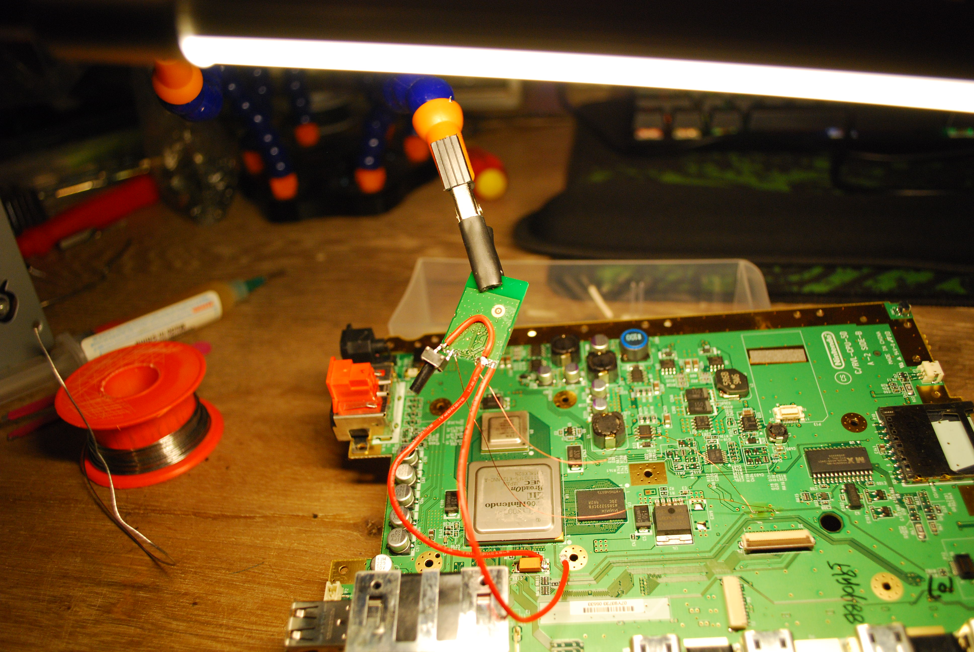

Small update, got a 4 layer board and wired up bluetooth module for testing.
all went perfect first time.
