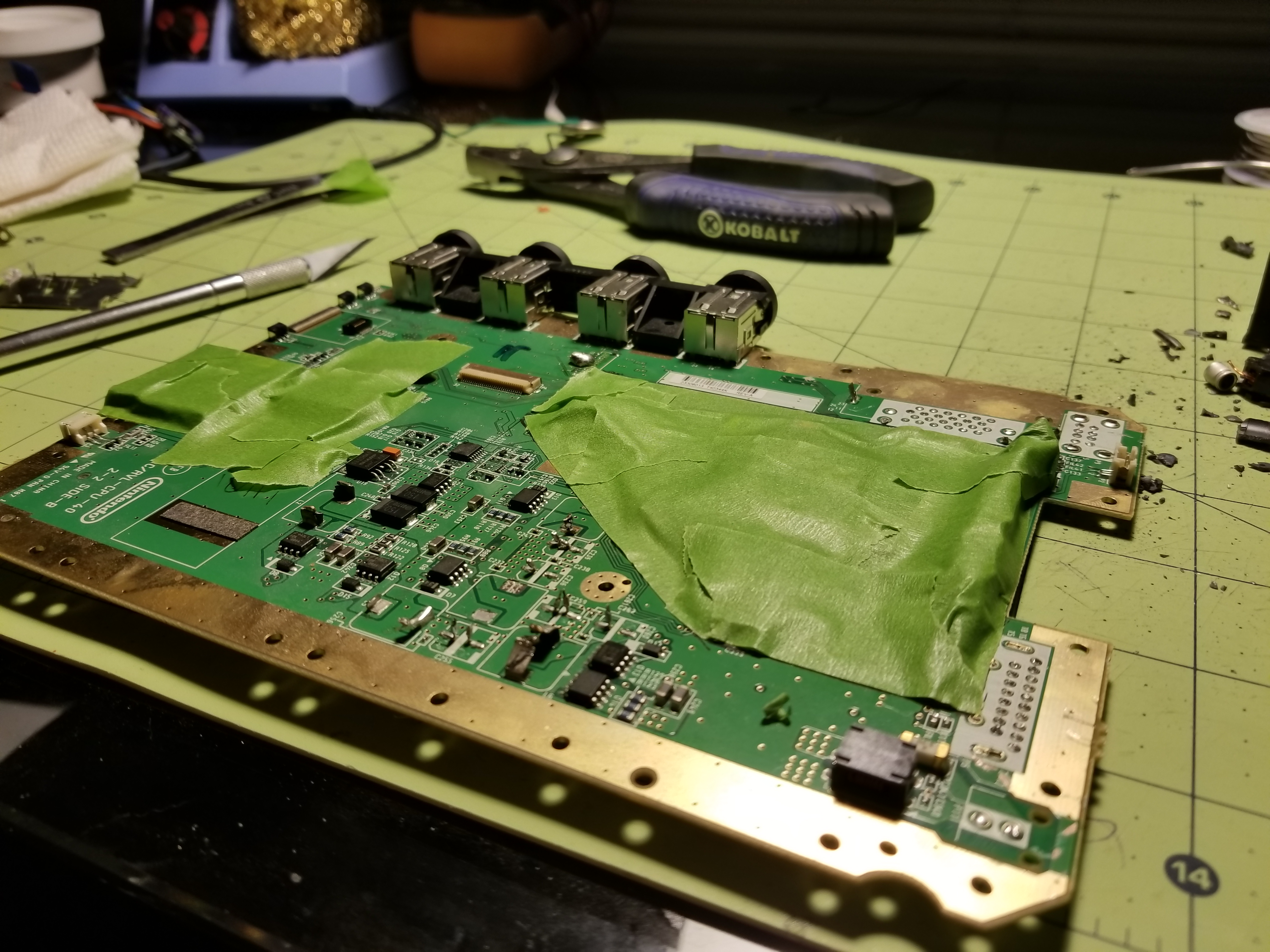

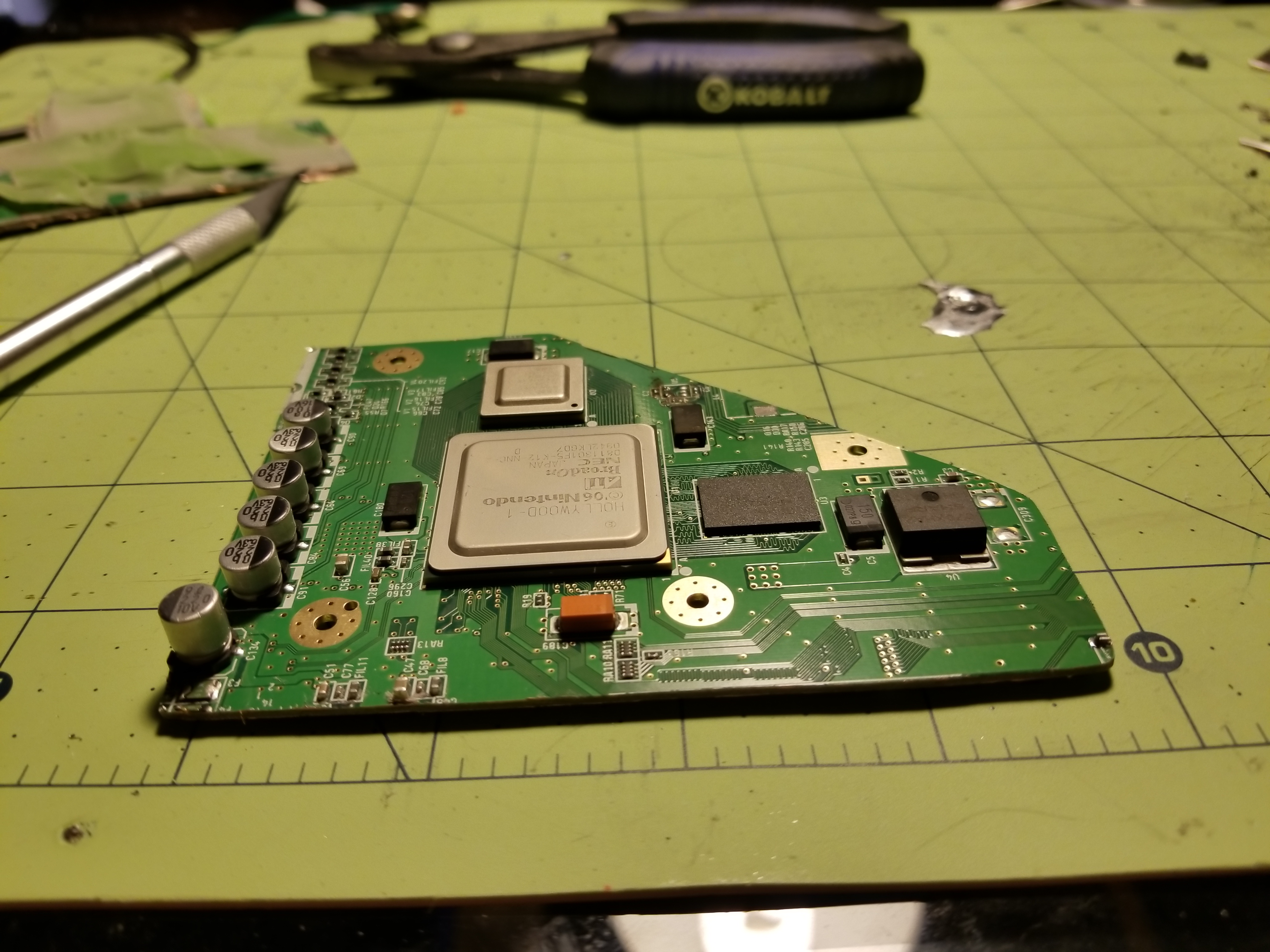

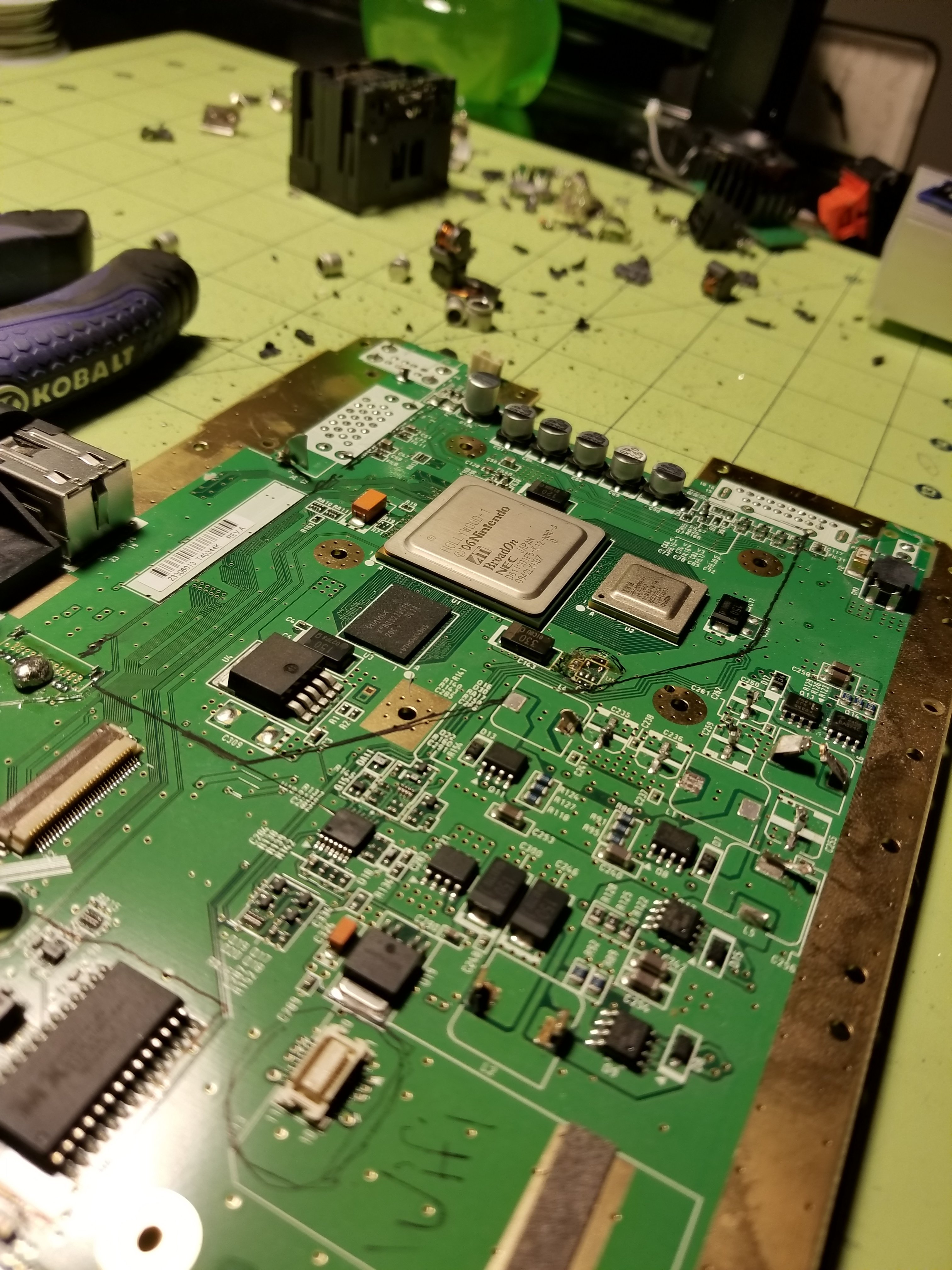

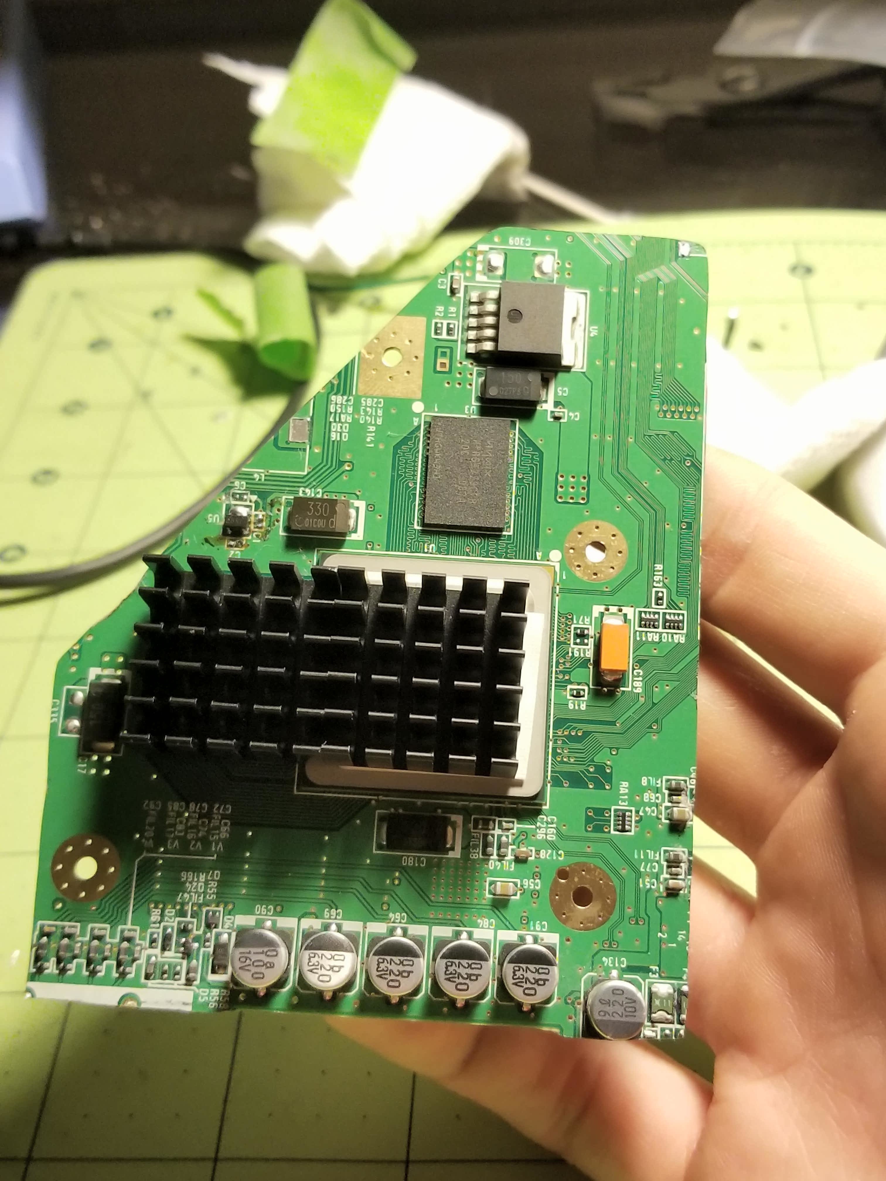

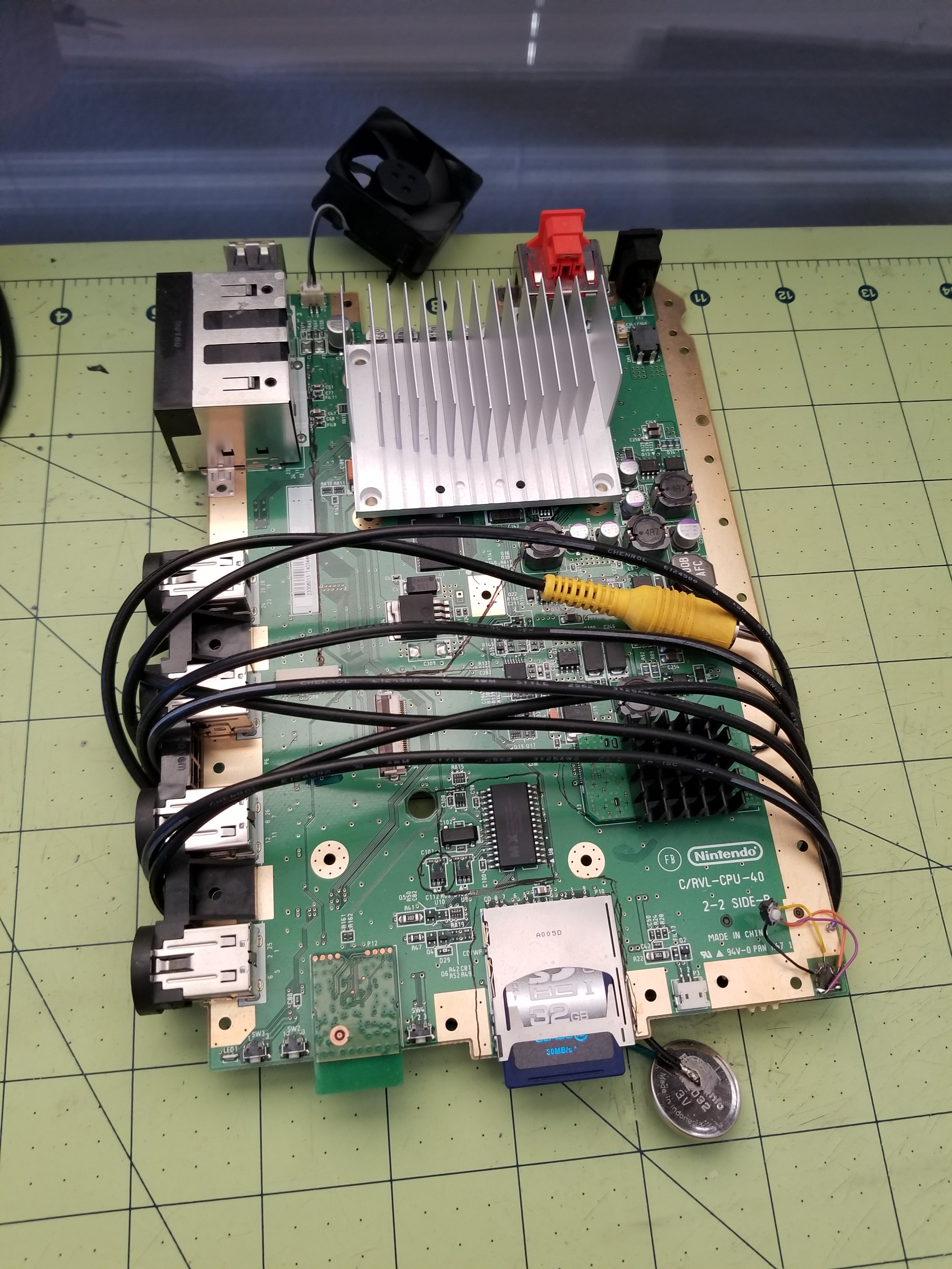

20170918_174849.jpg 20170918_191209.jpg Holy cow its been awhile since ive touched my Wii...

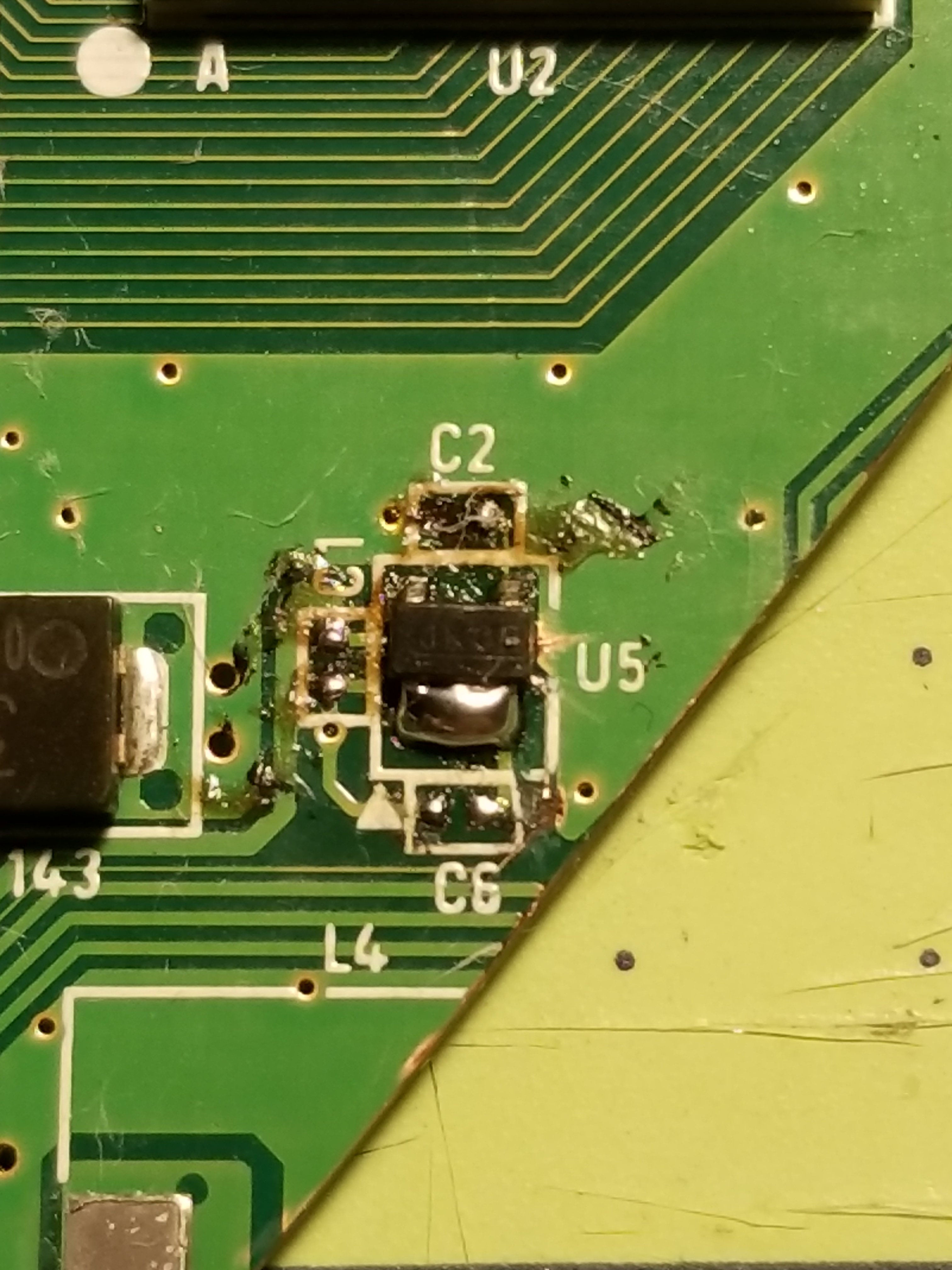

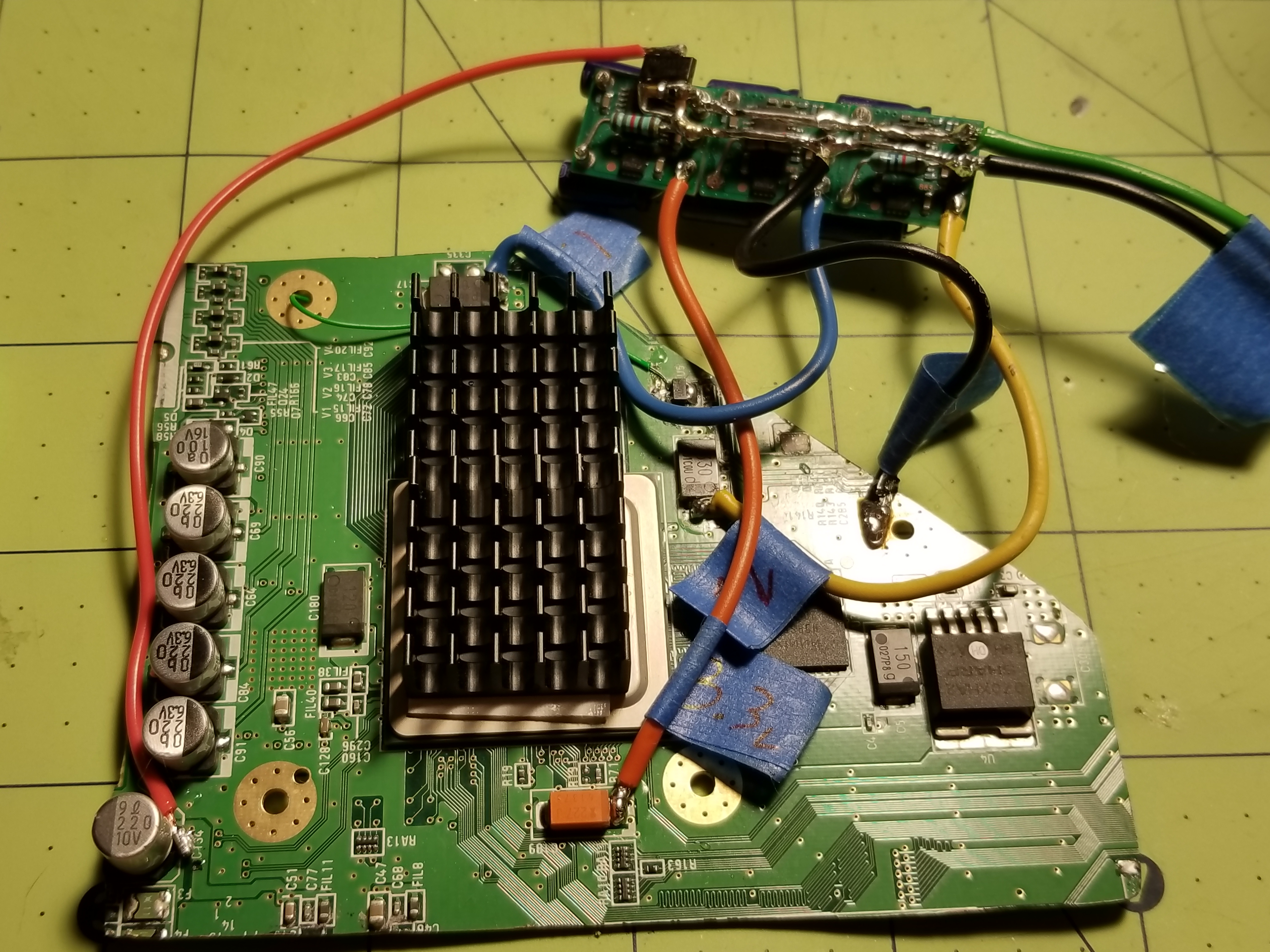

Ive made some progress today though getting the board cut and wiring up the power reg/U10 relocation. Using a heat gun made easy work of removing the U10/U5 chip just be sure not to drop it on your carpet afterwards.. :blush: I got the custom regs from SS, he did a hell of a job making them compact and easy to hook up. I was going to wait until i finished my case to really start hooking things up so for now this will stay put.
As for the trim some places have a little more meat than others i was kinda nervous cutting in too close. All the edges were sanded and sanded again until it was nice and smooth all the way around. looking around the edges i dont see any obvious shorts so im pretty pleased with the end result.
Let me know what you guys think i havent tried booting it up yet im waiting for some feedback just in case.

Looking good, zen_kyle. And welcome back!
Your trim looks great! I would probably use some IPA on that U10 though to clean off the flux residue. Also be sure to verify there are no shorts with a multimeter before powering on. :)
Thanks for the feedback Jeff ill give it another wipe down with IPA. I think some of that discoloration is from me trying to remove those pesky resistors though.

Checking the power lines im getting continuity on 1.5v and 5v. Its showing around 50 Ohms on each. Is this normal? Ive read other post saying it's to be expected but i don't remember the amount they suggested to be okay.
Yes that's fine. The 1.15v and sometimes 1v line will trigger continuity but as long as it's > 10 ohms you're fine.
Thats a relief! I think ill start focusing on the case now. I'll probably try vacuum forming. Thanks again for the feedback
