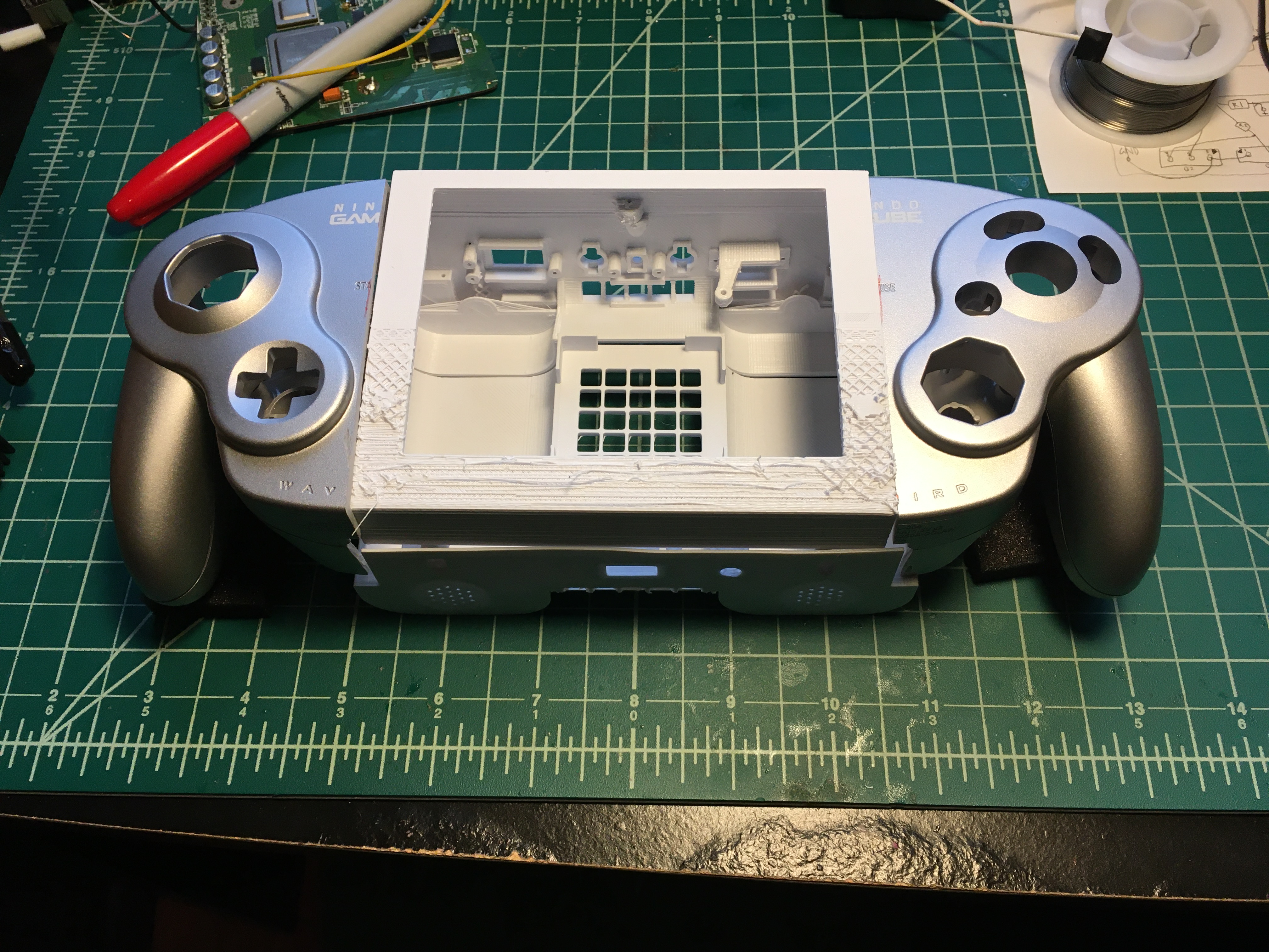

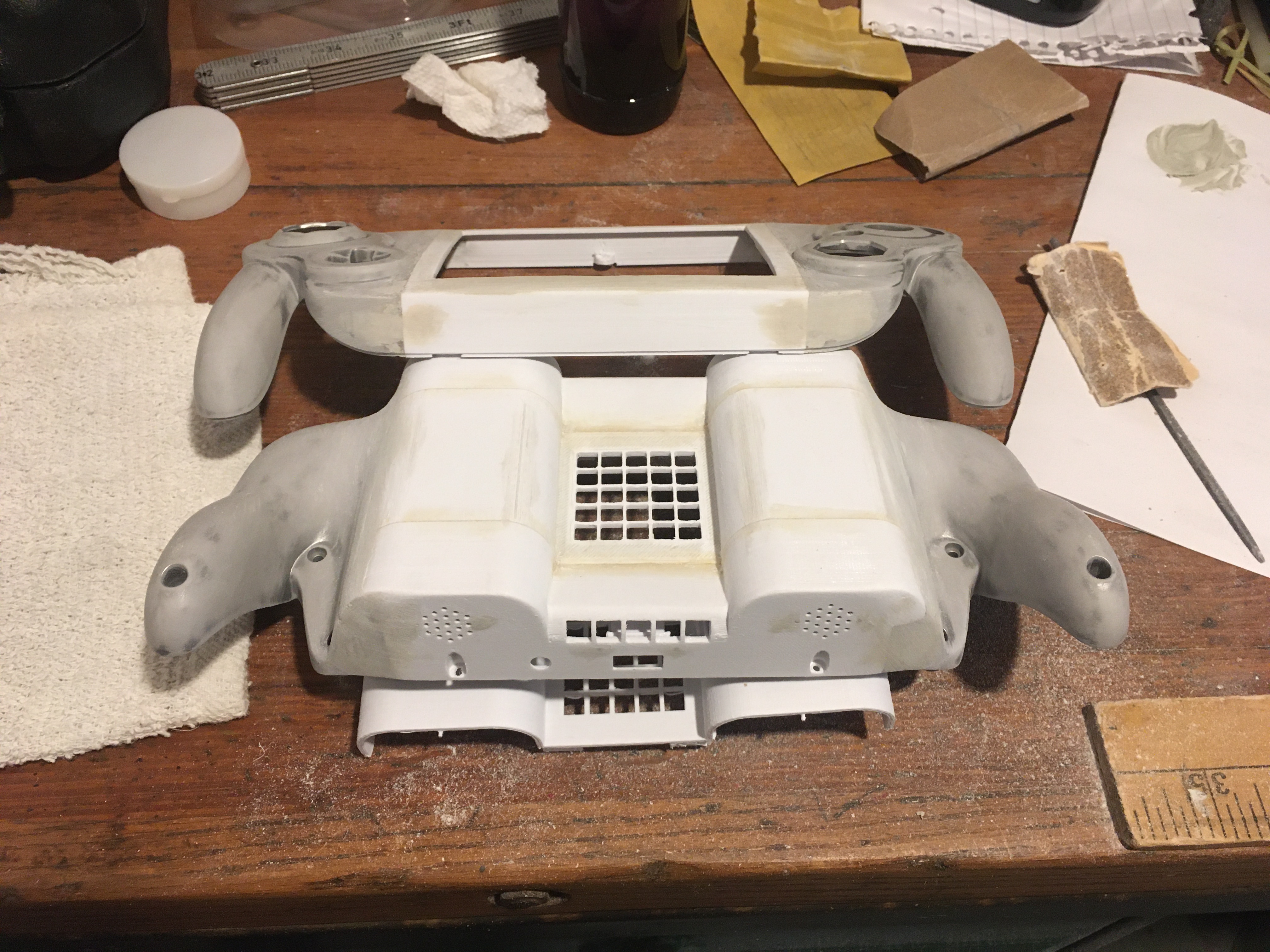

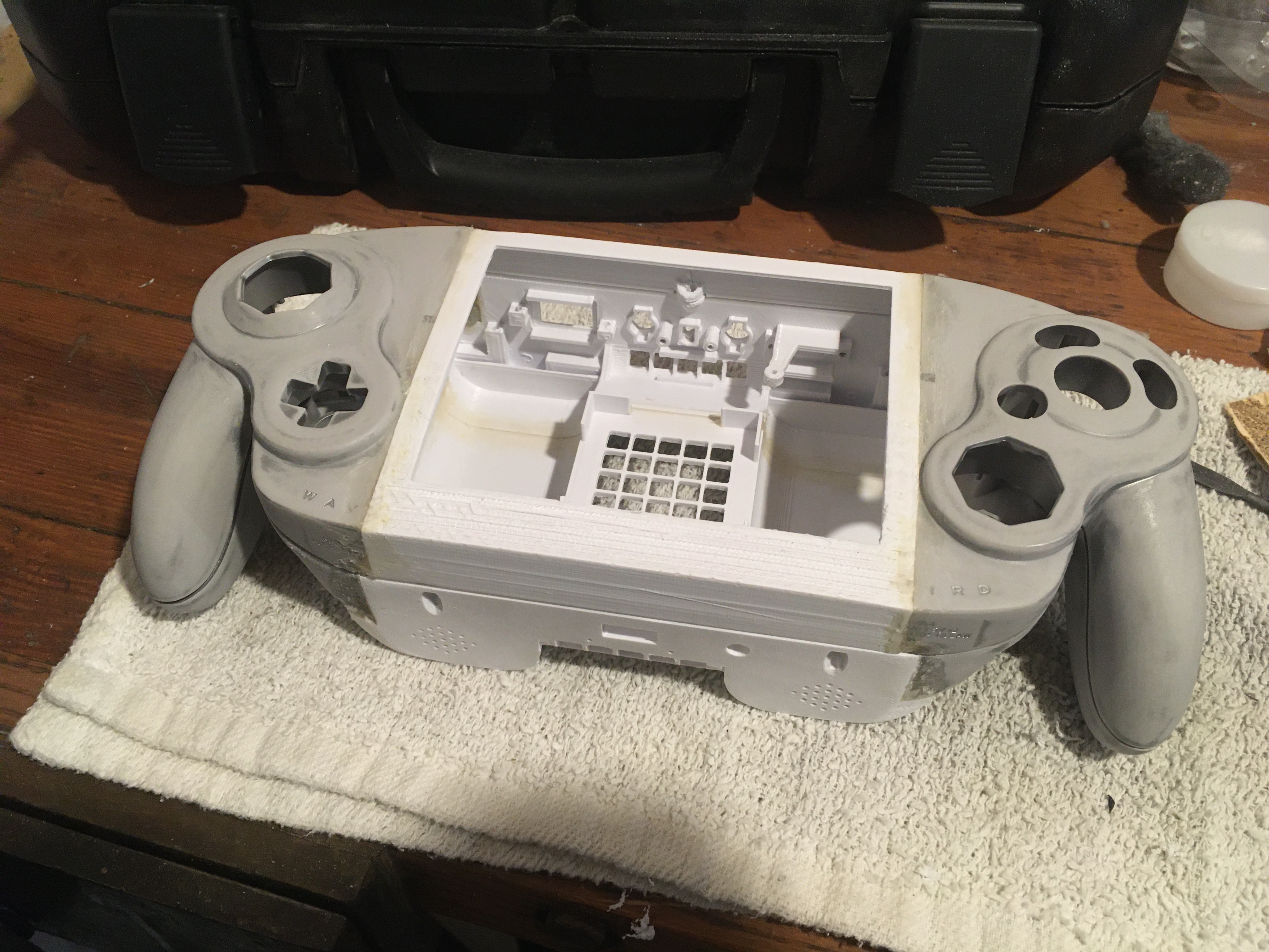

I did have a brief scare where the batteries were not fitting in the case due to the epoxy and og wavebird shell elements, but I got them in there.

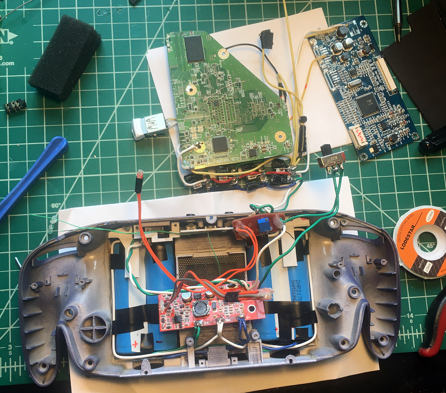

Because the audio circuit will go beneath the Wii motherboard, I have to wait until my TDA1308 comes in to screw in the Wii board and fully assemble the bottom half.

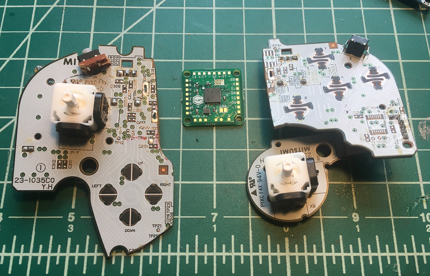

In the meantime i've been working on the top half and getting the wavebird board all hooked up, I did manage to mod in those T3 sticks just by drilling some holes.

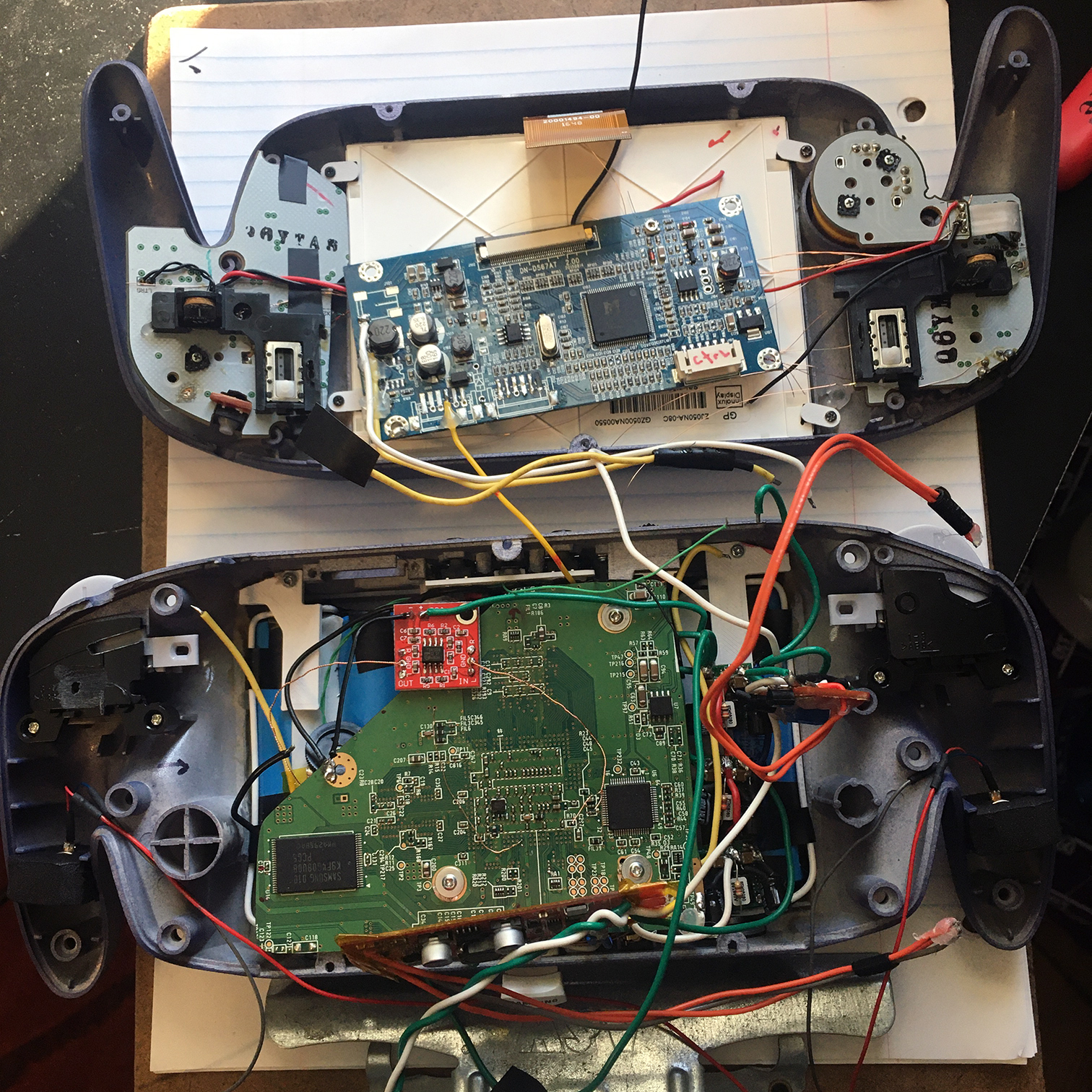

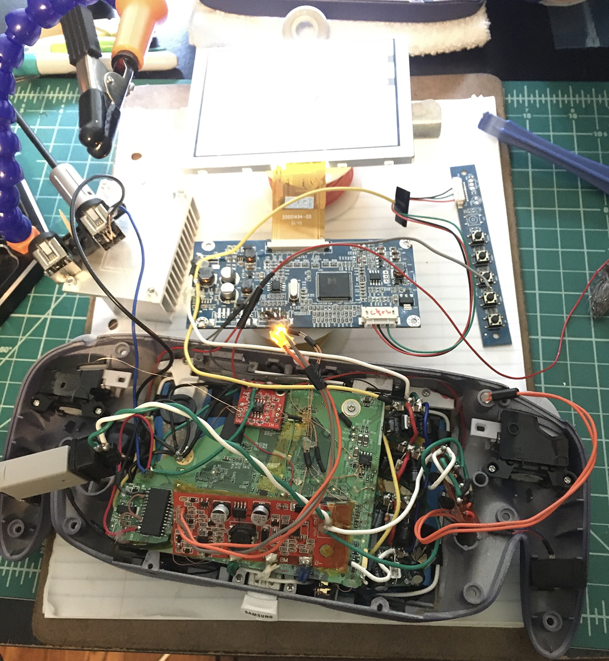

After a short hiatus I'm back, I ordered my headphone amp and got the board secured down, and hit some problems as usual.
When screwing the board down one of my screw posts kept breaking from inside the case, I glued it back with some epoxy and was able to get a screw in there carefully. I was about to turn the Wii on to test the audio but I found a short between 5V and GND, after some disassembly I determined that the short was on the PTH08080's solder points. I'm not sure what caused this since the last time I turned the Wii on it was fine, and I haven't changed anything or given power to the regulator since, but I ordered a new one and I'll troubleshoot with it next week when it gets here.

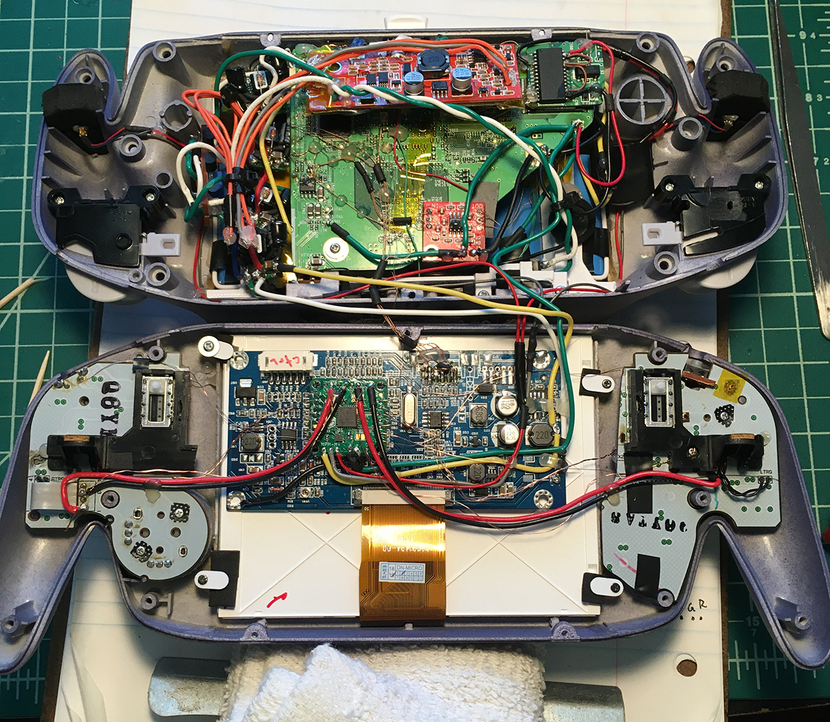

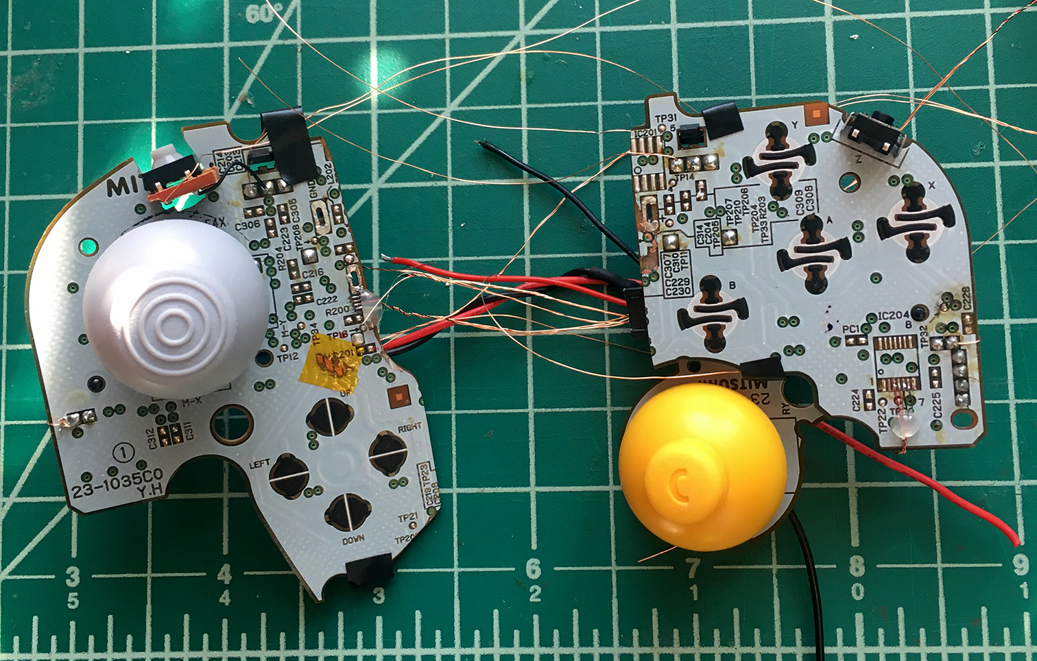

In the meantime I wired up the controller halves, having to make some slight modifiactions to the black trigger housing pieces. I can tell that closing the case to get the controllers to fit with all the wiring is going to be tedious. So if my audio and controller are hooked up right, all that is left is to wire up VGA, connect the MX Chip, and close the case, once I get this regulator issue figured out.

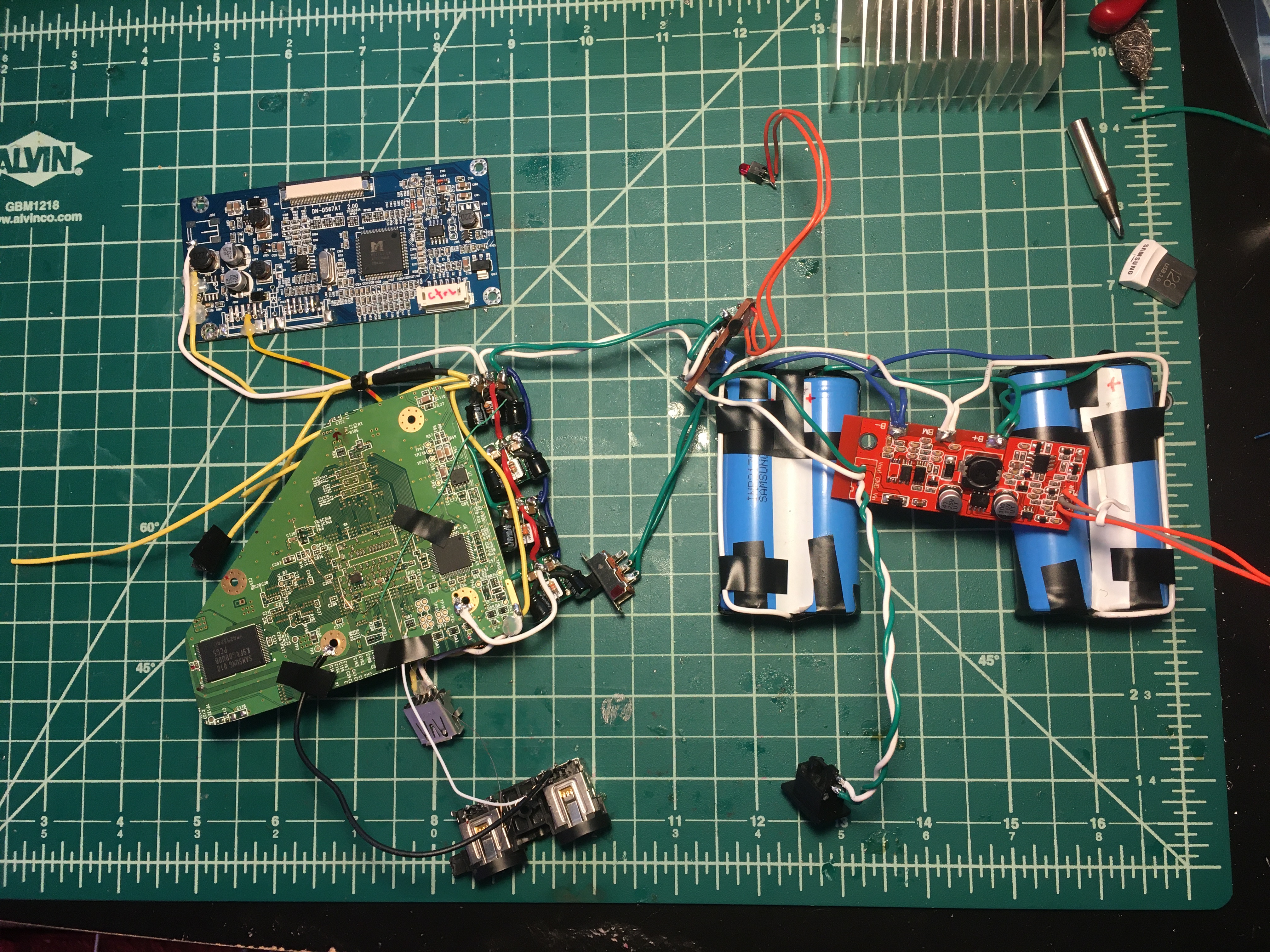

I replaced the 5V regulator, got everything hooked up correctly and then powered on my portable but the video wasn't coming through, I think the composite wire had been disconnected under the board because I couldn't find continuity. So I soldered on a new wire using one of the points next to the AVE, powered on, and heard a brief loud buzzing noise before quickly turning it back off. After testing I found that now my 3.3V PTH08080 regulator was busted, same issue as the 5V one where the voltage now had continuity wih GND. I am starting to wonder if this issue is being caused by my soldering multiple wires to the output of the regulator, but I can't really think of another way to do it while keeping the voltages in parallel. The only other cause I can think of is my big 21700 batteries, maybe the current is too high for the regulators?
I'm really hoping that the buzzing noise I heard was just the fan but I think I probably fried something, most likely including the Wii. I'll order some more PTH08080s and redo my wiring, but I'll probably take a break from this project for a bit to focus on some other stuff. Fingers crossed I don't have to trim a new Wii.
If anyone has any guesses as to what is causing my regulators to die, I could use some pointers so I don't keep making the same mistake. Each time I turn it on I test all grounds for continuity and test all voltages for shorts, so I really don't know what could be causing this.
Since I can't see anything visually wrong, I would disconnect all voltage lines, and reconnect one component at a time (ie start with just the wii and check voltages, then wire up something else until you find where the problem is). You may also be pulling too much current through one regulator, as each one is limited to 2.25A maximum for the output current.
I think you're right, I plan on getting my new regulators set up and testing things more incrementally until everything is back together. I think from my wiring I had multiple series circuits going from each regulator.
Took a little break but I'm back at it, I replaced my bad regulator and tested with the Wii board and found that the board was dead, so I trimmed up my backup Wii and will test it once its all sanded. I reorganized my wiring so that each component is no longer connected to the output of the regulators, now I have just 1-2 wires from the regulator outputs that chain across each component. I tested my screen and fan and both seem to work after the regulator broke, and I ordered some backup audio amps in case those got damaged. Once the new Wii is hooked up I will test the current during brief power ups before going in and testing the software.

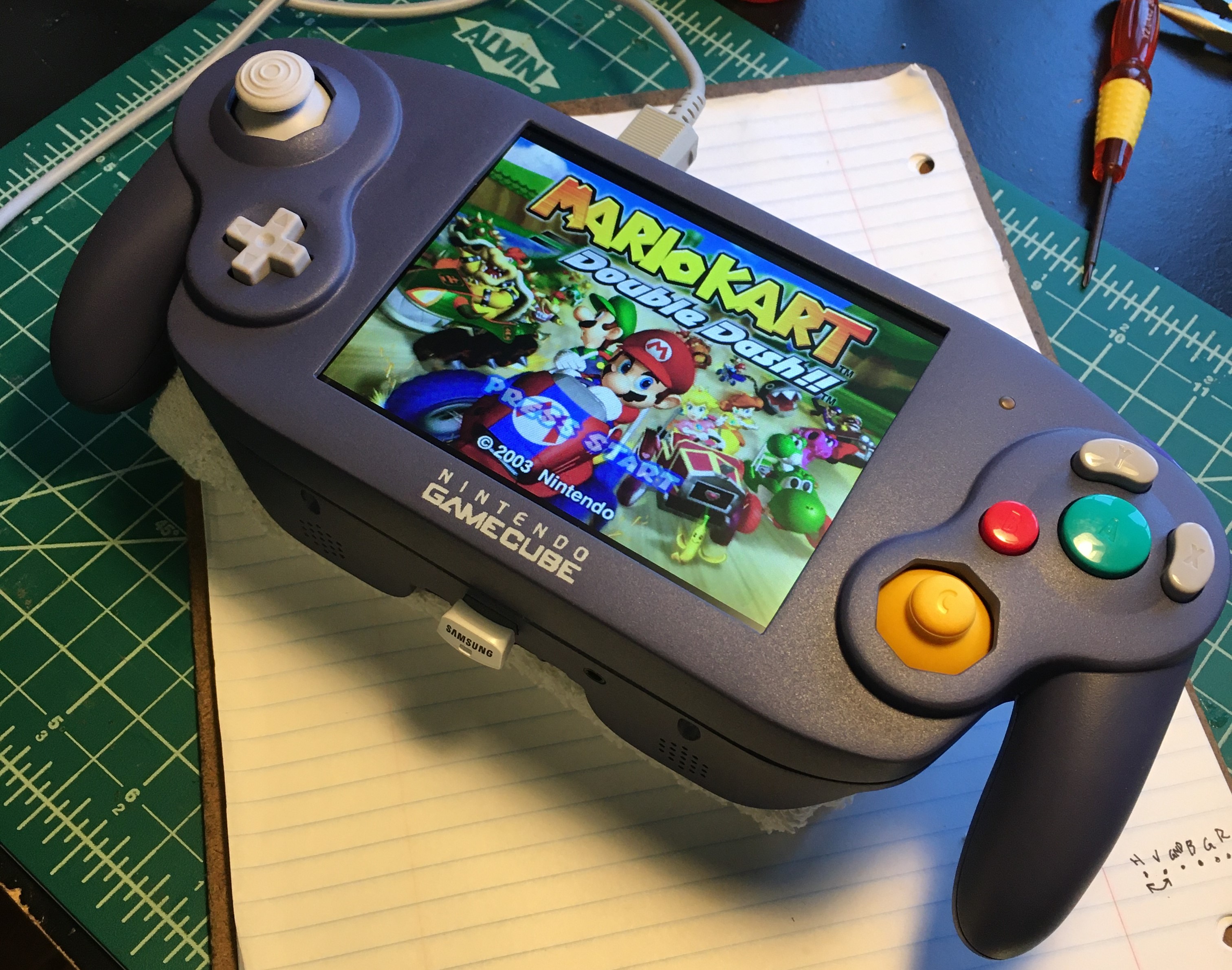

Audio, VGA, and MX all good!
After replacing my busted Wii board, I readded in my audio circuit and then relocated MX and enabled VGA.

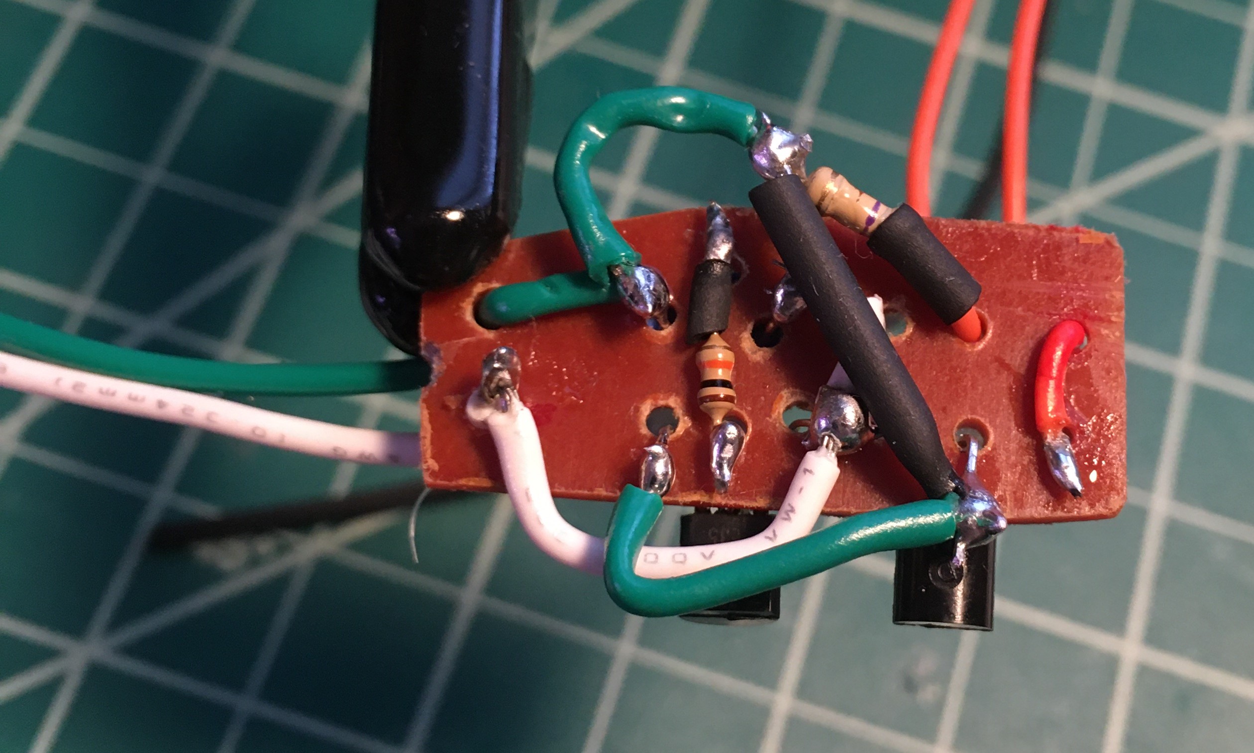

For the audio circuit I connected my Wii > TDA1308 headphone amp > 10k Ohm wheel pot > stereo switching headphone jack > PAM8803 Amp > speakers. Its not the most efficient setup but it gives me both speaker audio and the option to switch to headphones. I cant adjust the headphone audio so I just set the wheel pot to a level that was good for me.

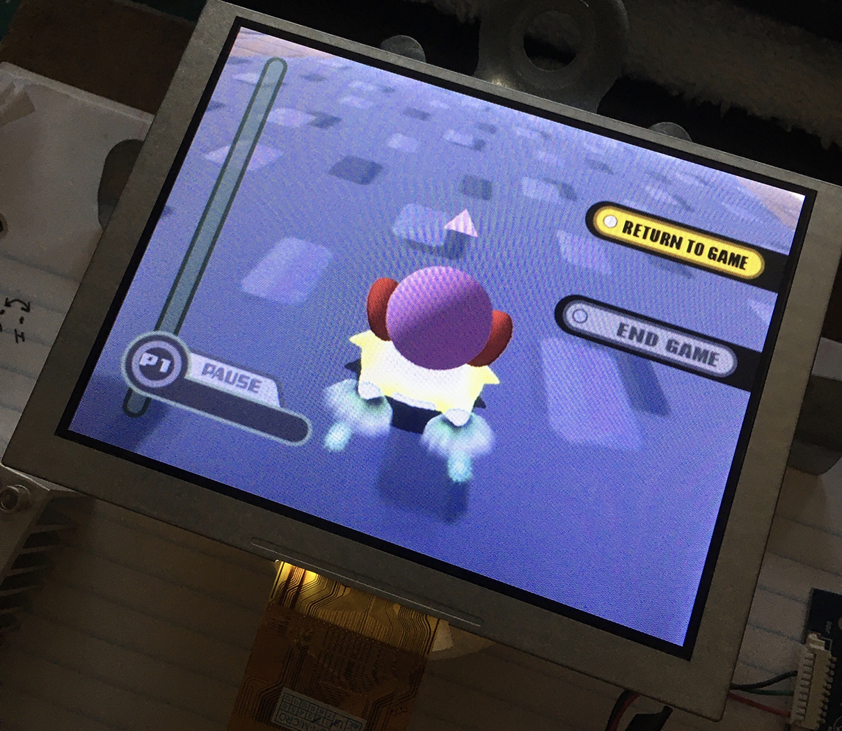

MX chip wasn't too bad, but VGA took some time. I spent an entire day removing a solder bridge from the AVE. What ended up working was using a stranded copper wire with lots of flux instead of a wick and sticking it down on top of the AVE, then pulling away toward the pins.
All that is left is to wire up the GC+ and then close the case! I'm going to continue working carefully but who knows what may come up.
Here are some bad quality pics showing the current build:

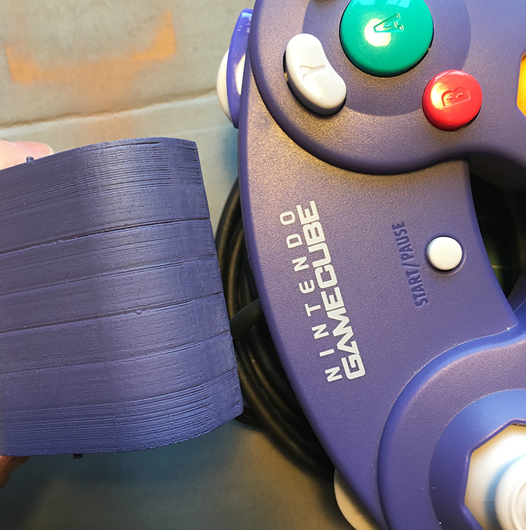

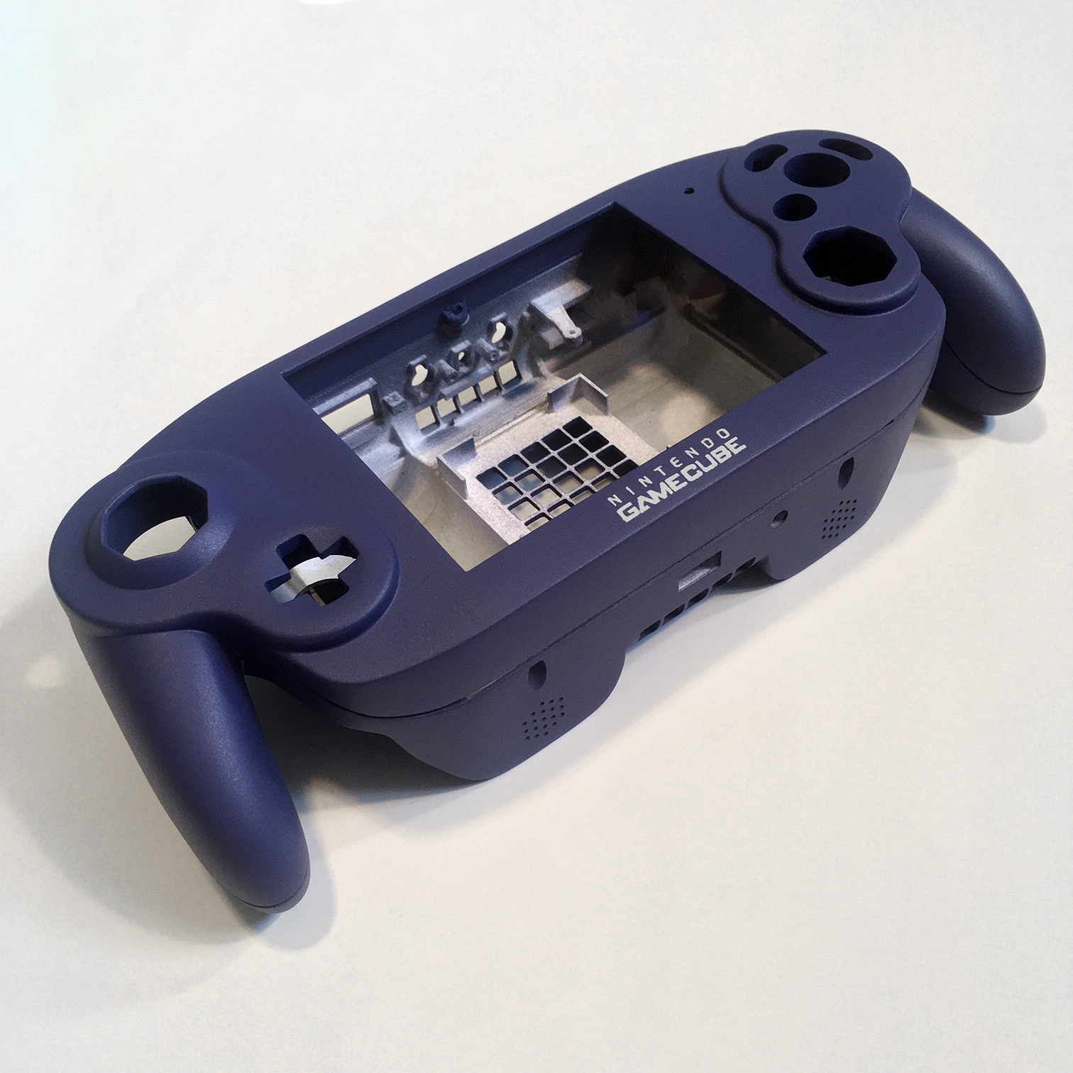

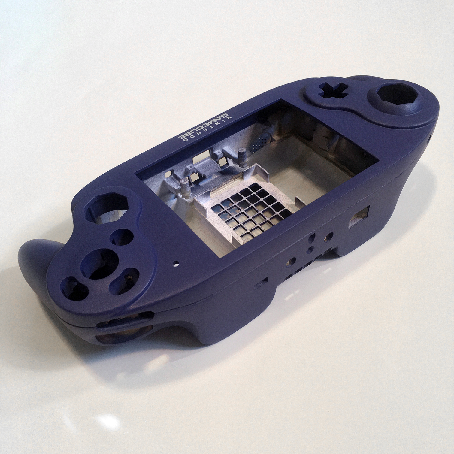

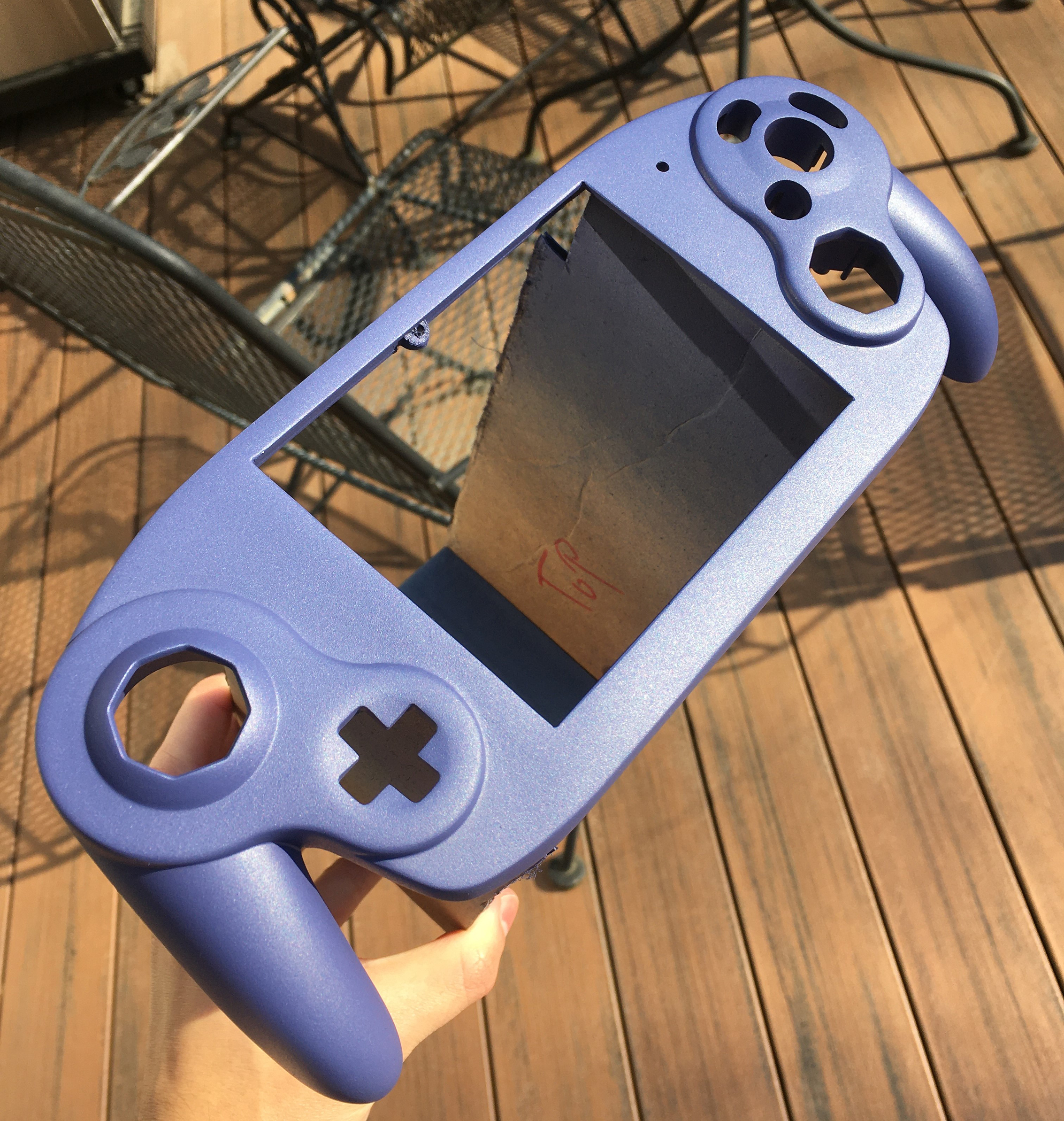

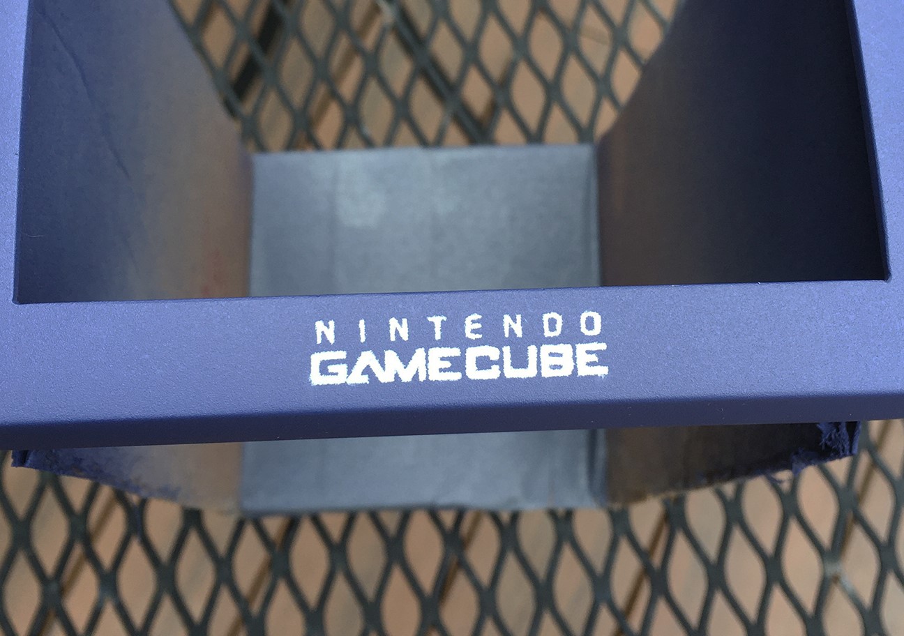

One thing you could do about the logo is sanding down the area that the logo is placed. I think a flat, polished finish would compliment it very well. With just a bit of radius outside of the text.
Great job on this project, also. This thing looks great and you definitely matched the indigo Gamecube look.

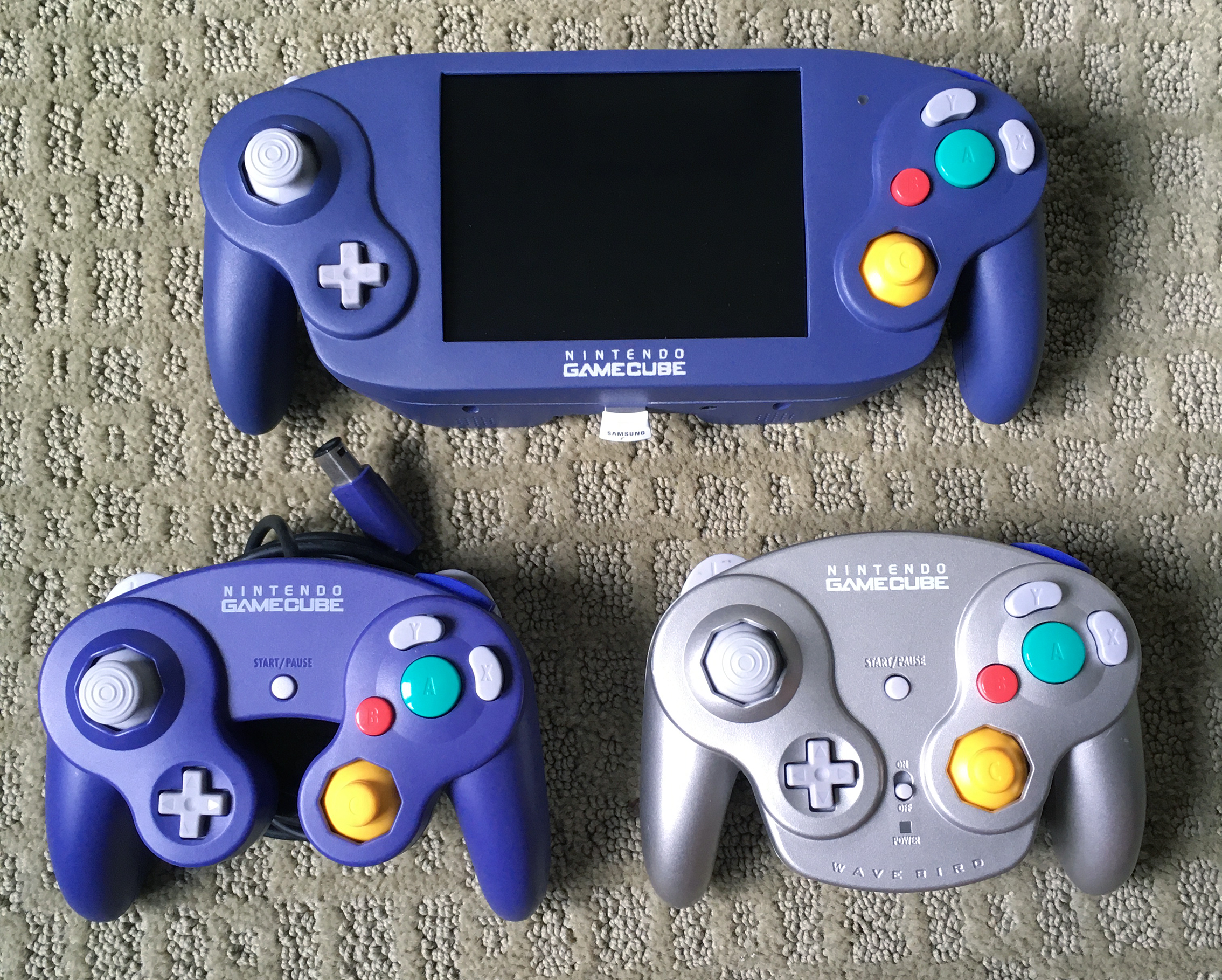

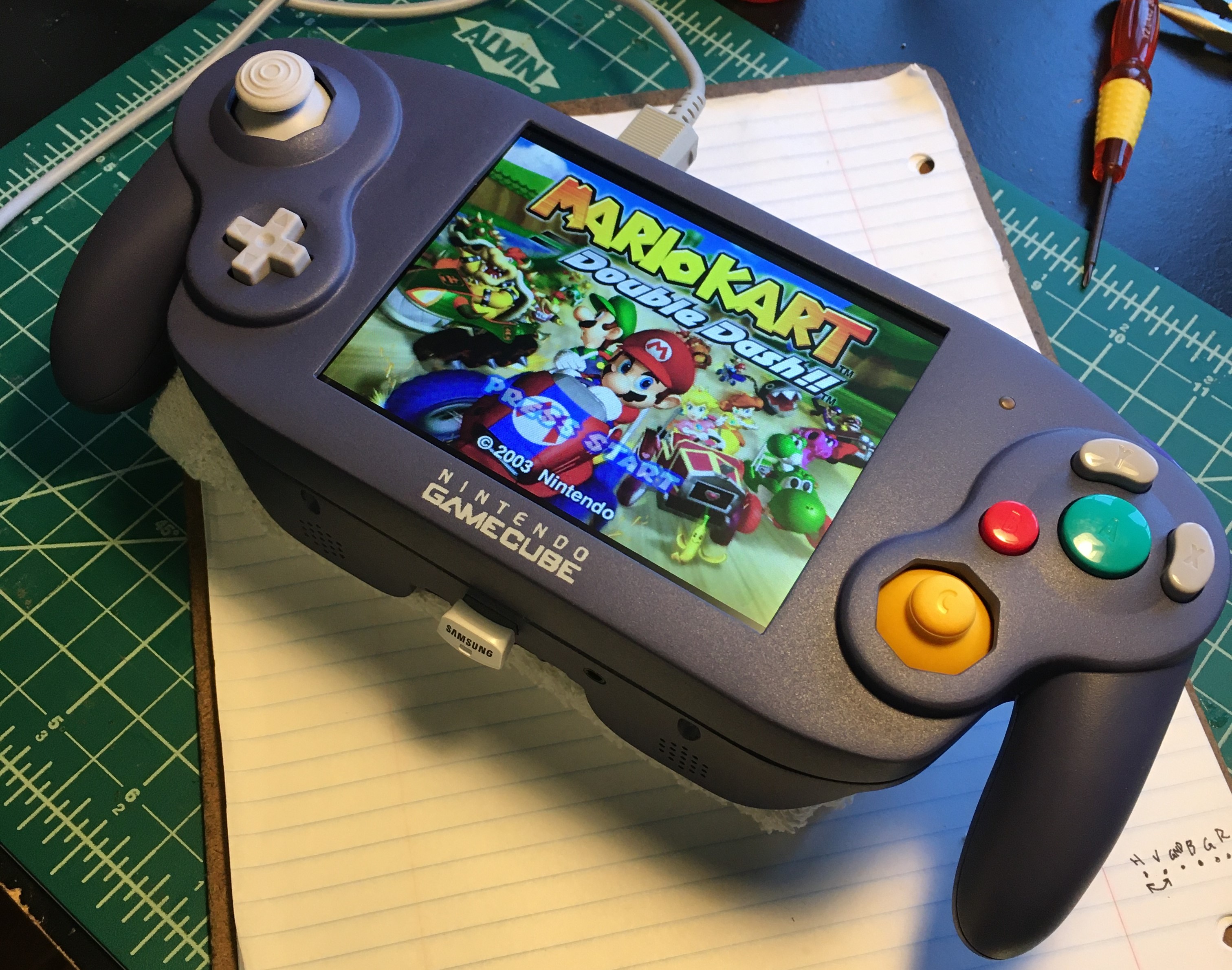

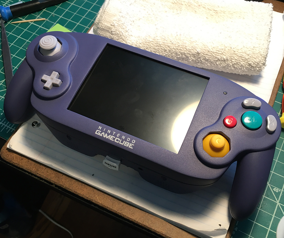

Finally done!
Got my hands on a new MX chip and swapped out my other one. I realized that when I have a coin cell attached, I sometimes get continuity between 3.3v and GND but not always, and I think this could just be due to the battery running. And only some grounds will have continuity with 3.3v, even though all the grounds are connected, so its weird. Either way the portable works great. I'm going to post later with some high res pictures as well as the STL files in case anyone wants to take on a similar project. I will say that I'm glad I chose the frankencasing route, it really is rewarding to be able to see what all of my work resulted in.
I'll get more specific specs later, but this thing is heavy. Using 21700 batteries was fun but I totally get why people like the 18650s. The battery life is around 5.5 - 6 hours. Not too bad for my first big electronics project!

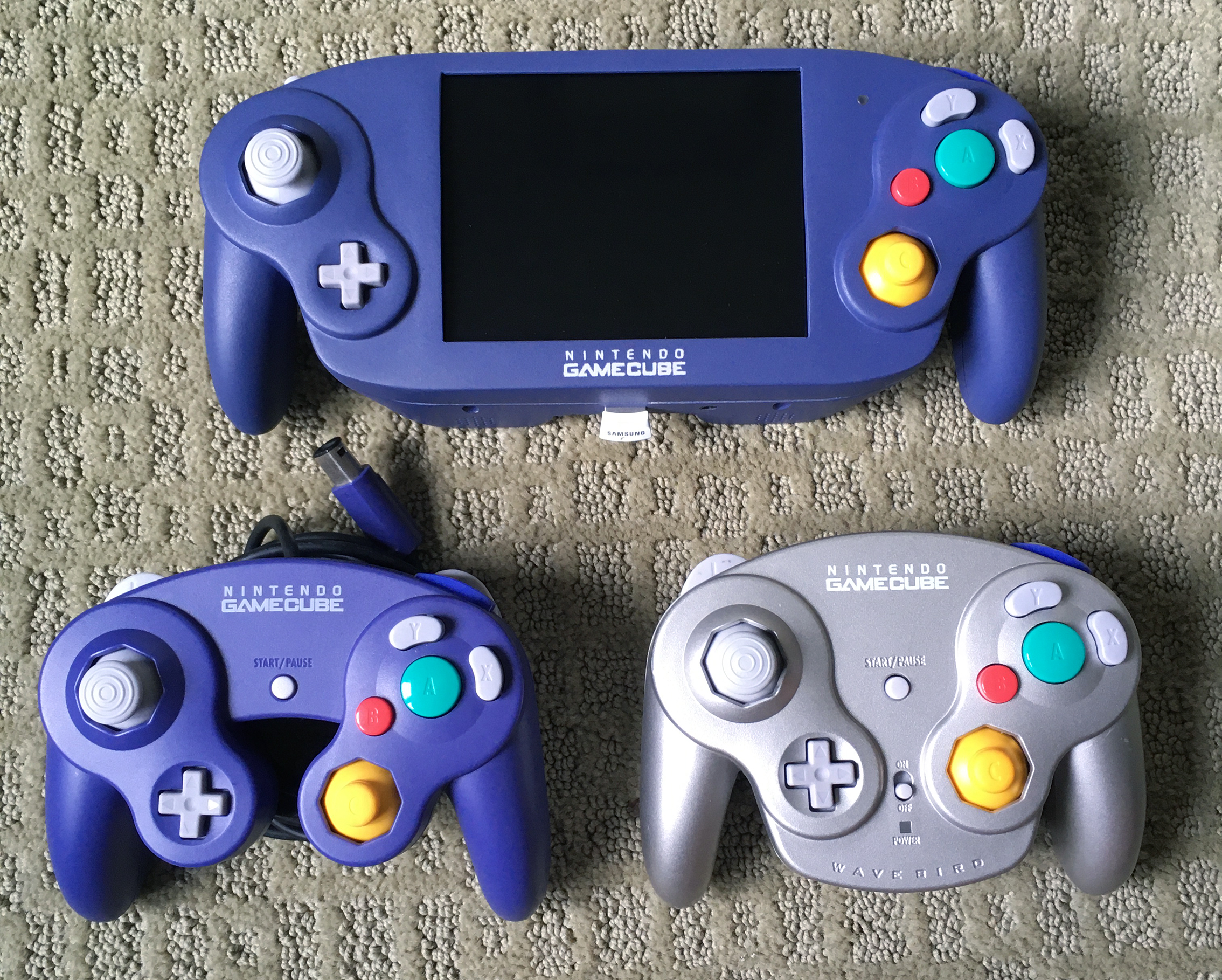

Finally done!
