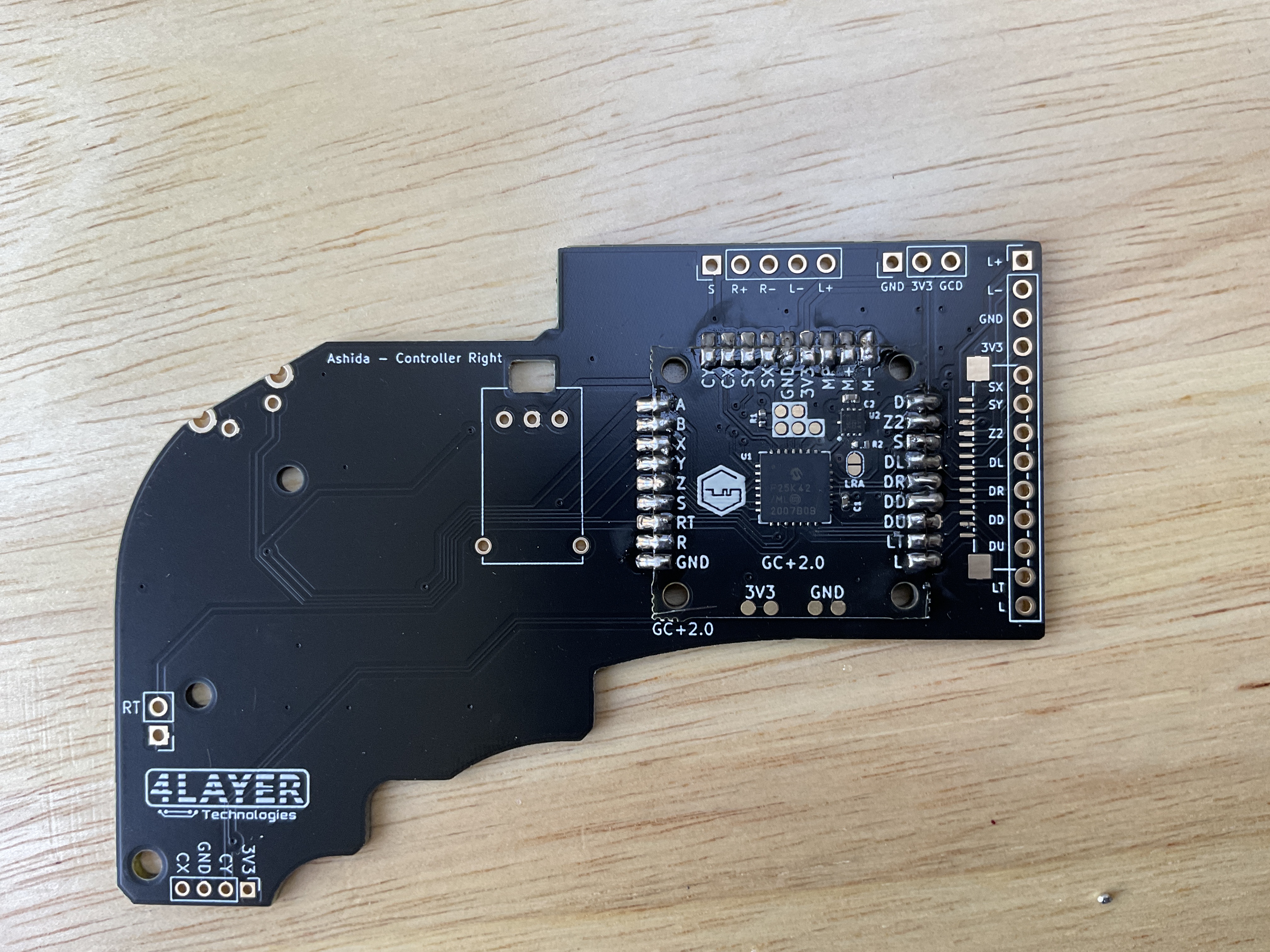

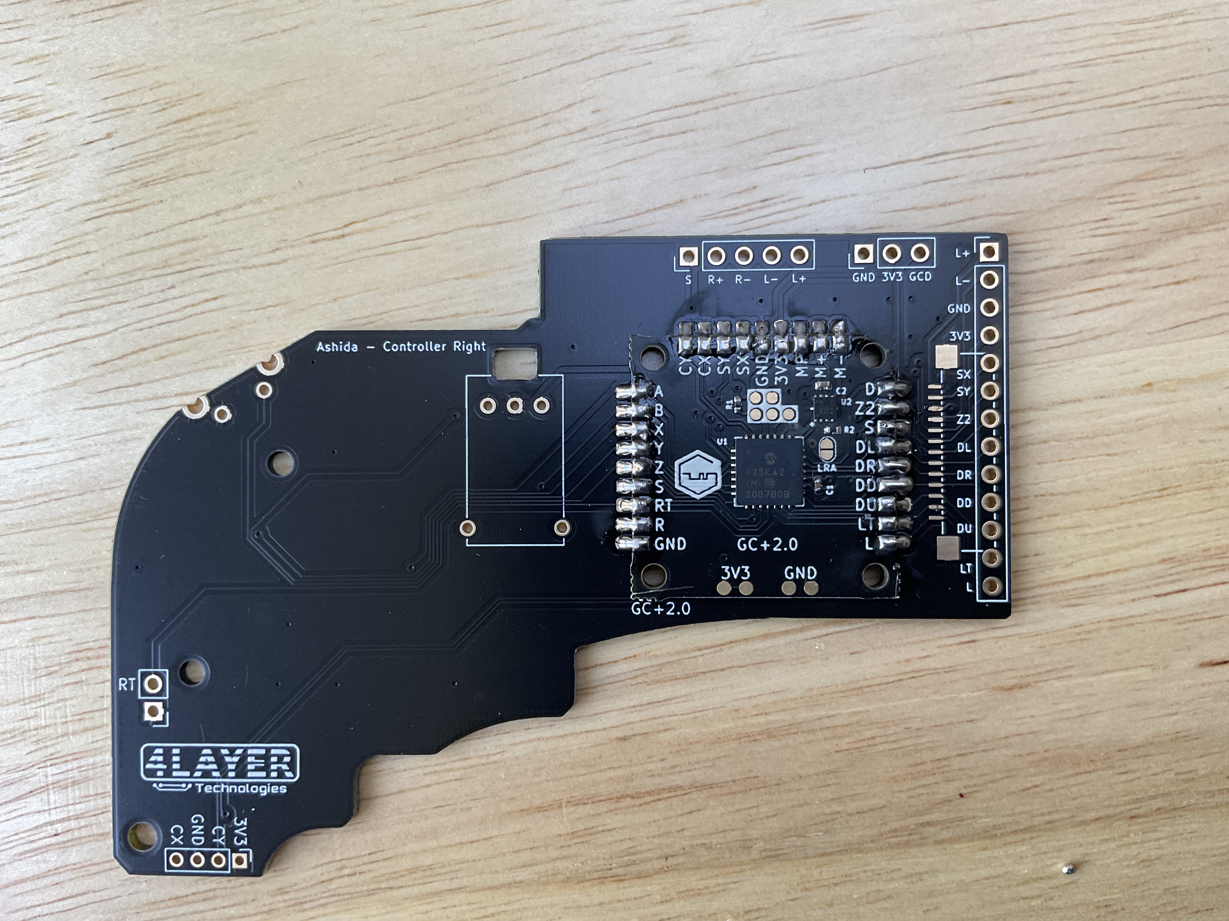

My 4Layer Tech boards have arrived so I thought i should make a worklog so i can document my build in the near future when i get my others parts. I shall now wait.....

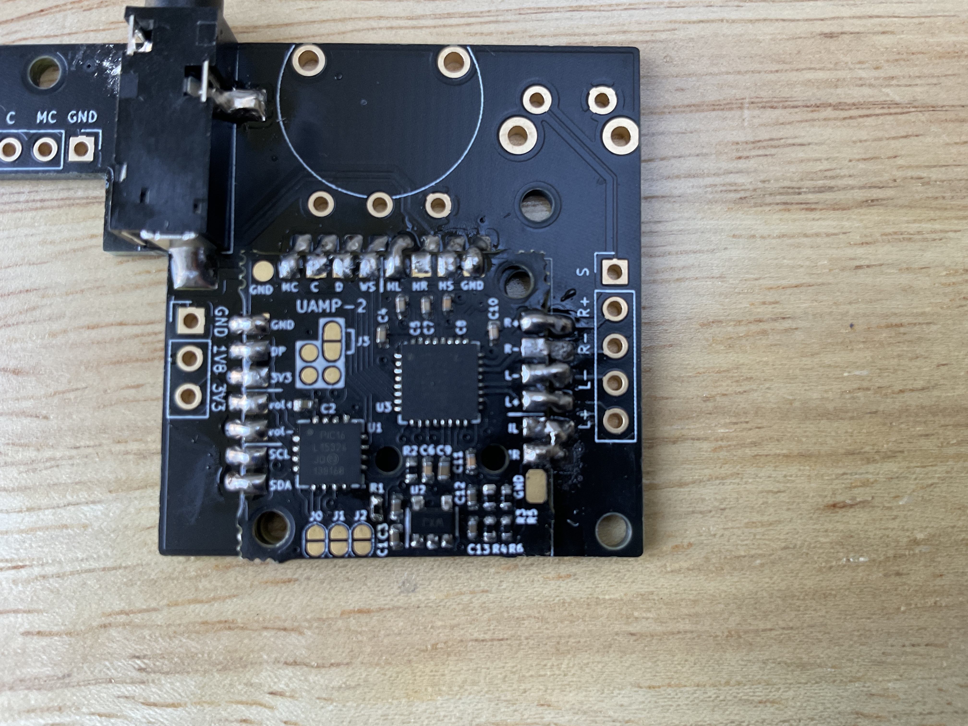

I have soldered the UAMP to the Ashida pcb, but I have one question. Does it matter if IR and IL solder joints are connected?
Looks okay to me but I would recommend to check if anything is shorted. S and DL may be touching from what I can see
I double checked them and they are fine and aren’t touching :)

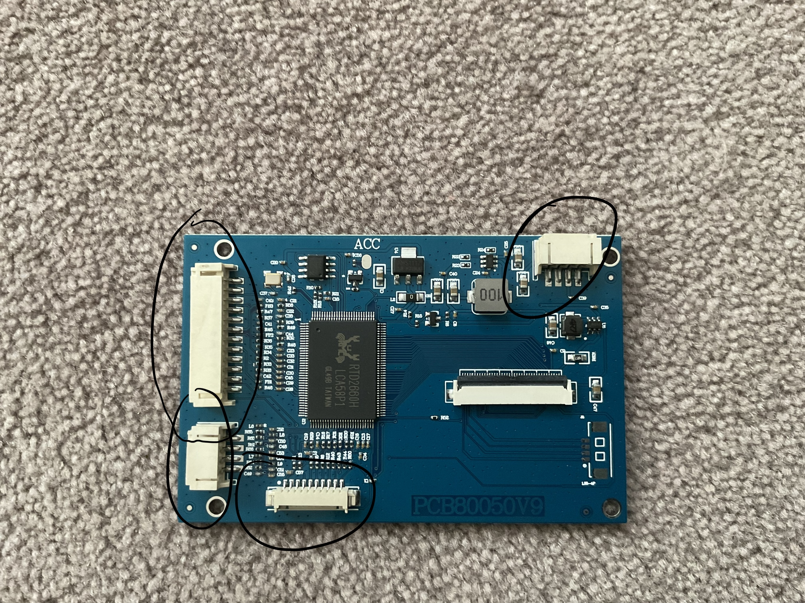

This may be a silly question, but do i have to desolder these connectors from the driver board?

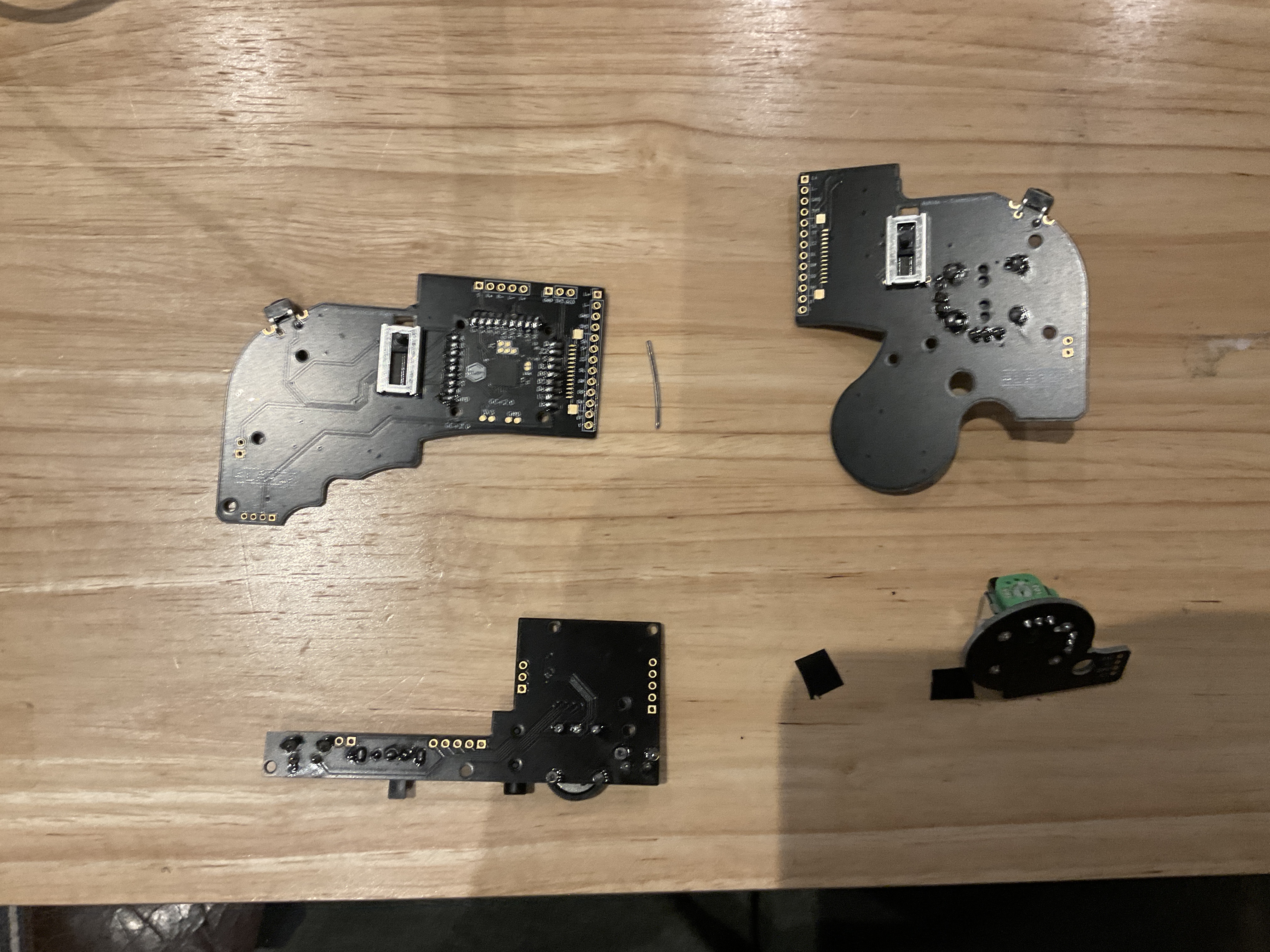

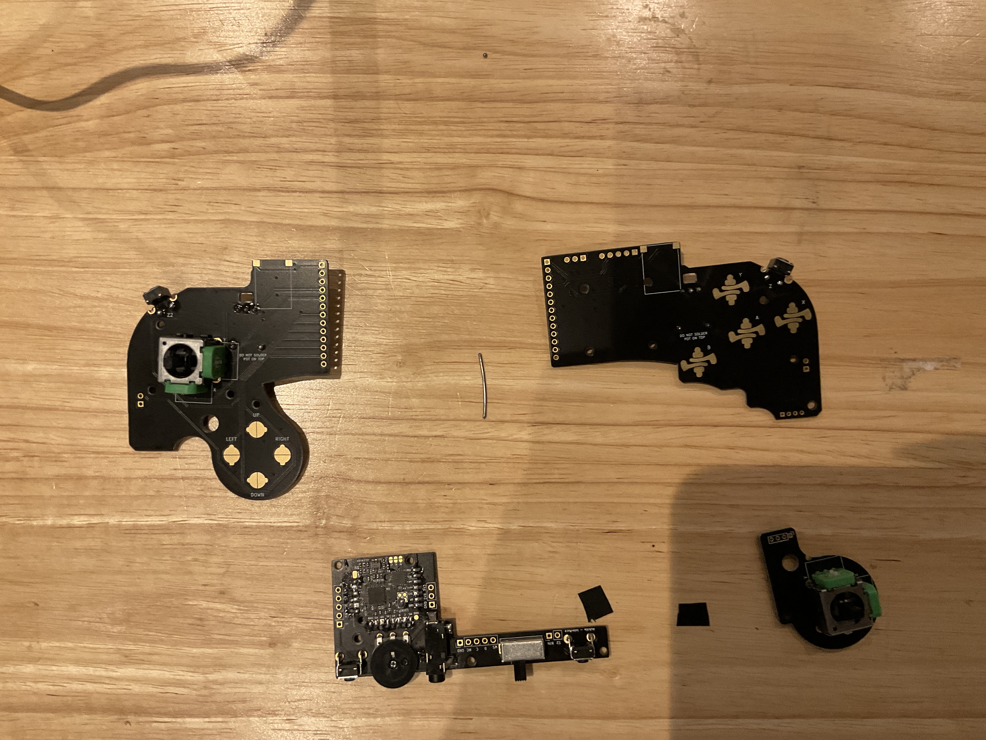

Alot has happened since last post. I got my case and soldered the pms lite and the pms pd. I wired up the battery contacts and then soldered them to b+ and b-. I soldered in the fan as well and it was working fine. The next day i was showing my little sister, but instead of it turning on the 2R2 component on the PMS-LITE started smoking and one of the capacitors popped. If i removed the popped capacitor should the pms be able to supply power to the components now?
Magic smoke is never a good sign. Disconnect the batteries immediately, take picture of the board, and post them here.
