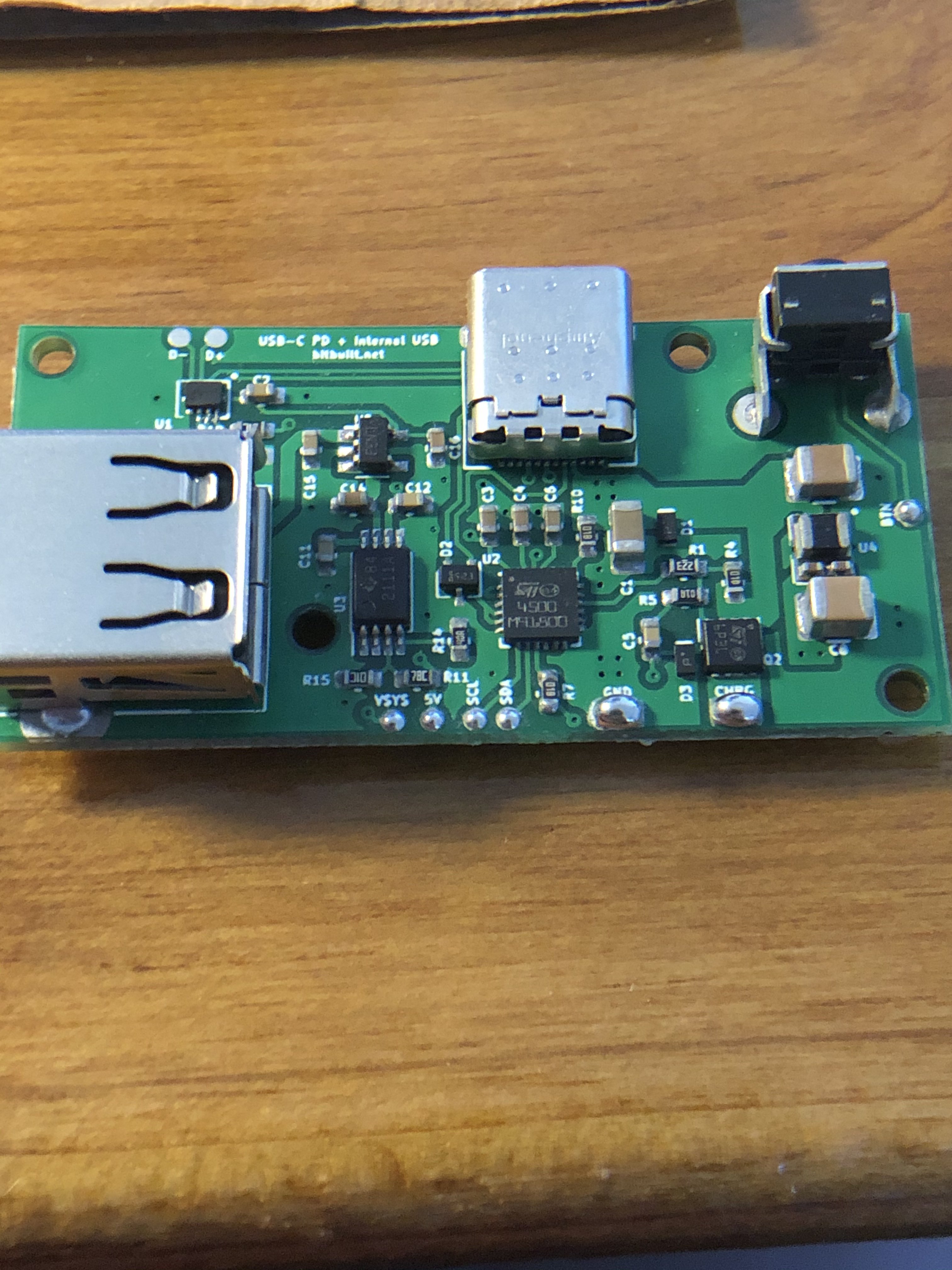

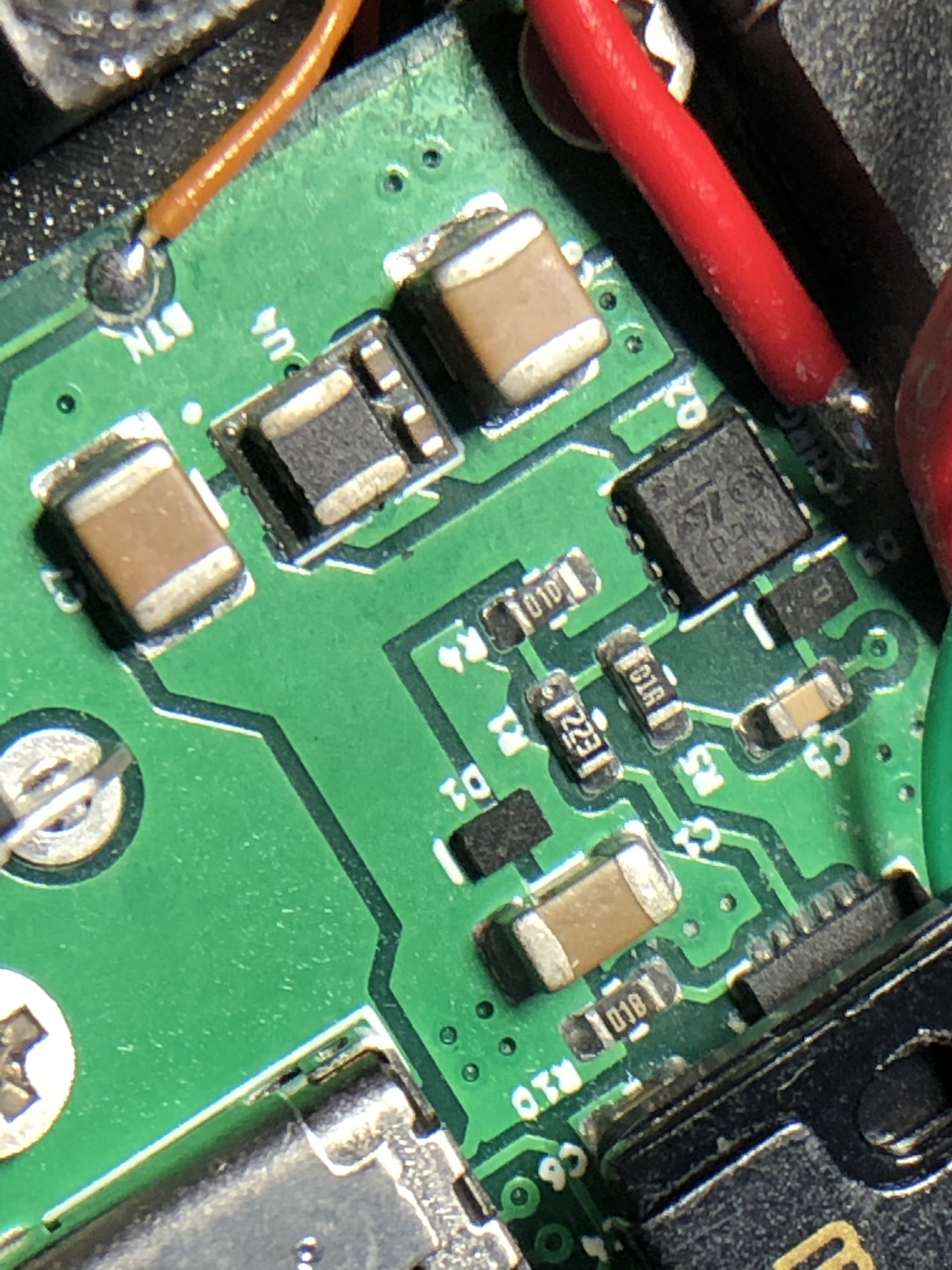

Look closely at R4 on the usbc board, is that a solder ball?
The light sequence doesnt mean anything, probably just the PMS switching between charging and fully charged if the battery is near its completion.
The usbc board should connect the drive to the computer with all the wires disconnected. If it doesnt work in this way, then something could be wrong with it. Could be damaged component or soldering. Could you try this? If it fails, then I can send you another to try. I have a test fixture for the usbc boards that tests the usb multiplexer, the sda scl, and the charge voltage so at one point it was functioning that is for sure.
Thanks gman, I have no doubt you tested it. I followed the guide exactly and the only wires that were reversed were identified and fixed before batteries were anywhere near the unit. The board looks brand new on my end. On R4, that was just the white paint as seen in the photo attached.

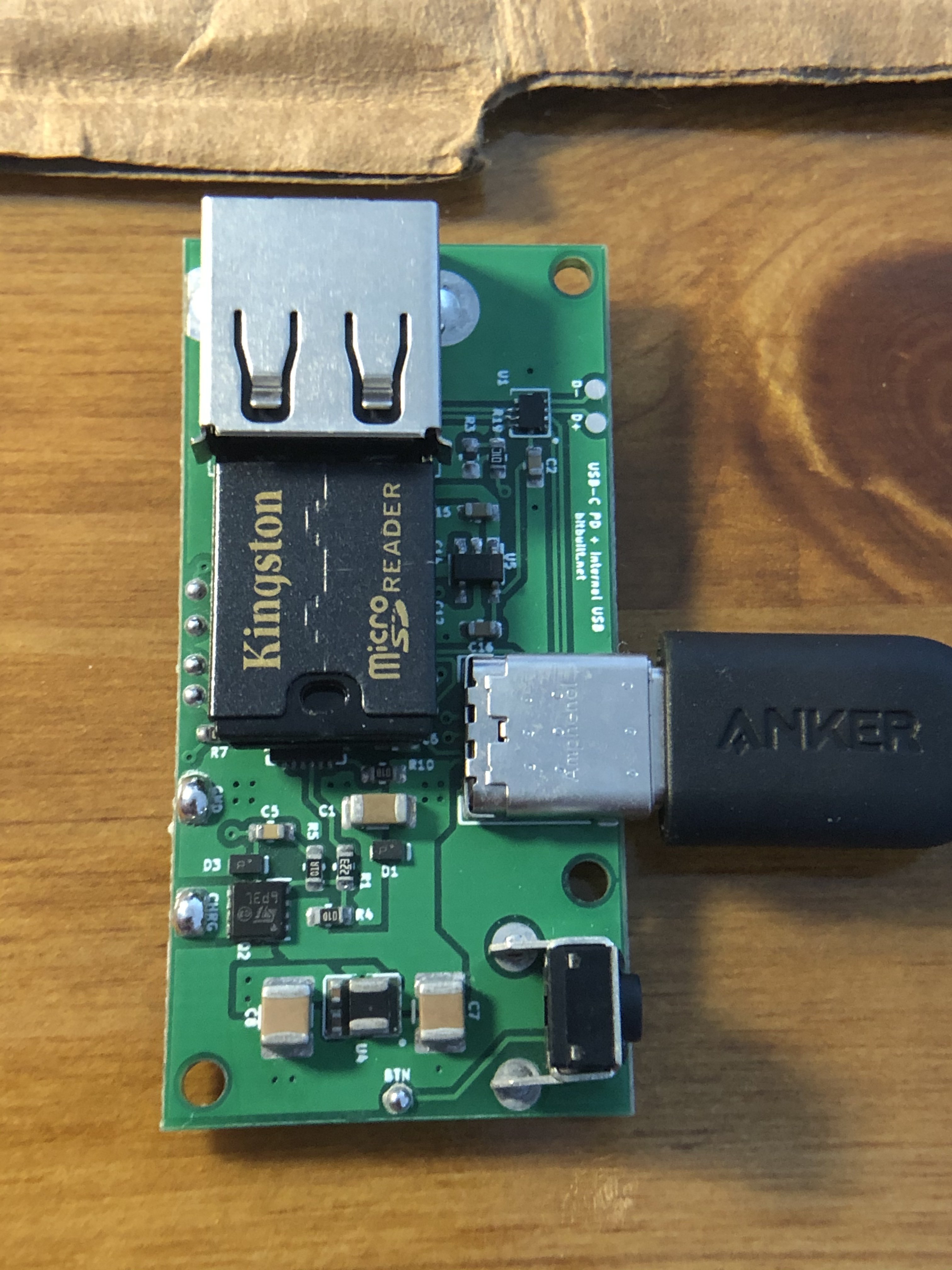

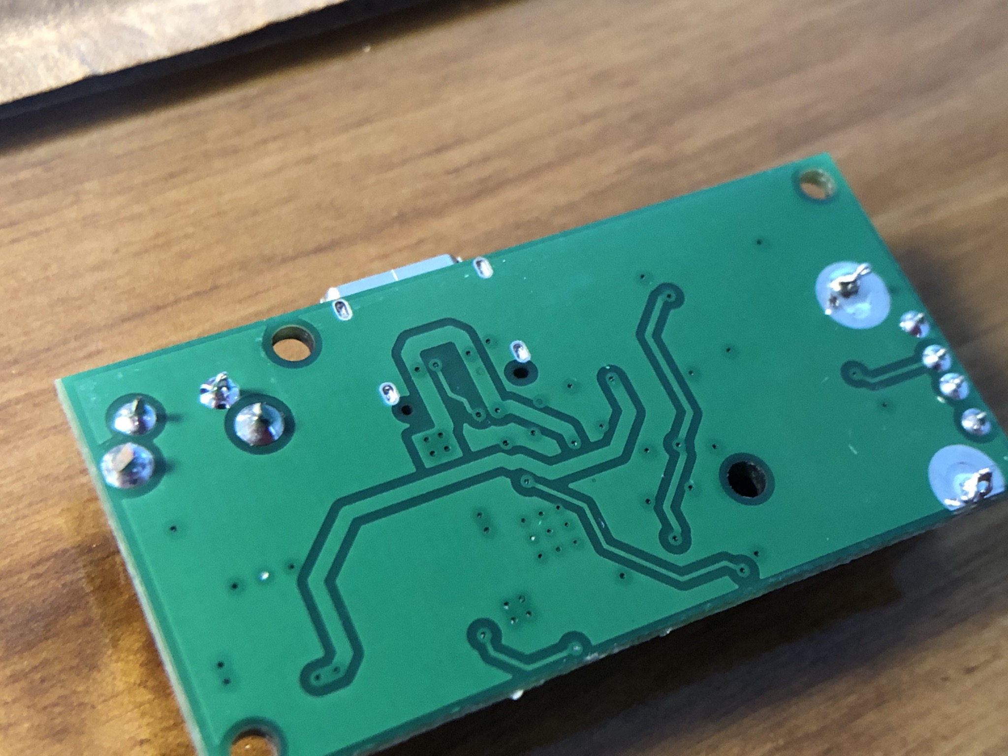

I desoldered everything and the sd card still doesnt show up...here are some pictures.
does the usb adapter + micro sd show up if you plug it directly into your computer?
Ok, I dont spot anything with the board it looks clean to me. Let me think, I'll message you with a solution and/or further testing.
