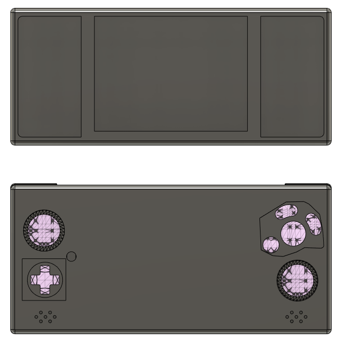

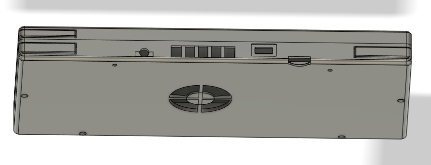

Hello,
I am doing a new portable wii.
This time it will be a clamshell. I ordered different sorts of hinge, for a notebook and eepc, but they are quite big.
I plan to use some 3DS xl ones, but they're the last one to come.
The screen I will use is the 5" screen from the store.
For now this is what I came up with (I ripped off the GWII system for the face buttons):

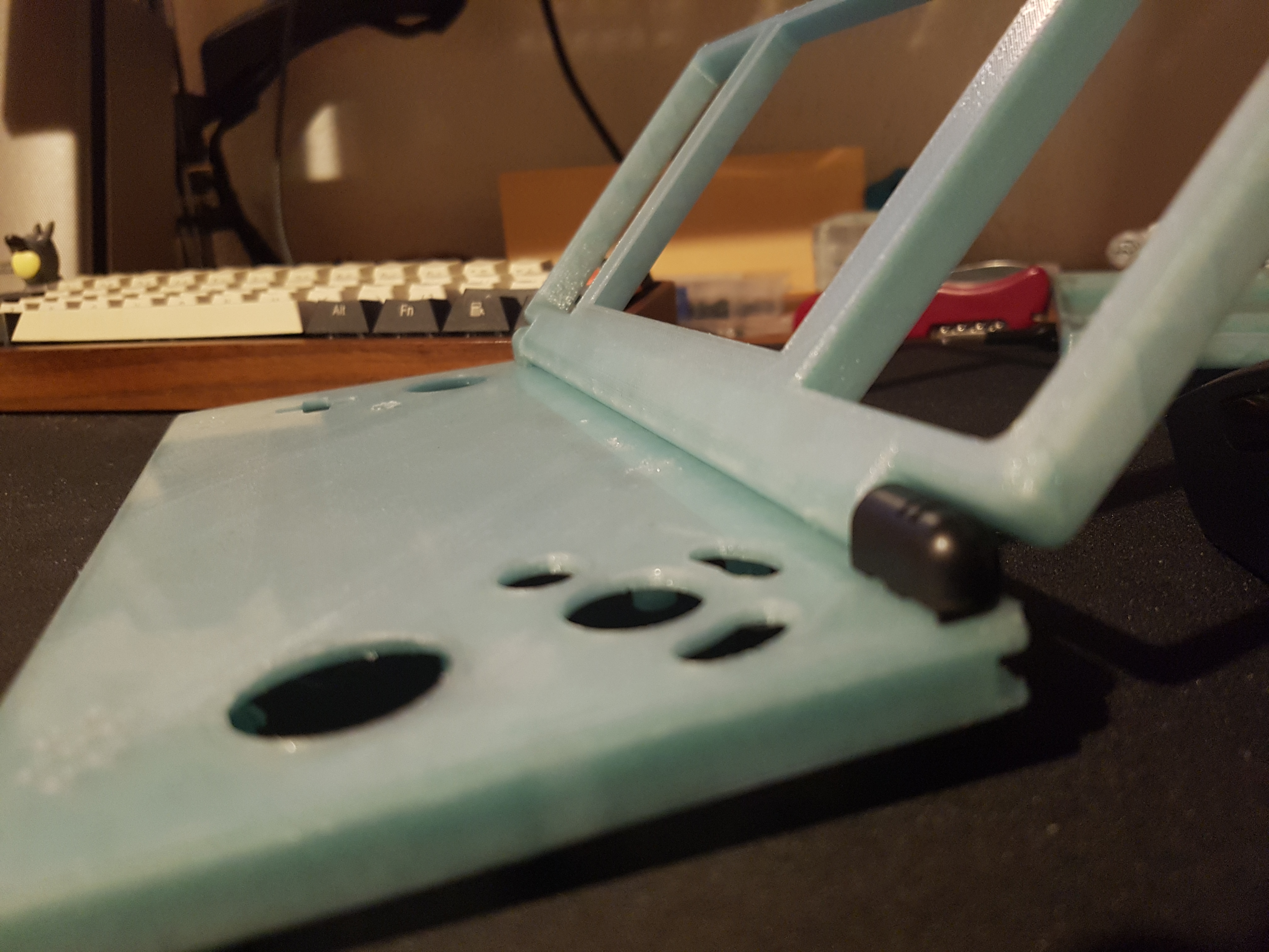

Hello,
There is some improvement in my design.
I now have a working hinge.
It is a DS lite one, I cheated a little by using an oem part.
I have a question for the clamshells makers:
Is magnetic wire sturdy enough to be in a hinge? Or should I use some multibraided wire (ie: an old usb cable).
Does someone sees a major design flaw?

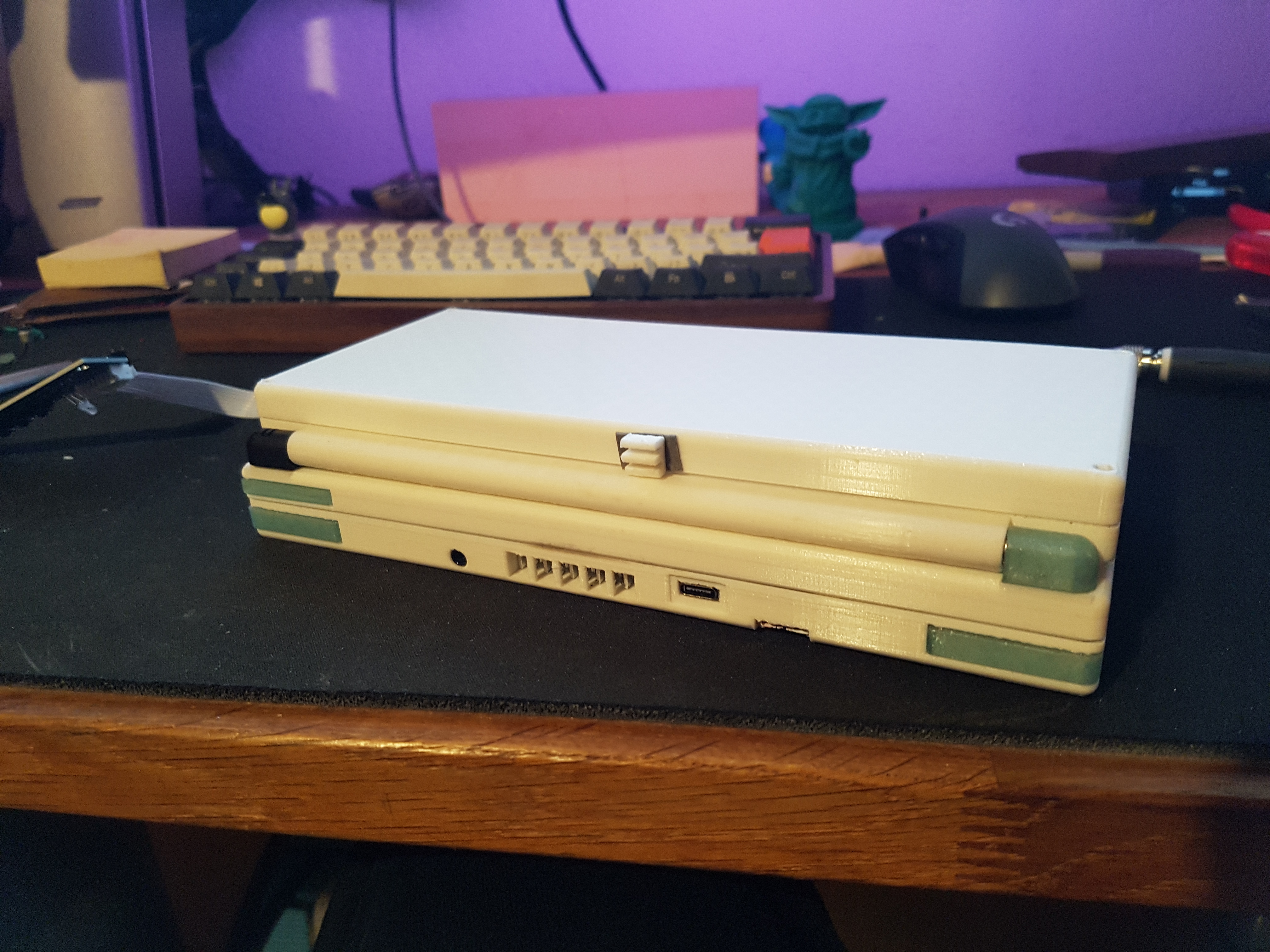

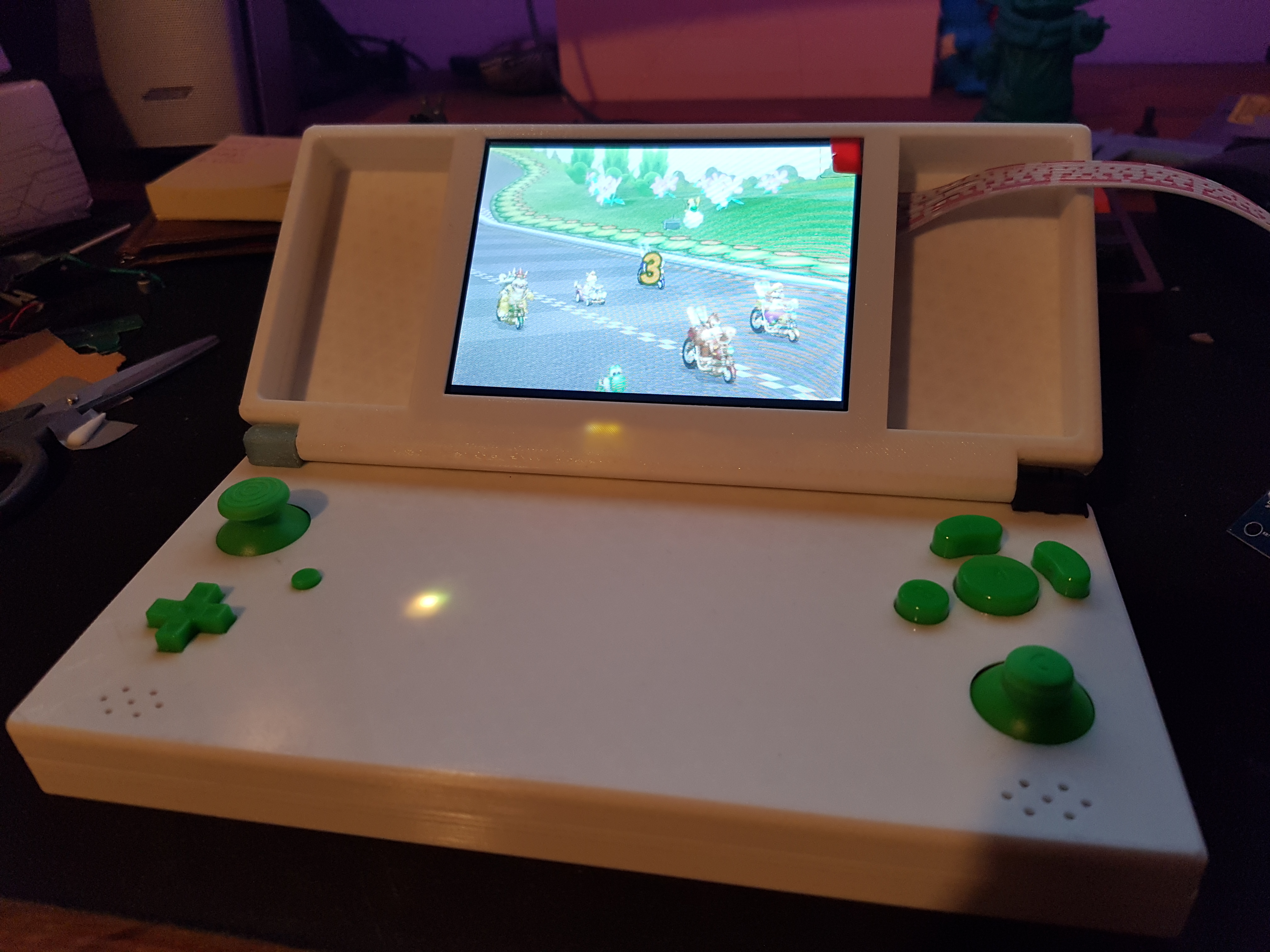

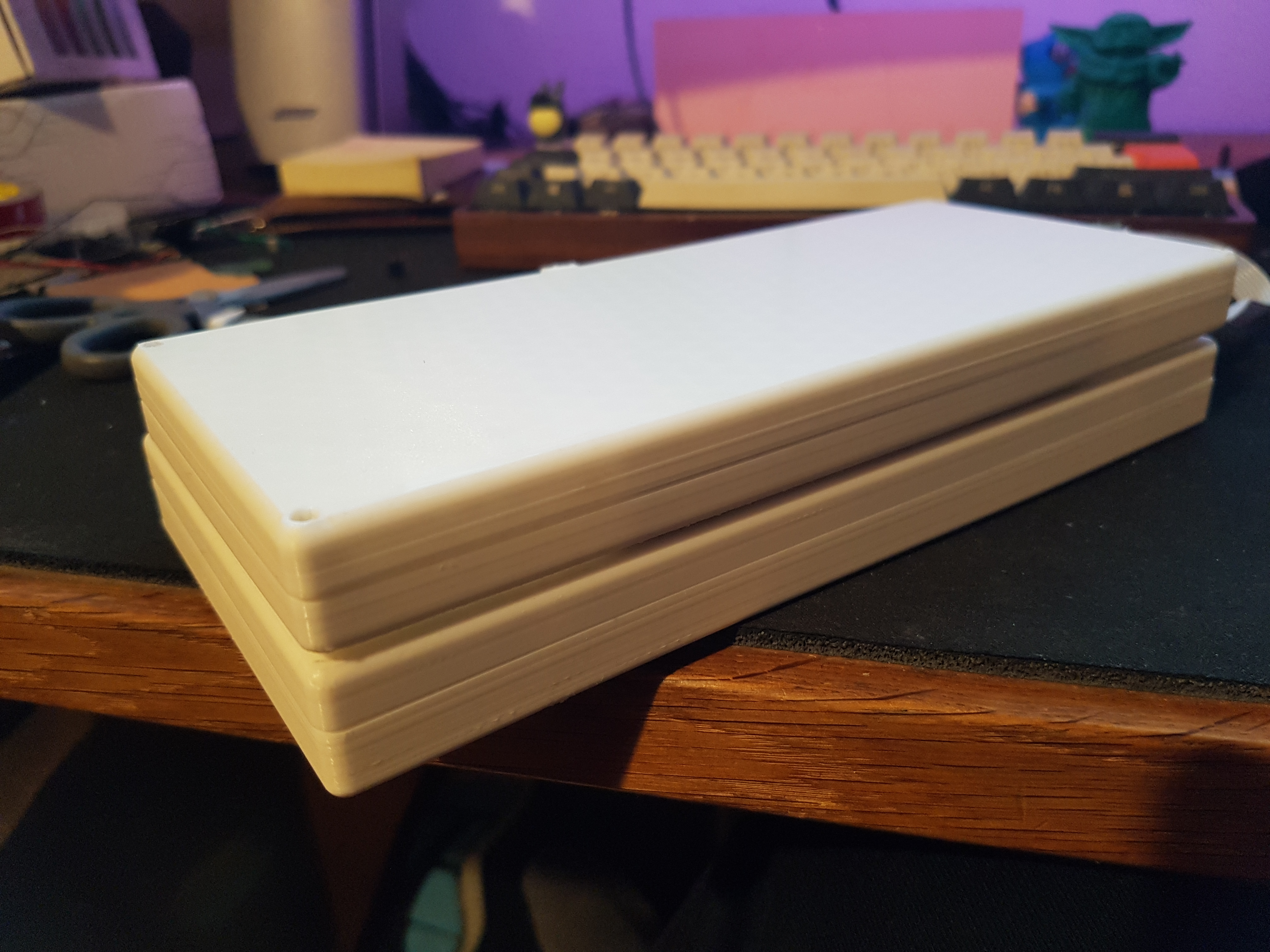

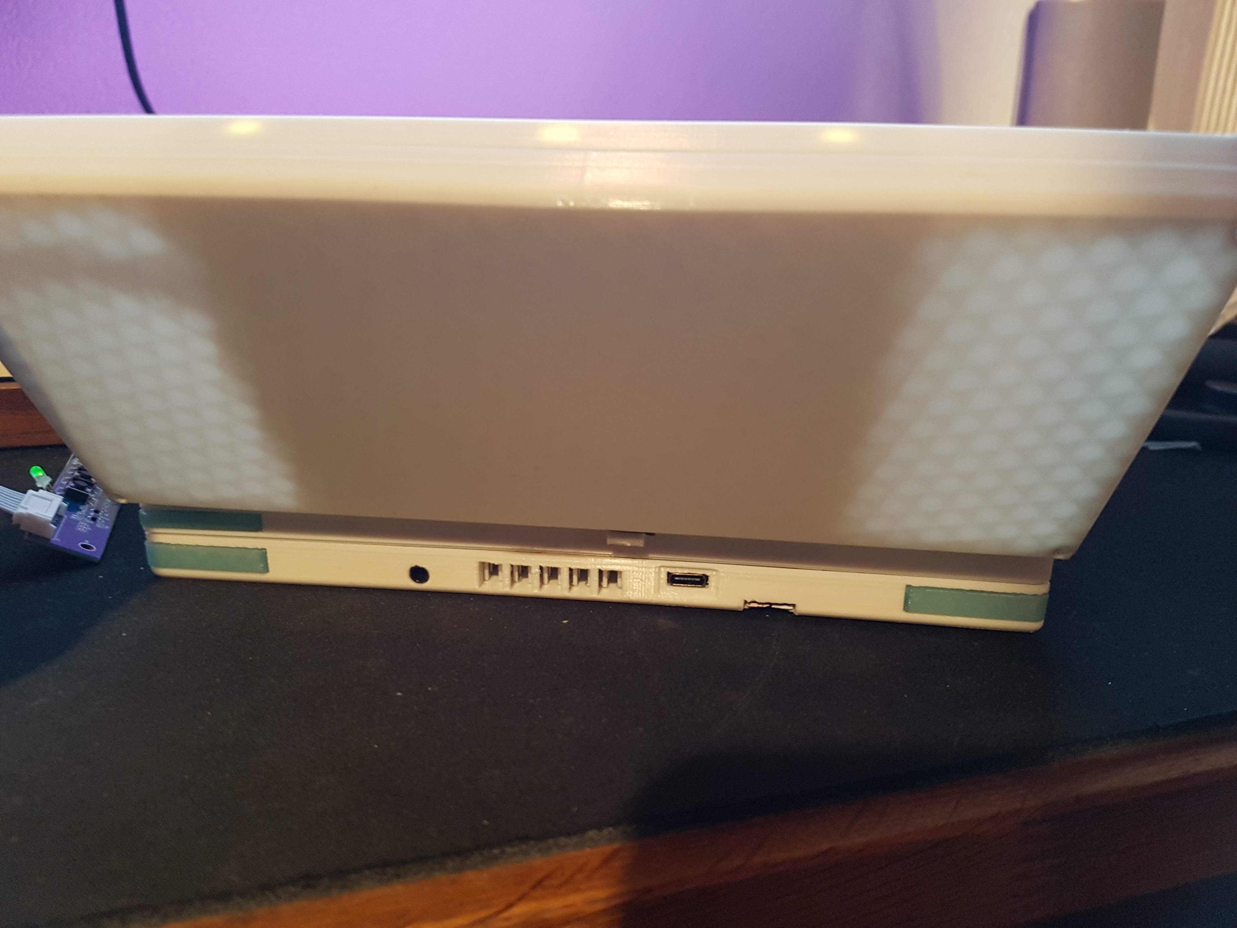

Hello,
It has been a while, but I have a working prototype, it is quite confortable to play and well balanced.
However, I'm not entirely happy about the design, so, any advices would be welcome.
It is quite bulky due to the driver board of the screen and the gamecube buttons, but I cannot do much about it in my design.
I wonder if I should remove the "wings" that were designed to protect the joysticks, but I don't know if it would look that much better.

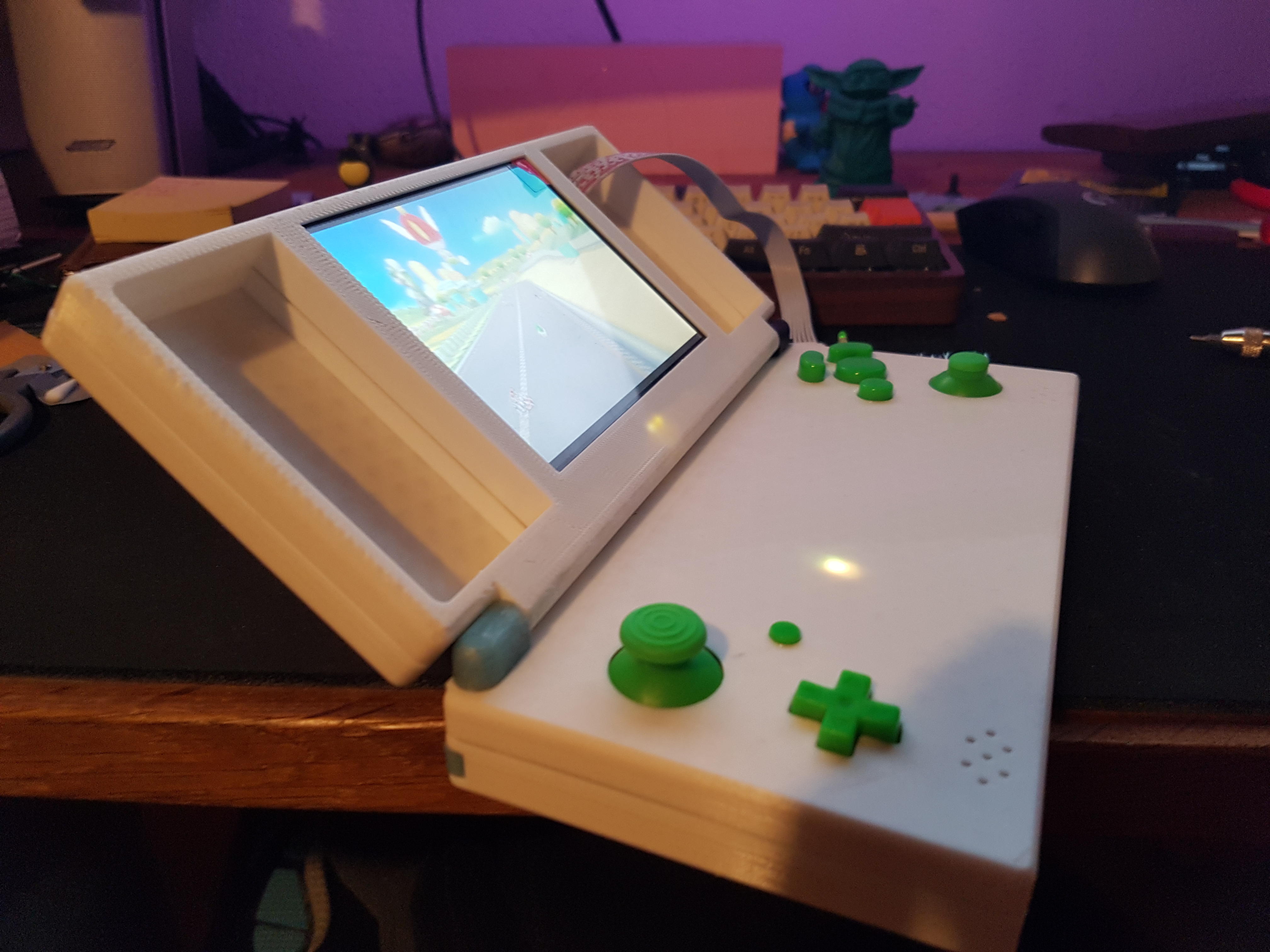

Hello,
I tested it extensively and I love the clamshell design, especialli with this 4/3 tn panel that have far from perfect view angle.
I have an issue: the single dslite hinge is not enough.
I will use a blocker to keep it open. But if I move it would be closing. I guess I'll have to use some magnet thingy to keep it open.
