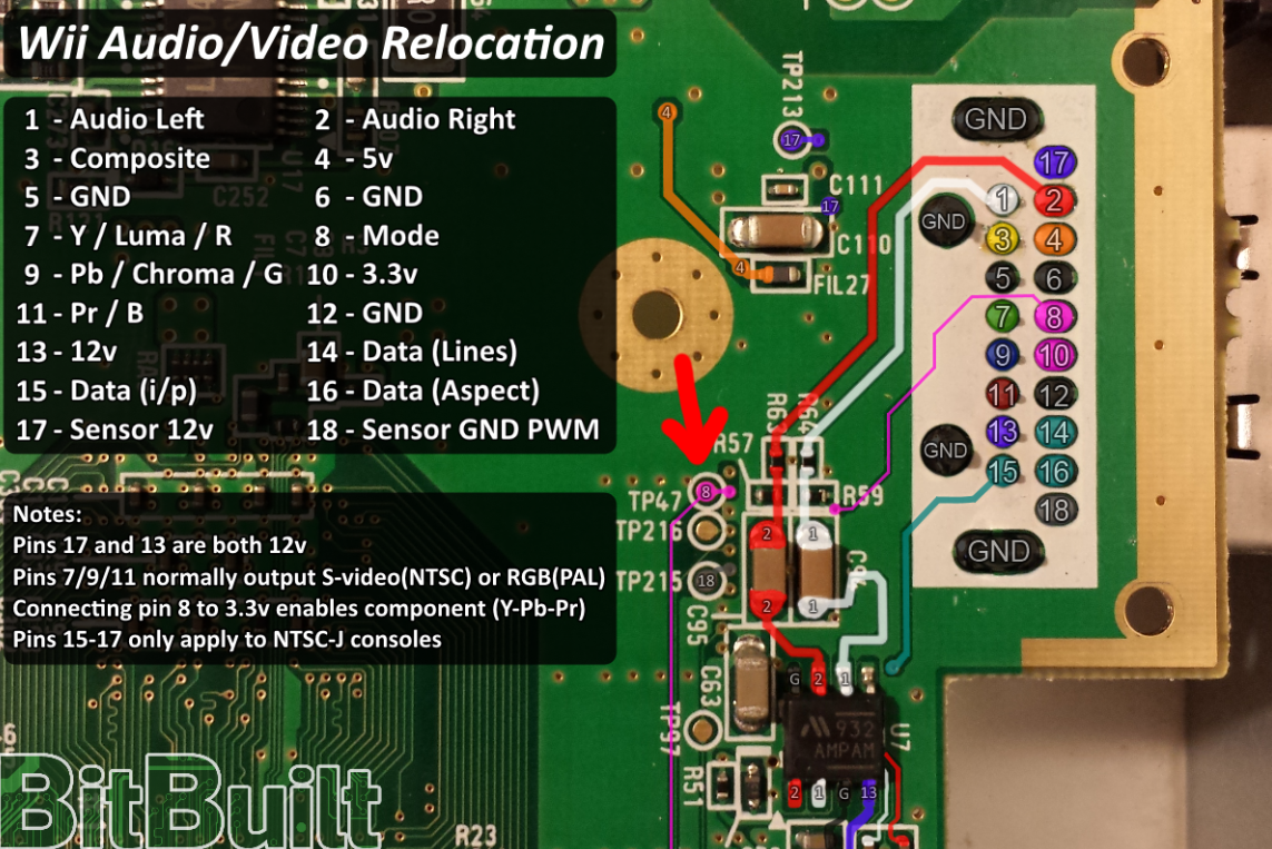

Is there anywhere else I can solder H and V sync to? This looks scary
If not, any tips? I saw the SMT soldering video you sent and that helped for the FFC connectors but these pins look even smaller

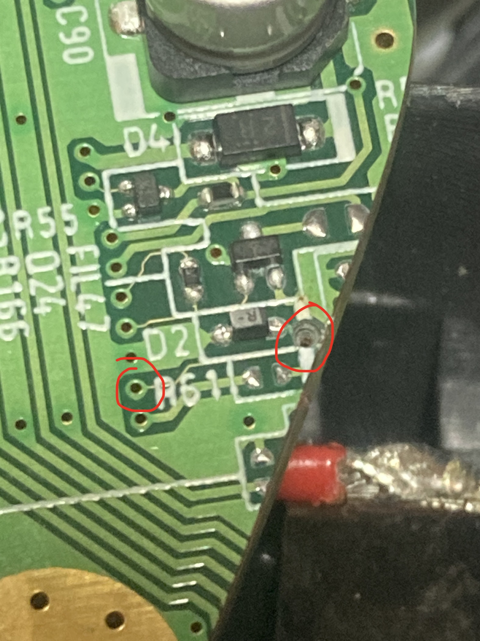

Another problem I just ran into is i think I butchered this mode via. These two red circles used to have continuity but now they don’t.
I think I know what I did wrong and how to do better on the other mode via— but will this be a problem that this one is damaged?

You can use a small piece of kapton tape on either side of leg your soldering on to prevent shorting any pins.
Thanks wesk, I’ll give it a go.
Welp, that via has been ripped out. I don't know the structure of the MODE lines and whether that bit of destruction going to break stuff, but I'd recommend using this test pad instead. Also, when soldering to vias/data pins it's generally better to solder the wire to a nearby attached component. If you'd soldered the wire to the diode right next to the dead via, you probably would have been fine.

That via is pretty far downstream, so it's fine that it's gone. Like Stitches said, solder to TP47, it's the easiest point. The yeeted via has a very low possibility of affecting anything.
Use the thinnest tip you have at around 400°C. Tin your magnet wire and then it pretty much just sticks to the pin. I also recommend to wire hsync from the side and vsync from the top so you don't accidently remove one while wiring the other one.

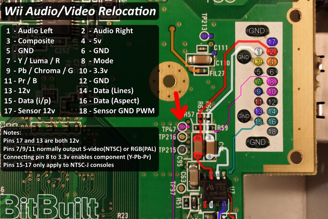

A couple questions - So first of all I see that the silver chips on the wii ( The CPUs?) I don't know what they are called lol but I attached a picture for clarity.Aren't touching the heat sinks. I see there is a small amount of space in between them, is that normal or should the heat sinks be touching those parts firmly?
Also I see that I will need to put the battery in before I screw the wii down. Am I able to do any soldering while a battery is inserted?

You need some form of thermal interface material, yes. If you jump on ebay/amazon and search for "thermal pad" you'll find a heap of options. I think the 2mm thick grey/blue ones should be fine for this. They're compressible so if it seems like the one you got is a little too thick, don't worry about it it'll just squish. They can also just be cut to size with scissors or a razor blade. Here's an example of a listing for the pads: https://www.amazon.com.au/dp/B07X38254H/
When you say "battery" are you talking about the 3v RTC coin cell, or the 21700 li-ion cells? If you mean the li-ion cells, no. Do not solder anything while they are connected to the system. If you must do any soldering work, remove the li-ion cells first, and then turn the power switch to On for a few seconds to clear any residual capacitance. Even when the PMS is "off", when the li-ion cells are connected there is still a tiny amount of idle current flowing through the system that could cause damage. It's the same principle as working on any normal console or swapping PC parts. You must always disconnect all sources of power (minus the RTC coin cell) and bleed the system of residual capacitance by holding the power switch On for a bit. Otherwise you're almost certain to kill something.

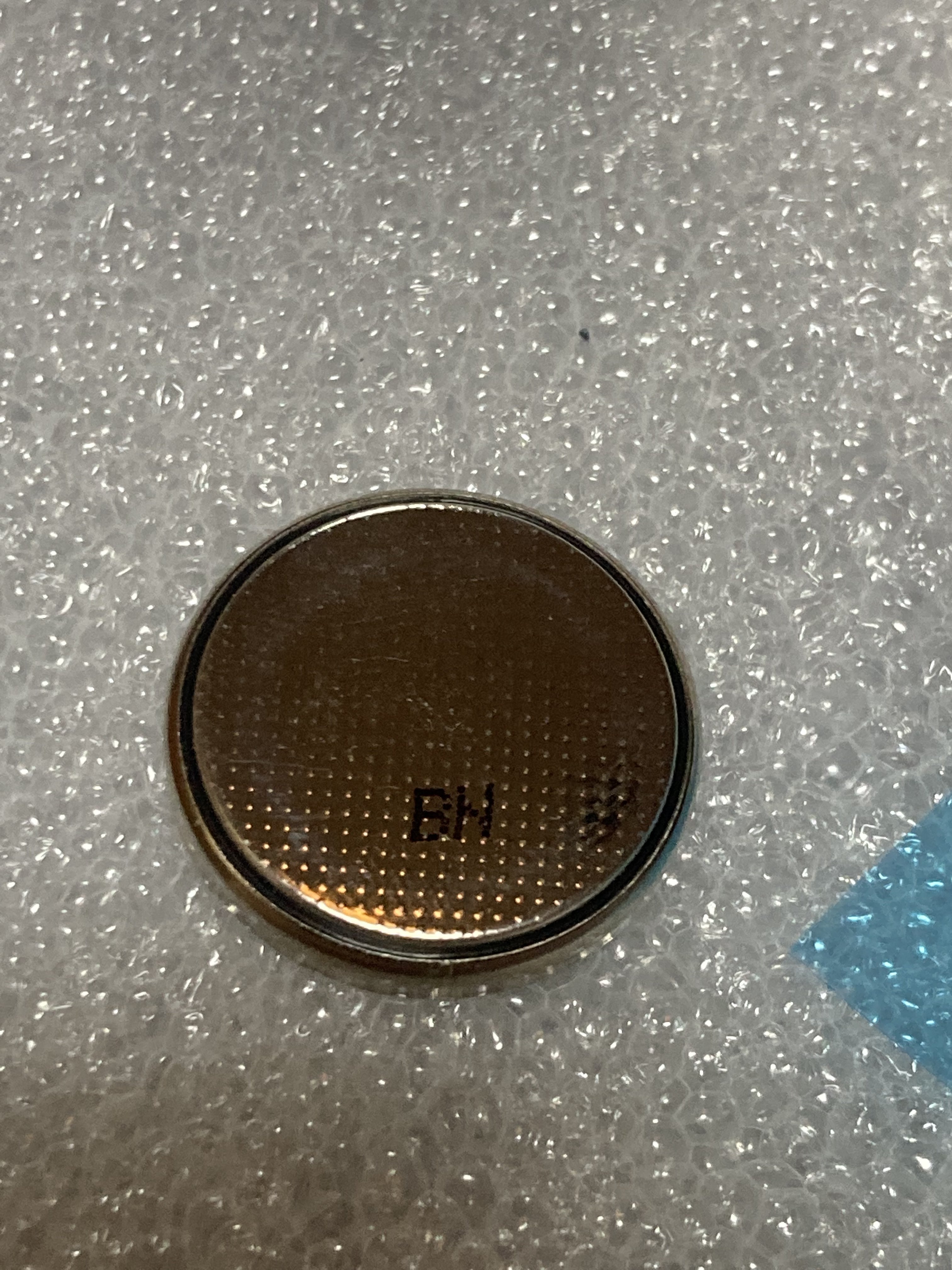

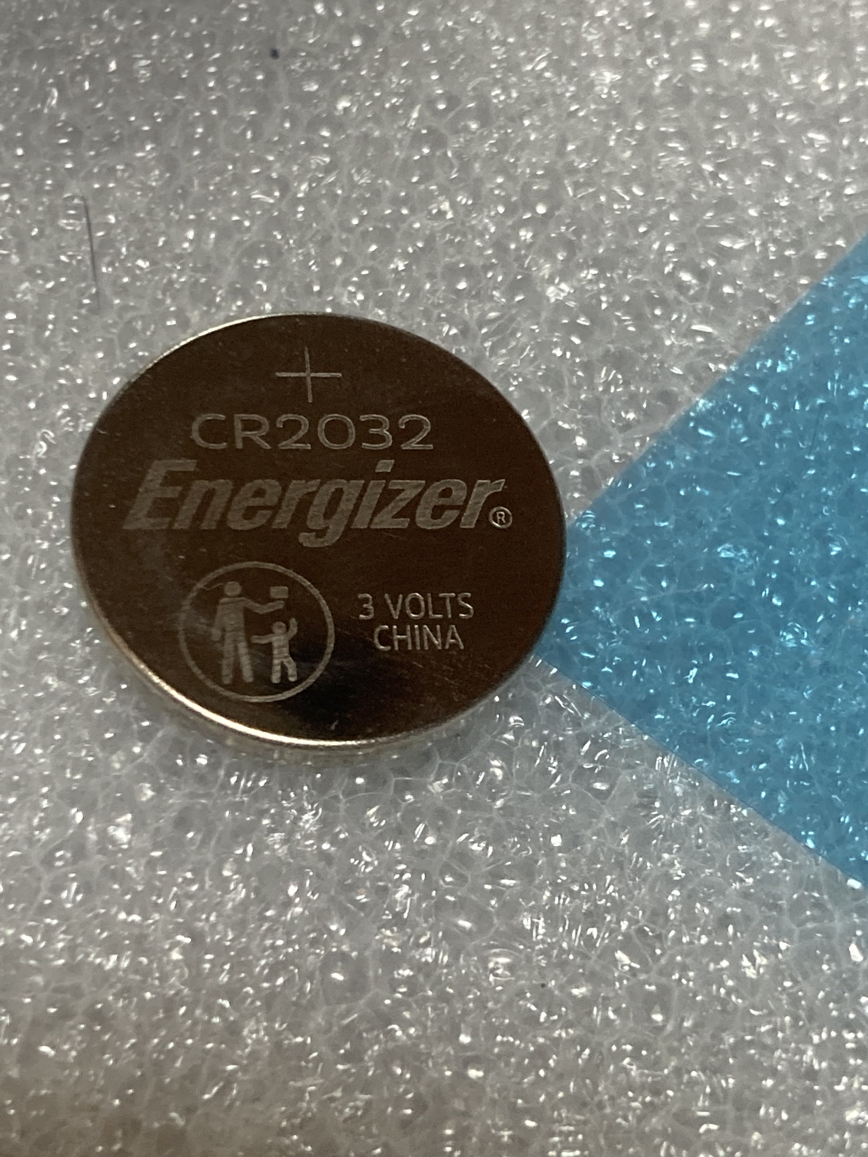

Alright I’m about to turn this bad boy on - I know which wires need to go to the watch battery but I’m not sure where. Where does positive and negative go on this battery?
**edit** is it just top and bottom?At first I wasn’t getting a reading on my multi meter but I was messing around with it and I think it may just be top positive and bottom negative
The face with the big + imprinted on it is the positive terminal, and the smaller isolated face with the textured bumps is the negative terminal
