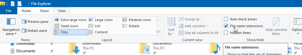

Click the view tab in file explorer and make sure File name extensions is checked. If file extensions are hidden, then you have named the file game.iso.iso
Success! Thank you guys. Now I saw in another post that to get the LED to work there is a rvloader setting I need to change. Where do I access this setting, I dont see it on the settings tab?

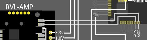

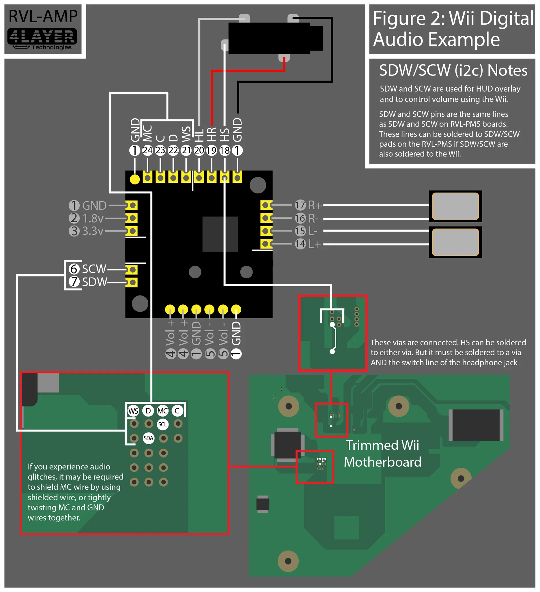

Do you have SCW and SDW wired from the Wii to the PMS?
I have them soldered like this diagram for the pcb set. Although now that I am looking I see the PMS shows a different diagram. So I don't need those wires connected to the rvl-amp at all?
SCW and SDW should be wired from the Wii to the PMS, and then chained from the PMS to the RVL-AMP. It's touched on in the top right of this diagram

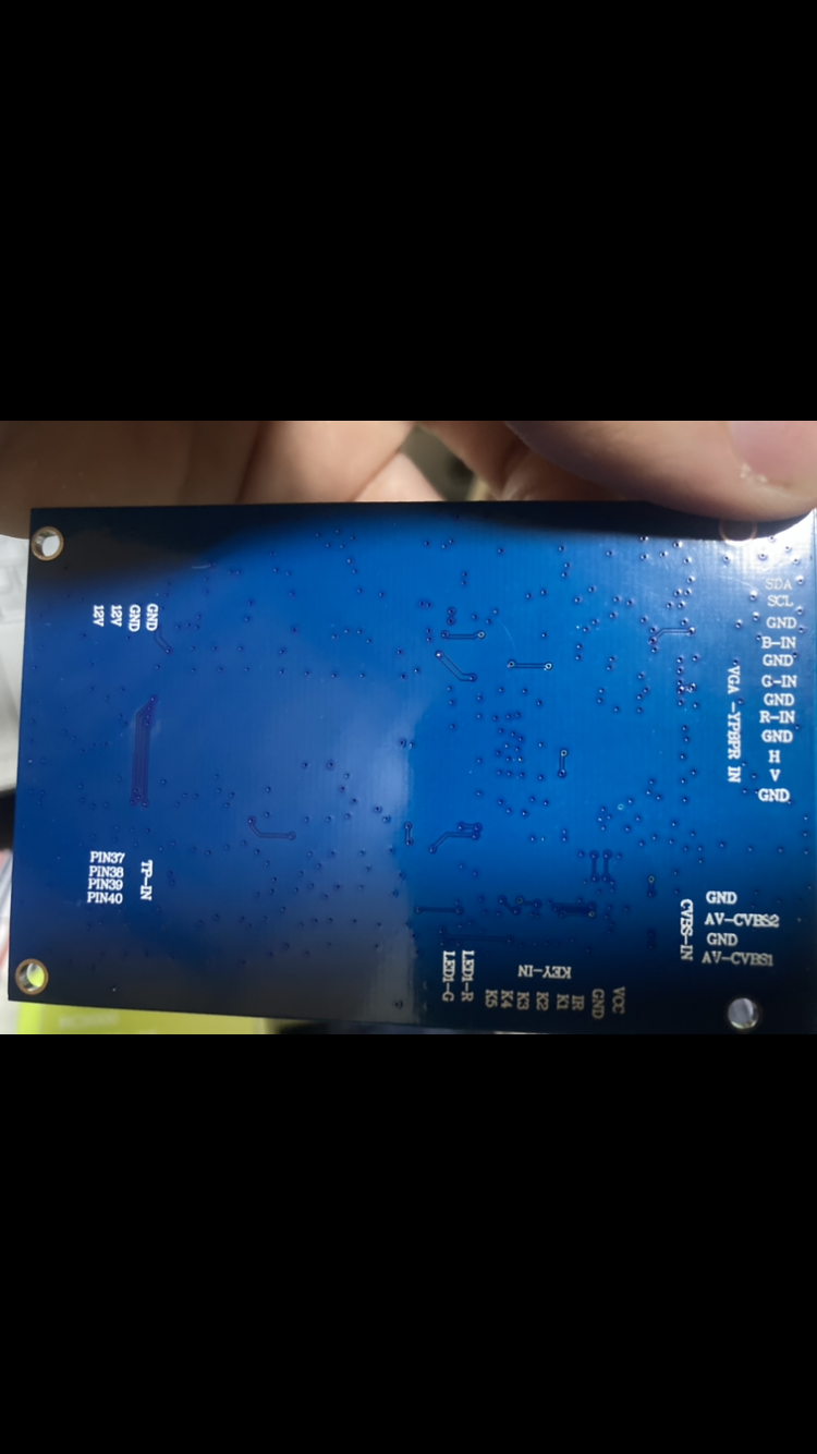

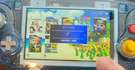

Hey so I am having troubles figuring out screen control. I asked gunnar he told me he thinks its k2 and k3 to control the menu but I tried k1-k5 and none of them open up the menu. Stitches I know you said you werent sure but what do you think? Or maybe does anyone else know which pin that would be?
- attached a photo of someone elses portable that has this screen open
- another photo of the back of my screen driver board
** edit ** I have ground connected and I know I am getting a response from the driver board because I was able to cycle through input channels with one of the pins.
No idea I'm afraid. Those are the OSD control pads, so one of them should be menu

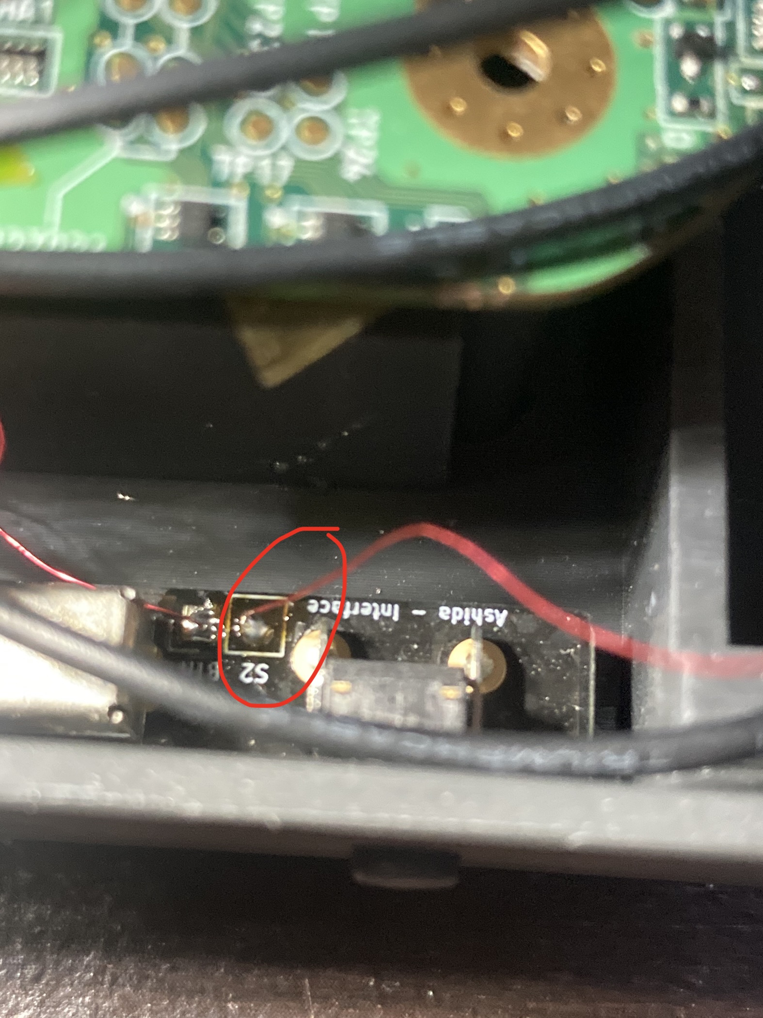

Okay so it’s this button that’s the problem (bluetooth button). This is the button pad right?
( i figured out which pin is for menu )
**edit** I just cleaned up that residue and re did the solder. This button still isn't working :(
You can only sync wiimotes at the Wii home menu. Navigate to that from RVLoader anx try syncing there. Don't be alarmed if you get no picture (assuming you have vga wired), iirc it's trying to spit out 480i over VGA and the screen doesn't accept it.
