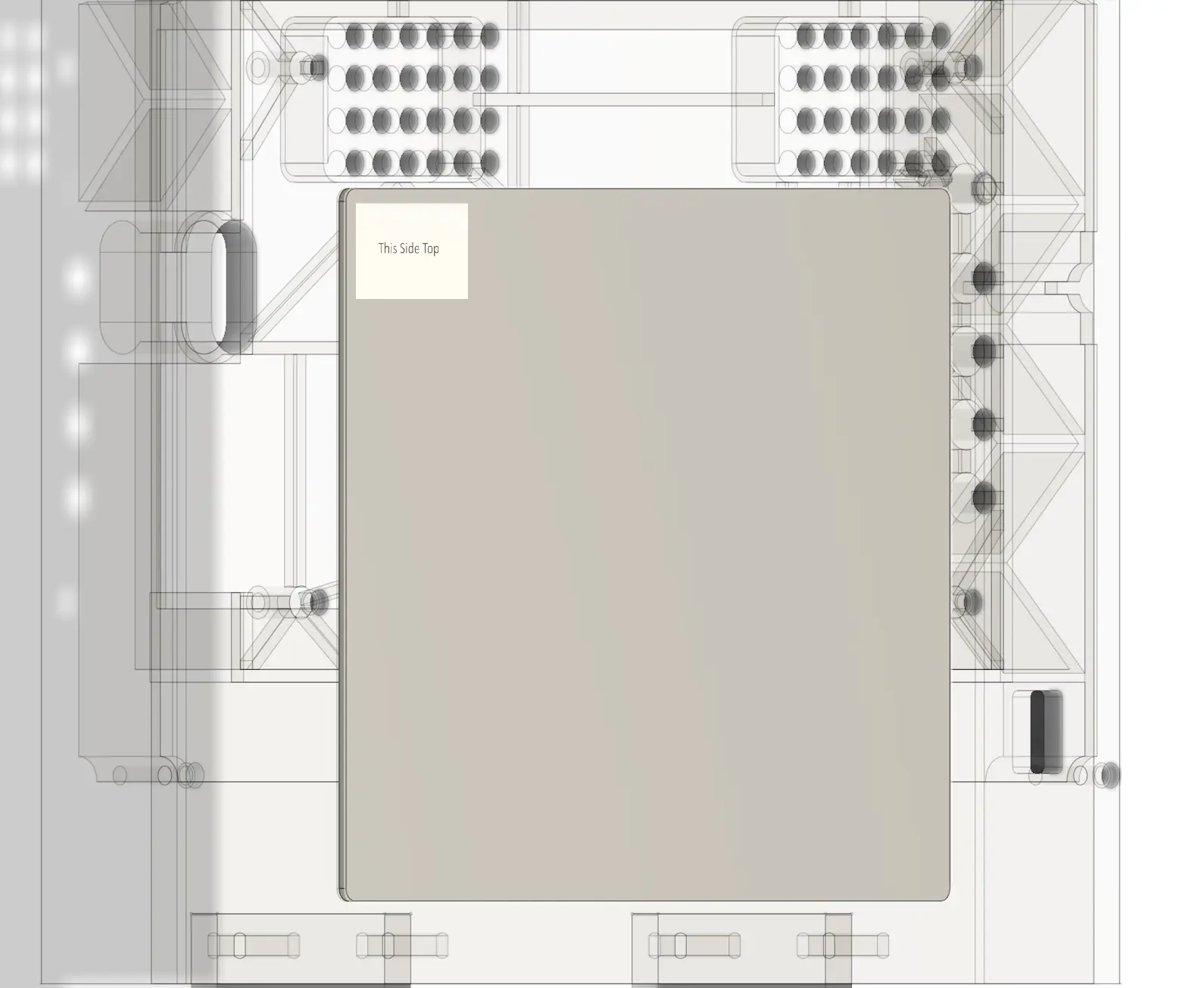

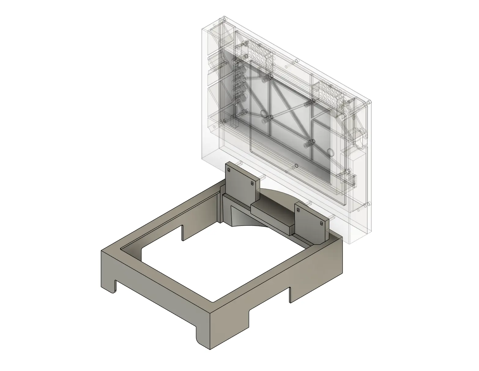

Model Update
Started working on the model for the housing on Friday. Currently it is "Function over Form" and will stay that way until modeling is finished.
Once the functionality of the prototype is finished i will be adding fillets to the edges and logo engravings on the back for customization. Any suggestions on logos would be helpful as I'm only thinking of using the Gamecube Logo, Hylian Crest, and possibly something Kirby or Pokémon related.

Model Update
View attachment 39711View attachment 39712
View attachment 39713View attachment 39714

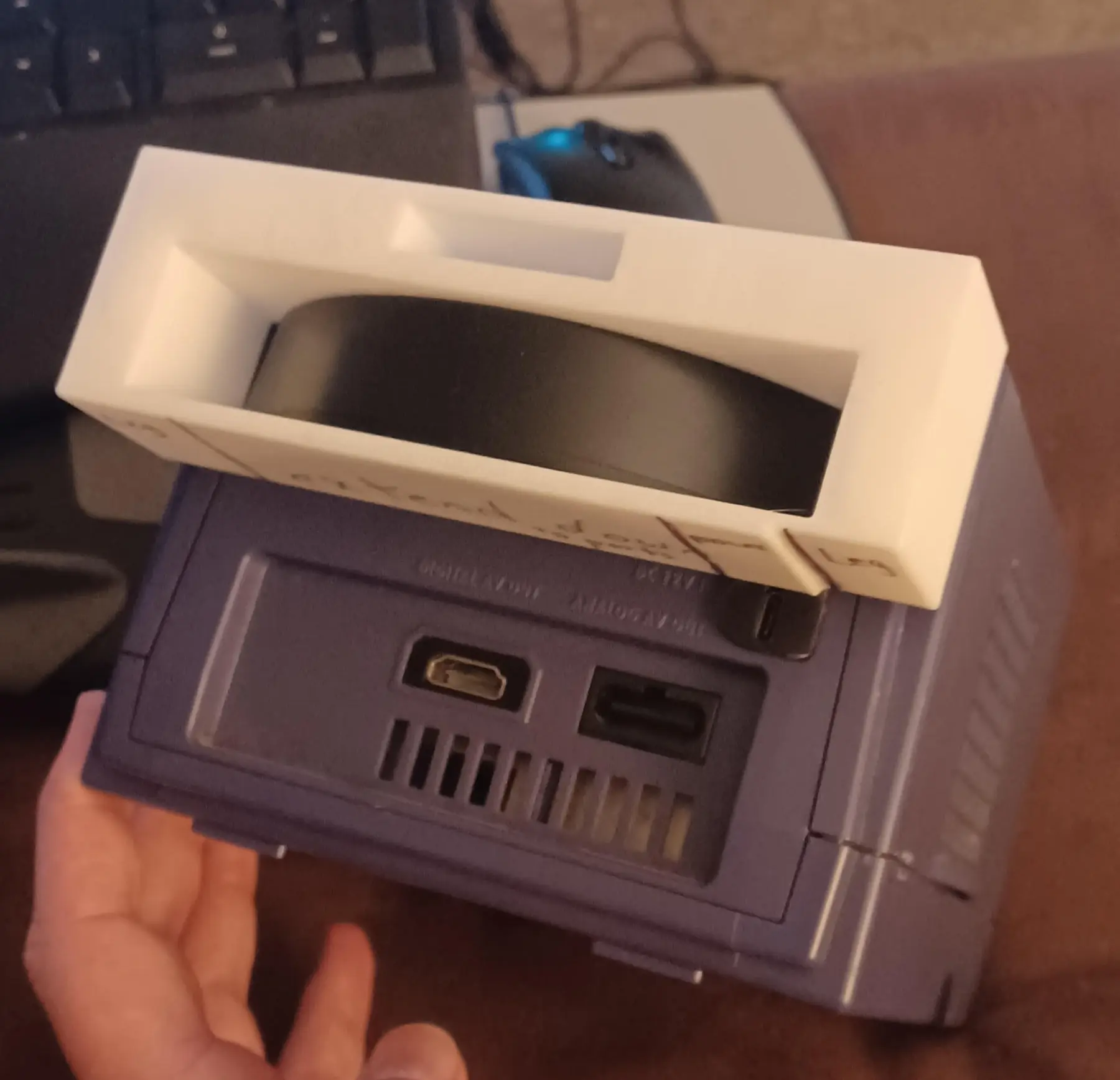

UPDATE
Had little time to work on this project this week due to issues at work and myself being one of two maintenance engineers, but the project MUST be finished!
First I took into consideration what StormEye45 said and made a vanity plate that attaches to the back of the housing with magnets. This will allow for interchangeable logos I myself haven't figured out if I want to make a logo for this project or not yet. I do plan on releasing the native fusion files when this is complete so one can add their own logo using the hobbyist version of fusion or changing it to fit their needs as I would prefer everything I make to be open source for all to use freely.
I than tried a design for how it would stay on the GC which didn't work so it was back to the drawing board for that. Thanks to the 3 day weekend due to labor day i will be spending time printing the initial prototypes outs and test fitting everything to ensure it works functionally first than worry about getting the "form" in a place I like.
I hope to get this completed before mid September for Version 1.0.
New Mount Design V.S. Initial Design
