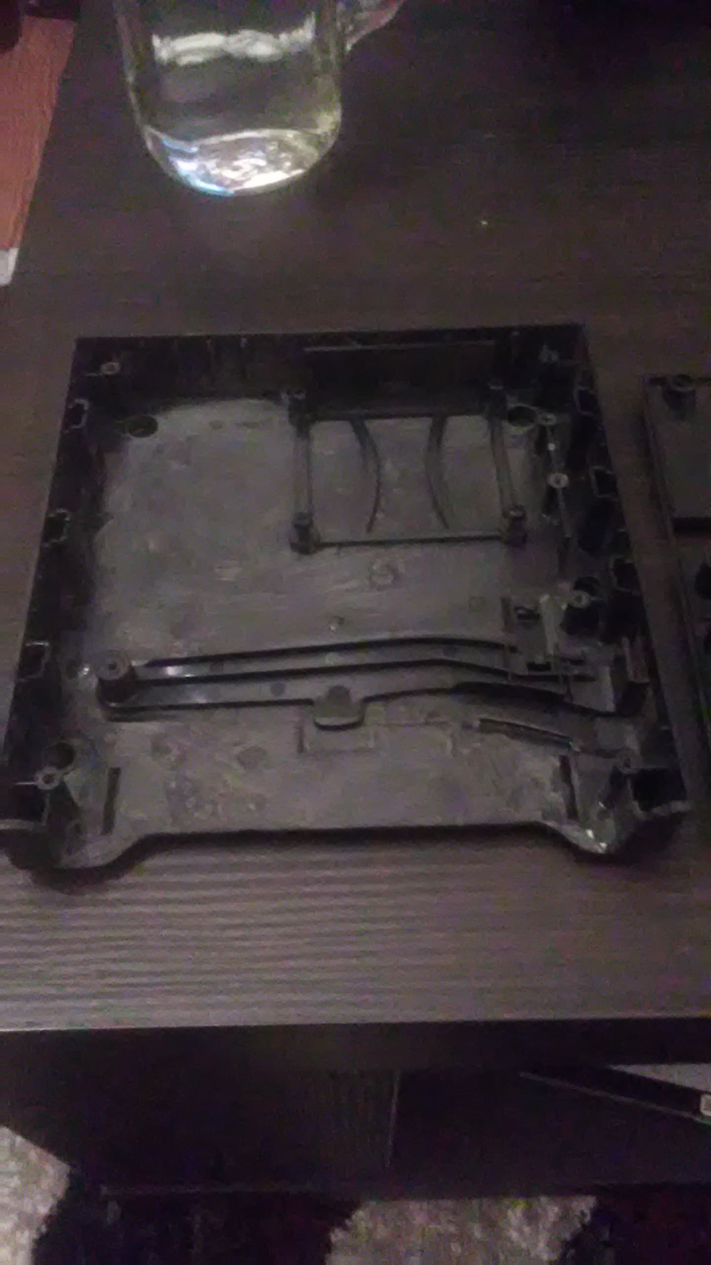

1. I am trying to keep the original dimensions of the height and widths of the Gameboy player as much as I can. The inside structures, front wall / cartridge slot, and screw posts of the GBA player have been removed with a Dremel, only the 4 posts for the gamebit screws remain.

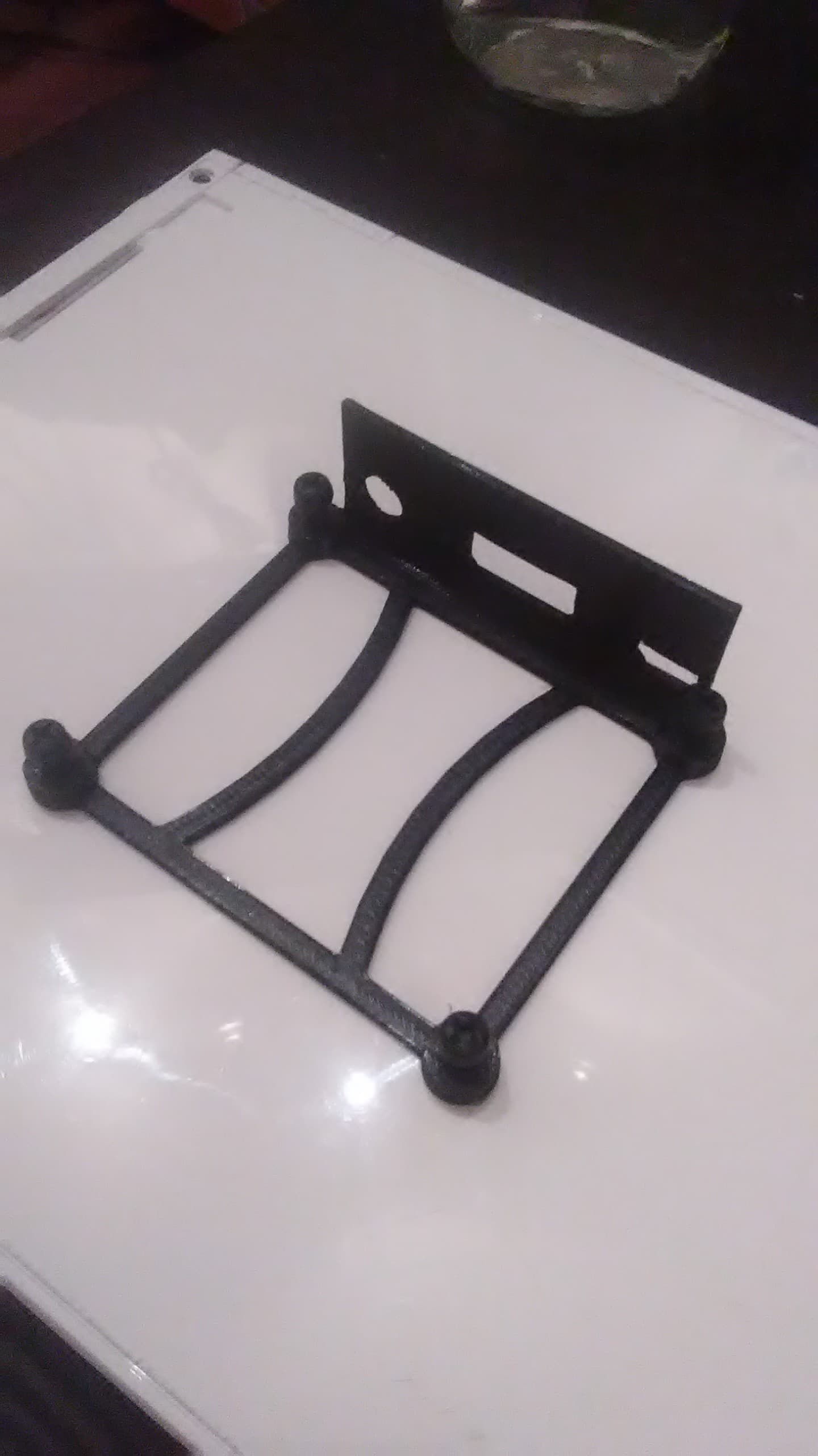

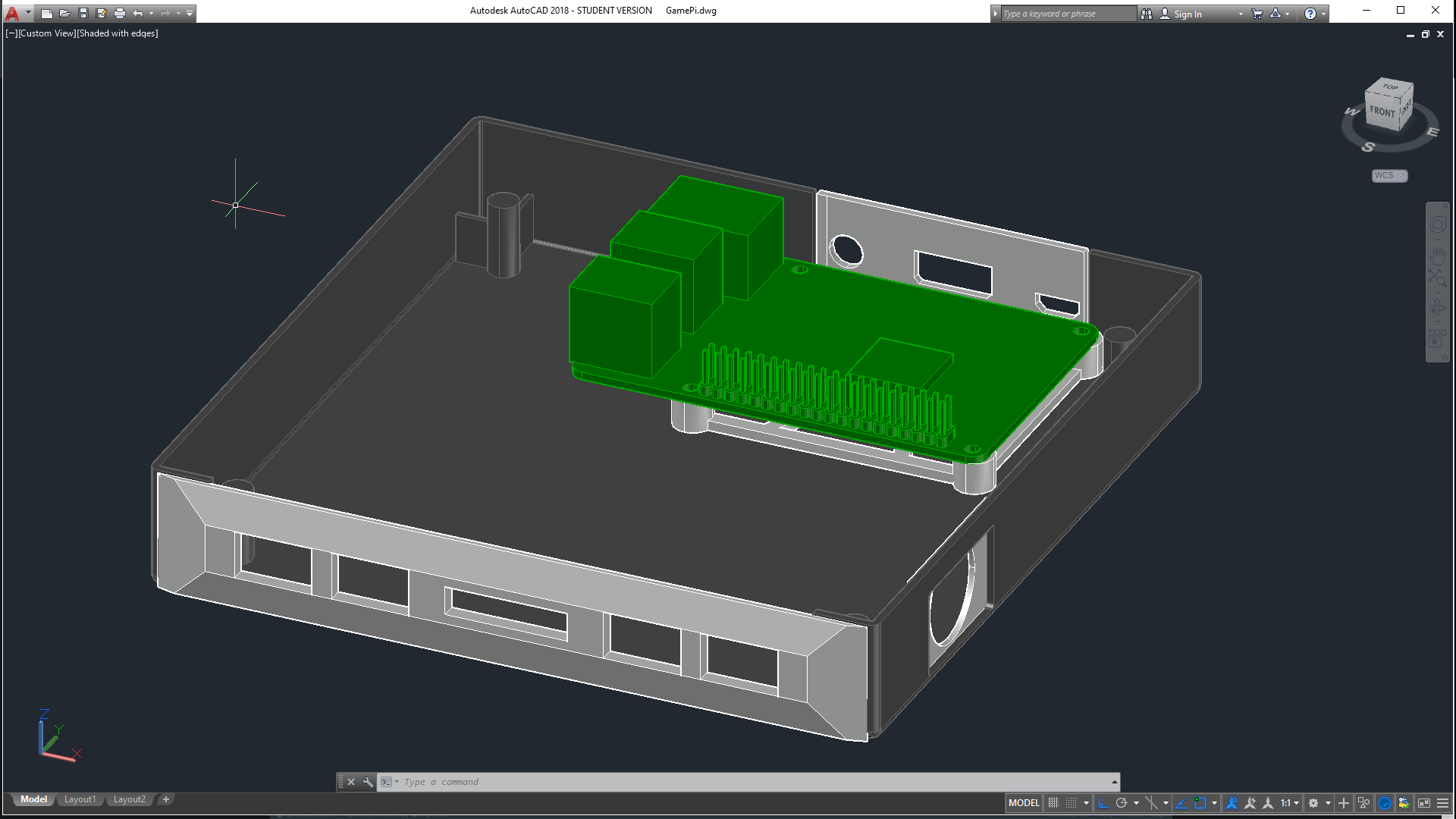

3. I have modeled and printed a custom mount to glue into the clean shell of the attachment, and a front panel will be modeled with slots for USB plugs, extending from where the Pi sits. An SD card slot will also be modeled into the front surface so everything is accessible from the front.
4. The custom printed mount also has it's own wall with holes for the HDMI, audio and micro USB ports. Therefore, a small section of the back wall on the attachment will be cut out later.

Sorry for the low-res images, I plan on getting a better phone next month. I'm also putting a screen capture of my conceptual build. I don't have much to show right now because I'm a huge procrastinator but I do have just about everything figured out. The USB ports look more squared than rectangular but I'll adjust those openings when needed. I ordered four male to female cables which turn out to be just too short for the build... The USB ports on the Pi look a little high but they just fit inside of the case. I figured it made sense to put the switch where the hole for the cartridge ejector lever is, just a small bit of sanding to have my current rocker switch fit, or get a rectangular one for aesthetics. As you can see with all the excess plastic removed there is a lot of space inside this little casing, so fitting other components in there should be really easy.
