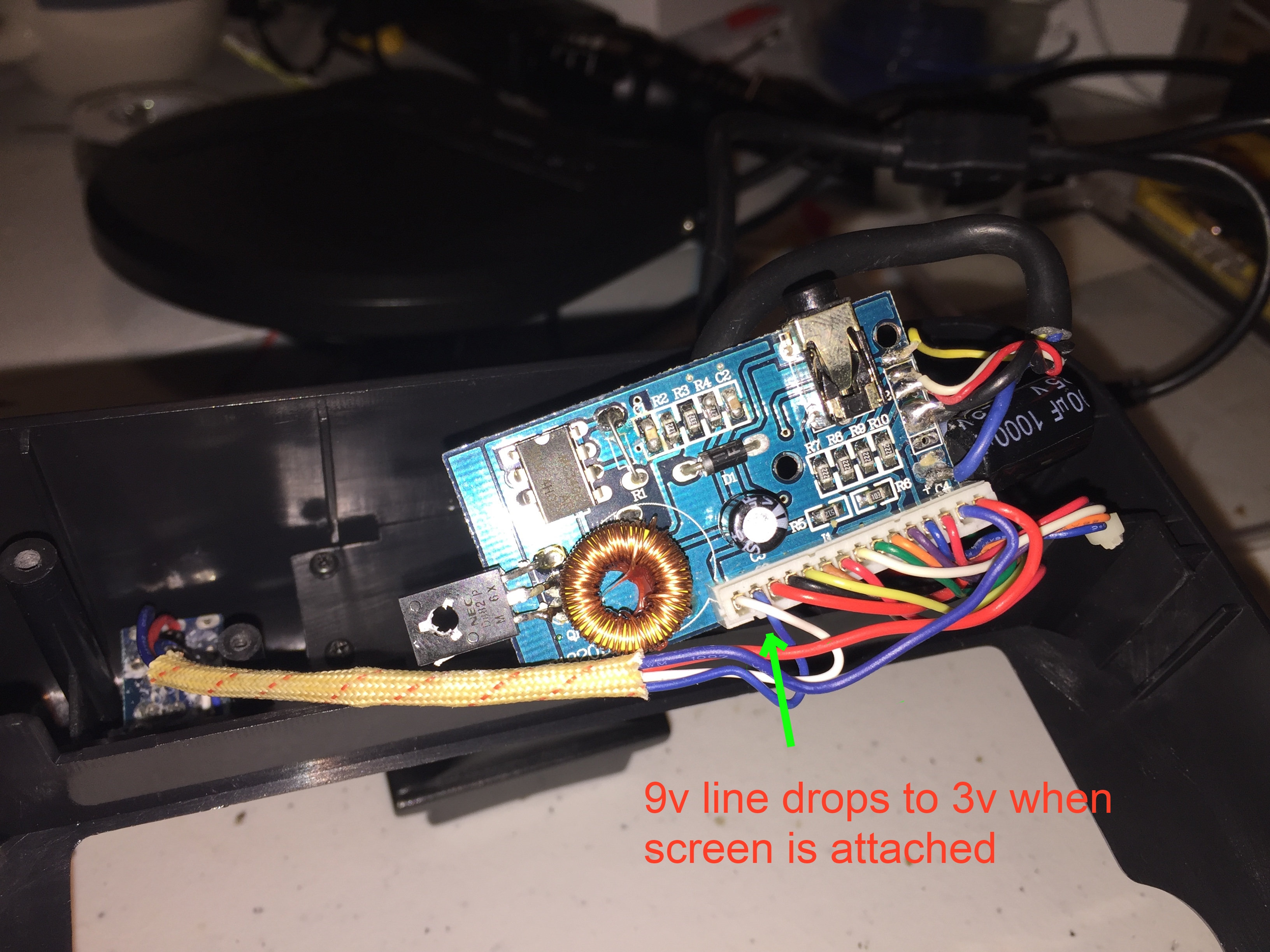

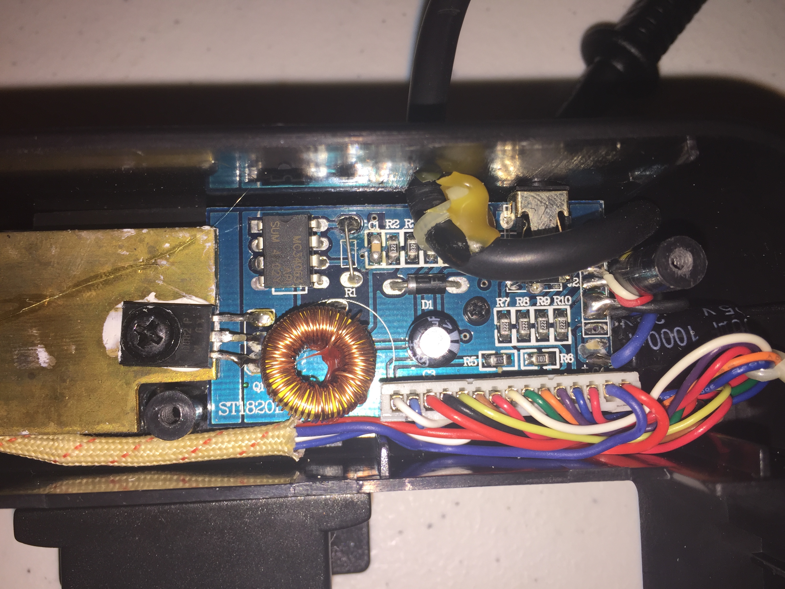

So I've pinpointed one issue. With the screen detached, this blue wire is at 9 volts. When the screen is attached, the voltage drops to 3v. Input voltage is 12v to begin with.
The capacitors look fine and continuity is good. I still think it might be a capacitor issue but I don't know how to test them correctly (especially the middle one).
Otherwise, any ideas on how to get the voltage to run correctly? should I re-route it? (The screen works fine on a different board)
Any ideas on just soldering on a replacement regulator?
