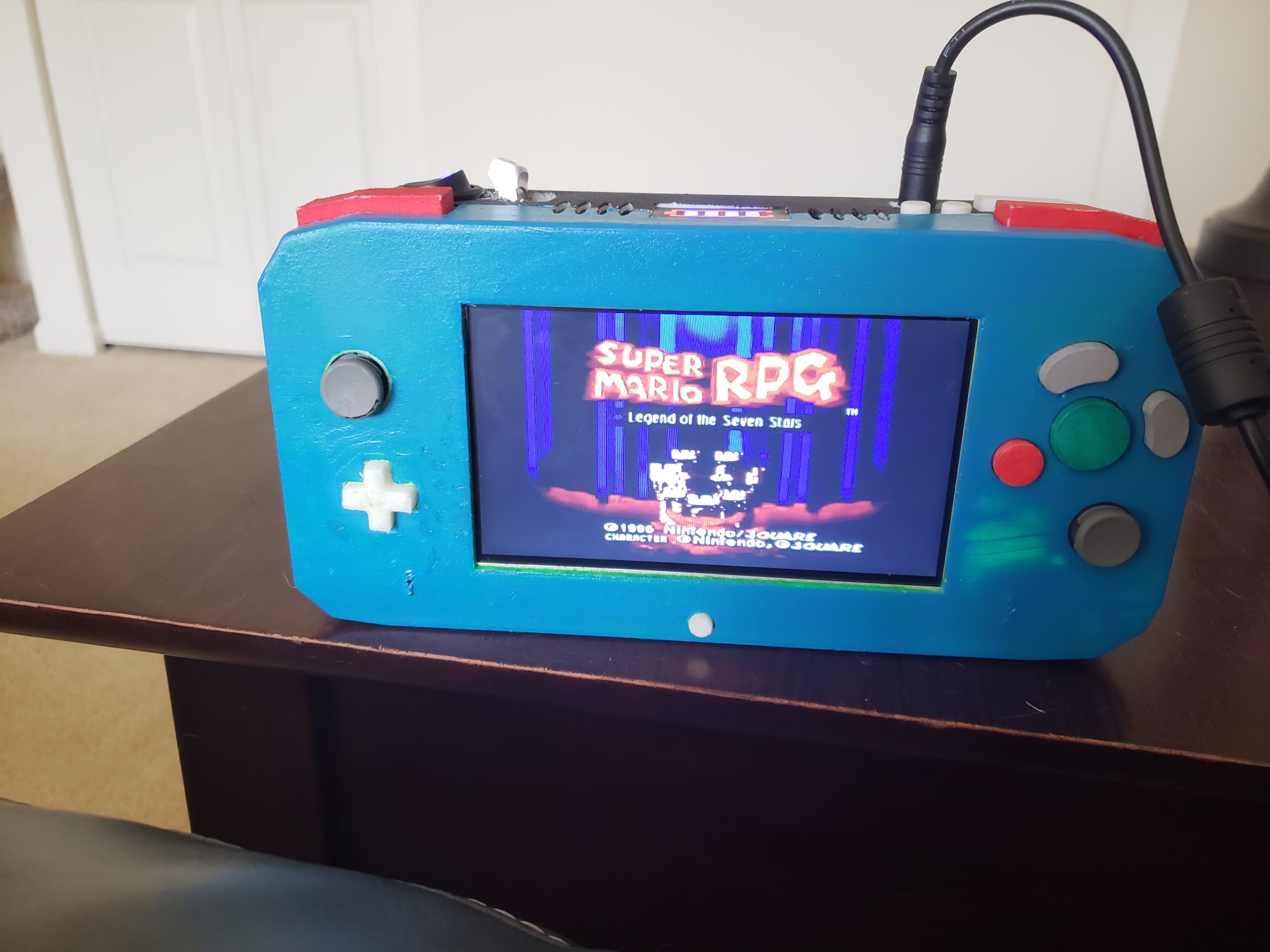

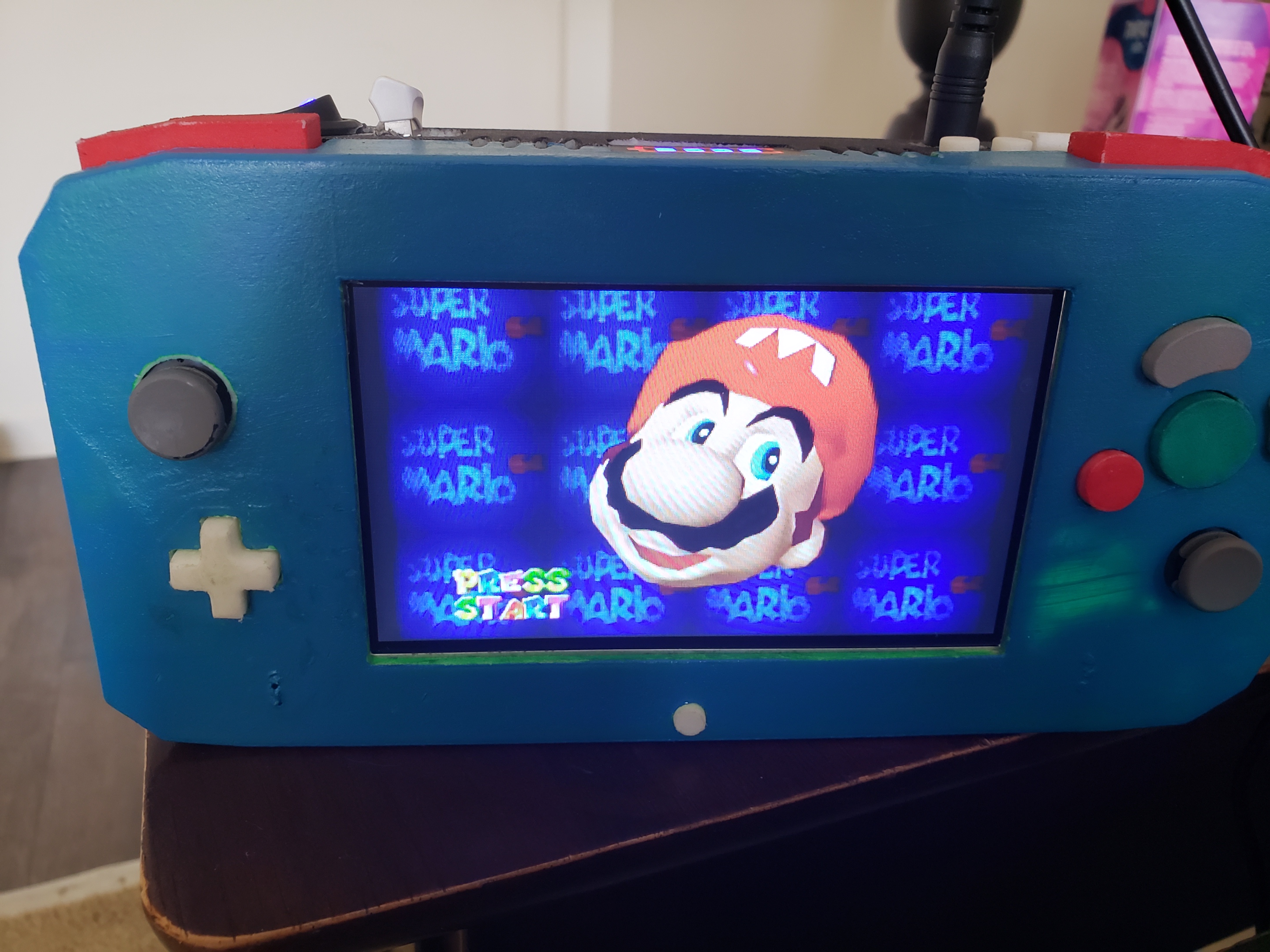

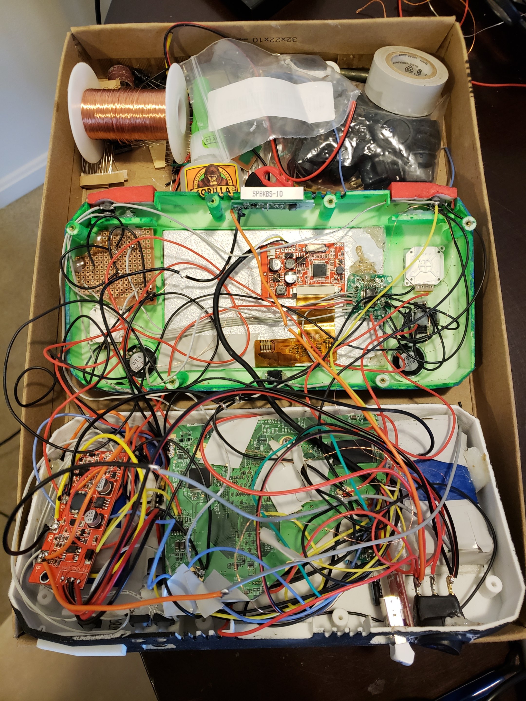

So I finished my portable finally. To an extent it still has some work and I am having one issue still. Everything seems to be working well but the main stick still veers to the left at boot about 90% of the time. I've tried xya at boot and it seems to slow it down when it calibrates the dead zones but it still does it. I noticed when I move the slider around it will stop sometimes and work normally no problems. And playing the game is alright as long as I'm moving the stick, does anyone know of a setting I can use to fix this??? I tried going into the gc+ config. settings to fix it but the text is really small and I cant navigate it it wont work. Is there an update I'm missing?? Thanks everybody
Oh and the internals look bad

Are you 100% sure that the slider is wired up correctly and that all the wires have good contact? And are you using stranded or solid core on the power/ ground wires? If you are using solid, maybe try swapping them out for stranded as a break in the wire could be the reason it doesn't work reliably. If that still doesn't fix it then there is a GC+ homebrre that'll fix the ranges if it is a software issue, but I'd do everything Hing you can to be sure that it isn't a hardware one, which is what it is most of the time.
So far I checked the continuity between the main stick cx,cx,sx,sy with the corresponding pin on the pic. All had good contact. I used stranded copper wire power and ground checked out with my multimeter. I dont know why my gc+ calibration isnt working but all other settings and menu navigations work fine.
Magnet wire for the x and y on the sliders and stranded for the v, and g

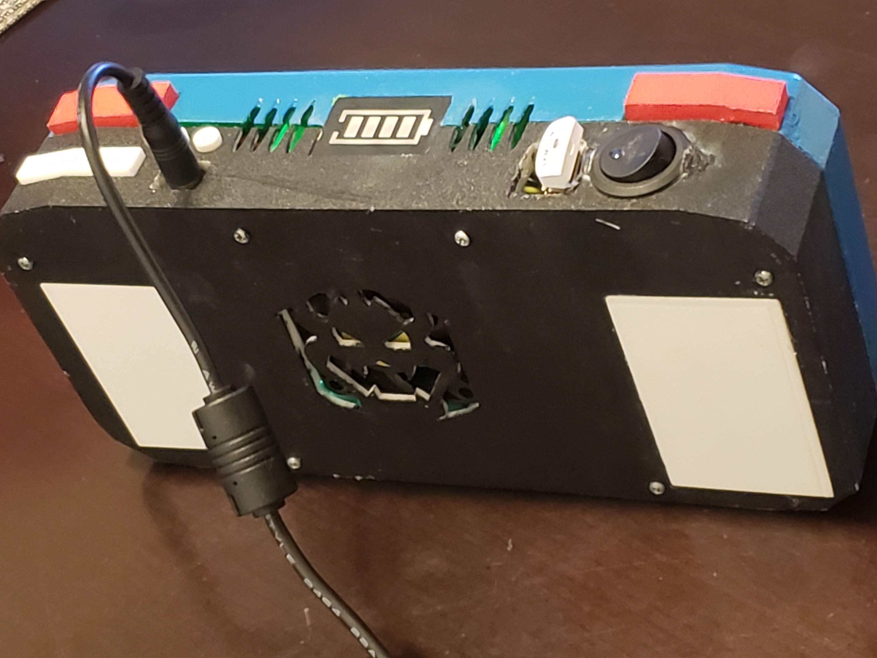

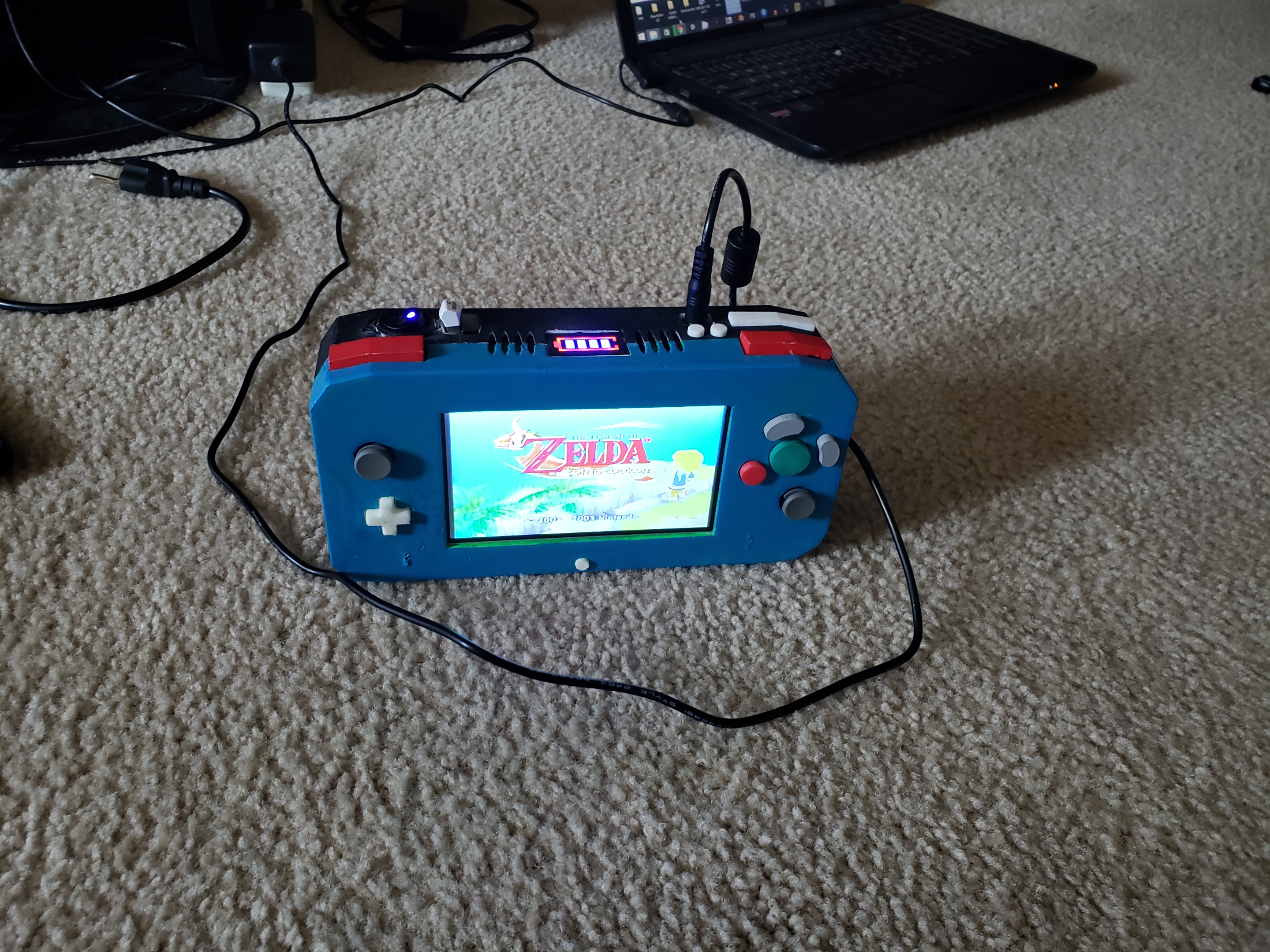

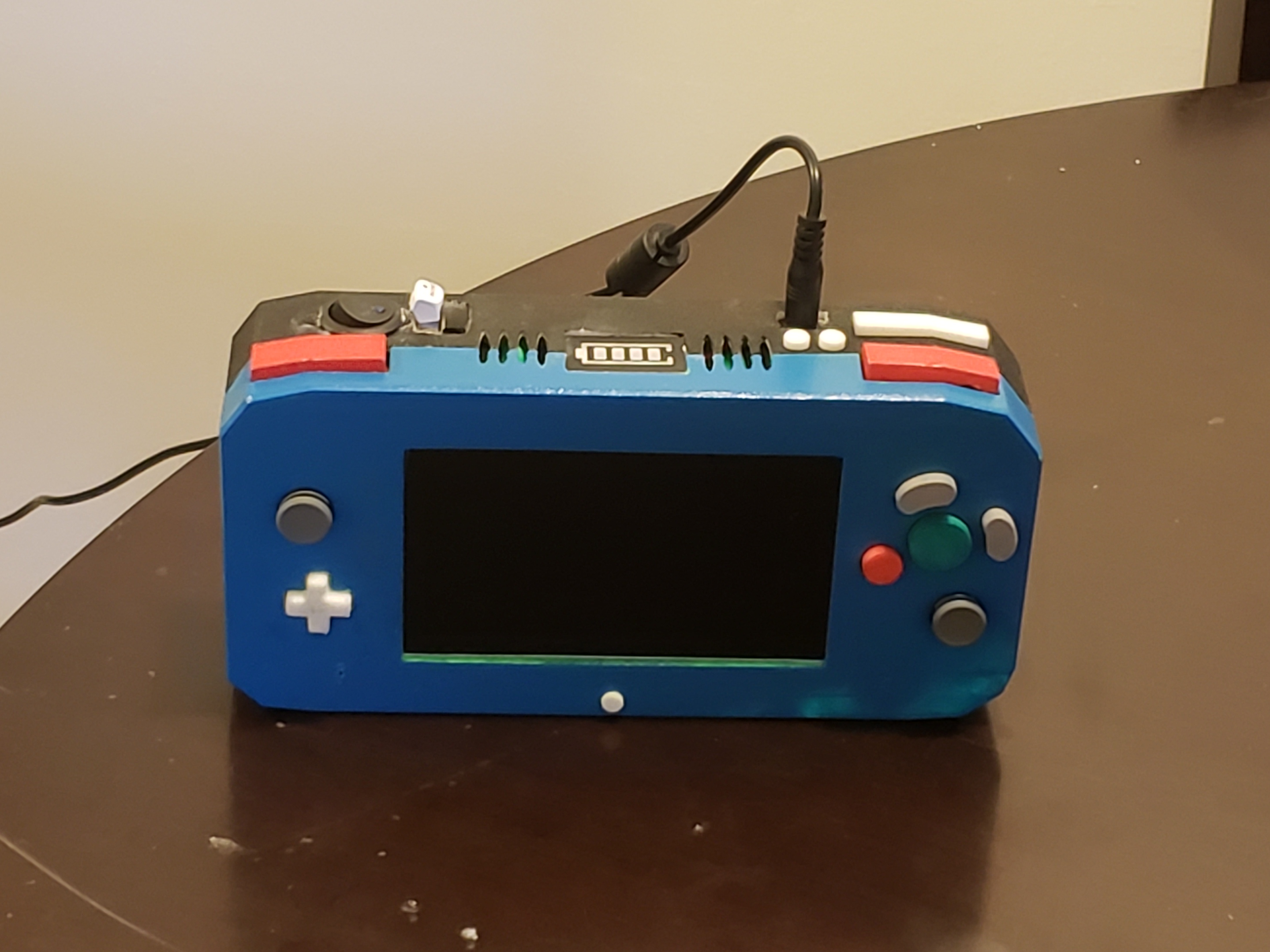

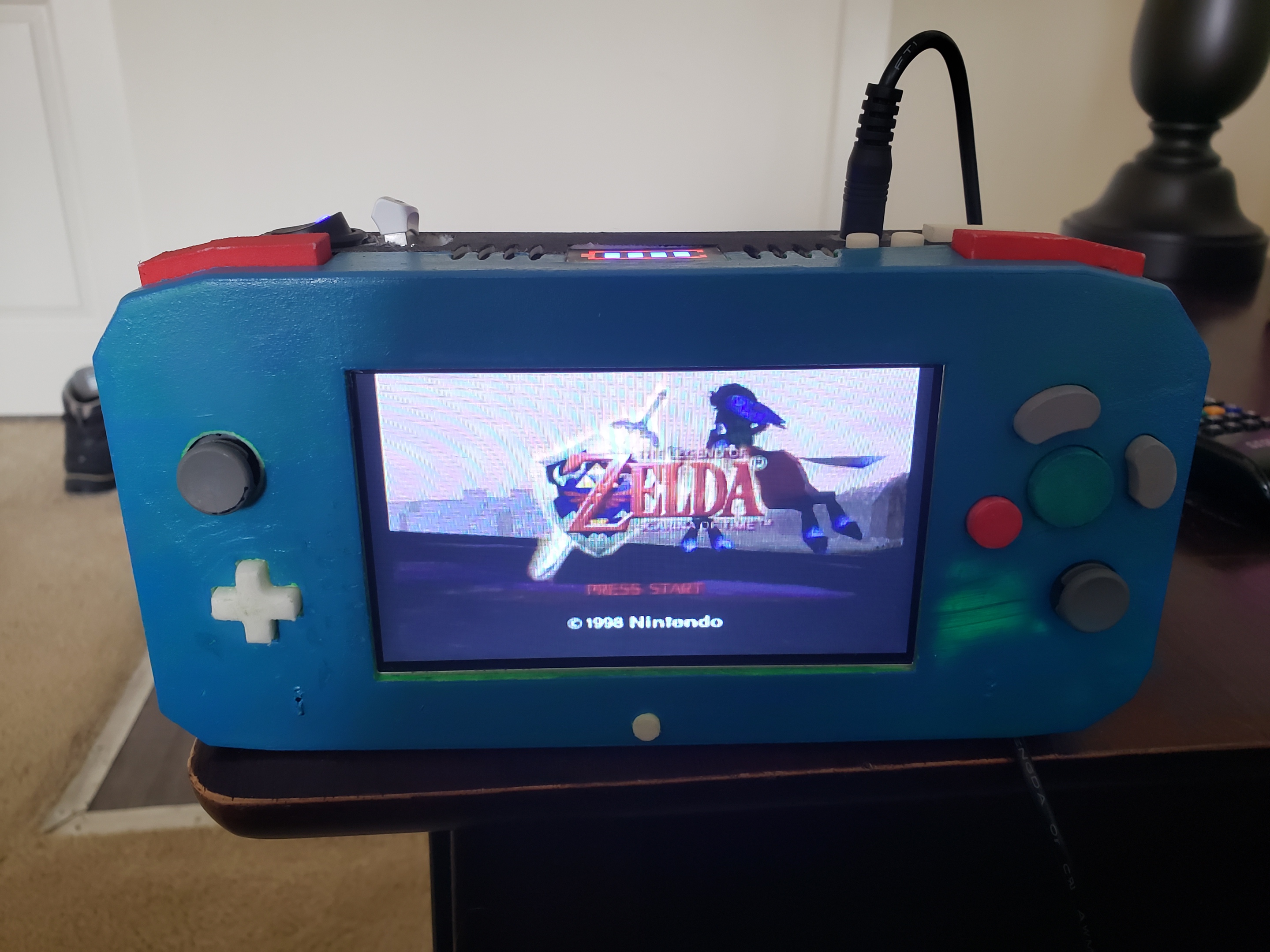

So I'm 99 percent completed. Thanks to everyone on here for all of your help @Aurelio @Gman @DeoNaught @Shank especially. But everyone else that has helped as well. I still need to fix the right shoulder buttons analog it's hard to press, my button design wasn't that well done, and I going to replace my red board as I'm pretty sure it's not charging right. But other than that everything works pretty good.
I do have a question, I can't get save states to work for snes? It says save to I think sram or something like that it creates a save but when loaded it just reboots the game? N64 works fine, and sega didnt have em anyway so that's cool too.
Did you relocate the MX chip and RTC battery?
No I didnt. I did the most basic portable basically seeing as it was my first one. No wifi or bt, no mx. Just emulators and gc really. I really like the look of the G-Wii and want to build that next. 100% more efficient and less bulky than mine. Overall I'm content with it but I really want something slimmer, with better button design, and no more sliders..ever. I'm just going to stick to the OEM sticks instead, also why I wanna build the G-Wii
So you're just using the SNES emulator? Have you configured it, or are you running on stock settings?
Yeah I'm just using the emulator I just figured it out I had to change the setting to autosave to snapshot and it works fine now
