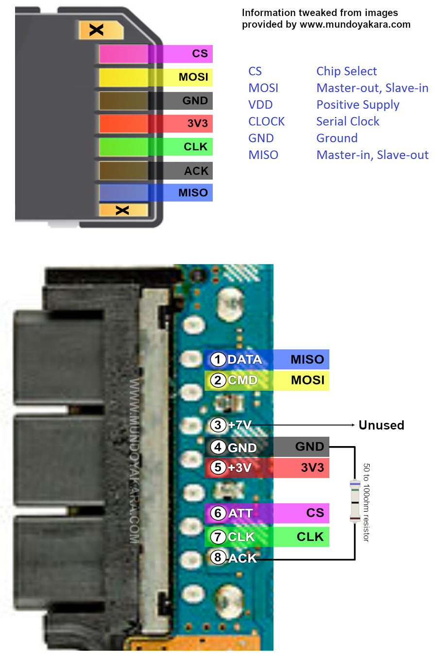

I never said i was owed anything so why dont you quit putting words in my mouth. I simply asked a question and vented some of my frustrations. I asked for a guide since im not a programmer and can find it hard to understand some of the jargon whiling digging through hundreds of posts. Also i just followed a link from the Ultra Slim thread since this is the GUIDE to wiring and setup for the sd card which is where im stuck since it seems the most ideal place to ask the questions, and when i said you have nacho promoting the mod i didnt mean you personally. If ya didn't wanna help you can just ignore my post.
Anyway thanks stitches. I have that checked off already. I rechecked my wiring and it matches the photo. My games seem to be formatted correctly since they play just fine when i use the usb port. So im thinking has to be the sd card or adapter. Is there some sort of size restriction on the sd cards? Im trying to use a 64gb samsung Evo Select, i have it as a exfat with 16kb clusters.
Can you provide photos of the wiring so we can double check? You could have a transient short somewhere that isn't immediately obvious
yeah np, here is what i have wired in. I dont have a a switch between the grounds since the shell i printed off was the one before the switch port was added.

Well the first thing I see (aside from the length of the wires) is that you've shorted ACK to GND, and I don't see the 50-100ohm resistor. Is there a reason for that?
I followed nachos video and I'm pretty sure he mentions the resistor wasn't needed, but maybe thats if you are using the switch?. As for the bridge I thought that was in the guide as well
I don't know anything about a switch (and I didn't watch Nacho's video), but I can't say I've ever seen anyone ground the SD detect pin like that. If you have a suitable resistor available I'd replace that short with it and see if anything changes
I when I get time again I'll try shortening the wires and seeing if I have a 50 resistor to put there. I did check the video again and he does indeed say it's not required

With the recent advancements in SD loading for the PS2 it's now viable for portables to use this feature for booting games. I've been testing on my stock 79k model and found game compatibility to be fairly solid with over 80% of games I've tested running without issue.

A resistor anywhere between 50ohm and 100ohm (doesn't seem to be that fussy, helps with SD card detection)
Note: The MX4SIO card has to be in Slot-2/the second MC-slot!

SD card wiring:
As the software side of things continues to develop this guide will be subject to change. If you see any inaccuracies with this information let me know so I can update the information.
