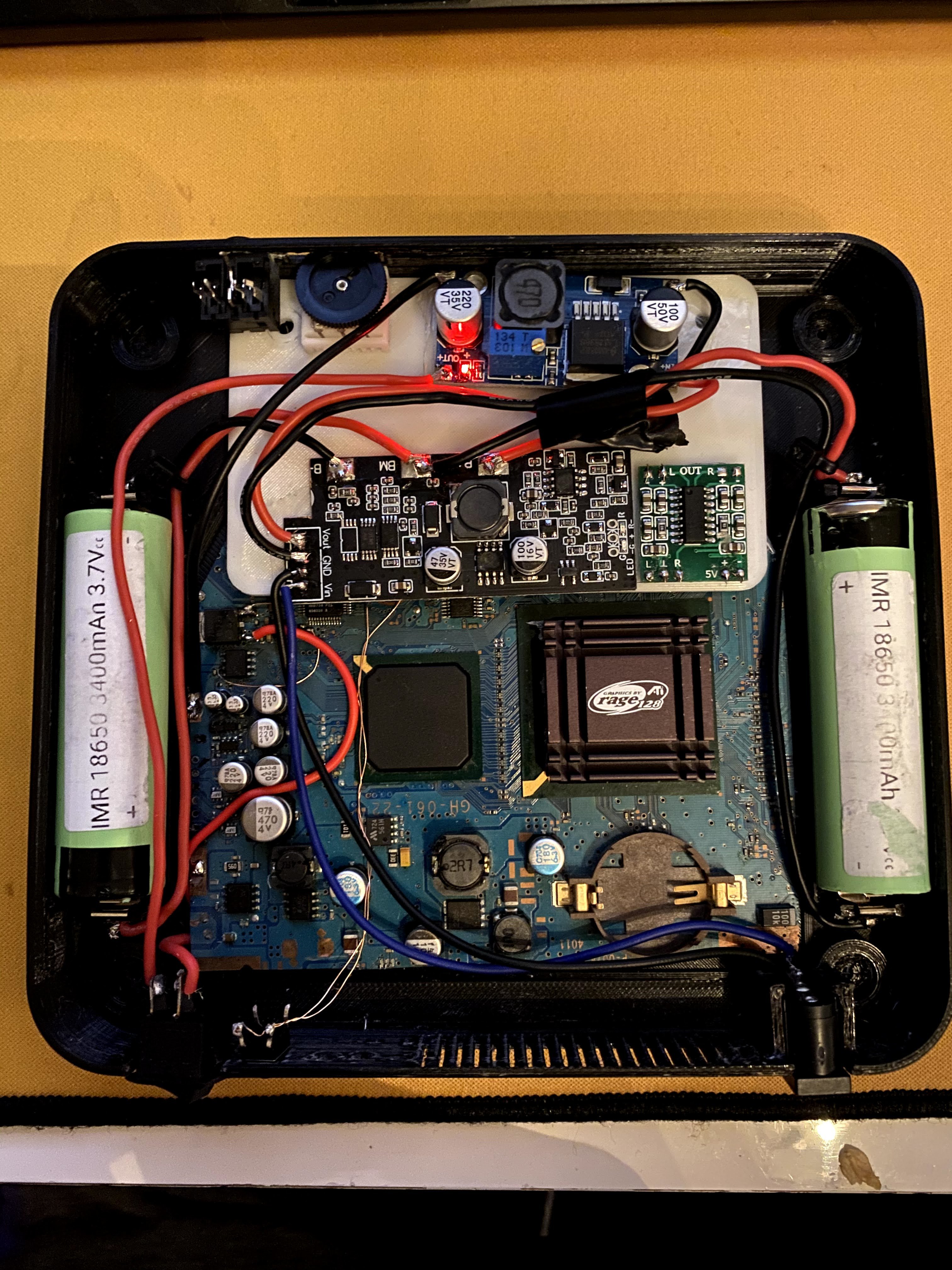

I have these two, Bigbucther (pictures attached). The Blackboard one is the same as one of these red PCB's. The other is a DC-DC variable step down voltage. I was wondering if it will let enough current pass trough in order to feed the PS2 board.
Do you have, or could you draw by hand a simple schemactic depcting how you are using It on your project? Could you post It here?

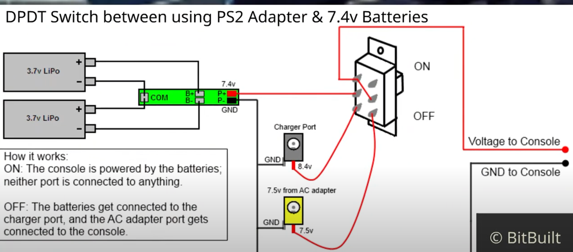

Imma countermand this advice and say do not do this. Using those cheapshit stepdowns is a bad idea, they have a history of catching fire at high load. It'd also neck the fuck out of your battery life. A better option would be to buy a 9V 3A power supply, and replace the default male barrel jack connector on it with a different connector. Perhaps a 2 pole high current JST connector like drone batteries use. Then you can put a matching female connector in your portable and it would prevent accidentally connecting a 12V DC supply to the system; and also not bring in the hugely uneccessary point of failure of a chinesium regulator.

Yes that's exactly what I have, not sure how reliable the circuit is as Stitches has just explained that those step down converters are a bit iffy. I did not realise this and may change my circuitry at another time.
Here is a diagram i would suggest you follow instead.
If you end up using the step down converter (maybe there are safer ones available?), you would need to wire it up and use a flat head on that blue box to dial the stepped down voltage to be around 8.5v (You check this with a multimeter on the output of course). The converter is rated at a maximum input of 15v so I would use a 9-12v power supply to charge it. Preferably 9v for safety.
Here you can hopefully see how it's wired. The V out is connected through the converter then to the power switch, ground goes straight to the console obviously.
Either that or you don't use a step down converter and you just be very careful not to flip the power switch when it is charging.
Final note, I think those cmbs have a protection feature if the batteries are disconnected at all so the cmb will not output anything more than 1V after you reconnect them. I have found plugging in dc and disconnecting will fix this and allow the full battery voltage to pass through again.
Hope this helps!
