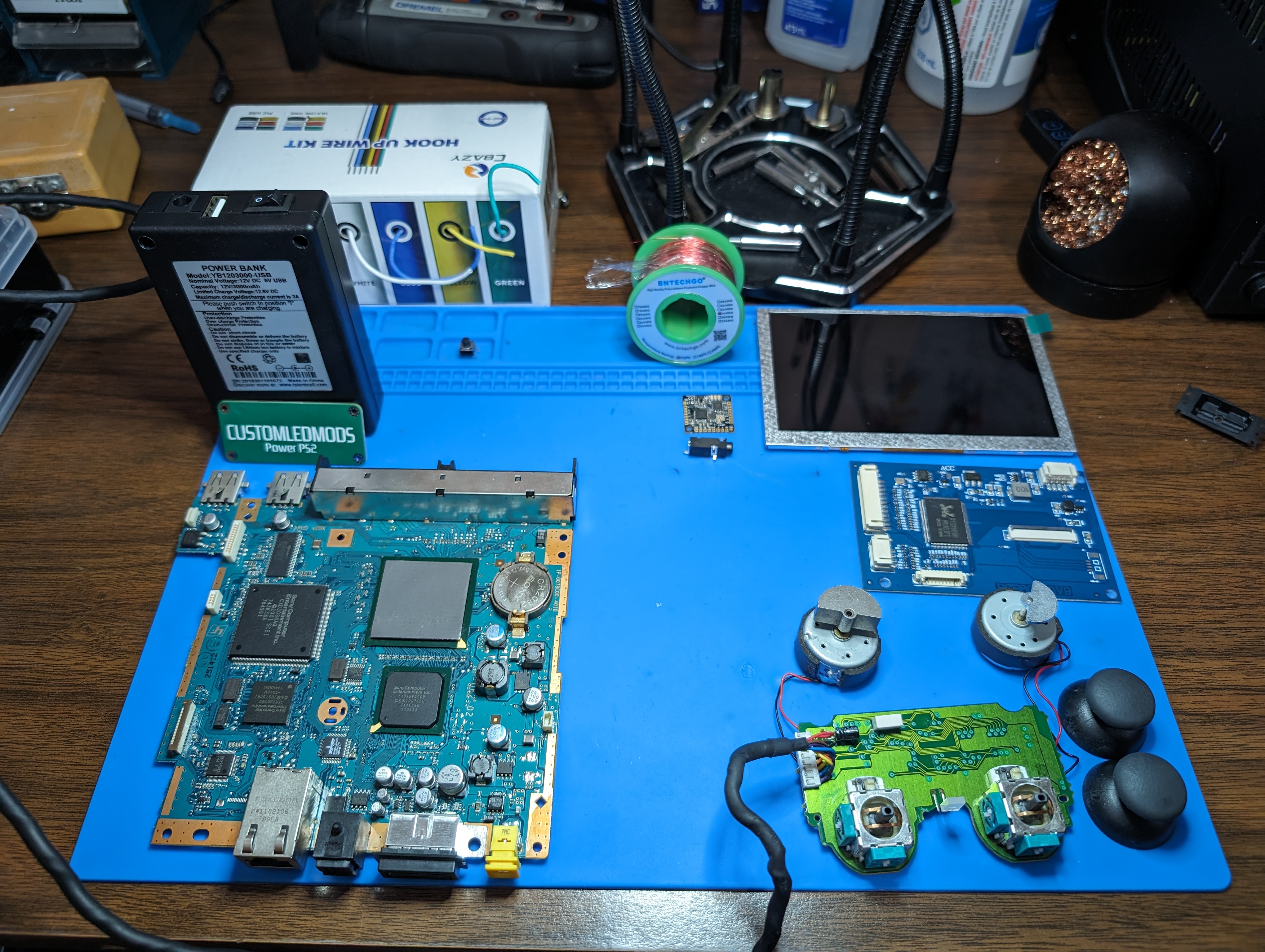

I'm finally making a worklog for my ps2 portable project. I will not start on the physical part of the project for at least a few weeks because of a hand injury, but for now I can figure out what I am doing with the project. My main goal with this project is to learn, but also to make a portable ps2 that isn't too big, uses an original controller, and doesn't use USB loading. I also have plans to make a dock with audio video out, network (for network game loading), and a built in ps2 multitap (I don't know yet if I will actually make dock).
Here is a list of parts I have (If I am missing anything please tell me):
- PS2 (Model SCPH-79001)
- PS2 Controller
- FreeMCBoot mem card
- 5" screen from 4layertech.com
- U-AMP 2 from 4layertech.com
- CUSTOMLED Power PS2 by @Mister M
- Some Random 12v 3000mAh Power Bank with 5v, 3M max discharge currant. (12v and 5v in one is good because the CUSTOMLED Power PS2 by uses 5v, I think, and the screen uses 12v without modification)
- wire: 34AWG Enameled, and some 20AWG stranded silicone wires
(helpfully didn't forget something)
