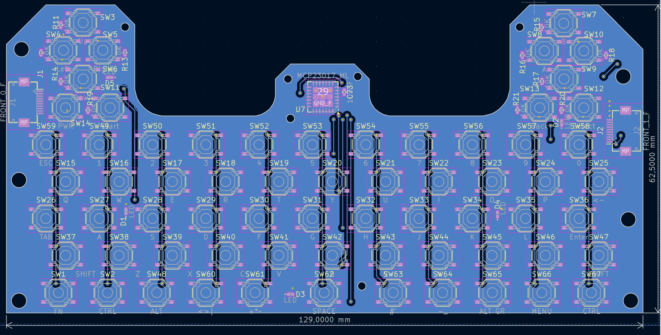

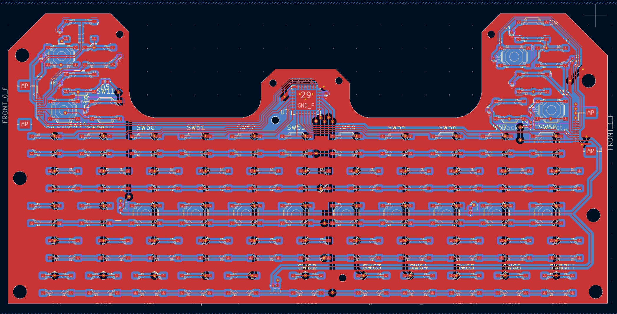

I attach the schematic because I don't know if I wired the Pi correct and for your feedback, if there is something I can improve.
Here is an update:
So far the keyboard is finished. For the connection are two 10 pin flat flex cable with a pitch of 0.5mm.
On the pictures attached you can see how the layout will be (the power button will be somewhere else, but the button is still named PWR).
One of the Pictures is the top layer, the other the bottom layer.
