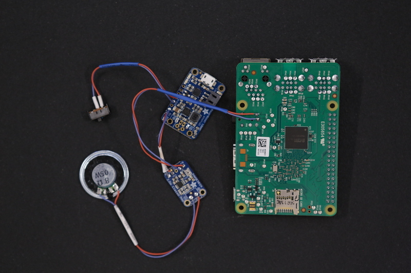

here is an example of how you could solder the Left and Right source cable on your pi 4
