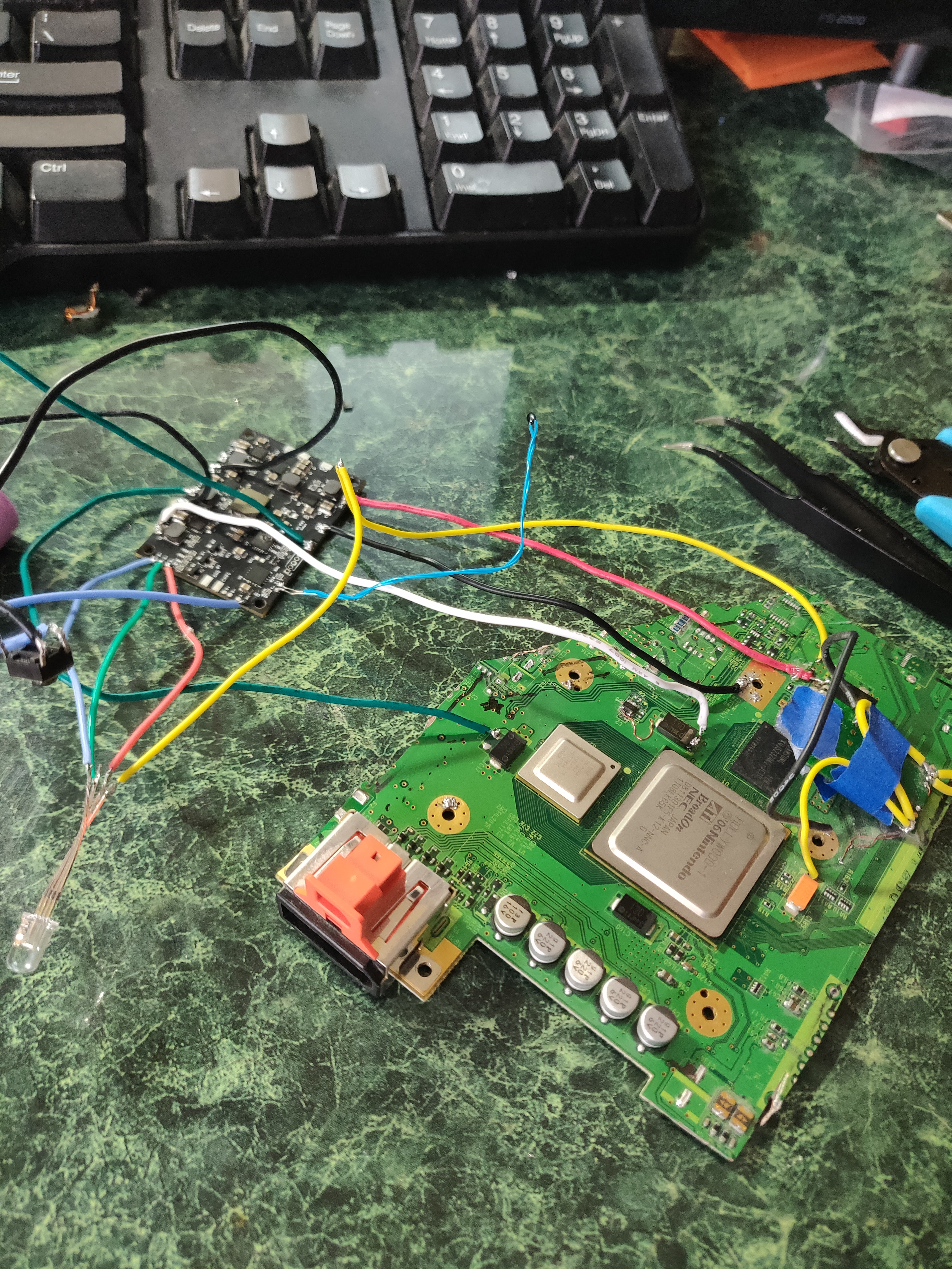

Back from the dead. Sorry, I was busy... training... and real life kicked my ass. I built myself a little PiGRRL 2 to practice soldering and learned some more stuff about soldering. Then I got into 3d printing to save myself some money so I can have unlimited case tries. Like I REALLY got into 3d printing. Printed out the Gwii and the Louii cases, just for comparison sake. I feel better about soldering and got myself two wiis so I can have extra tries in case something goes horribly wrong. Decided on a whim to ditch the MX chip to save myself some headaches and came back with many more questions. Since it's quarantine around my area, I figured that I have all the time in the world to do this.
1) I see battery holders on some of y'all builds. Would any soldered scrap metal be good enough to transfer the power from the batteries or is it something special I have to get online? I could probably 3D print a holder to keep it together, I was just wondering how it would work out.
2) Jefflongo brings up the point about daisy chaining 3.3v wires for the Bluetooth. Are there any other things that could be connected like that or is it just the Bluetooth?
3) I understand the buttons for the GC+ must connect one data cable to the pad and another to the GND. Would they all share the same GND or can it just be any GND on the Wii motherboard?
3.5) Also, after all the buttons are basically on the GC+ where would it go? The trimming guide points to a tiny little area with 4 data points but I would like to know for sure how I would need to hook up the GC+. I got the 1.0 and I have no idea how it would get connected.
Sorry if I sound annoying, but my mistakes are starting to get a little expensive...

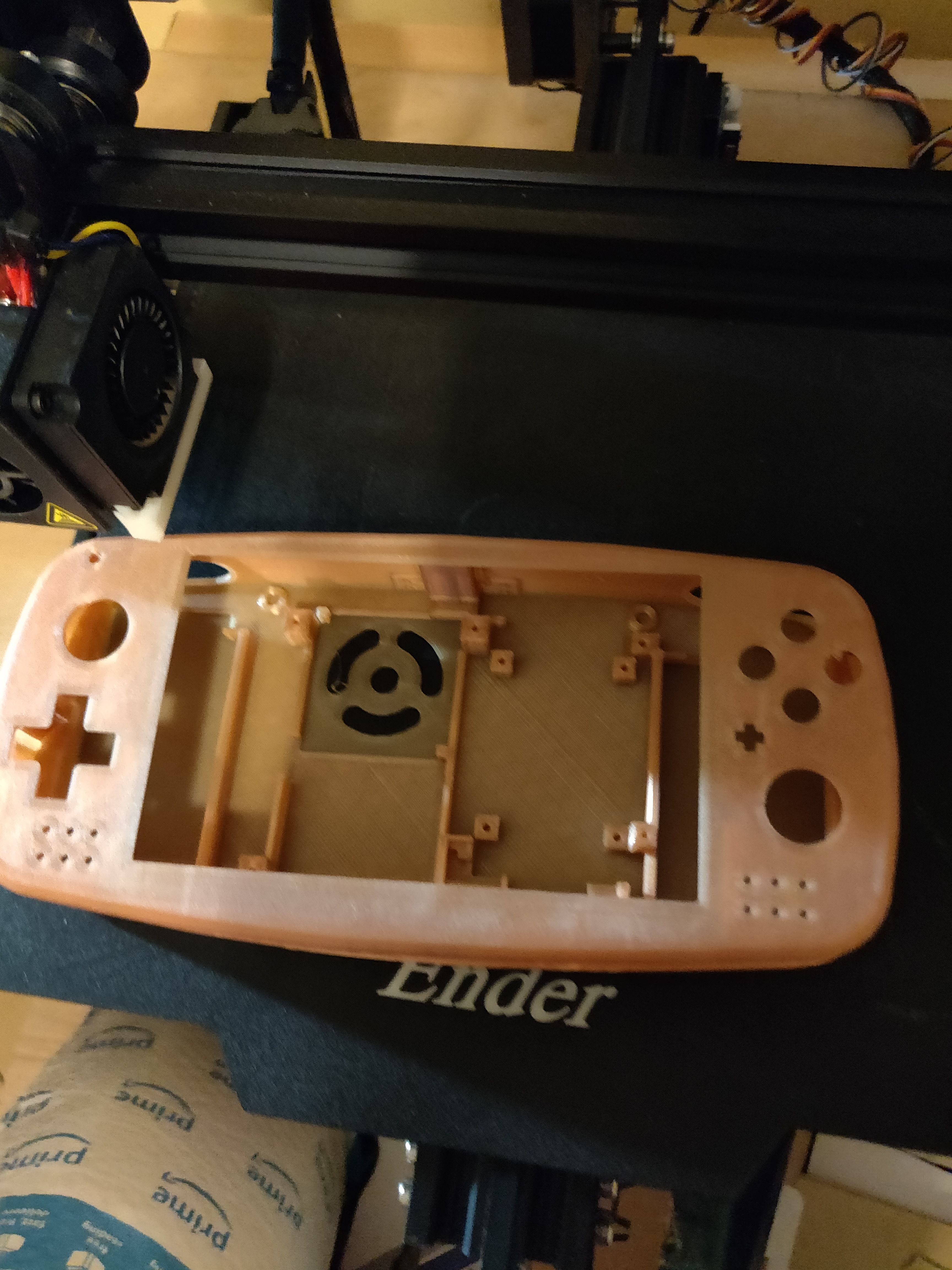

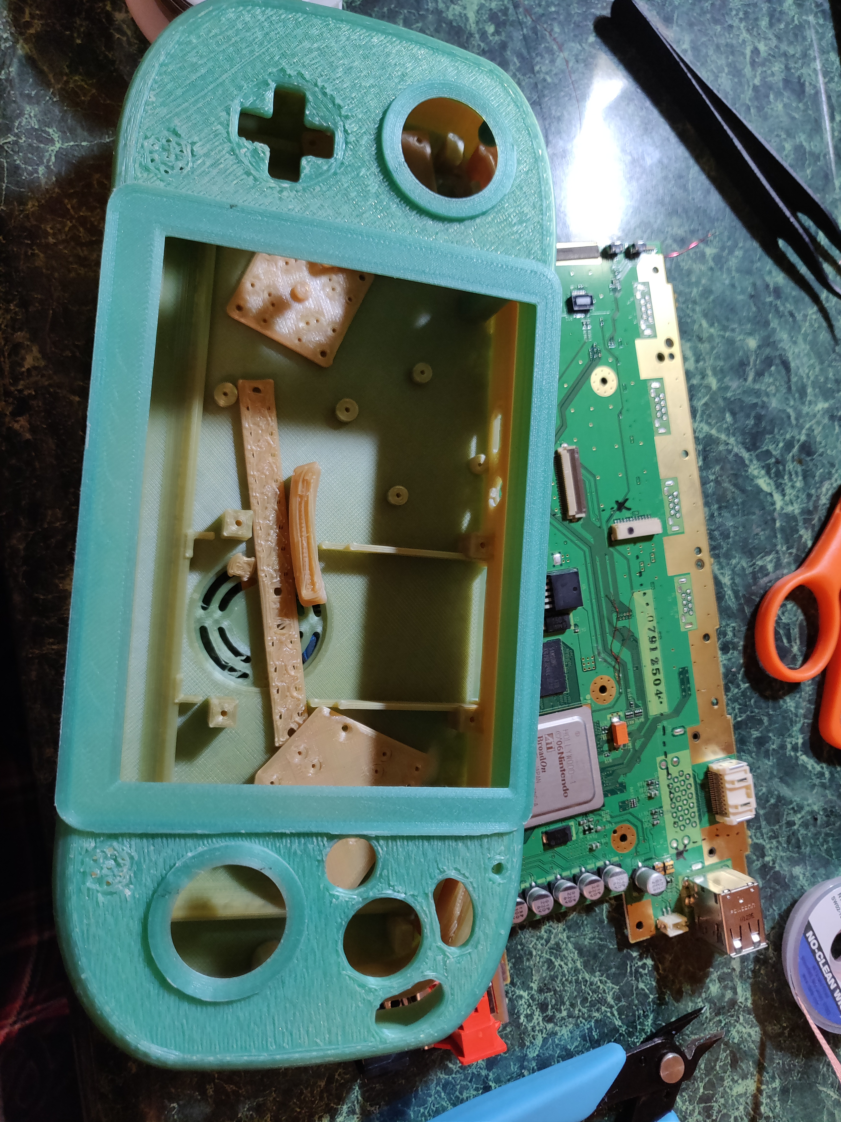

Absolutely. It's island themed. ... And the Louii is just orange.

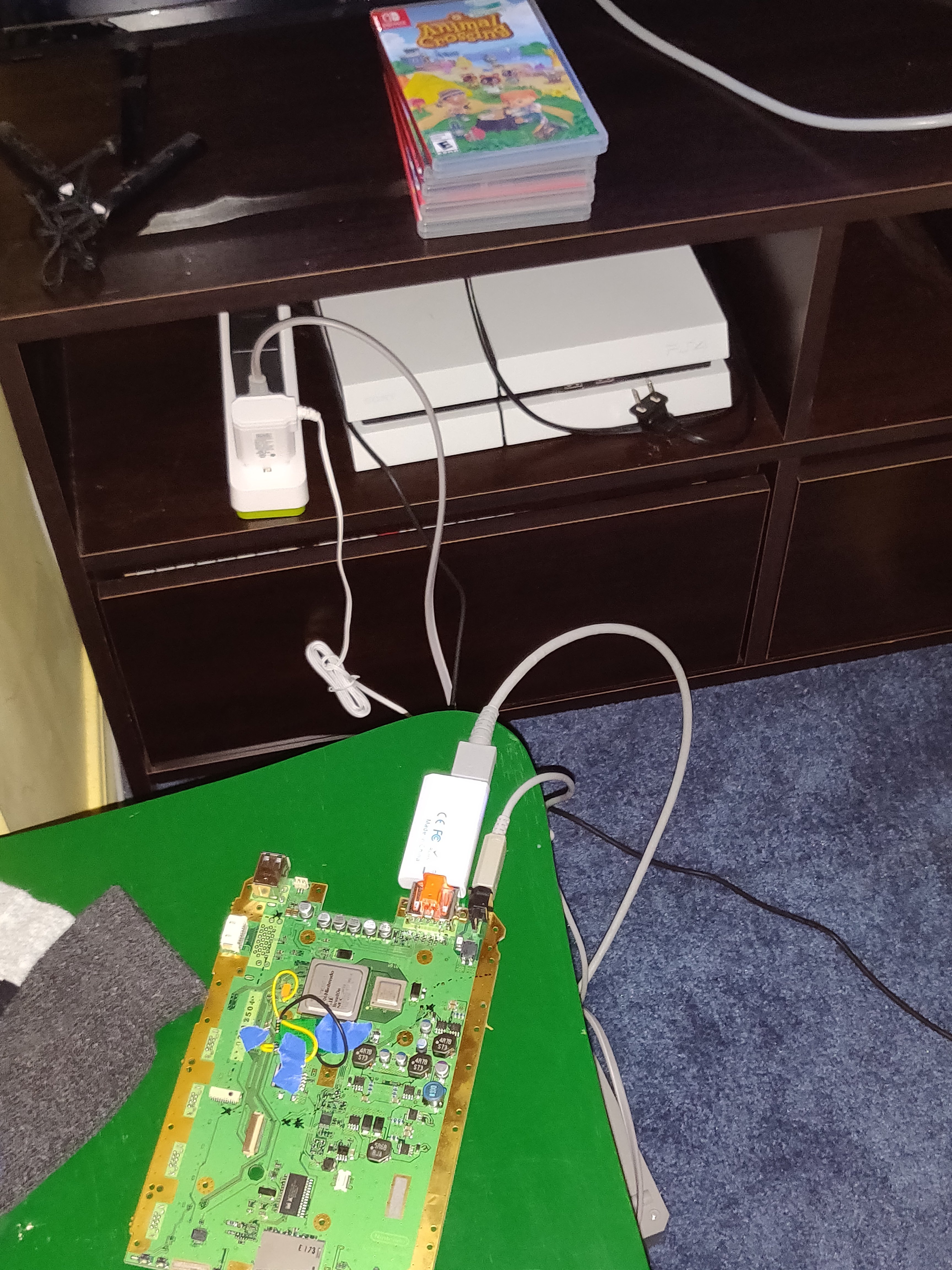

I got Bluetooth! Awww yeah!

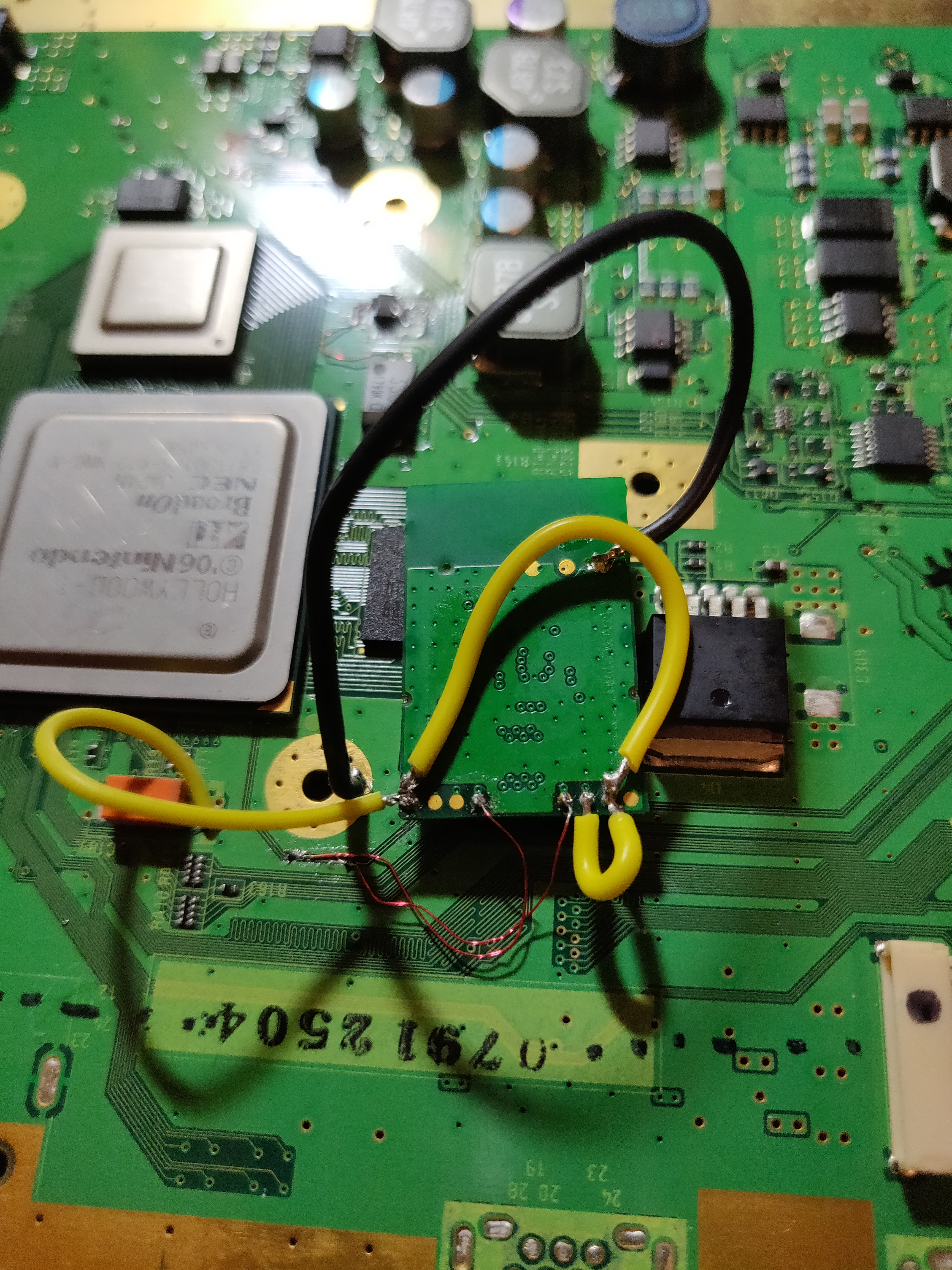

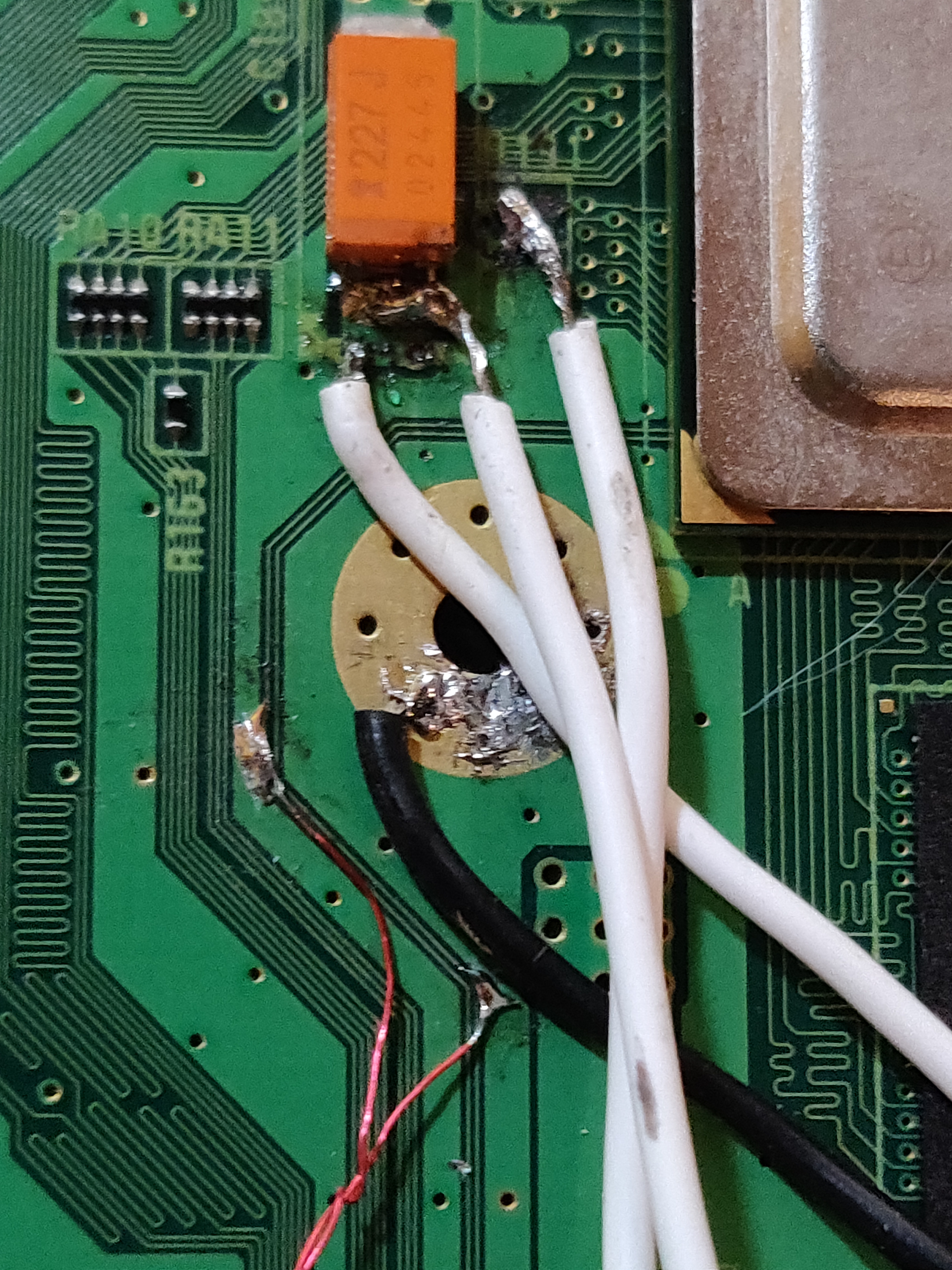

Uhhh... Hm... Saw some fireworks and quickly pulled away. So... I may have put the battery wires in reverse. I ordered another PMS (thank God it was still in stock.) On the bright side, that means it works in reverse and the only thing I got to worry about now is the PMS. The most important part! FML

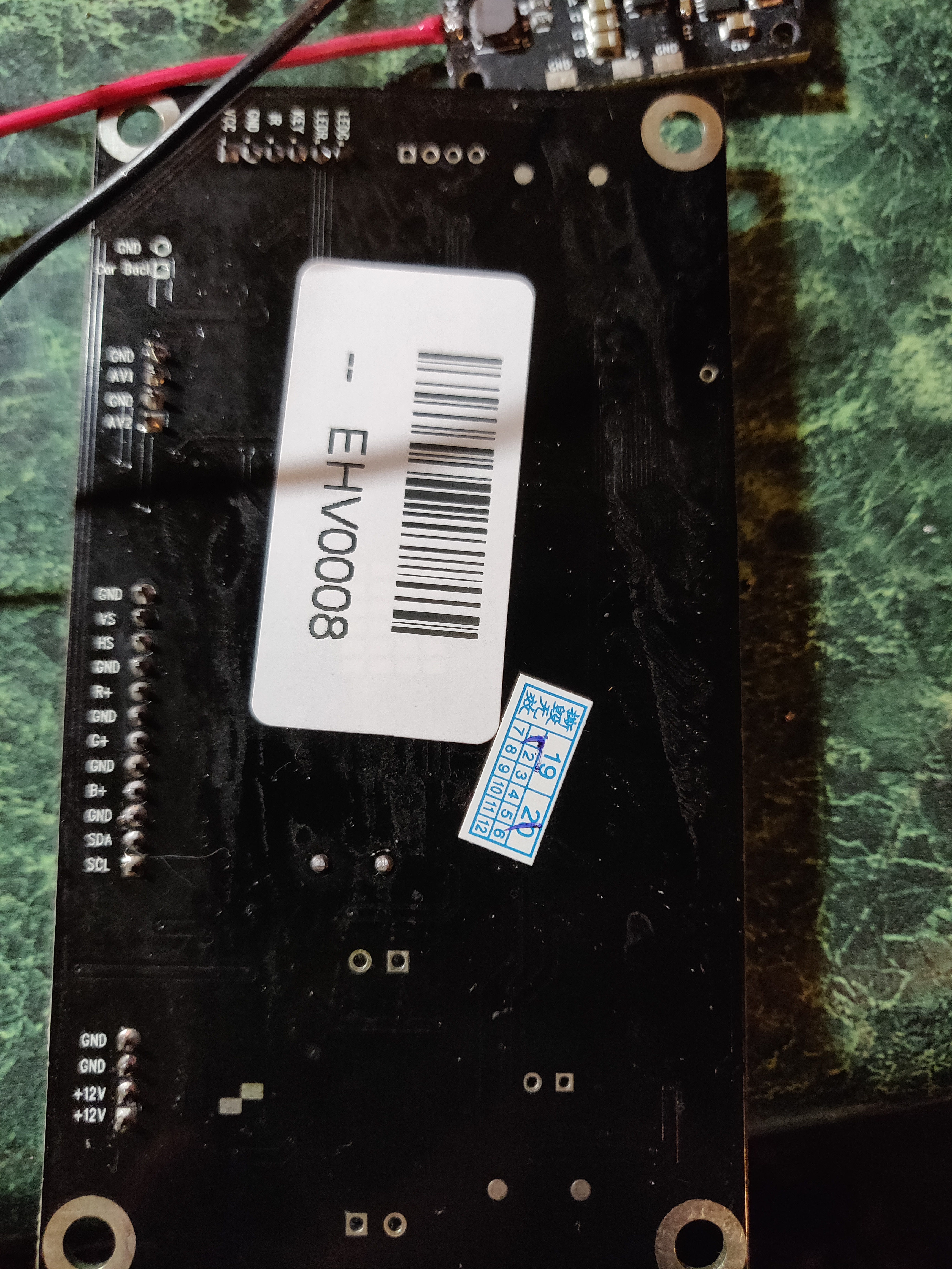

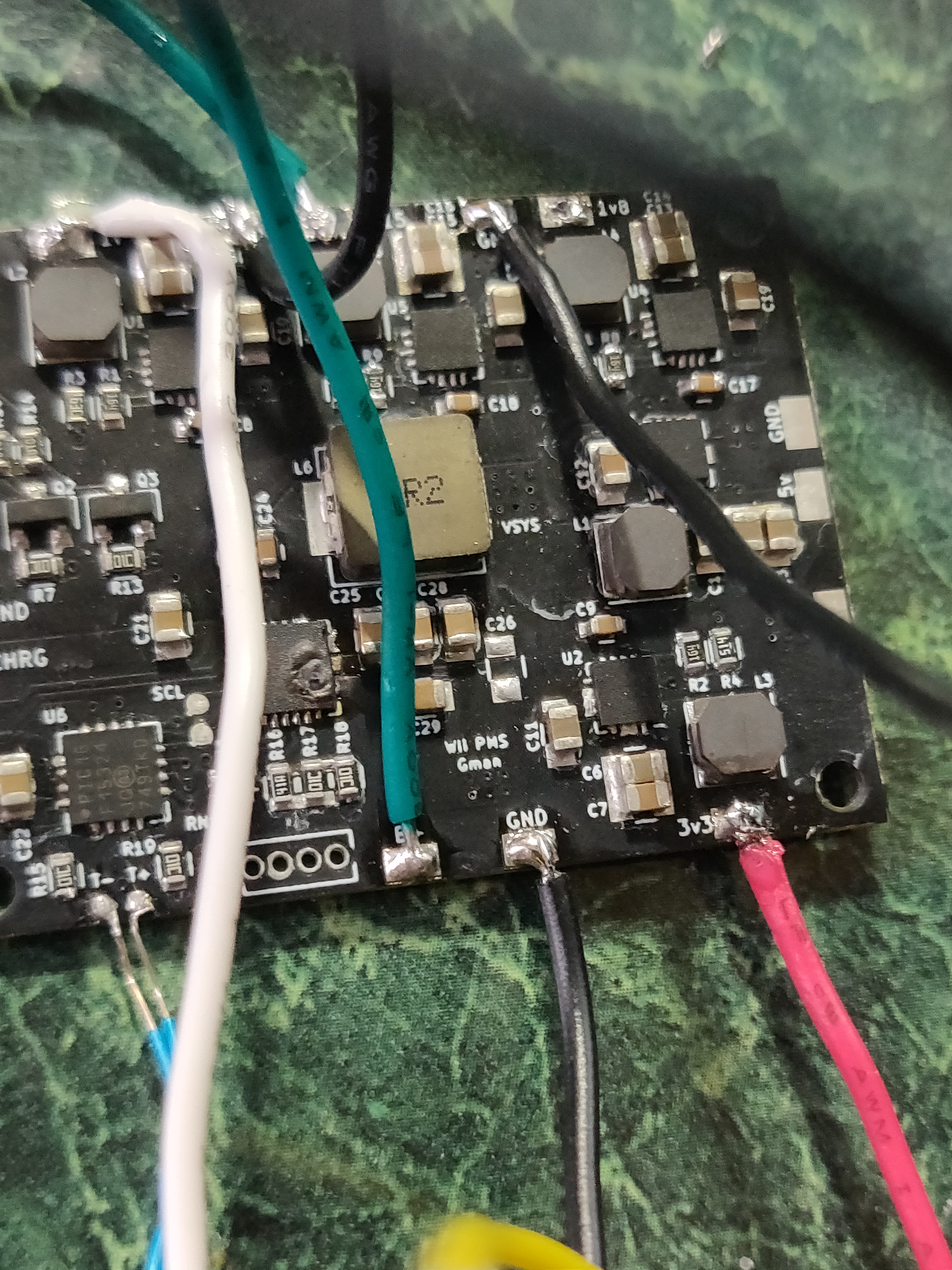

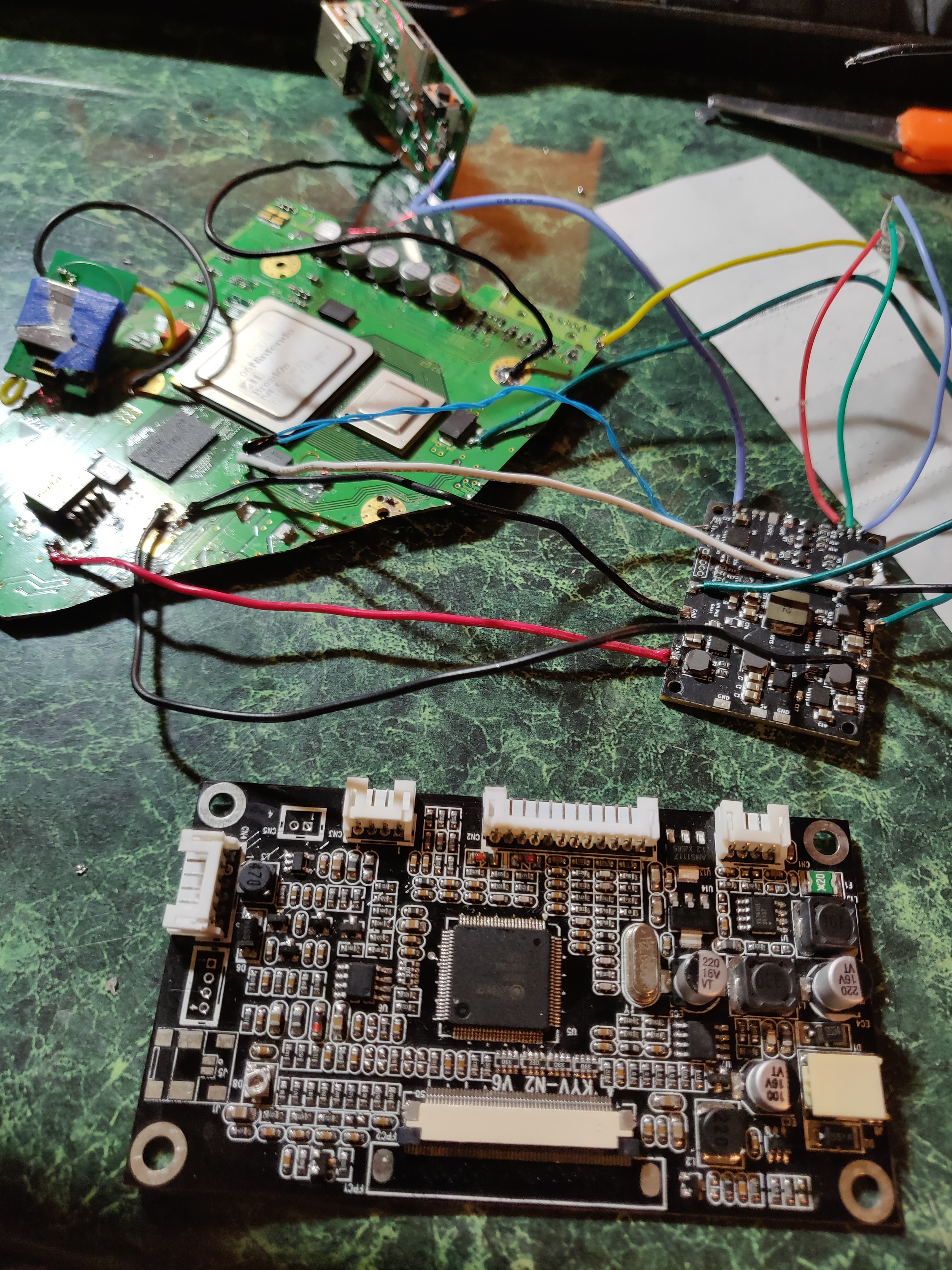

Alright now I really feel annoying. So while I wait for the new PMS, I thought I would finish hooking most of the grunt work together and see if miracles can happen. I know for a fact that I saw a guide on this forum with someone using this exact screen. My question is, can someone help me clarify the process here? I think I would have to flip it to the back and wire whatever I see to the motherboard.
On a separate note, there is a need for the vsys to be connected from the USB-C board. Do I just connect that to the box?
Take your time answering there's no rush.

Vsys from the USB c board just be connected to Vsys on the PMS. It powers the USB PD circuit when the system is off. Check the PMS description. For the screen, yeah, you would connect video and ground to the points listed on the board. The screen probably needs to be modded to be powered by 5v (bypass the 5v regulator on board).
Okay, I took a look at a whole bunch of cleaner looking worklogs and self-confidence aside, it looks like in order to mod the 5v from the board, I have to remove only one component from the board and it'll be ready to go from that pad to the 5v right? I see it in other worklogs but also I know I saw it in a guide that I can no longer find. It's the one marked "330" right? EDIT: STOP! DON'T ANSWER THIS! I FOUND IT!
Also, am I allowed to share 5v pads on the PMS for both the USB-C and the LCD?
Thanks for answering BTW. I know people here are busy so I'll try to keep my posting at minimum now.
You can check the guide hub for a generic guide on how to mod displays to run on 5v. Generally, you insert 5v at the output of the 5v regulator on the board, and either remove the regulator or remove a series component like an inductor on the 5v line to prevent injecting current into the output of an unpowered regulator. And yes, you can share the 5v pad.
Damn, you keep presenting me with more options. So my first gut reaction is to find and remove this 5v regulator but in your opinion, which one would be better? Removing inductor or regulator? I feel like they both do the same thing.
