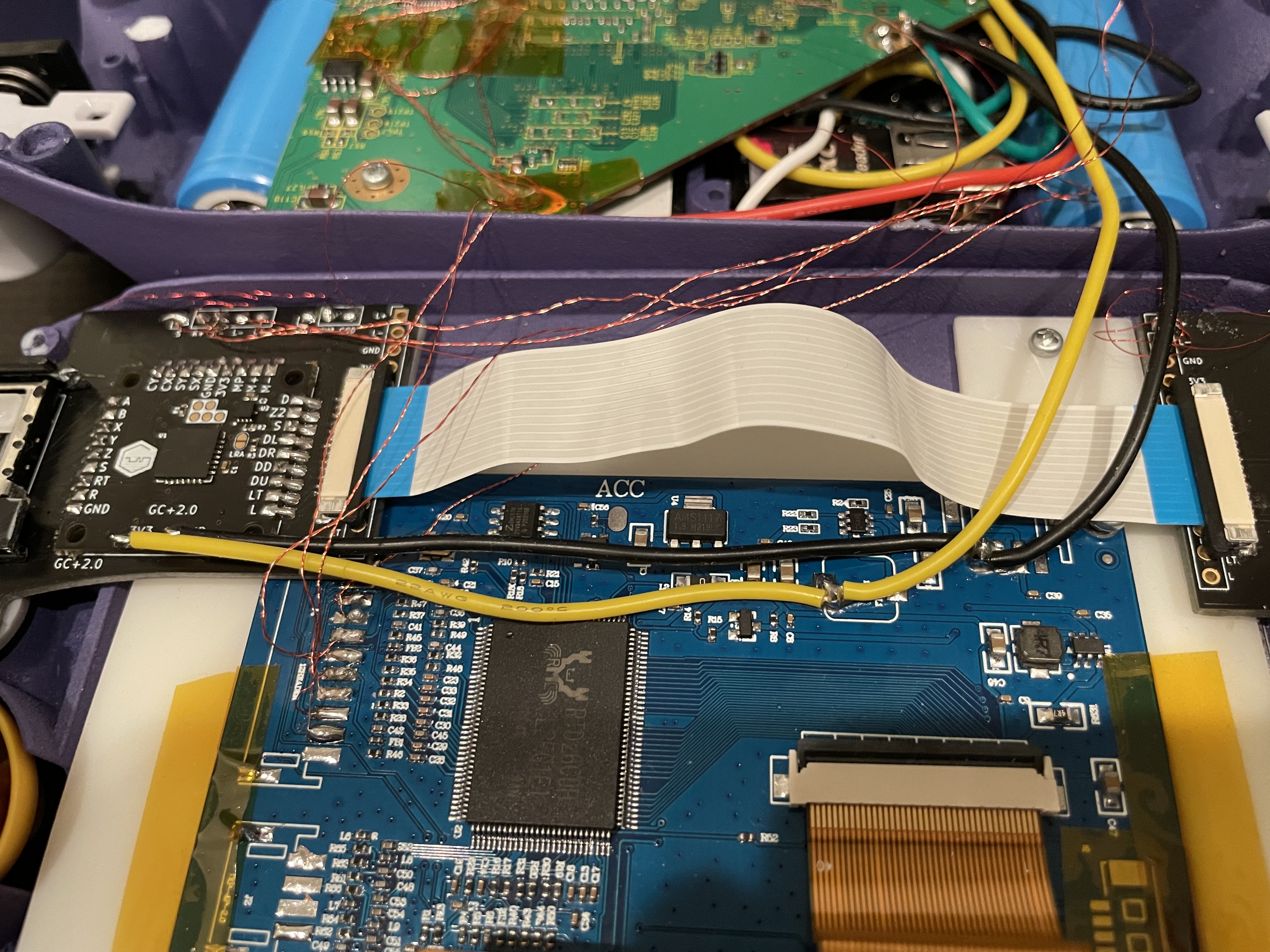

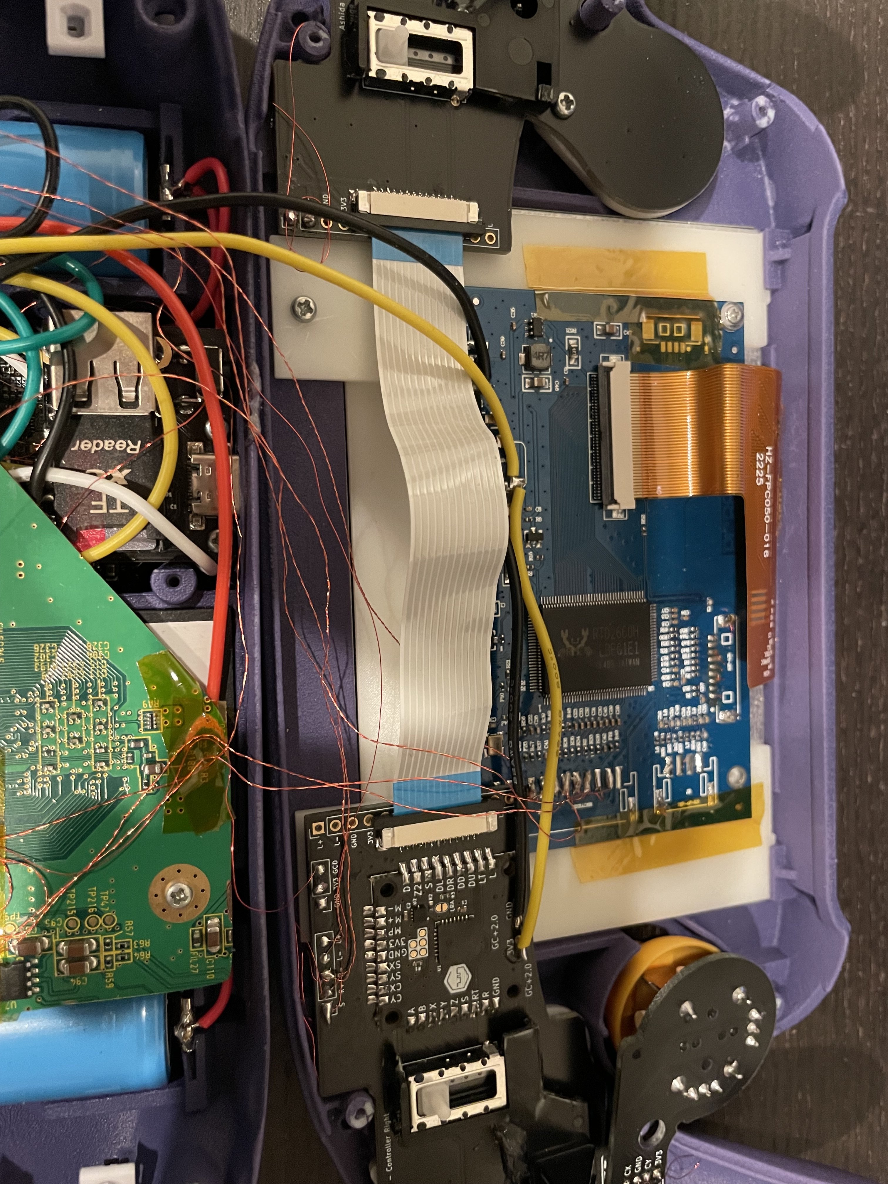

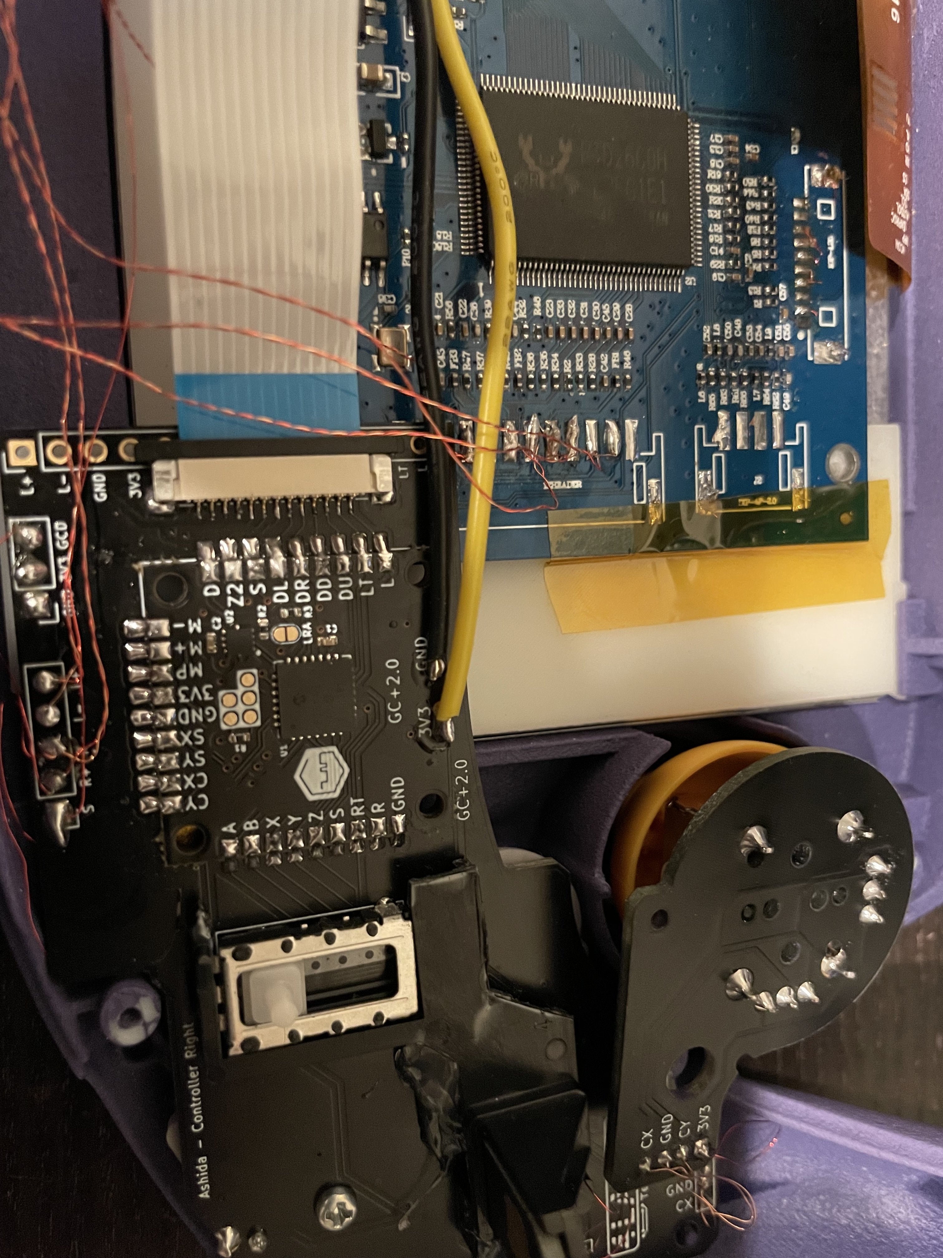

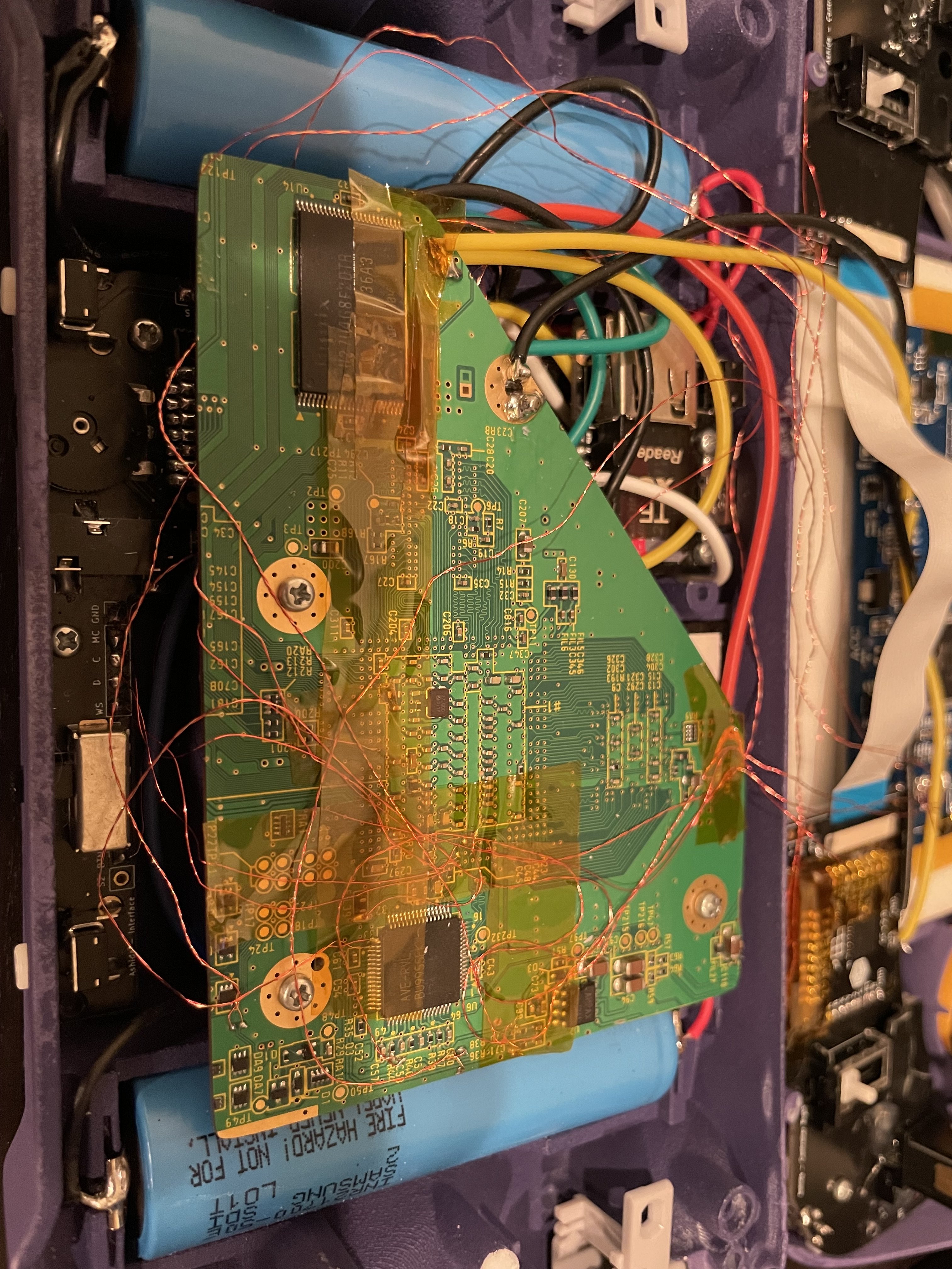

So I noticed that I can get the stick drift to stop if I open the case and separate the two halves. So it has to be an issue with my build. I'm guessing that something inside is shorting SX and/or SY to ground somewhere along those circuits. I'm going to try to cover any contacts with kapton tape to see if that helps. Anyone have any other ideas about the cause or possible fix?
pics would help especially of the two halves as you would assemble them so we can see what if anything is apparent from the outside
Thanks. If these aren't showing you what you want to see, let me know.

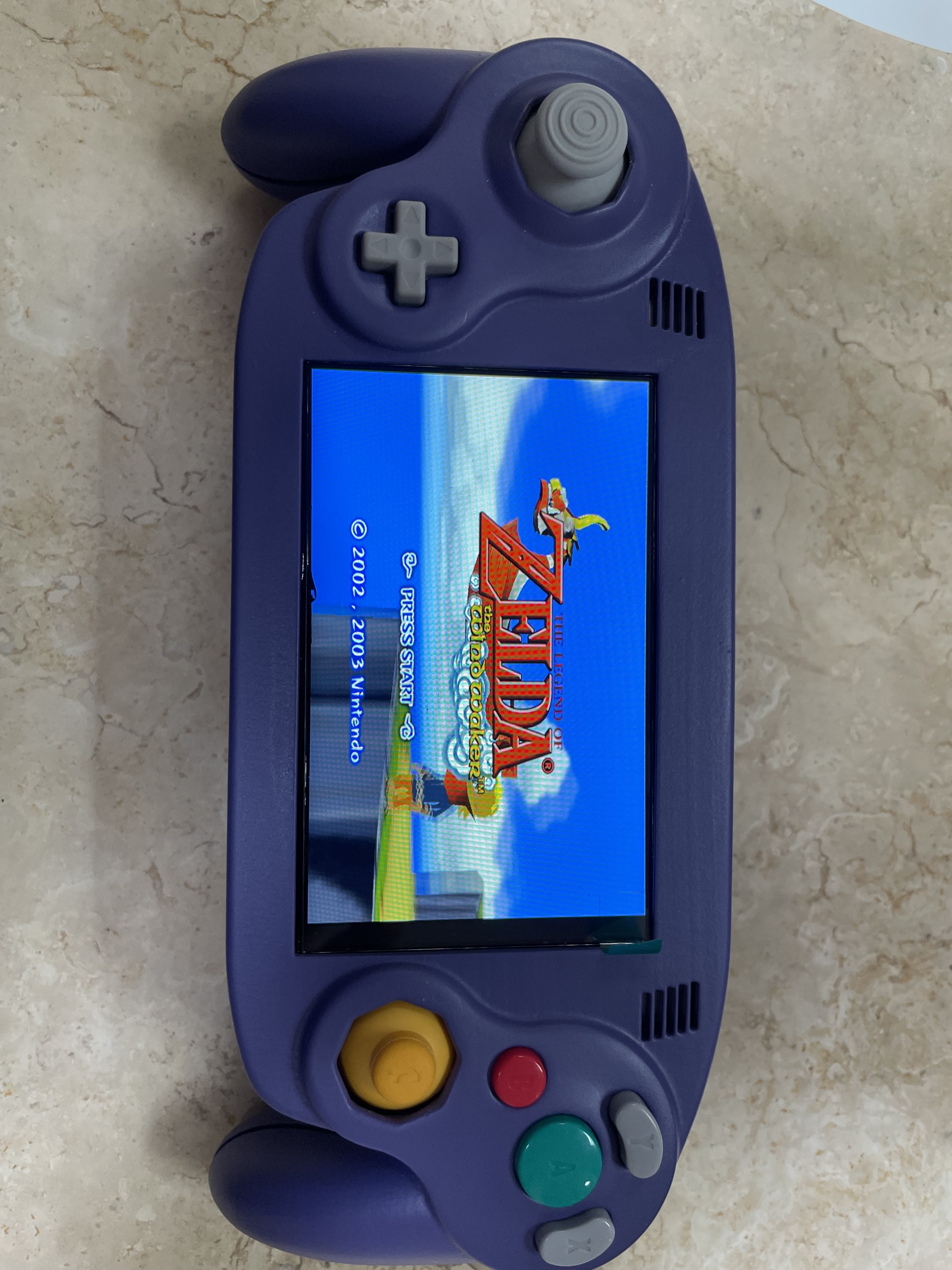

Well it took me about two months, but I think my Ashida build is finally done! Wesk, thank you so much for all of the work you did on this design! As a huge GC fan, having a real-hardware portable that has the same feel as a GC controller is amazing. It's something I never could've made on my own, so thank you for sharing all of your work!
And thank you to Stitches, Sully, and everyone else that took time to answer my questions! Your help allowed this build to come out as well as I could reasonably expect for my first attempt.
Thank you!
