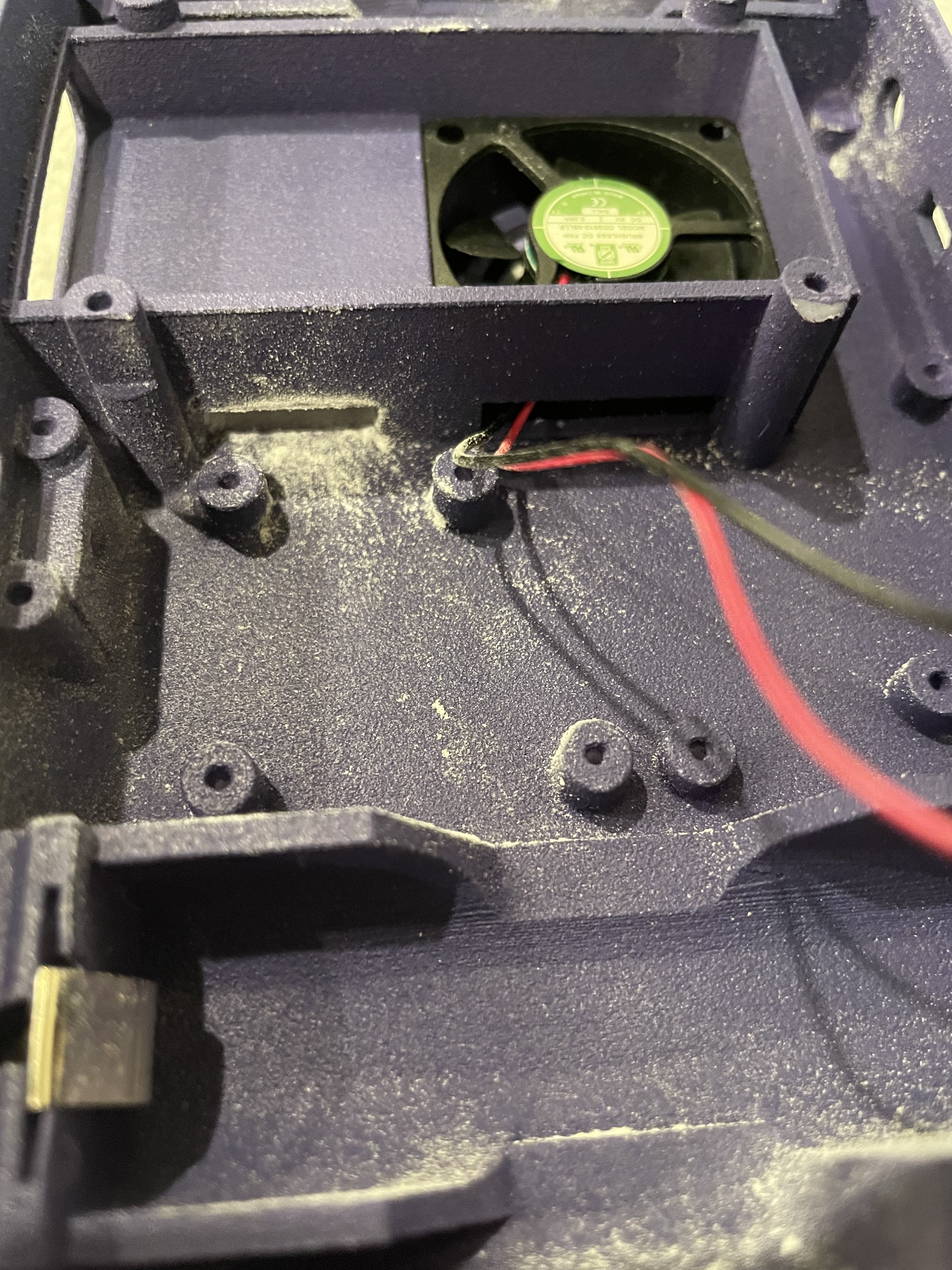

Just wanted to call out something interesting about my SLS shell from PCBway. I just noticed that the area under the heat sink where you can route wires was solid and I couldn't get a wire through. Messing with it a bit, I realized it was still completely full of the PA-12 dust that is used in the SLS process. I was able to dig it all out with some picks and I think it's fine now. But it was a LOT of dust. Just something to be aware of if you decide to go with SLS.
