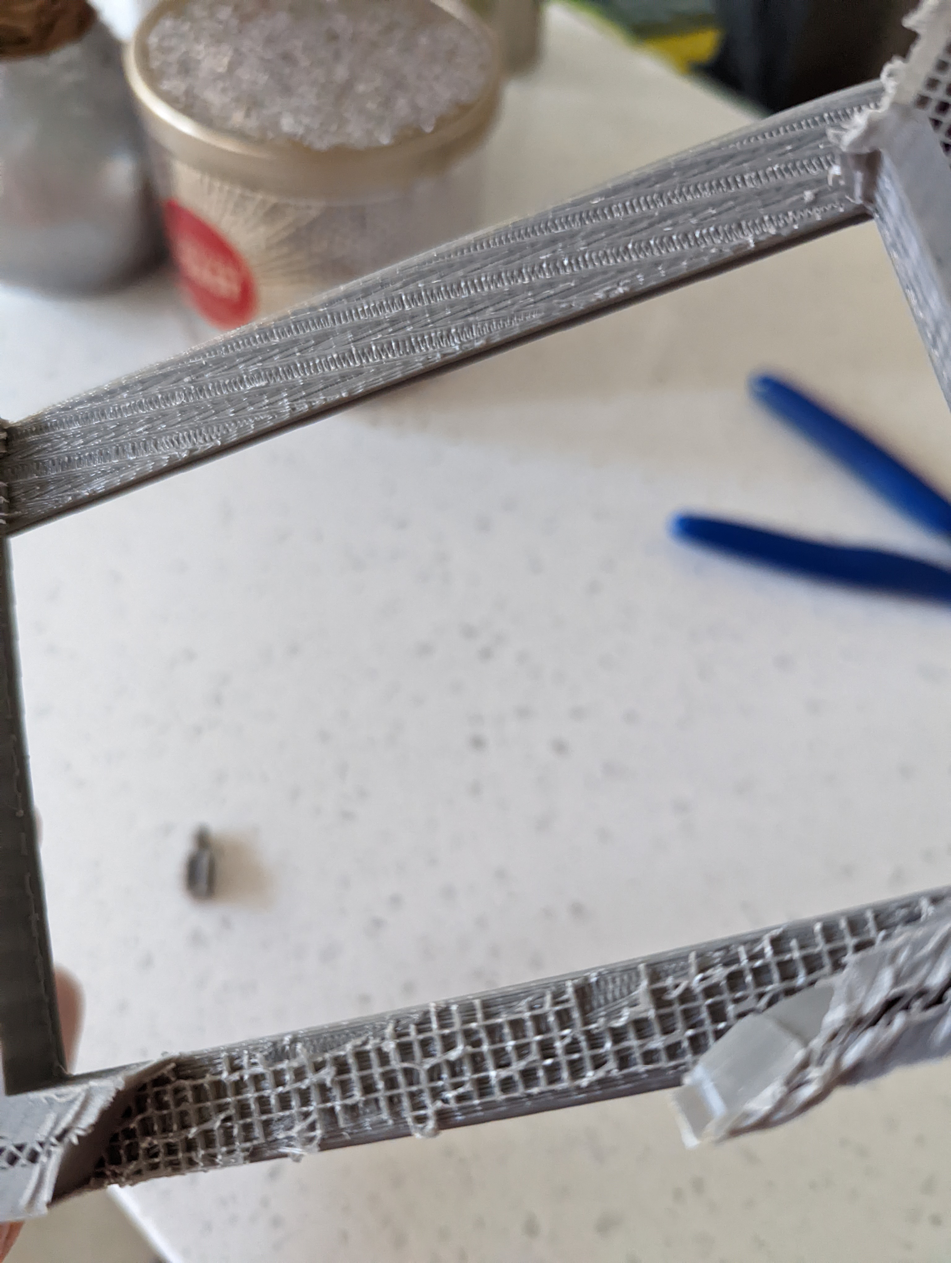

I got the parts and began my work. This was my first time working with a 3D printed part. It was not until I was struggling getting the supports off that my cousin told me he messed up and made the supports way too stong lol.
I eventually got the supports off and was left with a lot of clean up. I had a long road ahead to smooth this baby out.

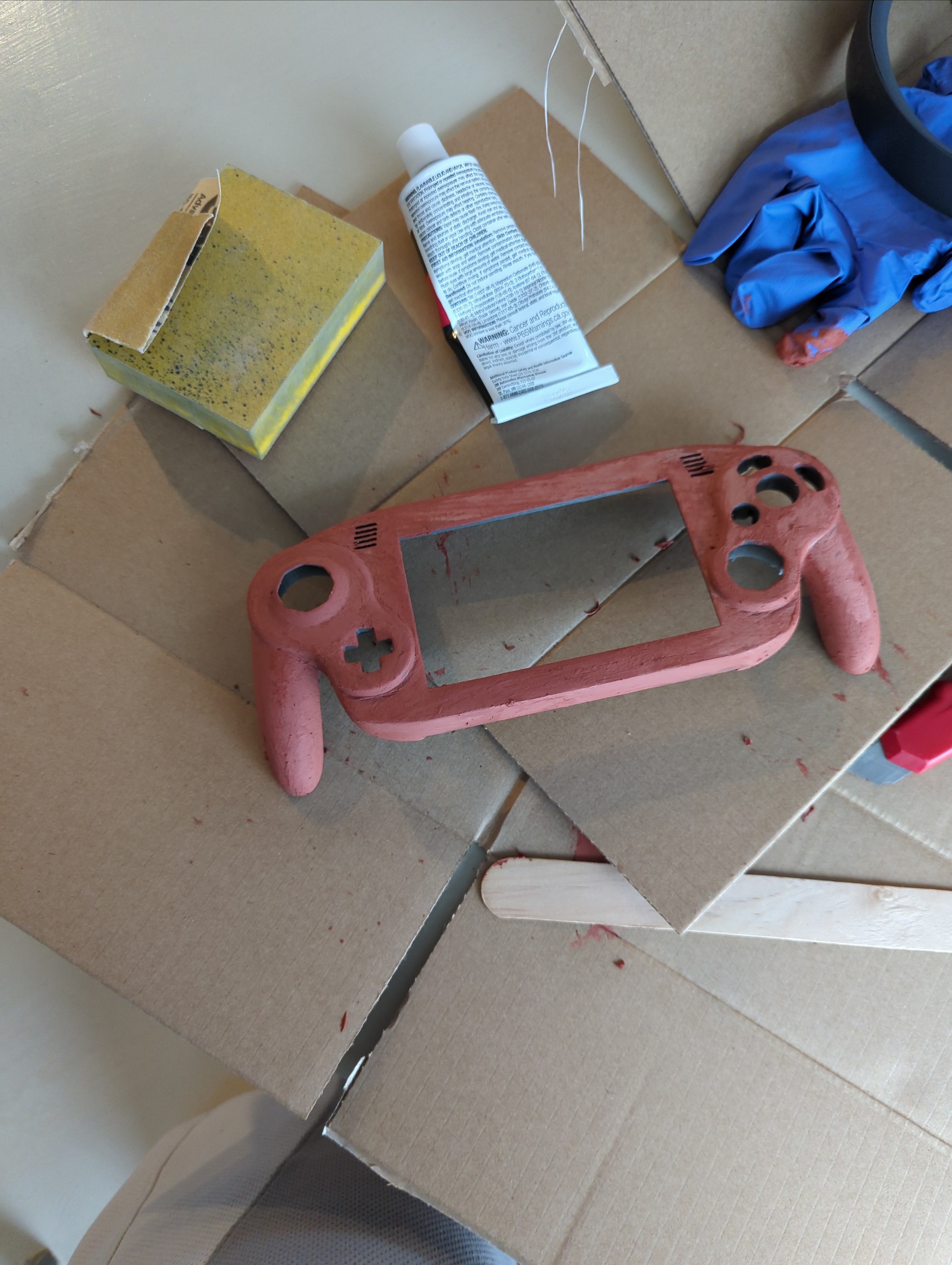

Many hours of sanding later I was ready for the whole sand, bondo, prime, sand, bondo, prime, and so on and so on.

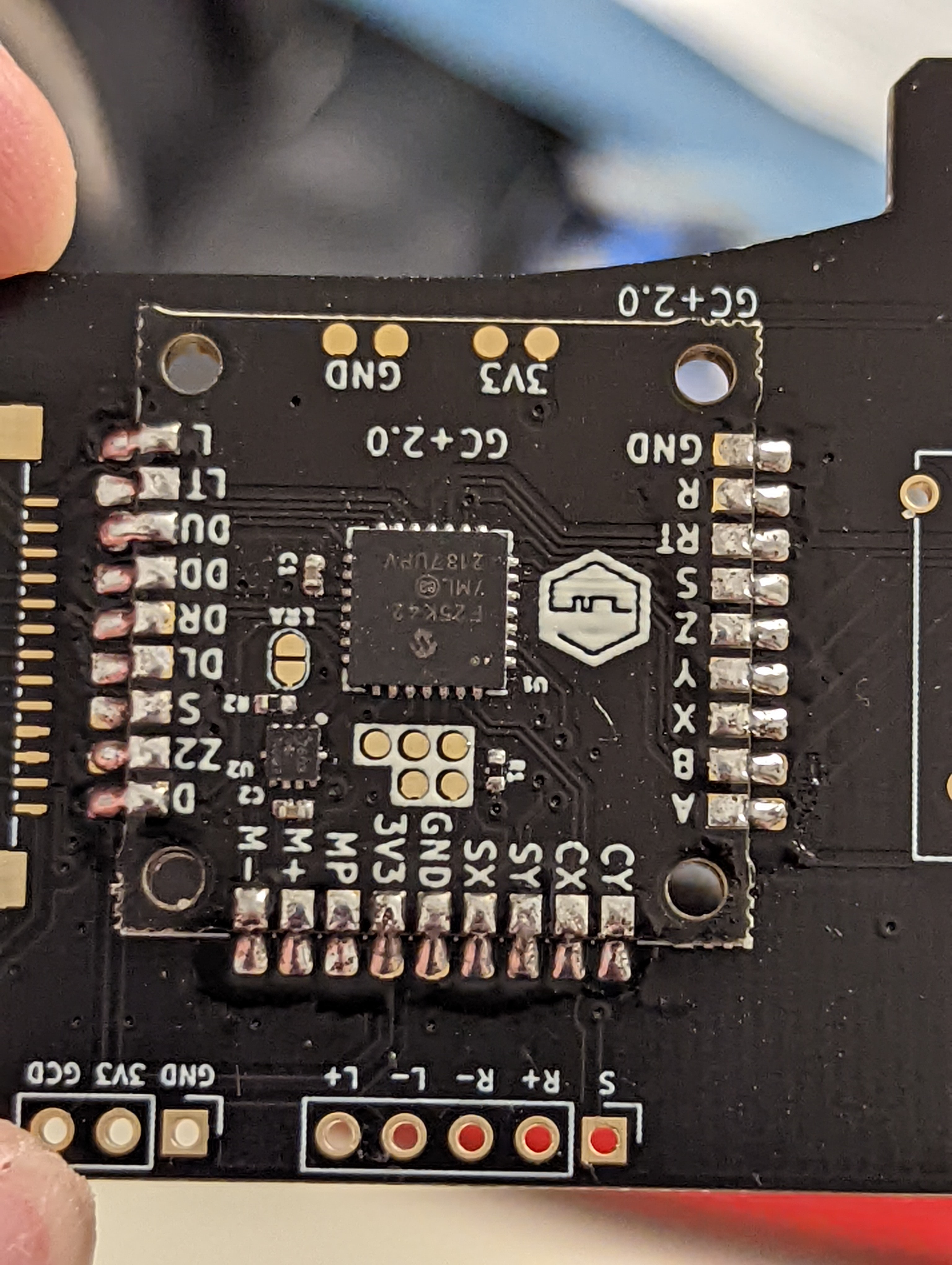

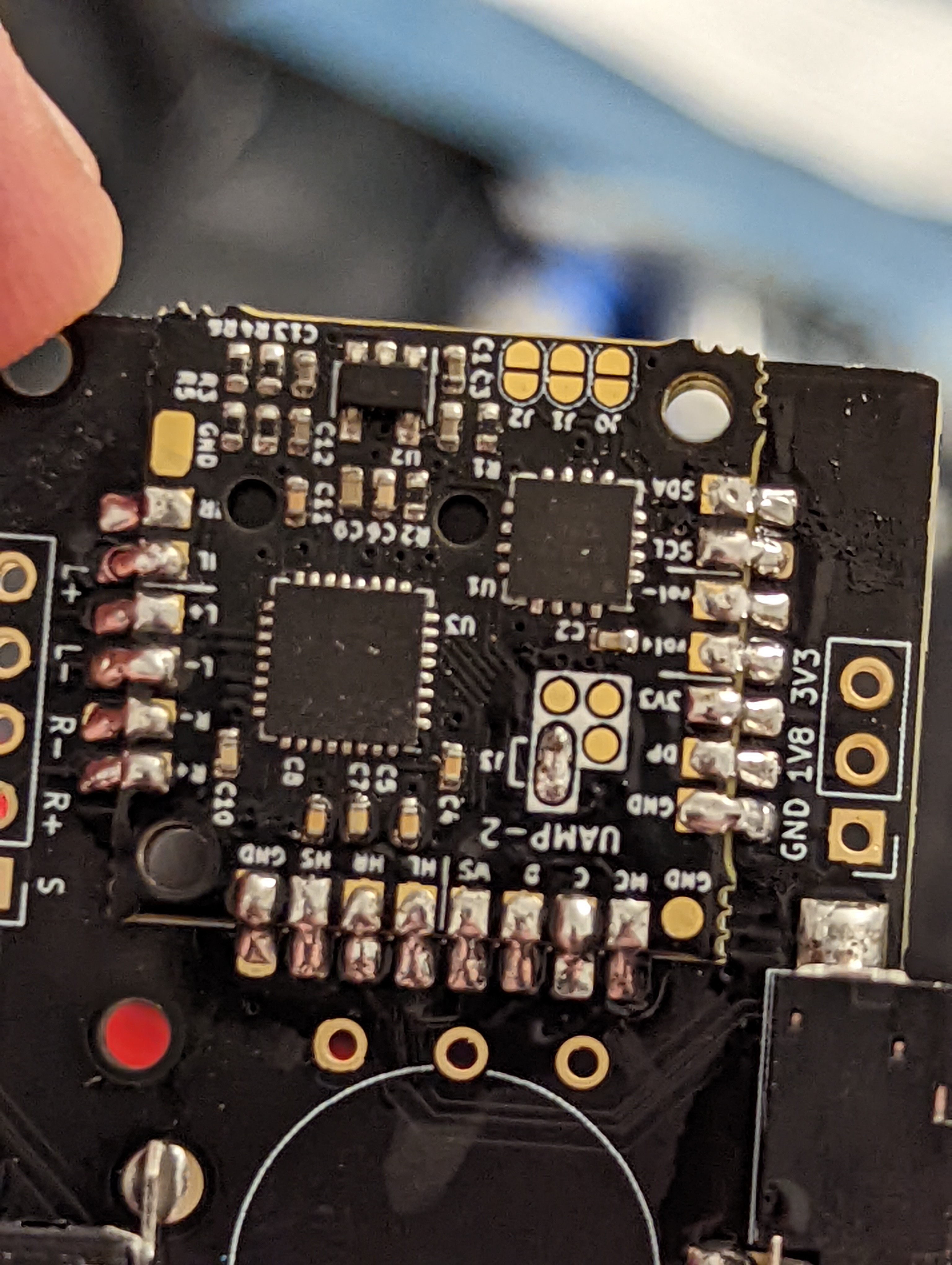

Now I do not claim to be a professional or hell even good at this at all but I began to populate the PCB's and I am very proud of my solder joints. More pictures to come in the next update.

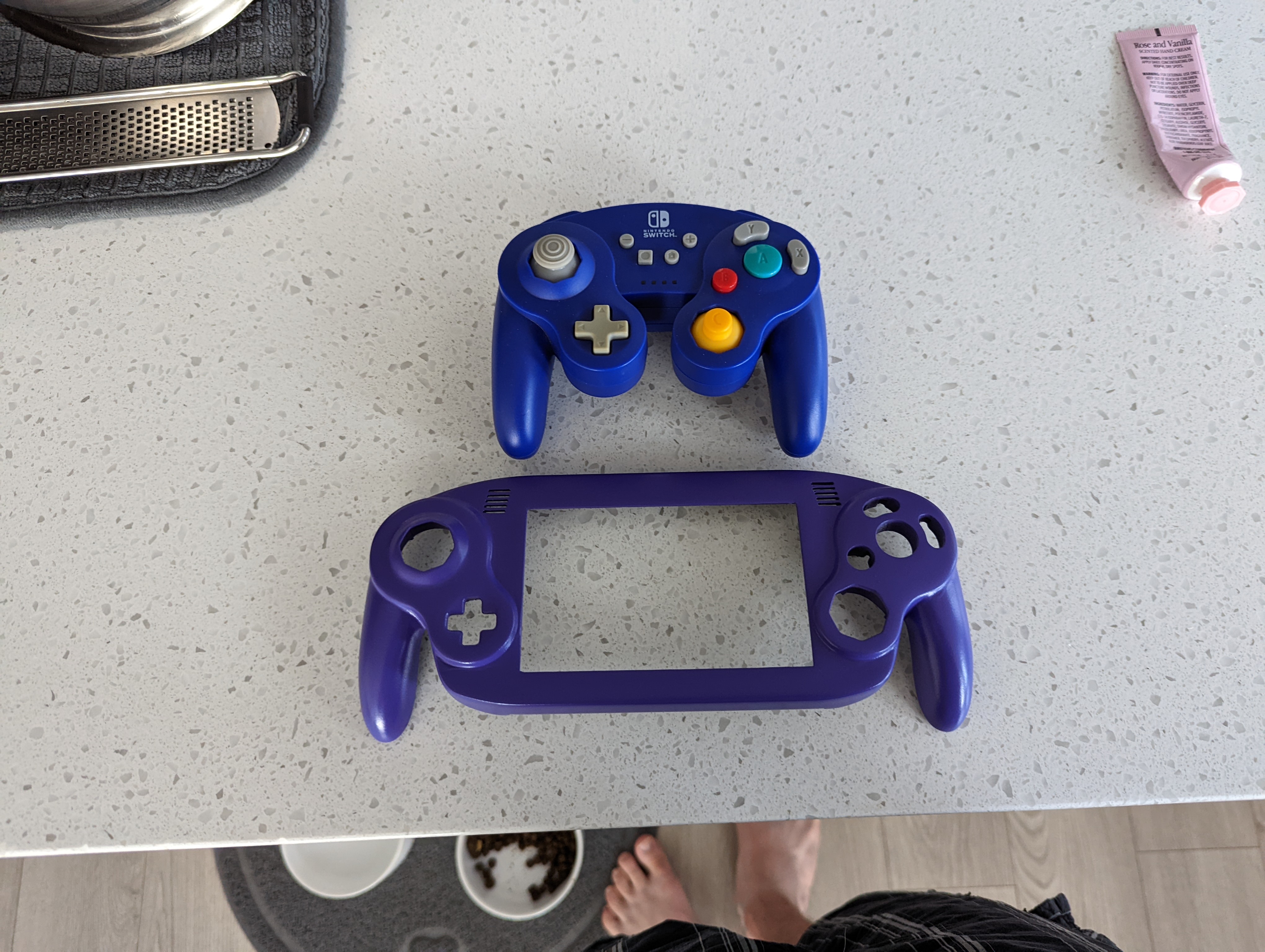

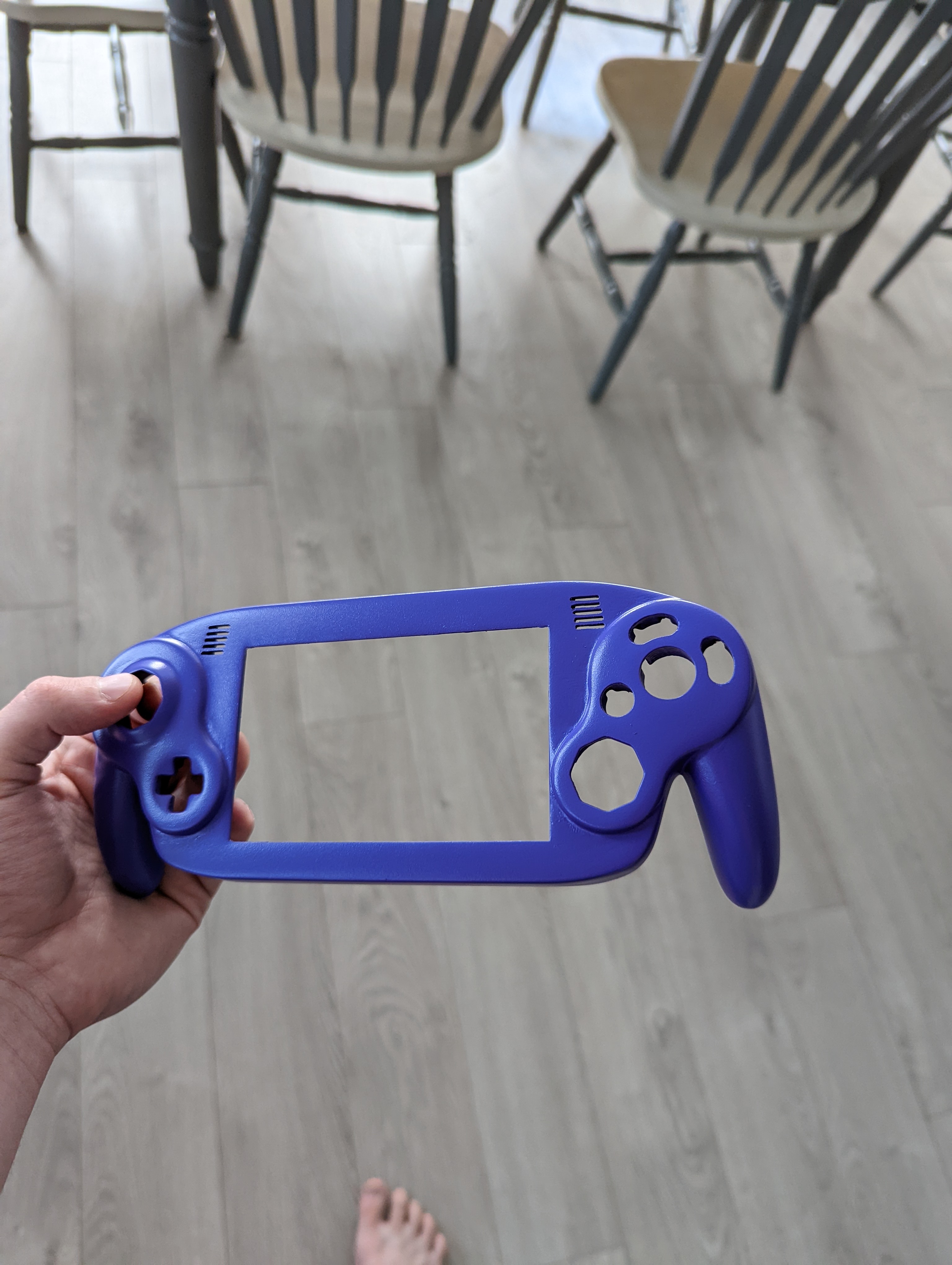

Our story (at least for now) comes to an end here with what I have finished as of this morning. The front plate is baby bottom smooth and painted! I love the OG purple and I do not think the Power A GameCube controllers are the same shade but from my paint job it is exactly how I remeber the original (don't rain on my parade if it's not even close).
