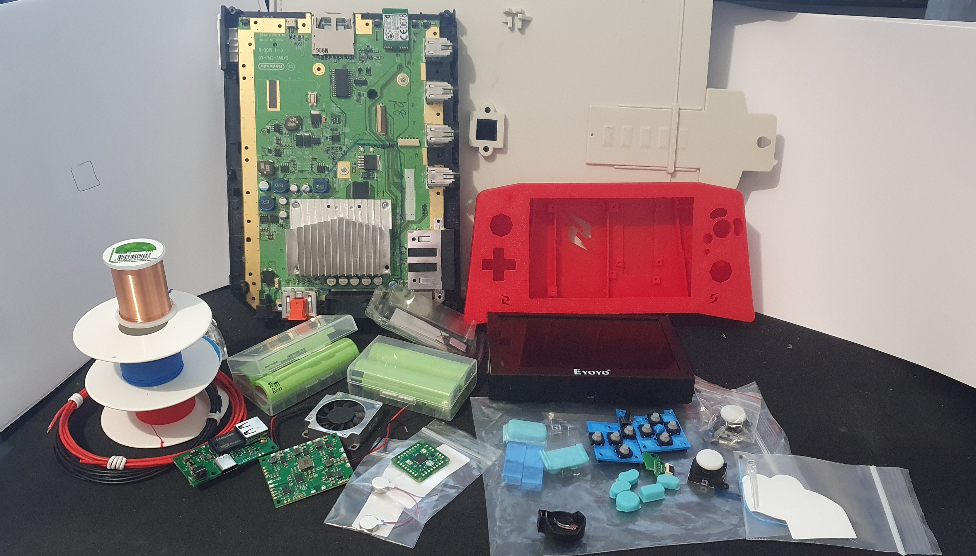

Most of the parts gathered together for my customary before i build photo.
Once finished the Aran is going to be Metallic Black, with blue buttons and white sticks, i went the Dark Samus route.

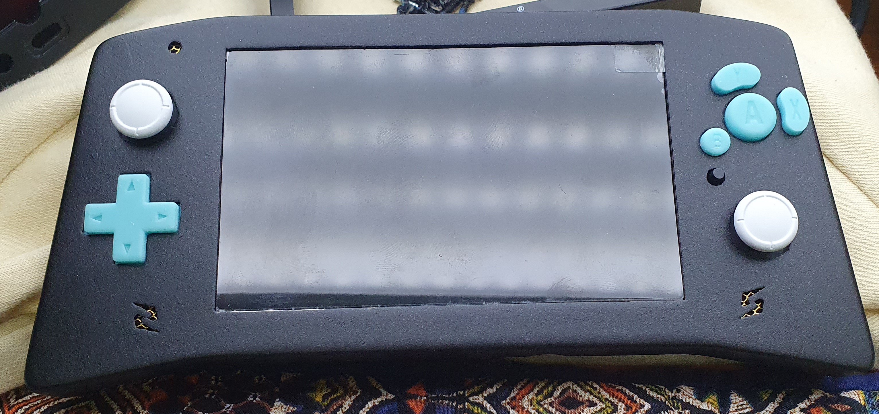

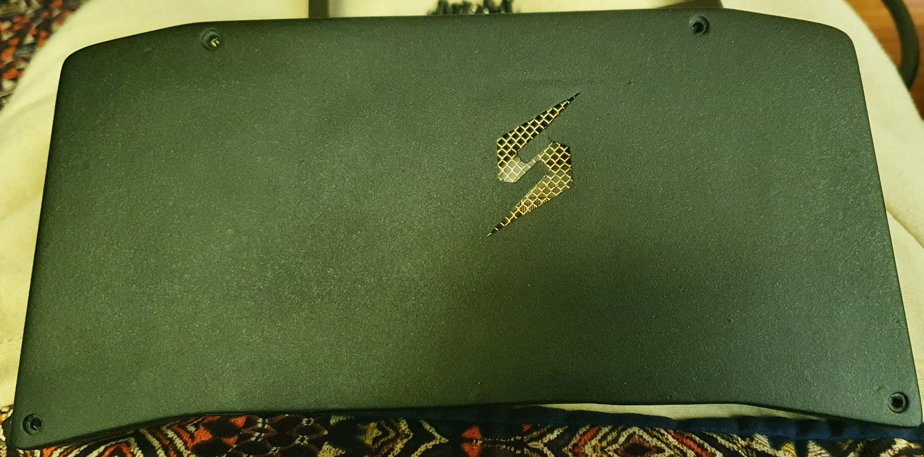

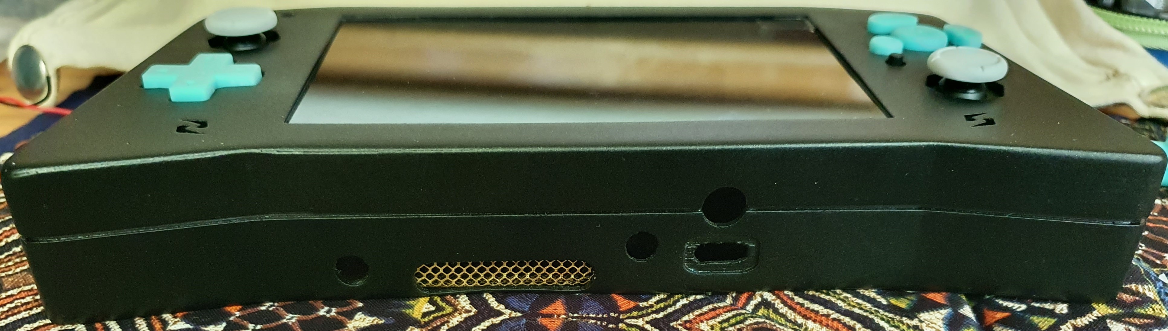

So i've finally gotten a chance to work on my Aran build.
Haven't had much time to work on it due to family health issues and school work
But here it is mostly assembled, still need to trim the wii and wire everything together, and program the U-amp i assembled
The light was a little yellow but the wii is metallic black, with bright blue buttons, white joycons and brass mesh on the openings including the speakers
was going for a dark samus theme :)
enjoy
Ooh that's a really nice colour scheme. I like the mesh you've used over the vents, looks clean. For your buttons are those printed SLA or FDM, or did you cast them separately?
Thanks!
Its brass mess for model trains and i absolutly love the contrast it has with the black. FDM case with a buttload of sanding, i was going to cast the buttons but decided to stick with the SLA buttons

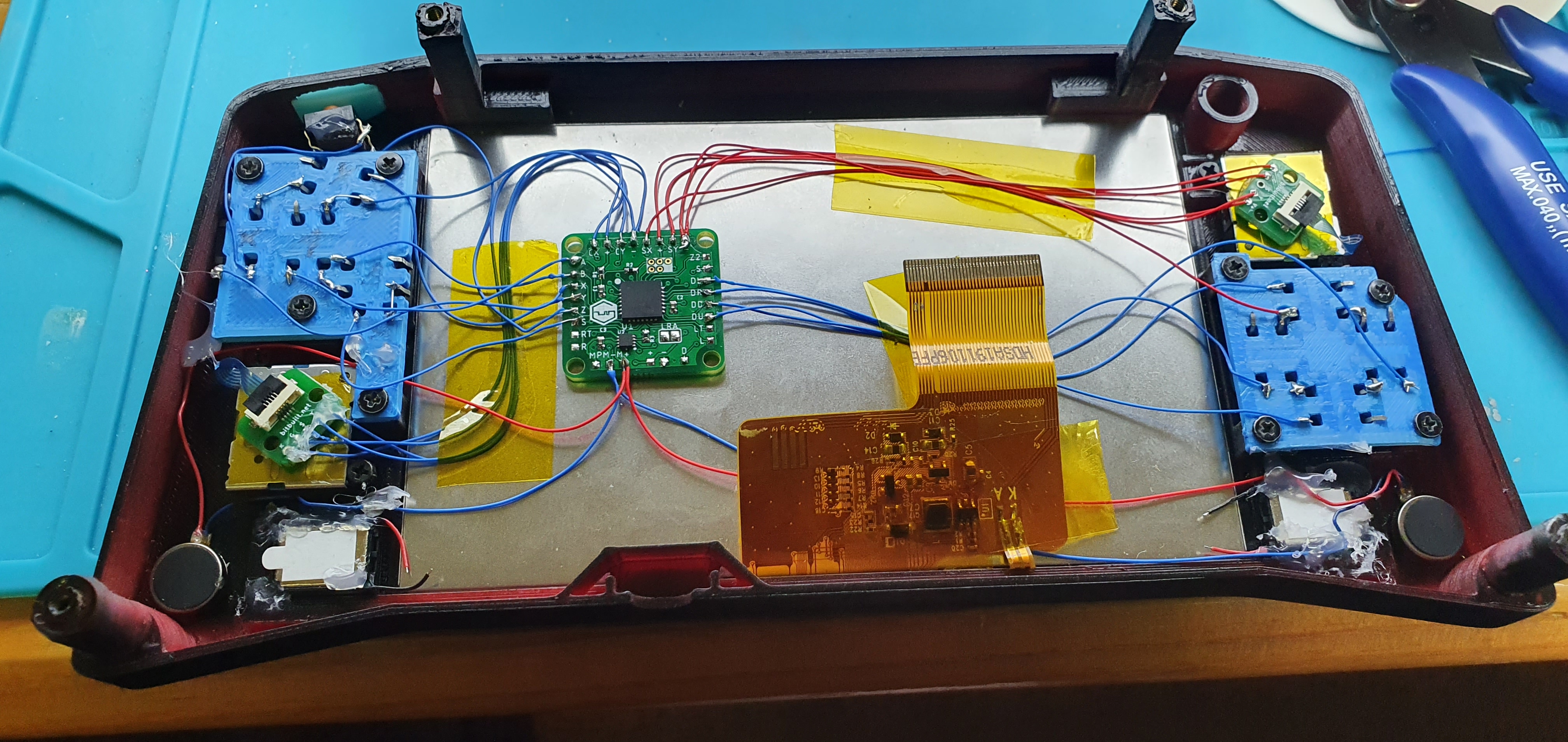

I even managed to get a pile of wiring done on the top half, most of the buttons are now wired just the L and R to go and the 5-way tact for volume and screen control, the rumble motors are wired up and the LED ready for wiring to the PMS. Photo was taken before i glued in the LED

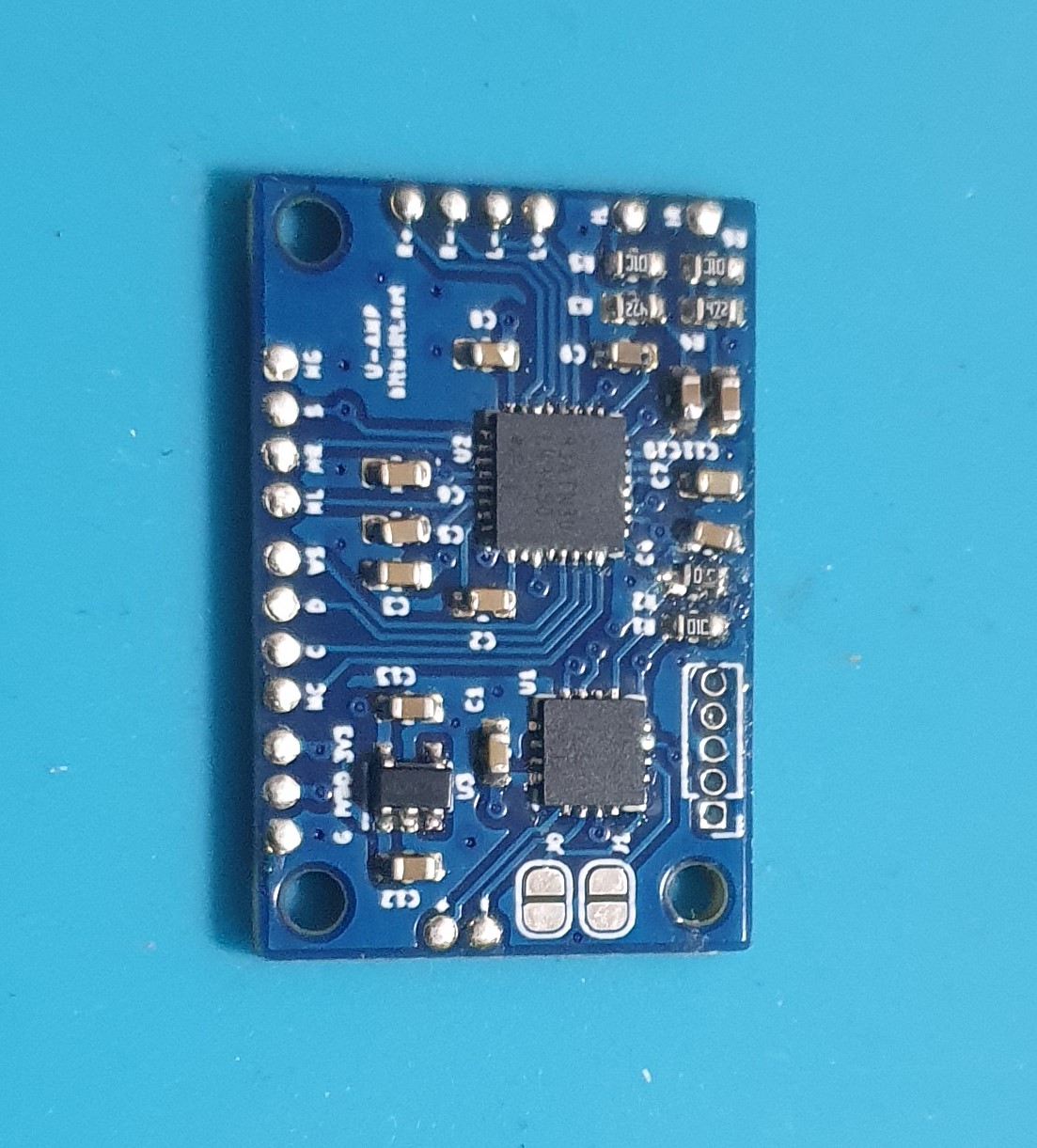

Speakers have longer wires now ready for wiring to u-amp.
The u-amp i assembled has now been programmed.

U-amp has been replaced due to a bridged trace and the large chip being in the wrong orientation

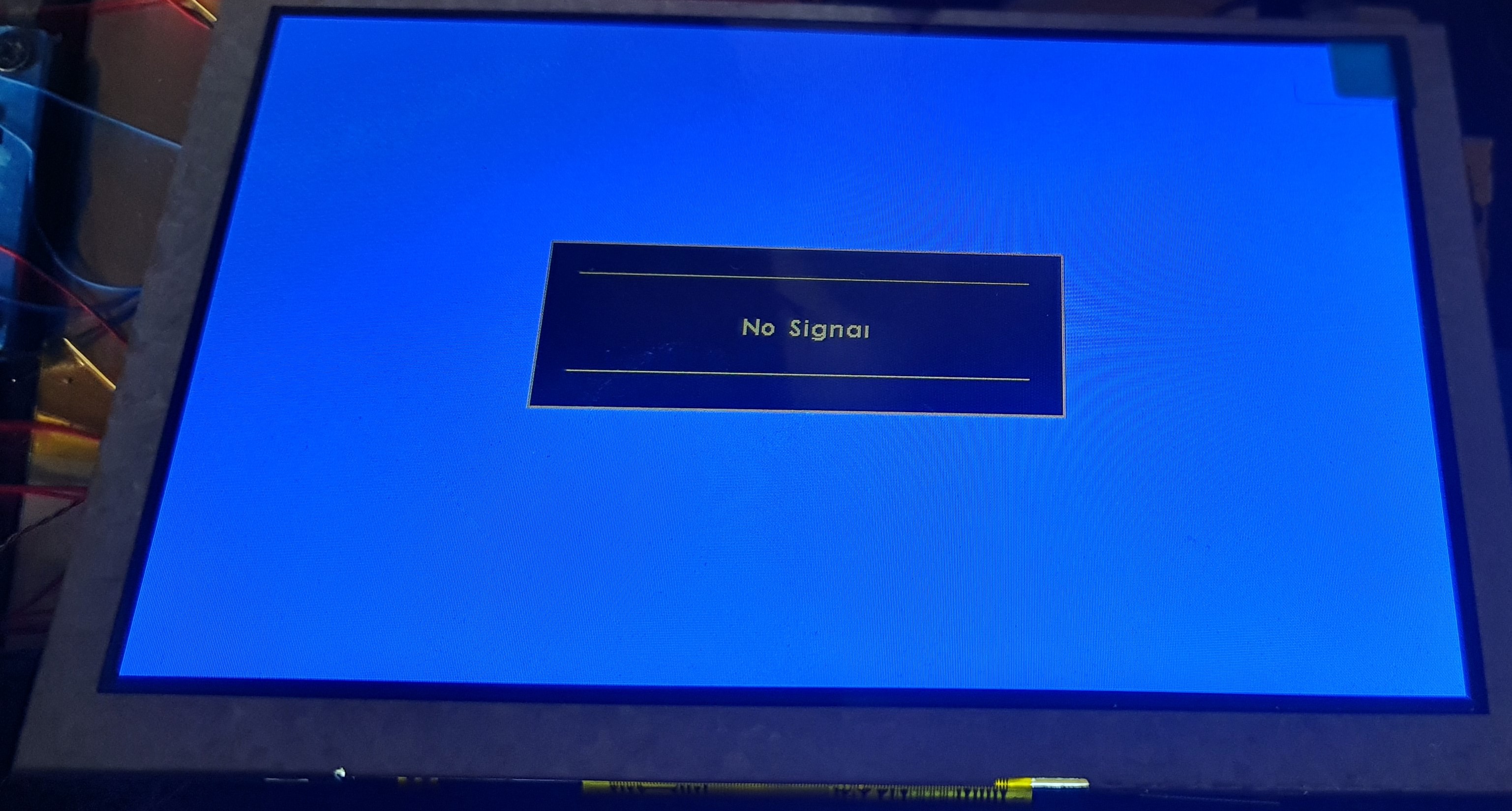

Modified the screen board to fit, after the PMS my screens backlight wouldn't turn on, as it turns out the transducer on the backlight circuit was dodgy.
@StonedEdge Thanks for all the trouble shooting on the board via discord late last night.
Safe to say i have never been so happy to see these two little words
now to get everything back in its correct position, double check the connections on VGA, reattach the batteries, and then hopefully never have to open this cursed build ever again
