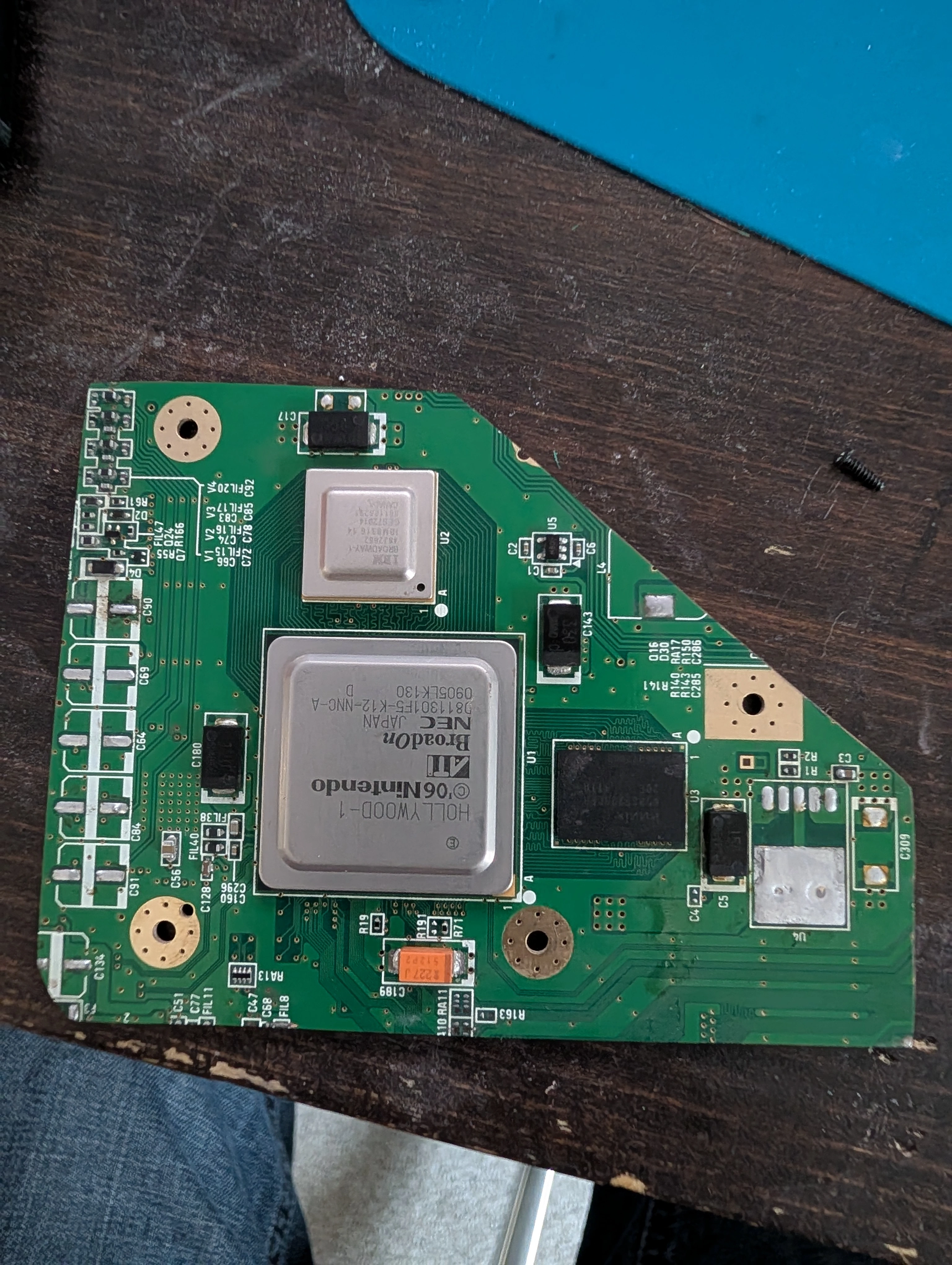

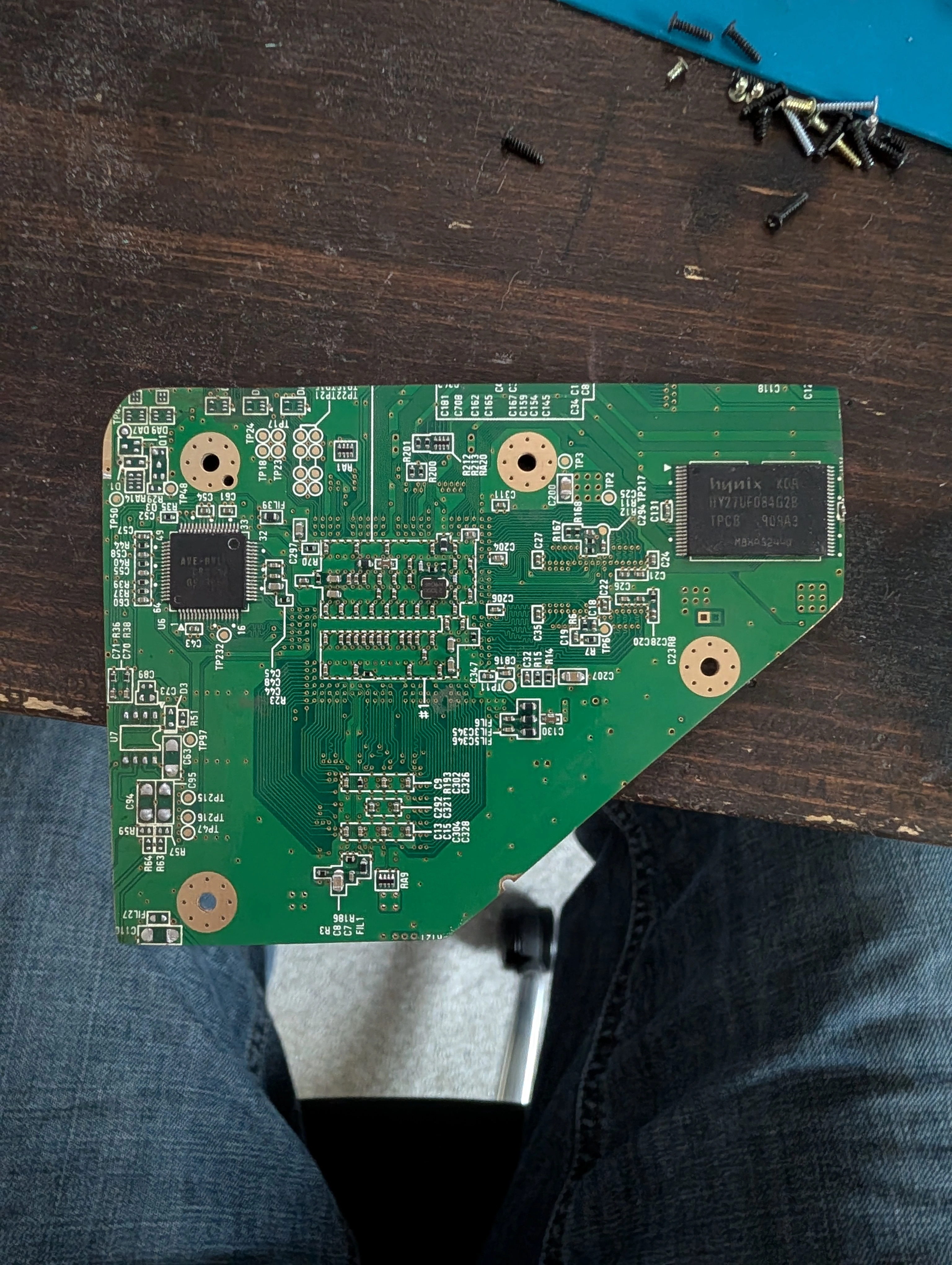

I got my cpu-40 wii taken apart.

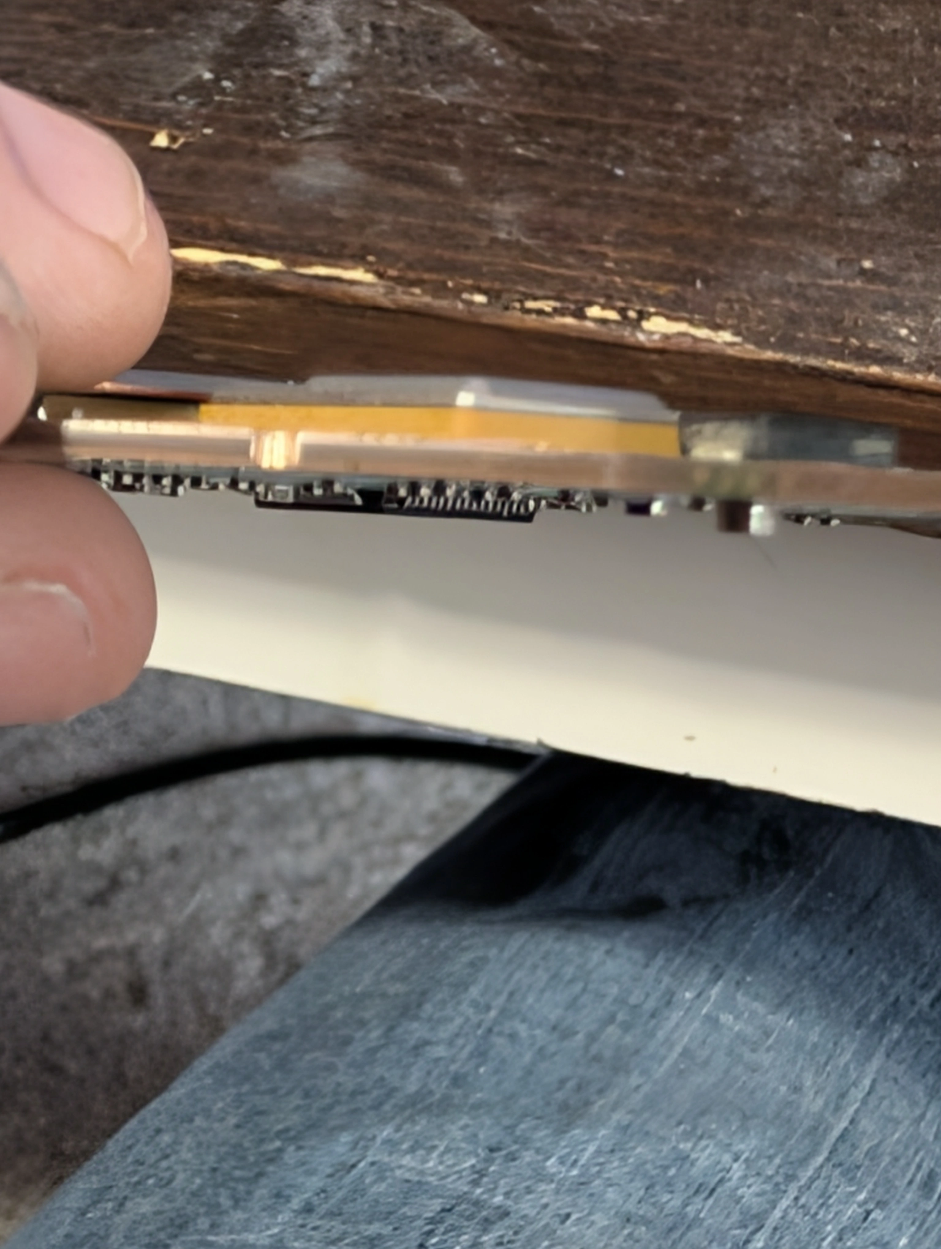

I went and bought a diamond wheel for my dremel I've never used and starting cutting.

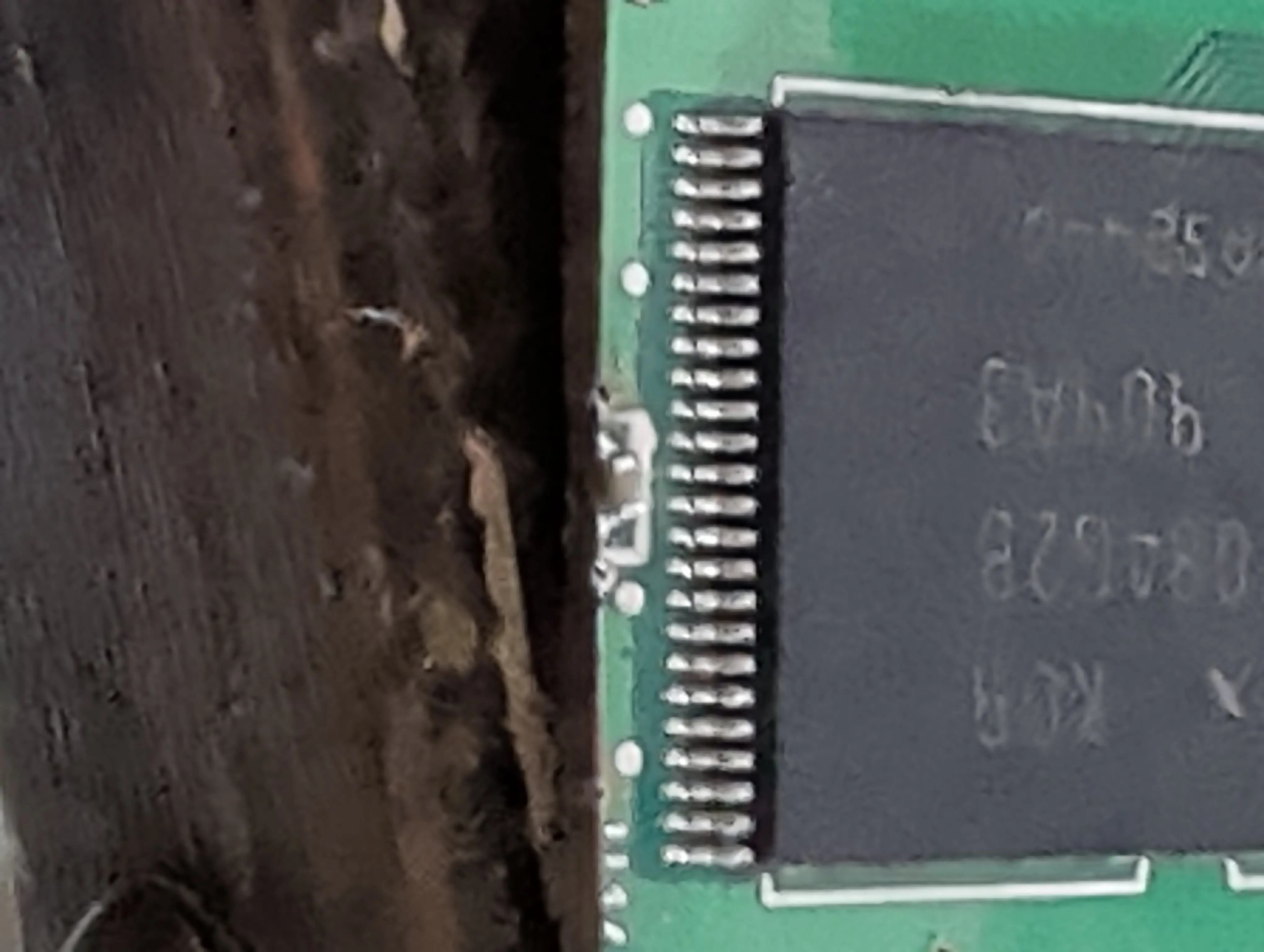

I ended up cutting inside the outline in some parts and nearly destroyed the cap by the NAND.
I removed the cap while sanding and restarted it afterwards. I sanded from 120 to 320 to 600 to 800.
I checked all my resistances per the guide and they all more or less matched up. Not the straightest cuts.

Losing the second NAND cap isn't ideal and can cause boot/loading faults, but it is relatively simple to resolve if it becomes a problem
I didn't lose it luckily. Removed it while I sanded but it's at edge of a Cliff after I repopulated.

Looks like you've sanded partway through the 3.3v and GND supply vias there. If you have boot troubles, you can run a 3.3v and a GND wire to the cap directly to restore function to that side of the chip

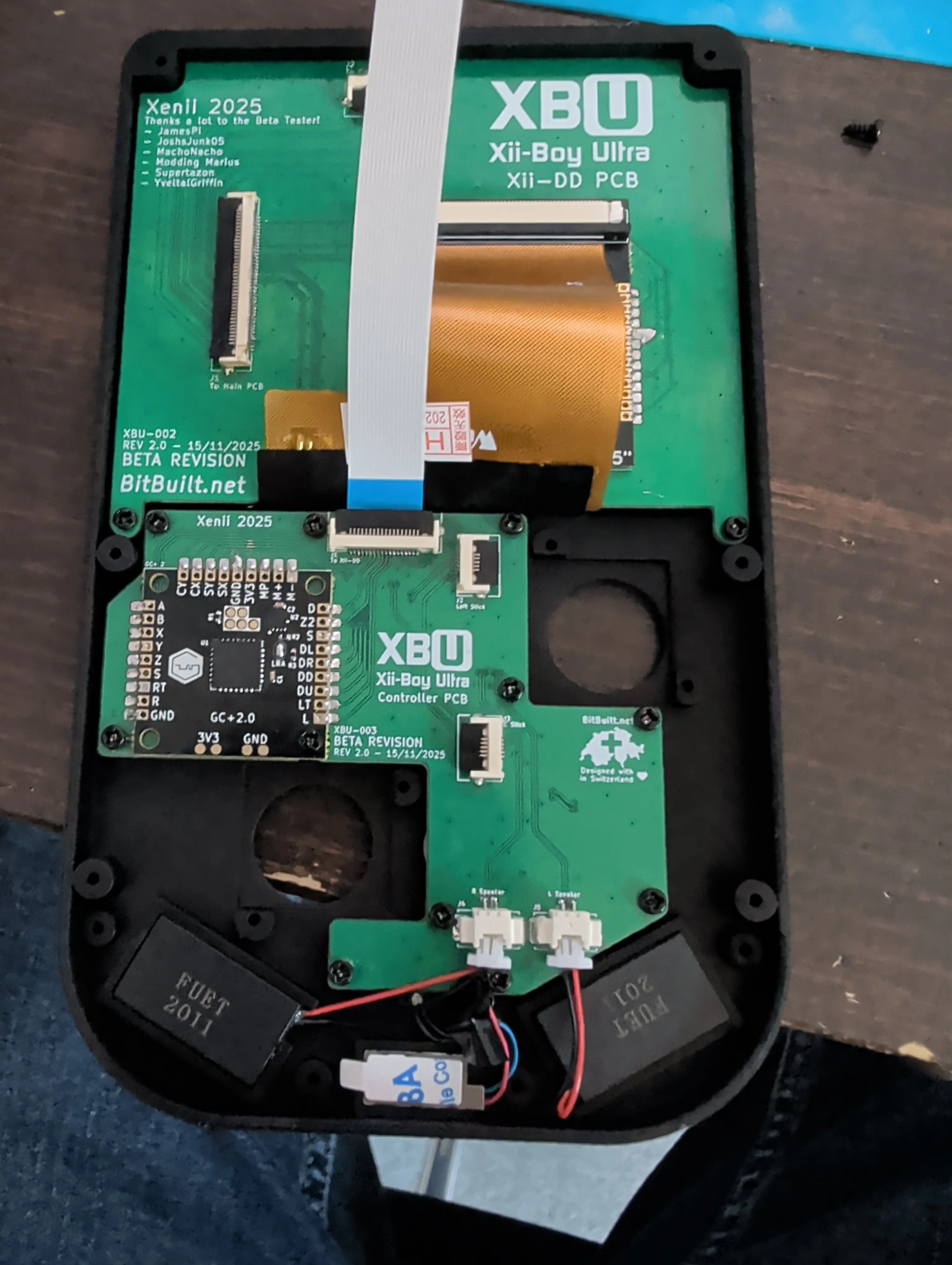

Been a bit and been working on this last few days.

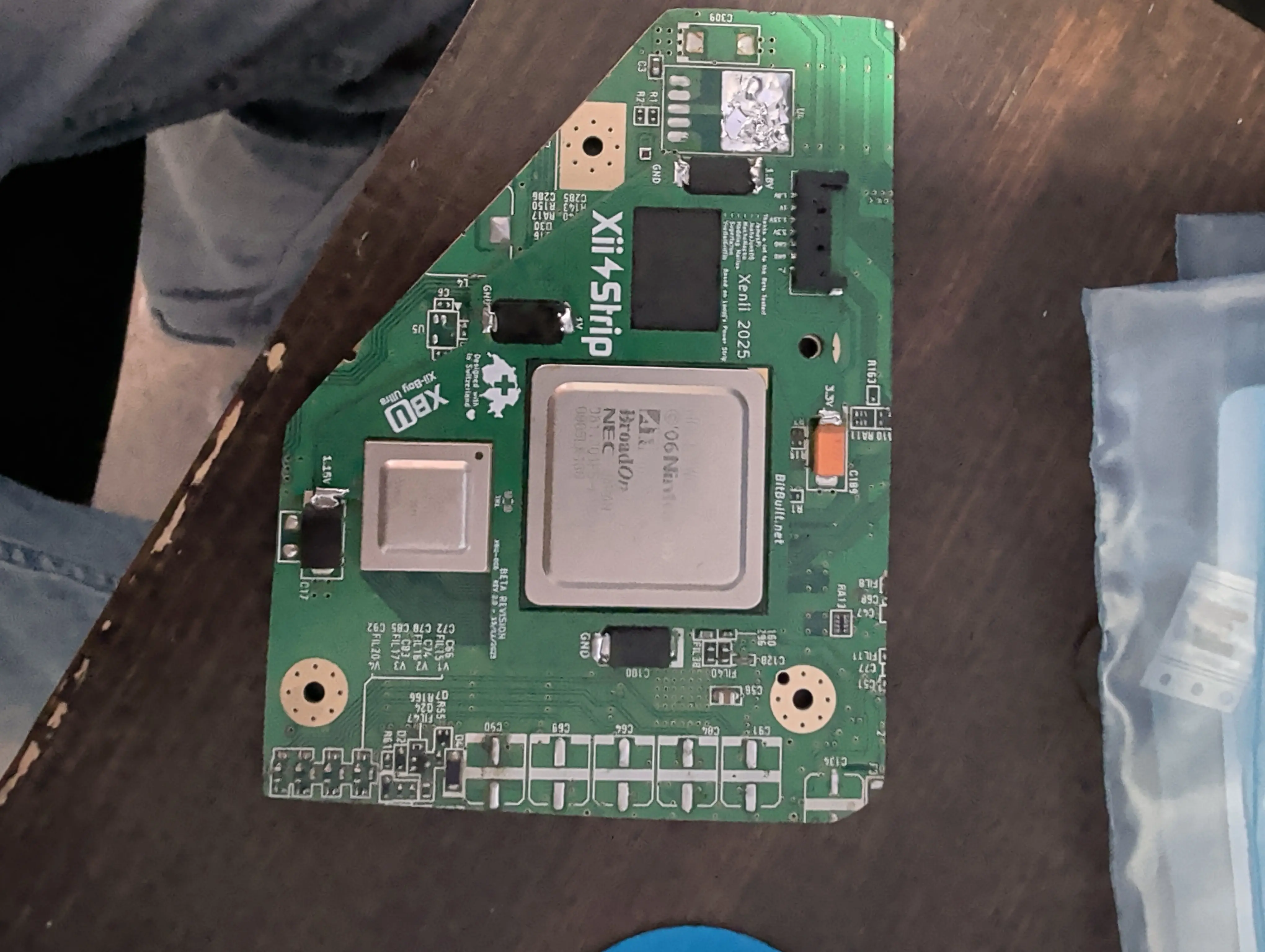

Xii Strip was more difficult than I imagined. I couldn't get enough solder to connect between pad and the voltage thingies. Ended up removing it and building up the solder and then moving it over and then I used my chisel tip I never use and suddenly things were working good. No shorts.

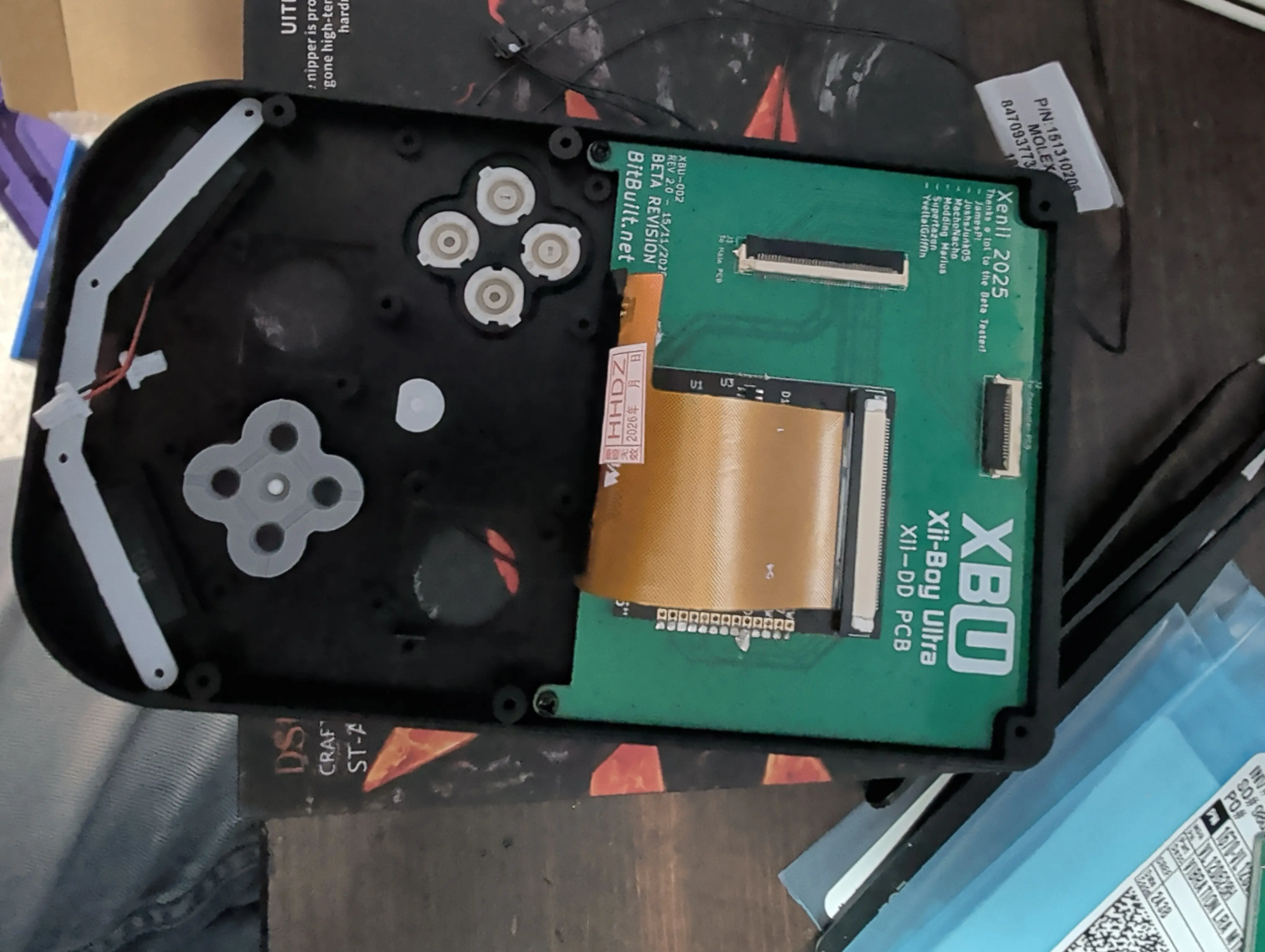

Then I got the DD board soldered together and tested for shorts. I bridged the hell out of everything to start and had to remove everything, carefully wick the connectors. I placed on board, hot aired the connectors from bottom and then checked pin by pin to ensure they were soldered solidly.
The rvl-dd seemed to be easy but shorted ground and 54 somehow and had to wick and hot air to remove. Noticing others they appeared to solder the top and allow it flow down the hole instead of on side like I did. Maybe I'm wrong but no shorts on here finally.

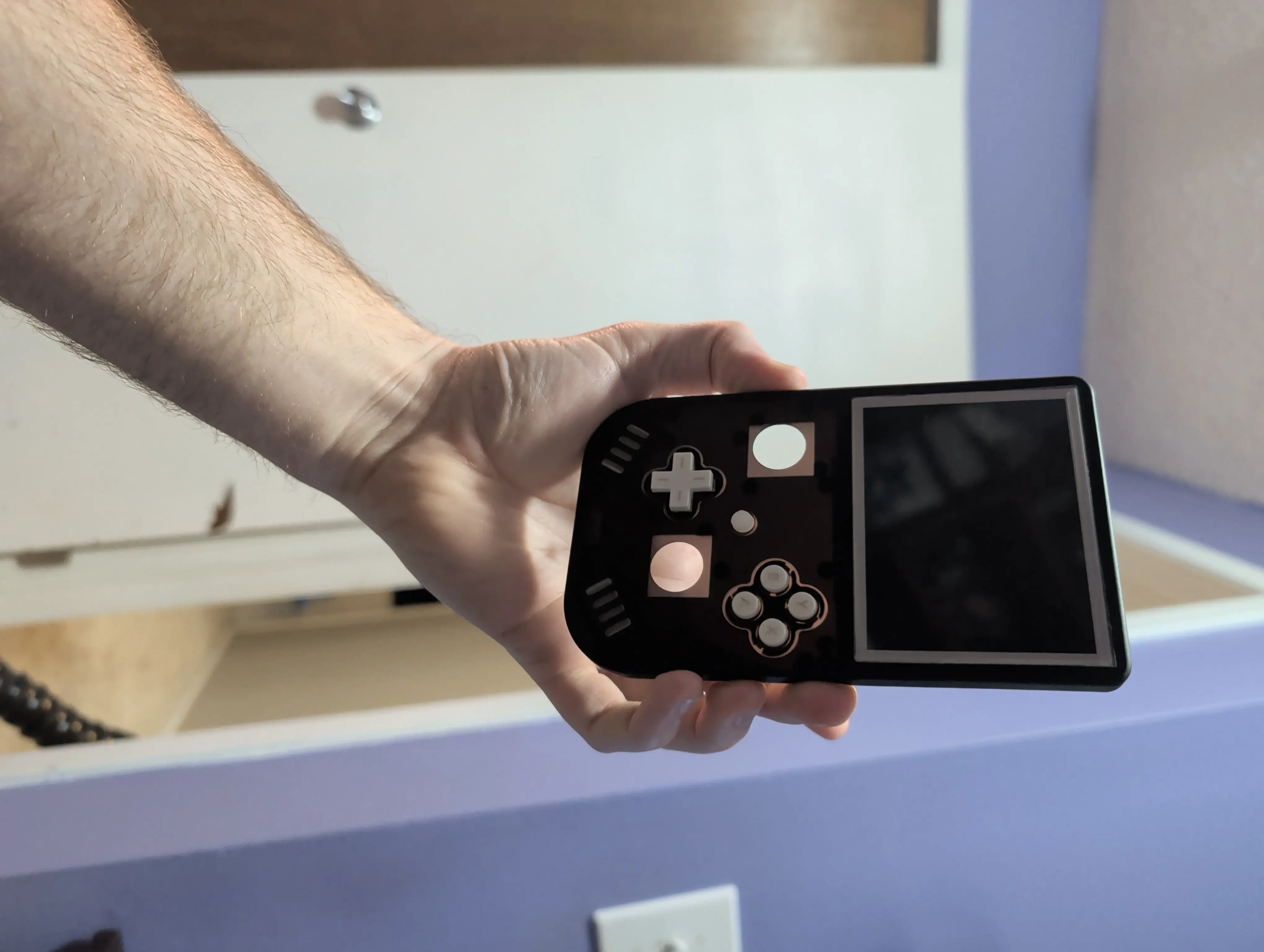

I put the screen(they were out of black outlines) in the front shell, wire mesh, speakers and buttons all in place.
I need to wire up the rumble motor with the appropriate connector and then I can strap down those bottom items.

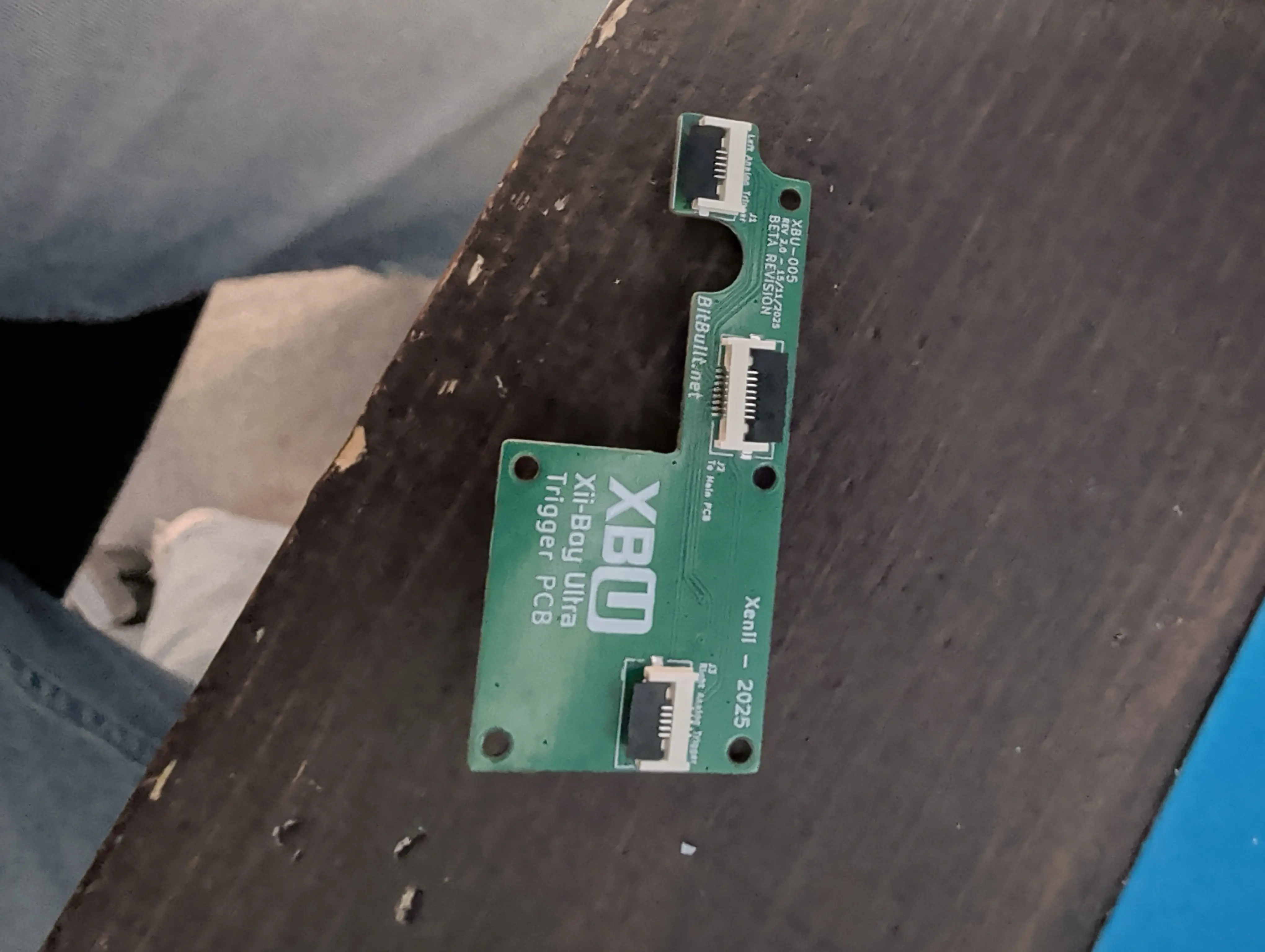

I soldered up the trigger board super quick. No issues there.
But I somehow missed ordering a bunch of items including on main board and the controller board so had to put in another order or two. Which is fine because I want to build at least two of these.
Progressing!

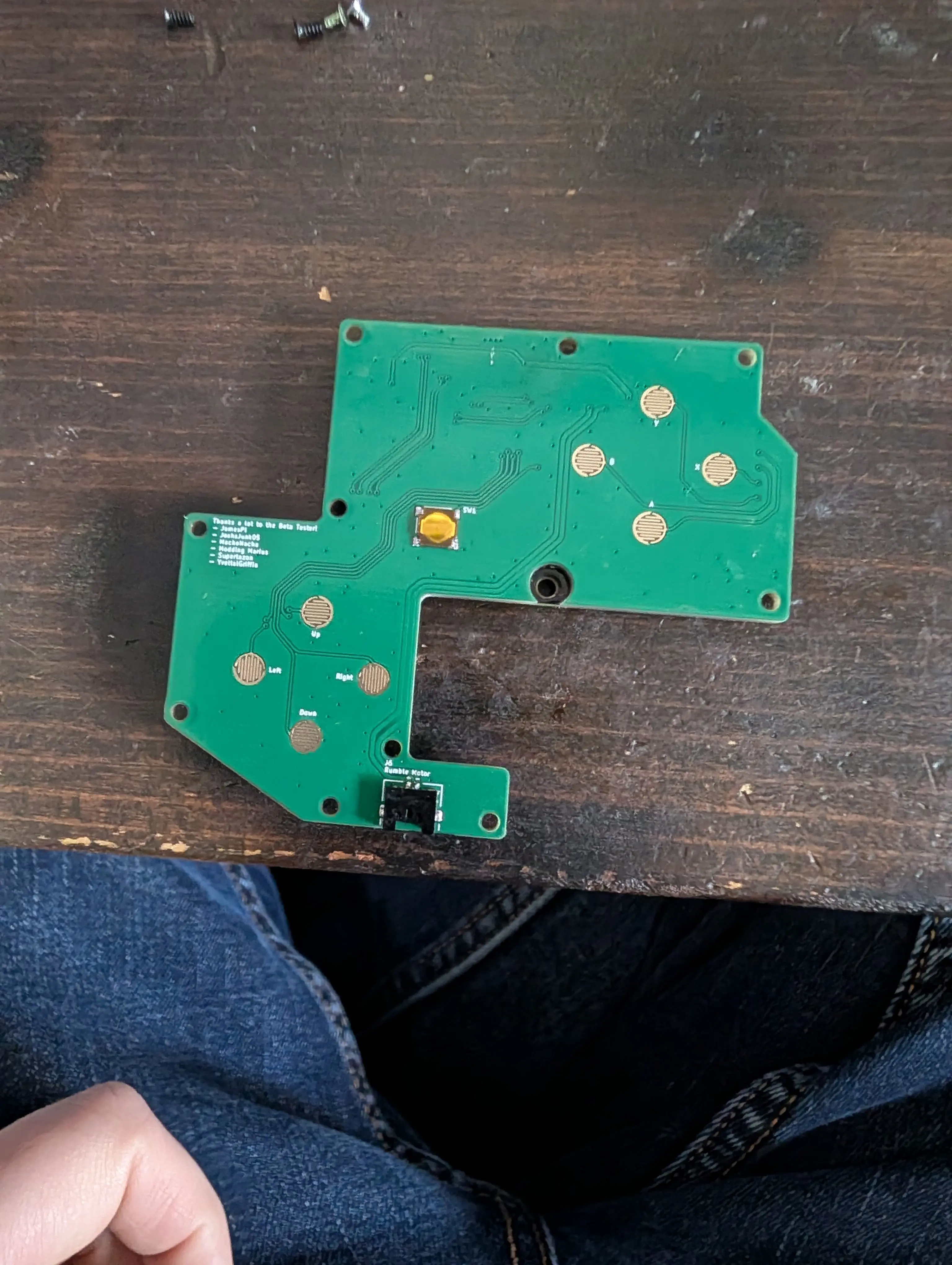

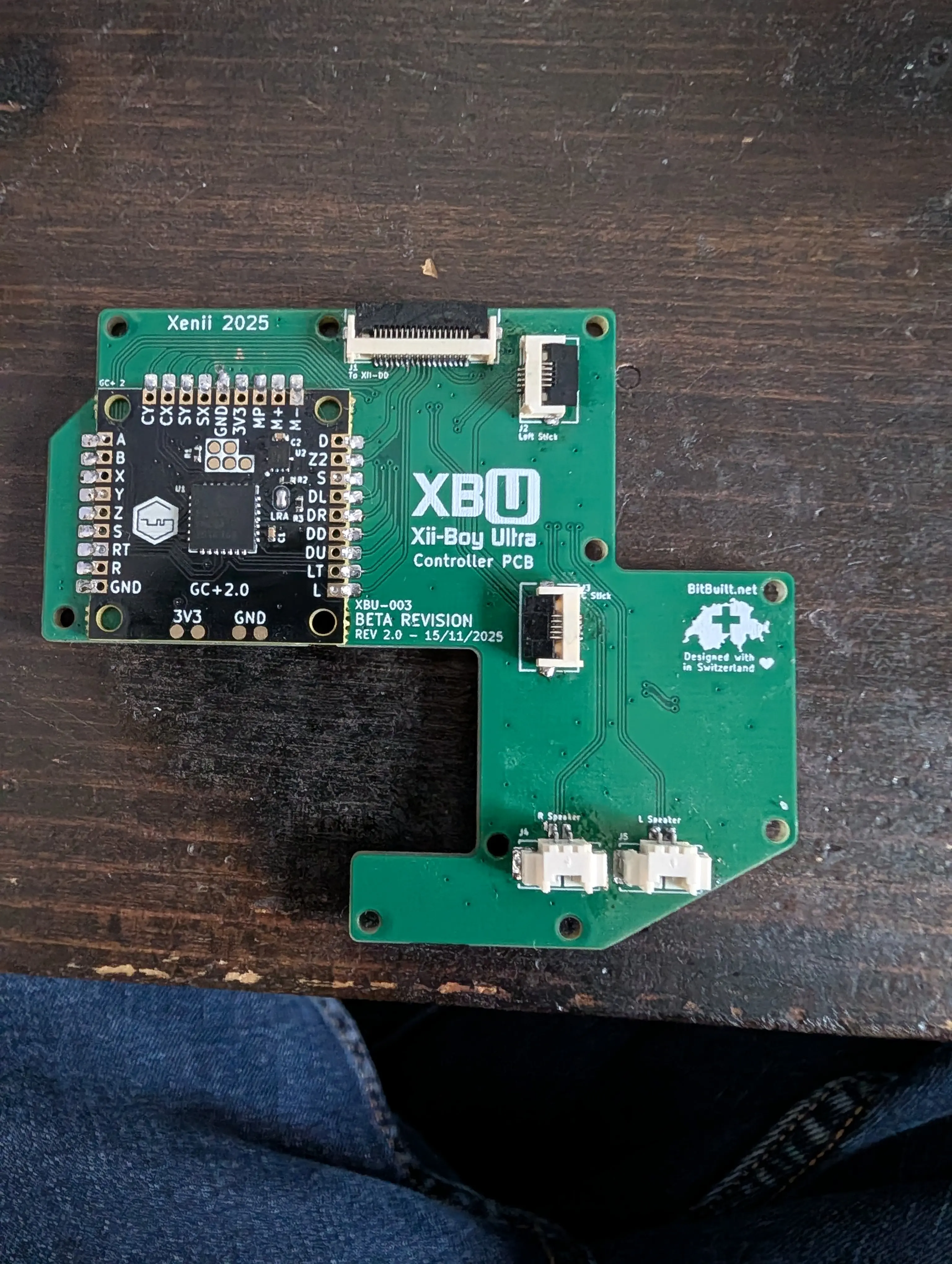

I got my digikey order in with the parts I missed and I finished soldering up the controller PCB.
I thought I had some shorts but didn't verify via the PCB design but wasted several hours on expected behavior connectivity. Lesson learned.
I scrapped the board and will have to order some solder mask to fix it but other than that, another one done.

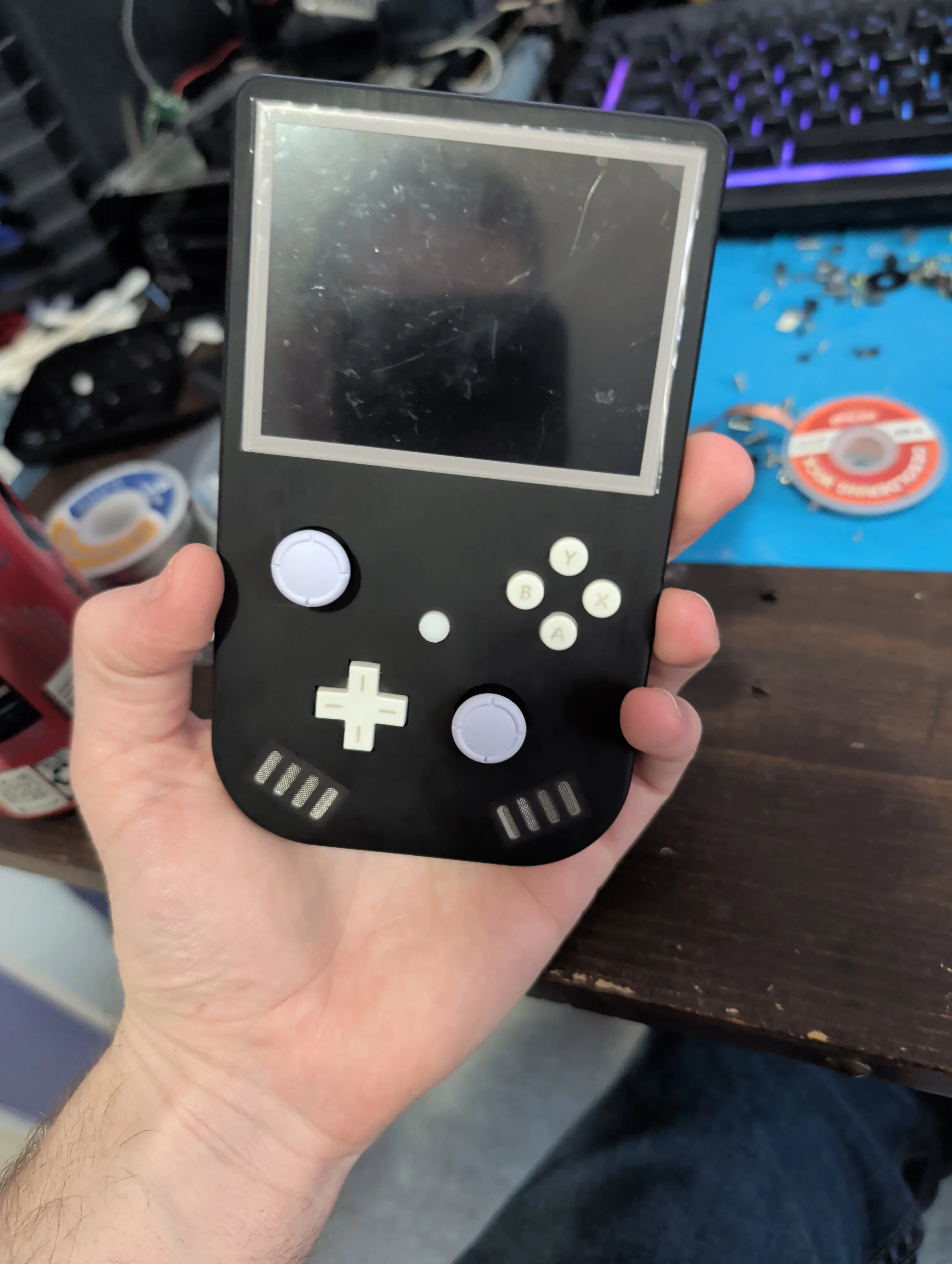

I got the front half done, though it came with some frustration. The 4mm screws on the first shell stripped out because I was inserting them too fast. Most of them didn’t bite properly, and I kept turning, which didn’t help.
I spoke with Xenni, and he’s going to start recommending 1.2mm board size instead of 1.6mm for the controller board going forward.
I'm dreaming of threaded inserts, but overall the second backup shell I ordered worked much better as I carefully screwed in. Everything seated fine except for one of the joystick holes, which did strip. I’m hoping there’s enough support behind it to keep it from pushing through.
The good news is that everything transfers over to a new shell pretty easily, so reworking things isn’t too painful down the road. I may try a different material next time—this one is Imagine Black. Red Herring on Discord also suggested using a bit of grease on the screws, which supposedly helps a lot, so I’ve ordered some to try.

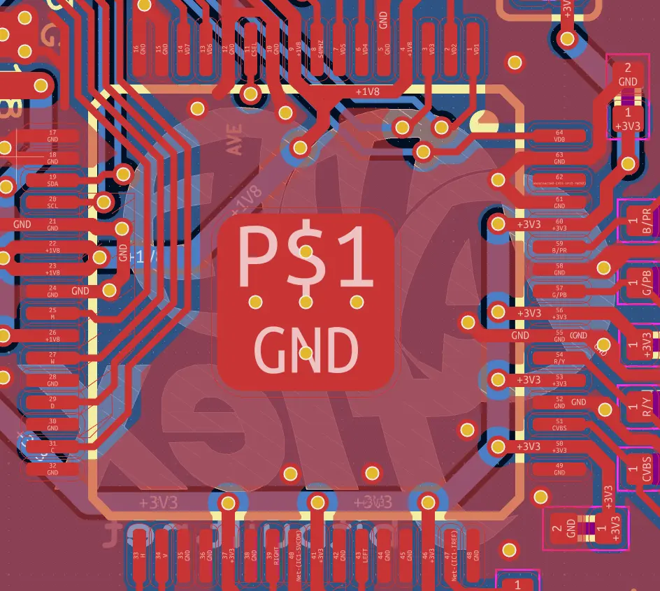

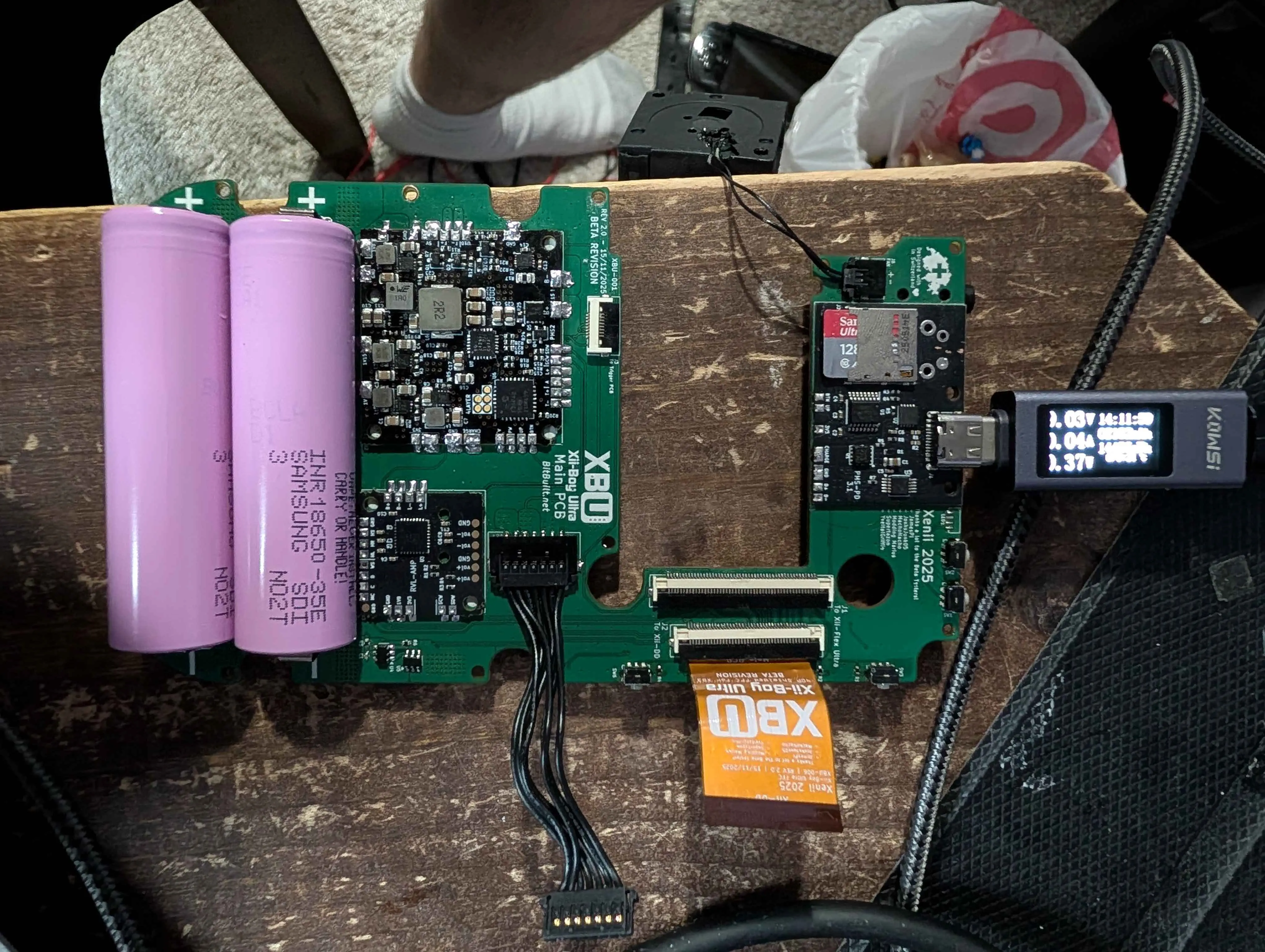

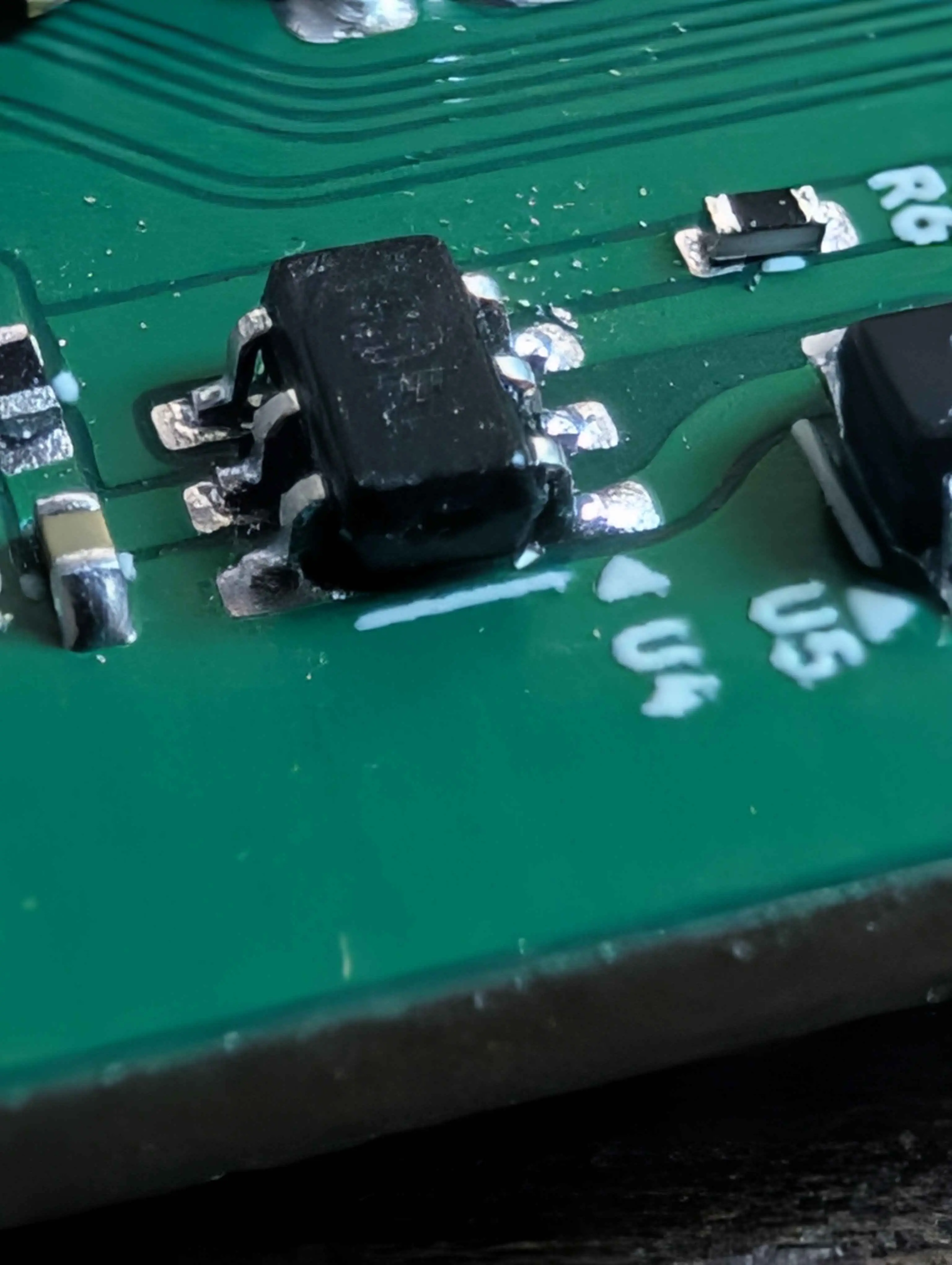

I got the main board put together but I was having issues with powering on. It would drop to 1.2v on B+ and B- on the BMS. I tried replacing U4 and U5 but no change. It would power on with USB-C and get fan spin but not with batteries and it would charge extremely slow.
After showing some pictures - we identified inefficient solder on U4, U5, the resistors around it also seemed sparse so I got them filled out considerably. I think R6 was the primary cause of this. So I put everything together and got strange screen but it was progress.

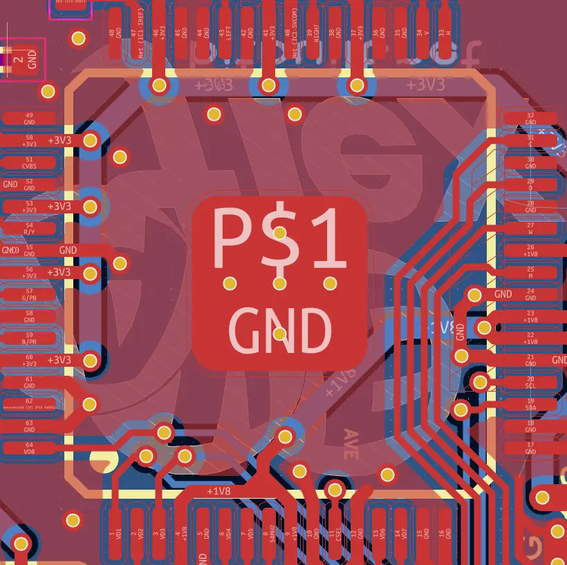

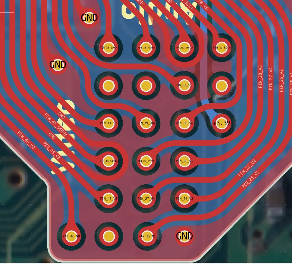

I assumed right away I likely have some connections on the Xii Ultra Flex that aren't making it but I couldn't find any resources for the Xii Ultra pin out to where it went on the AVE. So I edited the PCB files and referred to a pin out that Yveltal had linked with their AVE Flex.
I built my own table to reference based on the above images to then go pin by pin to check for continuity. Wifi and GPI01 were clear enough I didn't really have get super detailed on them as they more or less went sequentially but maybe somebody else can provide more details for me to edit the table.
With these I was able to easily test from the AVE to the end of the flex which connections weren't working and it turned out to be 3 of them.

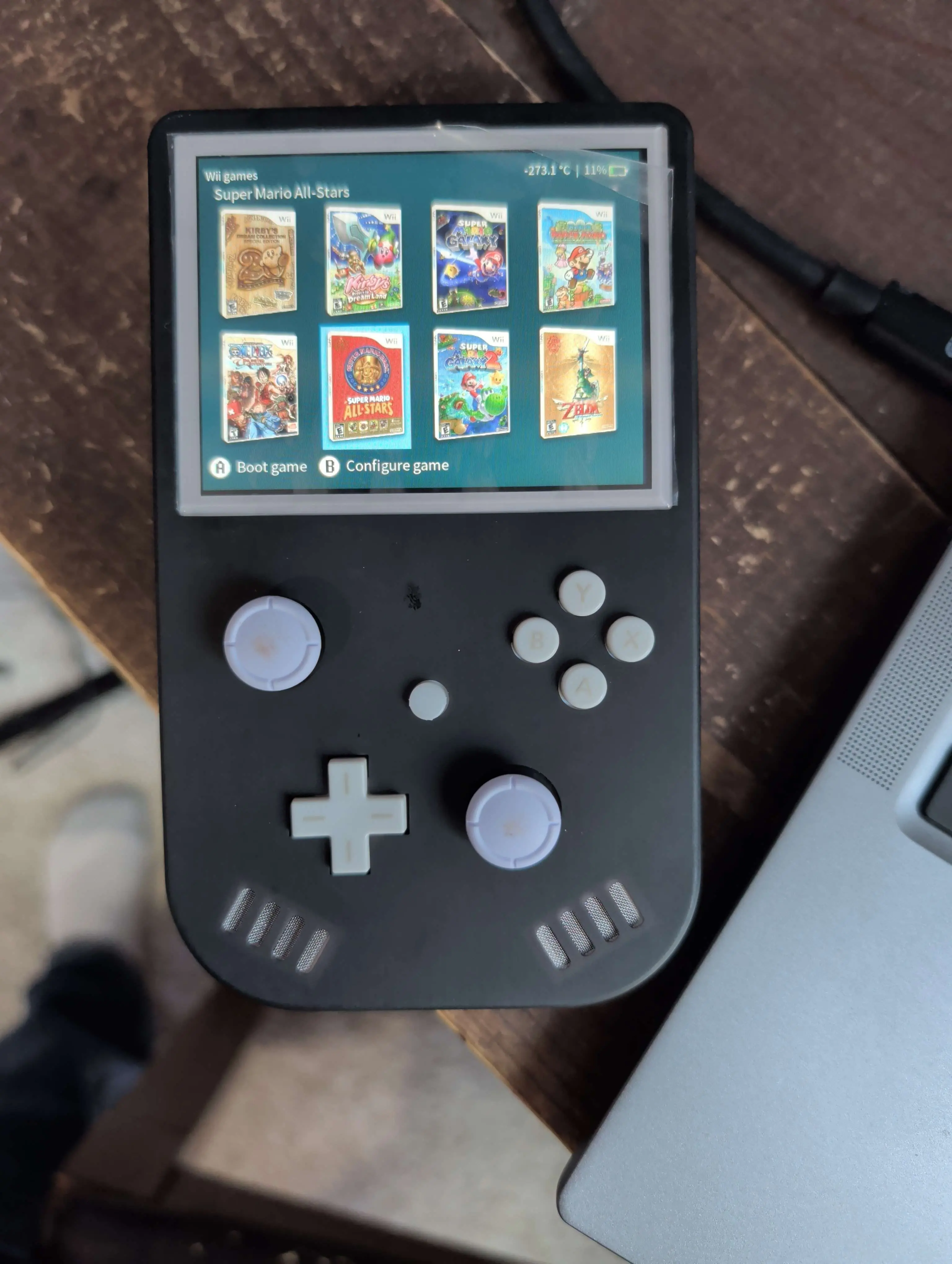

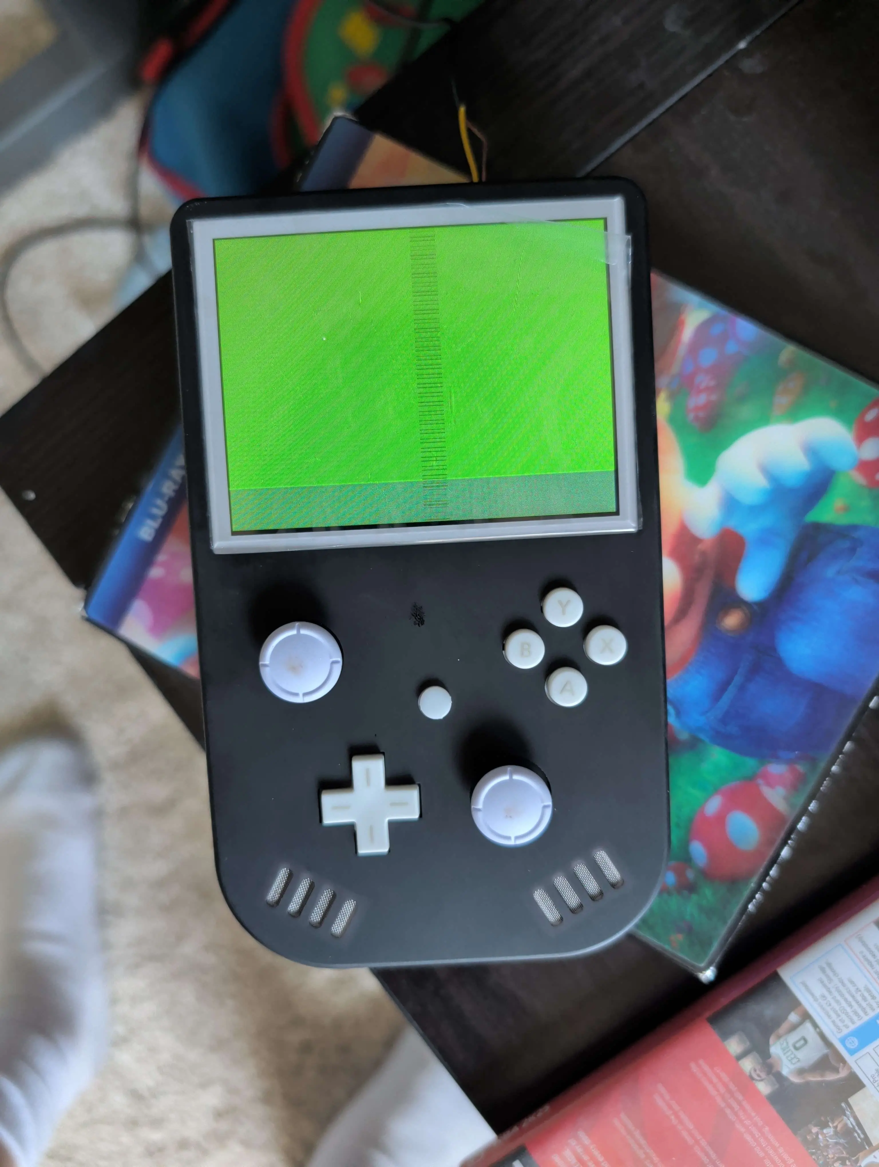

Once it was all soldered up and verified with continuity. We are up and running minus waiting on LEDs and thermistor. The buttons for some reason weren't working either so I just added additional solder to the GC 2.0 as it wasn't as thick as I'd like.
Now everything appears to work other then my left stick where the screw holes are stripped out and that stick is inverted. I need to epoxy the shell to be able to hopefully have enough material to screw into and then run the calibration but we're almost there!
