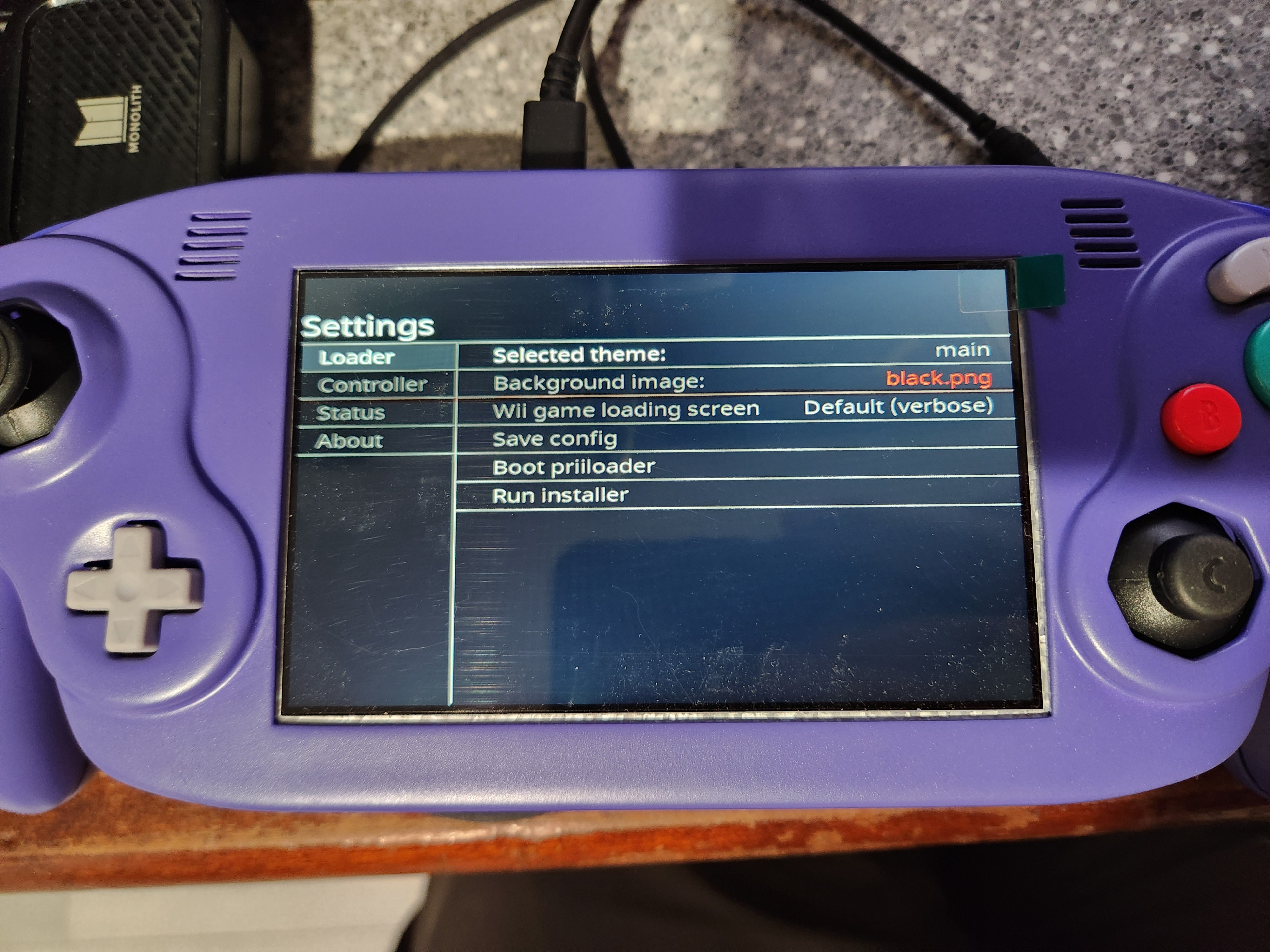

Im so sorry for taking so long to get back to this, I've been busy these last 2 months with school nearing its end, but I tried this and it worked! The controllers had some problems but it turned out I just pinched a wire and it broke so that was an easy fix. Now it's all working. Now on to software! The power settings aren't showing up. Idk if the pms lite just doesn't have them or what but I was trying to update the firmware and couldn't.
Check SDW and SCW. If they're not connected (or maybe the connection broke loose) then the menu would go away.
So that worked and the setting shows up but now none of the controls are working. I desoldered it and the controls came back so its gotta be that
