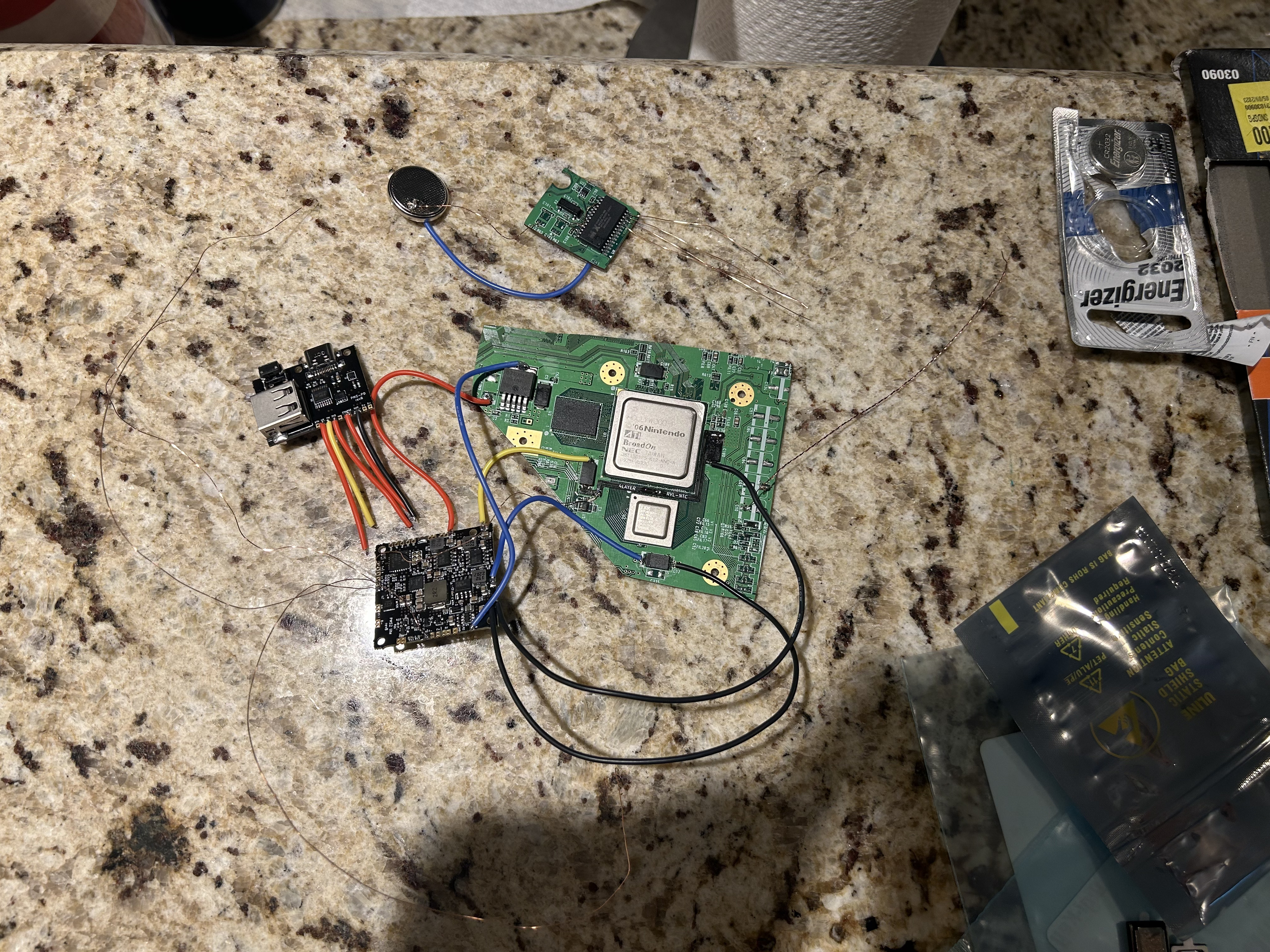

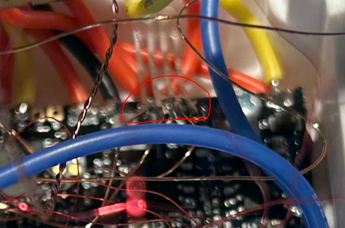

Alright, I was able to fully charge the batteries up to their 4.2V max. There are some new things I have noticed however:
  1. RVLoader refuses to boot while charging giving some weird green and purple artifacts on the screen.
  2. Booting into RVLoader is very inconsistent, however, it does consistently boot after removing and reinserting the USB (which I won't be able to do once it's screwed together).
    1. Sometimes it gives me a Lua error (code 6). Sometimes it displays the RVLoader loading screen and when this happens it always doesn't load. Sometimes it outputs "rvloader bootloader 1 loading" as text and also doesn't load. Sometimes it tells me it couldn't read the FAT FS device. My USB lines are coiled tightly and have good connections to the vias, so I think this might just be the USB itself, not a wiring issue.
  3. I did use heatsinks that I found on Amazon as the ones on Digikey were backordered at that time, so I believe that might be the source of the cooling problem. Luckily the Digikey ones have been shipped and should arrive soon. Though, I don't know whether I will be able to remove the ones that are already in the case.
Did you figure out the issue on #2? I am having the same thing happen from time to time.
On that note a little time for an update:
I have added the Bluetooth module and it works great! I did have a bit of trouble scratching the traces but I believe I have solid connections now and they haven't come off in about 4 days of playing.
Previously my speakers' wires weren't connected and now they are! At first, I thought I messed them up but I read the forums and saw that connection between the contacts and the speakers was a common problem, and it was the problem. I just bent them out a bit more and now I have them working!
