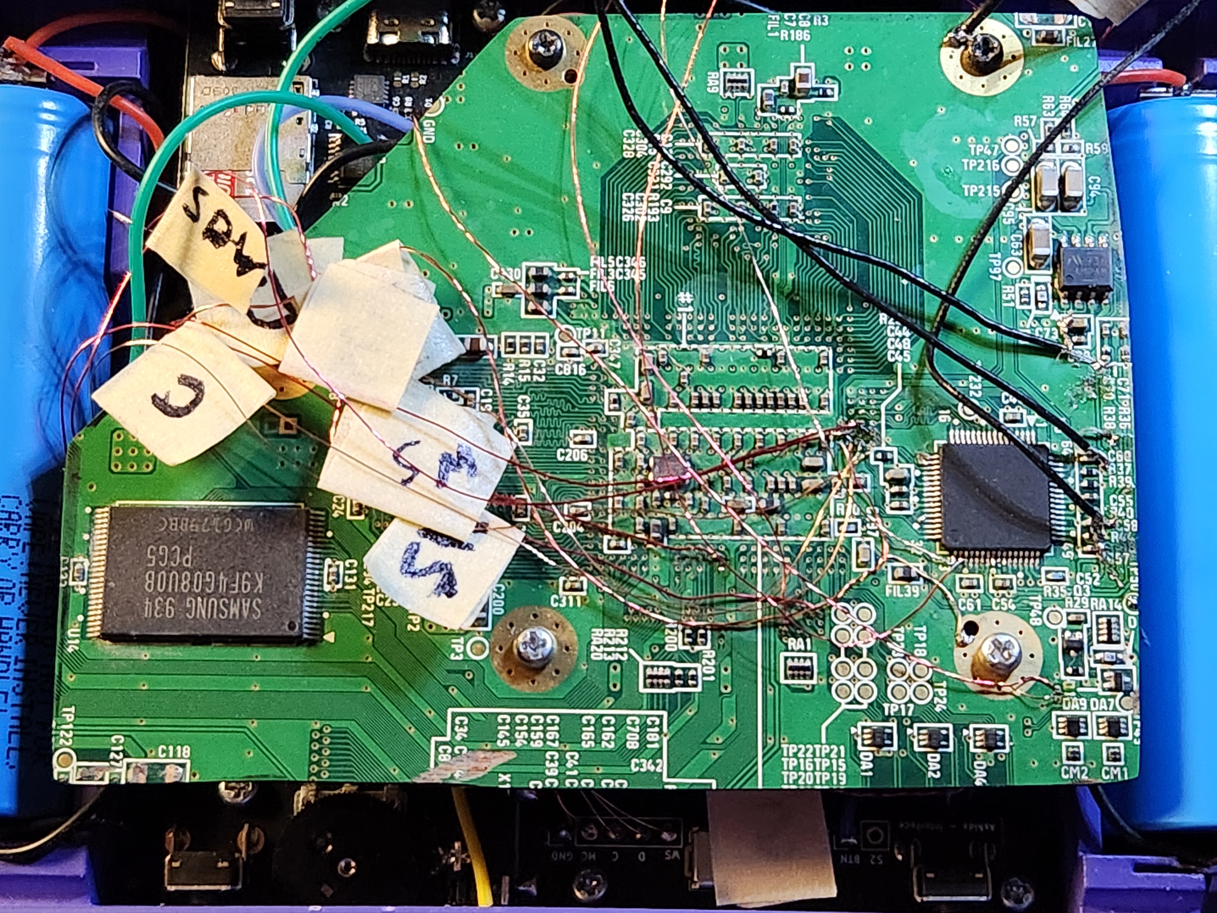

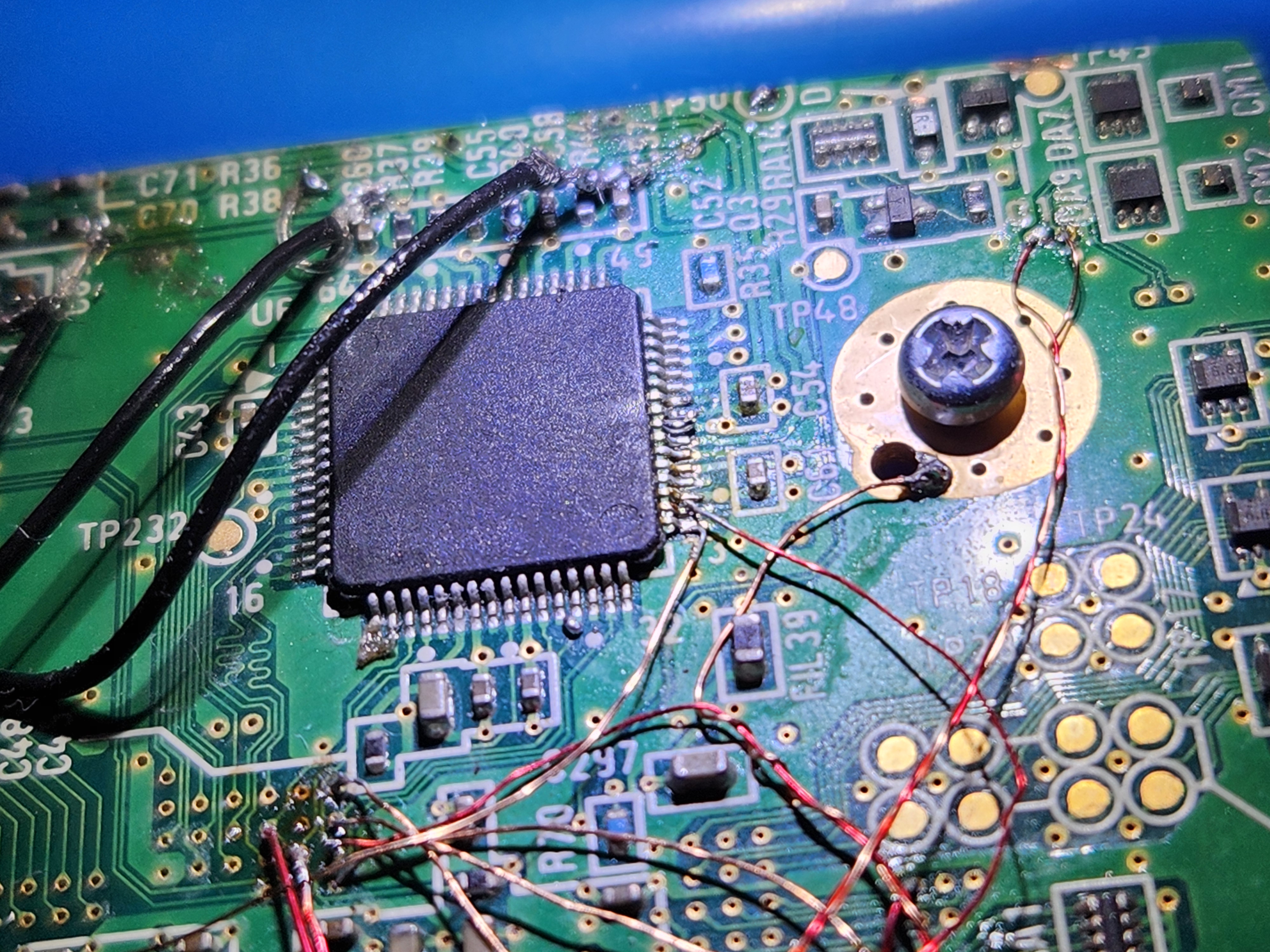

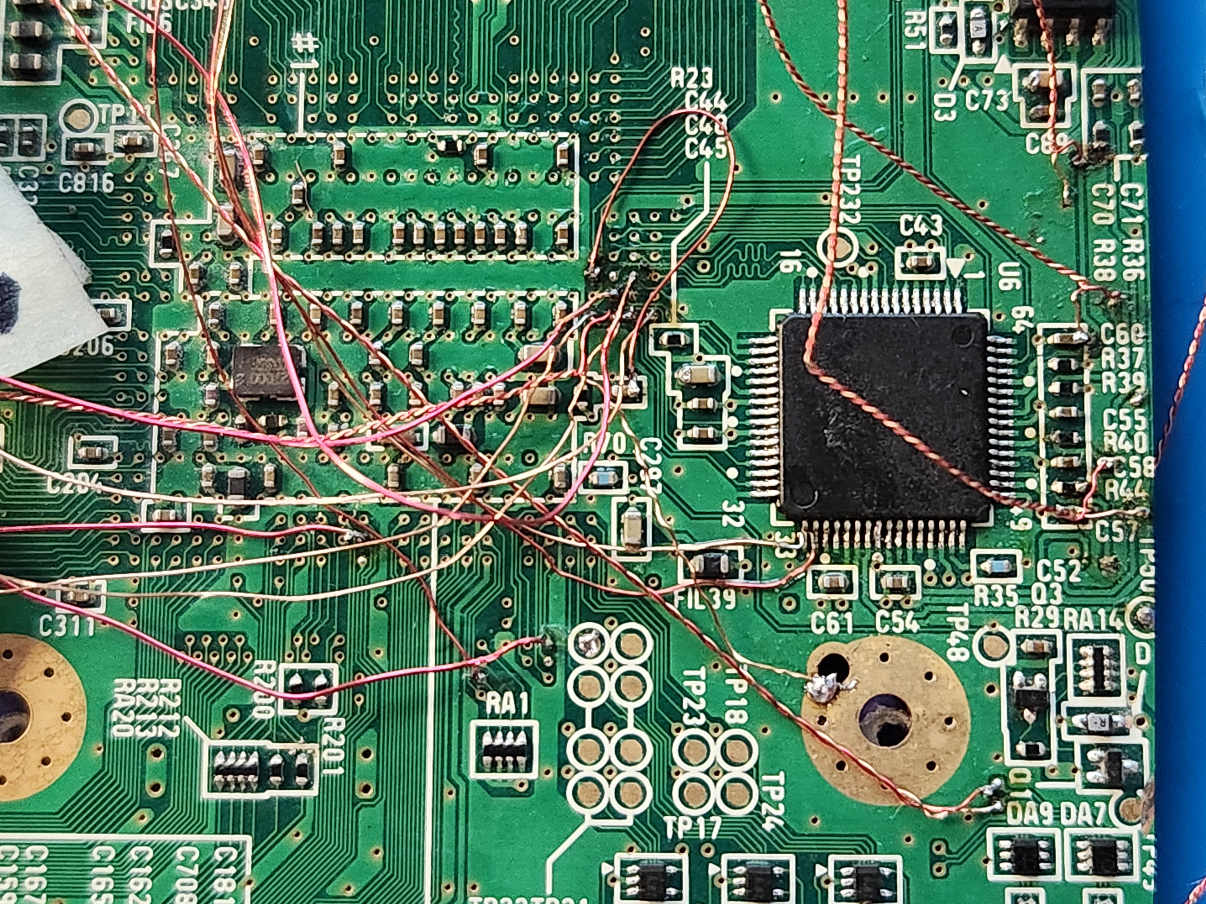

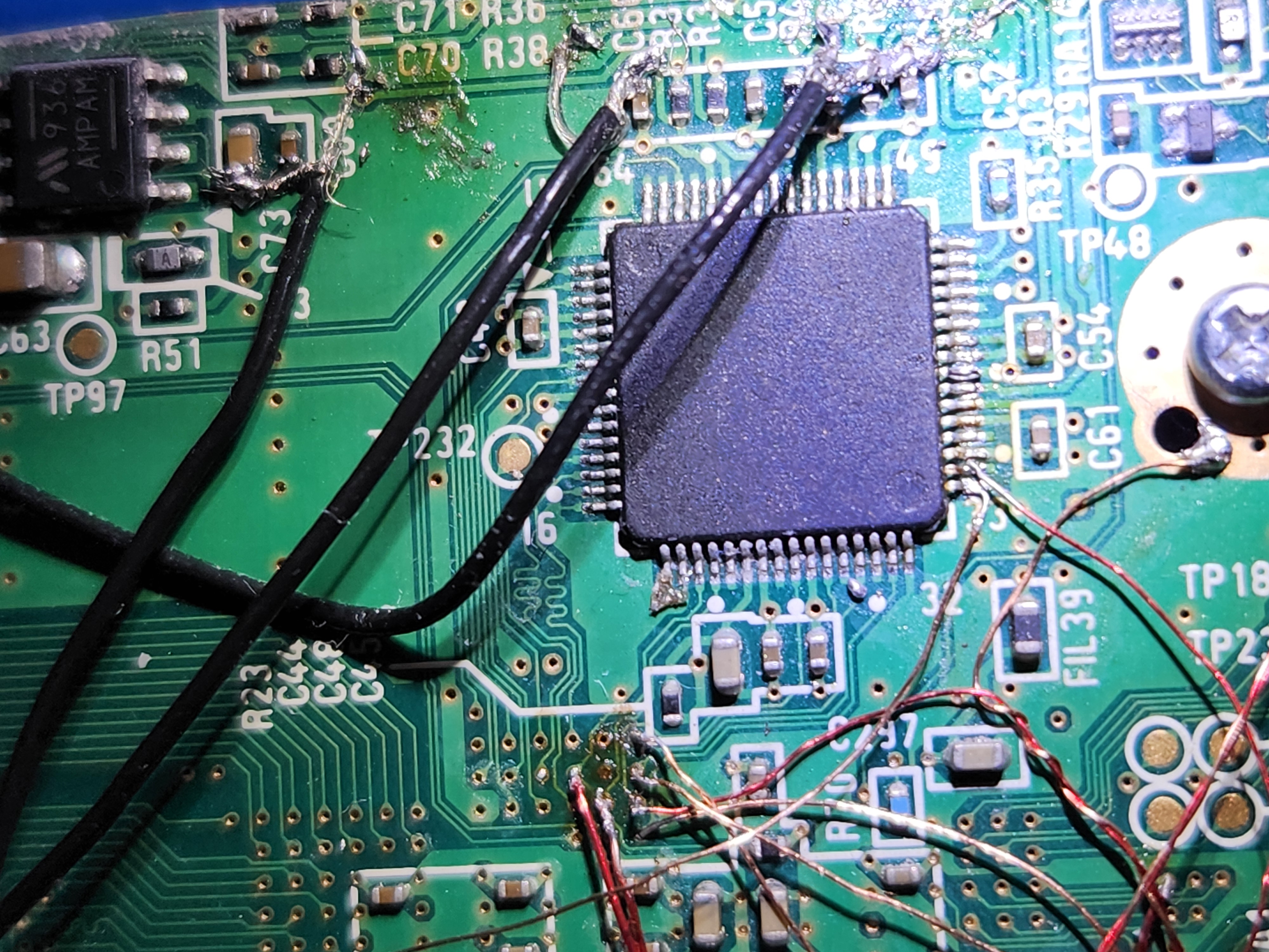

Inconsistent boots are more often than not U10 related... Are you using the real U10 chip or the PMS emulation? I used the PMS emulation for some time and it was pretty normal for me to have to boot the console 2 or 3 times until it finally booted... Turns out the wire lenght seems to be quite important for U10 boot consistency... I switched to use the real U10 chip with a "wireless" installation and now my console boots 100% of the time, guaranteed. If you're using the U10 installed next to the CPU my advice is to use the shortest wire you can get away with. There's a via next to the chip location that allows you to pass a 34awg wire through. Try that.
