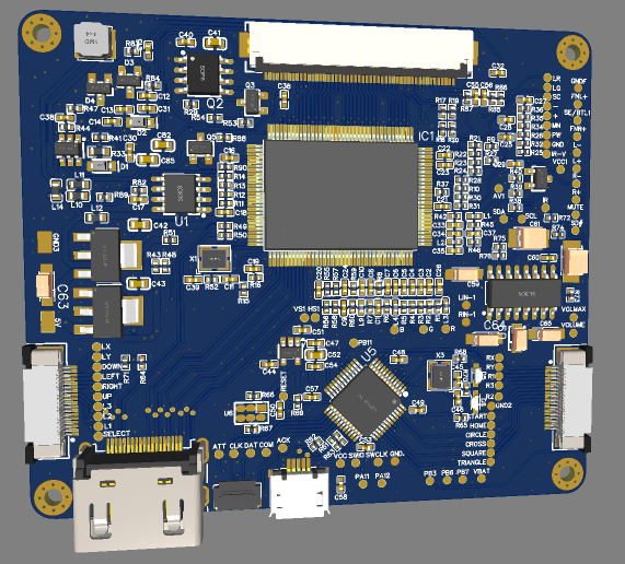

I'm using custom regulators created by @Gman, the board is powered via USB-C at 5V 3.1A, this power is managed by an IC IP2721-D, which in turn powers the Texas instruments BMS, as it is a portable PS2 , I prioritized reducing consumption and weight of the console, so I will not use engines. And I have a mod that lowers the EE consumption and consequently the EE temperature.

The work he did is incredible! I was 100% surprised! Reverse engineering and all that work! Now my doubt will it use 7.3v on the entire board? I have seen colleagues who ran the system at 5v and they work quite well! so study only the audio dac and joystick use 7.3v; The vibrating motors use 5v although the joysticks reach 7v, the processor sends 5v to a resistor and this lowers its voltage by 40%, reaching the motor with a minimum of 0.60v and a maximum of 3.08v. Vibration! and the negative or mass is the variable!, the positive goes direct! And my last question, will the plates or files be sold? I really want to transplant everything to your creation! since I have several 90k to try! Right now I'm putting one together but cut down! and it's a bit difficult for me without a microscope!
Estoy usando reguladores personalizados creados por @Gman, la placa se alimenta vía USB-C a 5V 3.1A, esta energía es administrada por un IC IP2721-D, que a su vez alimenta el Texas Instrumentos BMS, al tratarse de una PS2 portátil, prioricé reducir el consumo y el peso de la consola, por lo que no utilizaré motores. Y tengo un mod que baja el consumo de EE y en consecuencia la temperatura de EE.

I had translated it into English but my automatic translator had translated it into Spanish! apologies! now excellent when using 5v and already done consumption tests! ? in games like god of war? And regarding the DAC audio? And in its design are there options to pull a 5v voltage line to the joystick? I'm interested in the vibration option! Is it more immersive and can the pcb design be obtained? and what is the low consumption mod?
