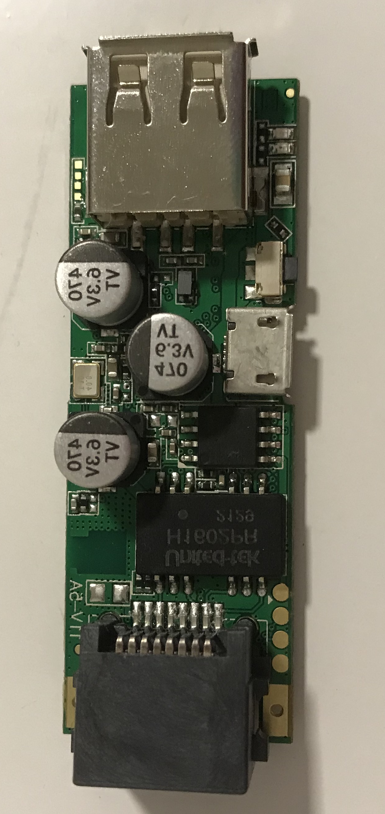

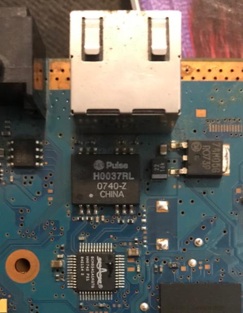

This is the transformer on one of the versions of the 7900x,
With that I don't need to use an RJ45 connector that has built-in transformer, if you open the RJ45 connectors of the console end series, you will see the transformer inside.

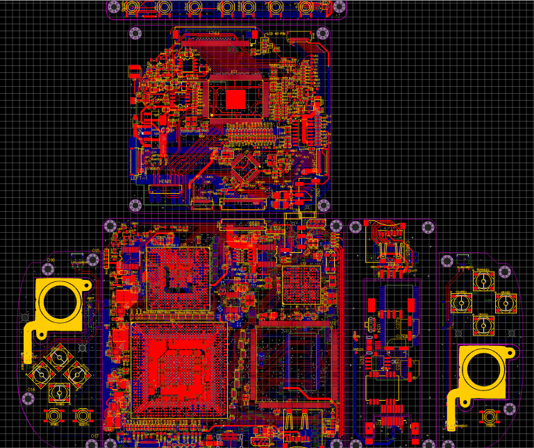

WE CAN HAVE AN OVERVIEW OF HOW THE PROJECT IS GOING, IT HAS VERY SMALL DIMENSIONS.

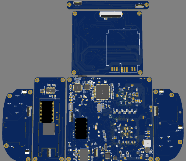

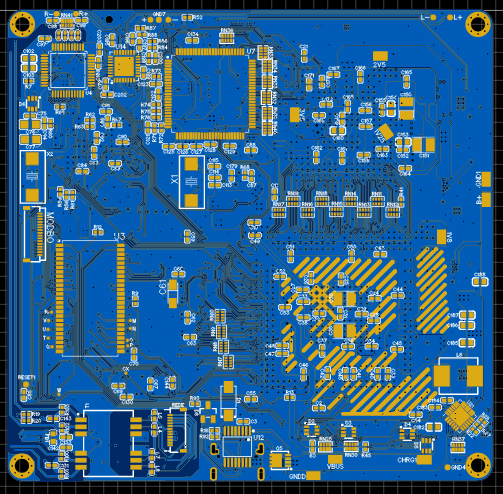

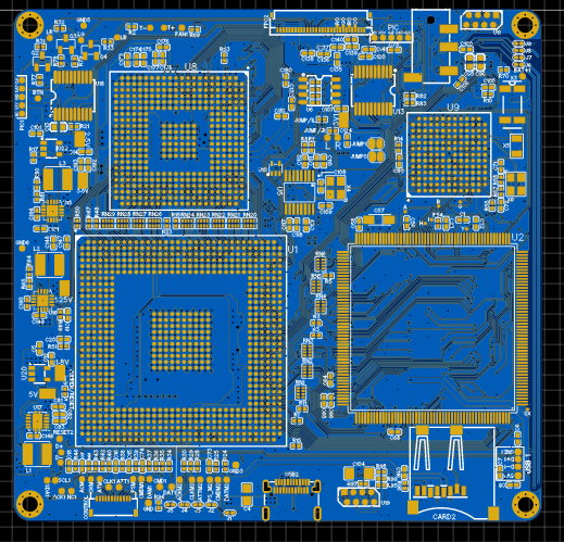

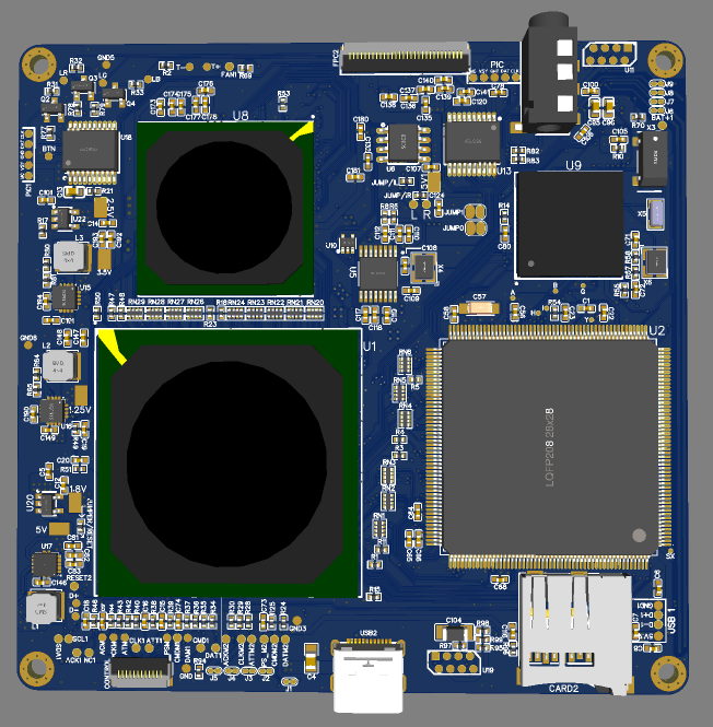

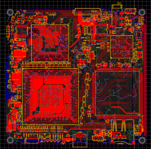

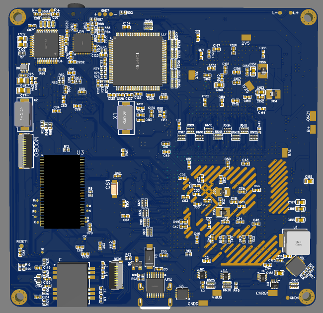

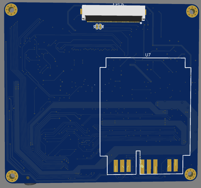

The console PCB received another update, we updated the pcb with new custom regulators, digital audio amplifier with headphone output, thanks to @Gman, but also keeping the original audio dac, a micro sd card slot for load games via memorycard with the MX4SIO mod and USB-C to load the console, several FFC connectors for flat cables connecting the main board to the secondary boards. What's new in this update is the Ethernet transformer used in other console series.

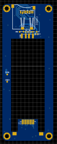

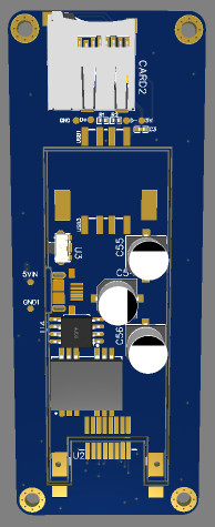

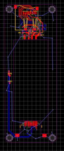

Speaking of Ethernet transformer, I chose to use the PS2 with a game server, the device I chose was a well-known mini router that proved to be an excellent device for this function, being compact and consuming little battery, I decided to use it.
The use of a memory card can be used with an sd card, for this reason it has two card slots in the image, because I can create one of the options with the MX4SIO or the mini router, I can also create with the integrated circuit of the card an internal storage like a flash drive but then I would need to transfer data via USB and that's not what I want, so I created a pcb to connect the mini router and in it the sd card slot and an FFC connector to connect the PS2.
I created a 3d model of the mini router that is not functional, just to see how it will look and help when creating the shell.

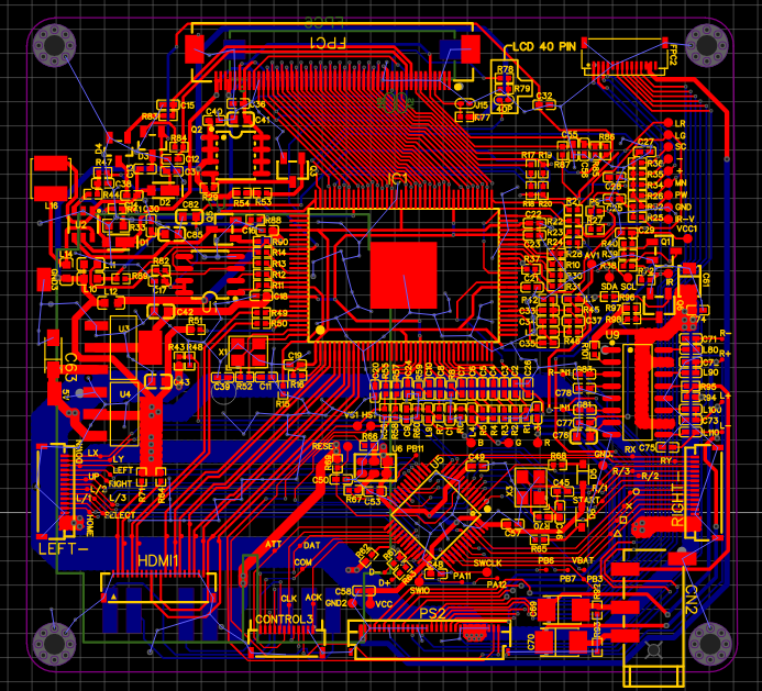

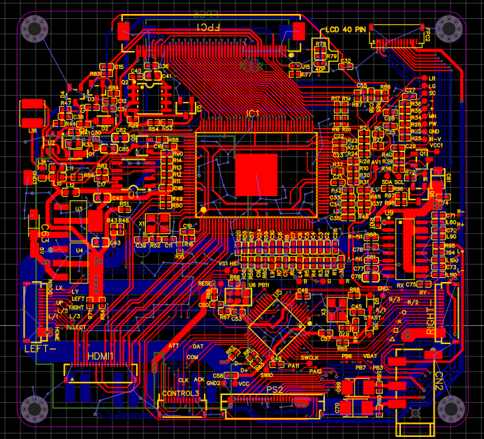

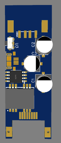

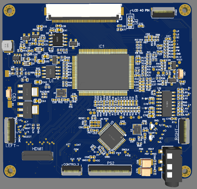

I mentioned in a past post that I had also made a screen driver, and yes the screen driver is complete. In addition to the specific function, it also brings other functions such as the analog audio amplifier for those who prefer and thus keep the original play dac, it is also for this reason that it has another headphone jack and also has a slot to solder the memorycard if he wants. In the screen driver there is an STM32 responsible for the control and gaming on the console, the idea is from a friend called Epaminondas, the guy has amazing projects and things that can be revolutionary for this scenario of portable consoles. That is, it is a pcb with the peripheral functions of the console.

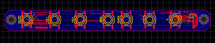

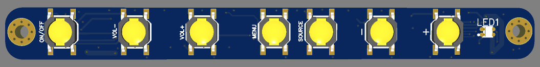

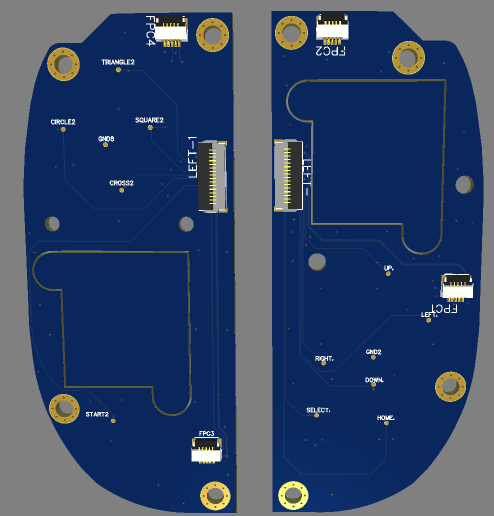

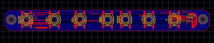

The screen commands and volume control and console power button.

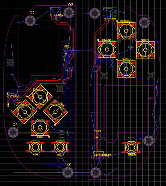

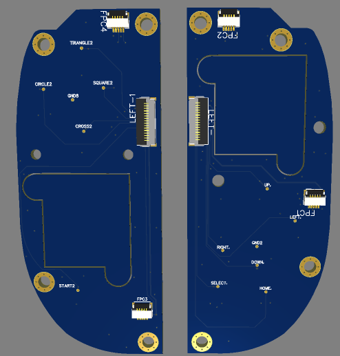

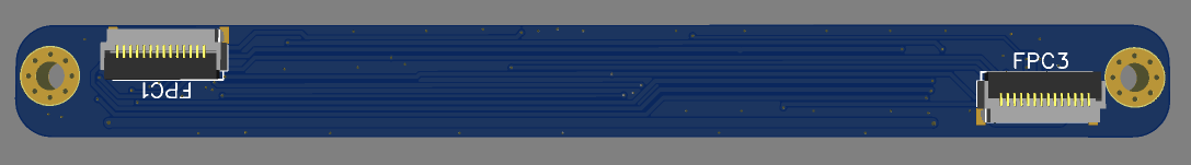

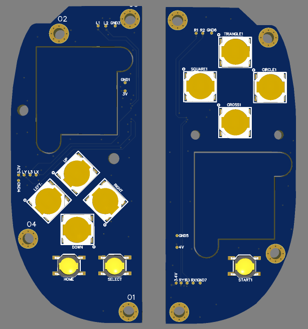

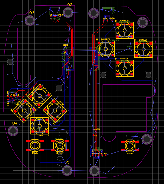

The control buttons are inspired by PSvita, using the analog of the nintendo switch.

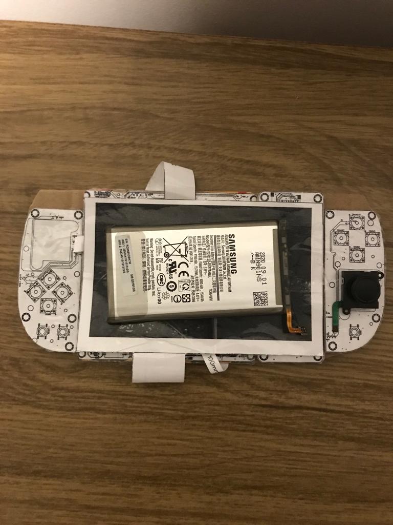

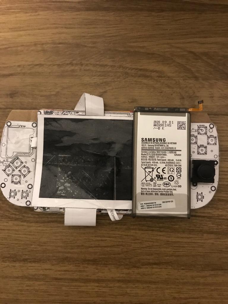

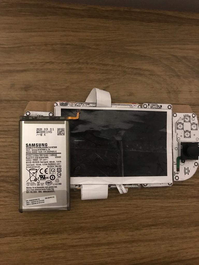

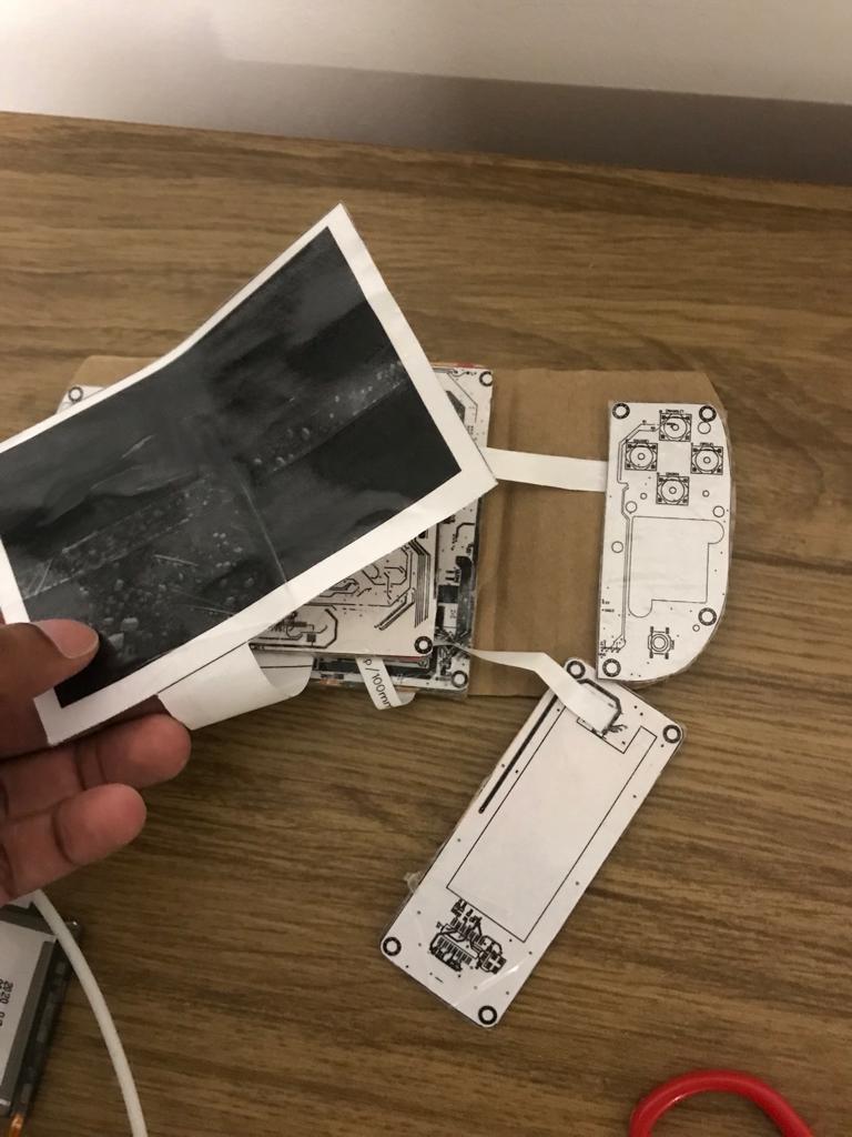

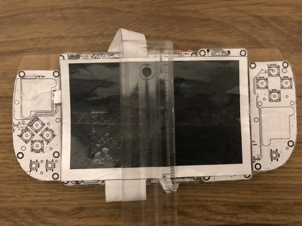

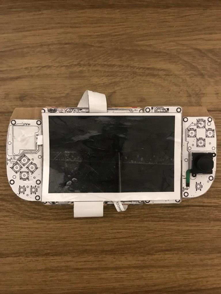

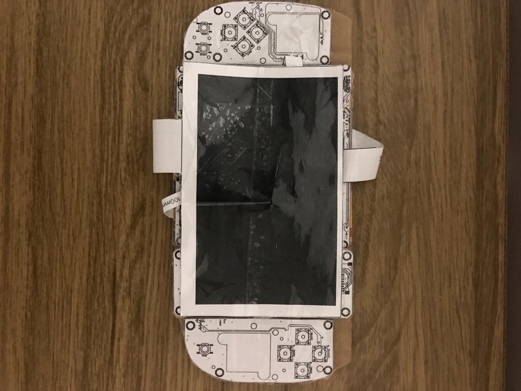

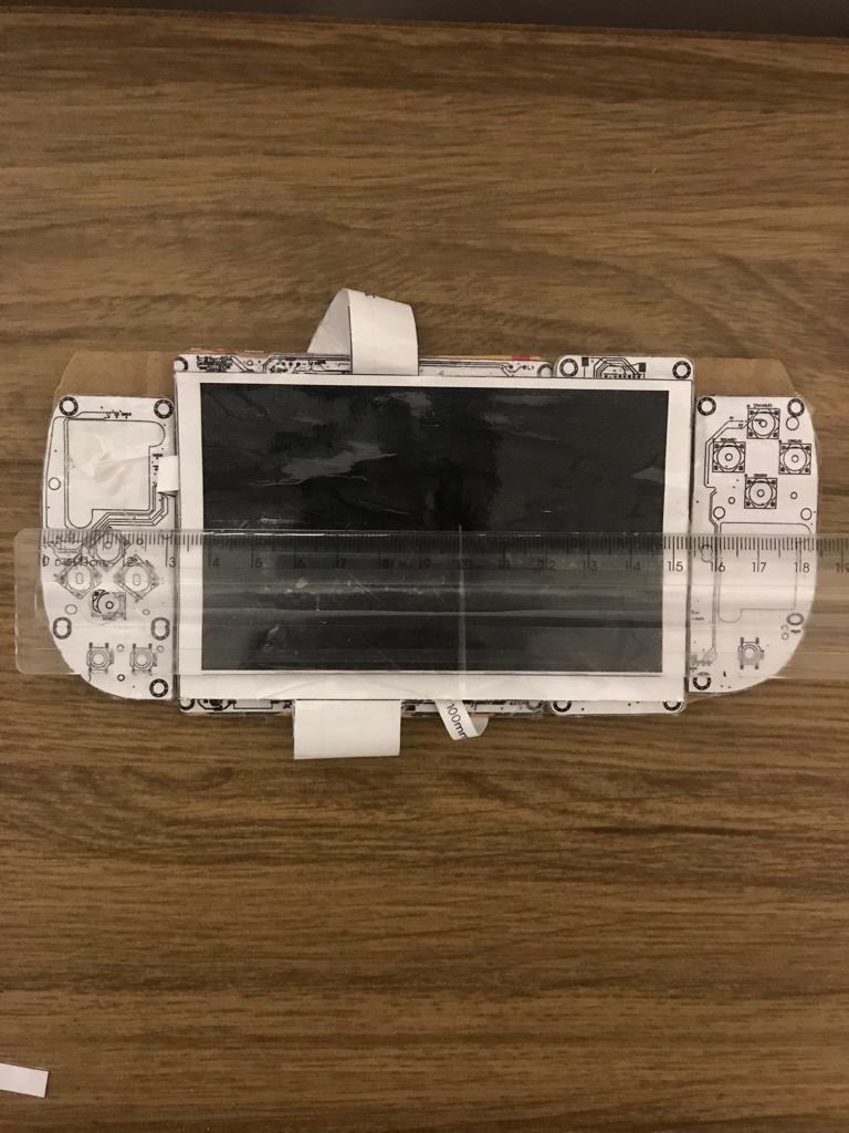

Using a 5" screen, the PCBs together will be 187mm x 87.7mm, compared to PSvita which is 182mm x 83.55mm, I'm satisfied with the dimensions, the console will be quite compact.

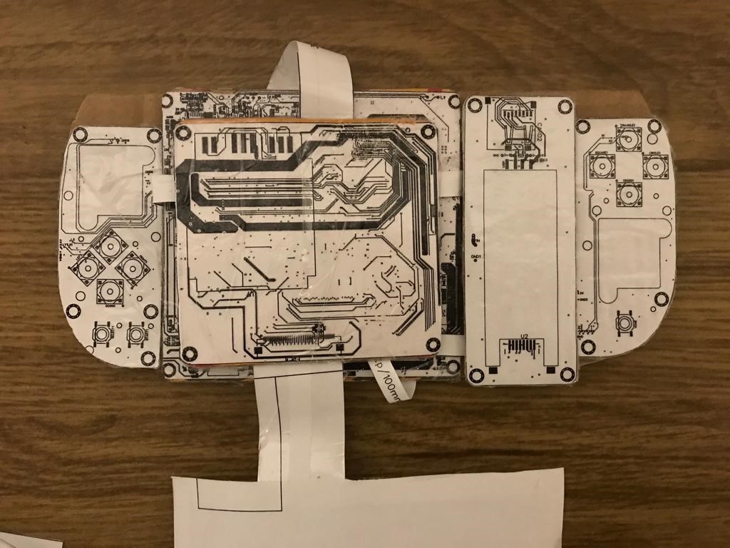

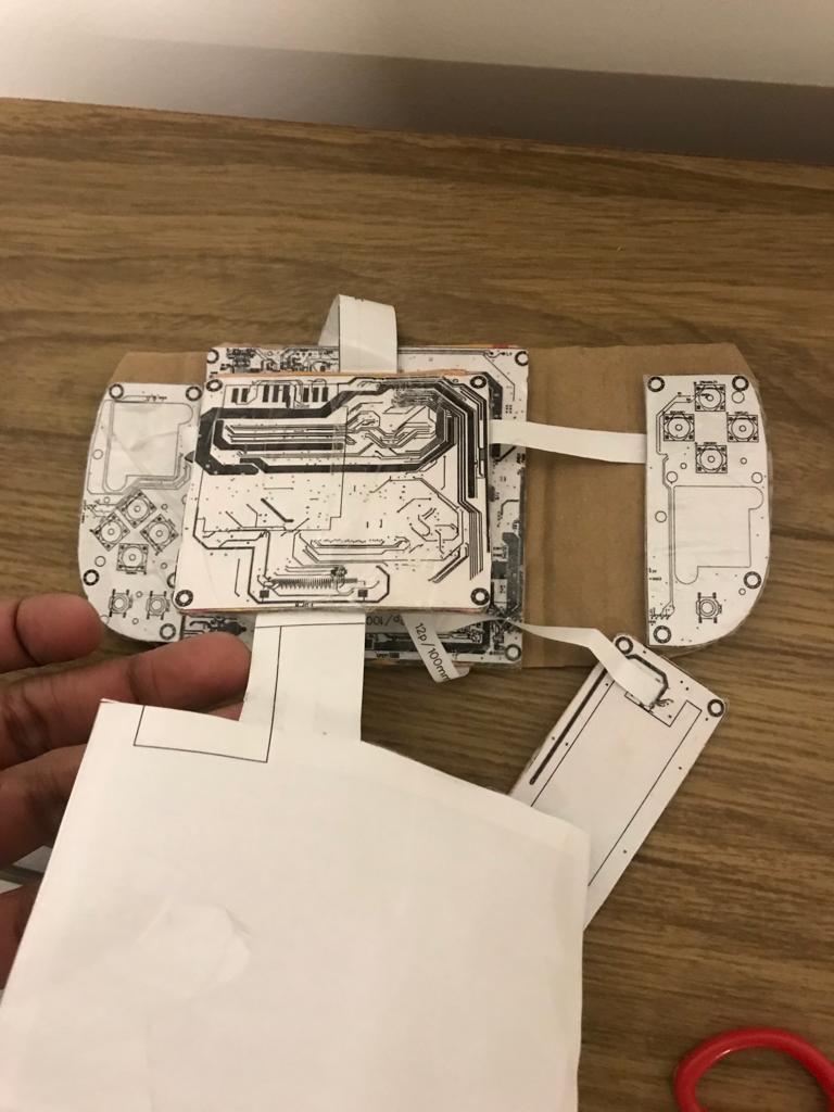

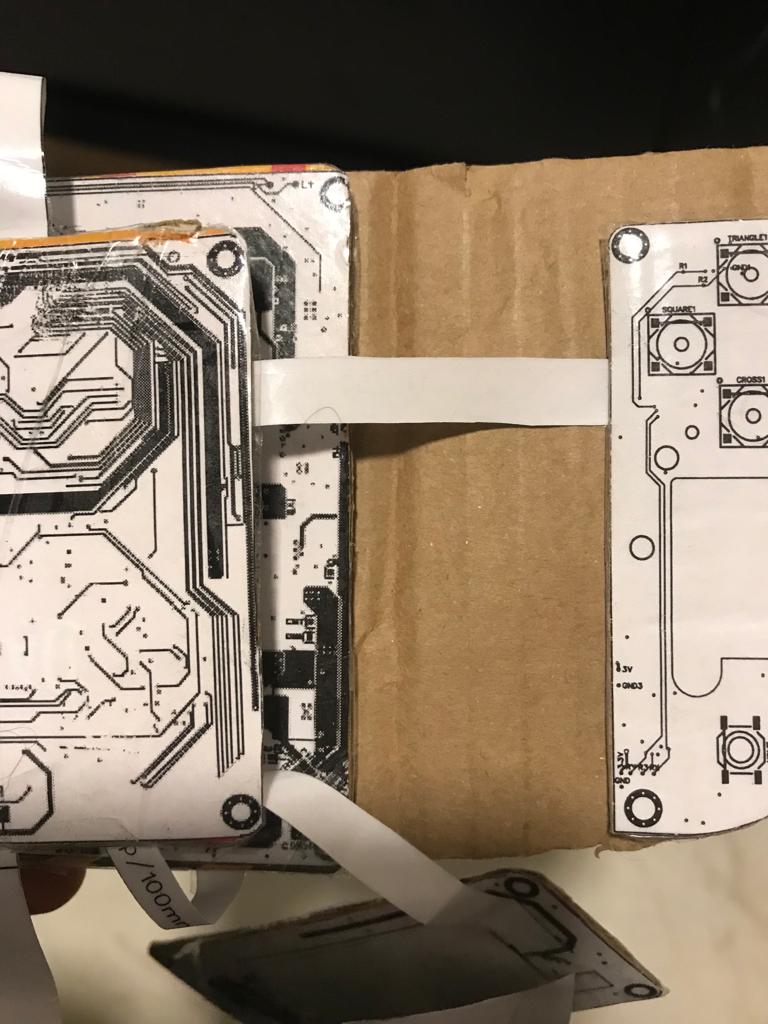

I used the printing of the flat cables in 1:1 scale, real, to have a real idea of everything and how it will look inside the case/shell, seeing this, the idea comes to me to unite the controls with the screen driver and the PCB of the mini router, but I will study this while I create the case/shell.

I created the smallest PCBs I could at the moment, and it always came to my mind to use a power bank or cell phone battery, today I used a Samsung S10 plus battery, to see how it looks, this battery has 4,100mAh and I believe that only one does not will be enough to power the game console, there is a powerbank with 10,000mAh that would give a longer gaming life, but it is longer than this, so I will have to decide between two cell phone batteries or a powerbank battery, as I want the console be very thin, so I'm not going to use the 18650.

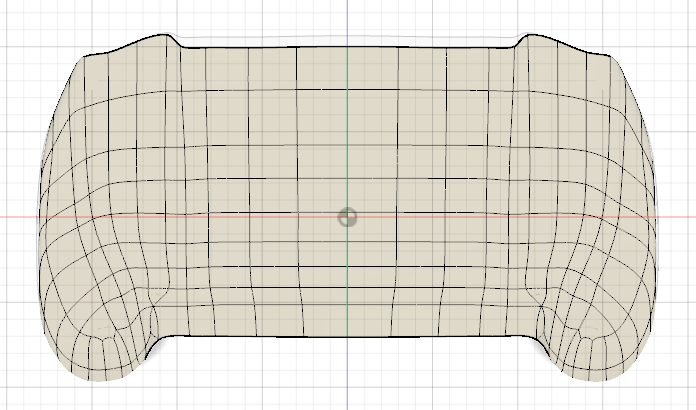

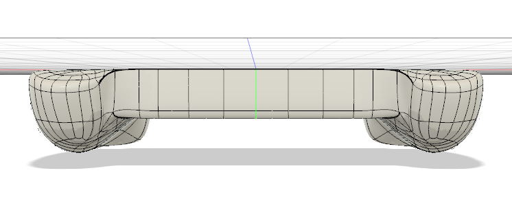

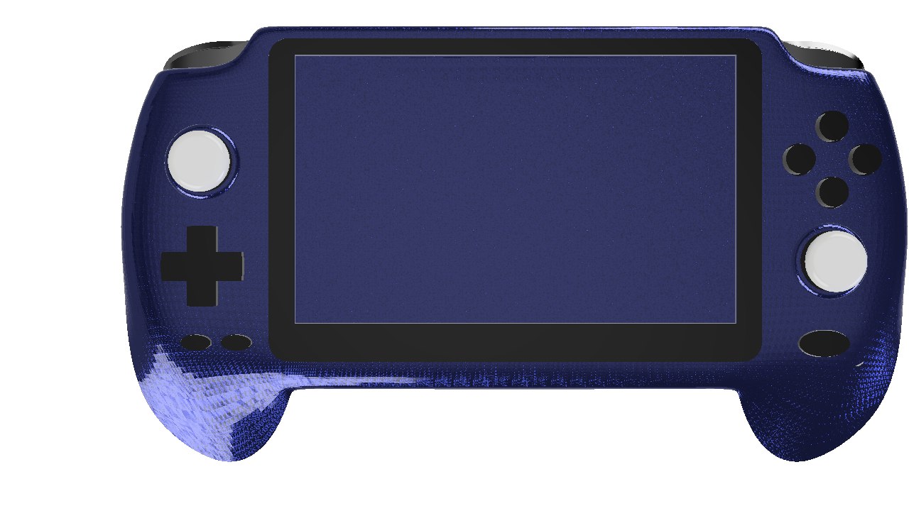

Last year I made the sketch of this case/shell, I'm still going to do something close to this, I want a case with this part that I know as 'grip' this spare part that jumps out of the case/shell and creates a grip for the hands, maybe I do something to put the batteries in that position.

This idea is interesting, some time ago me and a friend were talking about it, but with the 79k series onwards Sony abandoned this possibility of having the HDD in their consoles. In my research on the PS2 PCB and comparing it to the 70K PCB and schematics, I didn't see any real possibility, as there is no documentation of the new 79k and 90k chips. It would be a very good thing if we could rescue this.
Are you going to use FPC's or FFC's to make the connections?
I'm going to use FFC (flexible flat cable), I printed on paper real scale examples of the cables I intend to use, to understand the mechanics of everything that goes inside the case/shell.

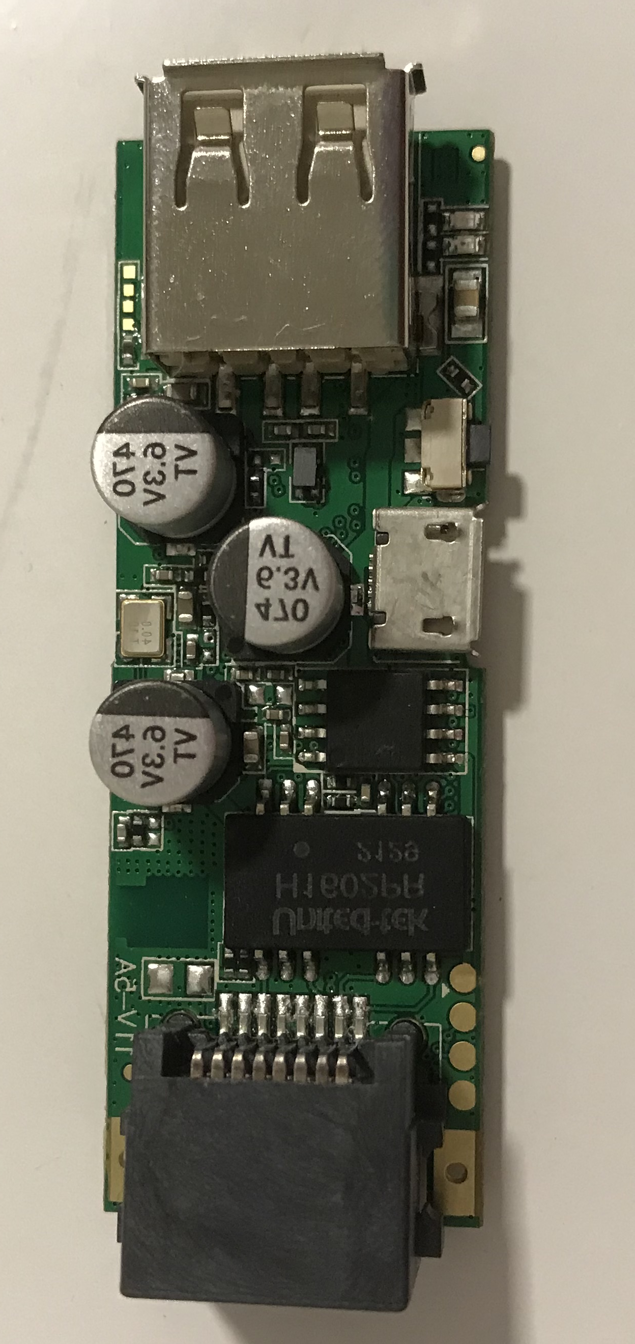

I just picked up one of these routers. Do you have any advice on how to wire it directly to a trimmed ps2?
If you have space in the case/shell, you can connect the RJ45 to the respective tracks, you can solder the wires from each pin to the corresponding track you cut. To help you better, open a question topic on the forum that I can answer you better there and show your case/shell project with the board inside so I can give you better guidance.
View attachment 22885View attachment 22886View attachment 22884

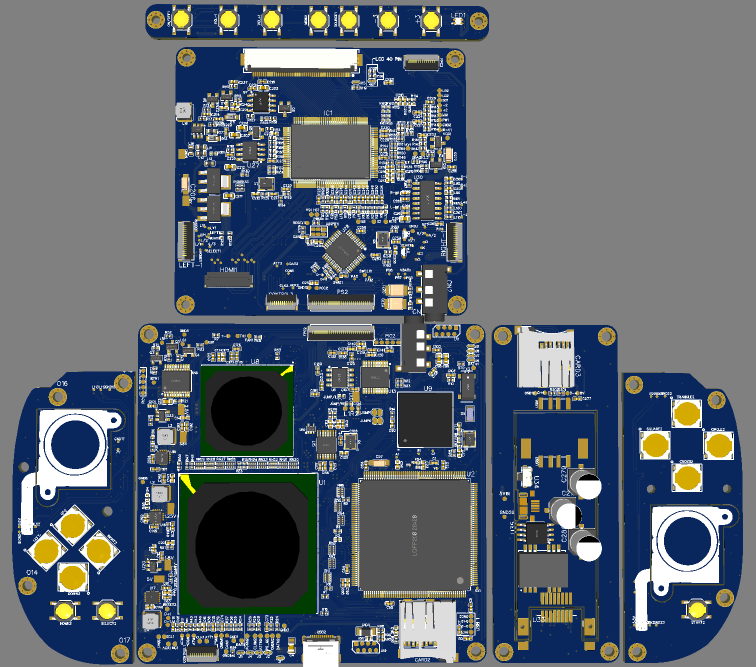

The PCBs creation part in the software is complete, all of them reviewed and ready to be manufactured and assembled for the first tests, but I cannot send them to be made without first seeing how it would look in a case/Shell, this allows some modifications to the correct functioning of mechanisms such as buttons, fitting of parts, pcbs and etc... So I'm creating the case/Shell with the help of PCBs and other components in 3D, (thanks to @Benge for providing his models of PsVita buttons and analog of Nintendo switch). I'm reaching the desired designer and very soon I'll buy the pieces for a correct measurement and tolerances. The mechanical parts are already coming, only the pcbs and their components are missing.

The PCBs creation part in the software is complete, all of them reviewed and ready to be manufactured and assembled for the first tests, but I cannot send them to be made without first seeing how it would look in a case/Shell, this allows some modifications to the correct functioning of mechanisms such as buttons, fitting of parts, pcbs and etc... So I'm creating the case/Shell with the help of PCBs and other components in 3D, (thanks to @Benge for providing his models of PsVita buttons and analog of Nintendo switch). I'm reaching the desired designer and very soon I'll buy the pieces for a correct measurement and tolerances. The mechanical parts are already coming, only the pcbs and their components are missing.View attachment 24002View attachment 24003View attachment 24004

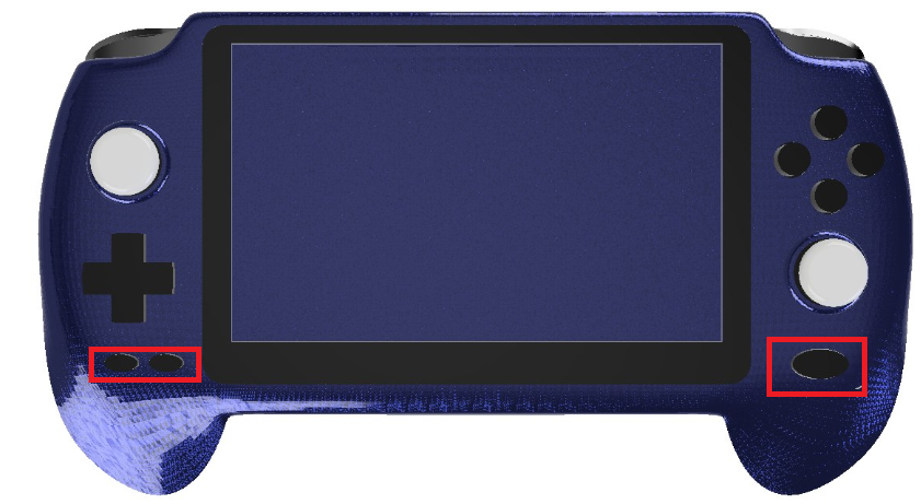

I realy love the design
but the oval buttons (red squar) don't make it justice
may I suggest something like the AYA NEO air
I can't wait to see the final product :)
I'm intending to use the buttons on the psvita, this is the button on the PsVita fat 1000, but I bought the buttons on the psvita slim 2000, so I'm still going to replace it, this is a sketch, I'm still working on the case. Thanks for the tip, the button options are many, I'll look at these now and see if they match the case/shell.
